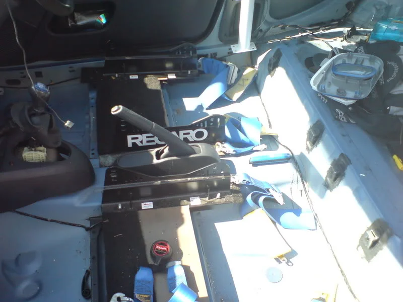

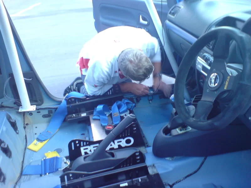

After already being halfway through this track car project, and wondering whether I should go the whole way with, I decided f**k it, so all the carpet went as did the old half cage…

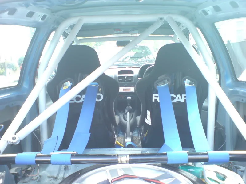

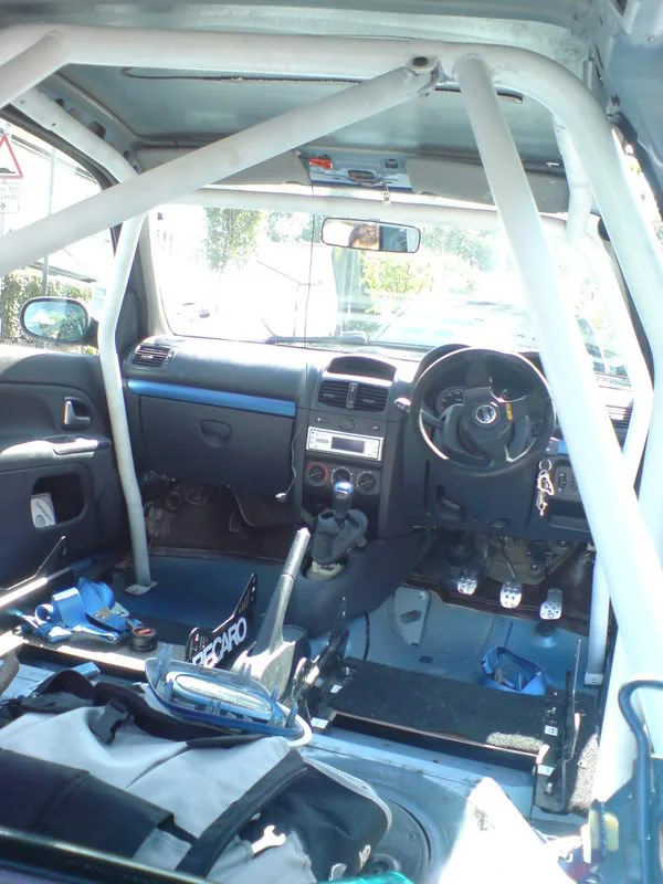

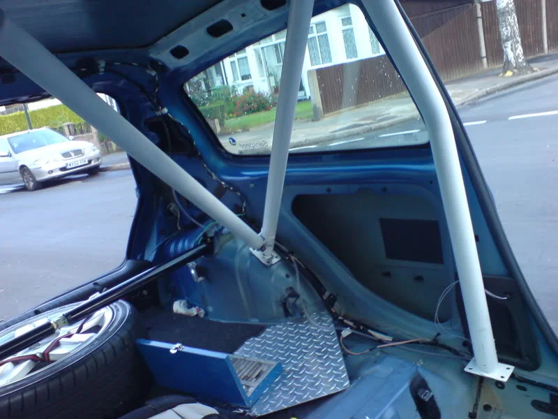

The next step was to attempt to get the OMP 6 point cage in, which surprisingly enough was easier than I thought…
Work in progress (good old dad!)
Now unfortunately, we came across a few problems with the main roll cage hoop, namely it not reaching the bottom of the car and a 4 inch gap! After a few phone calls and enquires I decided to leave the roll cage just laying in the car until I found somebody to sort it out for me!

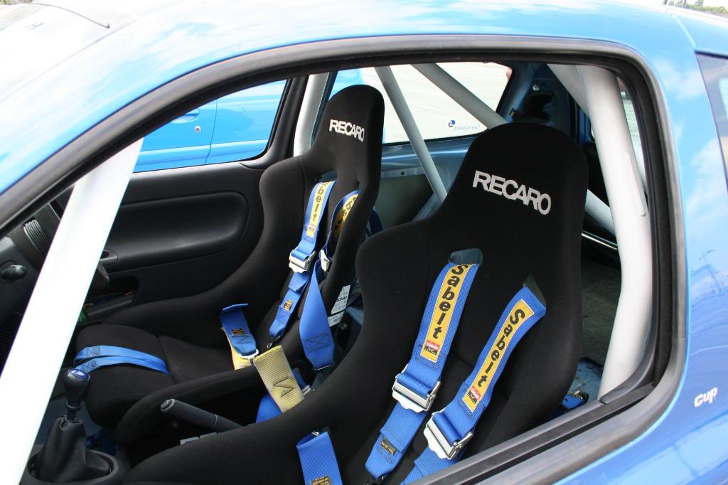

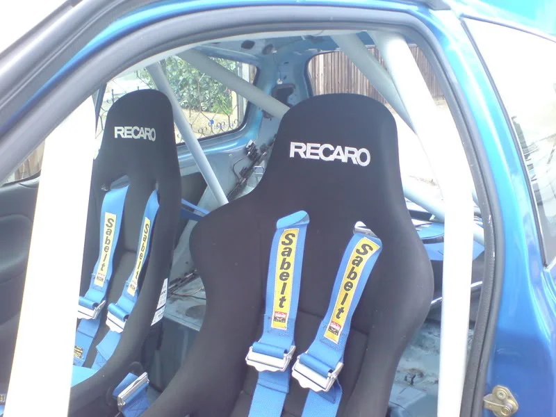

Right so that’s the cage in….seats back in, harnesses back in…done.
Now I know you lot are thinking (I’ve heard it so many time before!) GET THOSE HARNESSES OFF THE REAR STRUTBRACE, this was only a short term thing, and if you carry on reading then you’ll find the changes a bit later in the post…

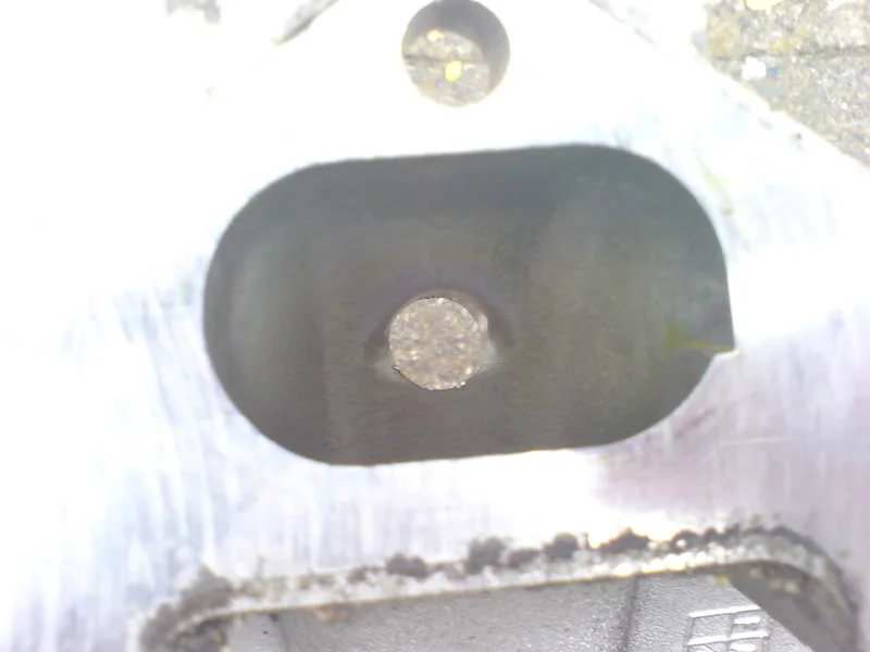

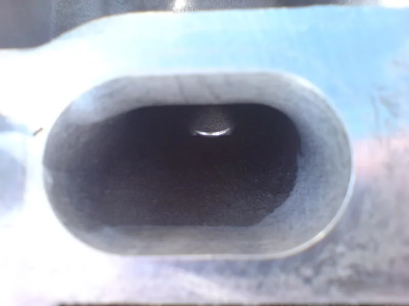

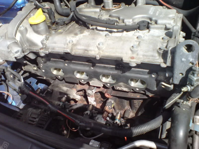

Now the cage was in, I could get round to fitting my AWT inlet manifold, which I must say was a work of art compared to the old unit I took off..
OLD INLET ALL ROUGH EDGED
AWT INLET – ALL SMOOOOOTH
WORK IN PROGRESS
After fitting, I took it for a quick spin, with the cage bouncing around when I went over every single bump I decided to only go out quickly and the car did seem to pic up quicker lower down with the inlet on, impressed, I certainly was!

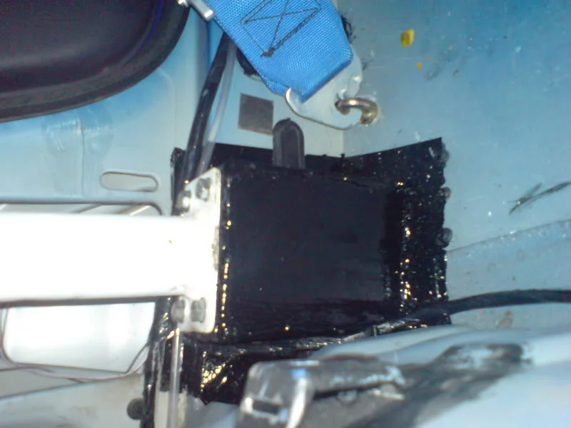

Bolt and weld it cage
Sort harnesses out
Etc etc

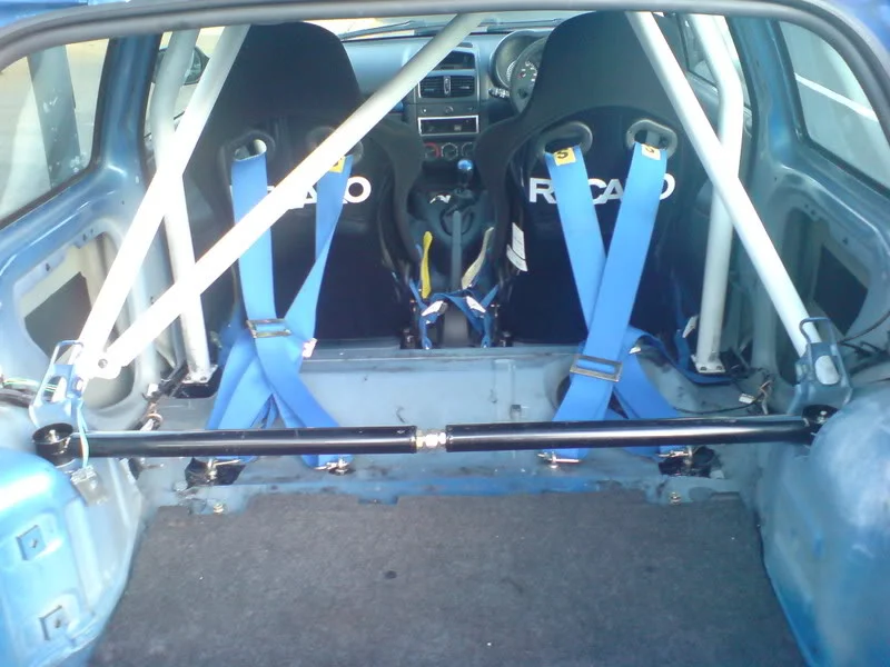

I picked the car up Saturday from Mark and it ran so smoothly with the fresh belts, service and cams, I thought to myself once this is mapped its going to be the best thing since sliced bread! Here are some pics of his work….

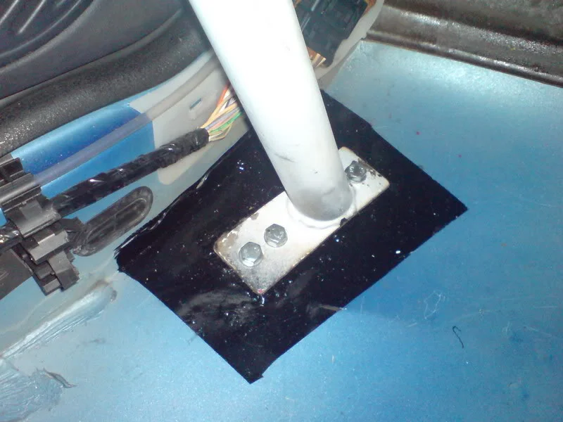

FRONT BOLTED AND WELDED
SIDE MOUNTS MADE AND BOLTED/WELDED IN
NEW REAR WITH HARNESSES CLIPPED INTO EYELETS BOLTED THROUGH THE FLOOR

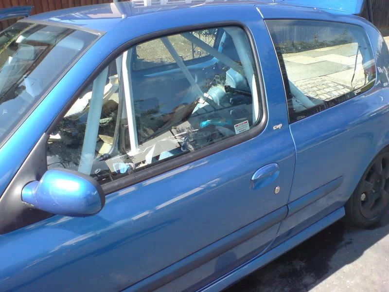

Here’s the pics of the outside with the cage in…

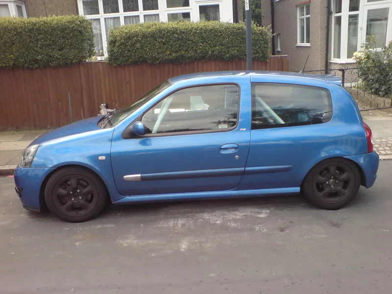

Well there she is! Wheels are for track, speedlines should be going back on shortly!
  Fiat Coupe 20v turbo
looking good chief...ph'2 are'nt the best track wheel tbh they are heavy and don't like alot of heat.
  Cup Turbo, Flamer
Ah really, i'll get rid then, when these tyres are fooked, only £25 from breakers so no sleep lost!

After all the hoo-har about harness mounting points, Mark Fish puts them there?
Looks mint on the ph2 wheels mate! Weird thing with the cage, was it brand new?
  Cup Turbo, Flamer
Yeah i thought they had to be at a certain angle etc, but if he's done them like that then i'm not gonna argue! Nah second hand cage but there is a 182 on here with the same cage he had to make up some brackets as well, strange!
M
mini-valver
I was going to say, If Mark has put them there then who am I to question! Edde has a good point though.
Omp must know about this? They're supposed to be bolt in, should'nt have to be fabricating brackets etc!

Can I ask, why are the 'belts crossed over?
Because of their length.

as for the cage, all bolt in cages will need the base plates welded in, and then the cage will 'bolt' to those. hence the name.
