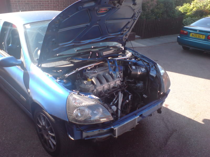

So this weekend it looked like this again...crappy phone pic
I had a breif look and it looked as though it had all pissed out of the sanwich plate for the oil cooler, had a look but couldn't really see much, so drained all the coolant (brand new 2 weeks ago!!!!) took the front end off and the rad to get a better look.
The outcome was that the braided hoses were only done up finger tight, shocking really, as I thought i'd done them up as tight as poss!
Armed with a spanner, i tightened them up till they would no more, i also stuck some PTFE tape round the fixings to stop any leaks in the future.
So all my Silkolene Race S engine oil had leaked out even though it was 2 weeks old, replaced with Halfords shizen for the time being, gutted!!
On the plus side, 5 days since then, it still has all its oil and running pretty well!

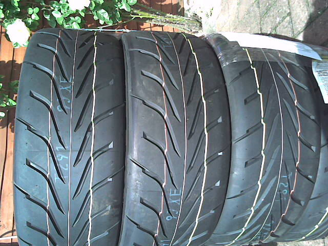

I also go this delivery today....
They'll be going on at the weekend!
