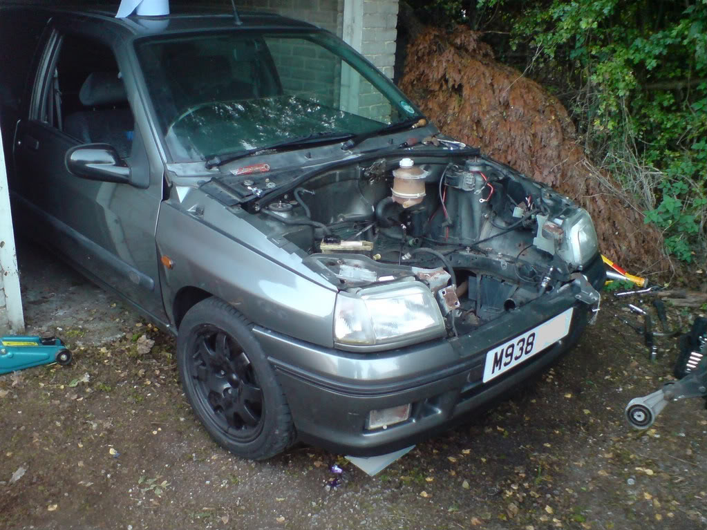

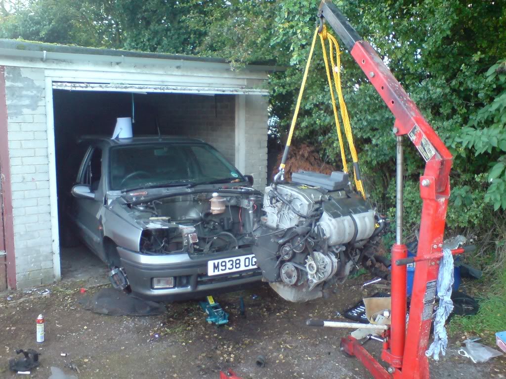

Saturday update.
Took the F7P out today! Going to tidy things up a bit, then its going down for the mounts to be made up.

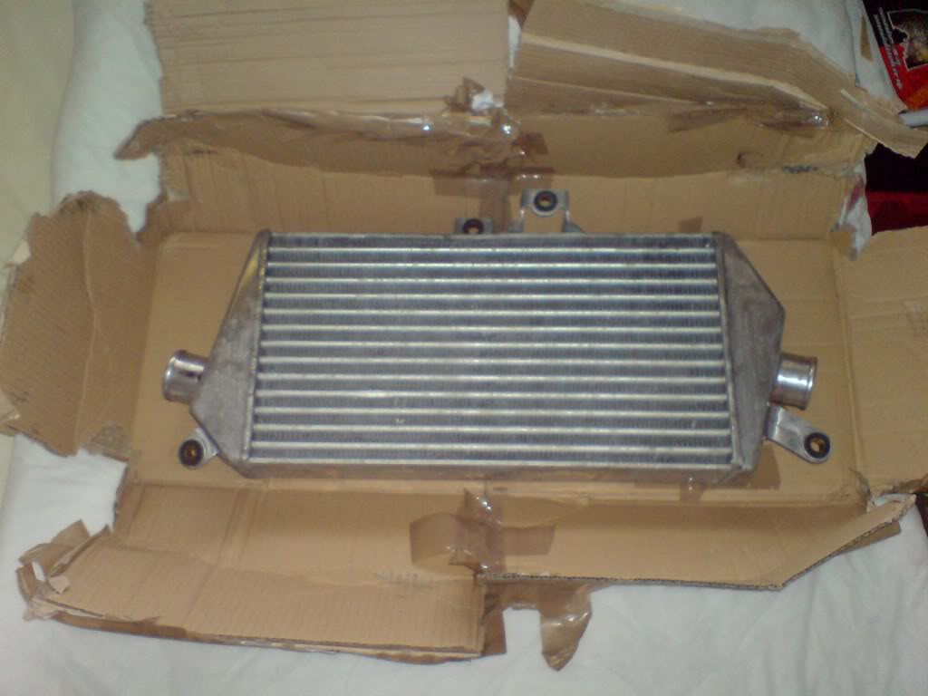

FMIC arrived too!
