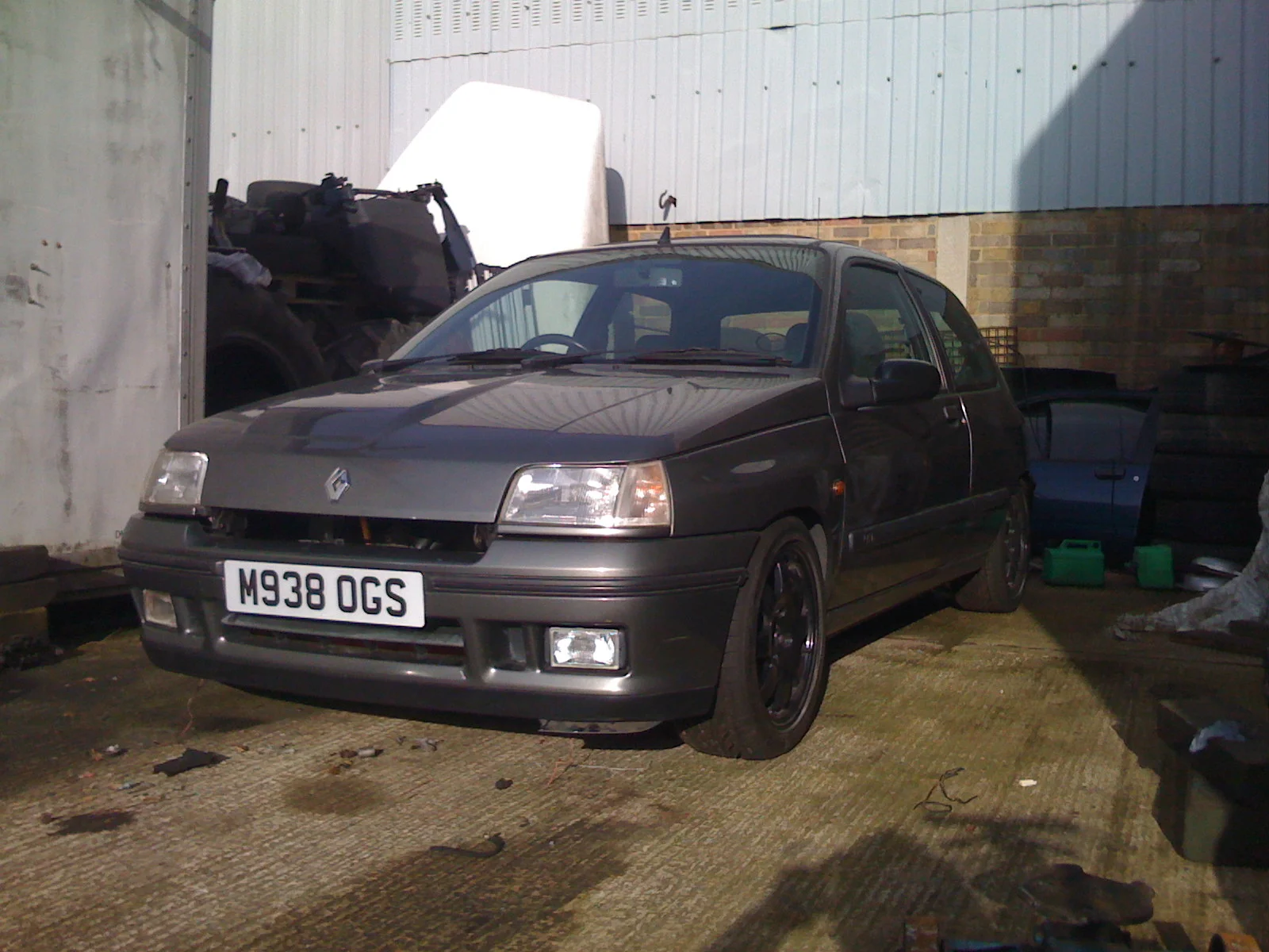

got some better photos today!
Havent had chance to do much since i got it back, other than fit the 1.2 steering column.
Need to sort a couple of bits, then it is being shifted onto the backs where it shall live for a while until its done!
will update more once I get cracking with it!

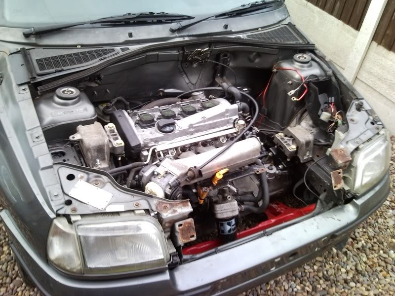

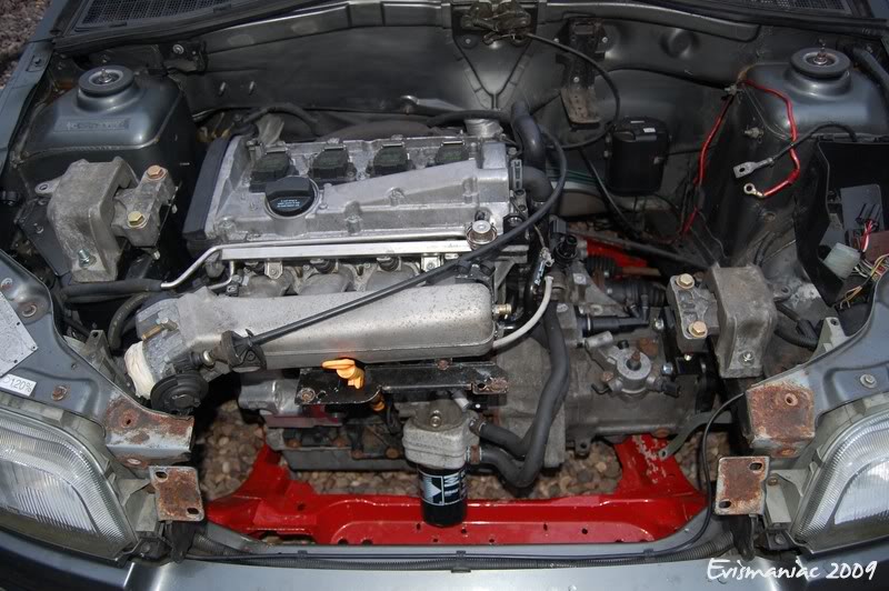

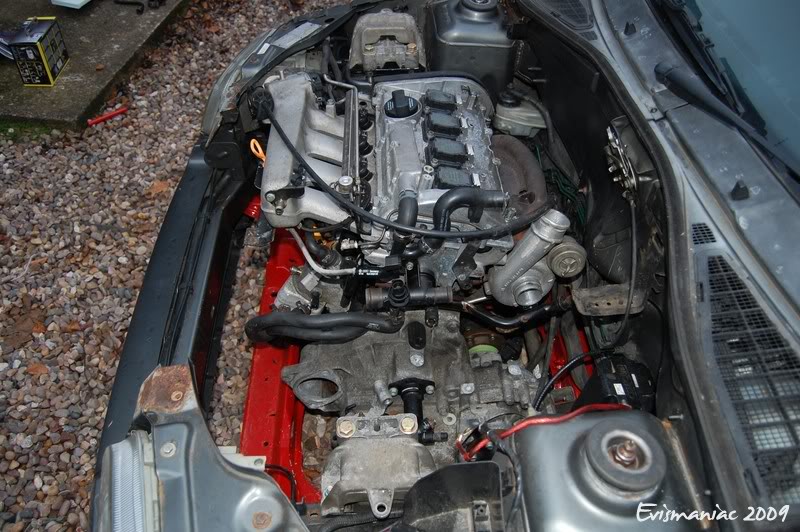

have you tried to fit the rad with that oil filter on? Doesent look like it'll go in the standard location. Filter relocation kit an idea?
More pics of engine mounts and subframe :)
  MERCEDES CLS AMG
They go but you have to bring the rad out by an inch ( towards the front of the car ) and then fit a Renault Kangoo fan motor with slim line blade. This leaves you with about 2mm of space between the filter and rad.

Mark, Filter relocation kit may be required I think, will have to do some measurements, I know flan relocated on his, but if there is another option i will look into it!

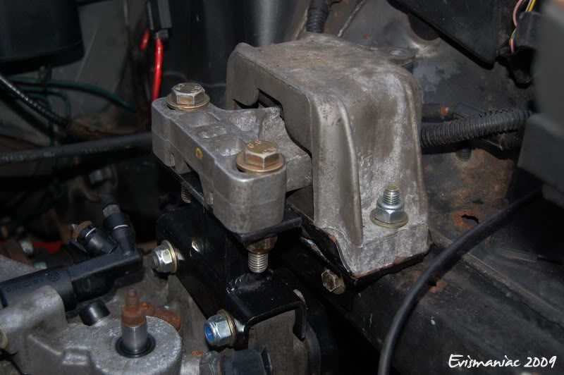

That is an excellent solution for the gearbox mount mate. Top job!
Just been trying to work out the best way to mount mine.

Have you managed to get the gear shift cables on with your N/S engine mount being there?

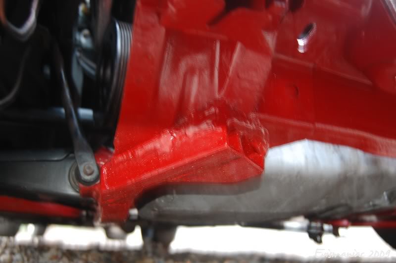

Made subframe mods. Just getting the engine mounted atm. Been trying to source some steel sections for the job, in the end found an ebay shop that'll do pretty much everything I need. Think I might get on the phone to emerald pretty shortly, see how much that's gonna set me back :(
Just a quick question tho.... Your N/S engine mount. Where you've mounted the VAG mount to the car, did you have to grind down to seat the mount properly? I've been looking at it, and I think i'm gonna need to grind right through into the arch to get the VAG mount to sit properly?

Ill check about the mount mate!
