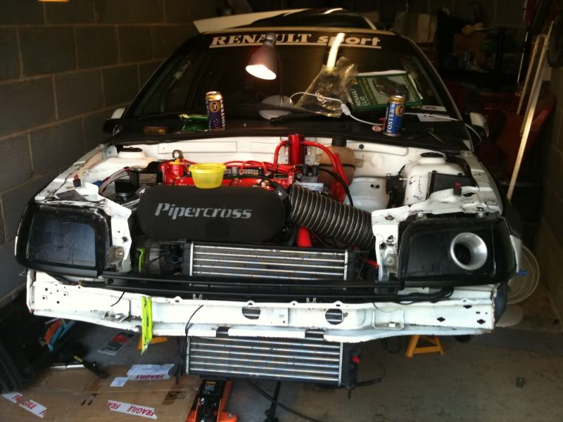

Looks really good mate. Not a fan of the headlight trumpet tho tbh
the trumpet was put there as i was going to buy and fit an airbox like the one you have and then the cold feed would go directly to the headlight
but i didnt get the time or funds to buy one before the trackday, plus i'm now not sure if the pipercross box will fit under my bonnet :S
  clio 1.8 16v, civic vti
it should fit ok if your filter does, we were going to run one on our white 205 but it doesnt clear the power steering, so it is redundant till it goes on ebay, but dimension wise where it replaces the filter it took up less room than the filter does

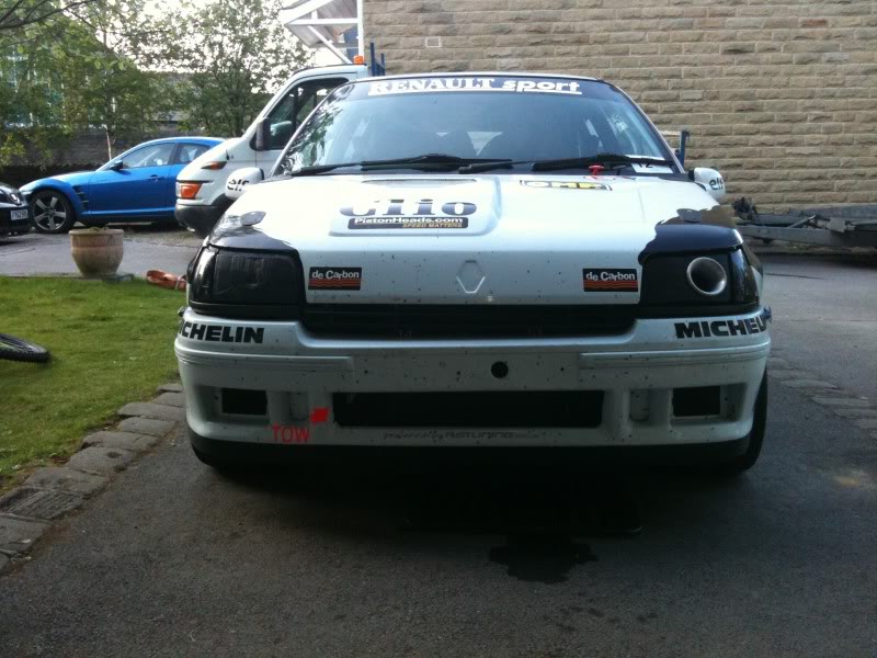

few more pics, some of when we got the car back to the garage after the trackday, plenty of dead flies and the coolant leak on show lol (found out what was causing the leak, very simple fix, for once!)
on the trailer, nearly home
track wheels still on, need to get them painted up at some point
plenty of flies to clean off

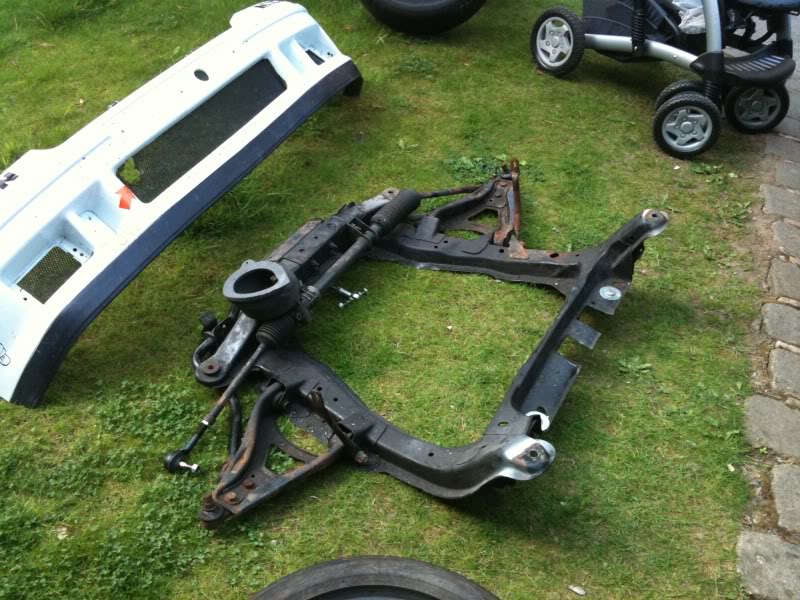

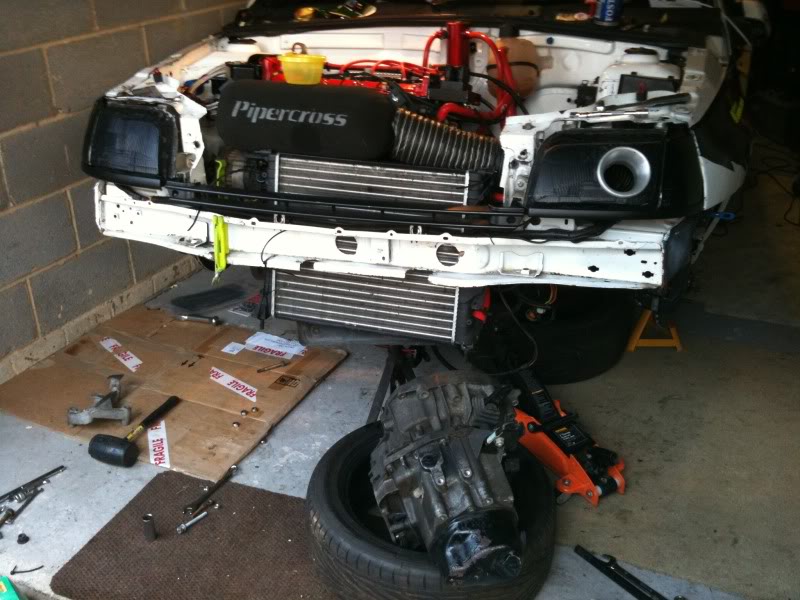

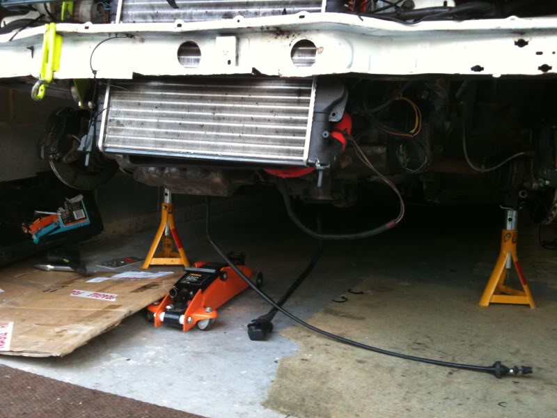

and then on sat it was time to take the gearbox off ready to send off for it's rebuild, was very hot in the garage!
subframe off
gearbox out
and it's now at Agency transmissions in Worcester thanks to Gray and Luke (The Boosh), thanks again guys :D

right, my gearbox is done and is getting collected by Luke and Gray tomorrow
had a phonecall from Agency transmissions as there were a few problems to overcome lol
basically he said that after 40 years rebuilding gearboxes, he has never seen anything like it! one of the shafts had around 1mm of play in it against the bearings, too much for it to have been created through wear, rather someone had rebuilt he gearbox previously and used incorrect parts! he was surprised it had lasted this long!
I have to say the guy is an absoulute legend, he reeled off a list of things that he has had to replace to rectify the problems (bearings, shaft, gearset, seals, pinion, crown wheel to name just a few) and has done all this in the 2 days he has had it (along with rebuilding Gray's box that was alot more straight forward)
he even spotted that the reverse switch plastic clip had snapped (been like that for ages now) and replaced that too
after all this i was bracing myself for a big bill, but no, only £50 extra over the standard £275 +vat that he had quoted me originally! :approve:
got to say a big thank you to Tony and Jay for recommending them, and a big thank you to Gray and Luke for taking my box down with them and bringing it back tomorrow, top guys :D

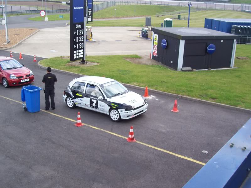

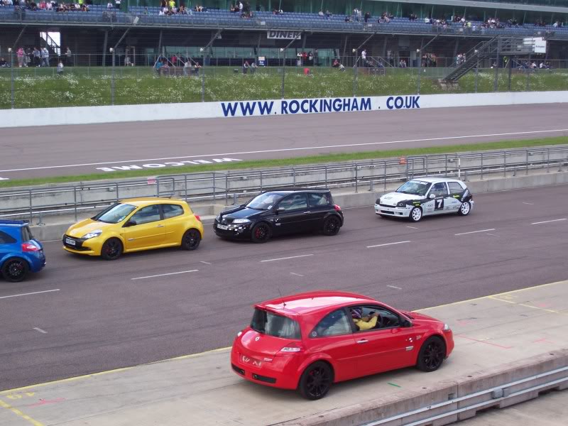

couple of pics and drive by vids from FCS
got to say i was less than impressed with the tracktime, on my second session i backed off on every lap whilst going round the banking so that i had a fairly clear run at the twisty bit, all because people weren't moving over :( also, on my last session my brother counted 28 other cars on track, i mean come on! that's just a recipe for disaster!

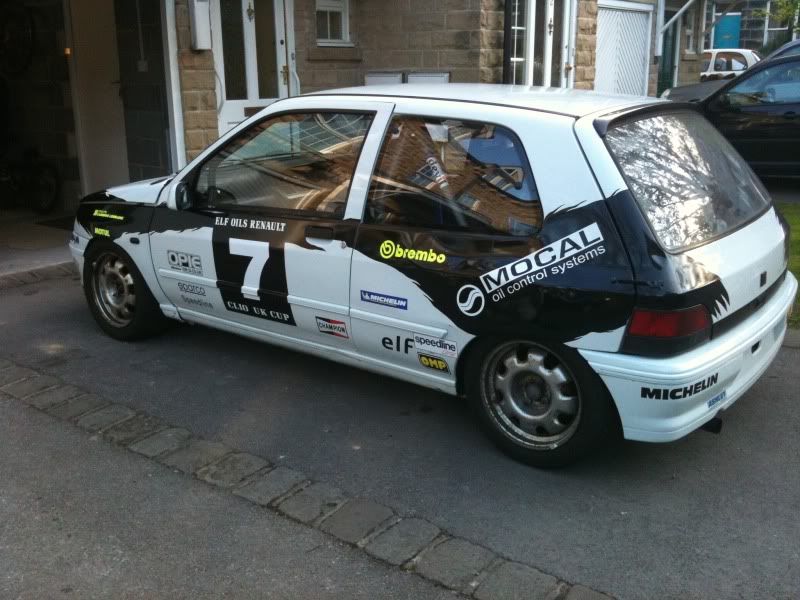

saw this car buzzing around the track.. had no idea it was you!! :eek: - not seen the decals before
looked good :approve:

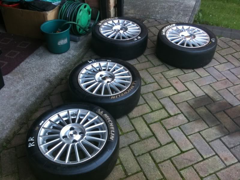

i found a supplier aswell for brand new S9B's, they aren't cheap mind! :eek:
hopefully if i can sell the alloys they will be going on a set of williams speedlines i bought at FCS

i'm still shocked at the price of them new! i can get pretty much any other size for less than the price of a 15"
be that 16, 17, 18's even :eek:
