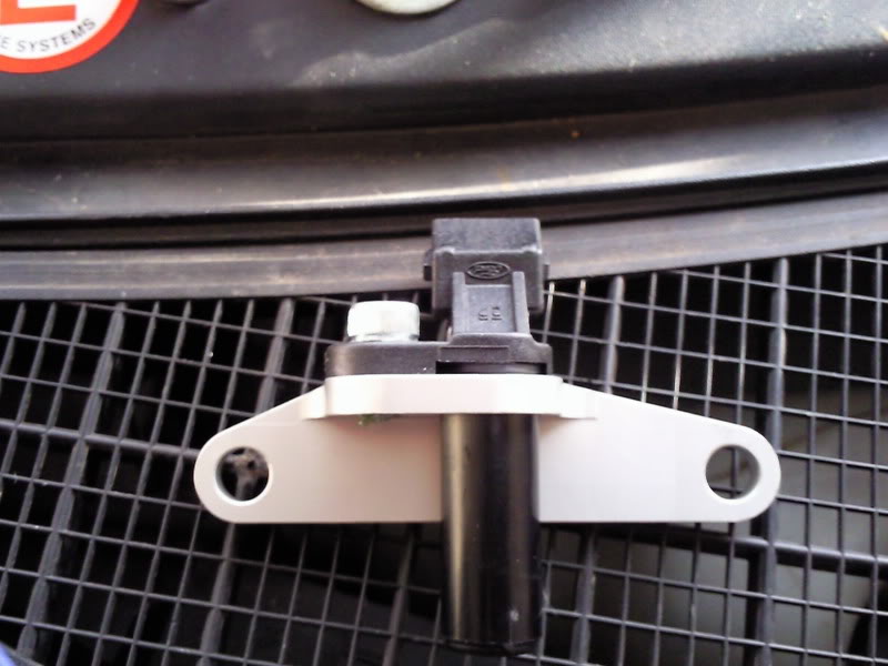

anyway i serviced the pug at the weekend so while i was over there i fit my new sensors from omex
cps sensor and bracket

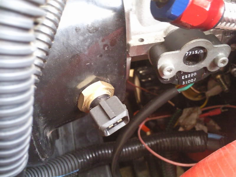

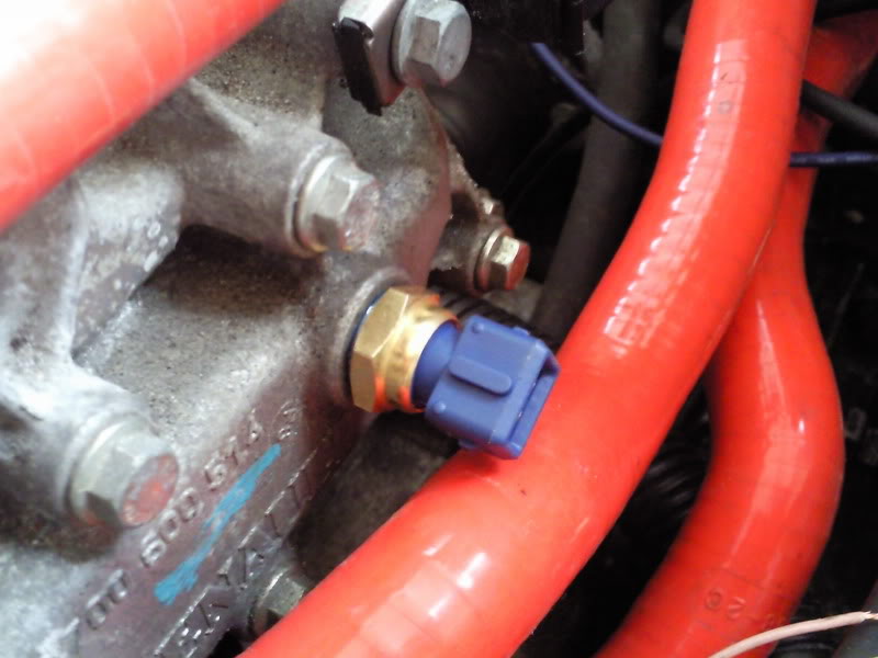

coolant temp sensor

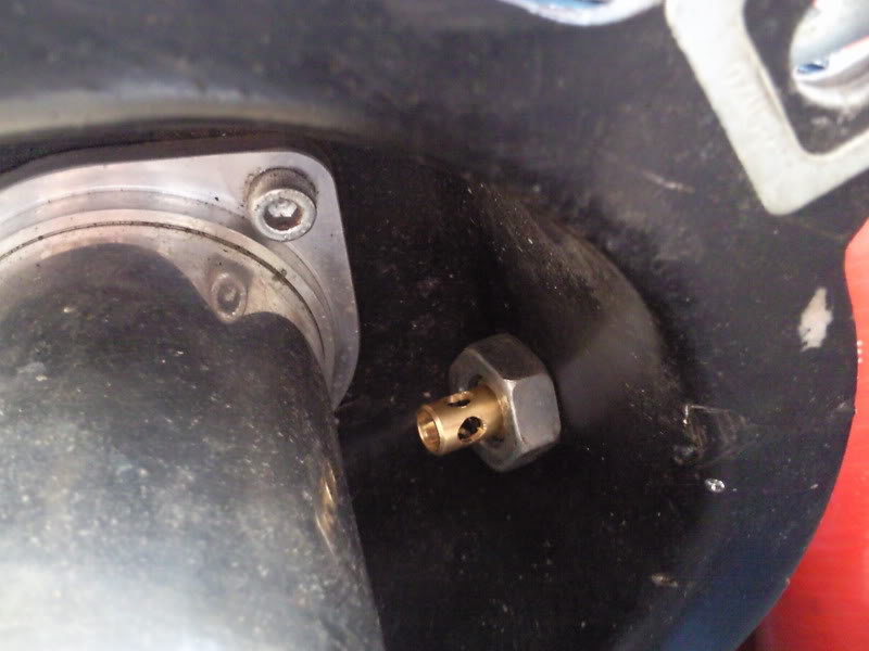

and air temp sensor (fixed into the pipercross airbox)

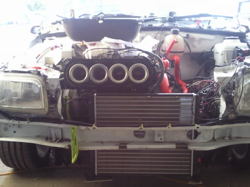

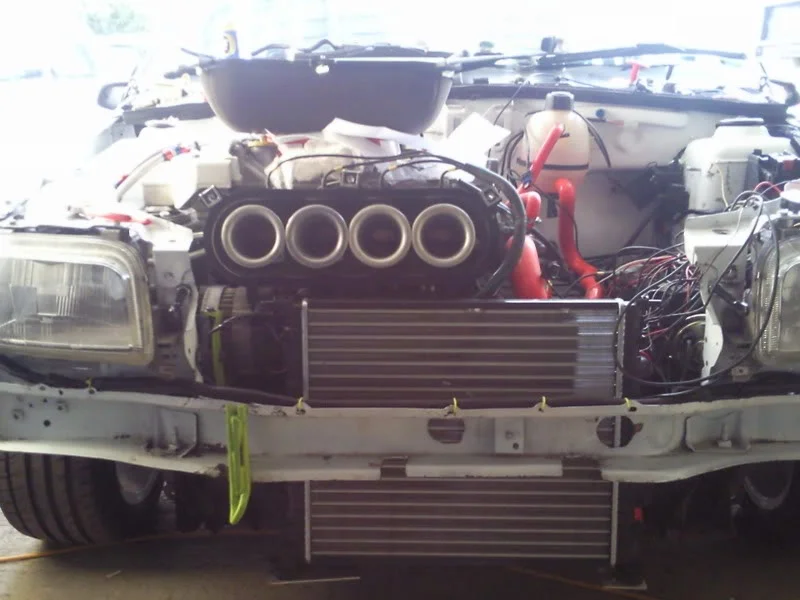

a front on shot now the rad is sitting straight

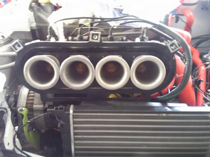

and a pic to show how tight it is for room in there!

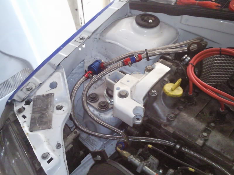

oh forgot to mention, i have done away with the FSE FPR (ben will be pleased lol) and used the Weber one, still in the same place as the FSE though, will get pics of that soon :)

Altho i would be worried about taking that out rad with road contact... might be just the picture but it looks low
yeh we were a touch concerned about that aswell :clown: those ali brackets sit about an inch or so lower than the subframe, and the bumper sits lower than that, so unless i whack the bottom of the bumper it 'should' be ok lol
your TPS is fitted wrong. you should have the plate that's on the outside, on the inside, the big hole in it centers the TPS
ah cheers danny, i'll get that changed round. i bought it like that so it must have been like that for a while on other peoples cars lol
gutted, yeh i had to shorten it due to the location of the rad, otherwise it has a dirty great kink in it, ive got to do the same with the red SFS hose, cut n shut to stop it kinking lol
yeah, well im not even sure if mine is the 172 item. goes all the way down under my clutch fork then back up the other side onto the rad lol....
I was going to cut it and try and make it into just an S bend, as the inlet for the top rad on mine is only a bit lower than the thermostat housing, but it just kinks, so im on the lookout of a way around it lol
yeah seen hoses like that, but as you said I have no idea how good they are (or not) either...
I have been looking around autojumbles when ive seen them at shows for a simple 'S' shaped hose in the right diameter, from another car etc, but ive yet to come across anything....wonder if there is anywhere that would make custom silicone hoses to specific shapes/sizes?! hmmmm.
The reason I haven't bought a whole samco/or similar set is I have no heater matrix, and im running a custom pipe to loop it back instead of going from the thermostat housing to the matrix, so I didnt want to be cutting up and bodging a brand new set of silicone ones

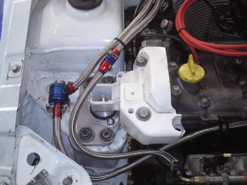

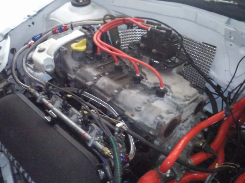

a couple of pics of the revised feul pressure regulator setup, i think it looks alot neater than the FSE

new cps sensor from omex made all the difference!

means i can tilt the engine slightly, which will help the downpipe seal, clear a bit of room for my bottom rad hose, and give more room for the ITB's and pipercross airbox/filter

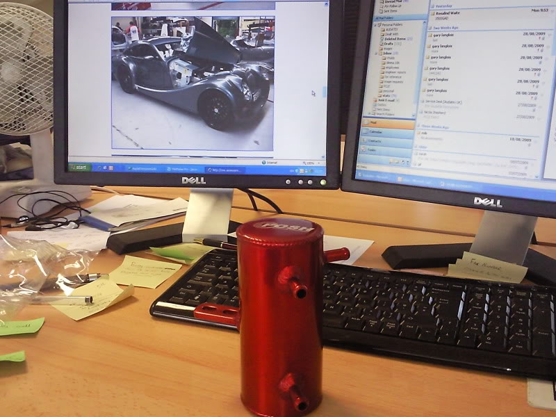

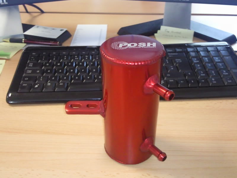

my oil catch tank arrived today, cheaper and smaller (space is a bit of an issue) than most you can buy
and just cos im sad :o a pic of Richard Hammond's Morgan Aeromax in the background which i am dealing with at work :cool:
