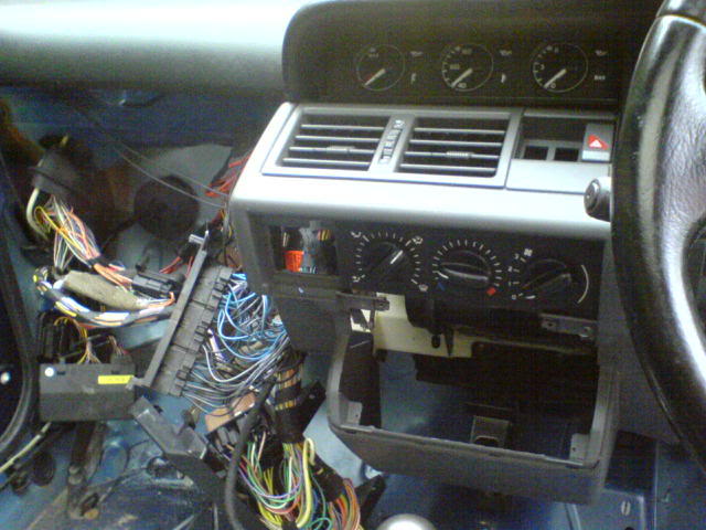

also took a dremel and a hack saw to the dash, i now have a very small dashboard :evil: and i connected all the dials and what not back in, although i think i may have mullered the hazard switch in the process :mad: only time will tell :rolleyes:

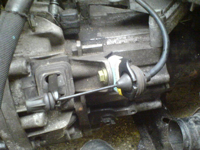

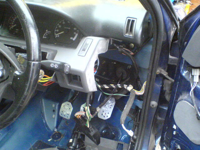

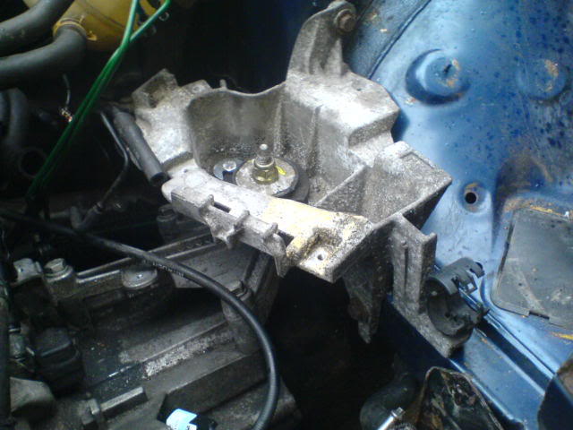

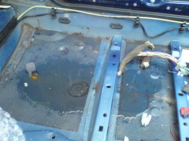

Re: My mk1 track car blog
right, did a little bit on the clio this weekend, but nothing of any an great consequence, mainly due to time and money issues, ie lack of both :(
but i took some pics of what ive been doing for the past couple of weekends..
gearbox mount all sorted
clutch cable connected up using soft pedal fork and bracket

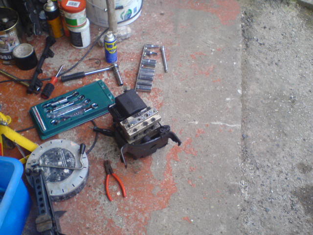

abs removed and i measured up my brake lines so will get them sorted this week

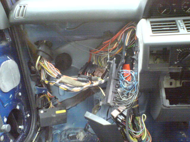

dash butchered :evil:
oh and indoor swimming pool fitted :rolleyes:
sunroof has been slowly letting water in, so i've just been out and sealed it with some silicone, hopefully that will stop it!

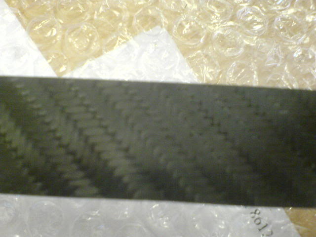

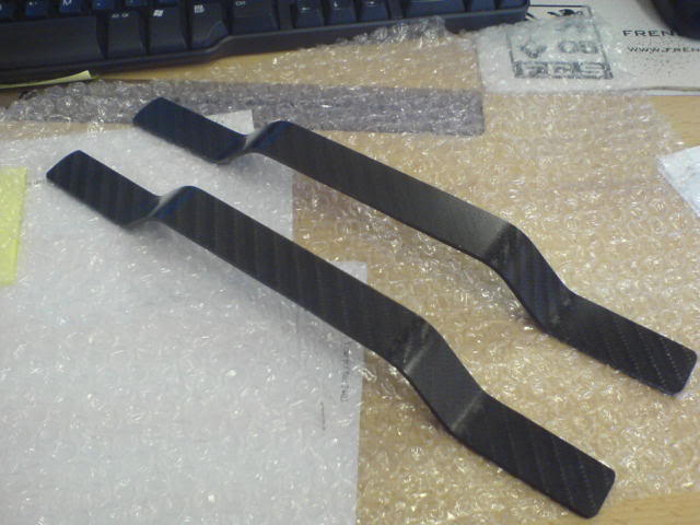

postie delivered my carbon interior door handles today
as i will be using plain carbon door cards i realised i would have nothing to grab to shut the door, so i got these
are u using a valver box?
standard clutch fork?
why did u add the cable braket?
  '92 172, Lotus Elise
looks like a 172 'box to me
the fork is longer hence the brackets to accommodate. It makes the clutch pedal a lot softer - really needed for the 172 clutch
  F4R'd ITB'd '92 cup racer
as above its a 172 box, i got the longer clutch fork and bracket from renault to make the pedal softer :)
