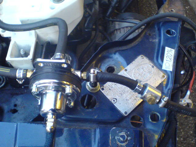

got my fuelling sorted, fse pressure regulator rigged up so that it runs inline, the inline connection to the right is for the gauge just in case you are wondering

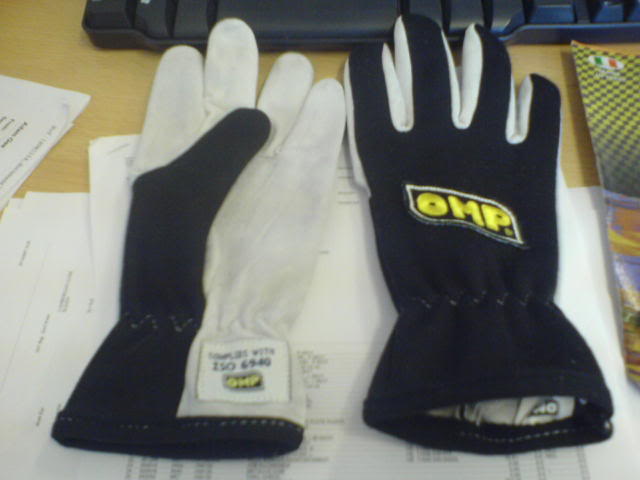

few more prezzies arrived today
my omp gloves so i dont wear away the suede steering wheel with my sweaty hands lol

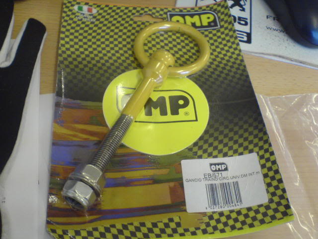

and an omp tow hook (not that i plan on being in the gravel or anything :eek: )

dude sorry to be a t**t with copy'n the handles.... but where did you get that OMP toe hook from, cant find it LOL
  F4R'd ITB'd '92 cup racer
Re: My mk1 track car blog
dude sorry to be a tw*t with copy'n the handles.... but where did you get that OMP toe hook from, cant find it LOL
lol dont worry about it mate :D
ybracing (omp distributor) i have used them quite alot for the clio and for the 106 in the past, take your pick from these they stock
http://search.stores.ebay.co.uk/YBR...ACINGQQfsooZ1QQfsopZ1QQsaselZ89270726QQsofpZ0
i was orginally going to get the flat style hook, but mounting it and getting it to stick far enough out of the bumper to be visible was going to be a farce :rolleyes:

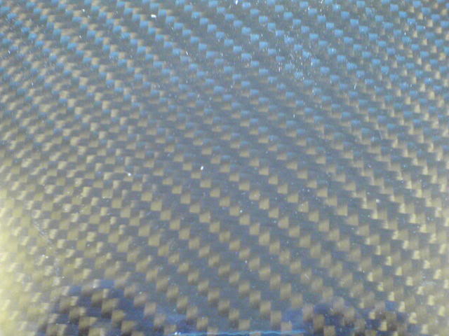

delivery man has just been......:clap:
will take some pics for you all at dinner, had a peek in the packaging, i spy carbon weave :D

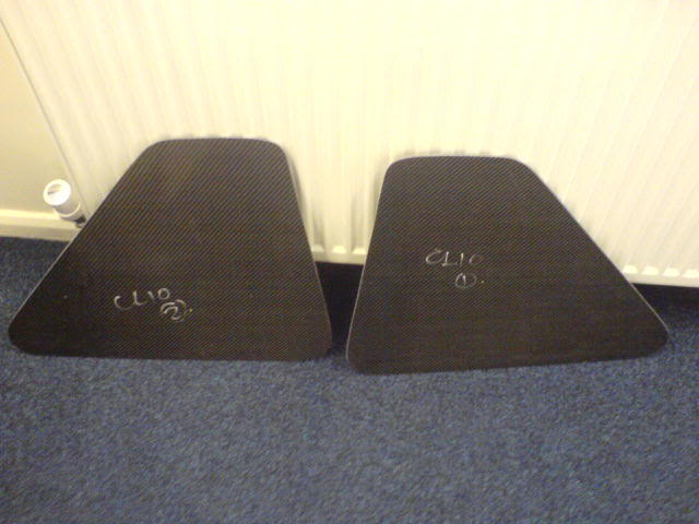

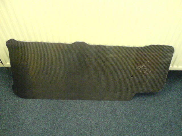

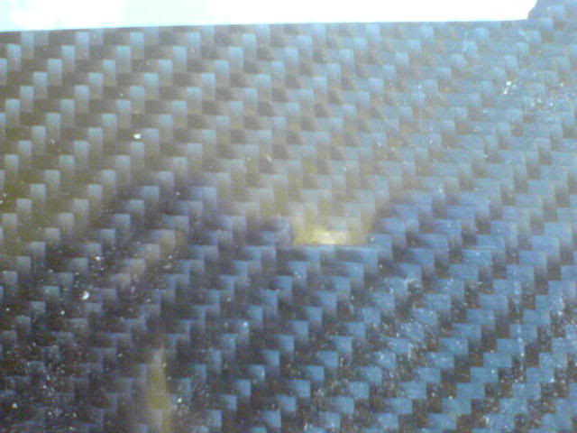

here it is, been waiting a long time for this to arrive....
:cool: :evil: :race: :clap:
* i have just realised that he has drilled a hole for the window winder, but not one for the door handle, so i'll have to do that myself :rolleyes: any tips or tricks for cutting carbon fibre?

very nice! u plz`d? r they from that company that u gave me the web address for?? how lomng did they take to arrive?
yeh same company i sent to you mate :D
im very pleased with the quality of them, just need to line them up to the car to make sure they fit correctly, cant imagine why they wouldnt.
i ordered them around 25th october, got an email explaining that they were very busy but that i should expect them in 3 weeks. 3 weeks went by and i still hadnt heard anything, but i wasnt in any rush so i left it, got into december and i was itching for them so tried contacting the company, rung and emailed numerous times but got no reply, thoughts entered my head that the company had gone bust and that i was left out of pocket! eventually the guy did answer the phone and he was very apologetic, really sound guy and promised me they would be sent out that day (friday), they arrived today so i cant really complain at that :approve:
considering they do stuff like this...
i can appreciate that they were busy lol

there the same as mine i never got the handles cutout i used a small drill and drilled loads of holes then filed the edges smooth

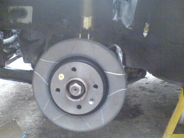

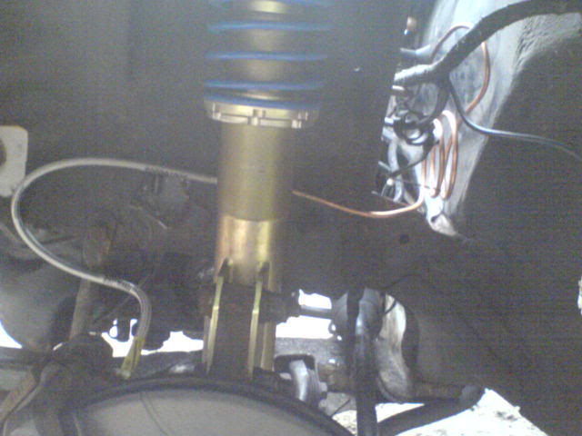

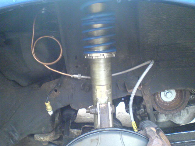

right, this weekend i have been mostly crawling around on my back under the clio in sub zero temperatures :nono:
first thing i sorted was the aux belt, picked it up from a mate who works at andrew page, then fitted it in about 5 mins :D
then i fit my replacement n/s driveshaft as the nut on the other one wouldnt start as the end thread was damaged
then i made a start on the brakes, i'm not going to go into massive detail, but basically the carbone lorraine pads i bought are wrong, only realised when i tried to fit them, then spent a good hour cross referencing them against the carbone lorraine website which confirmed what i had feared :(
i did however get the front discs, front pipes and braided flexi's fitted. as you will notice the front pipes i got made were slightly too long, so i put some loops in there to sort it.
and then started on the pipes to the rear which i didnt quite get finished as it got very dark and i smashed my lamp. i contemplated removing the rear bias valve and using some adjustable valves, but then looking at the price of them i decided to stick with the original setup. hopefully 2moro i can finish the rears and end my new found hatred of fitting brake pipes (i used to hate it when using a ramp, so doing it on my back in the freezing cold has just made it worse! :dead: )

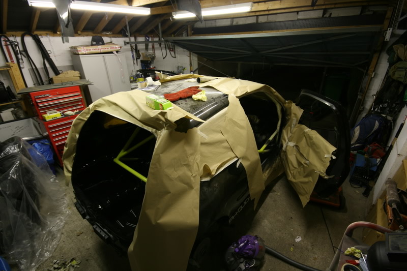

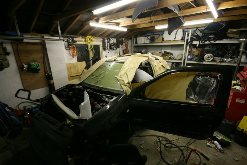

ive just got in from outside... oh its soooo f**king cold, im in a garage though..... feel for ya dude.
my progress has dropped right off dude to the freezing temps !

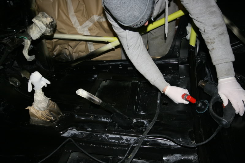

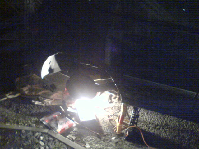

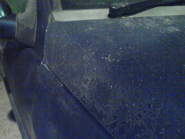

i managed to finish off the spraying..... for some stupid f**king reason a few areas have reacted? sanded it down to the steel, re sprayed.... still f**king does it... wierd
ive got 5 layers on. wooly hat, fotball sock on my c**k.. and ive still got blue lips!
heres a few pics from tonight!

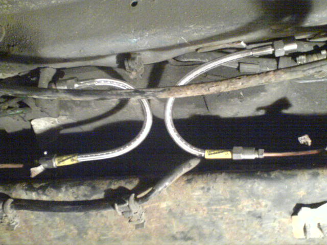

where you have coiled the lines.. could you not just slide the unions back, cut the pipe and flare them?
dont have a flaring tool :clown: had the pipes made up at a garage across from my work....a good 40 miles away from the car! lol
its no biggie, im sure ive seen some tuned cars with the same. i could get them cut and flared when it goes for its mot, but thats a long way off.

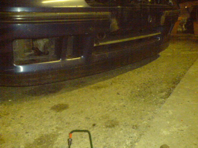

well i dont think anyone can knock me for commitment on this bloody car :rolleyes: i was out there again last night!! :quiet:
this was my work area

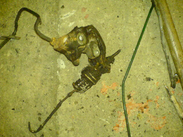

removed all pipes from the bias control valve, then removed the unit itself as it looks like it might not have worked for years :rolleyes:
what you think? give it a clean up and see if its ok, or just whack a replacement one on there?
fit new brake pipes to rear calipers, then braided flexi's
and just to show how cold it was.... :dead:
and if only i could get the front this low all the time :evil:

looking good dude, id change that bias valve, whilst its off etc..
yeh i was thinking that, moves freely enough, but i dont know how easy they are to source, i'm on with it now :)

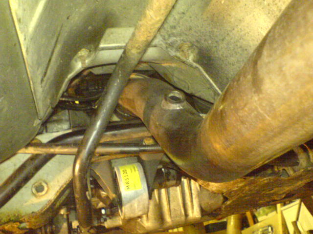

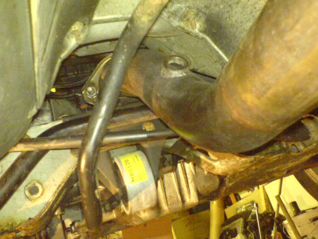

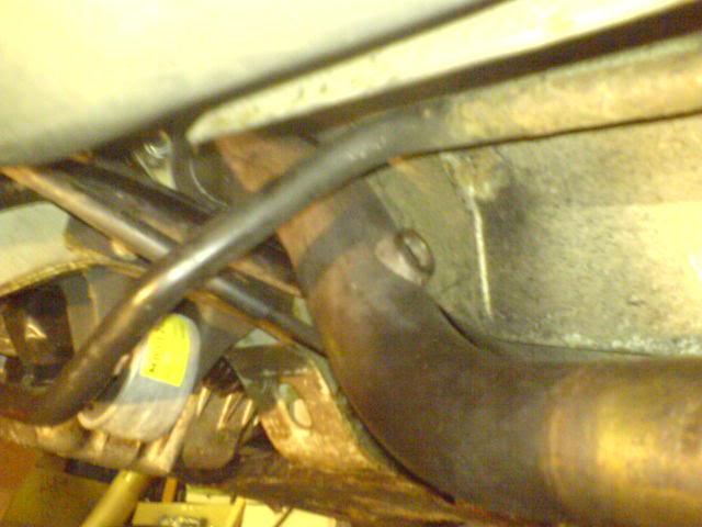

right little bit of progress but not alot as xmas is a busy time of year :rolleyes:

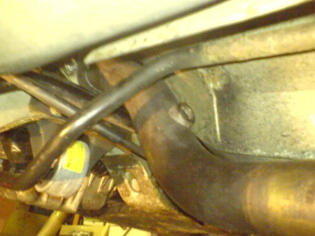

after talking to people who had already done this conversion it seemed the only solution on the downpipe was to make your own. i had pretty much accepted this and was getting ready to buy some jetex exhaust sections to make my own downpipe, when a 172 cup decat popped up for sale on here. it looked about right for what i needed but i couldnt be sure, price was good so snapped it up. so the other day came the moment of truth, would it fit and save me a bit of hassle, or would i be selling it on and buying the jetex stuff after all?
result....
IT FITS
checked it for clearance on the arb and there is more than i expected, can easily get my hand in the gap thats left! onbviously i wont know if it knocks/bangs on anything until its being driven, but its looking promising :D
