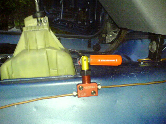

basically it lets you adjust the amount of fluid pressure to the rear brakes, meaning depending on track conditions/tyre temp/tyre wear etc you can control amount of rear wheel braking
lets say im on track and its quite slick, meaning that the rear wheels are locking up under heavy braking, i can adjust the valve whilst on the move so that it stops them locking up
also means you can get the balance just right to minimise dive under heavy braking (thats the weight shifting forwards, making the car unbalanced and leading to the arse end wanting to step out when going into a corner)
theres alot more to it but im no racing driver :eek:

Ah right! I thought it was for front brakes aswell! Makes a little more sense now! I was thinking "Why would you want less brakes?" LOL!!!

well you can setup the bias valve any way you like, so you could have it altering the front brakes or each wheel individually, front left front right etc

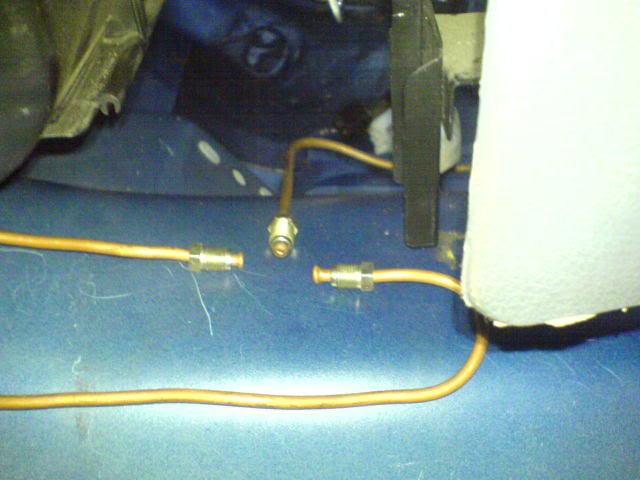

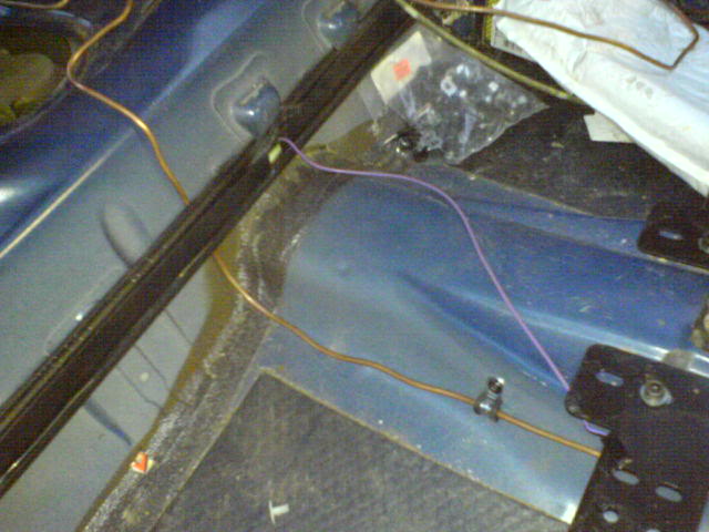

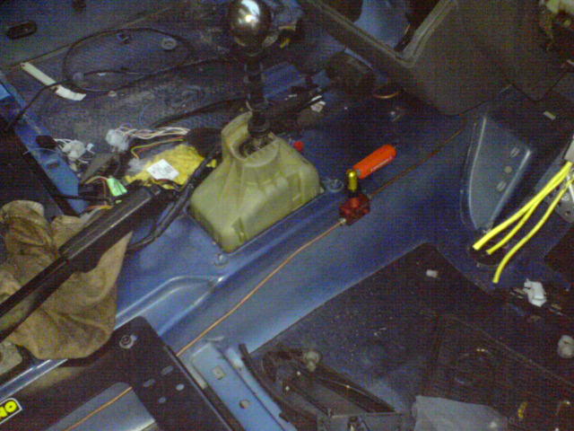

right bit more done today, couldnt do anything yesterday as i was busy.
fit my rear pads, just bought some cheap omp ones for now, will upgrade if they are cack.

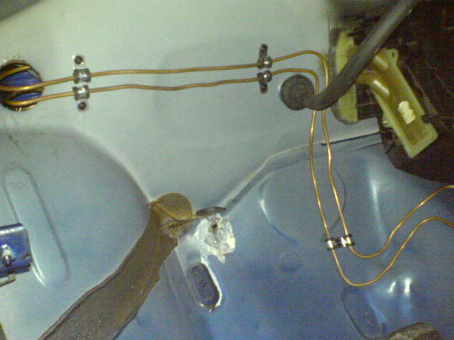

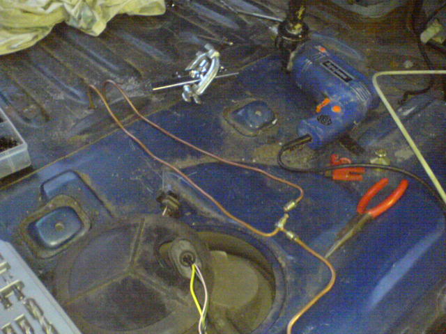

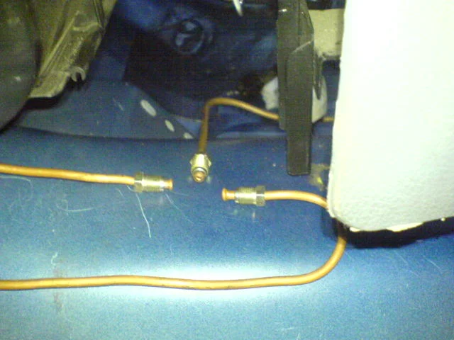

i borrowed a brake pipe flaring tool aswell so that i could sort out my in car bias valve, and also trim my front pipes that i had made too long and had to coil up.
so i started by removing the 2 front to rear pipes that i had run under the car, then re-routing them through the bulkhead like so
which run to this
im still waiting for my T piece joiners to arrive so cant connect it all up as yet :rolleyes:

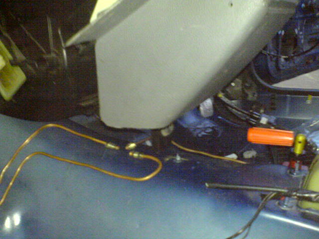

the single pipe then runs to this, mounted it just in front of the gear stick, easy enough to adjust, but not too close so that it can be knocked by accident

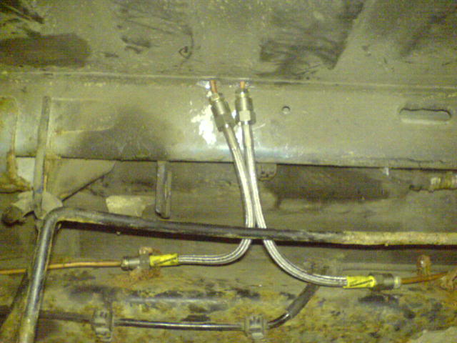

the pipe then runs under the seat subframe and up to another connection where it splits into 2 again
these then go through the boot floor and into the braided flexi's under the car
so once i get these T pieces that'll be the braking sorted, including:
standard valver calipers
brembo max discs
carbone lorraine pads
goodridge braided flexi's
all new brake pipes throughout and front to backs run inside car
Tilton 7 point in-car adjustable bias valve
standard rear discs
omp rear pads
Motul rbf600 brake fluid
should be ok for a few corners at least :clown: :approve:

Looking good mate! Some brake pipe there, lol!

You going to put rubber gromets where they go through the floorpan?
yeh to stop them chafing (sp?) just need to find something the right size, also going to spray with waxoyl to prevent any future rusting on the boot floor
going to do the same where they come through the bulkhead, because ive got no arch liners you can see right through to the front wheel, might get a bit chilly for my passenger :rolleyes:

It is easier to put the grommets in first then push the greased pipes through them,than try to put them through after,but we all learn the hard way.Good luck with the project.
i'll be able to get some that go over the unions, failing that i can cut one side and wrap them round the pipes, as long as they are protected they dont have to be air tight, car is going to be
noisy/cold enough as it is :)
and yeh i know about learning the hard way all too well, like today when having a lapse in concentration i flared a pipe without putting a union on first, done that plenty of times before now :eek:

i just find making pipes fiddly, plus getting them to bend to the contours you want is a farce, and then i find they never look super neat, ah well at least its not something i have to do every day :D

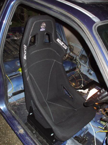

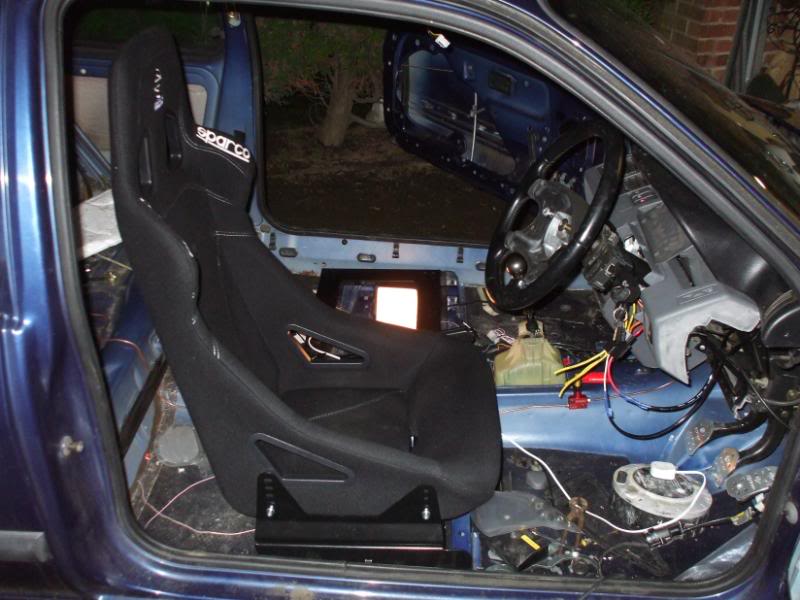

well normally i dont get to work on the clio at all during the week, but today was an exception, ive been on a course for work over the past 2 days, got a nice early finish today so went about fitting one of my seats and doing some odd jobs on the clio
so got the seat out of the packaging and fit the side mounts in the house, next thing i turn round and my apprentice technician is 'testing' them thoroughly :rolleyes:
so after they had passed the rigorous testing i whacked them in the car, had them on the lowest settong at first, but as im of normal height* (* read short) i had to raise them up a bit
good god its actually resembling a car now! :clown:

fitted one of my seats last night too, can barely see over the steering wheel haha
yeh i like the stealth look, but ive always loved touring cars that are stickered up to high heaven, and although its not a race car, its as near as i can get (for now ;) )
what subfames you using?
my eye level wasnt over the steering wheel lmao, and although im getting a smaller wheel, it just didnt feel right, it still feels like im sat on the floor, but now i can see where im going!
and to think i was going to use ultra low subframes :quiet: glad i didnt!

Im 6ft 2 and can just see over the dash. Im using cobra subframes with runners modified to fit the sparcos, I thoguht tit was going to be high as well with the runners, great seats for the money though!

So i assume the seats measure up with Sparco side-mounts, and omp sub frames? Or have i read that wrong!
indeed mate :D
got sparco seats and sparco side mounts, then omp clio specific subframes
a little birdy told me sparco and omp products work together in other applications aswell :D which is nice :cool:

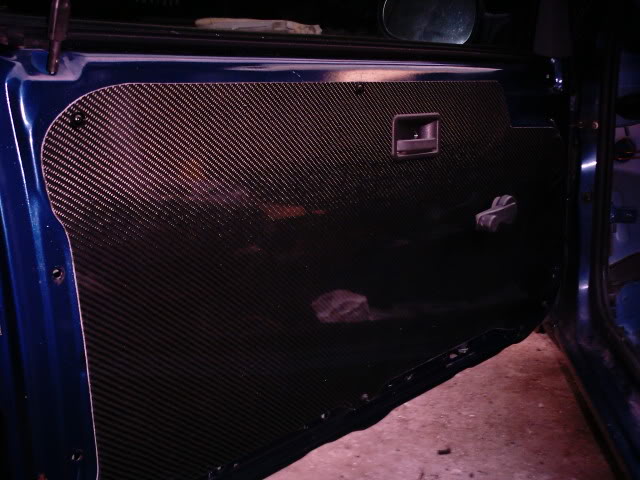

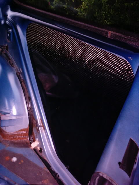

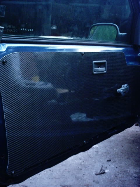

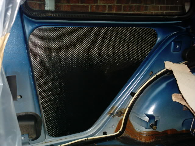

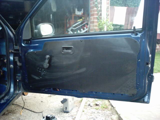

right not a lot to report today, got my arb fitted with powerflex bushes and got my carbon door and qtr cards fitted (all bar the passeneger door which i am fitting 2moro) pics to come 2moro

right bit more done this weekend, i have decided that the cage is going to wait until the car is on the road, that way i can have my ideas put into practice by a very good welding company, you'll see what i mean when its done :cool:
so with that in mind i could start fitting the interior bits, so got to work on my carbon door/qtr cards
and i also finally got my arb fitted with powerflex bushes and fit my magnex (which was a task in itself to get the ktec centre section mated to the 172 cup decat, and then to the magnex backbox :rolleyes: )

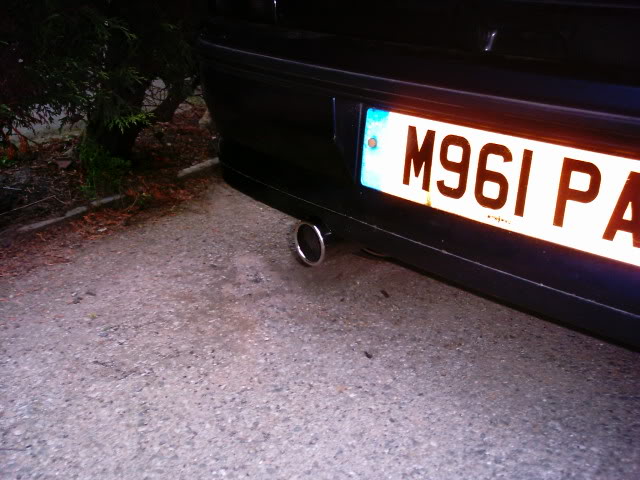

with difficulty and a bit of luck lol
basically the ktec centre section comes with an adjustable flange slotted into the end, what i did was take this out and turn it round, then weld it in place. the bit on the end of the flange that would normally slot into the centre section then slots into the 172 decat, bolts through the 2 flanges (with a bit of adjustment from the grinder lol) and tighten up, jobs a good un :D
i can take pics next weekend when its light to explain it better

my 16v exhaust is a straight through that includes the decat... that will be too long yeh?
  F4R'd ITB'd '92 cup racer
Re: My mk1 track car blog
yeh, unless you make your own downpipe from angled sections like i was going to at first?
