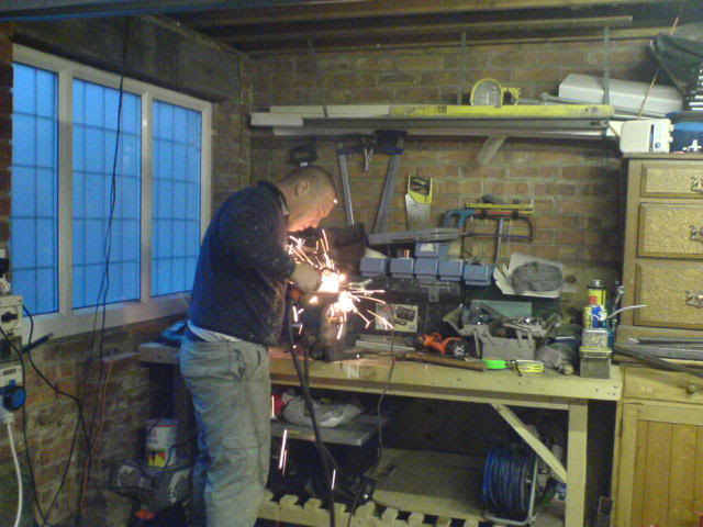

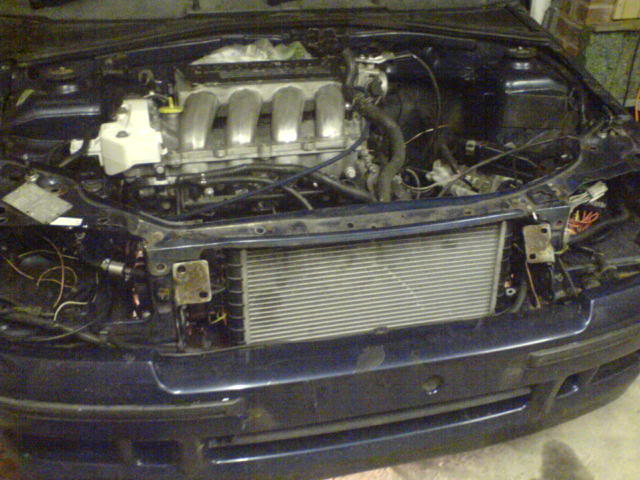

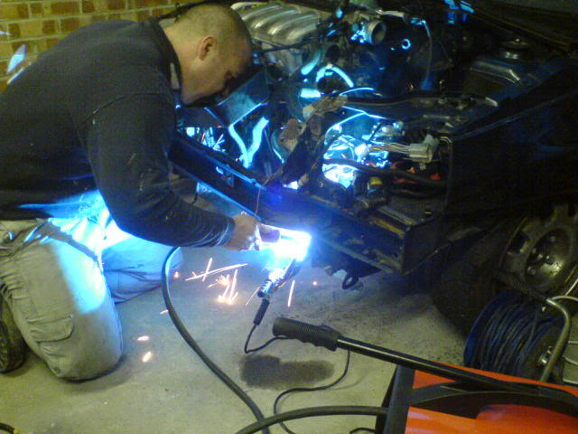

then i got home and went to see the next door neighbour as he has got a welder and offered to sort my brackets out to mount the 172 radiator
and all sorted, just need to connect some pipes and attach fan 2moro

rad hoses are all connected up, was easier than i thought (had visions of pipe adapters, joins and god knows what!)

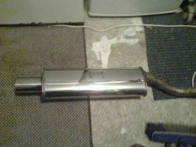

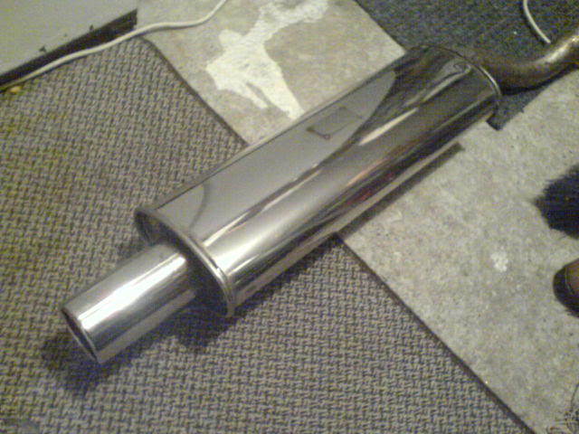

also picked up my magnex exhaust last night, wasnt keen on the ktec tailpipe design and after looking at paul's (RStuning) car while i was there i wanted the same (thats why i asked what exhaust it was mate ;) )

gave the magnex backbox a box of a clean up last night, came up like new (man i really need to use my digi camera rather than my phone!)

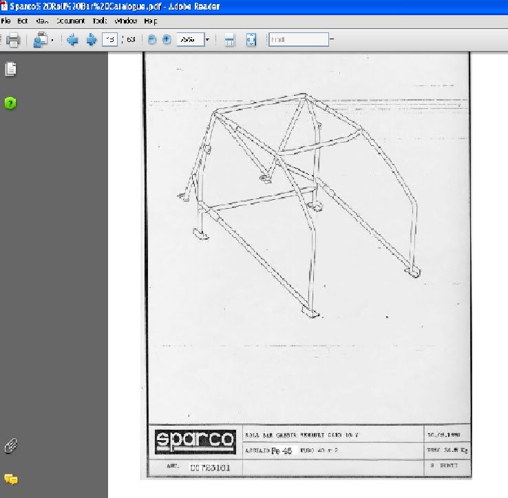

looking at bolt in, either one of these these by omp
or this by sparco if i can find a supplier (sorry about quality its a screen dump)

i really like the sparco one, says 8 point on the pdf, found one on peter lloyd rallying but it says 6 point and there is no pic of it

the sparco ones looks sweet - if its 8 point - go for it

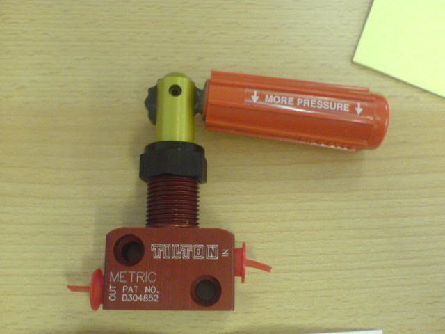

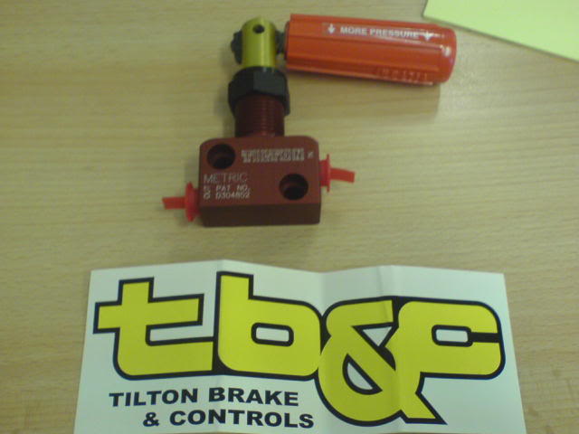

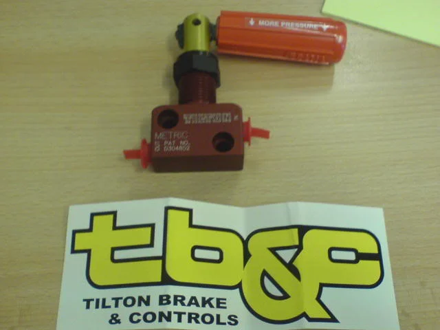

right i made the decision to do away with the standard load sensitive valve, it was causing me headaches and there was no gaurantee it was going to work even after all the messing about :rolleyes:
so today my new piece of kit arrived, tilton 7 point in car adjustable bias valve :cool:

Looking good mate! How do the brake valves work then? Novice, lol.
