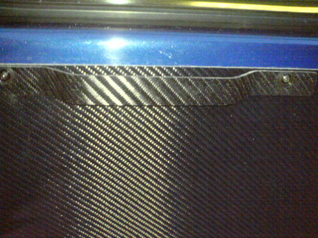

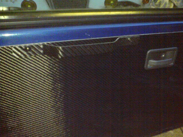

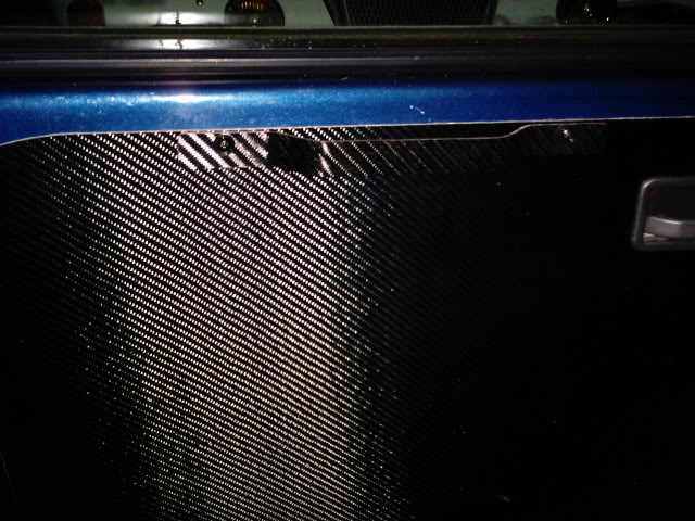

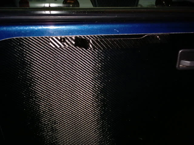

bit more done today, put the passenger seat in, fit my carbon grab handles

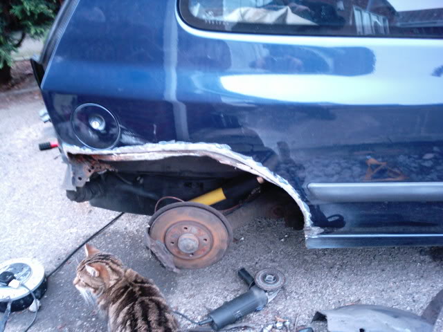

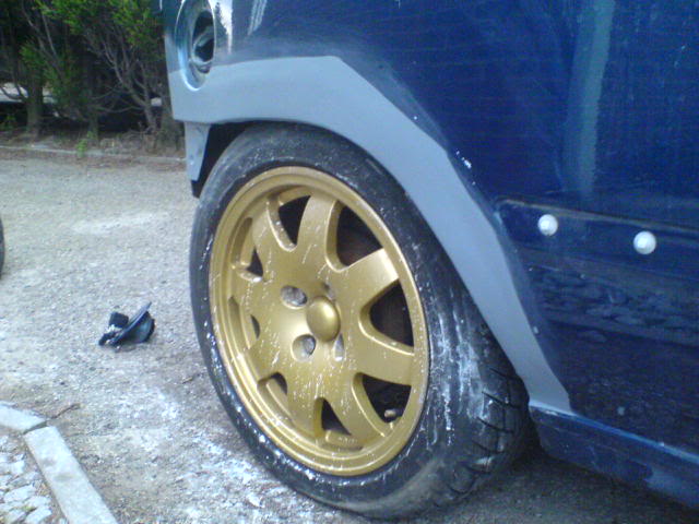

and then started work on my rusty arches :dead: as you can see passenger side isnt too bad, just needs a small piece welding in, but the drivers needed about an inch cutting out all the way round, so that will be the harder one to do :rolleyes:
thats all for now :approve:

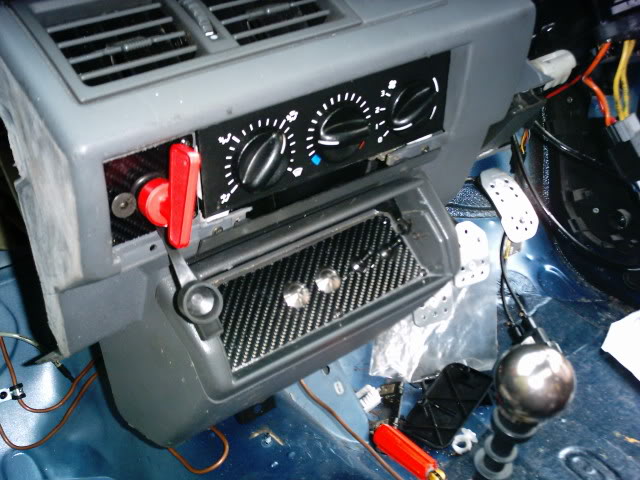

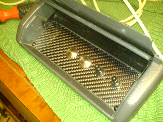

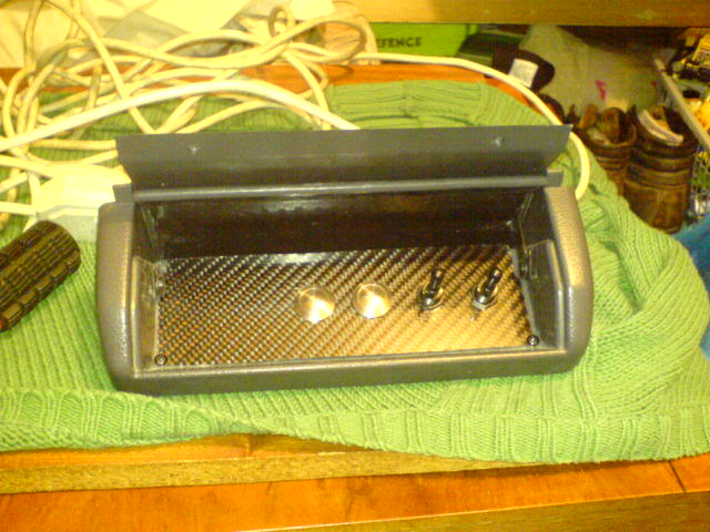

mr postie has delivered some more goodies this morning :D
battery isolator
and 2 toggle switches (from some sort of RAF aircraft :cool: )
and these are yet to arrive

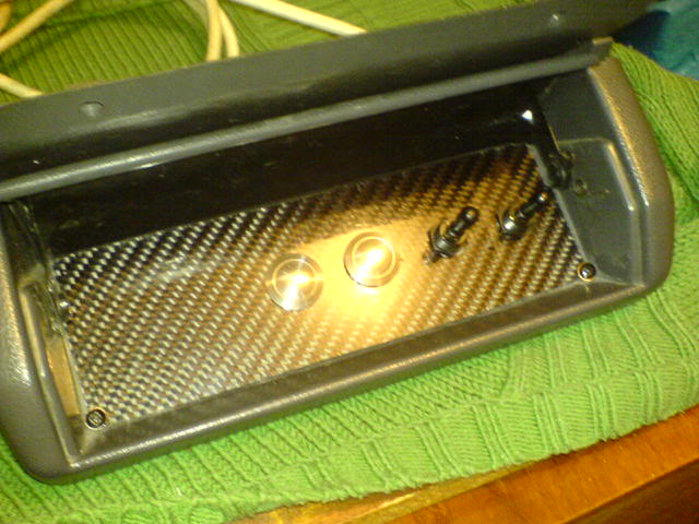

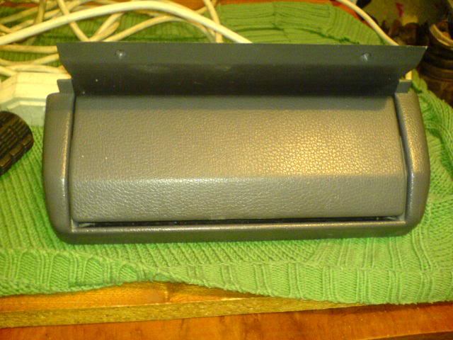

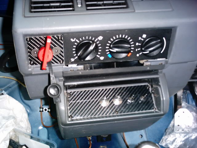

all this (bar the isolator, thats going where the clock used to be) will be going in my carbon fibre DIN panel i am making from the extra peice performance-trim sent me :D :approve: :cool:
  F4R'd ITB'd '92 cup racer
Re: My mk1 track car blog
so last night i got to work on the carbon fibre DIN panel and i'm pleased with the final product, just needs securing in place properly, then it's ready to go in the car :D

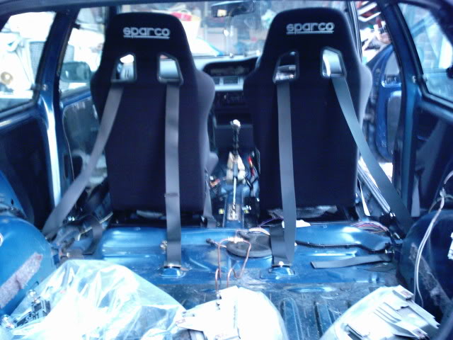

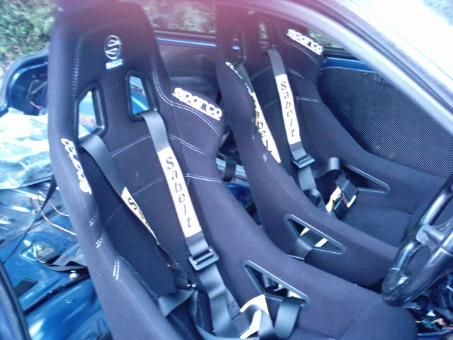

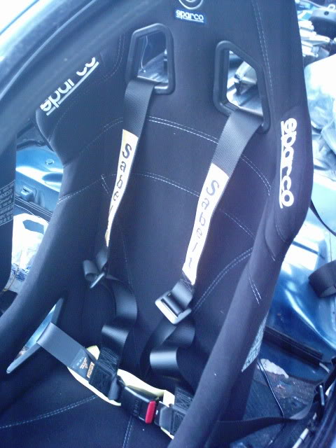

first was fitting my new 4 point sabelt harnesses

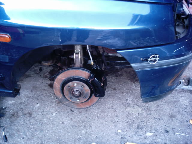

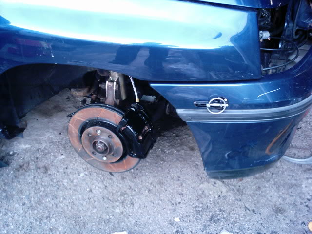

then i gave the calipers a lick of paint and fit some quick release pins to the bumper

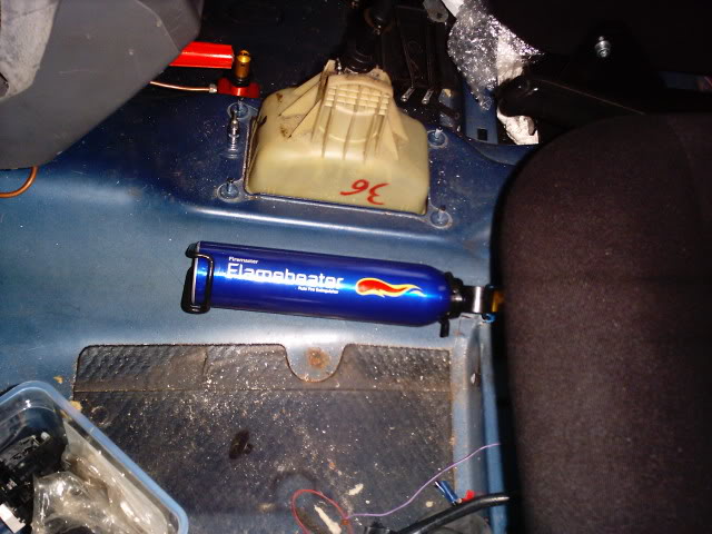

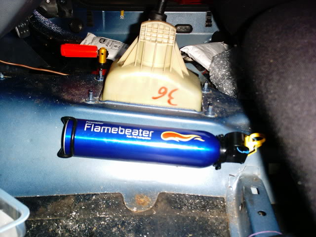

then fit the small handheld extuingisher (either a larger hand held or plumbed in mechanical system is going to be added aswell)
then fit my battery isolator switch and DIN panel i made earlier in the week

Looking good fella...it's advised to cross over your harness straps at the back....
cheers bud, yeh ive heard that too but forgot when fitting them lol why is that anyway?

Looking good! I now know where to mount my harnesses as forget about the two bolts up the sides!

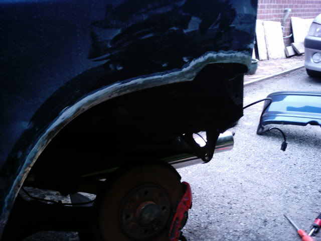

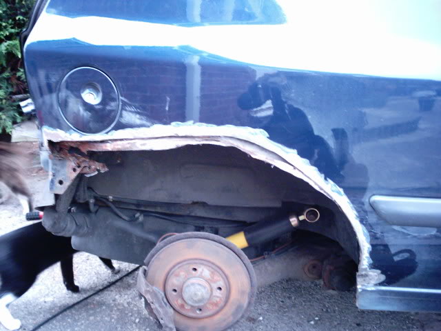

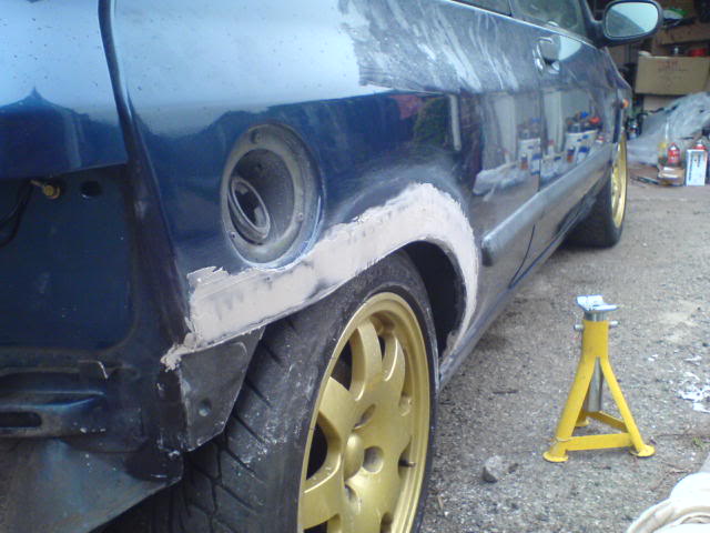

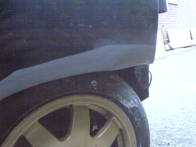

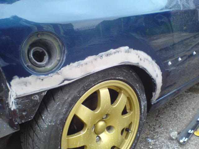

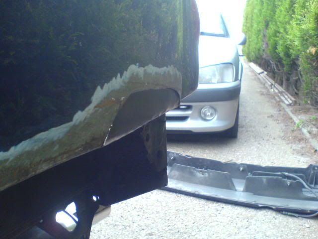

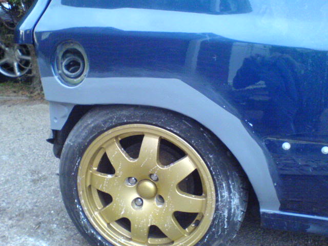

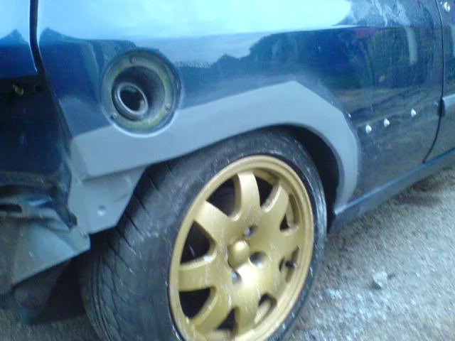

so whilst i had some time i decided to make a start on my rusty arches and paint up the inlet plenham

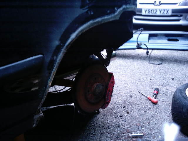

just a reminder how the arches looked after i had chopped out the rust :eek:

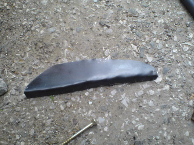

so i started by chopping a small piece out of the offside repair panel i bought (sorry didnt get any pics of the repair panel!)
and then checked fitment

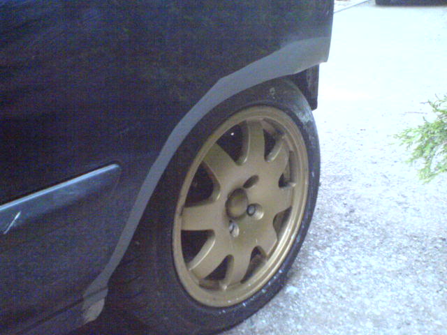

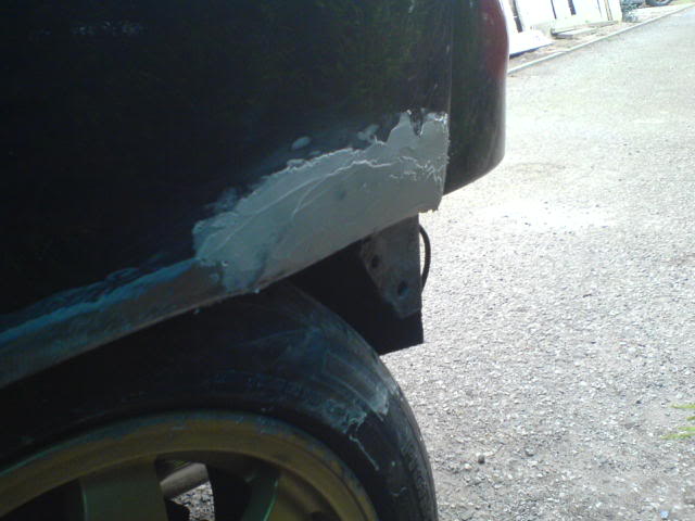

did the same on the offside but obviously i had a much bigger and more accurate piece to cut, didnt get any pics of that side, was in a bit of a rush to get it sorted before it got dark :rolleyes:

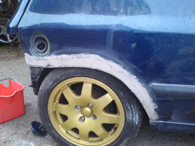

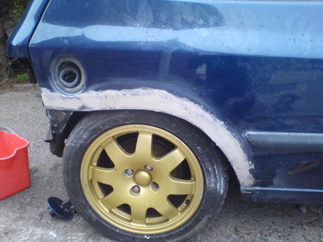

then i pushed the car round to the next door neighbour who tacked the pieces in place, then pushed the car back round and started on the filler :evil:
did two layers of filler on both sides, rubbed down inbetween
then once it was rubbed down for the second time and i was happy with the result i masked up and primed the area
not bad for a first attempt, i think i'm going to go over it with a finer filler to cover the blemishes but so far i think its come out ok

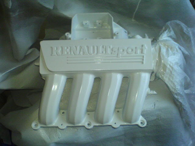

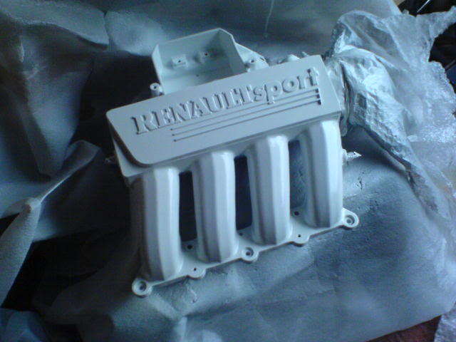

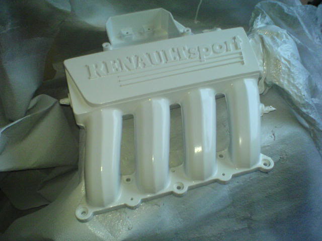

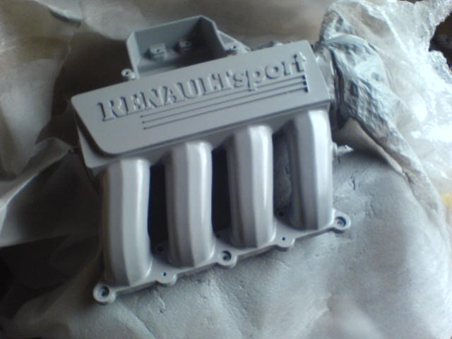

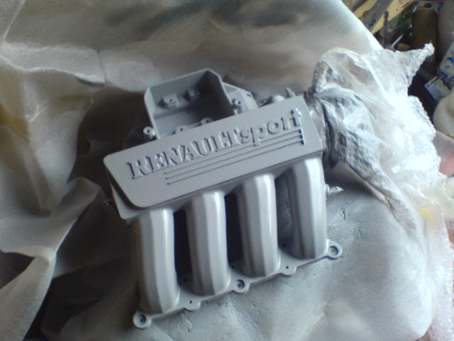

whilst waiting for filler/primer to dry i got on with the plenham, primer:
and then white to match the engine mount (which really needs doing again after oily hands have touched it)

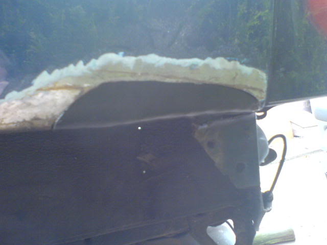

oh nearly forgot, whilst filling the n/s arch i had a bit of a prod around (fatal error lol) on the sill, seems there is a hole big enough to house a badger hidden under underseal and paint :eek: so looks like i will be doing a bit more bodywork before it see's the road :rolleyes:

omg - white plenum
I think I'm going to have to copy you! have been uhhmmming and ahhhing about a colour scheme for a while now, and white will match my wheels :D

aye white and blue is my theme, white wheels, white cage, white cup racer decals, white plenham and engine mount etc, white mirrors ;) all on the blue car :D
