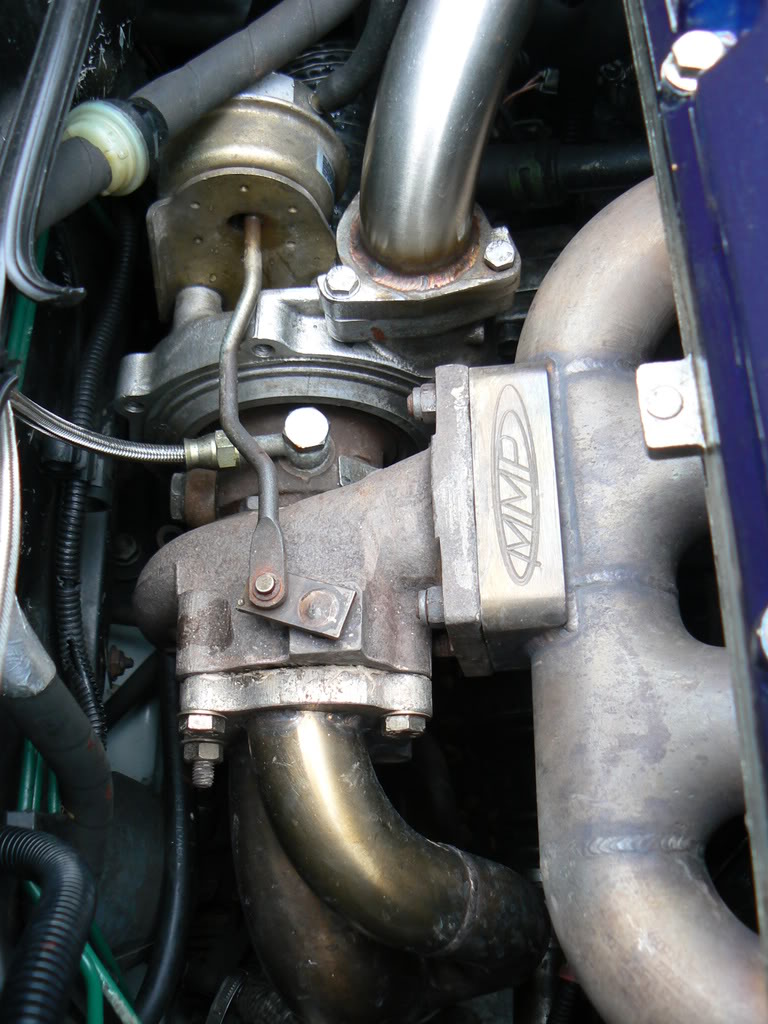

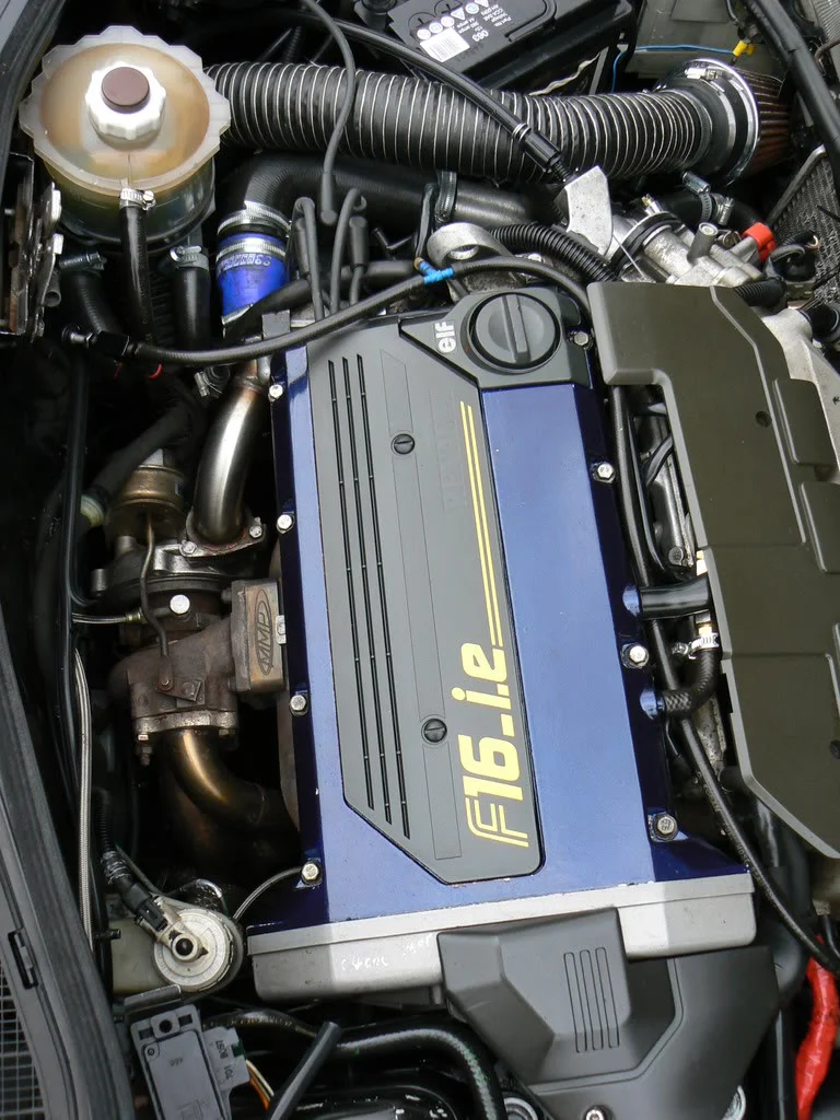

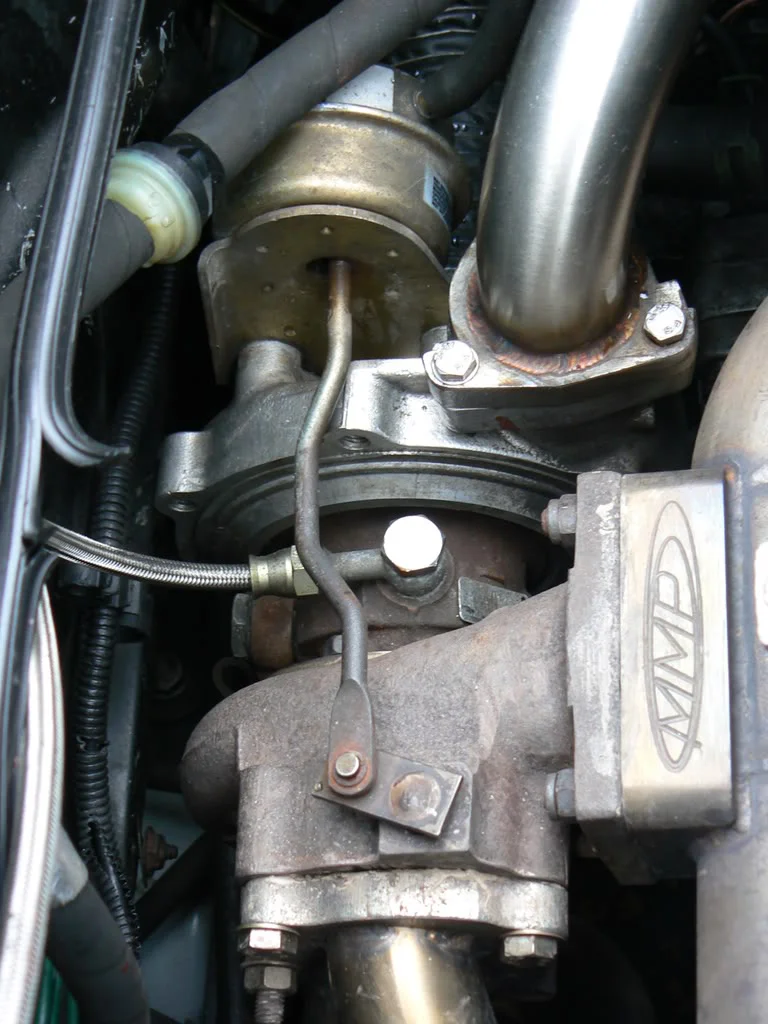

But what could be cheaper than a ph1 and quicker???? A turbo converted valver of course!!! Picked this black valver up yester and its nothing short of insane! It was dyno'd last month at 170 bhp ATW and about 200 bhp at the fly and 189 lb ft Torque.
Its a low boost conversion running about 8-9 PSI, the torque is brilliant and the wooooosh from the turbo is great. Its running a nice sublte waste gate that gives a nice chatter.

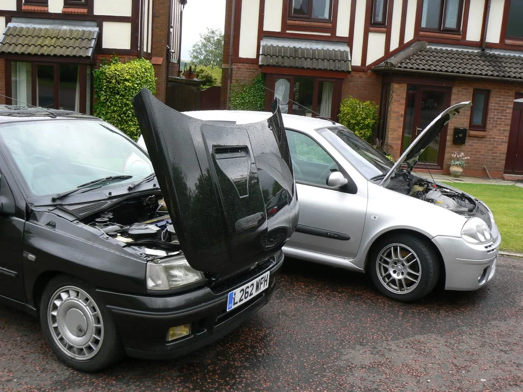

Not compared to my ph1 side by side by its def a bit quicker. But dont think there would be much in it.

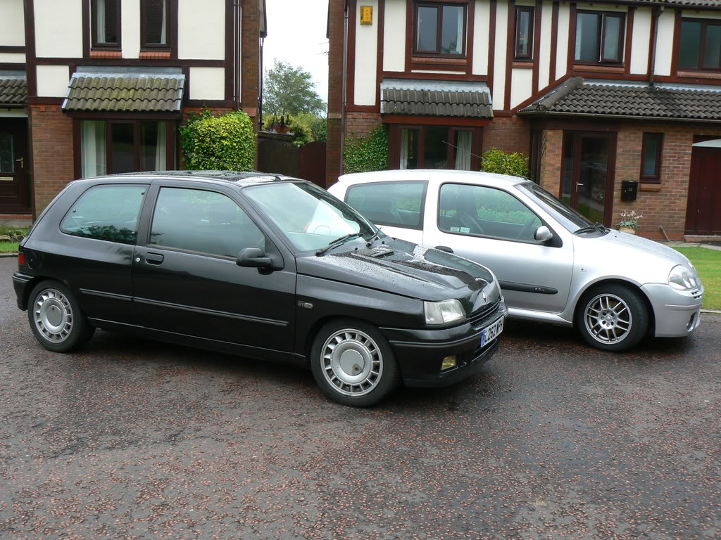

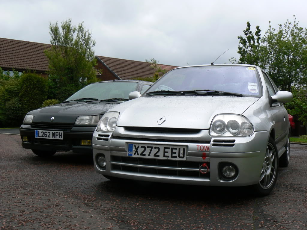

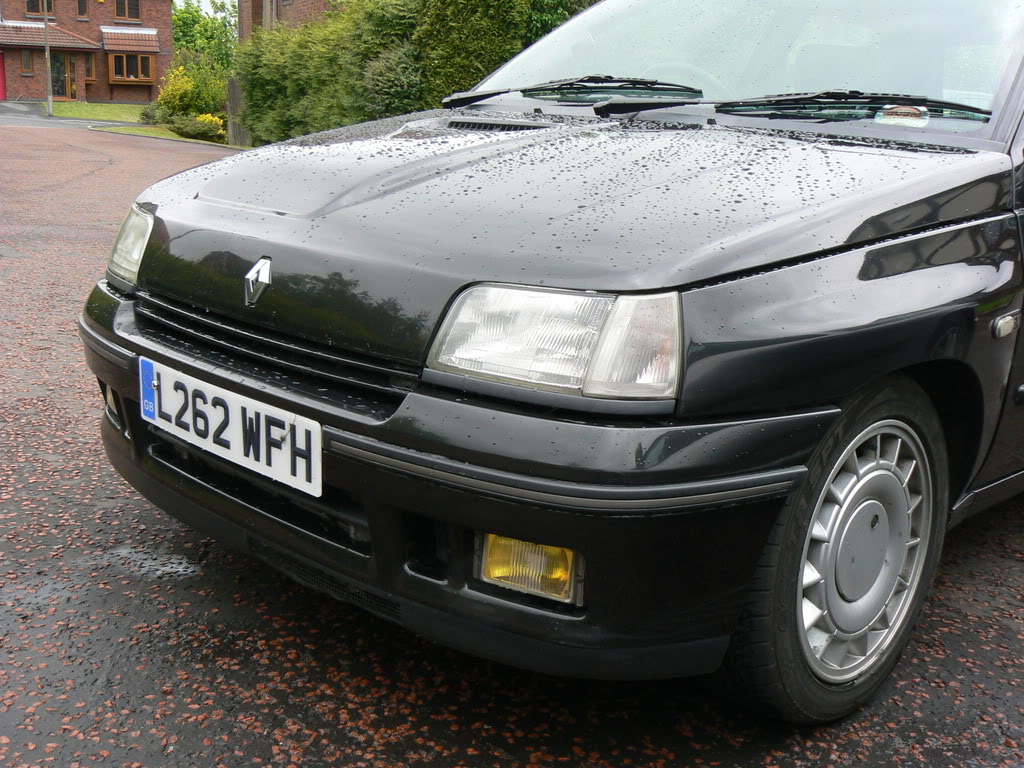

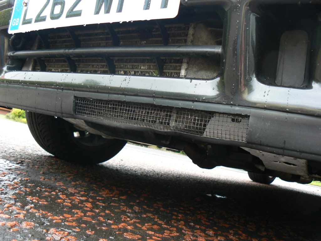

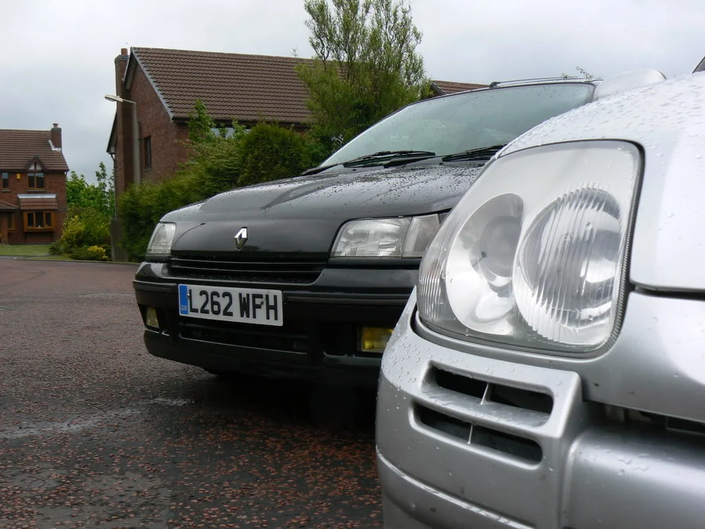

Here are some pics of my ph1 ans the valver turbo:

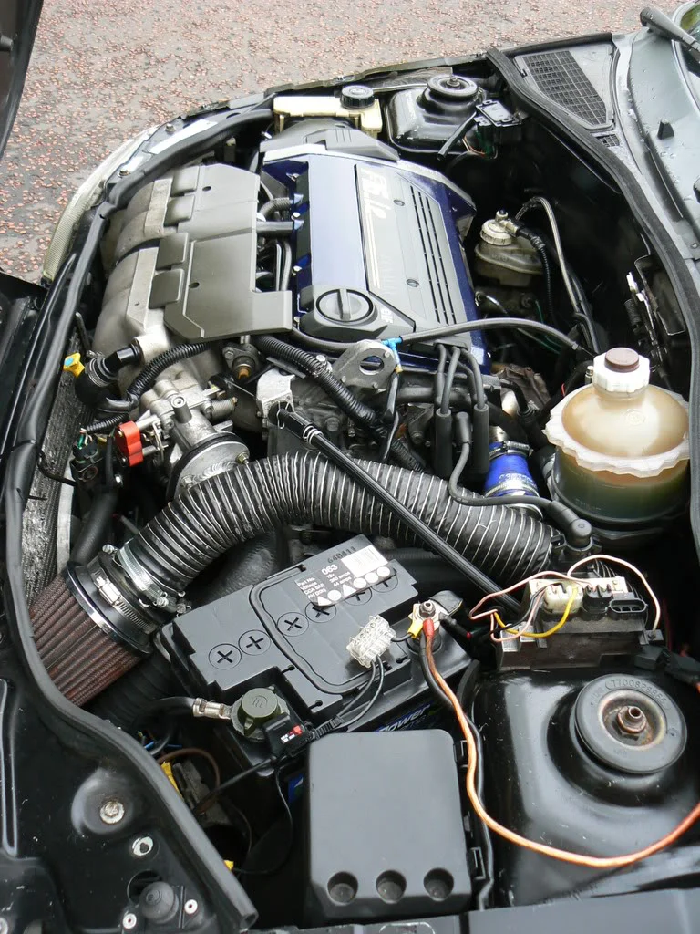

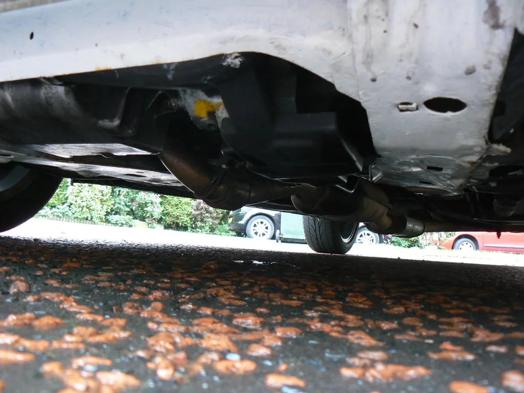

Full spec of the build:
  • GT28R60 turbo @ 8 psi
  • Renault 21 Turbo MAP sensor
  • Renault 21 Turbo injectors professionally cleaned and refurbished
  • IVECO Dailey intercooler
  • manual boost controller
  • Group N organic clutch
  • ‘soft clutch’ pedal conversion
  • fully rebuilt engine with:
  • honed bores
  • 9.1:1 dished pistons
  • New piston rings
  • Spesso Head gasket
  • new bearings and seals
  • refurbished oil pump and piston-spray jets
  • new valve stem seals
  • lapped valves
  • low-temp thermostat

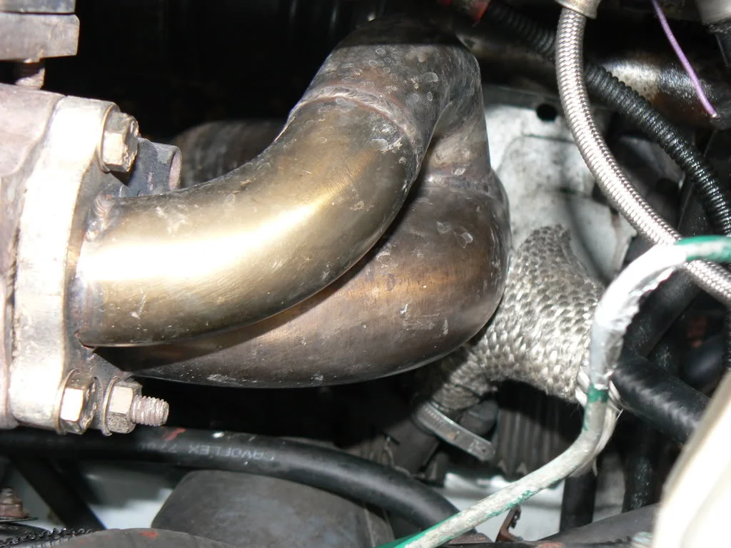

  • stainless-steel exhaust manifold
  • stainless-steel downpipe
  • Rtuner engine management
  Corsa C SRi
a good mate of mine has one running 10psi atm
foooking rapid is an understatement,
looks like a lot of work has gone into this.
Good work, stunning motor =]

I think its quicker than my ph1 but not by much, my ph1 is not exactly standard.
