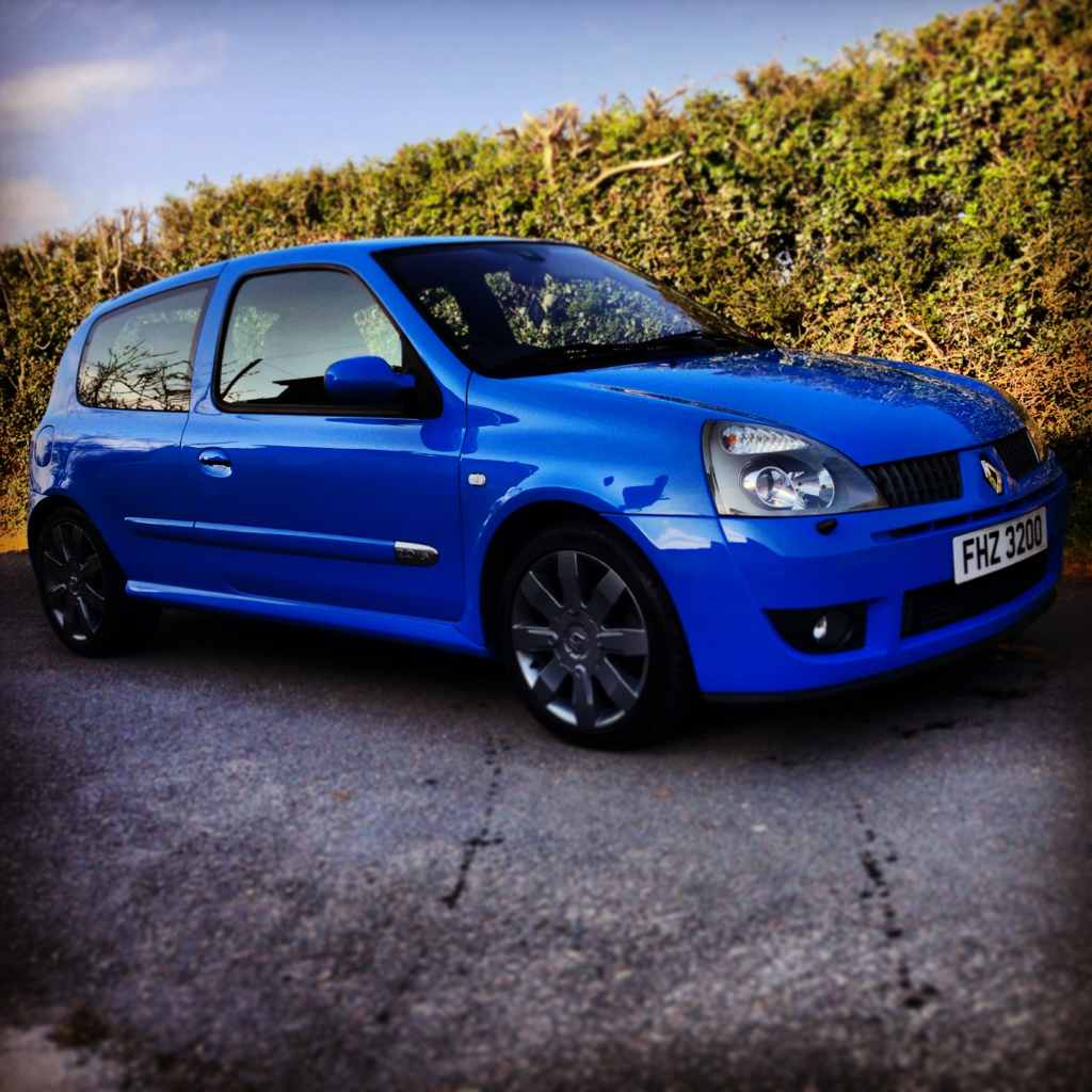

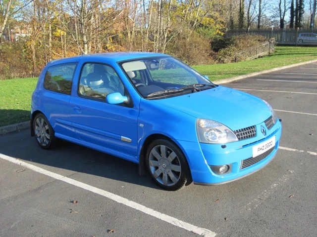

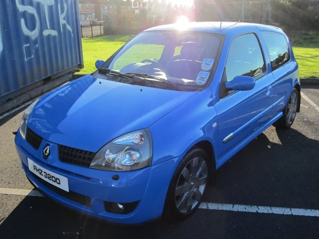

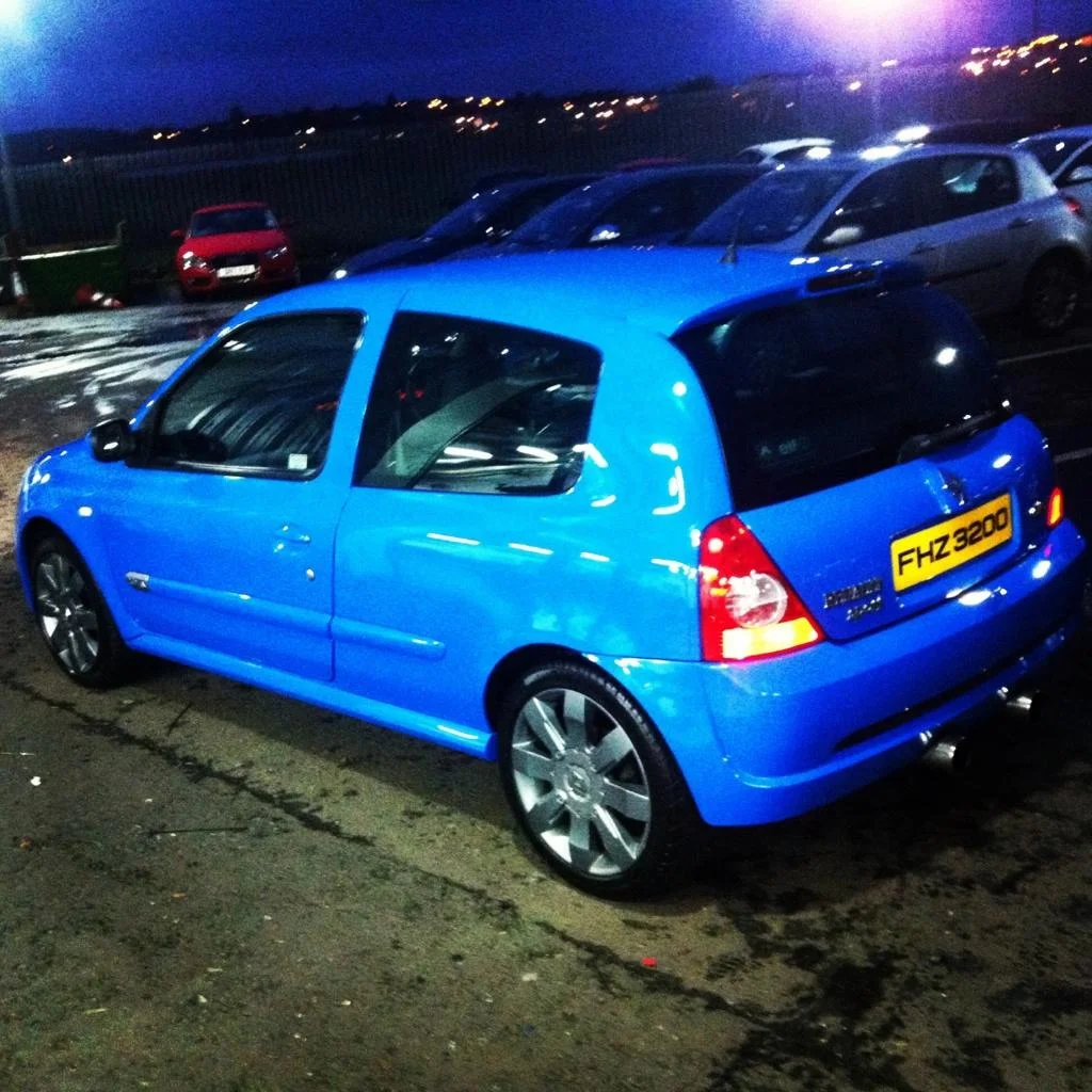

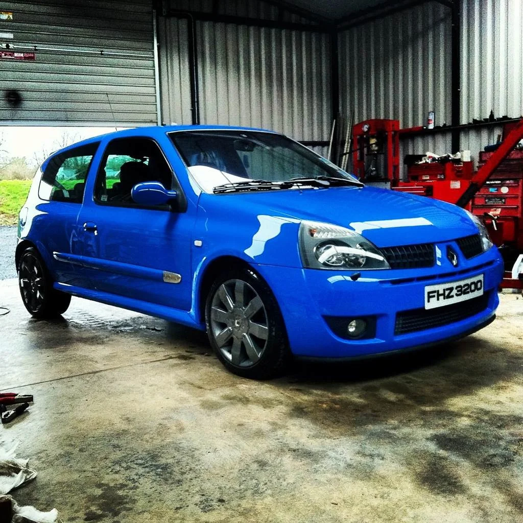

thought i would start a project thread tho i wont be doing much to it just a bit here and there , got the car on friday and had started to order parts for it before i even got it lol , any ways the car is very very clean only 48k with full service history, time for some pixs (mud flaps now removed along with silly small plates)

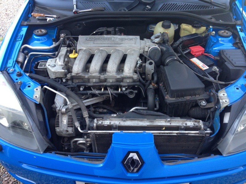

itg filter in the stock air box
parts on order

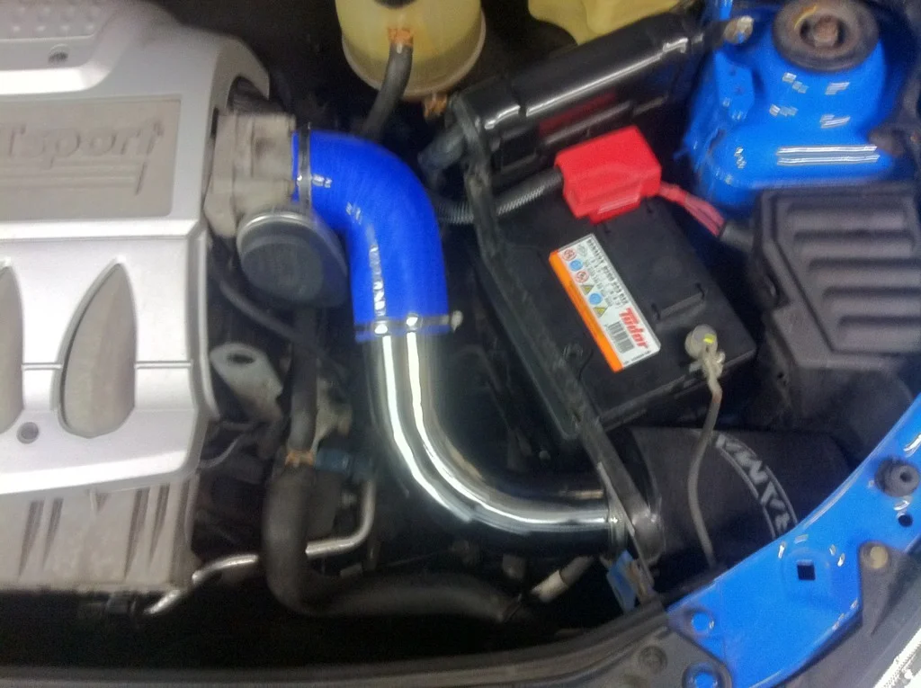

pipes to make up ktec style induction kit

polly bush lower engine mount
some cams 421s?

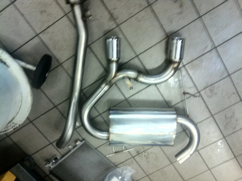

New piper exhaust and some dodo juice goodies

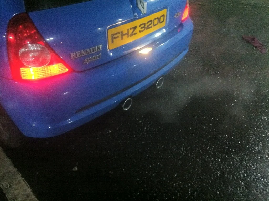

Made a new decat after work and got the exhaust fitted , forgot it take pixs of it in the air but it fits great and sounds class tho abit loud lol very happy with the piper system :)
Il get better pixs up soon

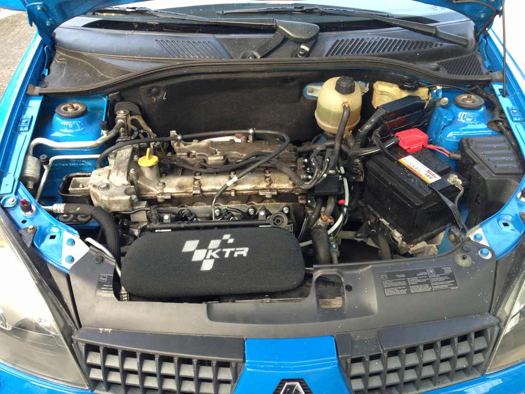

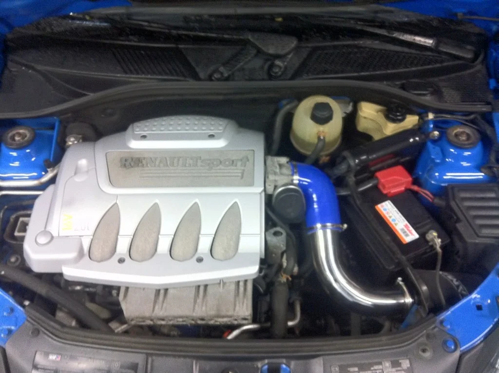

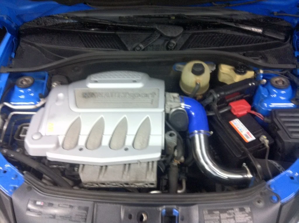

Some more done , made my own induction kit very happy with it as the filter is much lager then I see most use any ways some pixs (sorry for the crap quality)

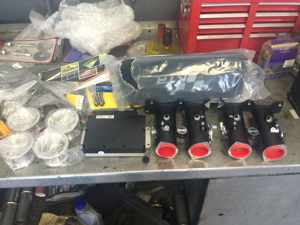

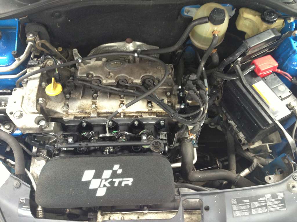

Last night I ordered some dth itbs ,421cams ,2 piece filter , gen90 ecu and tuner pro software , arp rod bolts, aero catches and a power flex lower engine mount just have to get my self a bonnet fit catches and get it painted , I'm really looking forward to this lol

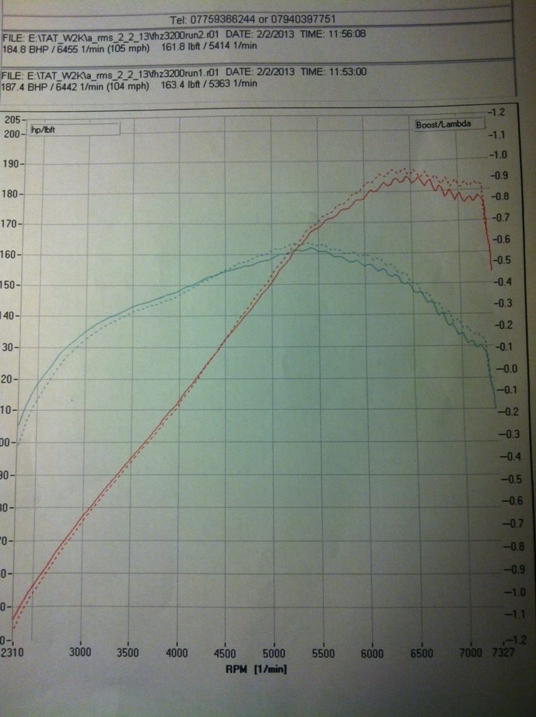

Are u on stock cams buddy ? What hp did it make ?
Some up to date pics
Yes on stock cams. It made 187.5 bhp part way through the day with 163/4 ft holding above 150 lb ft right up to 6500rpm
Mike had to finish the final bit of mapping on the road as we ran out of time at surrey rolling road. But he thinks it should be 190-193ish Bhp as it under fueled a bit at 6500rpm on the rolling road
Going to get it in for a power run fairly soon so I have a proper finished print out.

Be interesting to see the print out mate I must dyno mine with just the itbs on to see the difference

Try and get it on a rolling road before you start any engine work though. Then when it's all done or part done you can get another power run done on the same rolling road to make comparisons.

That was done a good few months ago with just exhaust and filter I take the number with a pinch of salt
The dotted line was with my home made induction kit the other with stock air box

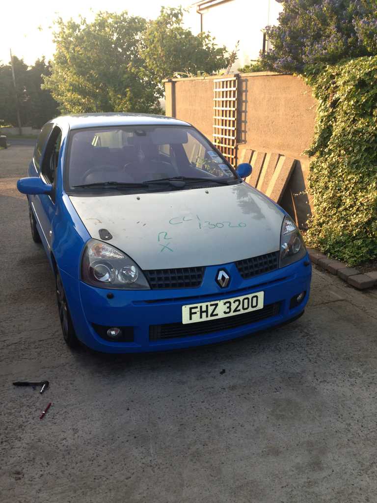

Parts from ktr should be with me tomorrow , I had a scrap bonnet around so give the aero catch a try , I wanted to put them some were I did not have to drill the car it self and the catch must be flush looks like it will work ok
Heading down the scrap tart tomorrow o pick up a bonnet fit the catchs then off to paint

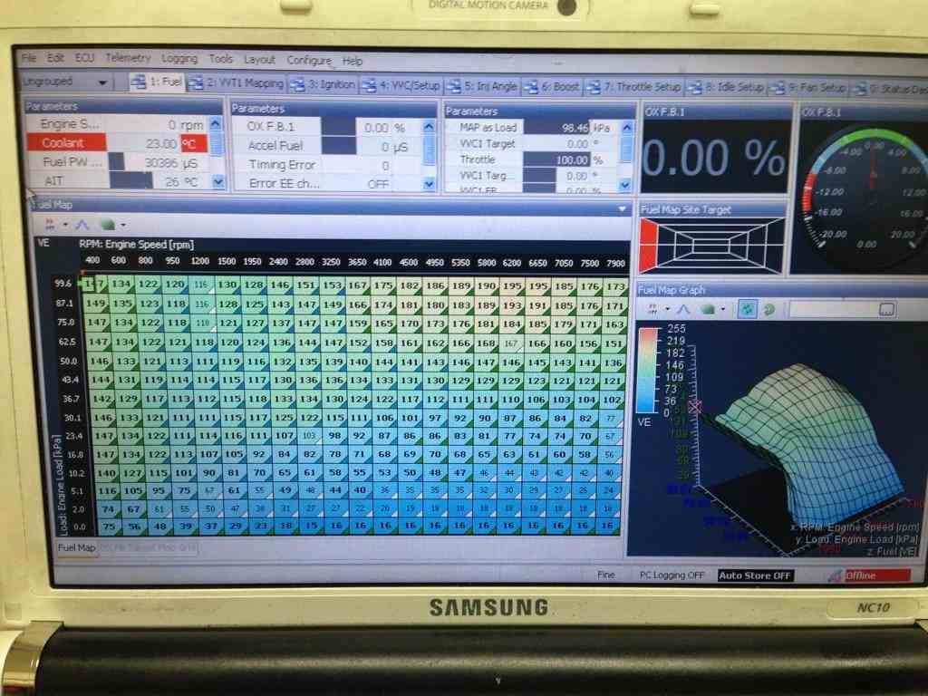

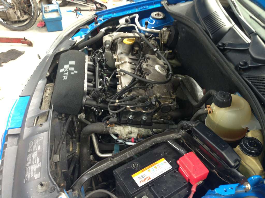

Well after having a huge air leak on one side due to some fitting problems with the kit , I removed the body's and modified the lower bolts , once refitted the car runs great , leaned the map at abit as it was much to rich at wot and turned the pops and bangs off as it was just silly , cars now running great just to fit my cams when they ever turn up , fitted some Trim edge in the grill as well really tidys it up tho it's not in the pix lol
