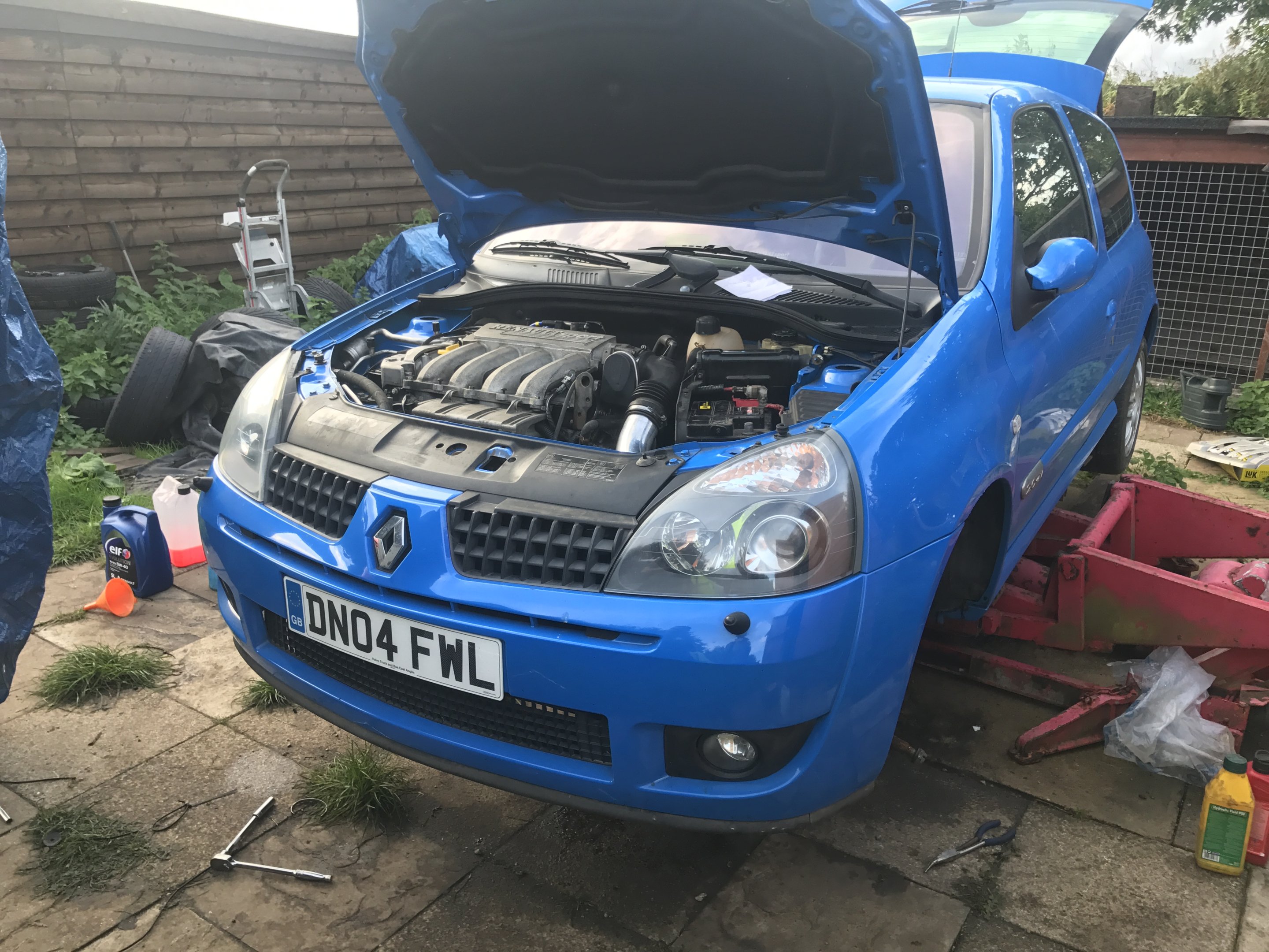

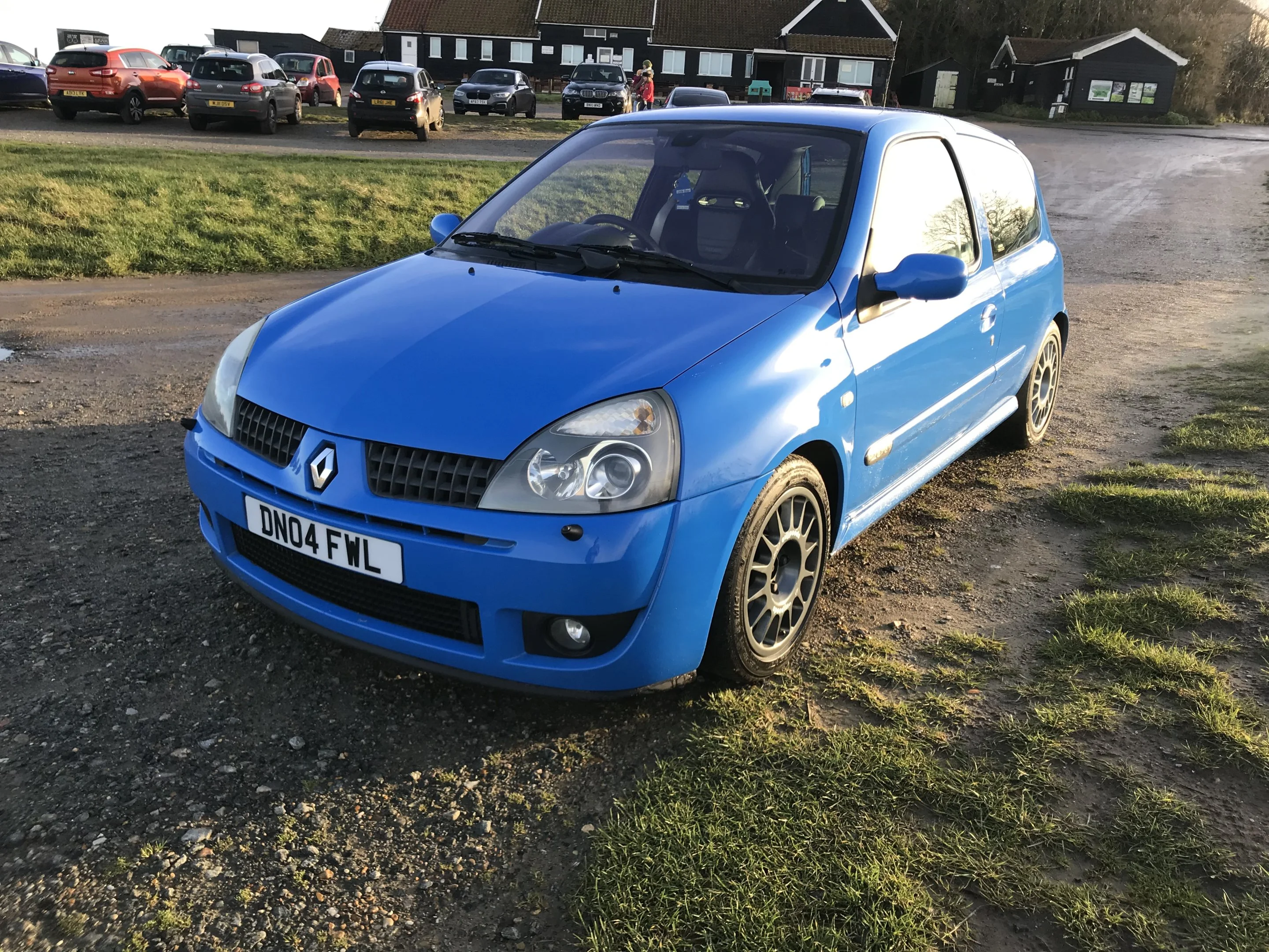

So earlier this year I managed to pickup a full fat 182 in rb.After much searching I found a reasonable one at a good price so we made the trip to go get it. Here’s the car as I brought it.
After using the car for a few months until the MOT ran out and with the cam belt being due I took it off the road to sort any issues and do the belt. Although I’m not very good at remembering to take pictures of everything here’s most of the stuff I collected.

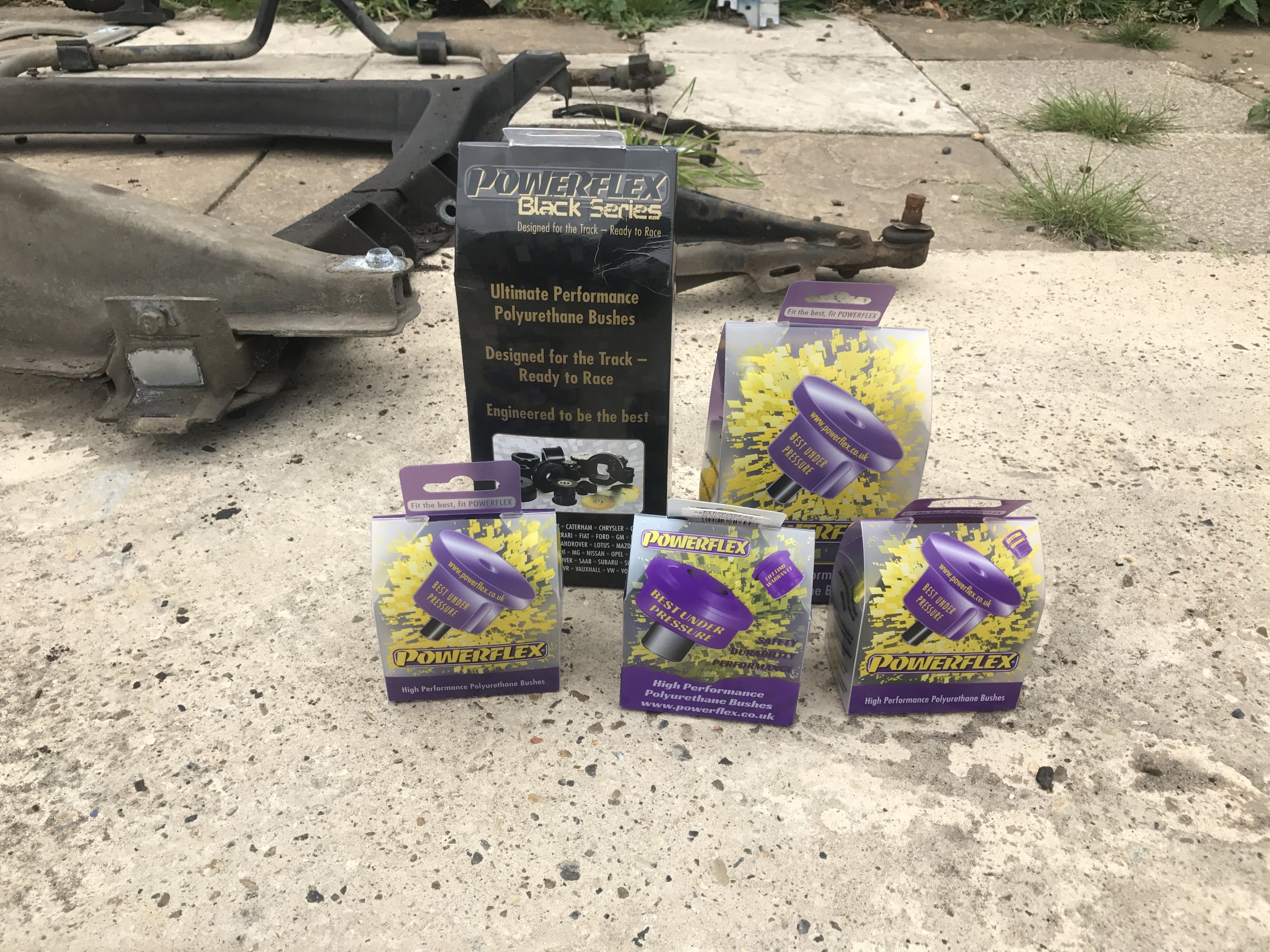

Full pollybush set for the front end

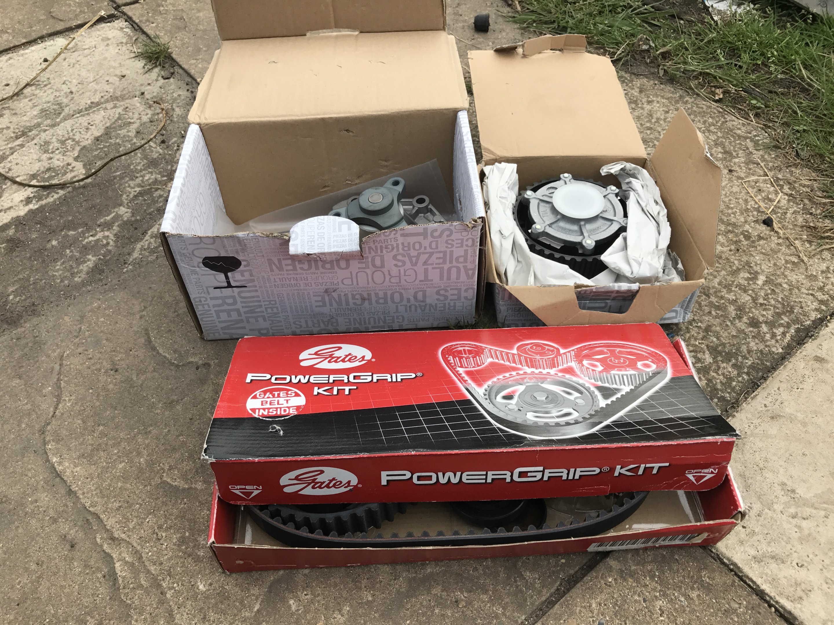

Genuine Renault dephaser, water pump and cambelt kit

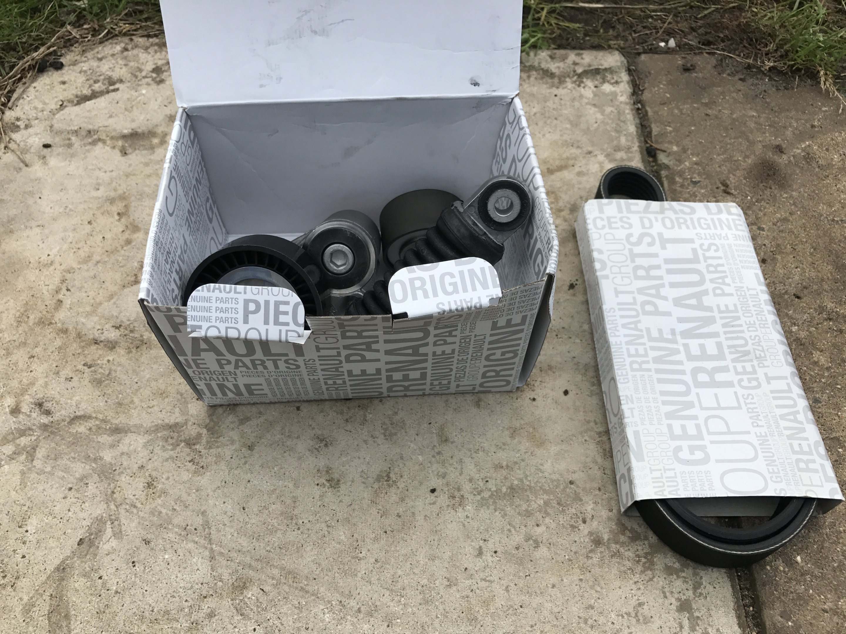

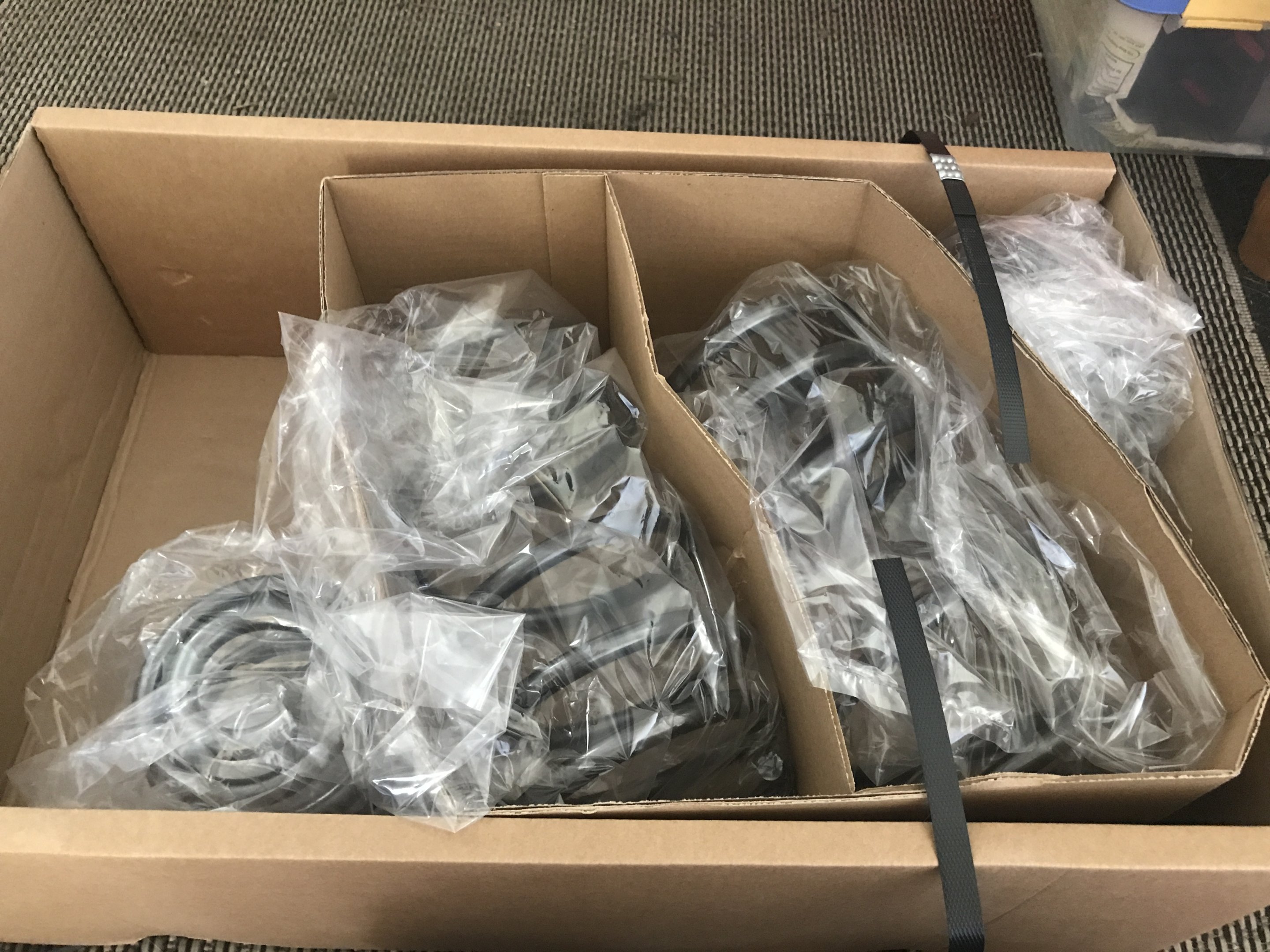

Genuine Renault aux belt kit

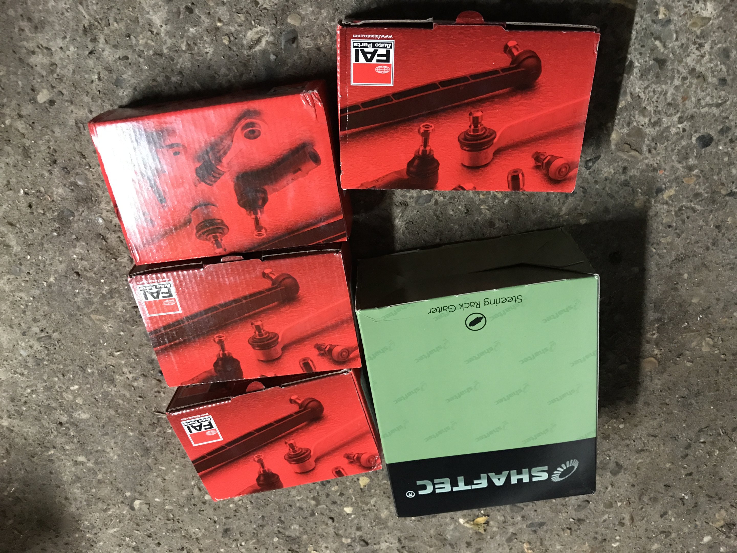

Iner and outer track rod ends with new gaiters and bottom wishbone swivels

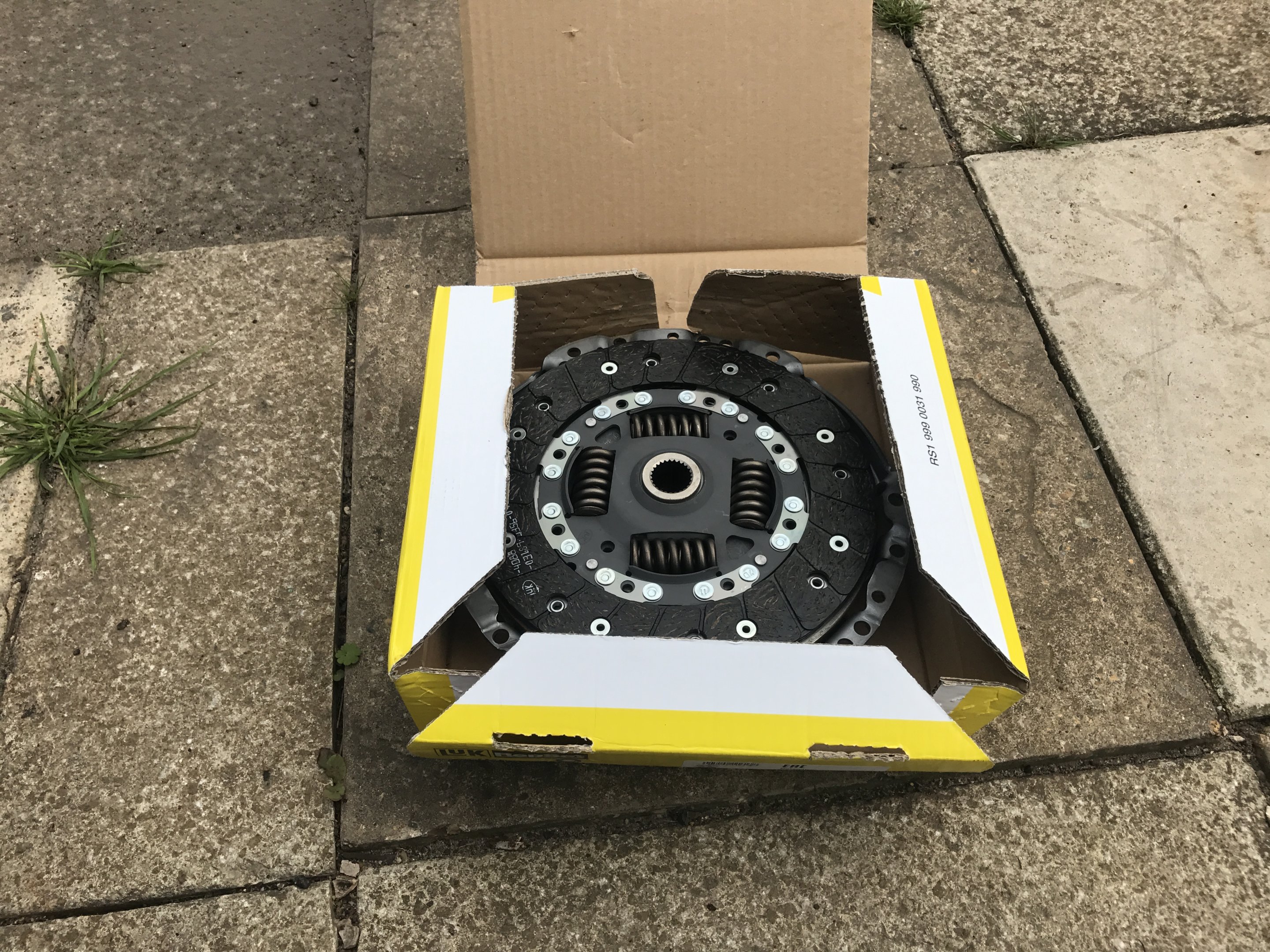

Full LUK clutch kit

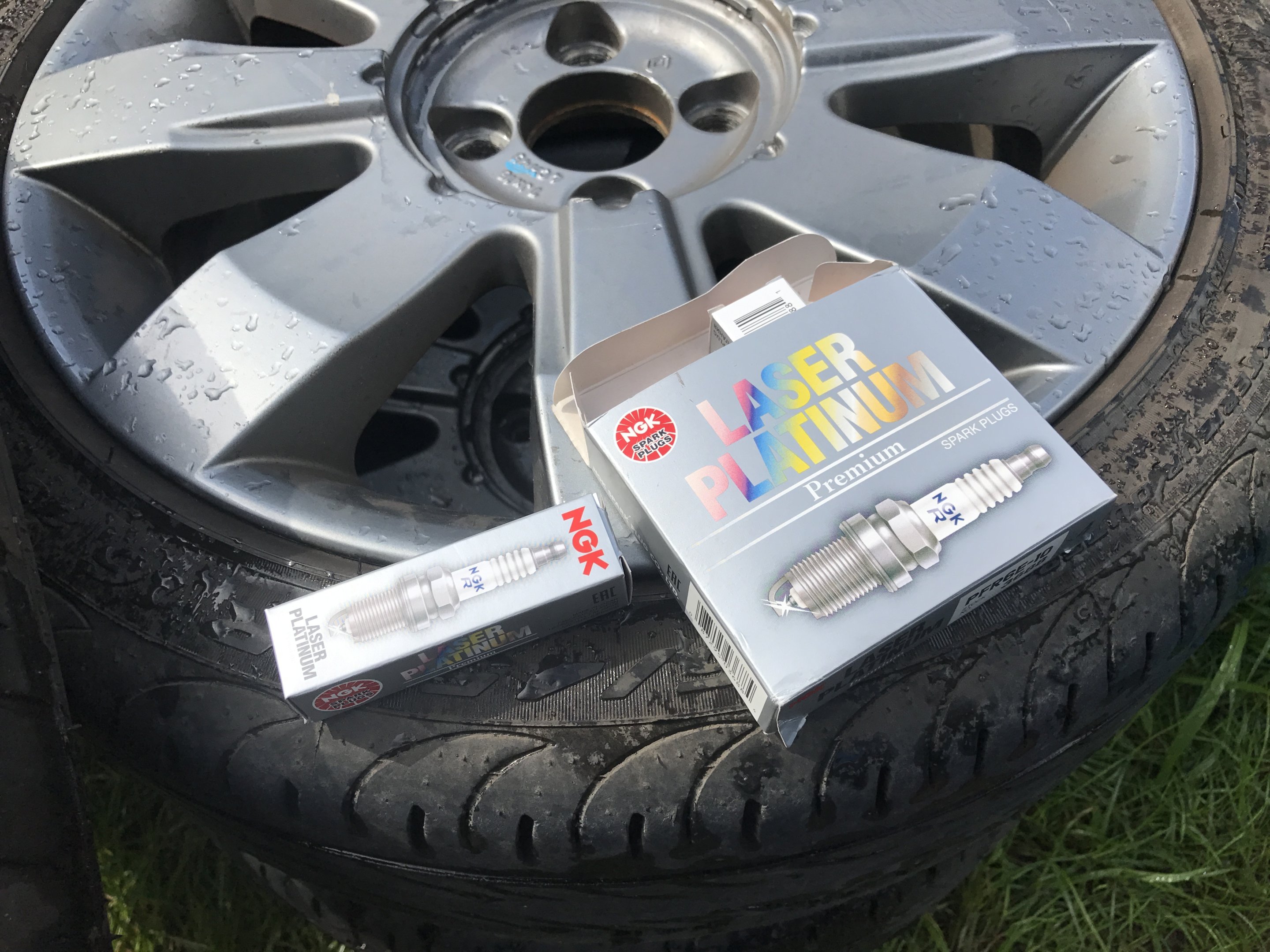

NGK platinum spark plugs

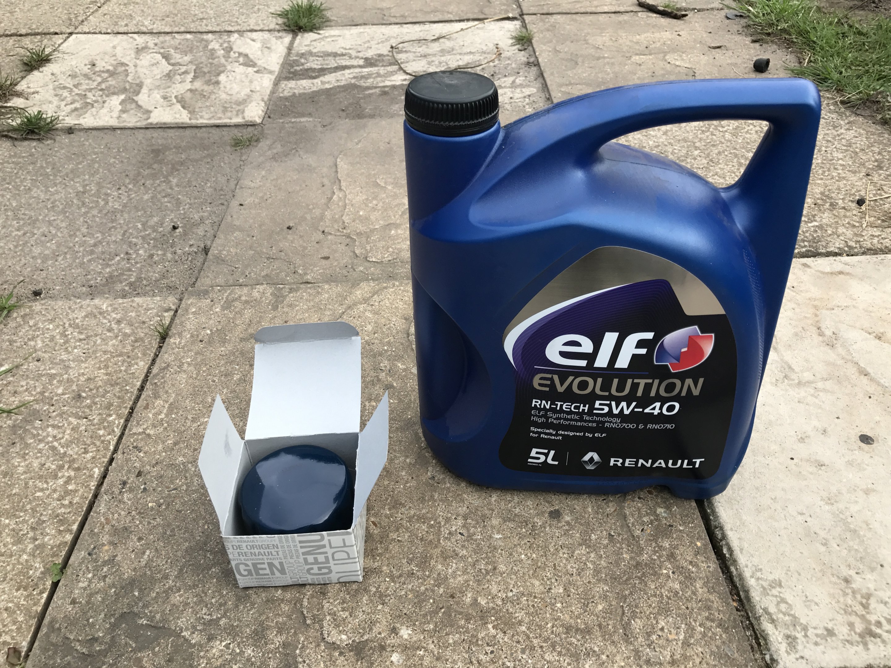

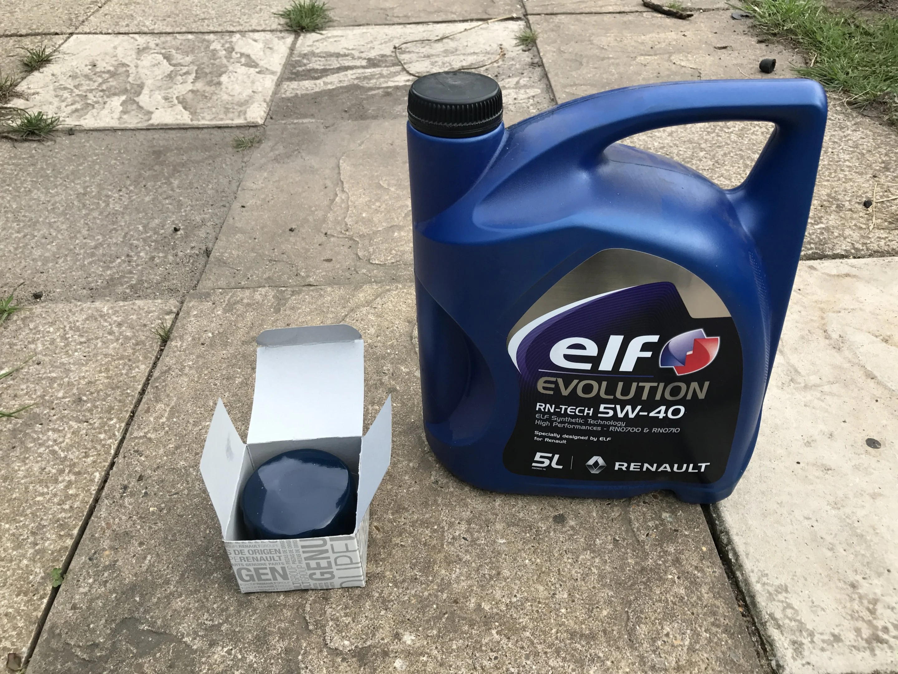

Renault oil and filter

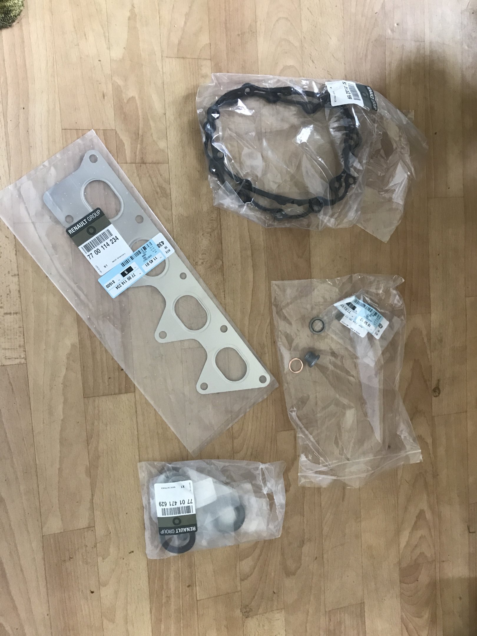

Gaskets sump plugs and washers etc

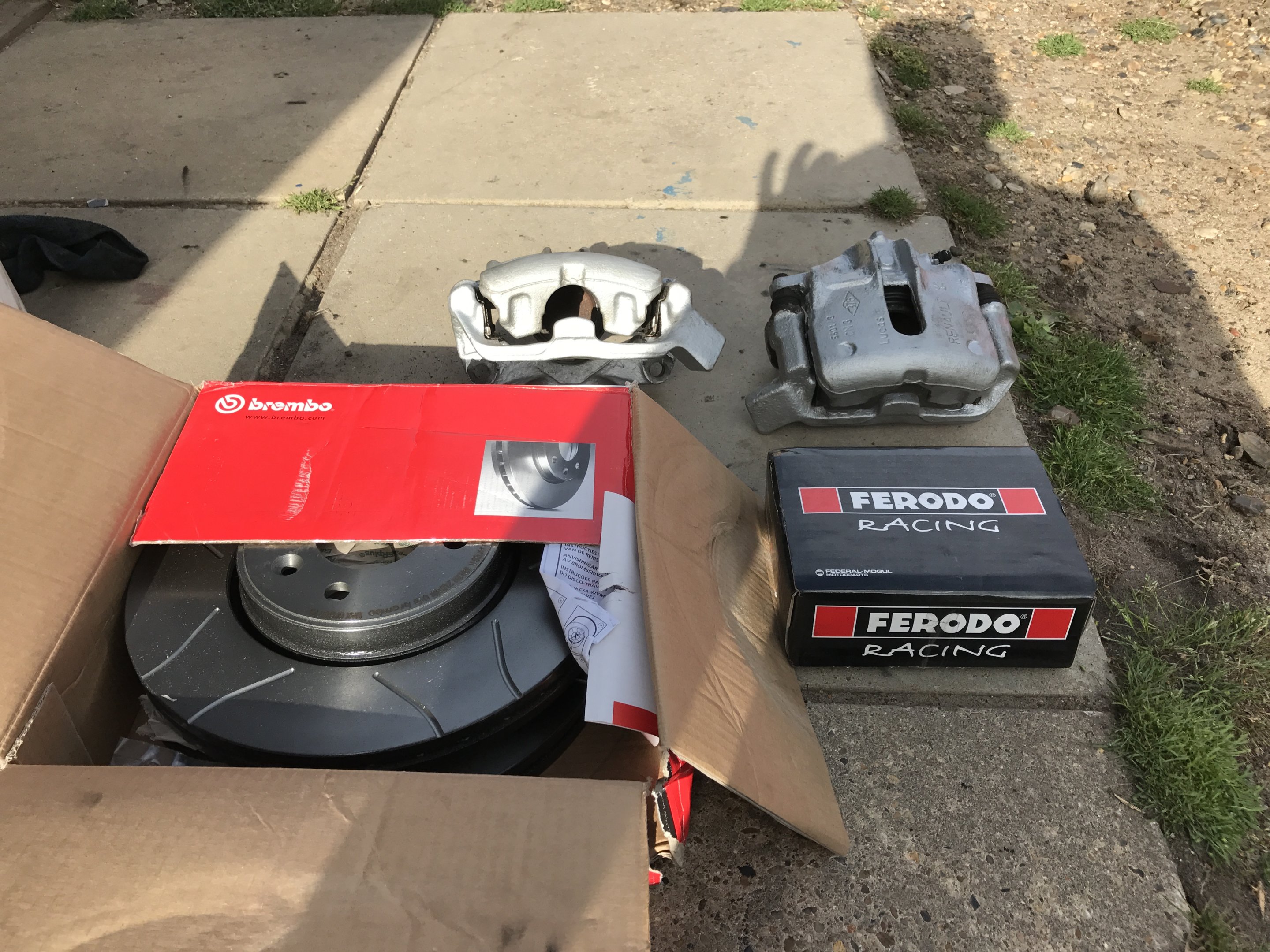

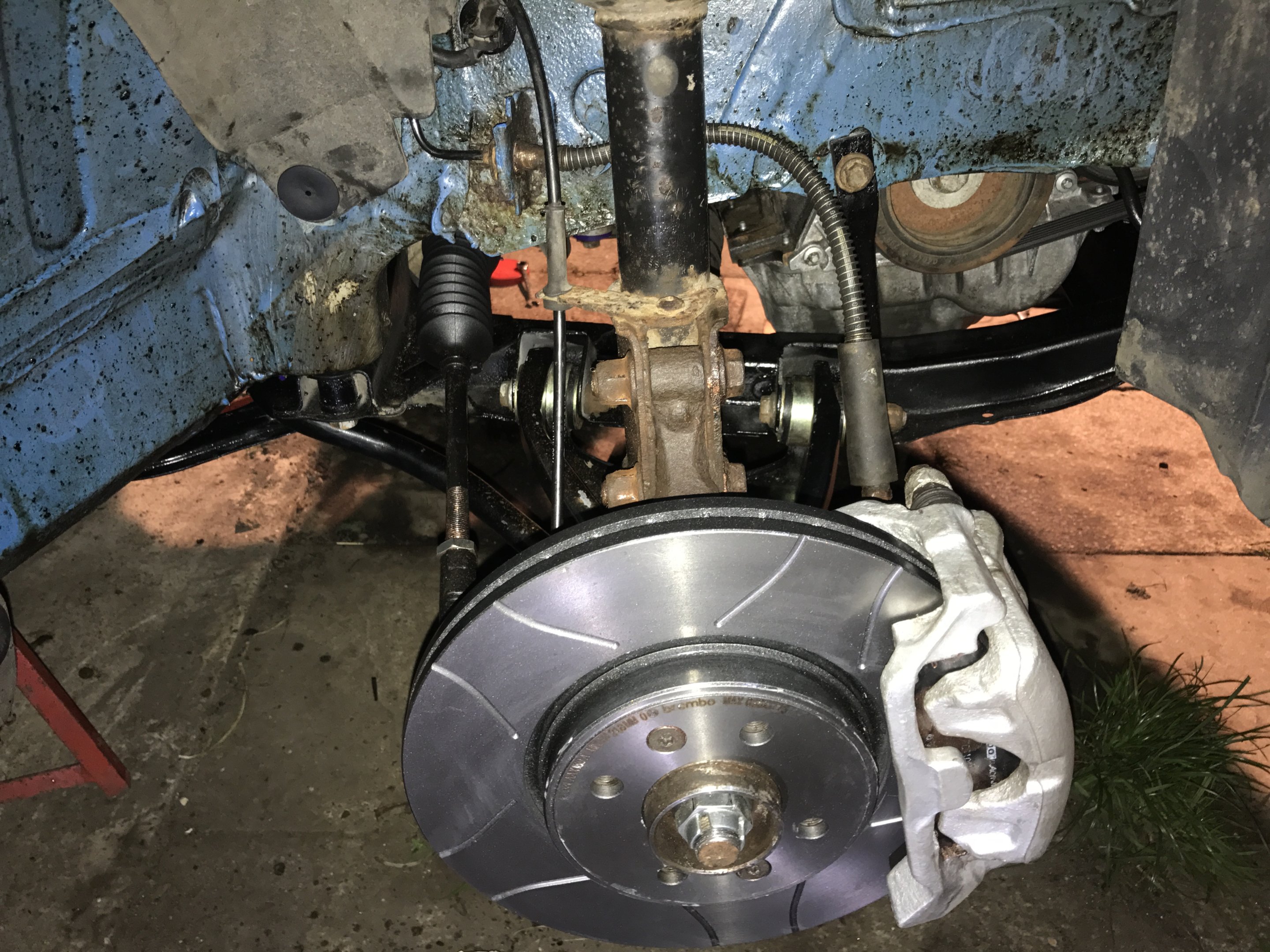

Brembo HC max front discs , ferodo ds2500 pads and rebuild front calipers

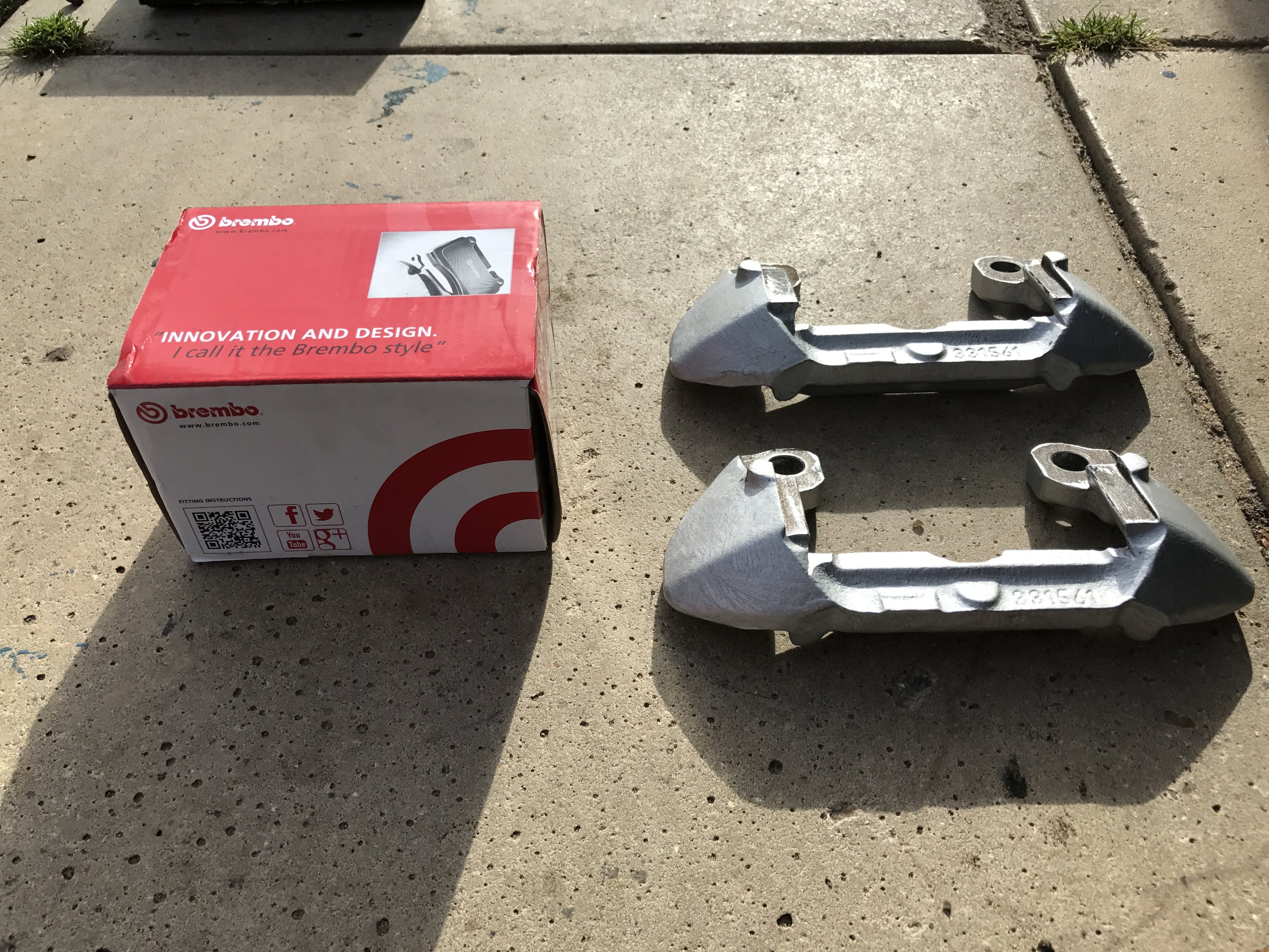

Rear discs were good so brembo rear pads

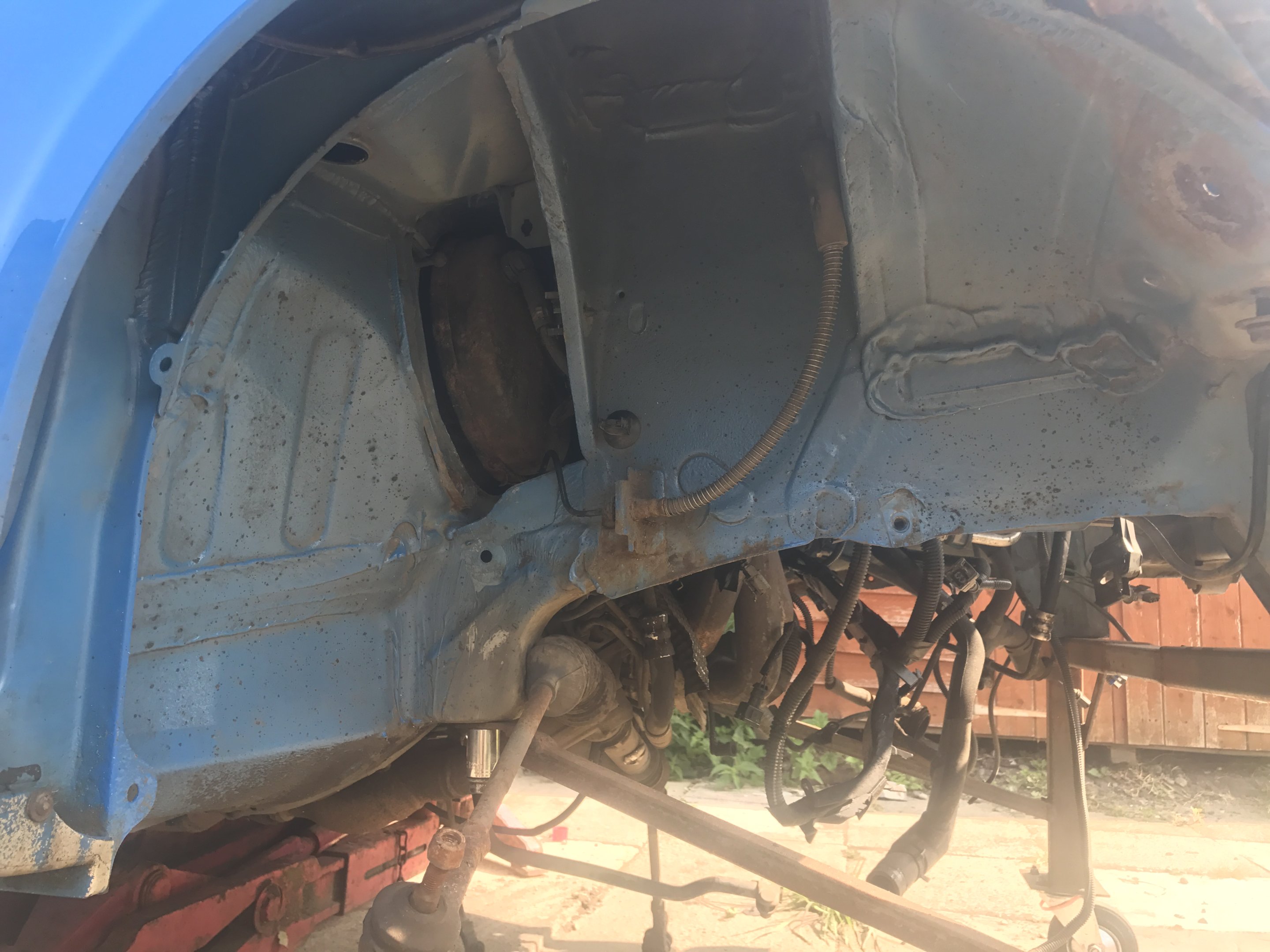

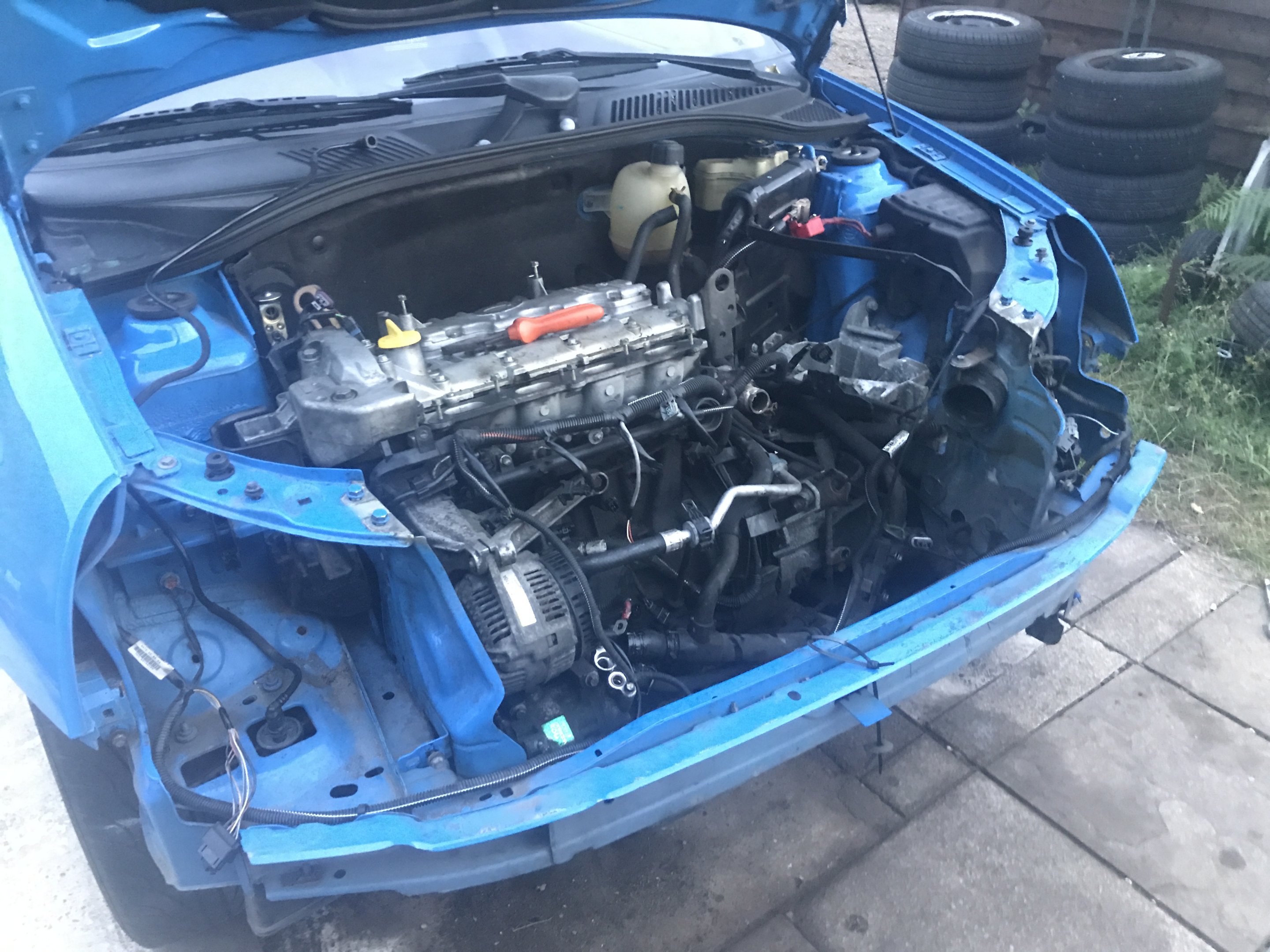

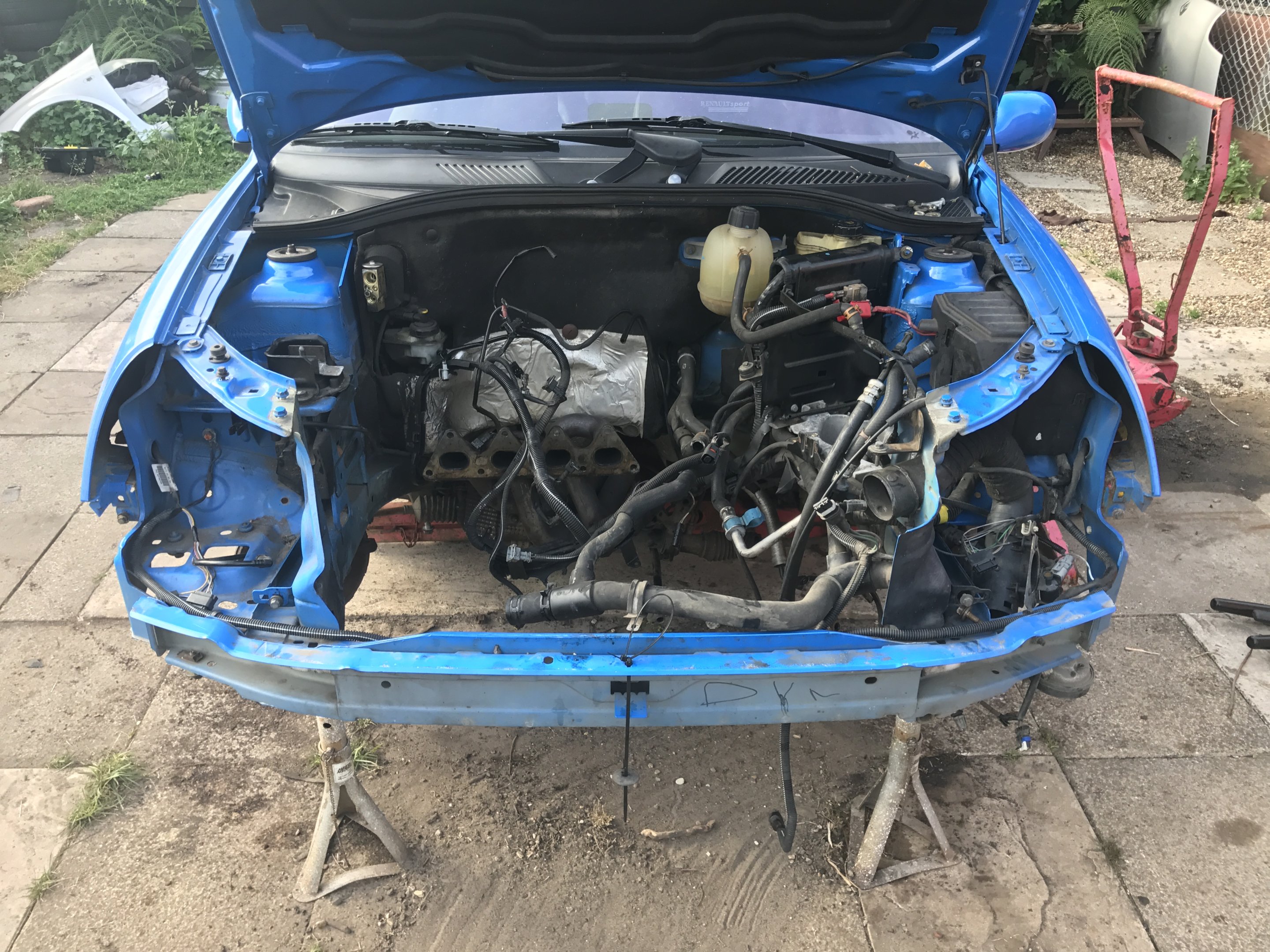

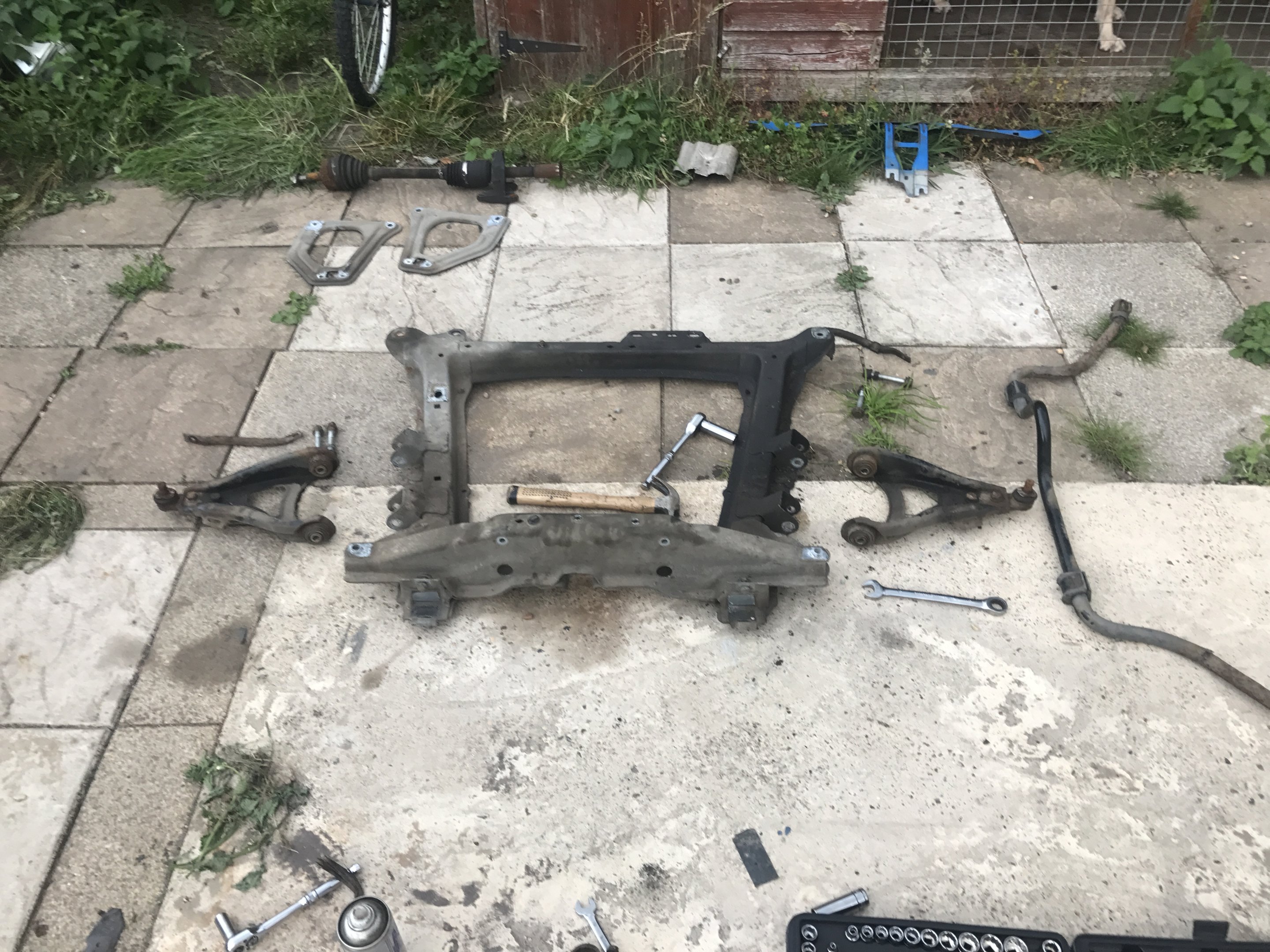

So I set about removing the engine and box from the car as well as all the front subframe.

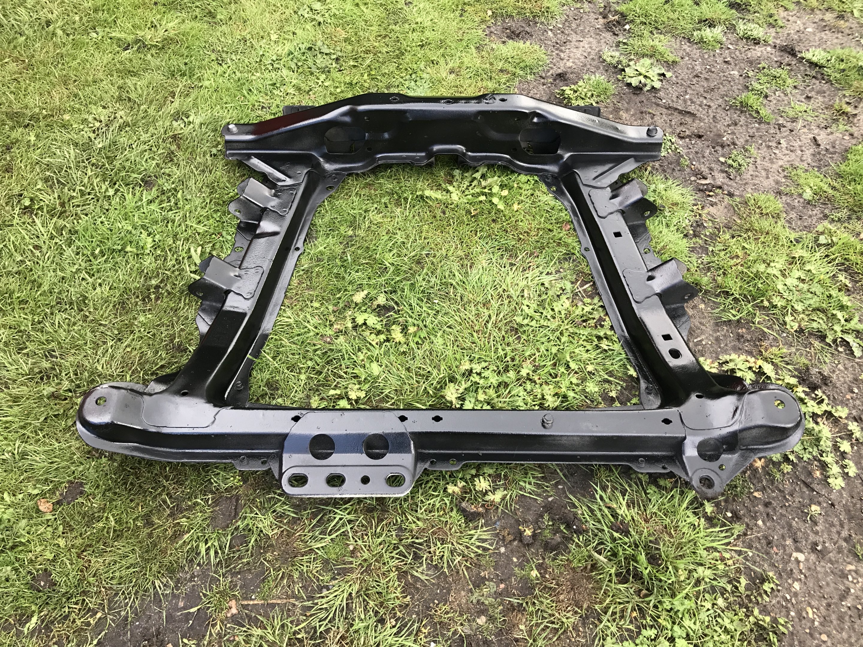

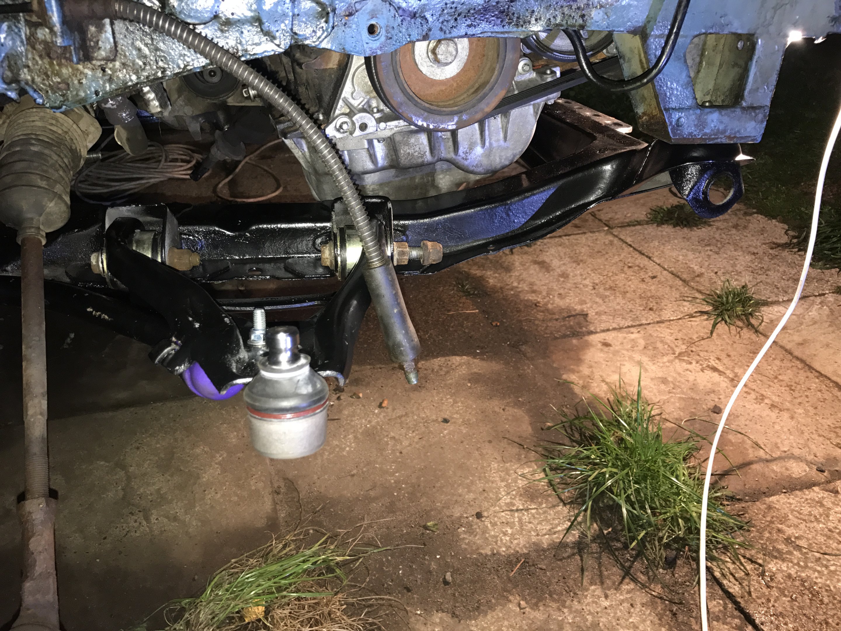

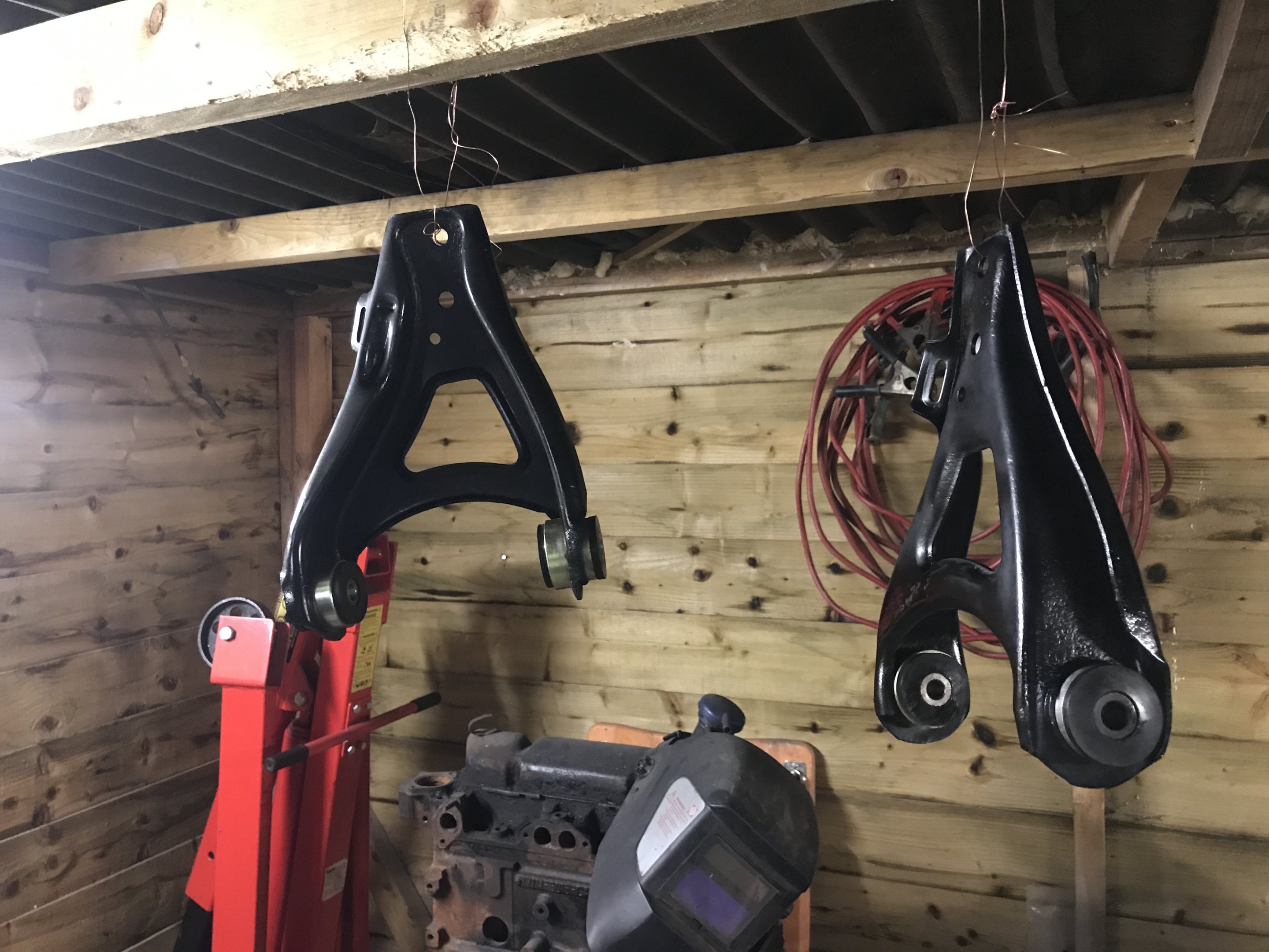

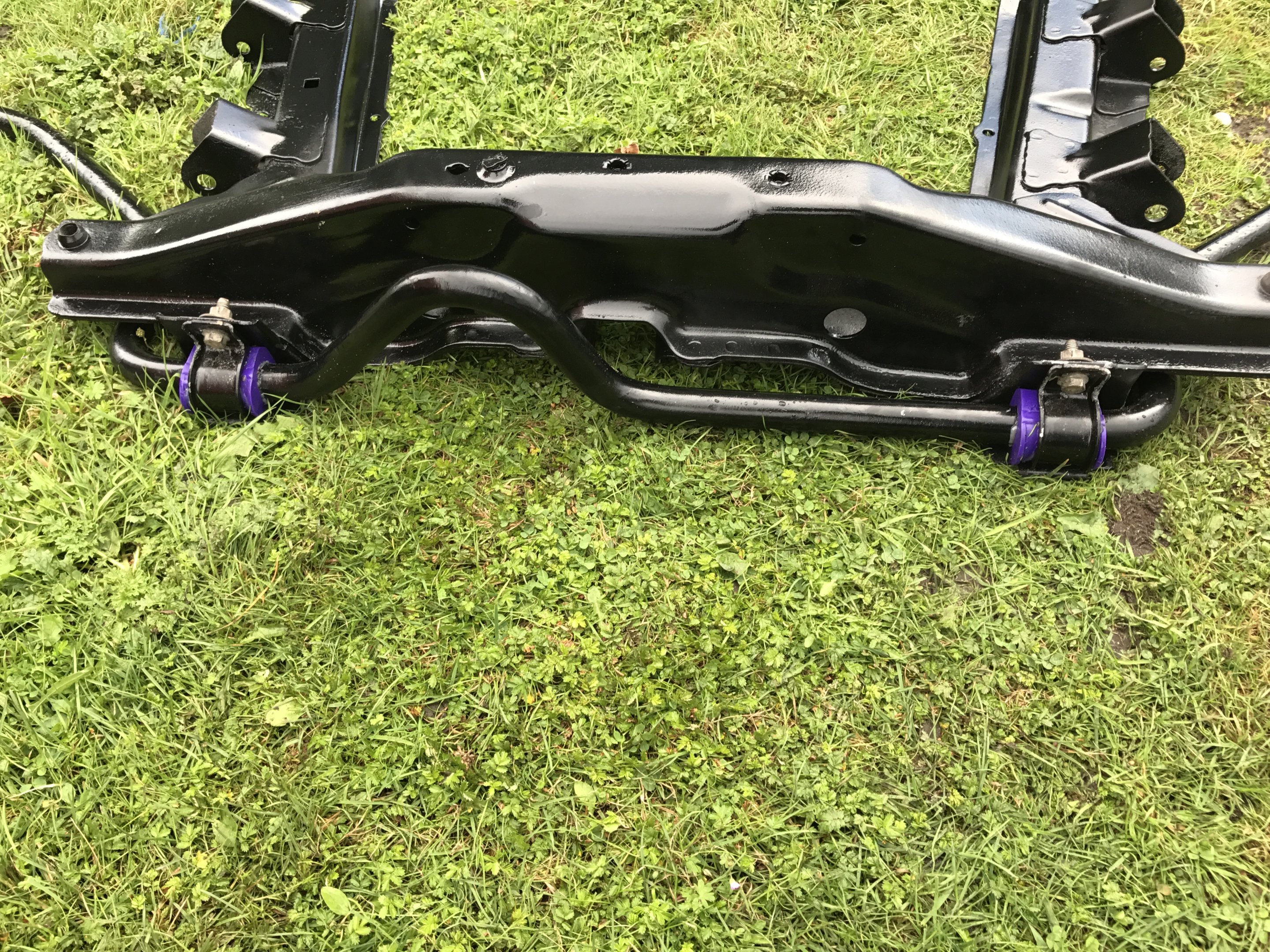

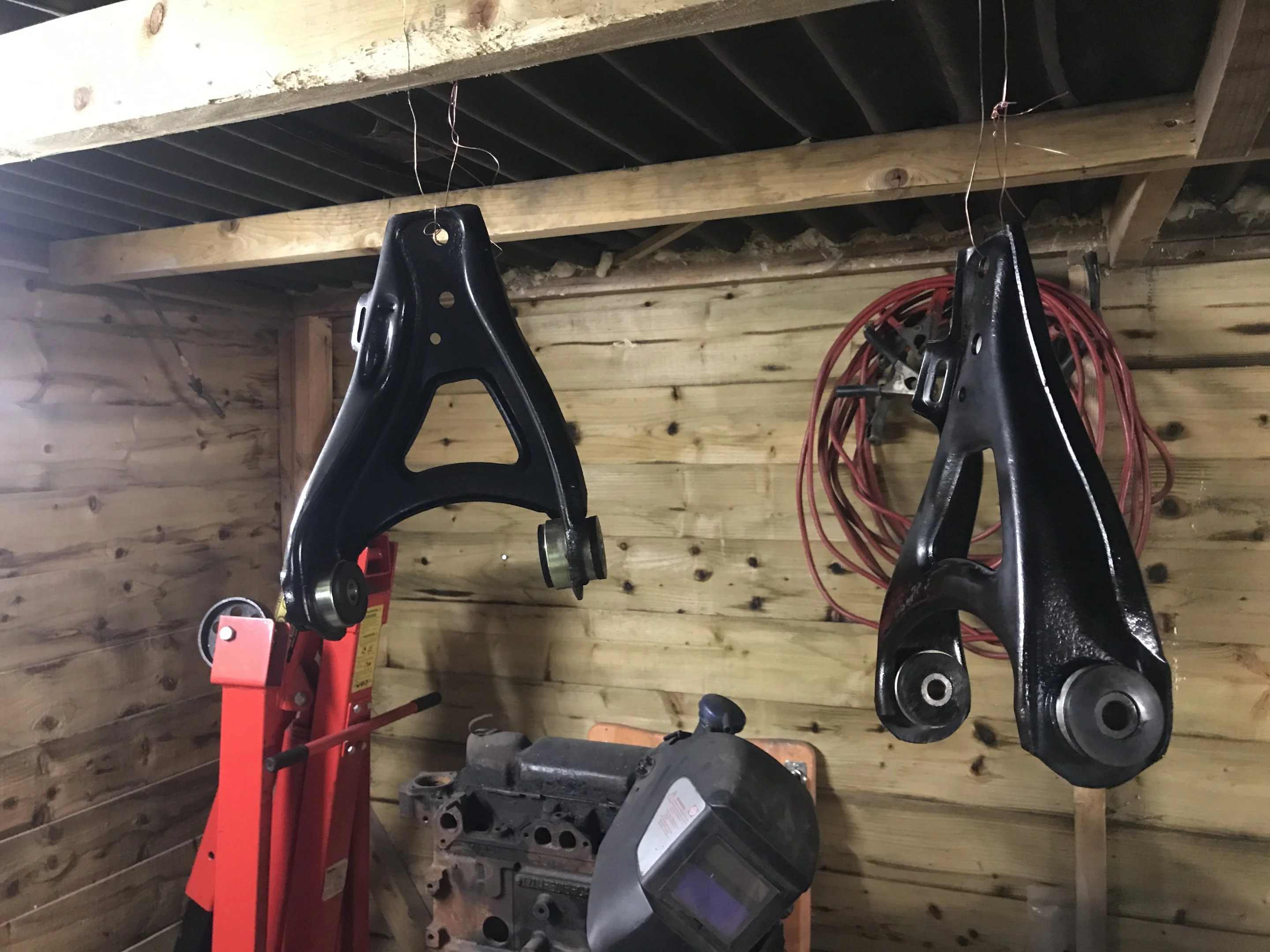

So anyway painted the front subframe and bottom arms as well as fitting the pollybushes to the bottom arms and antirollbar as I rebuilt it.
Also removed all the front arch liners and cleaned and wax oiled around the front end

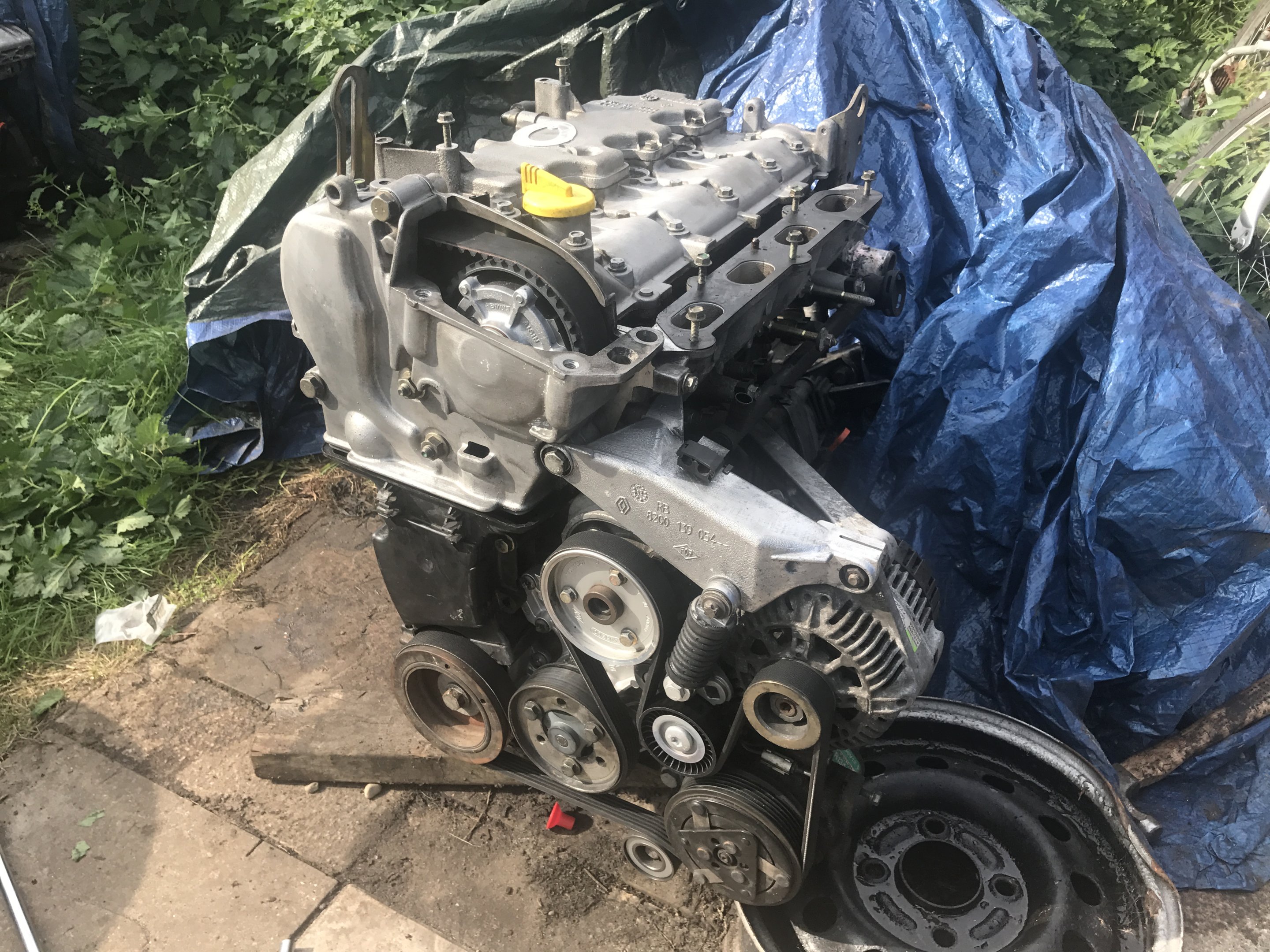

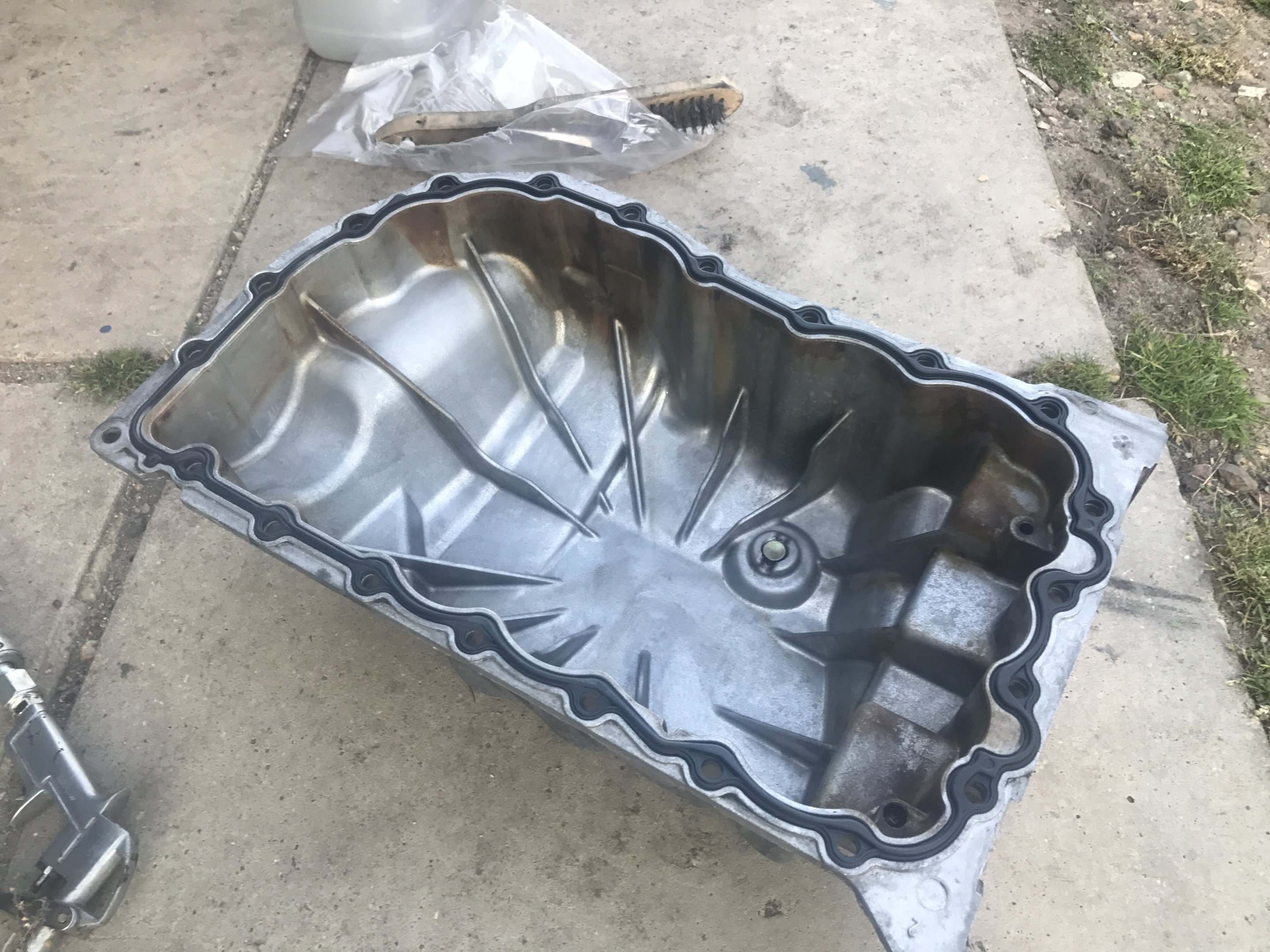

Then set about sorting the engine. Removed the sump, cleaned and refitted with a new gasket as was leaking before

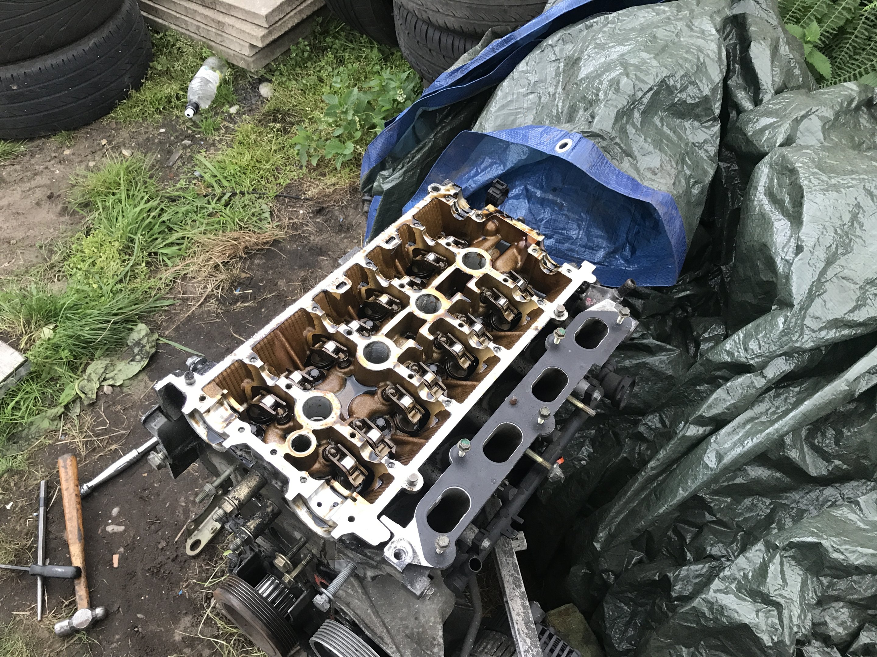

Also removed the cam cover to refit/ seal as was leaking
And refitted ,ensuring it was torqued down correctly with new cam end seals to avoid it leaking again

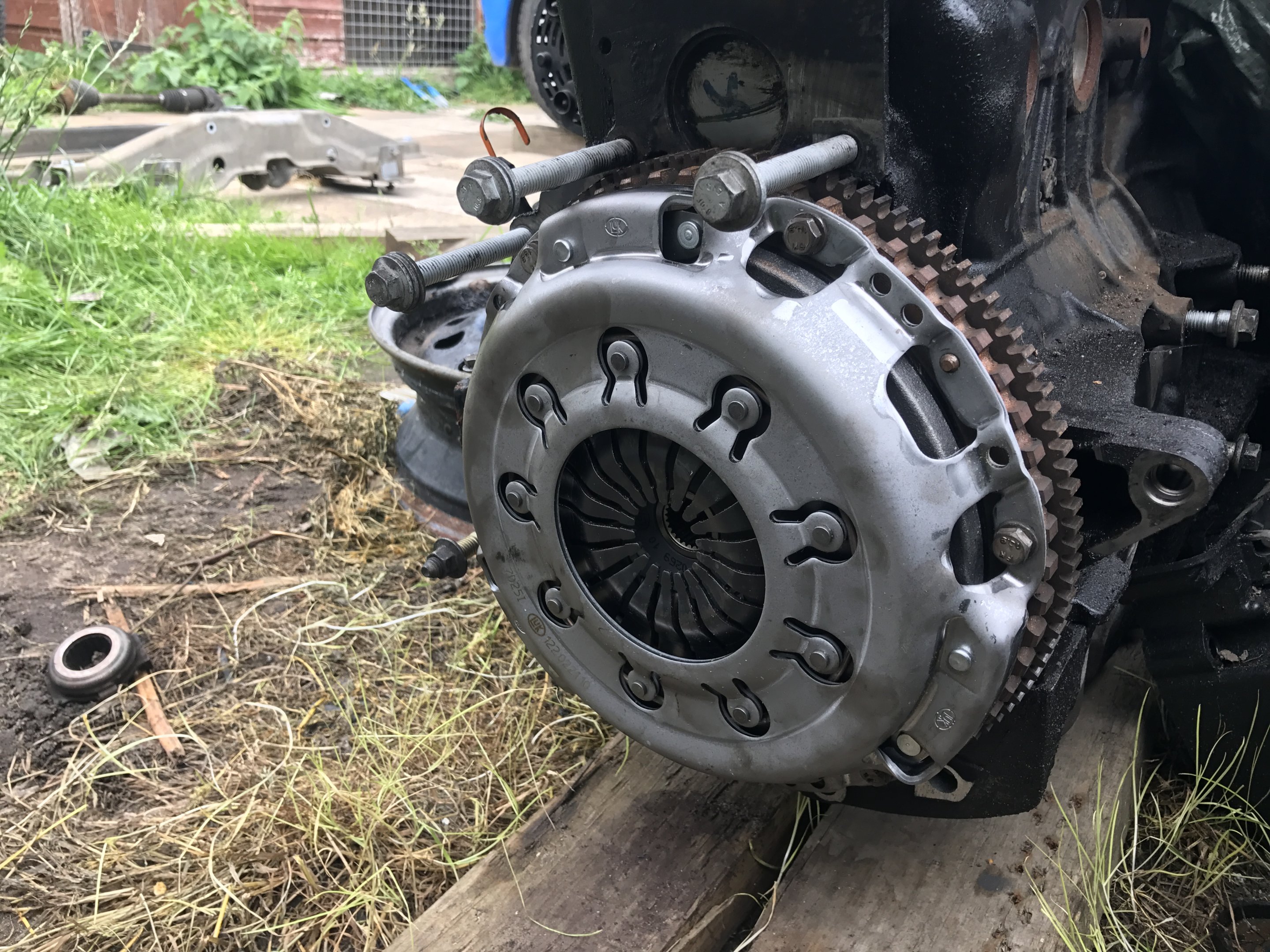

Also fitted the new clutch kit at this point

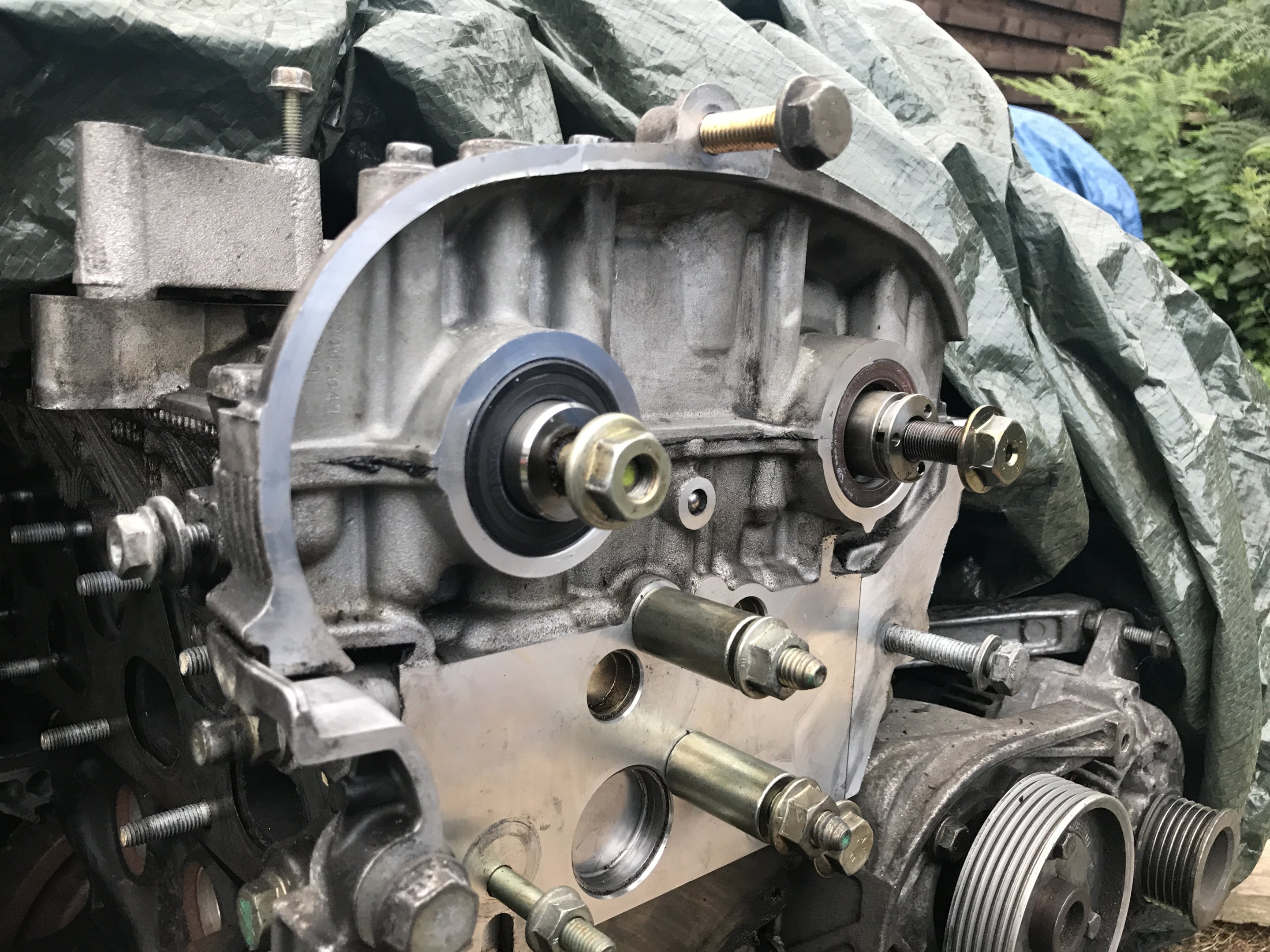

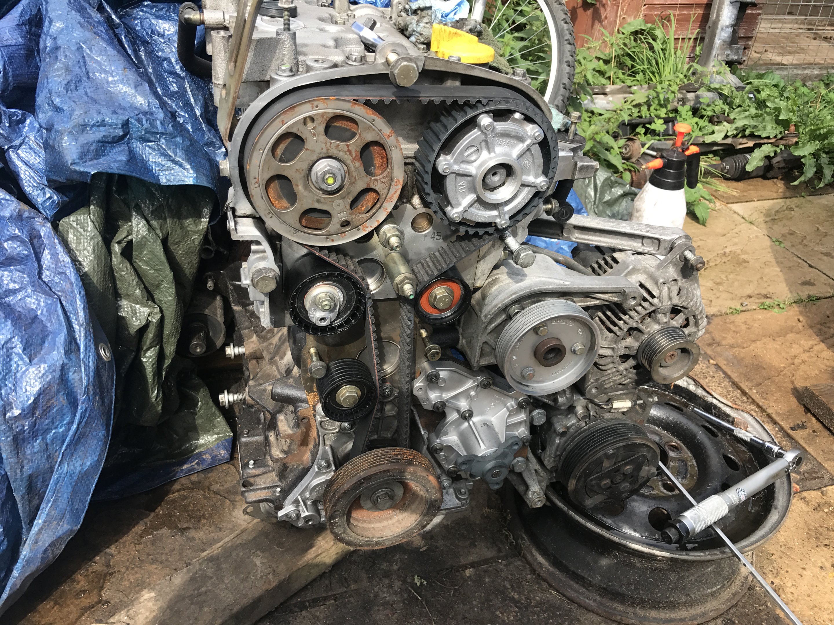

Now when it came to fitting the new cambelt and dephaser I had some help from a good relitive who has all of the correct timing tools and experience in timing this engines. I felt this was better than trying to tackle it myself and ensure it was done correctly. Pics of it all fitted and with the aux belt set up back on too.

How much was the polybush stuff and where from?
Cheers mate , can’t rememberer exactly some bits I got through eBay, the wishbone polybushes were black series and believe I got them off someone on here but think they are around £100 new, the anti roll bar ones around £50 , steering rack £30 and the dog bone mount ones are about £40 I believe.hope this helps :up:

I presume it's easier to remove the lower arms and anti roll bar if you remove the subframe?
Reason I ask is because I've just bough new bottom arms and all new inner and outer ARB bushes and need to fit them.
Yer, really don’t try the inner ARB bushes with the subframe on the car
