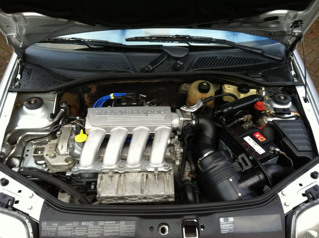

My Renault Clio 172 Phase 1
Obviously this is a before, can't wait to see what it makes once everything is ready to rock and roll !

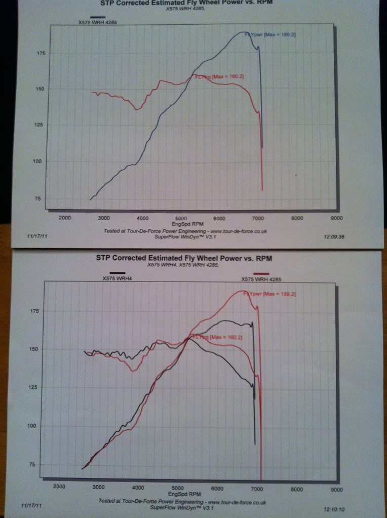

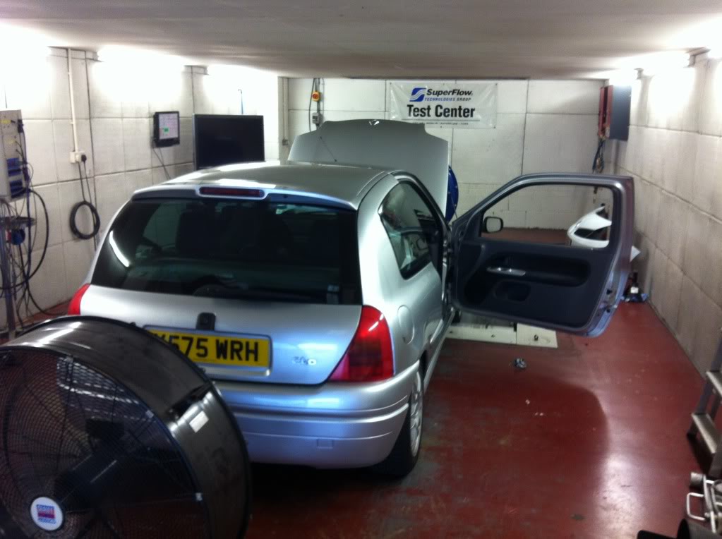

What it made so far....
All the
modifications are fitted and the car feels and sounds like a race
car, I haven’t put my foot down yet because I would rather wait
until the mappings been done. The car as it stands made
189.2 BHP and 160.2 torque which I was
very very pleased about..
Matt said with the map it should make
a little more perhaps 2-3bhp and improve midrange and smoothen out
the curve, my results can be seen below
[URL="http://i858.photobucket.com/albums/ab150/CorreyLay/428.jpg%5B/IMG"]http://i858.photobucket.com/albums/ab150/CorreyLay/428.jpg[/IMG[/URL]]
what do you guys think good or not ?

Impressive result! Should be for the money though.

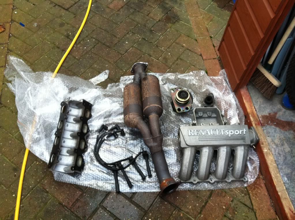

The old parts I had removed

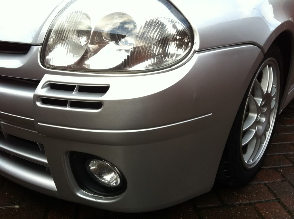

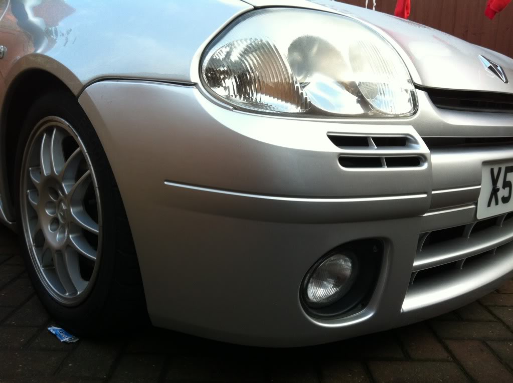

And this is the bumper spacing I am not happy about
The cars booked in at a Renault body work specialist Monday so this can be addressed, the bumpers being repaired and sprayed for around £120 which is not too bad.
lol i know this is an issue with phase 1ns but hopefully these guys can pull something out of the bag
if they do come up with a way of getting it to stay there, would you be able to get some photos so others can do it ? i think every ph1 owner would love you (myself included) as i have given up trying to secure it in place lol

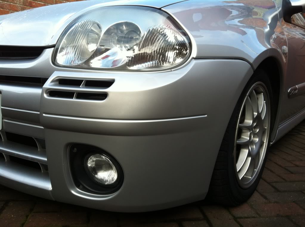

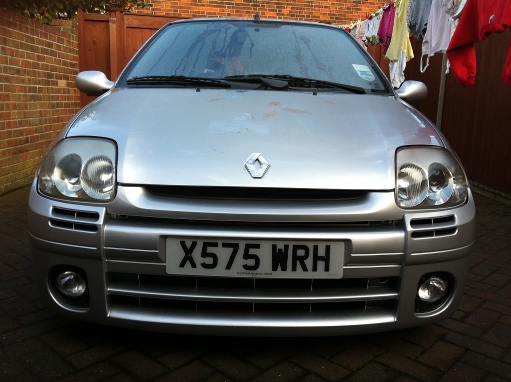

I got the clio back yesterday after having the bumper re alligned so the spacing is correct, i also had half repaired and sprayed and blown in as there was a little pressure point where a previous owner had knocked into something (garden gnome perhaps).
Anyway here are the pictures now...

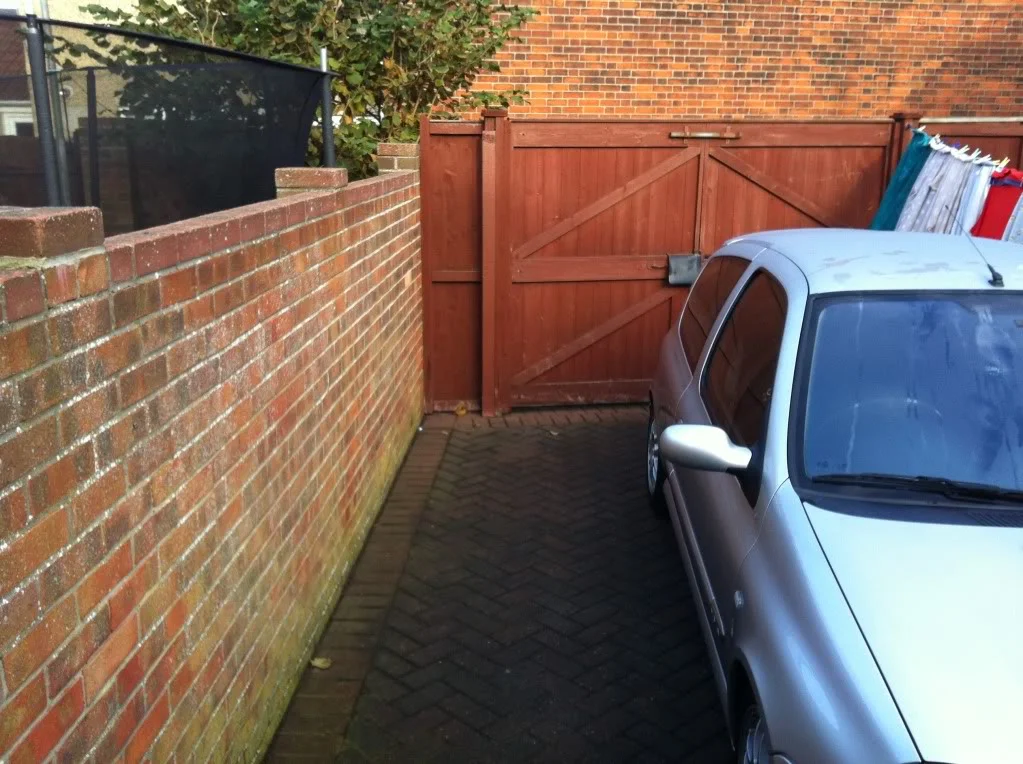

As i have said before there is a cat that comes into my garden at night and treats my car as a slide, pictures from this morning when i woke up
the distance i park from the wall to stop this car attacking my car at night !

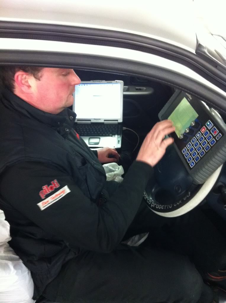

As im sure you are aware I had all my parts fitted by TDF , however my port was damaged so Matt was unable to connect into my ECU. Kindly Matt ordered me another one and told me he would let me know when it arrives so it will allow him to connect into my ECU. The part arrived and I arranged with Matt to go up to TDF midday today. Matt successfully changed the port and identified a damaged pin on the one he removed which was great. After replacing the port Matt successfully connected his equipment into my car and then started to work his magic seen below.
After working his magic, my clio made 192.4BHP and 166.9trq which I was absolutely delighted about. Matt was even impressed by how well my car has responded to all the work and said I should be very pleased which I am totally made up about. Figures shown below with before and after remap.

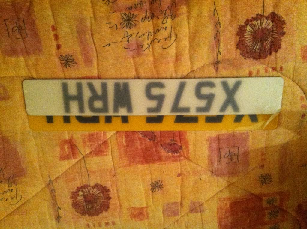

On another note I have purchased some 20mm H&R wheel spacers and some new smaller number plates.
The plans to fit both of these at the weekend to give a few more finishing touches to the car.
