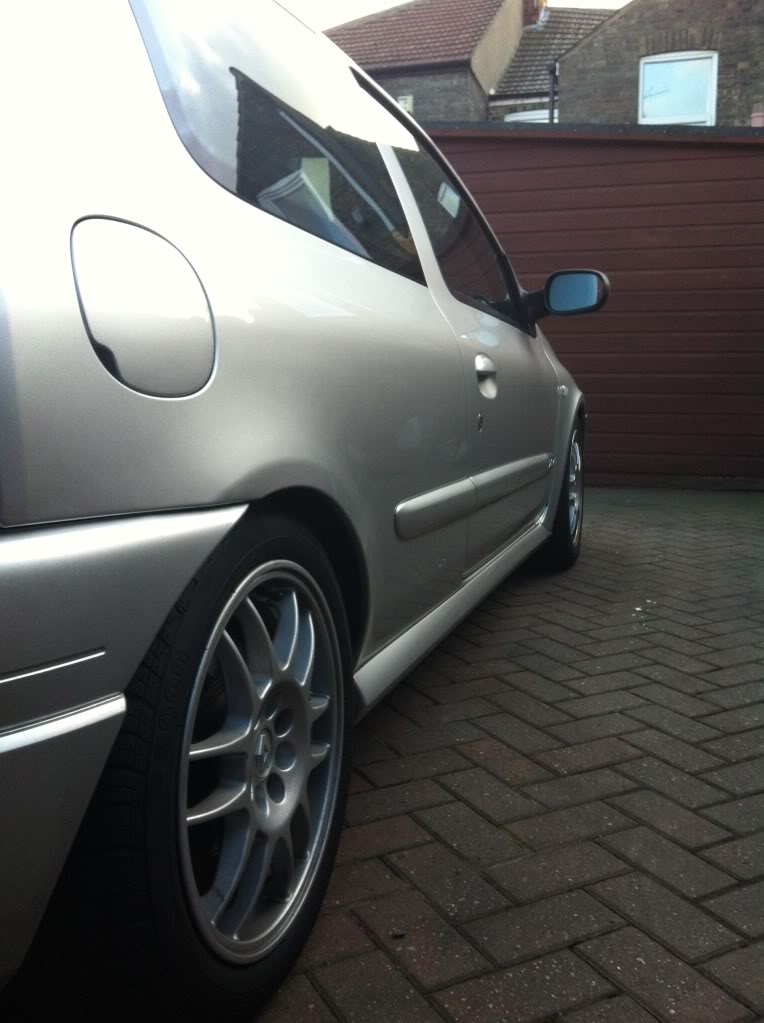

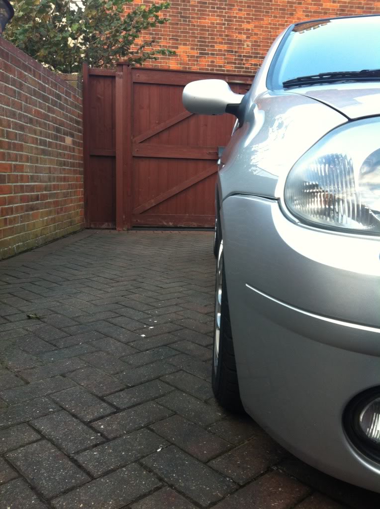

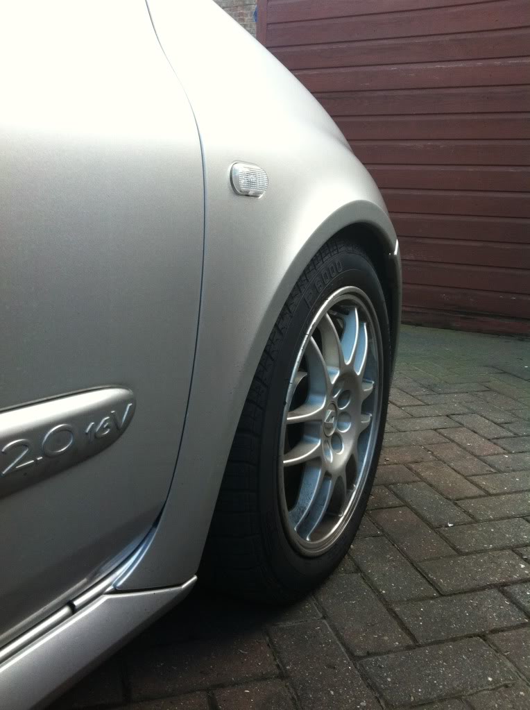

As i have mentioned before I had a little bobbling noise coming from the rear off my car after having my v maxx coileys and geometry fitted and done. Therefore I had a little time to get over to SCA ralley who installed them and set them up just to have a look and see if there was an issue. They put the car on the ramps had a look and took it for a drive and they didnt spot anything that could be causing a problem. I am very fussy so its probably something of nothing but I think its important to get things like this checked. I also had my new 20mm H&R spacers to fit to the front of the car so i let these guys just whip them on and supply the longer wheel bolts just so it was not a wasted trip. It looks alot better than before and I deffo glad I didnt go no more than 20mm. Check out the pictures below.

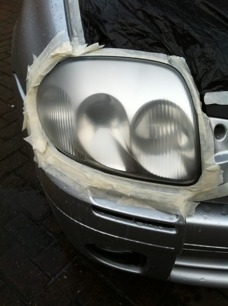

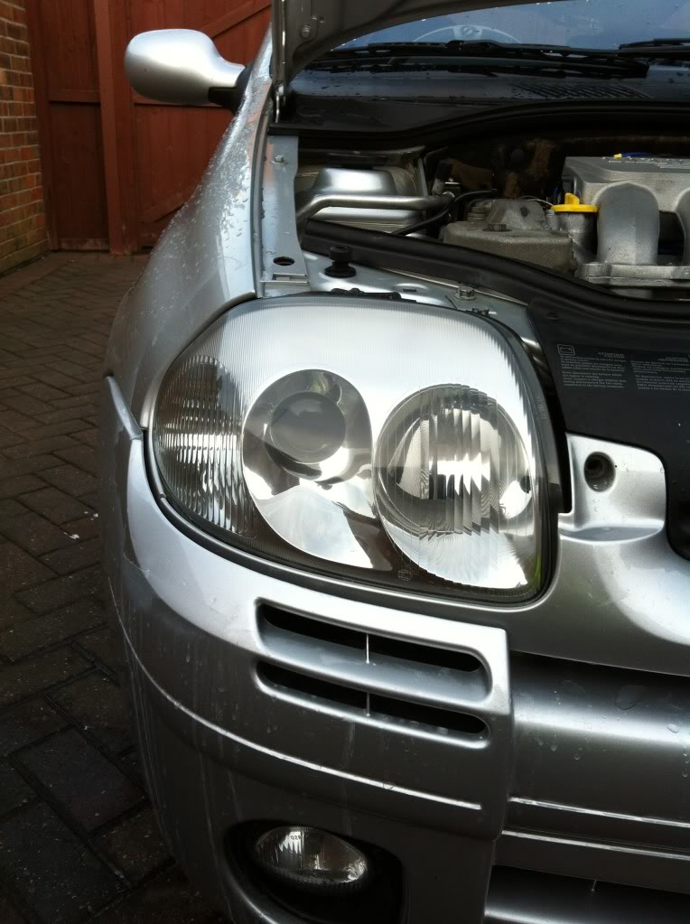

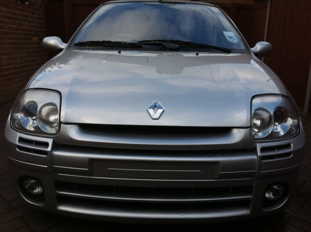

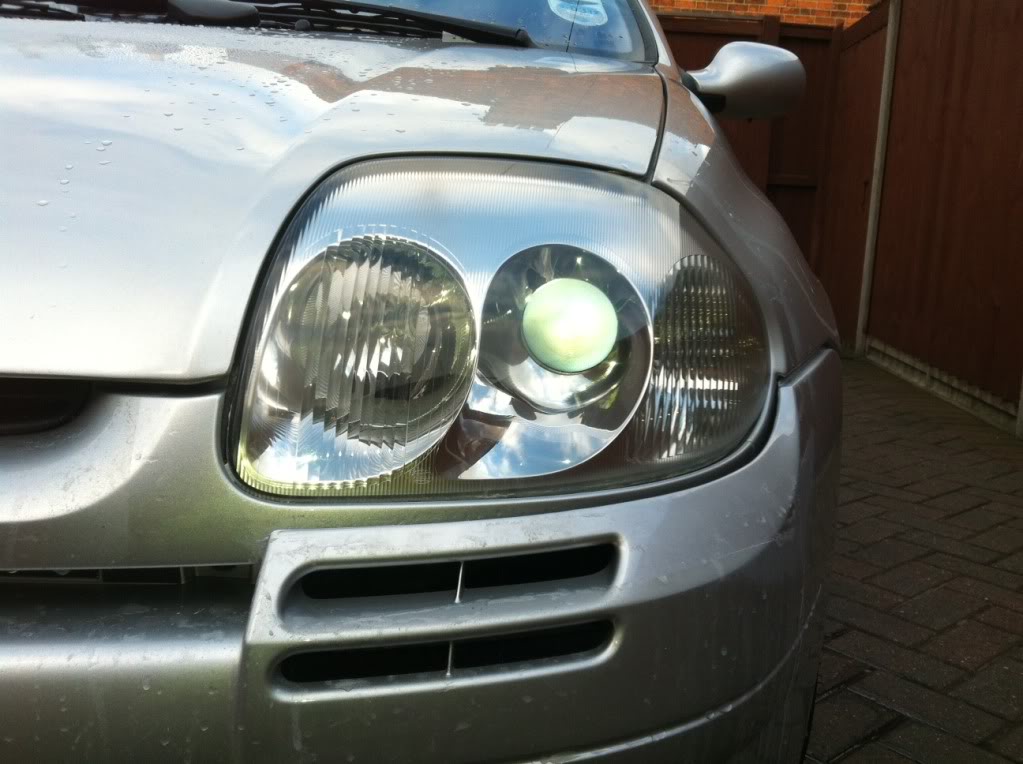

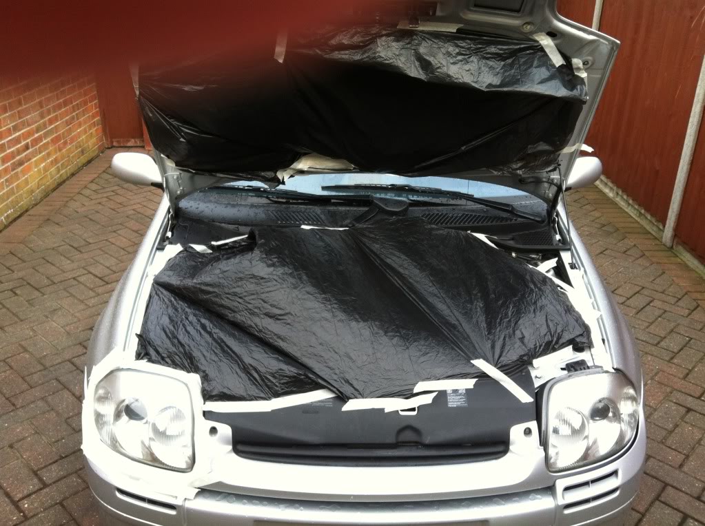

As you may know I had a little bit of yellowing on the top of my headlights. I attempted to have a go with the procedure on here. After getting the bits I needed from Halfords I gave it a quick go one night, however i was not impressed with the finish so I had a chance today to give it another go and I am now very pleased with how it turned out.
Before
During
After
It is really windy here and freezing cold so I have only done one headlight. If the weather improves then I will get onto doing the other one. You do have to put a bit of time and effort into this if you want the end product to be spot on, but the results speak for them self.

Yes I did mate, obviously 600,800,1200 wet and dry, buff with meguires using drill and buffer from halfords, auto glym wiper on and off with a cloth. It said to use house polish after that but I decided against it as its not designed for headlights specifically, I'm sure it would do no harm if you were to use it otherwise someone would have said
Tempted to get those spacers for my ph1. Is there any difference in handling with them fitted better or worse?
If I'm going to be honest, I don't drive the car harder enough to notice a difference, technically making something wider should handle better. I really just wanted the front wheels as far out as the rear because I thought it looked a little odd with the fronts tucked in so far under the arches. One thing I have noticed is that it makes me 15" look massive
Handling definitely changes, at first it feels a little odd but then you notice it's actually better and far more solid in the corners.
Nice car too :)
Did you have to get your tracking & alignment set up again Rob? I really fancy these H&R ones. Do you know where to buy them from?
I didn't, it does put something slightly out and your tyres may not wear perfectly but I am led to believe this is something you should expect if you want a wider wheel base
I was really lucky, I got them new and posted for £60 from a lad called Josh on here. I posted a thread mentioning I was considering getting some and he offered me his in a PM so it was to much of a good opportunity to miss. I think there around £100 new on euro performance, I think there alot of money for what they are. You will obviously need longer wheel bolts as well if you get the same as mine, some you don't need to because the spacer bolts to hub and the wheel to the spacer. Wheel bolts are only £2-3 each I think, I'm not sure how long the ones I've got are because they were supplied and fitted before I had a chance to ask

it was absolutely freezing cold today and very windy, but I soldiered on and re vamped the other headlight so they are both nice and shiny. I am really peed off at the moment, firstly because stancewhore has ripped me and others off by failing to send the lights I paid for and secondly, I ordered some sticky velcro circles for my new number plates to go on and they should be been here ages ago. I know its not the end of the world but people are quick to take your money but when it comes to sending them, its a different story, glad ive got my moaning out of the way.
There was still a tiny little mark on the headlight i done today, but no matter how much I rubbed and buffed I couldnt get it to shift. However these both look great IMO and I am very pleased with final outcome.

your lights look superb now, did you use the guide off here? as i need to do mine so might have a go with that.

Thanx Lewis, yes I did mate, I thought it worked really well. Thanx for the recommendation, I have quite a few now. I will check them all out and make a decision in a couple of days or so. Its supposed to be gail force winds tomorrow so im glad I got the other one finished today lol
