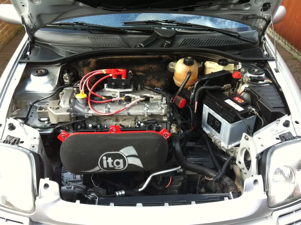

My engine management light keeps coming on and I've got to go back to TDF for Matt to map it out.

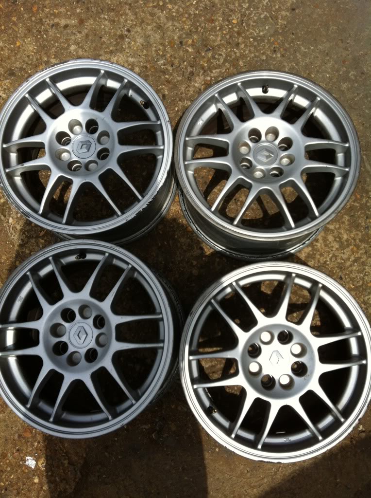

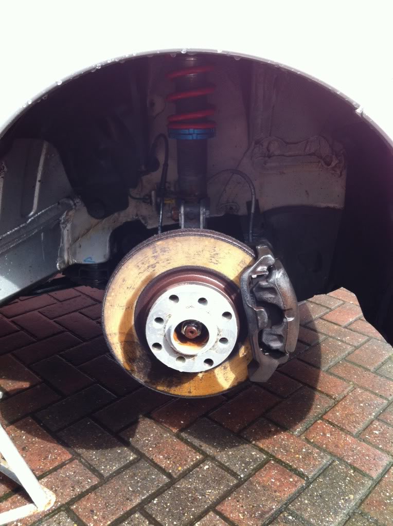

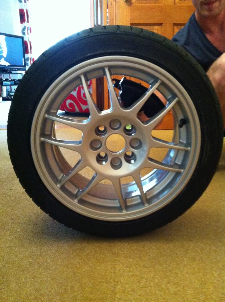

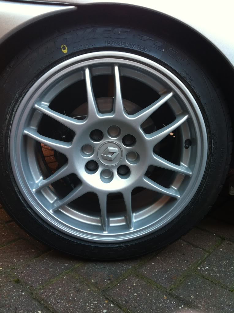

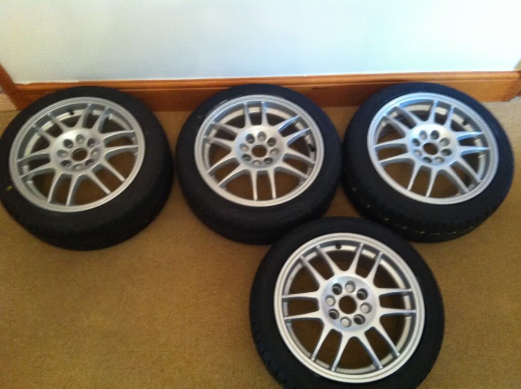

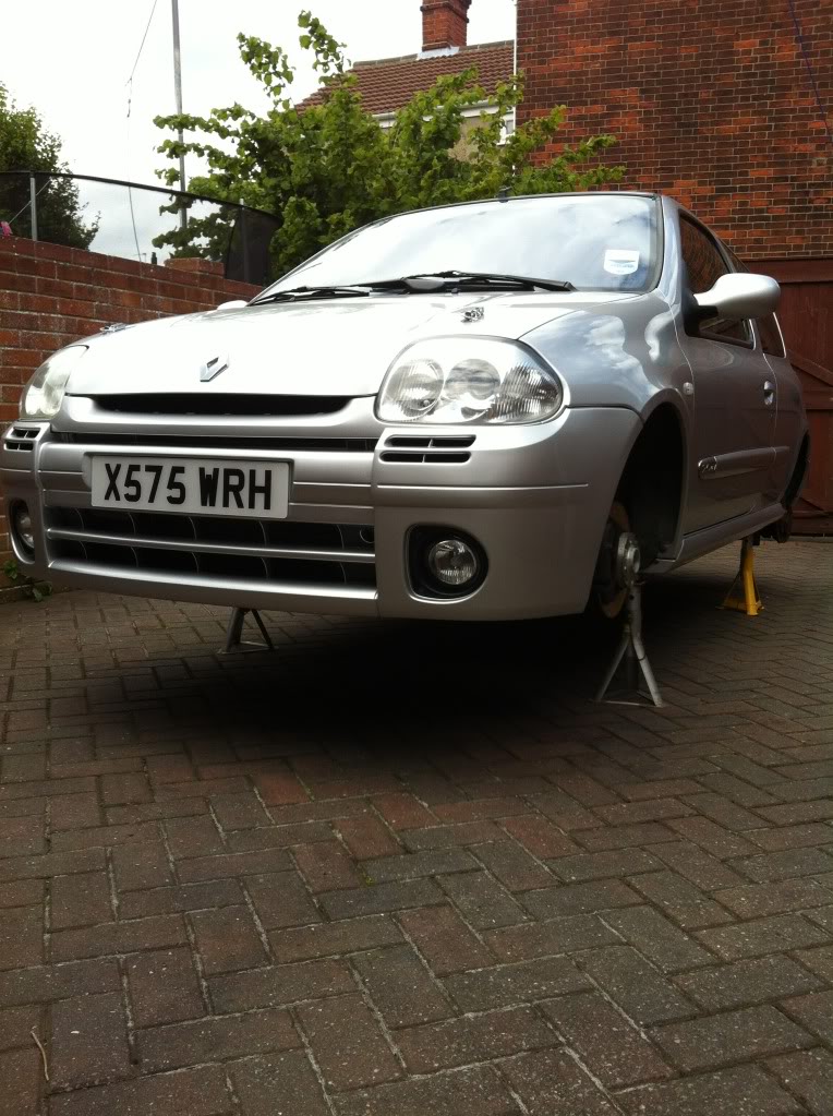

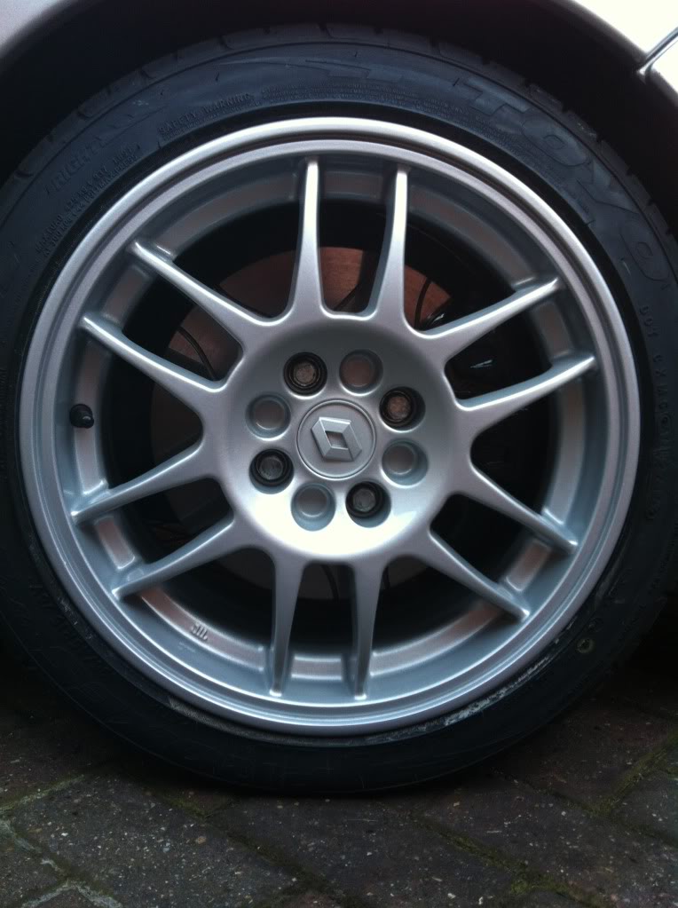

I decided its finally time to get the f1ns refurbed and get the 195/45/15 T1rs on. As I was weathered off from work today I had a chance to get the wheels off, tyres off and sent down to aero coat the powder coat specialists. I am going to get the f1ns done in a flat silver which is more or less the same colour as they are. I did like the look of the shadow chrome but I dont think it would work on little 15" wheels.

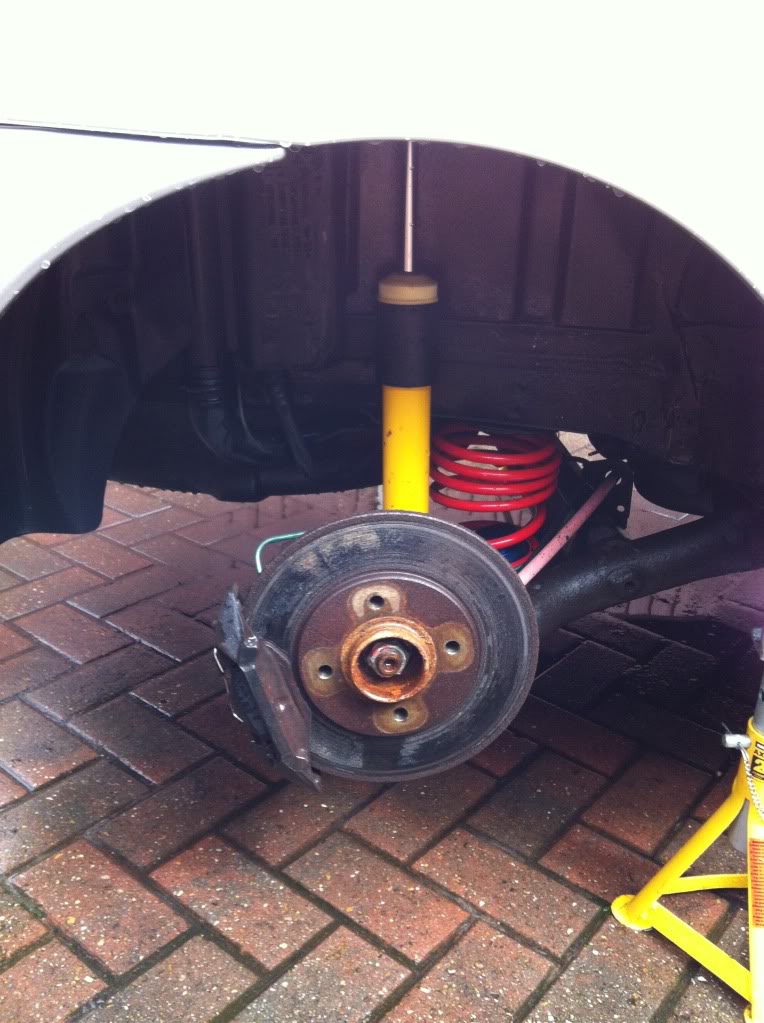

The car on axle stands
The rims before they went in, they are in okay condition but they laquer is beginning to peel and there are a couple of scuffs (previous owner)
I am trying to get a mechanical friend round to strip down my calipers so I can get them powder coated whilst the wheels are off and the cars on axle stands. This might be a good time to but and fit some Ferrodo front pads and fit my Brembo Groved High Carbon Front Disks. Obviously I will be cleaning the arches up over the next few days.

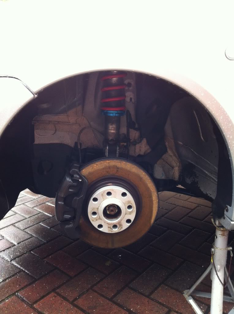

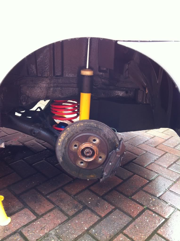

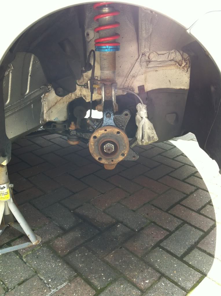

As the car was on axle stands, it gave me the chance to clean the arches. I used my brush for my alloy wheels and my dodo juice shampoo in a warm bucket of water. I can not believe the amount of mud and dirt that came out of the arches. I can not recommend doing this job yourself enough if you get a chance. It allows you to remove all the build up and clean parts of the car that are usually inaccessible. I also sprayed treatment onto the coilovers, nuts and bolts to try and keep them in as good a condition as possible.

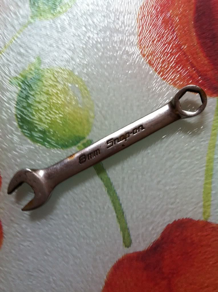

To my disbelief I found a 8mm spanner on the rear drivers side break caliper lol. I have no idea how long its been there.
The plans is to now get the break calipers removed front and back and get them powdercoated. They will need to be completely stripped apart before going as the seals will melt in the oven. Once there back I will get new seals kits for all the calipers. Fit the groved max brembo front disks along with new ferrodo ds front pads, put uprated break fluid in and bleed the system. Finally refit the wheels, there is alot of work to do in a short space of time so im trying to my hardest to get all the jobs done.

No lol, must of been someone who worked on it previously. Who ever it was, was more than likely embarrassed to ask for it back once they realised where they had left it.

If you follow this thread you will know my car is currently on axle stands while I had my f1ns refurbed at a professional powdercoaters called aero coat. I have now recieved the wheels back and they look fantastic. I took my old 195/50/15 P6000's tyres off and stuck on four new Toyo T1R 195/45/15 tyres on. Heres how they now look.

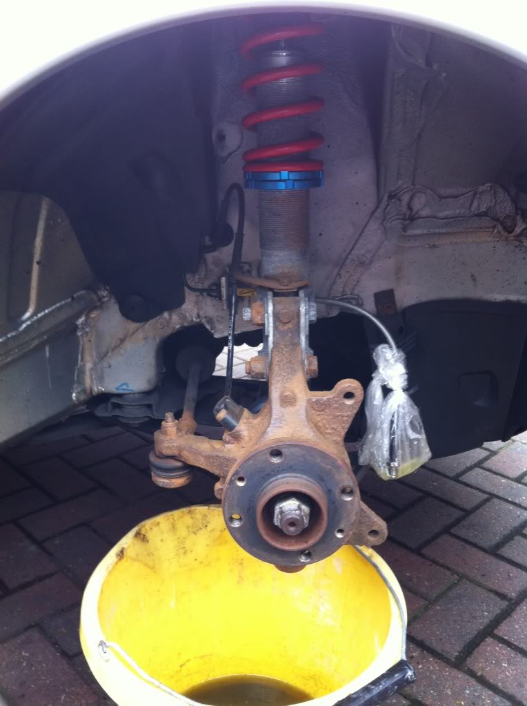

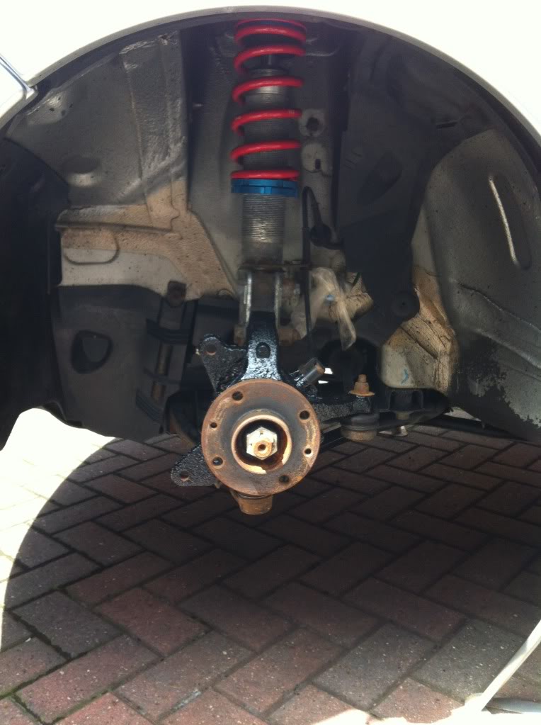

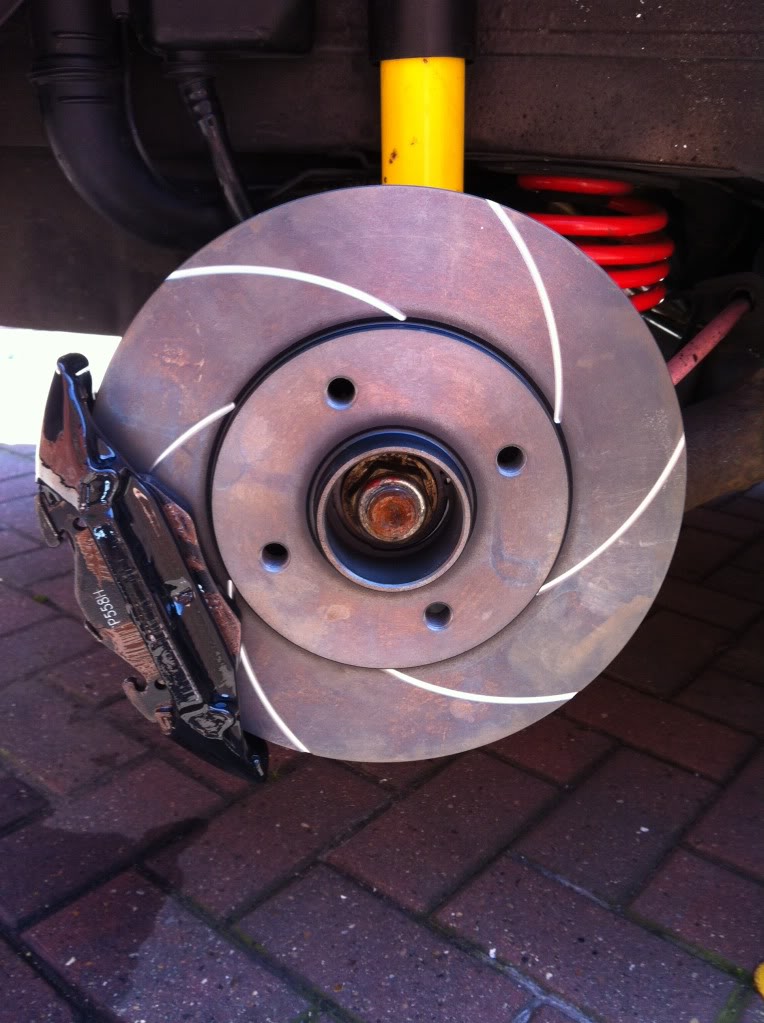

While the wheels were off I cleaned and scrubbed all the arches as you can see in the pictures above. I had a set of Brembo Max Grooved Discs ready to go on the fronts that I bought second hand from a guy on here. However my mechanic informed me they were cracking and were forming a lip. He told me if I fitted new pads with these discs it would wreck them, I was pretty gutted by this point. My mechanic pointed out my pads on the rear were 70% worn too so I thought a new break set up was required. I knew deep down my breaking power was getting weaker all the time so I bit the bullet and called K-tec. After looking at the options I decided on Ferrodo 2500 pads at the front and rear, Max brembo grooved discs at the front, I then bought genuine renault discs with bearings and abs ring for the rear but k-tec are going to groove them for me so it will all match, well thats the idea behind it. A good bit of money spent there on my new break set up. I am currently waiting on this to arrive.

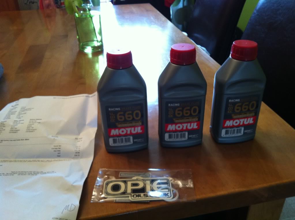

After speaking to BigAsh on here with the TDF super clio I decided to go with Motul high performance break fluid, again not cheap but you pay for what you get.

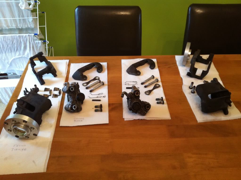

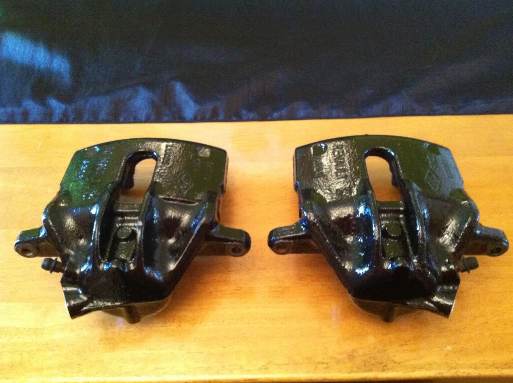

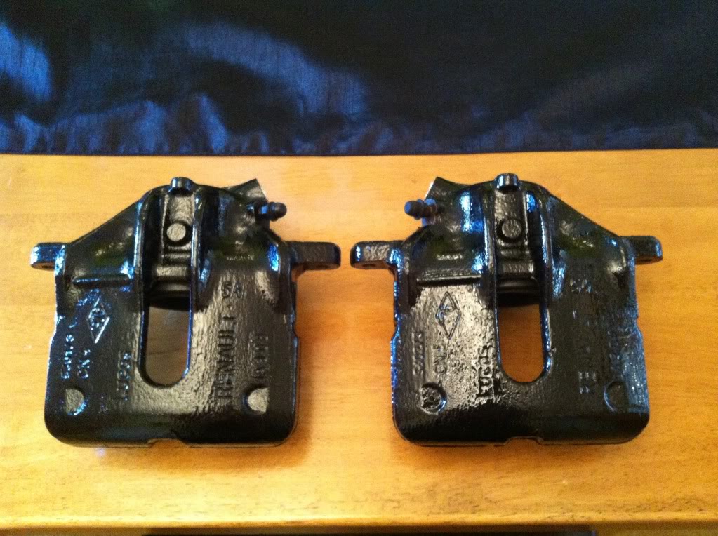

I decided to strip all the break calipers off the car to get them repainted and powdercoated. I had the opportunity so I thought why not.
I then bought Foliatec black caliper paint and wire brushed all the rust off and then hand painted the calipers.
This is a very time consuming job by the way.
What it will look like

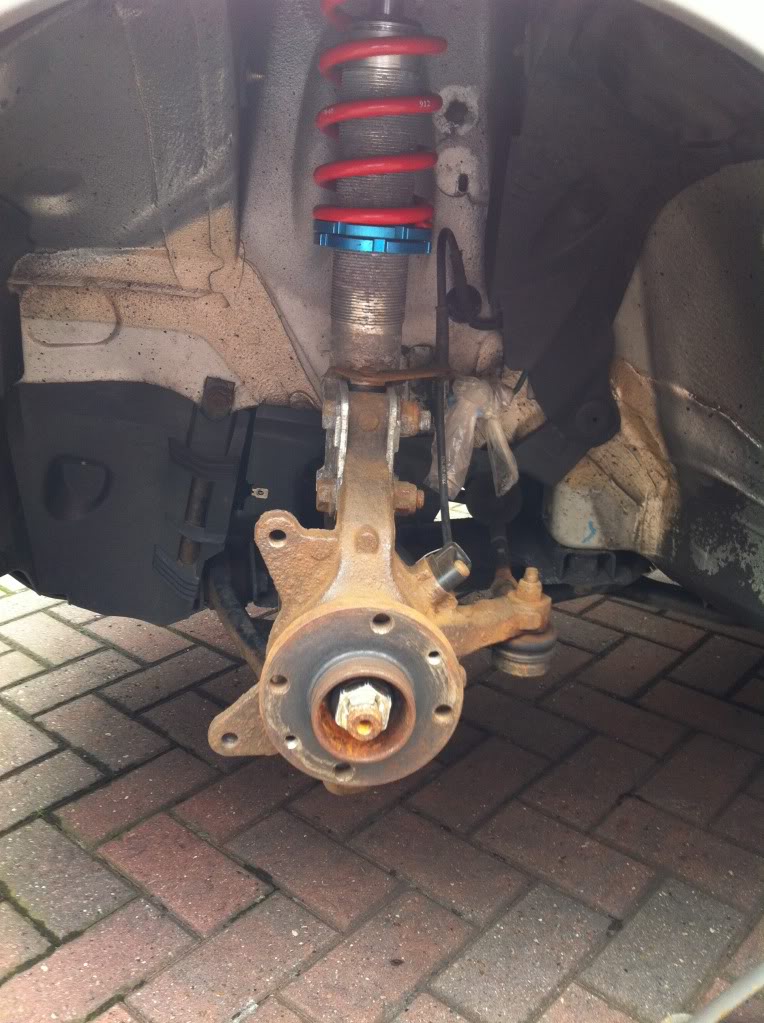

I then wire brushed the front hubs and re painted them black too.
after

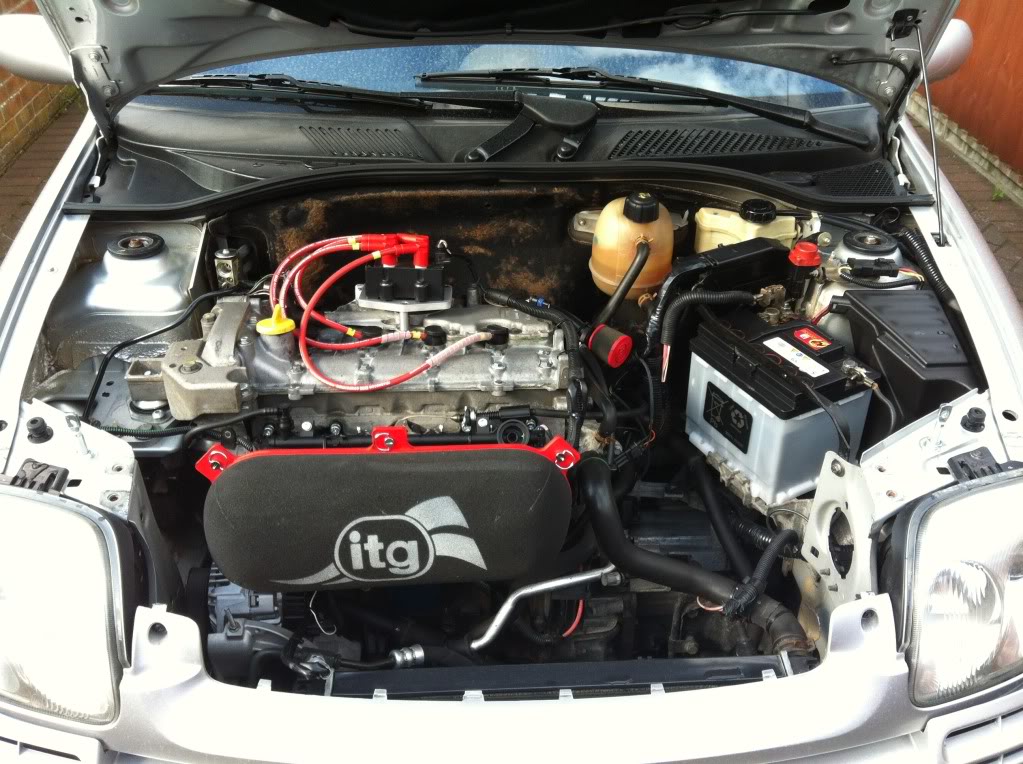

The easy job... I bought some 8.5mm Magnecor ignition leads to match my Red ITB set up
The rest of the breaks are still currrently at the powdercoaters, I did want to send the whole lot to them but they said some parts they cant put in the oven because the internals of the caliper will explode. I looked at stripping them down and getting new seal kits but they were almost £20-30 a caliper so it was too expensive. Once I get the break set up from k-tec and the callipers back I can put it all back together and start driving it lol.

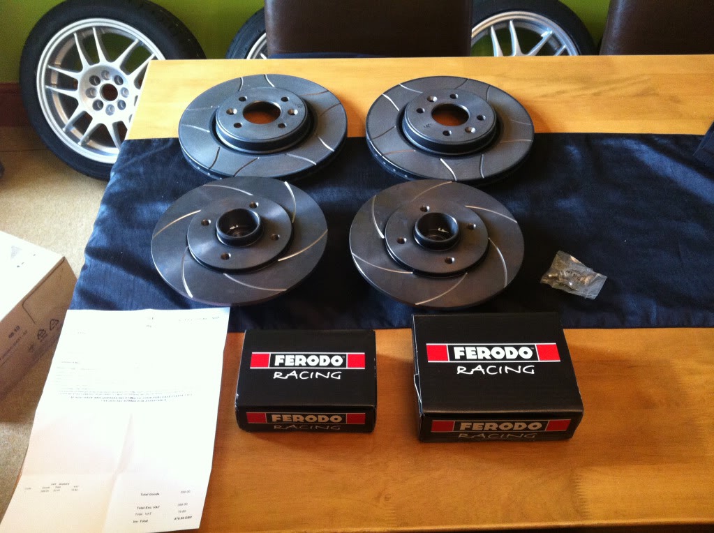

Update

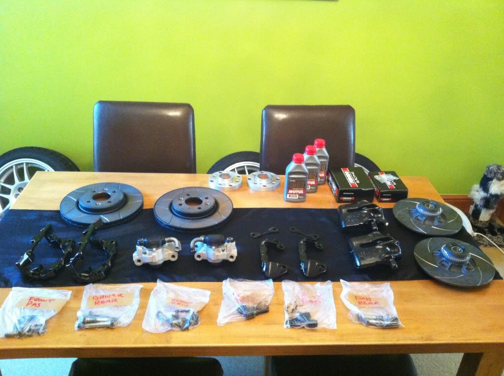

Just had these turn up
Brembo Max Grooved Front Discs
Ferodo DS2500 Front Brake Pads
Genuine Rear Discs Grooved by K-tec
Ferodo DS2500 Rear Brake Pads
Just waiting on the rest of my brake components to come back from the powder coaters, they have kept me waiting for 3 weeks now and still have not started the work, they are now doing the work for free to make up for this.

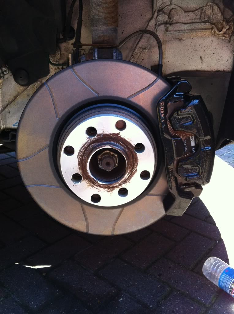

I finally got all the parts for my brakes back from the powder coaters and they look better than new. The only downside was is that they had painted areas i asked them not too and the rear callipers where covered in a sticky residue from the masking tape when they were bead blasterd. After a good scrub with some warm water and degreaser it soon came off. I dropped the brake components off to the powder coaters in labelled bags so I knew exactly what corner of the car they came from. The powder coaters decided to make my life that bit more harder and give them to me all in one bag. My mechanic arrived this morning and we began installing my new big brake upgrade.
The front drivers side
The rear drivers side
As the powder coaters painted the areas of the callipers that brake pads use to move, the new pads would not fit in, I had to file off the paint back to bare metal to allow the pads to move once more in these areas. Despite filing off the paint on the front callipers, the pads would still not fit in nicely. I then had to file a little off the slider to get a snug fit that woud allow the pads to move when I brake. I copper slipped a few areas to ensure the moving parts stay moving for years to come.
After the installation was complete, we then bagan to bleed the system. We bled each corner twice to ensure we got all the air out of the system and a firm pedal. I had previoulsy drained down the entire brake system using the brake pedal to force it out and to my surprise I only used under a 1 litre of my new brake fluid to bleed the system and top it back up to maximum. After a check for leaks and checked the hand brake and brakes were clapping on, I then finally got my refubed F1ns on with the T1R's.
As the car had been on axle stands for just over 3 weeks, I was wondering wether or not the ole girl would kick into life. To my surprise she fired up after the first turn on the key.
I took the car for a drive to see if the brakes were all okay, and everything seems okay but the brake pedal did not seem as firm as I previously remember. It might just be me as I havent drove it for so long or the fact everytings new. My mechanic told me to take it easy for a bit to allow the brakes to bed in. If the pedal doesnt feel a bit more responsive in a month or so I will have a look at bleeding it again, however we thoroughly bled and rebled the system so it would surprise me.

The DS2509 come with bedding in instructions.
10 or so hard brakes from 100 down to 30. Do not lock them up or come to a standstill.
  2014 Clio 200t edc
Looks great. Although my only bugbear is that the front discs don't match the rears. Though my fronts are grooved but my rears are standard. :quiet:

Lol yes I do agree, they are genuine rears but I had them grooved by ktec as the front are although the pattern is not the same.

Back on subject, brake overhaul looks awesome. Personally i wouldn't of got the grooved disks, they eat pads much quicker, Brembo High Carbon disks about £40 FTW :) i'm only using grooved disks as they came on the car :eek:
