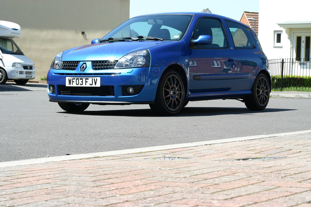

very nice motor you got there,looks a little higher than i expected, will read your thread asap, cheers

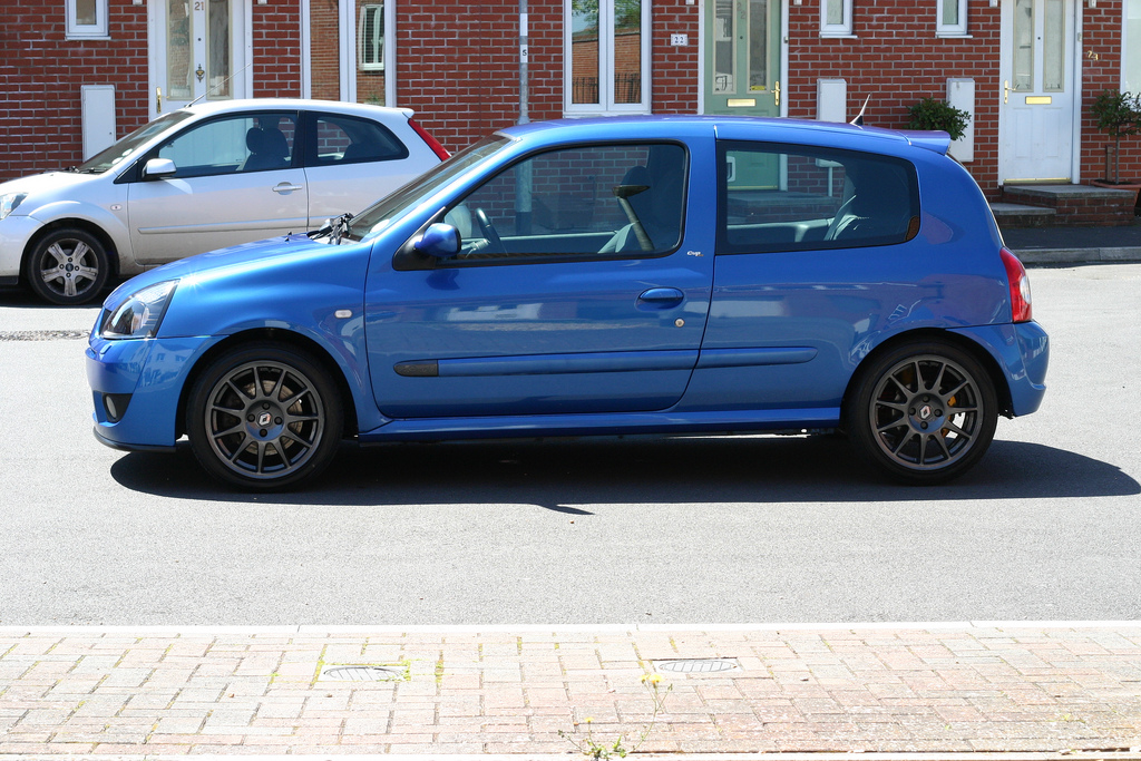

i'd say mines lower than that tbh, (then again looking at the pics, maybe not so much ) stephen at grinspeed advised me not to go any lower, best pic i have at hand although the front has been lowered since for rake, excuse the winter steelies!

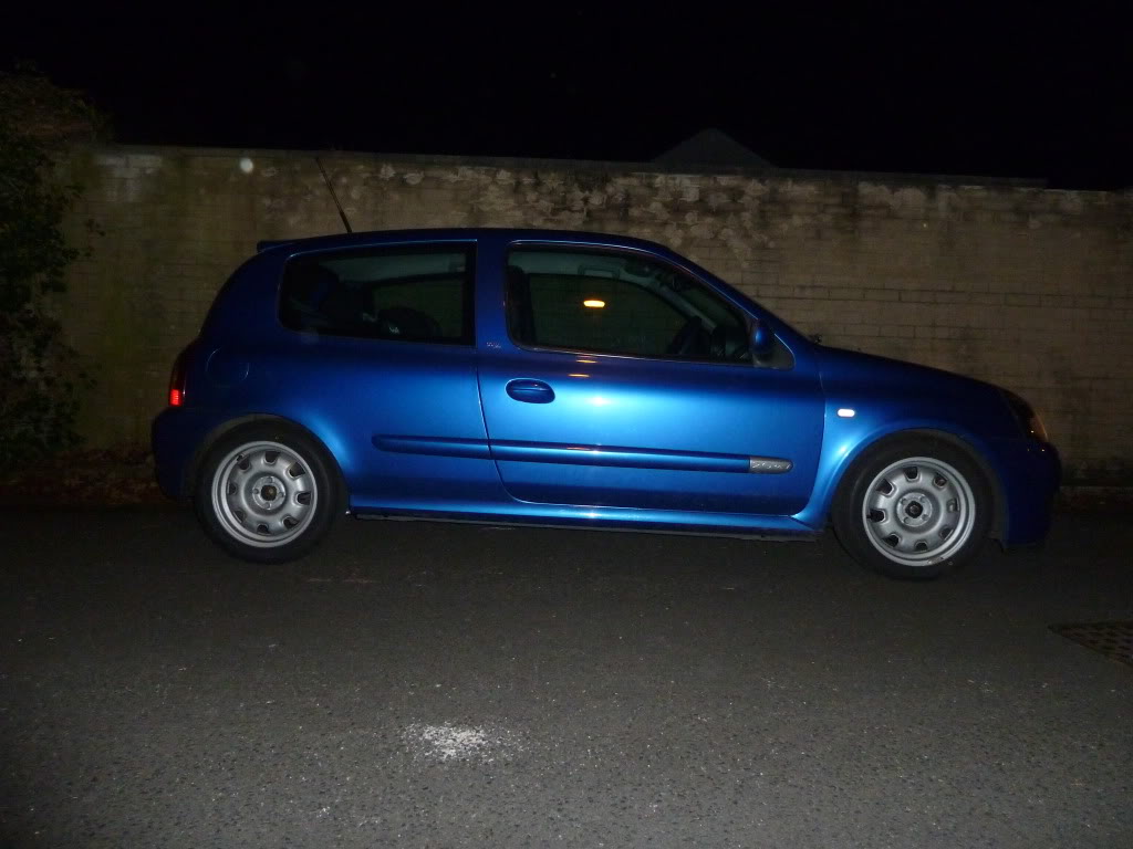

  535d / t5 caravelle
its more nose down than that now, that was before the geo set up, think that pic was about level ( or ment to be )
