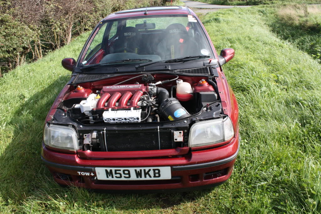

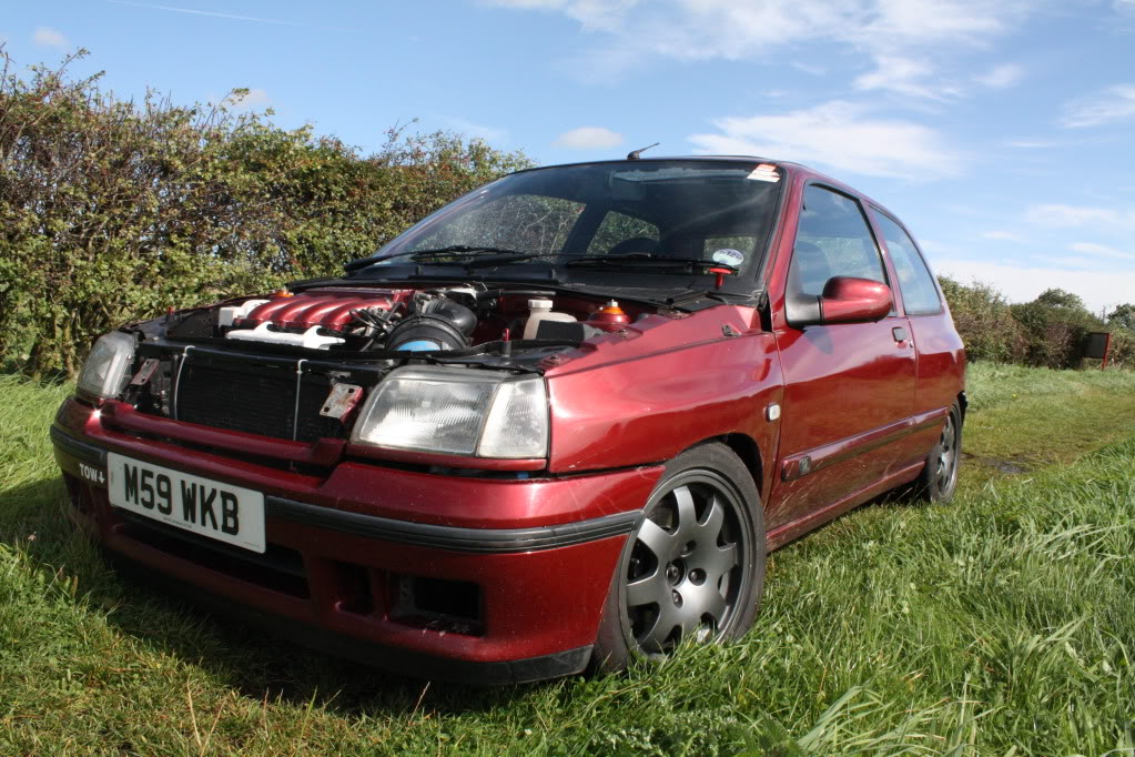

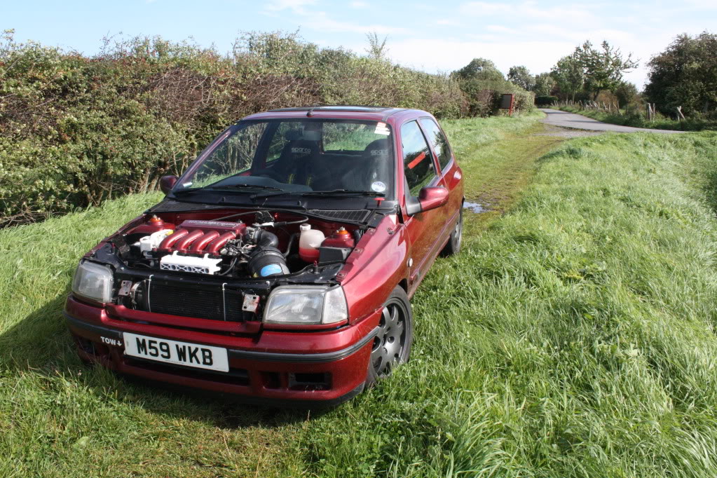

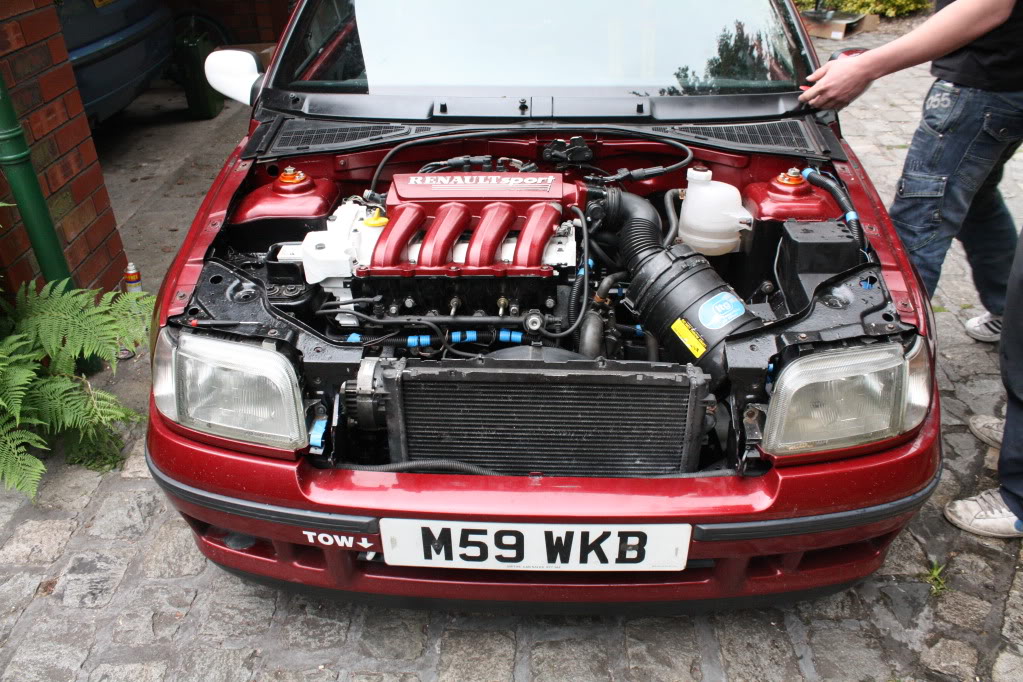

We're getting close... Idle issue now sorted and revs up nice. All the lights/electrics work as do all the 172 clocks...
After filling the coolant with water and finding an inch round hole in the radiator Adam had bought we fitted my spare, bled it through with water again to check. All fine with no leaks so drained the system then filled with coolant and everything is good. No leaks anywhere!
Took a while to figure out the high idle (2.5k+) and trying all sorts of sensors/parts from my engine, then thinking it was a vacuum leak. Turns out it was the throttle body grub stop screw had been messed around with (Well, its a Laguna F4R throttle body as we now know, so the stop might be different on that particular engine), after a lot of fine tuning and making sure the ICV was still good everything went fine - now idles fine!

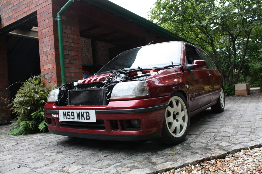

As you can see the car is now running but its taken some effort getting it to this stage, had the cambelt and rocker cover off three times to figure out were an oil leak was coming from and it was a dodgy factor seal, so the solution was to buy genuine ones £25 from renault. Ill be doing a proper updade in a soon when ive got more time and a pc that works

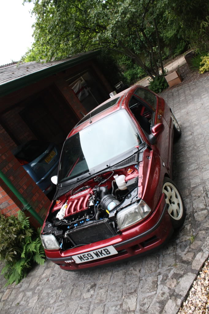

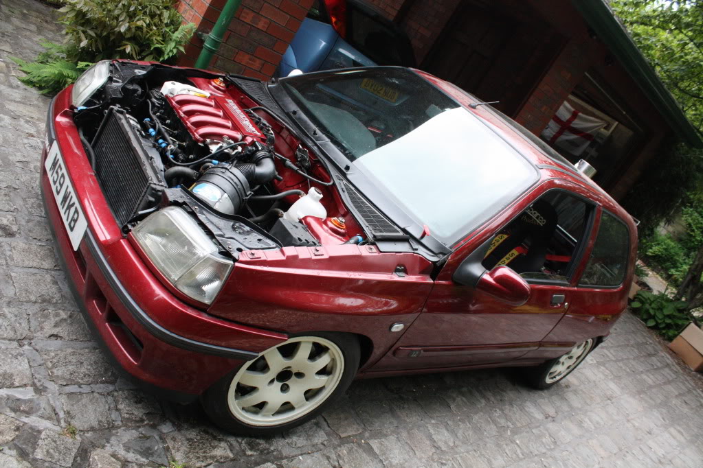

Few pics of how it was lastnight

The dodgy idle issue turned out to be.. the wrong throttle body that was off a laguna and a bad idle contrle valve both have now been replaced and is fine.
Anther problem then arises leaking oil frm the cambelt, didnt know if it was the dephaser pully or the end cam seals as they were cheep GT ones out of the head gasket kit. Borrowed jords spare dephaser pully and timed it all back up, it was still leaking oil so went to renault for the new seals £25, cambelt off rocker cover was striped down everything sealed back up with the new cam seals in all timed back up and... it works fine no leaks at all.

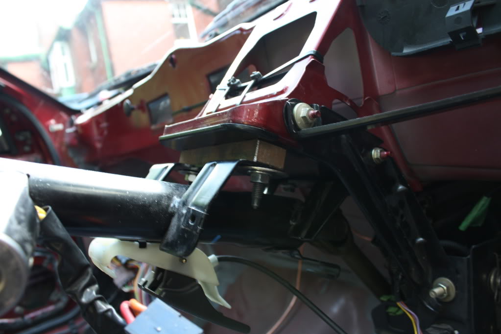

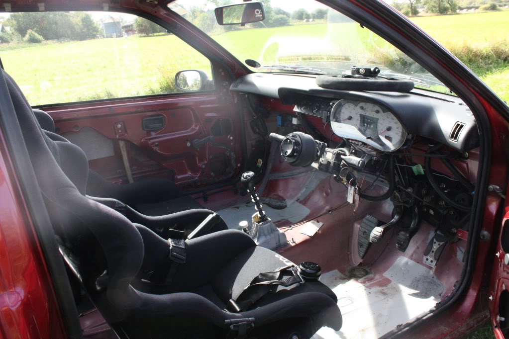

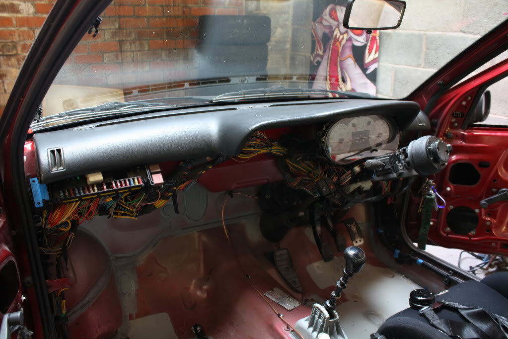

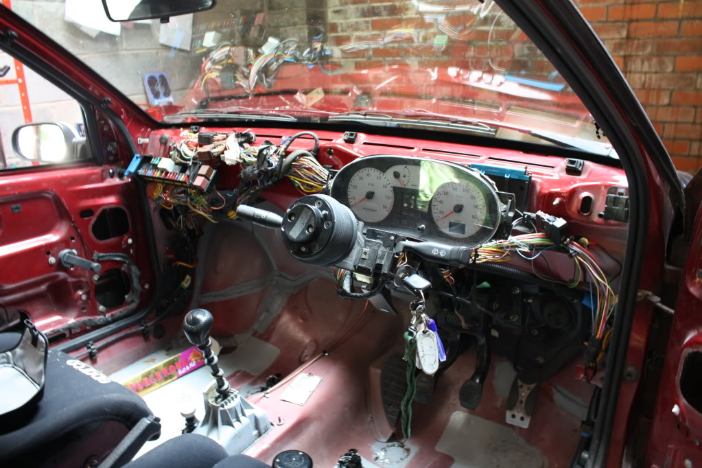

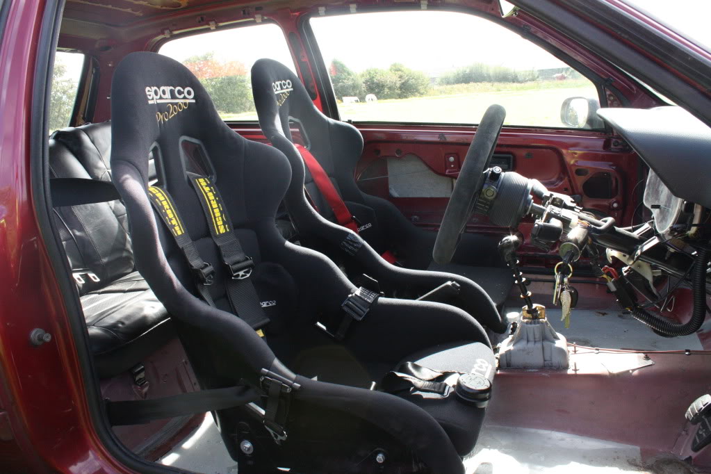

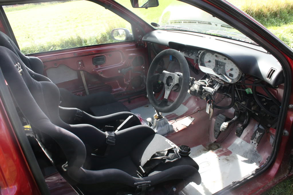

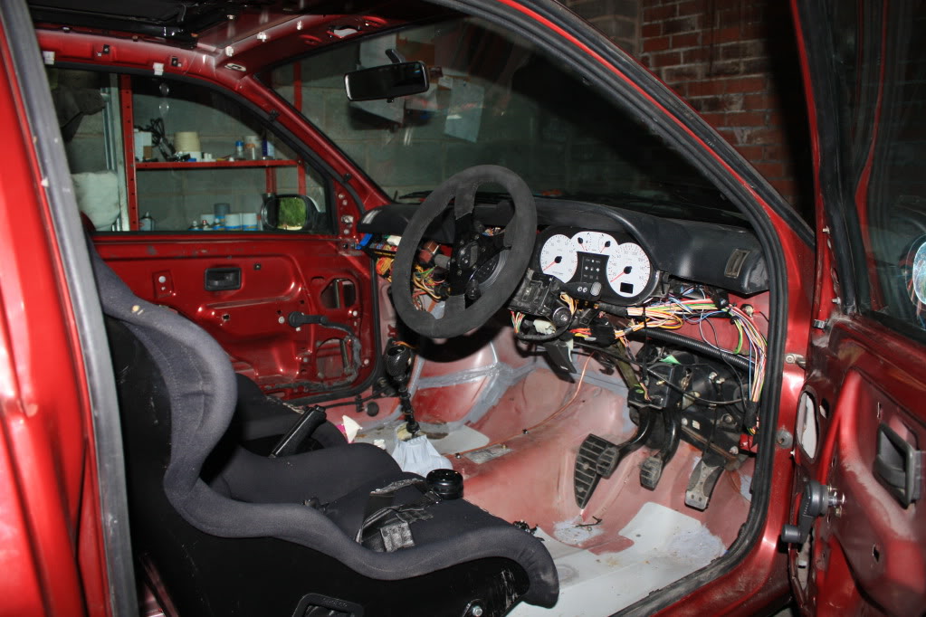

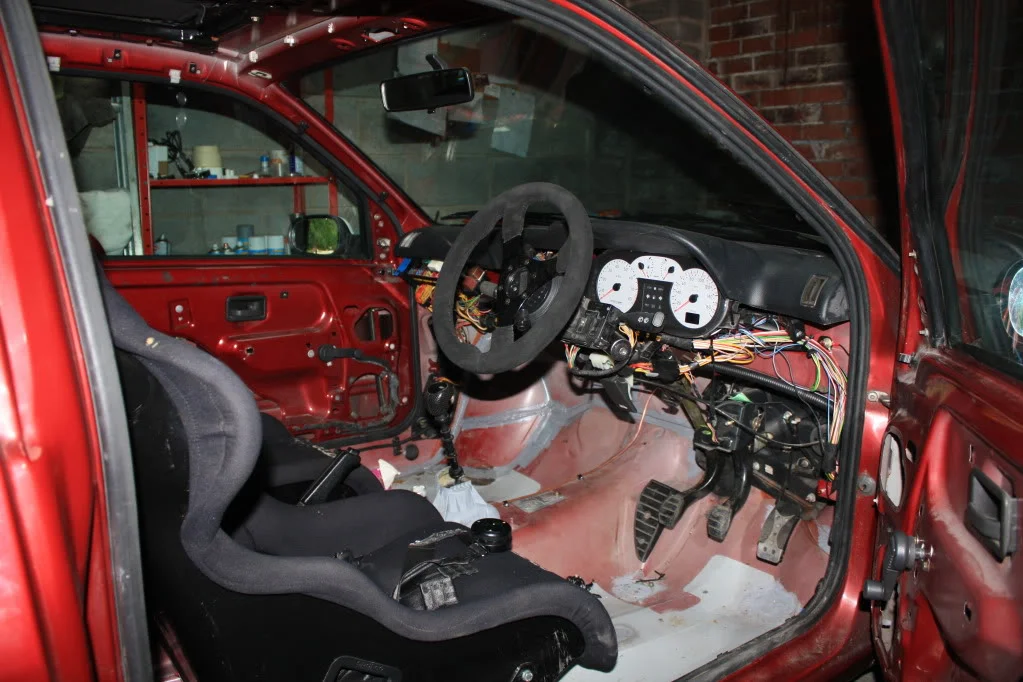

Id been driving the car round with a pillow under my seat as i couldnt see over the steering wheel so set about lowering the steering column

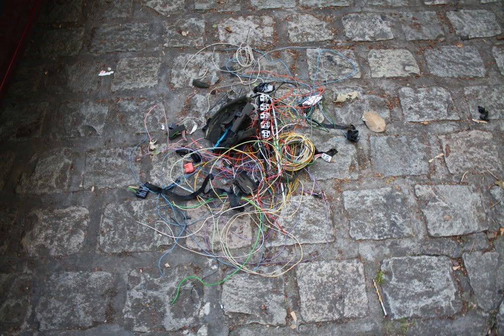

How it looked and all the wires in a compleat mess

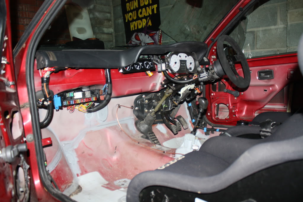

got a peice of bar cut and drilled in the right places, cut the old threads off with the grinder as they wasnt long enough and then drilled through the top all fitted together with 2 new bolts big washers and nuts
as the wiring was out i did abit more trimming and wraping in conduit
what i took out
Everything back in place, also relocated the fusebox
The driving position nw feels sooo much better :D

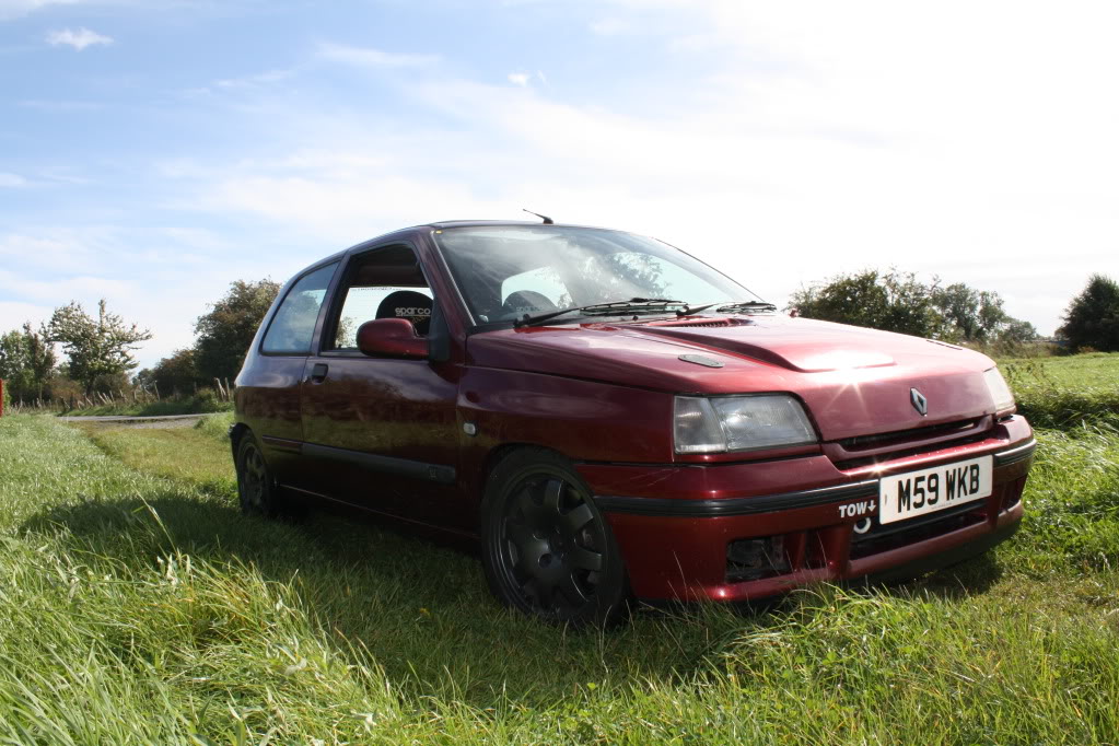

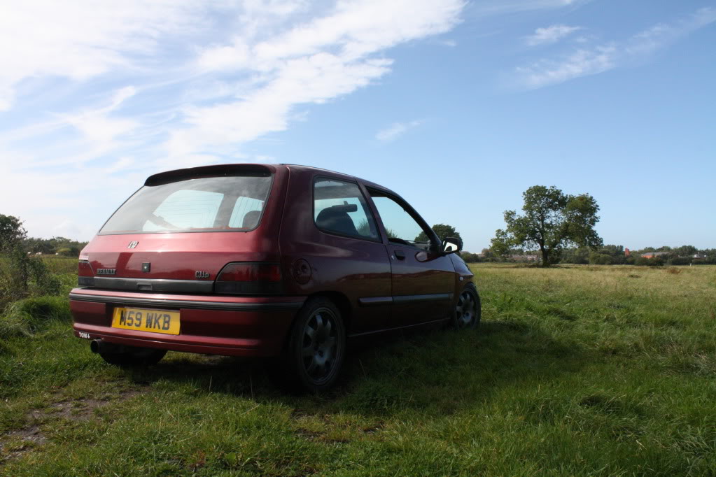

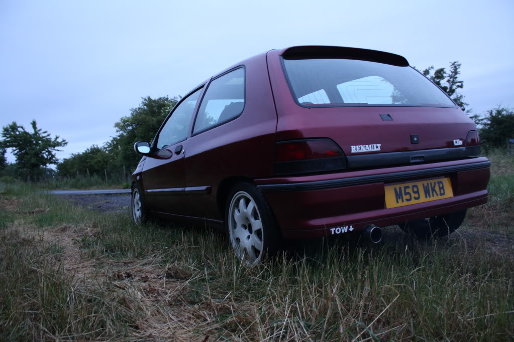

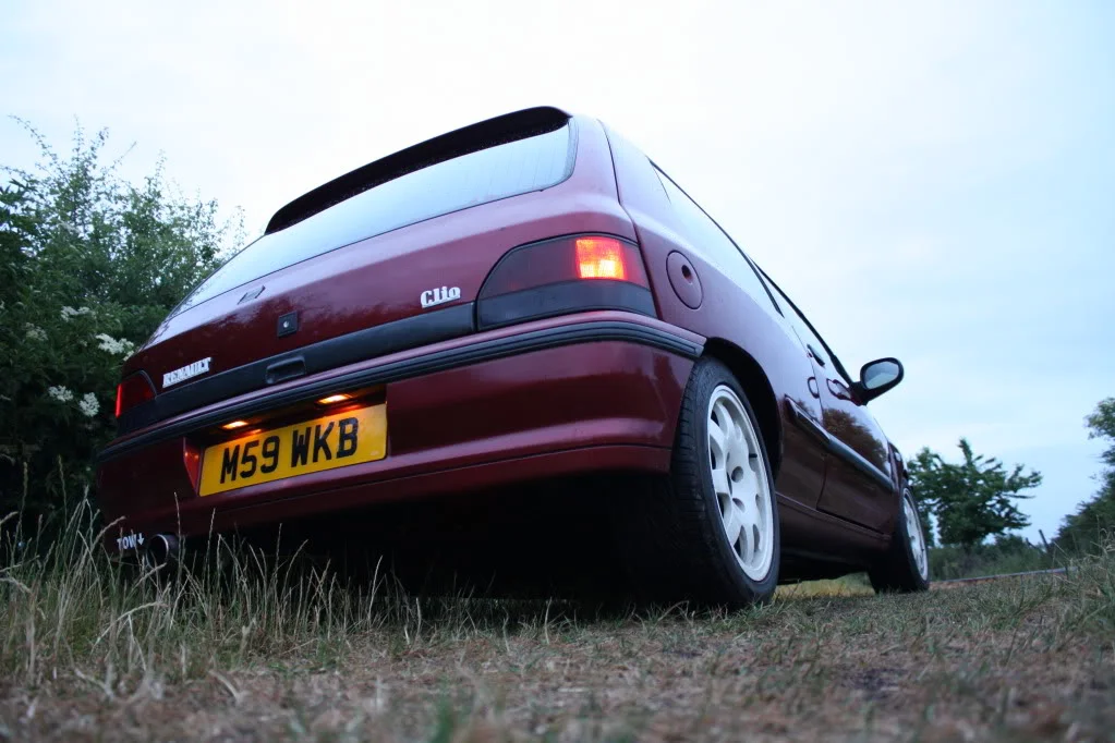

Just a few pics of the car on its first outing

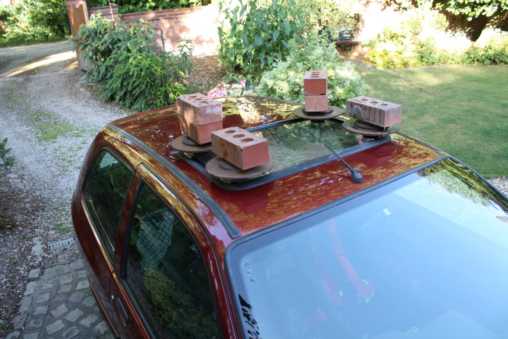

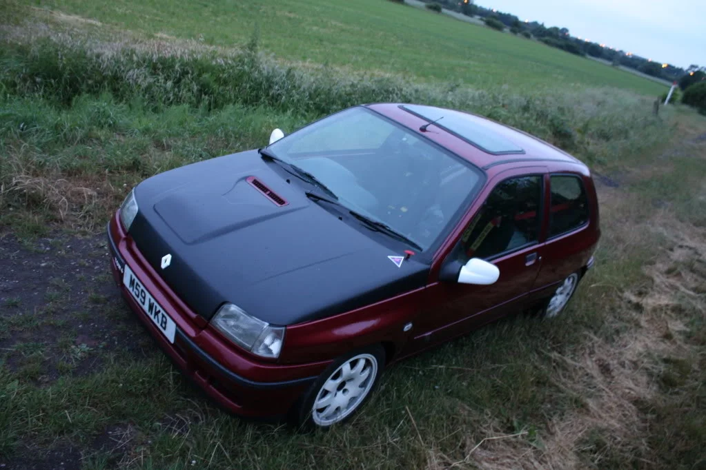

The sunroof has now been polycarbed and tigersealed in, found a big piece of 6mm polycarb when i was sleding so put it in the car and took it home looked like really good stuff. Few scratches in it but meh :cool:

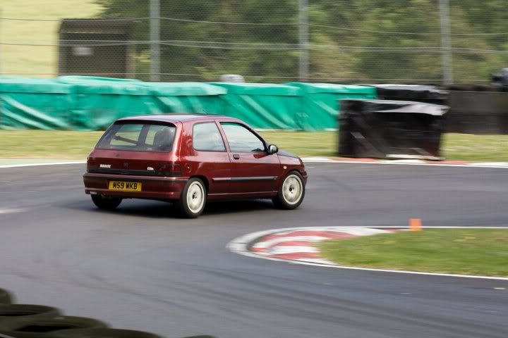

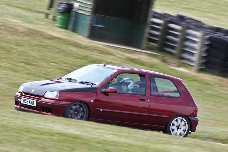

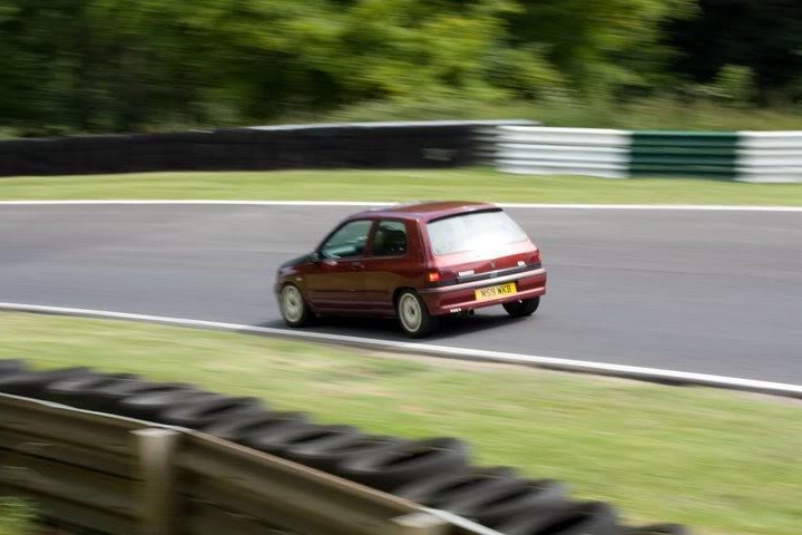

The first trackday was at cadwell park 7th july, quite a few of us from cs went for rileys bday. What a fun 2 days it was, the car was fantastic over the 2 days with no major problems (the cars firts proper drive out, lincoln , trackday then home so put a fair few miles on it in 2 days) only thing that was mysterious was an oil leak coming from just under the manifold were the head meets the bottom end only noticed it as there was oil up the back of the bulkhead, it was drippeng onto the driveshafts and being flung round the bay, i thought it could be the head gasket as it wasnt a renault one, i had just had problems with other items not being genuine. Dont really know wot the problem with this was but its now fine and hasnt leaked since, bit strange if you ask me, ill be taking it apart over winter as i think the piston rings are on the way out (sometimes it smokes really bad and then other times its fine) anyway will find out soon.
The cadwell track is one of the best ive driven on, in the morning i was running the toyo s4 tyre and the car handle preity well
In the afternoon i thought i would put the r888 on the front to see wot there were like as ive never driven on them before and omg wot a difference it makes it was so good, dont really want to do another trackday without them :rasp:

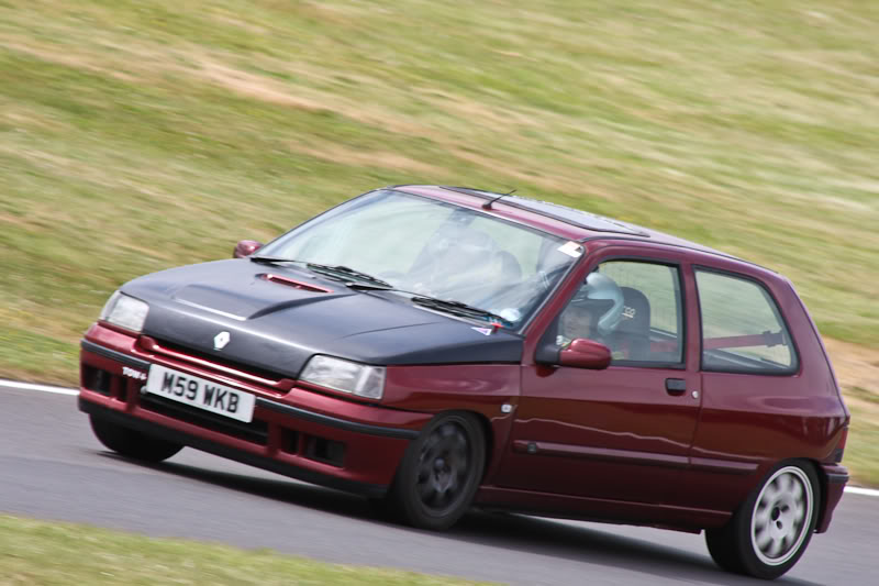

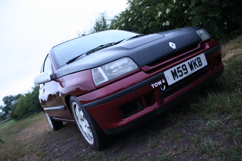

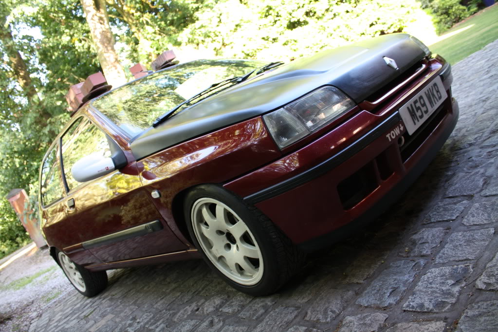

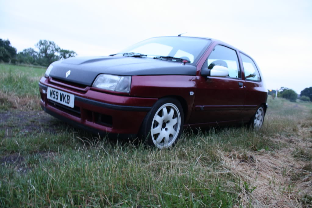

Since cadwell the car has changed quite abit, the naples red bonnet has now gone back on with aero catches fitted
the white williams wheels have been painted gray as i thought it looked to girly for a track car

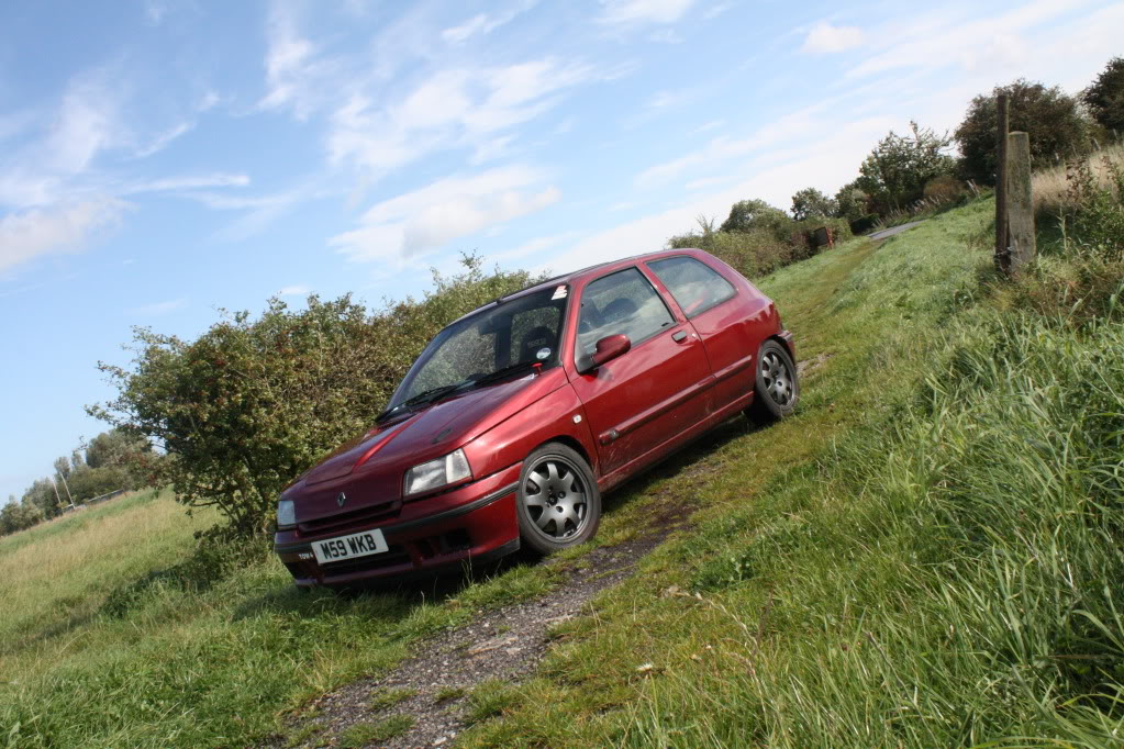

Got a little giddy with the camera :)
