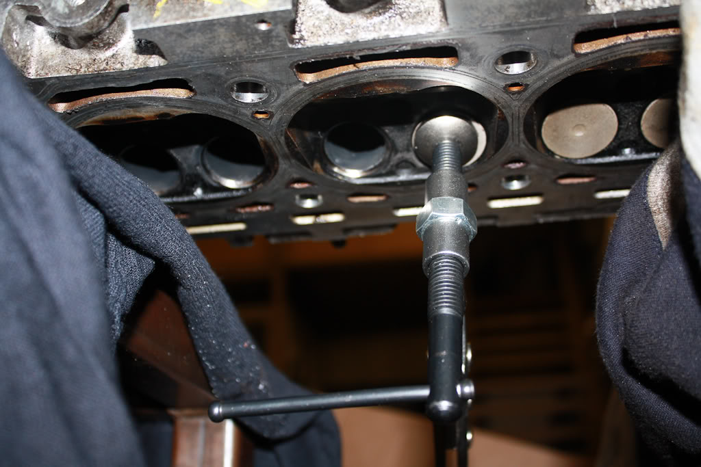

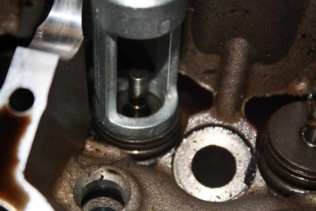

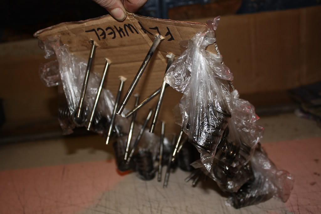

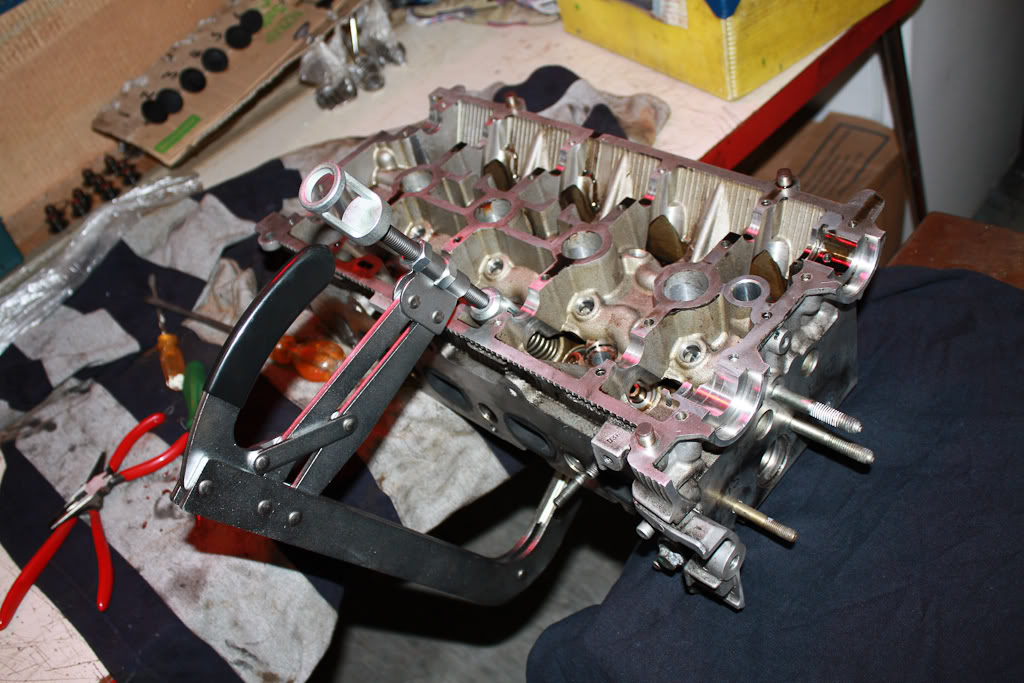

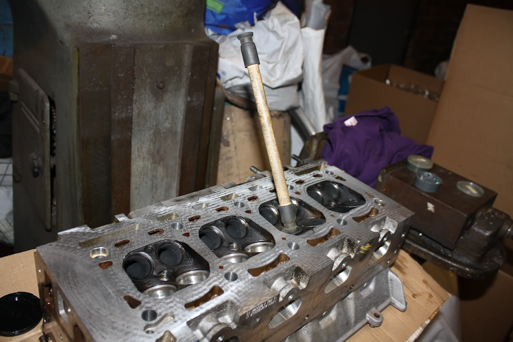

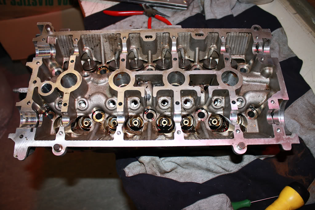

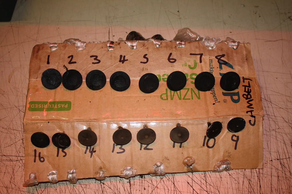

Got a peice of card and numbered it 1-16, then got cracking on taking the valves out, never done this before but once told how to do it i was away
first 8 out with no problems
The tool in use
Took me about 2hrs to get all of them out, the trickiest bit is getting the collets from off the valve stem had to use a magnetic screwdriver and then try and not let it fall inside the cylinder head
Full set

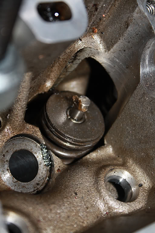

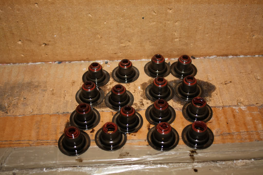

the old valve stem seals

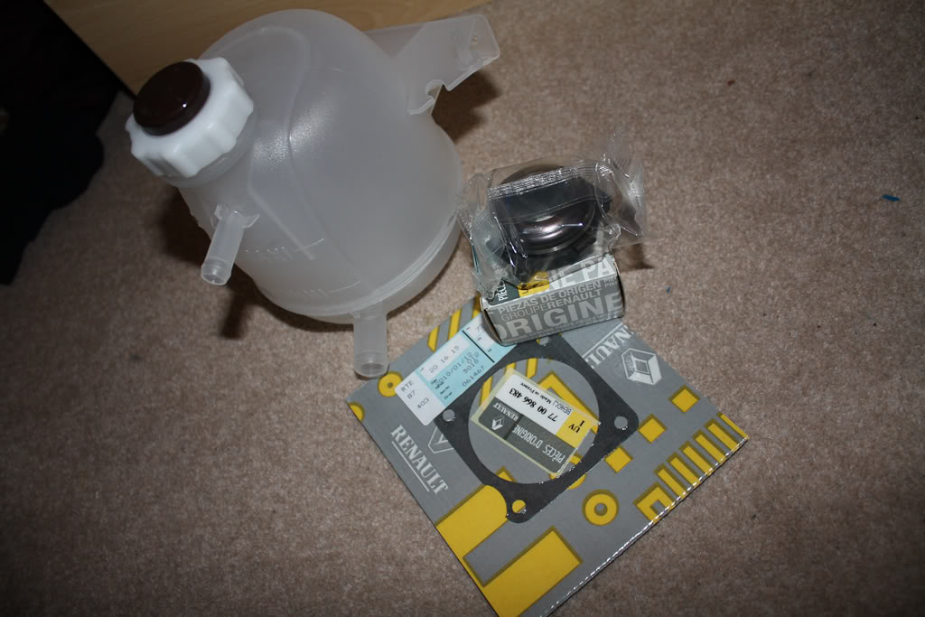

Picked up a few items fron renault
header tank, Release baring, Inket gasket

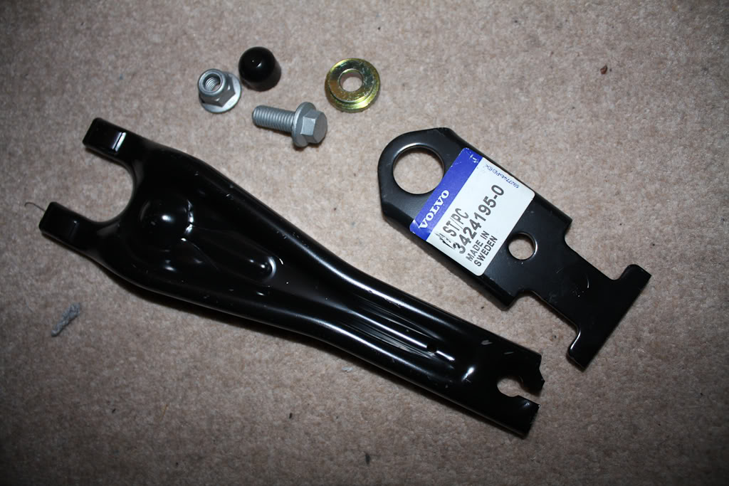

Also picket a few parts up from Volvo for the soft pedal conversion
Fork, Bracket, Nylon Cap, Brass Bush, Flange Lock Nut, Flange Bolt all comes to just under £30

how much was the header tank and the gasket if you don't mind me asking
Header Tank (Comes with Cap) - 7701 470 460 - £28.25 + VAT
Throttle Body Gasket - [Cant Remember Part Number] - £2.00 + VAT
Normal prices...if you're looking to order a few things PM BRUN on here, he will sort you out (Works @ Renault Parts).

Header Tank (Comes with Cap) - R77 01 470 460 - £28.25 + VAT
Throttle Body Gasket - R77 00 866 483 - £2.00 + VAT
Clutch bearing - R77 00 102 781 - £15.23 + VAT
Ive changed them to the right codes. Total price inc VAT came too £50.60

Those stem seals - did you damage them on removal? Some of em look fooked! Worthwhile job though. Well done for taking the time.
  Mk1 F4R
Good work. Real project threads are a little thin on the ground at the mo.
Real project thread. Awesome thanks, never thought id hear that one
I had to take my time i was bloody clueless as wot to do at first lol
yes damaged some on removal
At firt i was using long nose pliers to get them out and as you can see from the pic the rubber jusk kept snapping (the first few on the right of the pic). I then found a better way of getting them out, little screw driver... carefully put it under the rubber and you will feel the metal on the stem seal then carefully pull up and it should come out in one piece

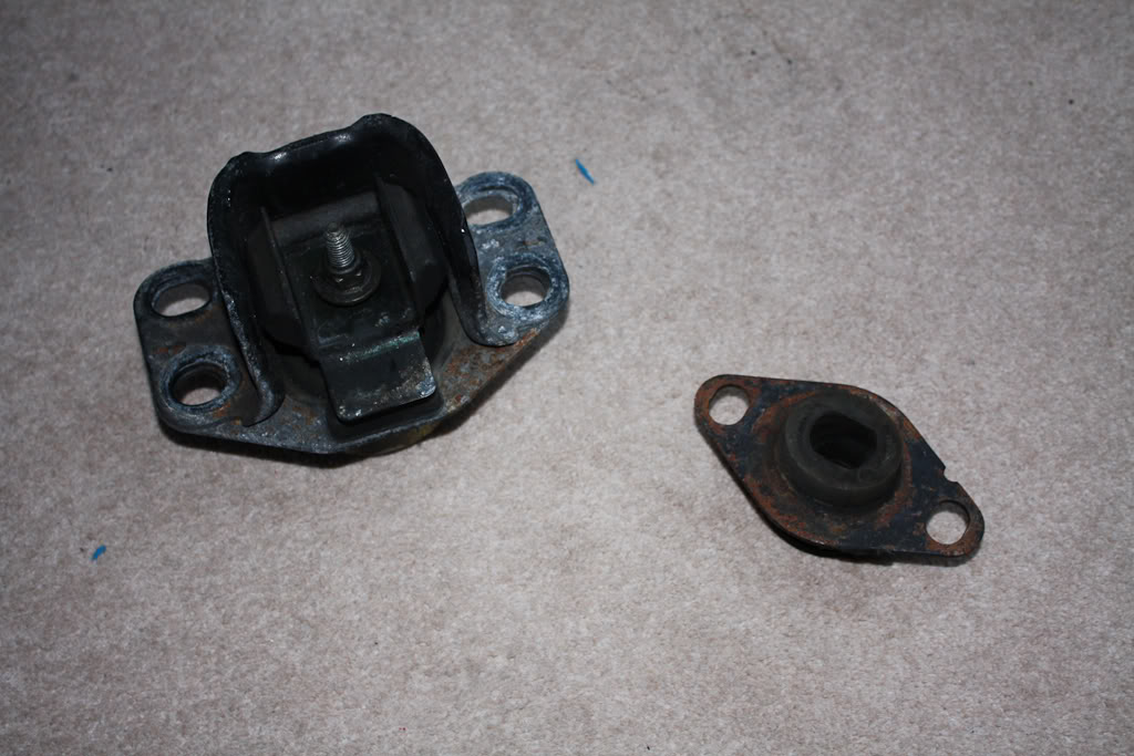

Big thanks to gray for the 172 engine mount + gear box one too

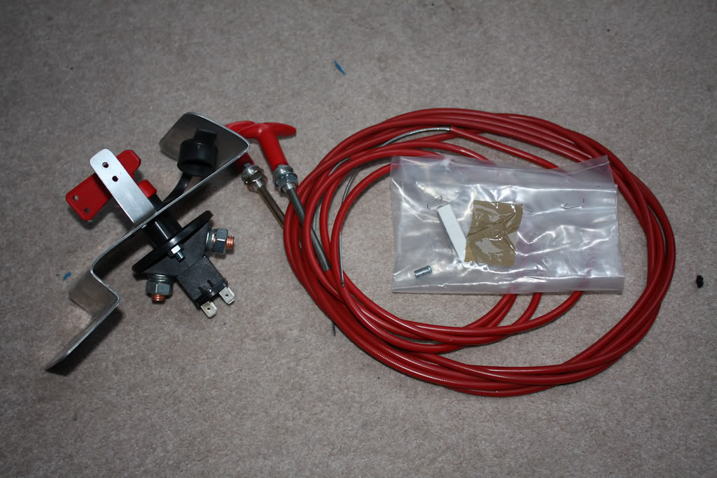

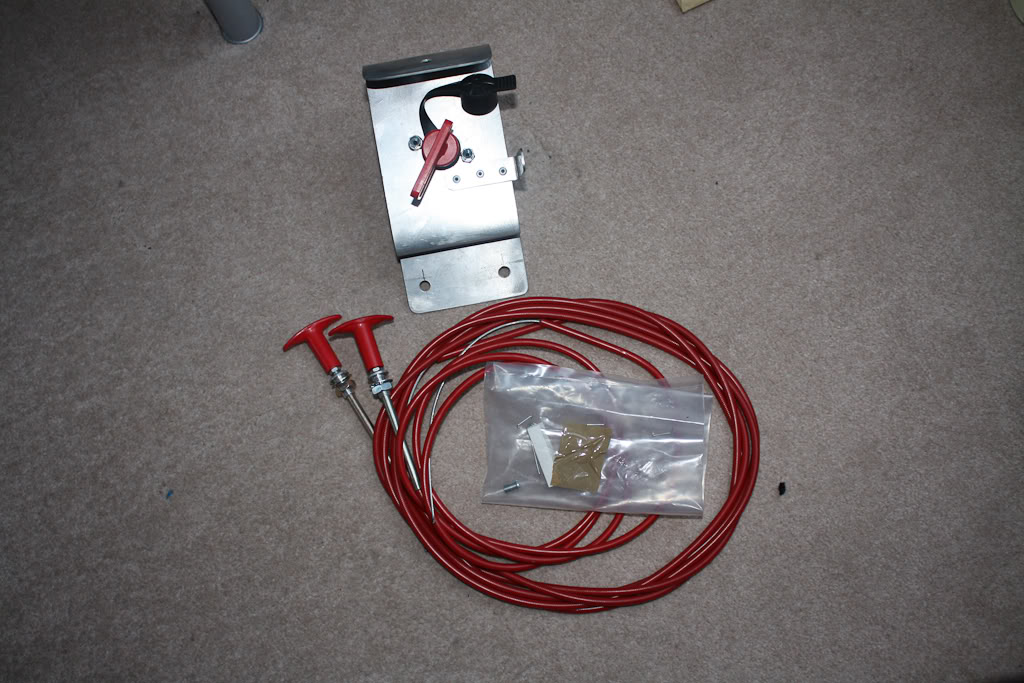

also thanks to arj156 off cw. Batter cut off switch with 2 pull cables will look good when it's in and also serve a purpose

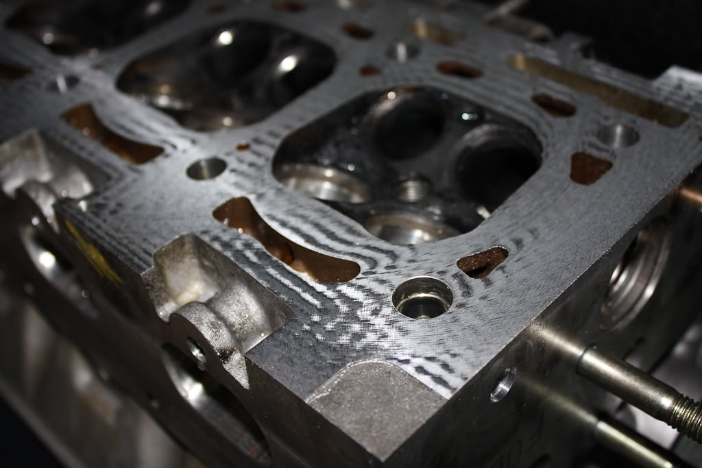

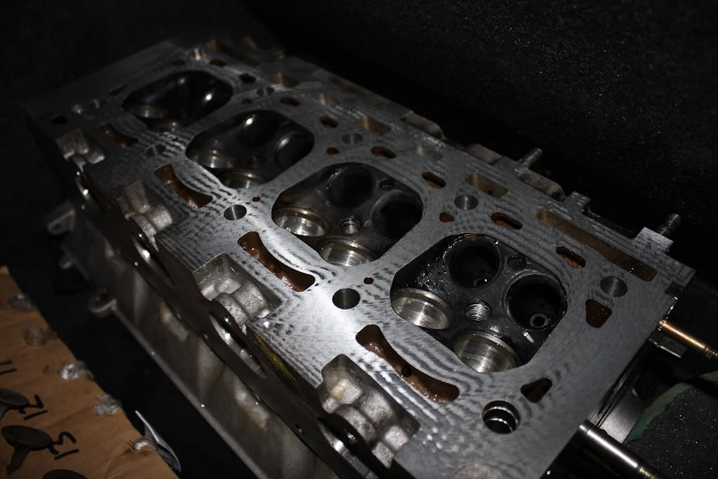

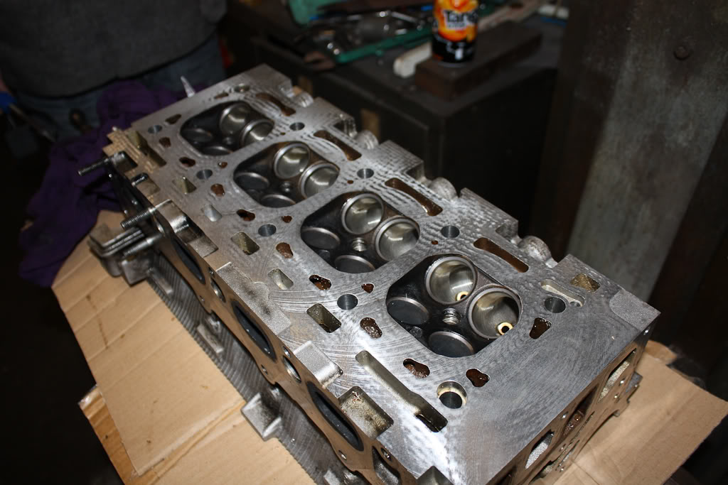

Took the head to be skimmed at Roant engineering lastnight (Warrington), took the head in and the guy said, we are quite busy so itll be a few days, i said no probs not in any rush for it left at 16.45. Decided to got to my my mates in warrington and at 17.30 i get a call from a 01925 number and i was thinking who could this be, turns out it was roant would you like to pick the head up tonight as its just been done, turned up at 17.50 and it was looking good.
Cost was £25 it was also washed to get rid of all the swarf in unwanted places

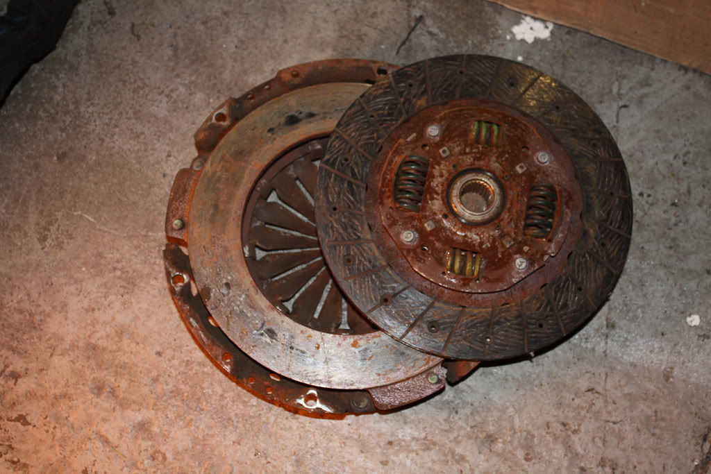

Clutch

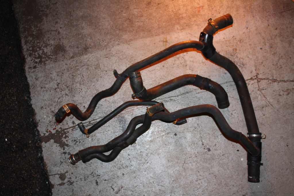

Engine pipes

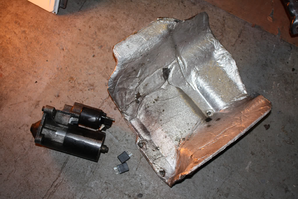

172 Starter motor + Heat shield

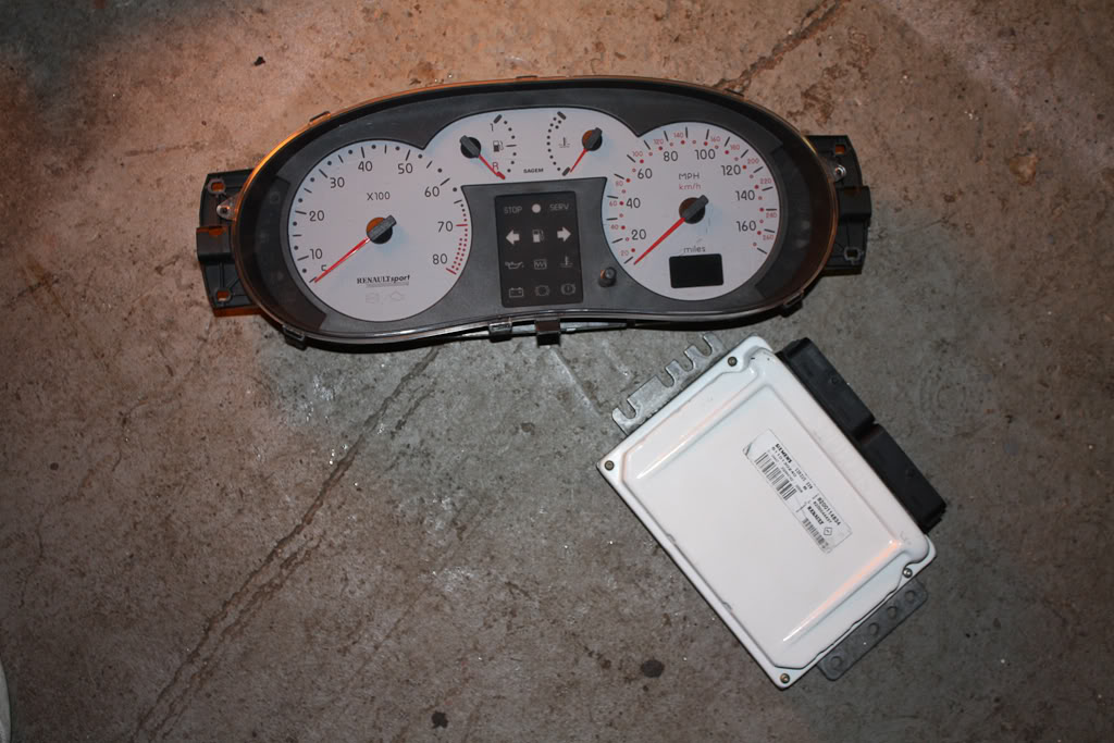

172 Clocks + ECU

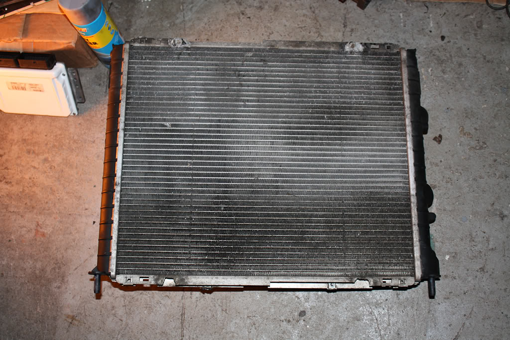

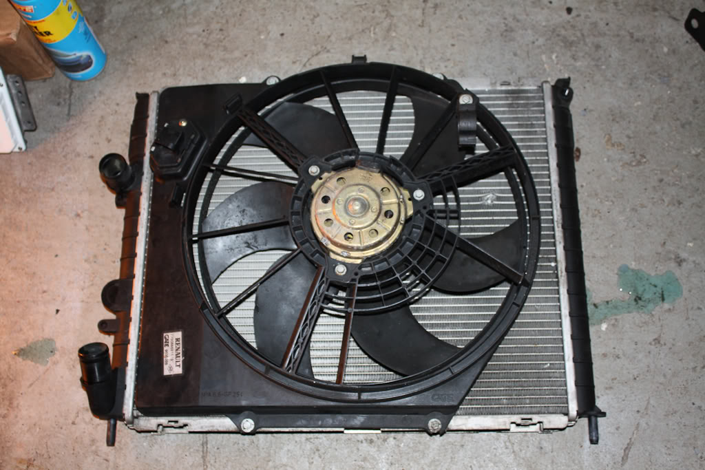

172 Rad
172 fan

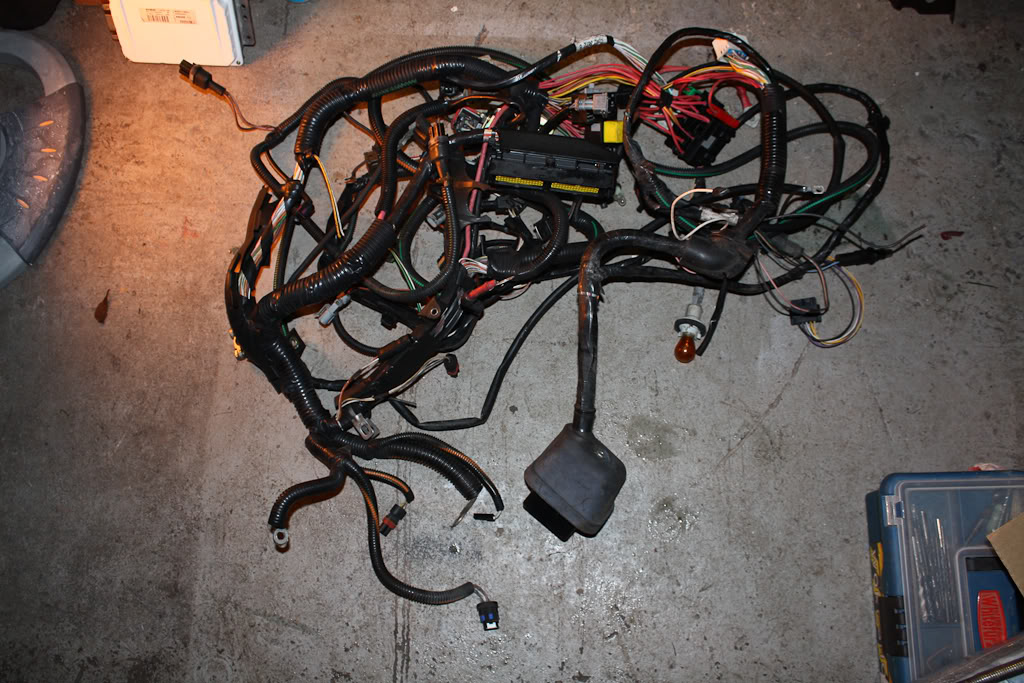

Last but not least 172 engine loom (now ive got to cut it up to fit bring on the good times lol :S)

engine pipes LOL, hoses*

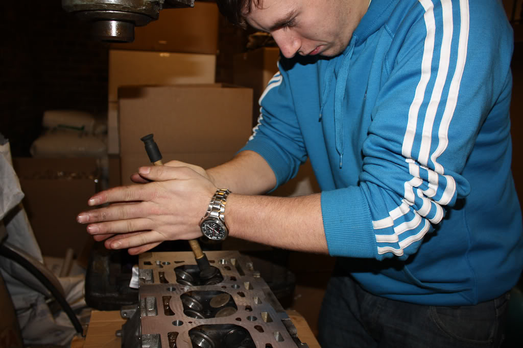

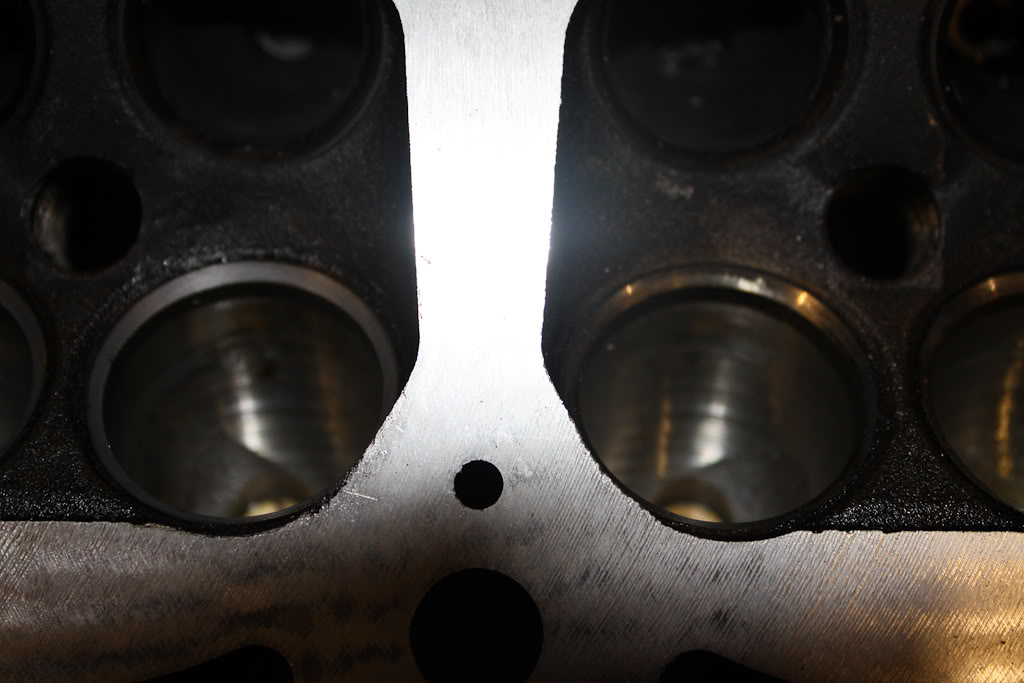

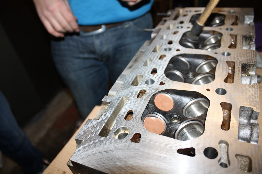

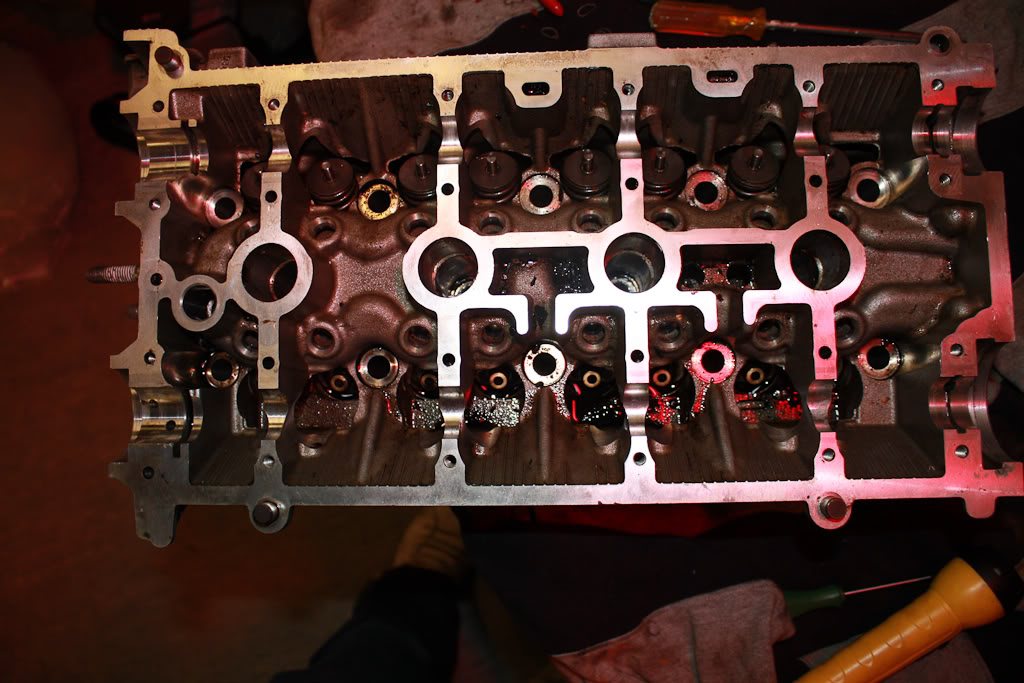

Last night took the head down to the factory to get some work done on it (laped the valves in) so its ready to put the valves back in

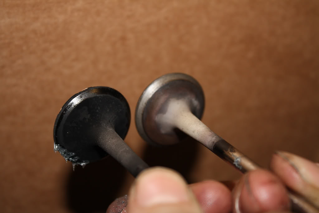

first two done, you can see that the one on the left has been done should go a gray colour when done and that is now a perfect match to the valve
If there is a gray ring around the seat of the valve and its in the middle of the valve seat, you've got a good seal. The one on the right has been done, not a very good pic and it's a exhaust valve too so its covered in carbon
First 4 done and looking good
The grinding stick was used by rubbing my hands backwards and then forwards to grind the past that was put on

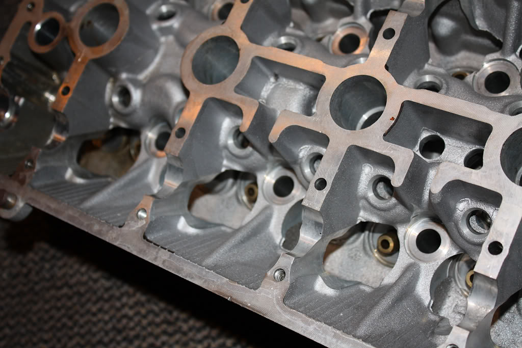

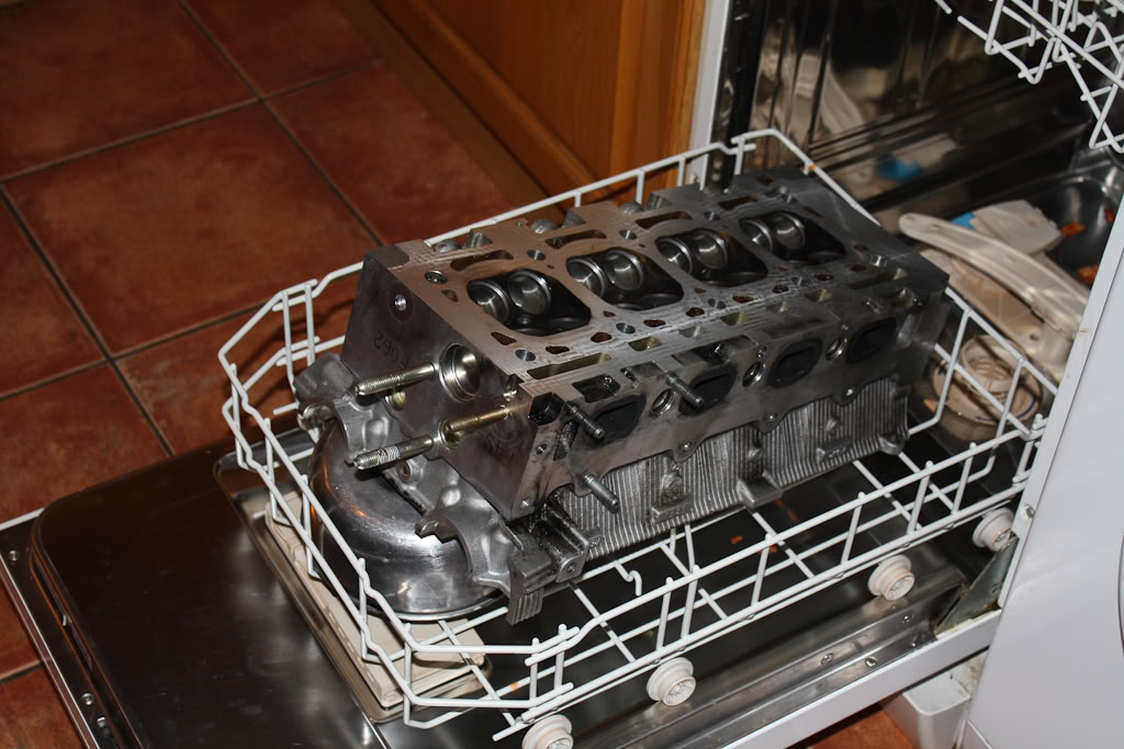

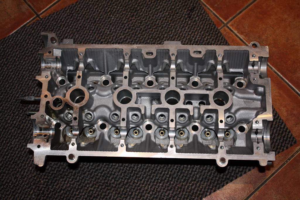

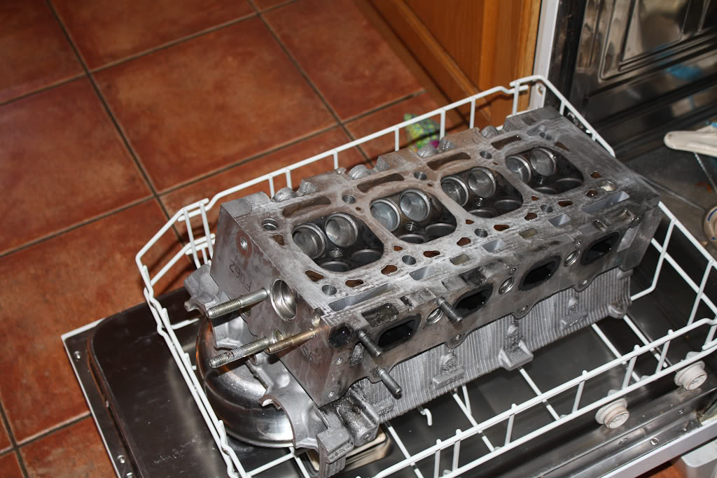

All 16 done and now ready for a wash to get rid of any unwanted grinding past and swarf from when it was skimmed

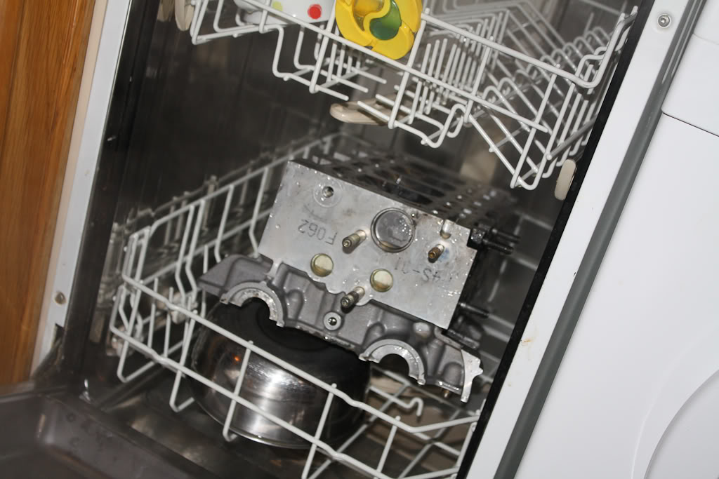

This is how we washed it ill let the pics do the talking, came out amazing i was well shocked when it came out
All thanks to finish (the diamond standard) and to jord for letting me use his dishwasher

great work, looks very clean thanks to that powerball.

LOL, awesome dishwasher work!
If I even brought an engine component in the house my Mum would go mental hahaha!!!!!
  Mk1 F4R
Thats why you have to do it when ther are out lol ;)
I feel sorry for them mugs :(
Yep we forgot about those
surely the salt and the dishwasher tablet wont do the ali much good
will it ??
Will be giving it a final wash just to m ake sure nothing is still on it
