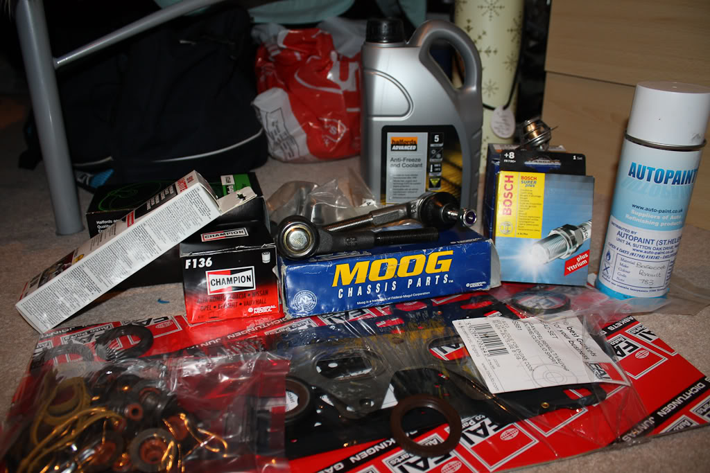

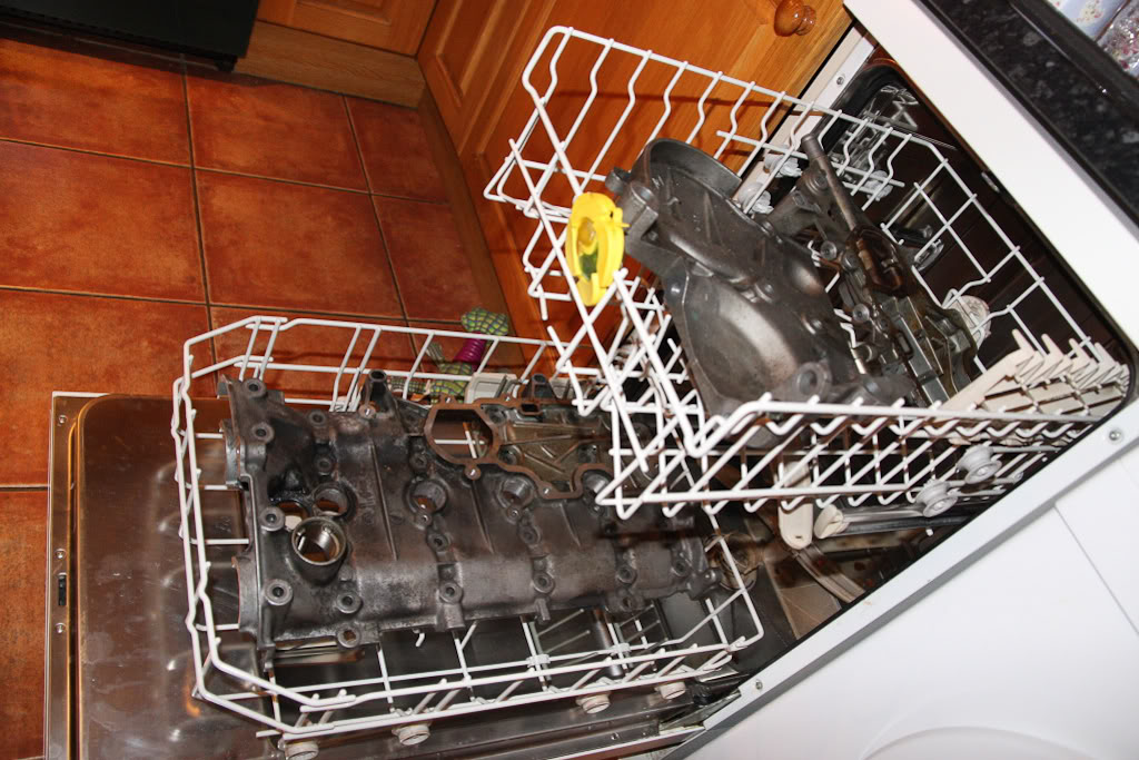

Few more items for the dishwasher
I also went on a spending spree yesterday
172 gasket kit
Bosh spark plugs
Champion oil filter
Halfords fuel filter
Halfords advanced coolant
2 williams trackrod ends
2 172 ball joints
172 Thermostat switch
Naples red paint
Loctitite black silicone
Also got quite a few items from ryan k
  '92 172, Lotus Elise

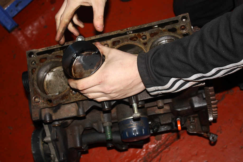

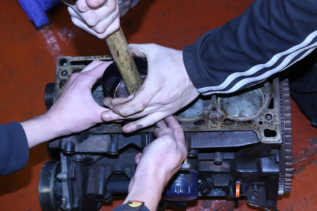

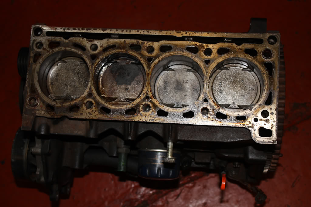

Took the engine down to ryan k so we could put the piston in the bottom end (couldnt be bothered to buy the tool) and needed to go down to buy some stuff off him
knocked it in with a hammer

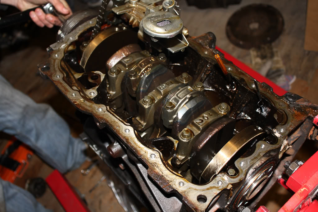

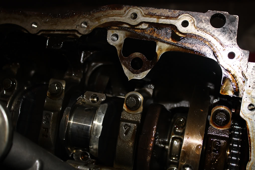

Got some more done on the engine lastnight

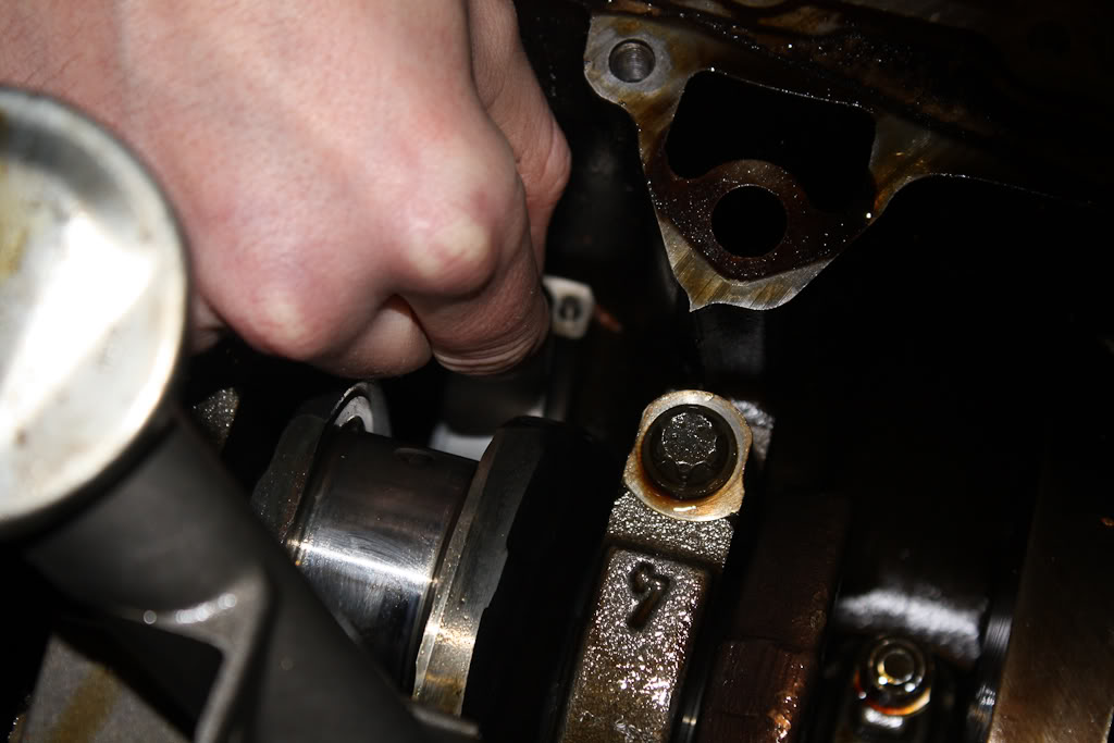

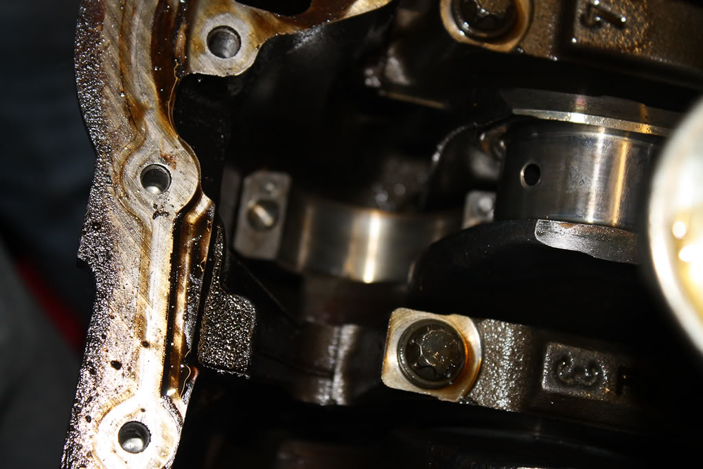

We took the flywheel off the bottom end so we could put it upon an engine stand, once it was on we turned it over so we could take the sump off. We then took the old piston apart so we could get the big end bearings out to put into the new piston
putting the bearing on
piston pushed up to the crank
We then fitted the big end lower half tapped it down slightly then put the bolts in and it was done, turned over fine

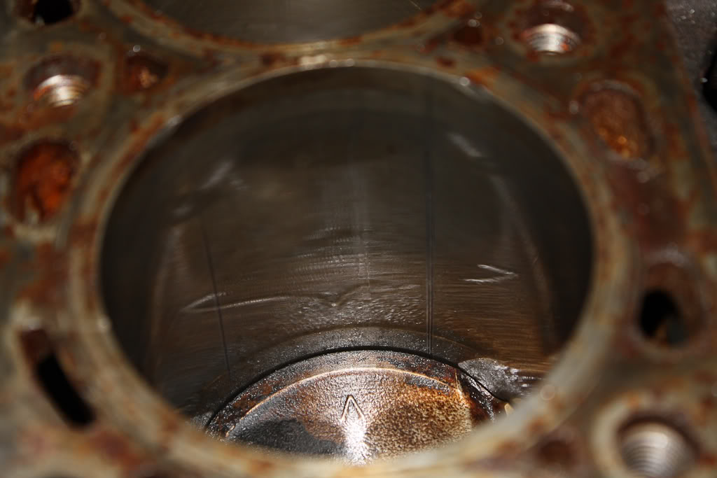

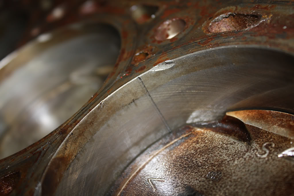

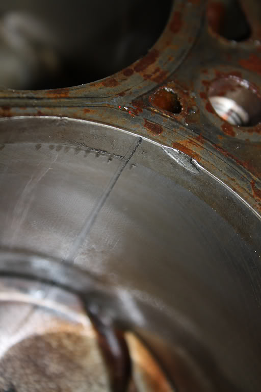

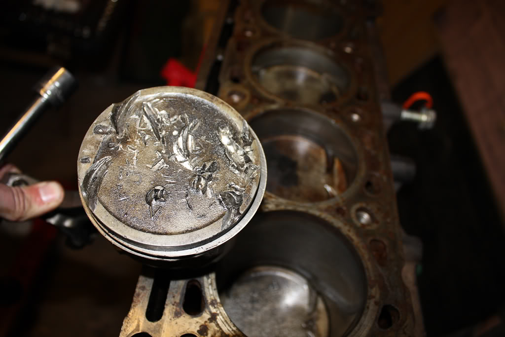

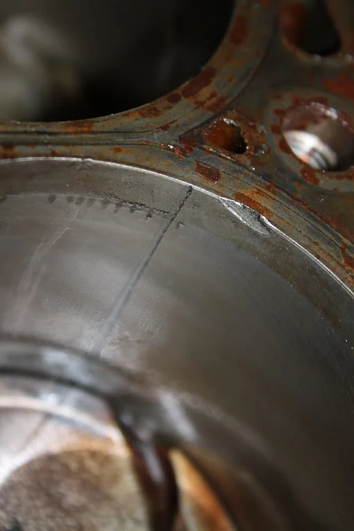

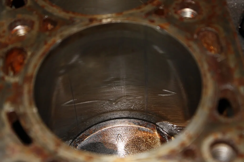

Turned the engine back over to inspect the new piston abit more to then come across this, well annoyed
2 big scores in the cylinder, we have put it down to the old piston
There are a few other mark on it too so we think this is were valves have hit the block.

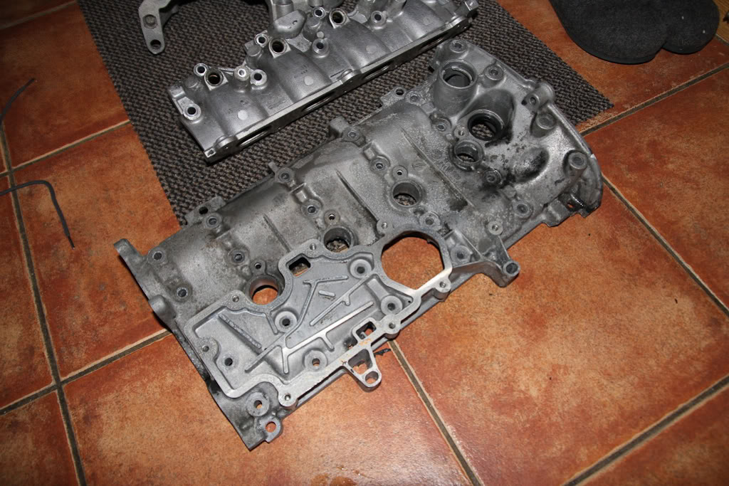

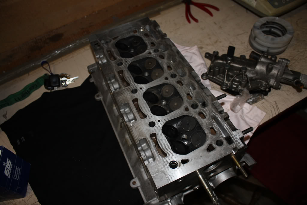

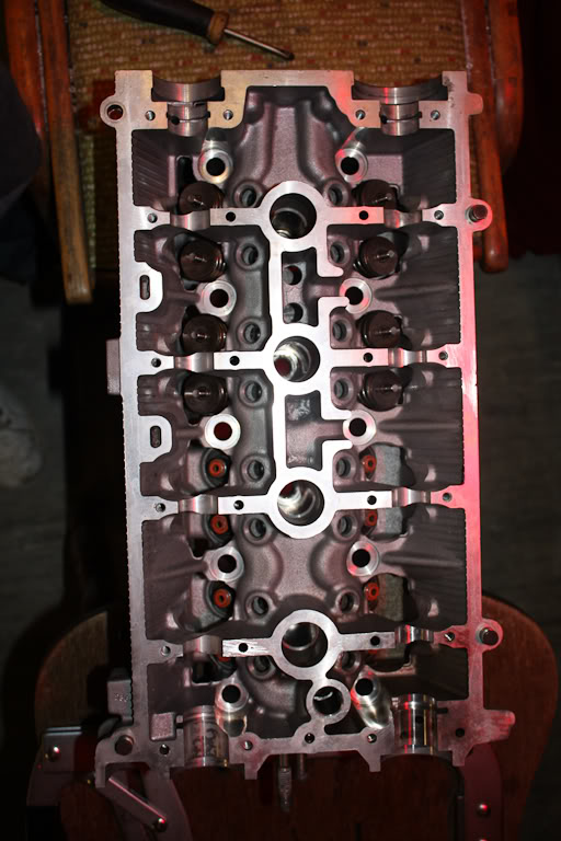

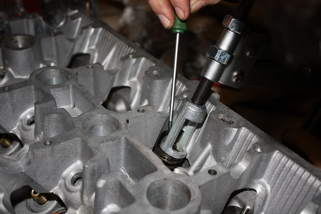

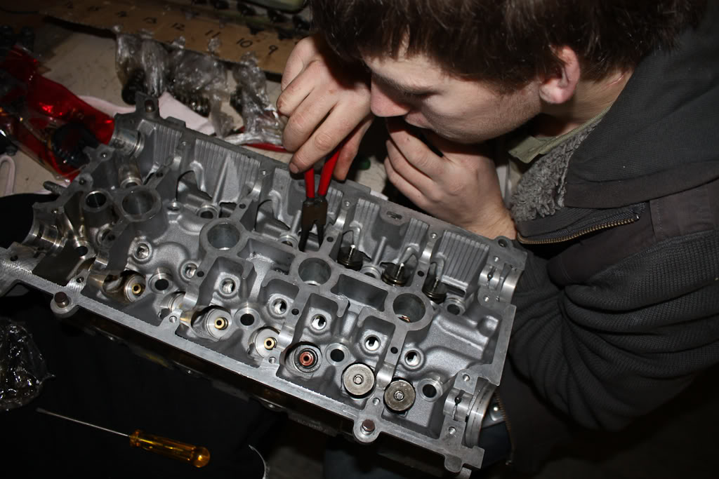

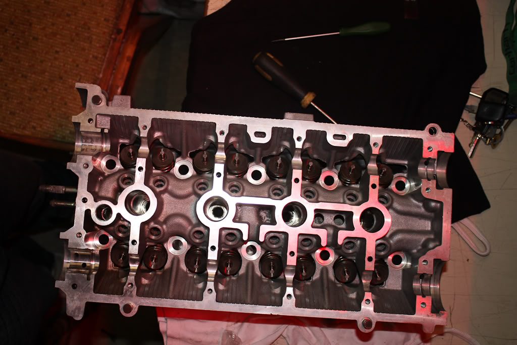

I packed up and then started to put the valves back in the head with new stem seals, wot a tricky task putting the collets back in it is
First 8 done only took an hour
and finally all 16 back in 45 mins later
I am now on the lookout for a bottom end in good condition if you know anyone or have one please let me know asap would be much appreciated

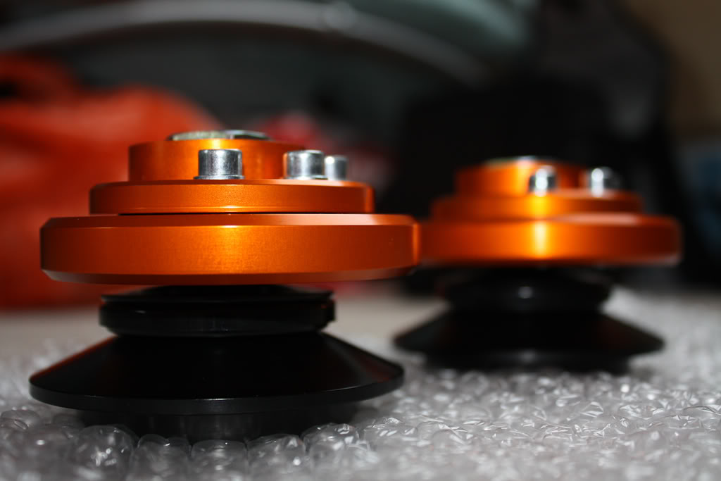

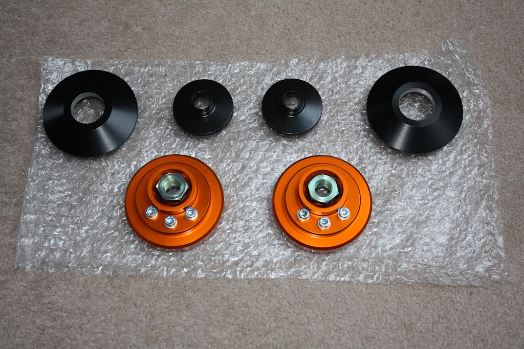

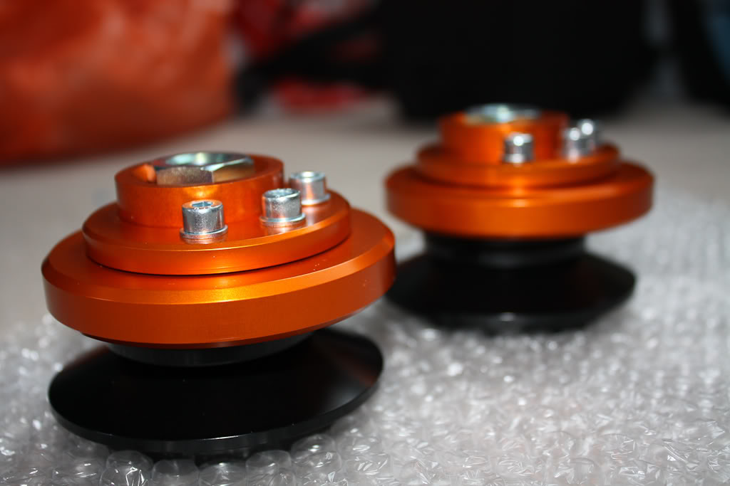

wtf, yours came with the washers... i was told by Kam who contacted AST that they didnt anymore so mine currently dont have any, fail.
They are awesome btw :)
  Mk1 F4R
Well i guess it was pot luck any of us could of got them when they got to kam racing and then straight out in the post prob didnt even open them, im sure it wont cost much for 6 washers ;)

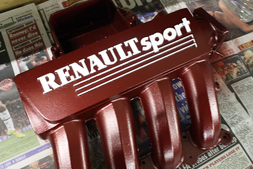

Little update on wots been going on the last few days

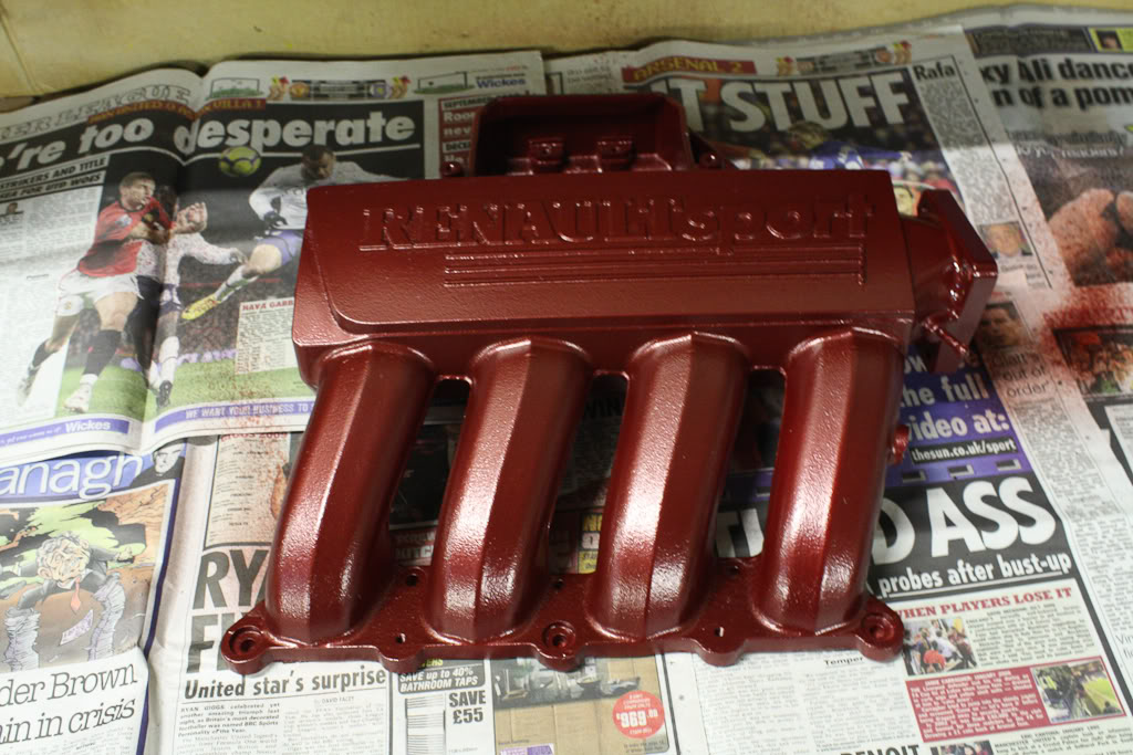

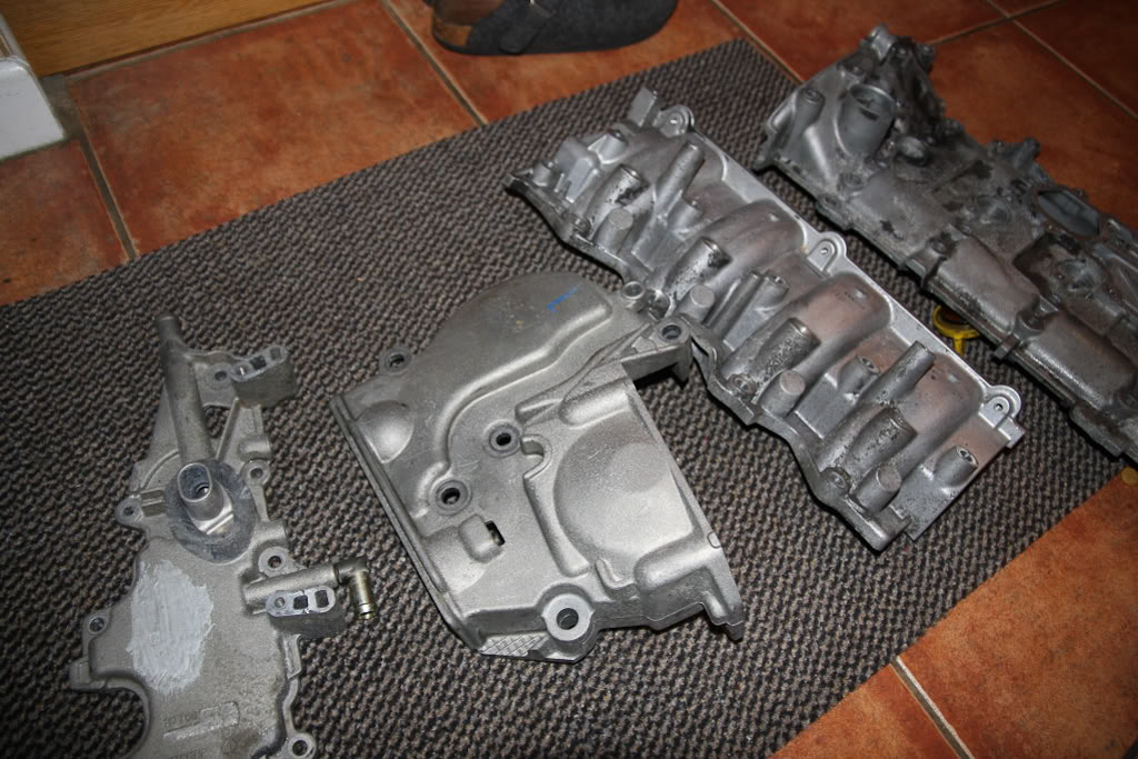

Inlet now looks like this
Ive also been painting the rocker cover, cam cover, fuel rail guard, lower inlet and top mount bracket not got any pics yet, ill be painting the subfame in the next few days ready to go back on the car
  Mk1 F4R
looking good, the writing would look sick polished.
Think ill stay with the naples and white for abit looks good imo
he was telling me last night.. fingers crossed it's a good one, and he isn't asking silly money. let me know if it's a gooden.
yep going to go and have a look at it later, hopefully itll be ok and i can bring it home
That looks really good, how did you end up painting the white bit?
I took my time with a really small paint brush, now its dry im going to tuch it up with naples as the white dripped down the letters abit
