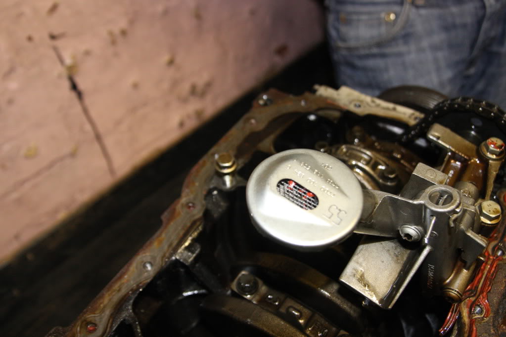

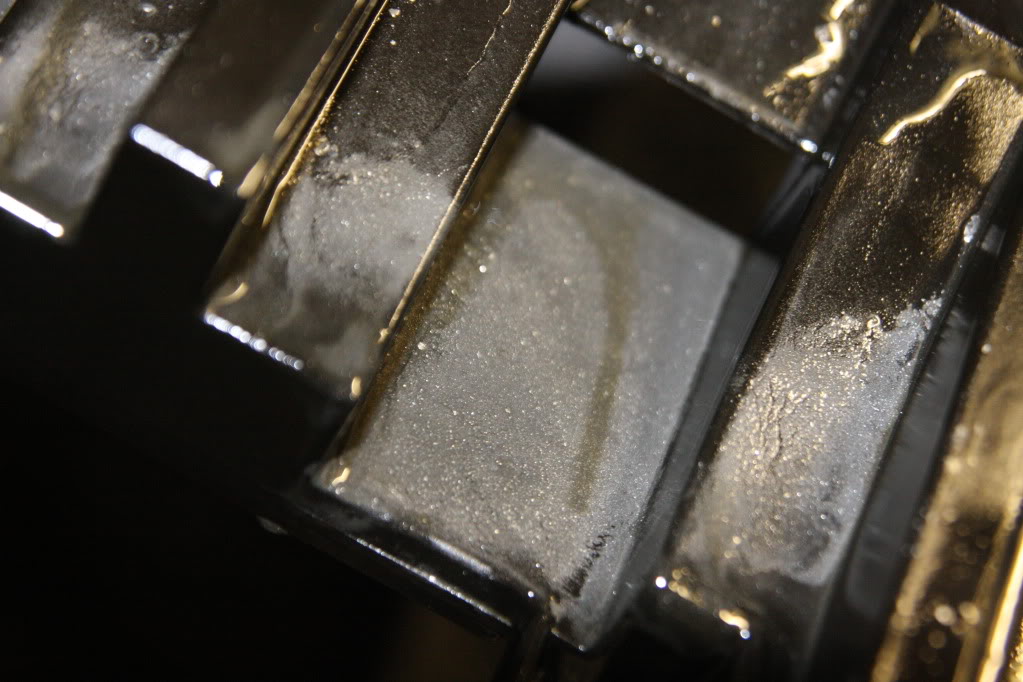

Got it back to the factory earlier, flywheel off and on the engine stand just to double check. Turned it over via the flywheel (no crank pulley on it) beforehand and it span over ok. Slight bit tighter than the other one, but I thought it may have been down to lack of oil/being sat etc.

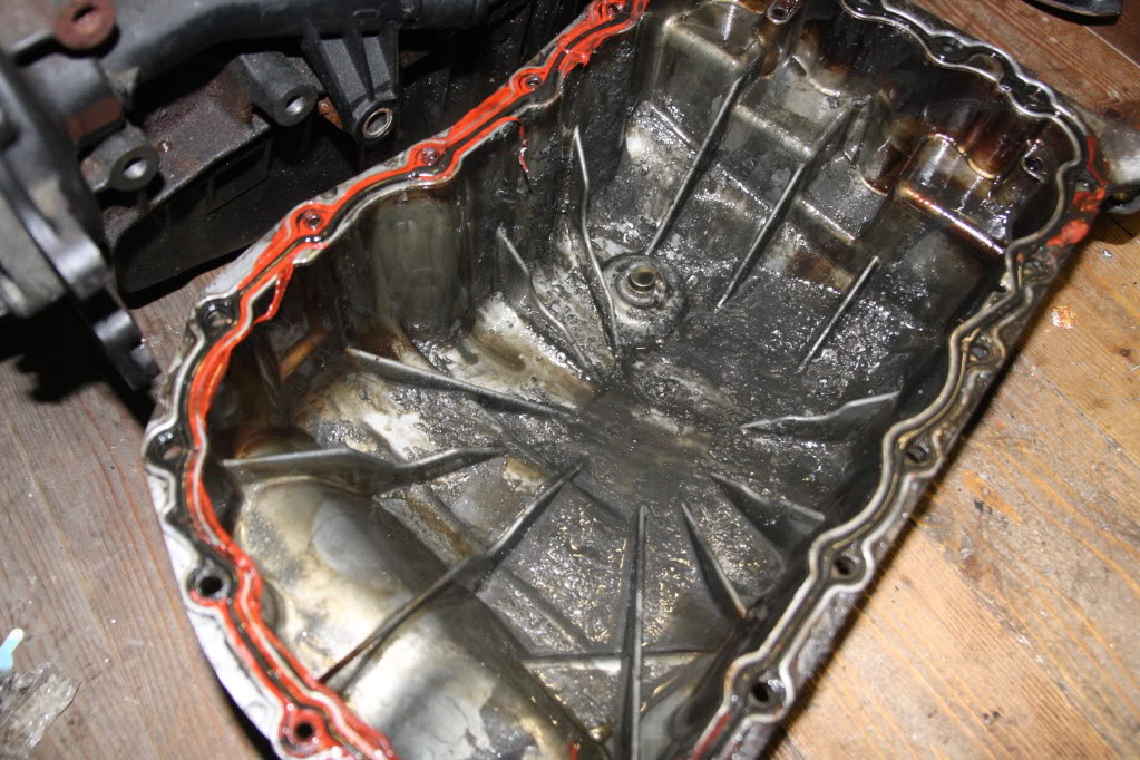

Put it on the stand to find some of the sump bolts were loose, removed them all anyway after having to drill one rounded one off, that was just the start of the story...

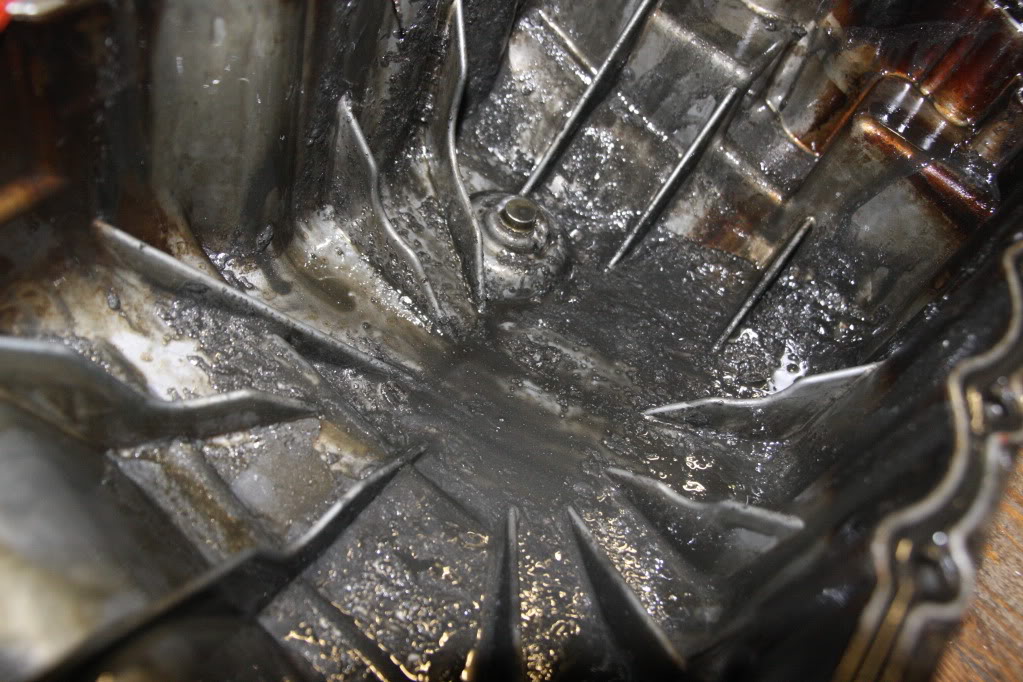

After a few hours just getting the sump off, finally got it removed...
All that is just swarf! Someone had used sh*tty silicone gasket on the sump which doesnt even need it, as it has a re-usable seal! Some of this was in the oil pump pickup...

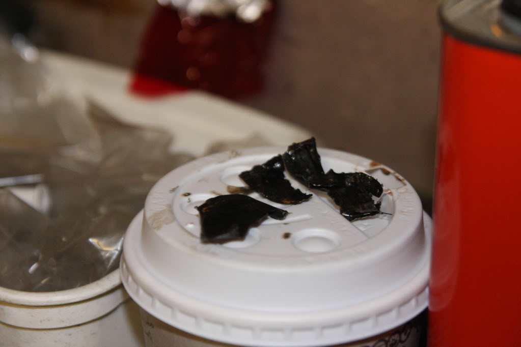

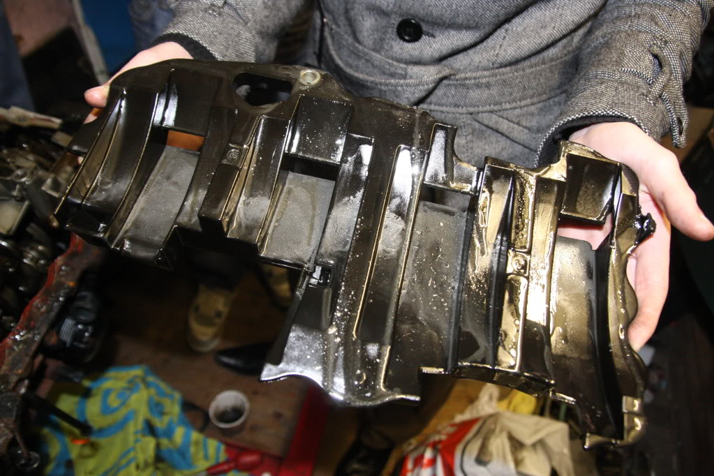

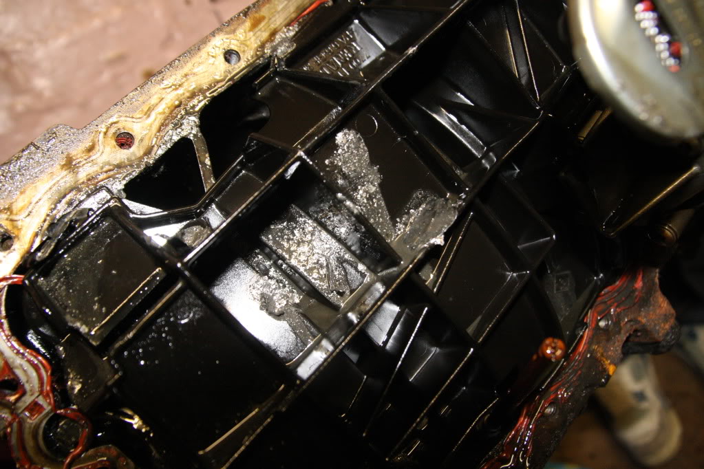

Checked the plastic baffle and found more swarf, and some bits of metal that looked like some parts of a shell...

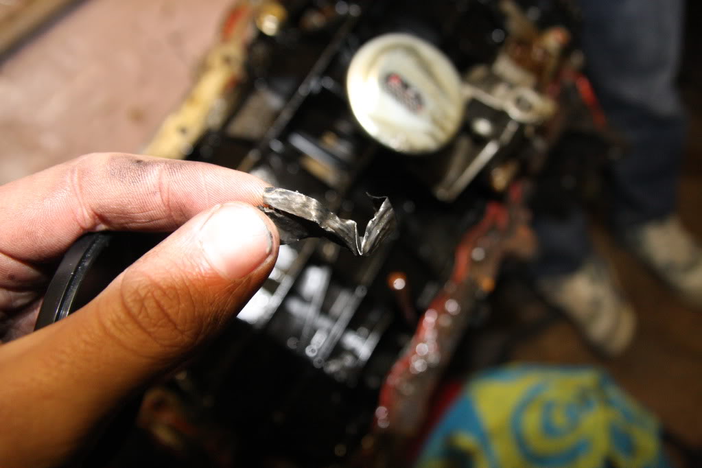

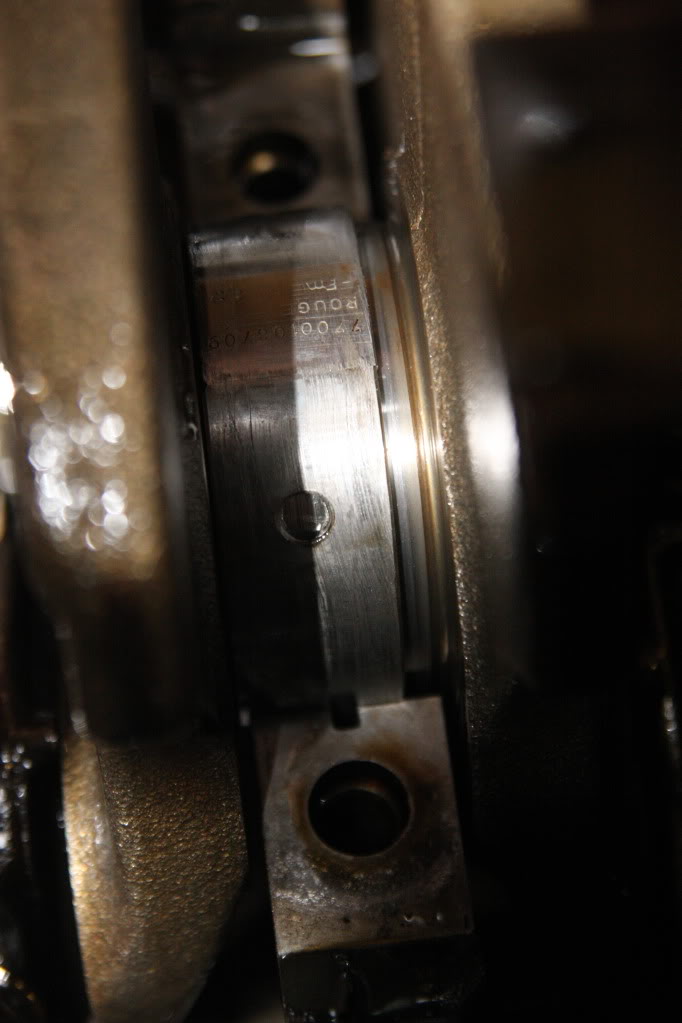

Also swarf everywhere down the back of the bores, popped a few of the rod caps off to find some slight scoring. Then took one of the mains off and it was scored but still in position. Moved onto the next mains cap to find there was no gap in the bearing, it had spun and welded together...
So basically at the end of the day completely useless! Grim.

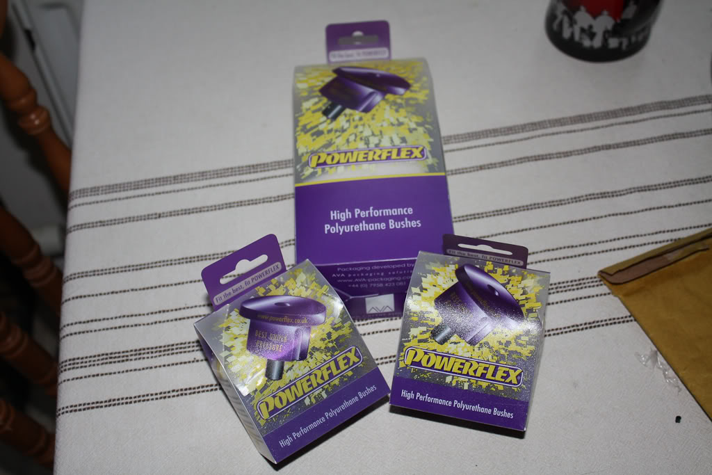

Pollybushes
Powerflex : 1*2 wishbone bushes
Powerflex : Williams anti roll bar bushes

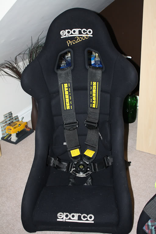

Also my new harness turned up
Schroth Profi III-6
Lightweight 6-pt professional harness with snap hook attachments on 3“ shoulder straps (wrap/snap hook fi tting) and 2“ lap and T-Bar crutch straps. RFR rotary buckle and alloy adjusters. FIA approved.

Schroth Profi II-6
just need to get another when i can afford it
so happy you posted twice haha
they look good, really like the seat! them belts look very heavy duty!
