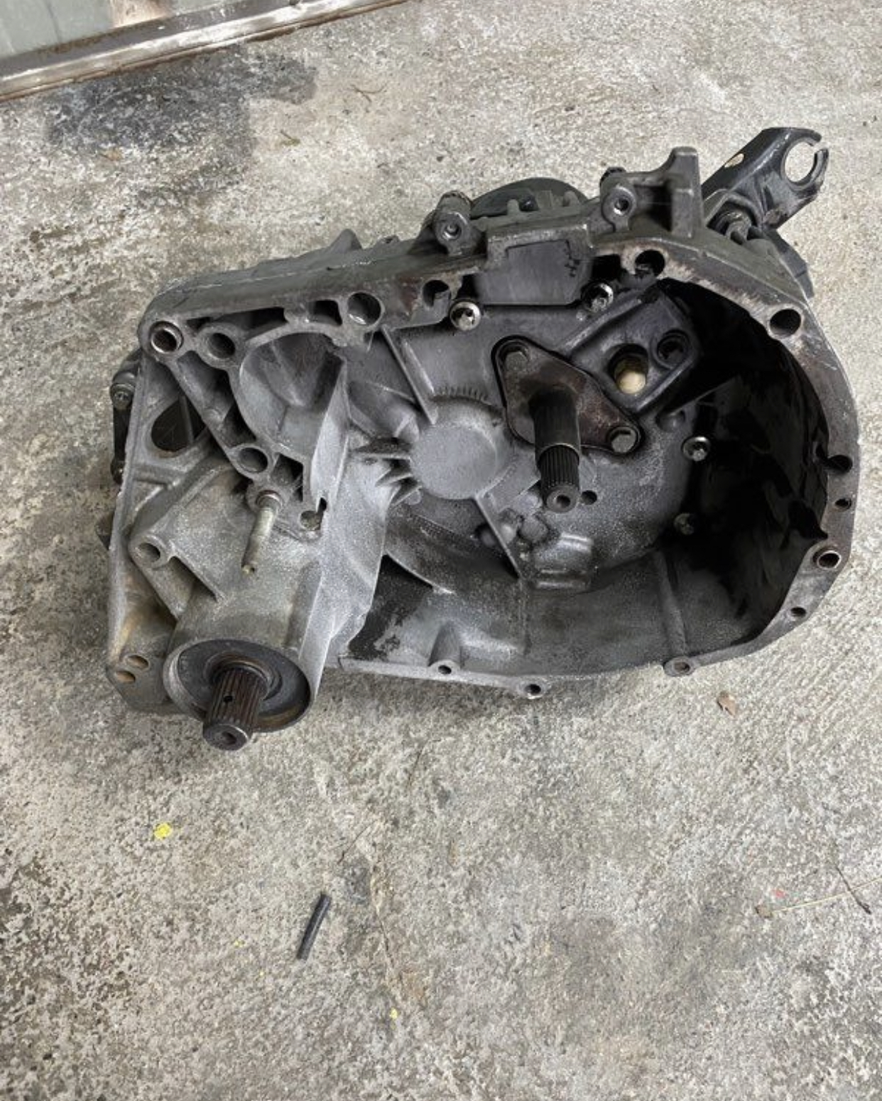

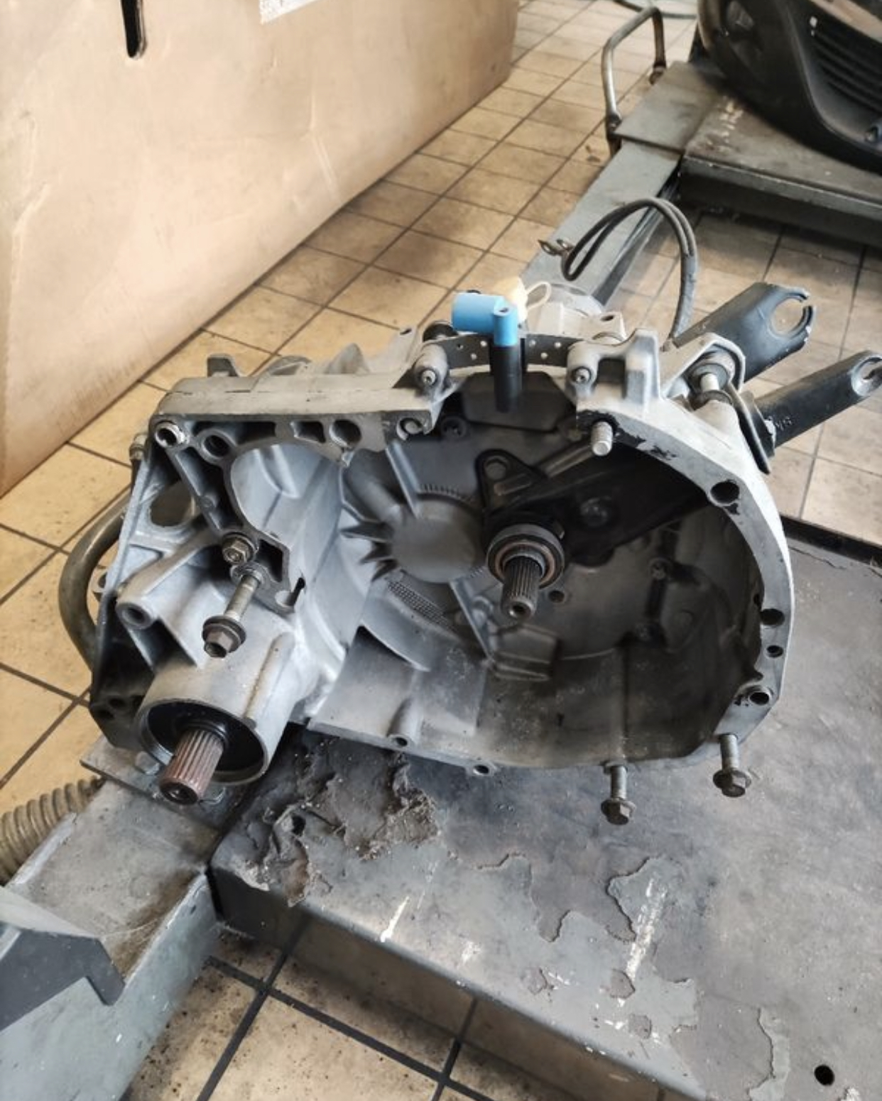

Could I fit in a jc5 089 ? Or JC5 129 ? I know they have a speed sensor on it that I don’t need but would it fit anyway ? Second question is that I‘be been seeing 2 kind of JC5 130 now, on has an opening at the top with a blue sensor on it, and one has not, they are both JC5 130s tho ??
No sensor, and closed at the top
With the blue sensor and opened at the top :
So ok do I need the one with the sensor on top or not ? Can I use either one of them ?
What even is this sensor ??

Sensors you’re seeing are just different crank sensors. Original sensor is black - new style is blue.

ohh I see, then is it normal for the top one not to have that sensor ? Could I still use it ? They both do say Jc5 130 on the casing but I worries me that it doesn’t have the sensor nor the space to put one it seems ?

You can just use the sensor on your gearbox as it’s the crank sensor.

Okay so it would still be possible to screw in my old crankshaft sensor on the gearbox in picture 1 then ? Even with the casing being « closed » at the top compared to the one in picture 2 ?

The top one looks closed because there’s no sensor fitted mate, that’s all. You’d be fine to fit your sensor.

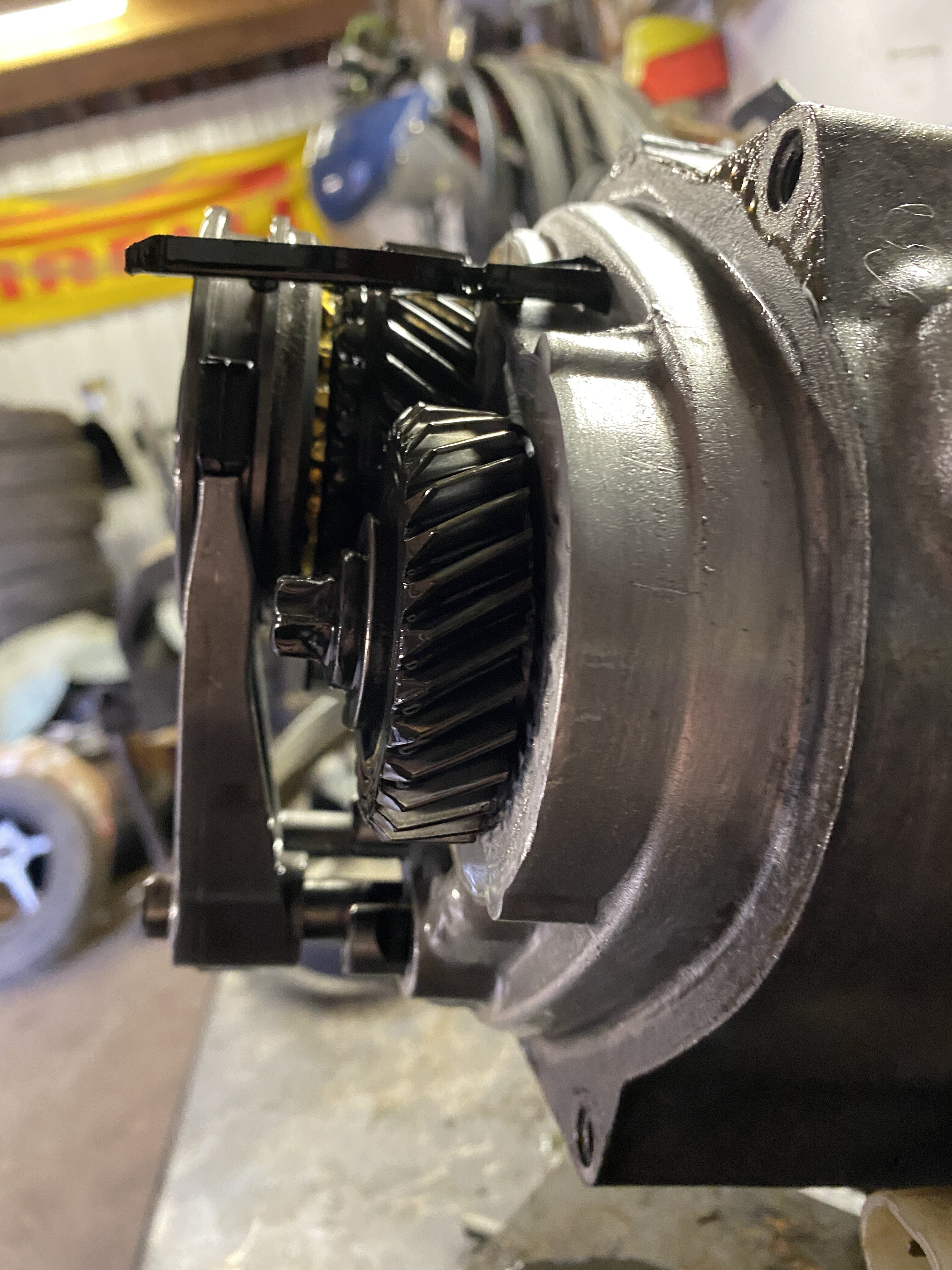

Take the black end cover off with the gearbox in neutral and take pictures so I can see the selector forks. Upload them in here and I’ll be able to tell you if it’s selected a gear itself.
