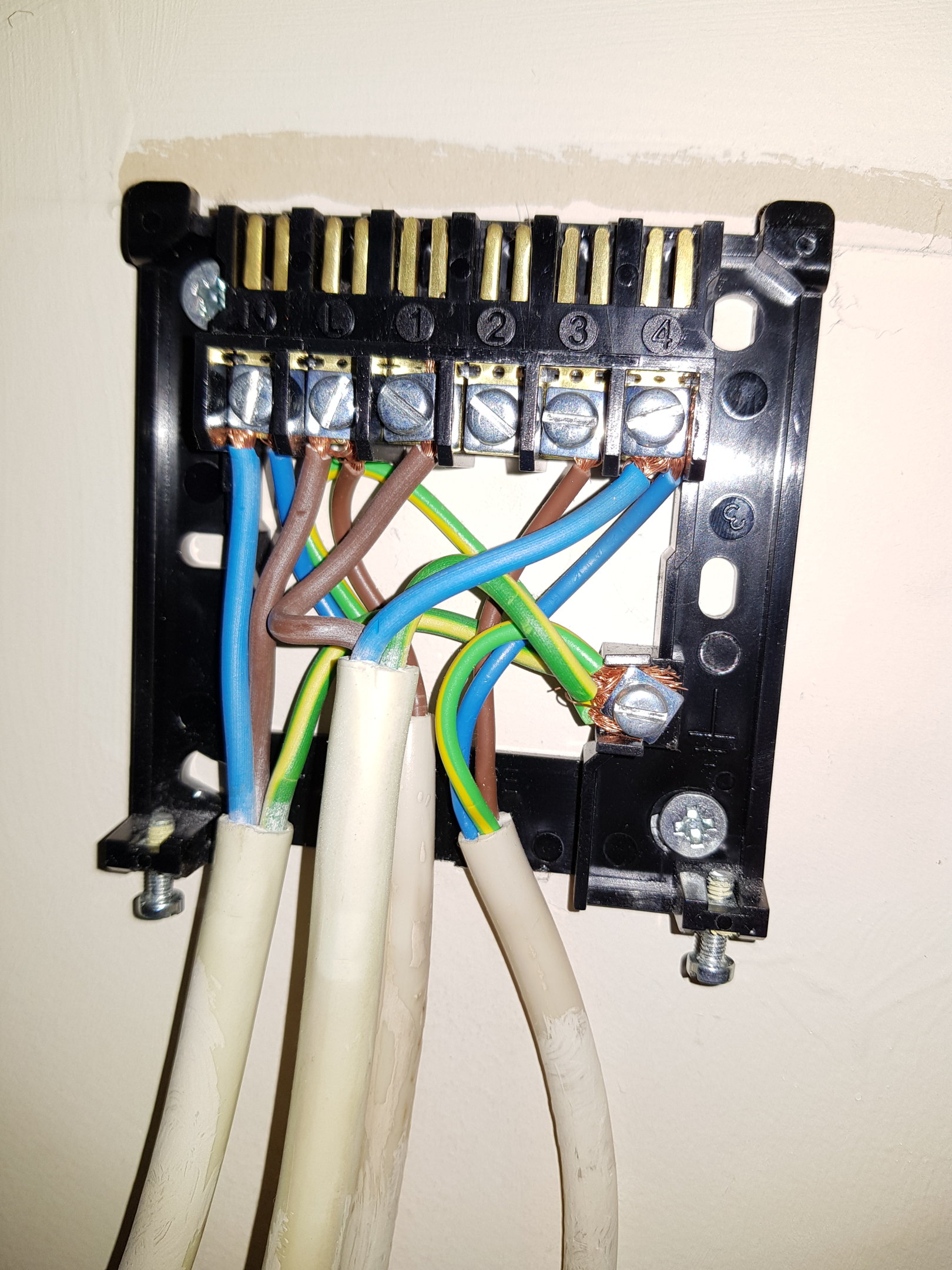

Just got a Nest thermostat installed today :) it's great apart from one problem... which is I can't get hot water without the heating being on! Googled it and found someone else with the same problem; hope it can be resolved.

Have you got a combi boiler?
I went to a job the other day and the heating worked fine. The chap would turn his hot water tap on and he couldn't get hot water unless he pressed the button on the hub next to his combi boiler. I found that it had been wired incorrectly.

Same sort of thing then. Found someone else with the same problem on Google too... spoke to my plumber, he thinks it's a wiring issue. Admitted it's been 3 years since he installed a Nest lol. Hopefully be sorted soon. It's a shame you can only set one schedule per day, though I am looking forward to it's learning bit!

Anyway... had the rewiring done today and it blew the boilers circuit board :( so was back to no heating or hot water tonight. Plumber can't work it out! Wired it to Nest spec first and I didn't get hot water without having the heating on, then this time wired it to boiler spec and the hot water worked but when he turned the heating on it blew!
Said he's going to phone both companies tomorrow for support.

Even my plumber messed up the initial install and it ended up blowing the PCB in the boiler! So for me, f**k the hassle I'd always get a professional to do it (it was something about having to wire it into low voltage mode, which isn't mentioned anywhere in manuals)

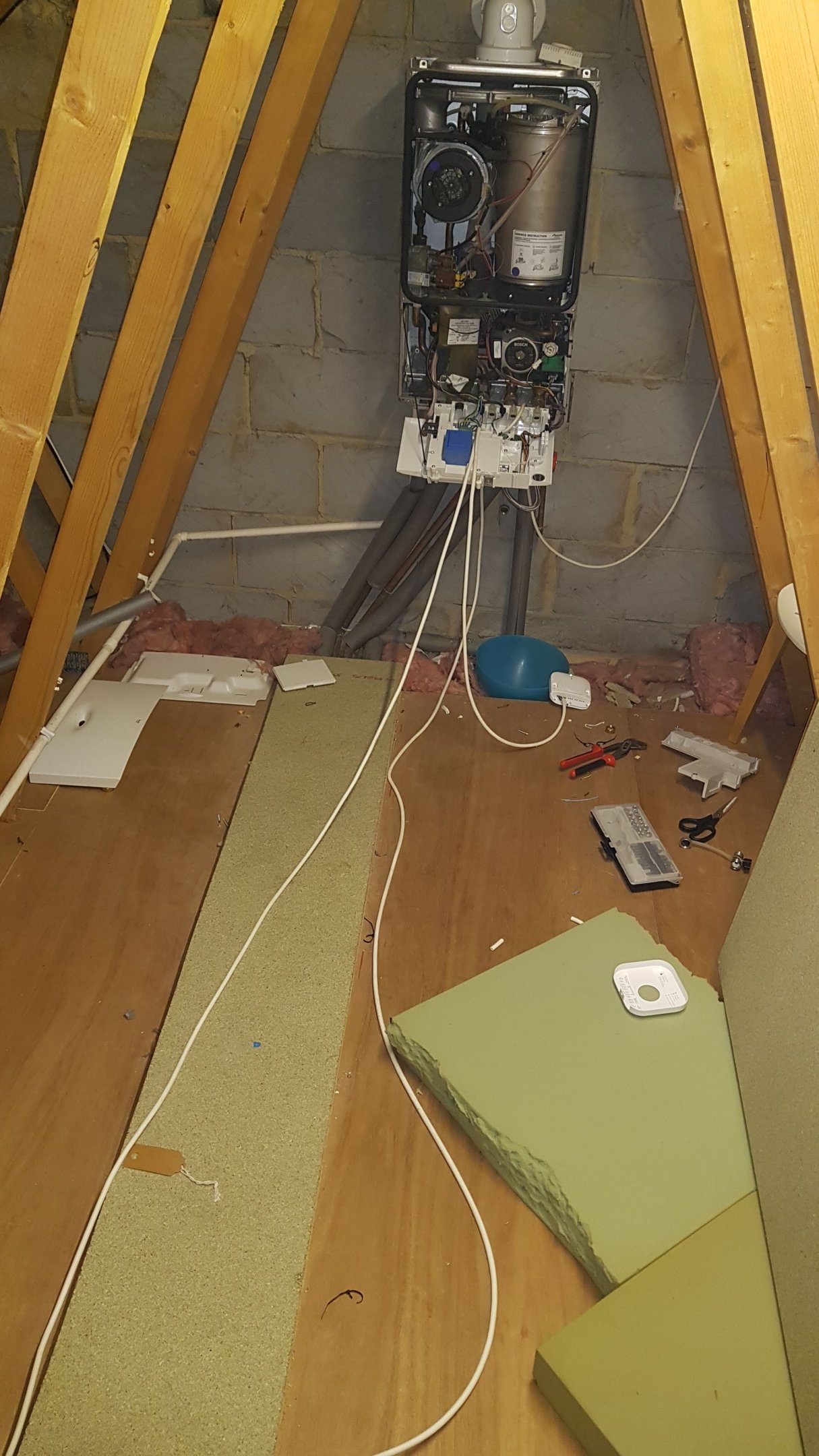

Did it myself yesterday. Get someone else to do it lol.
What a f**king ballache. Had to bodge a lot of stuff as I lost power to the boiler completely. Turns out I did need both cables coming from the old programmer to power it after I cut the cable to use for the heat link.
Took about 3 hours and had to leave it like this until I can rewire it all later today when I get home.
