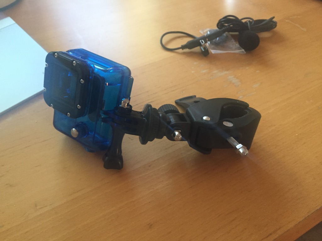

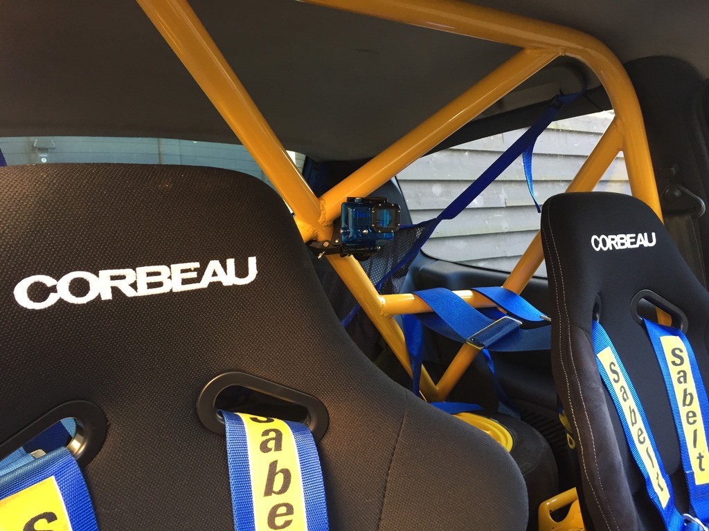

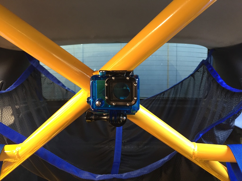

Go pro mount turned up

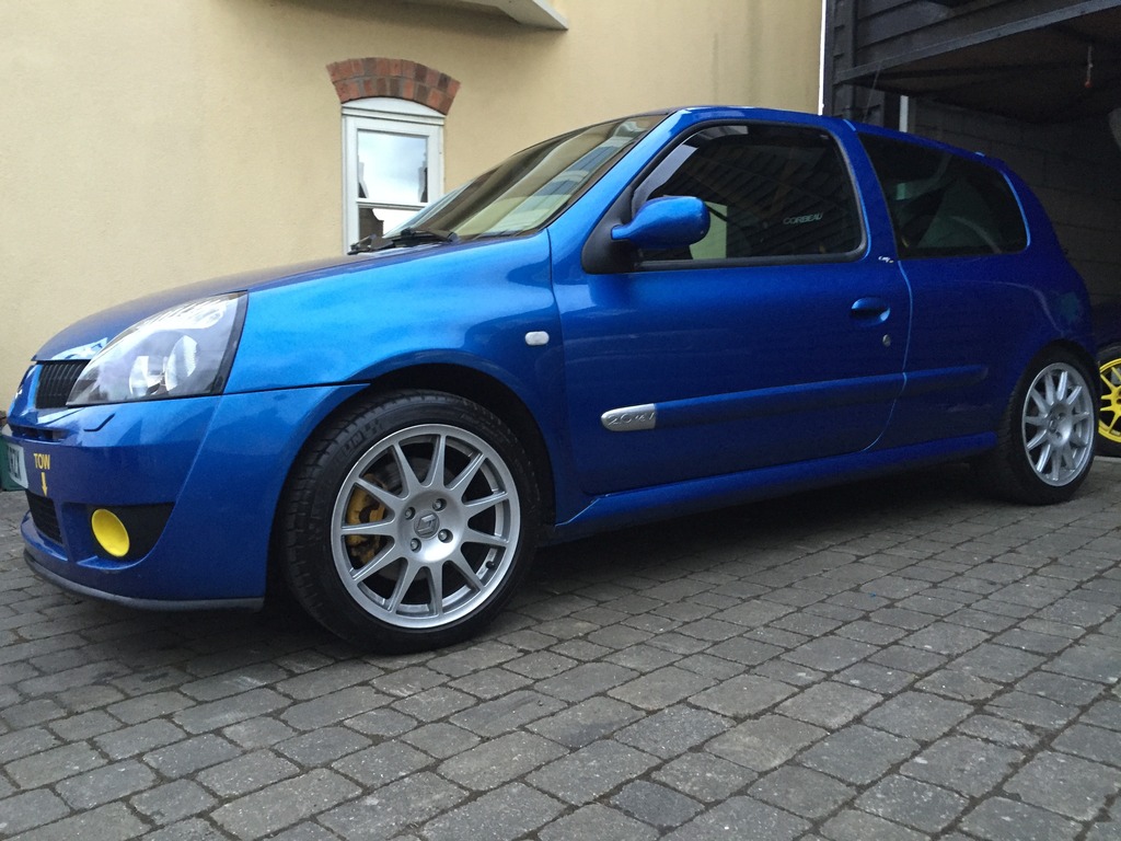

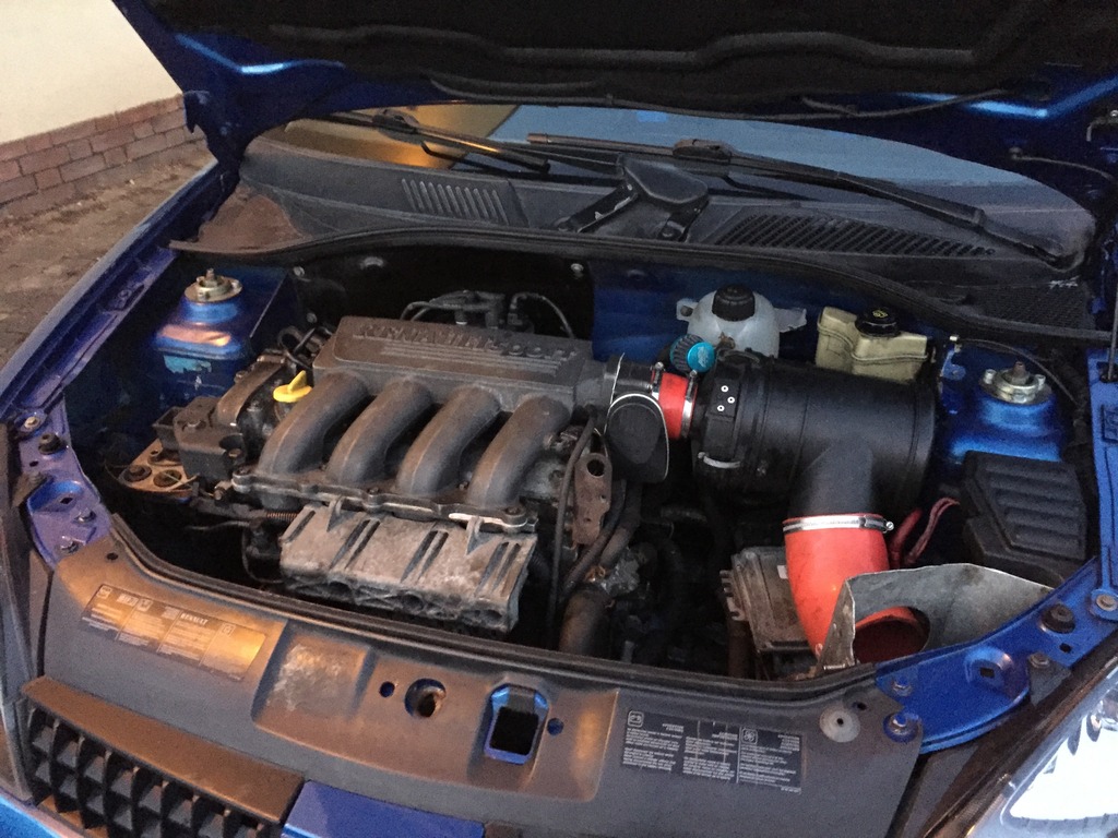

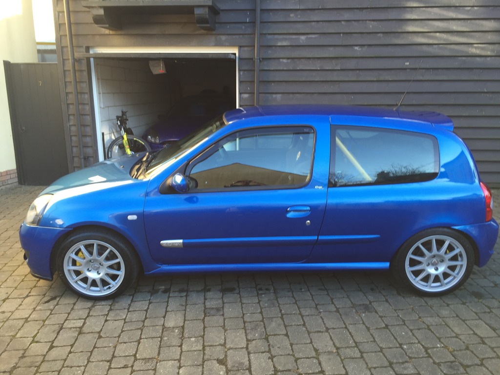

Okay so today I sorted out the battery and since then the immobiliser issues and starting issues have been resolved :)
I also paid £6 for the local car cleaning place to power hose and give it a quick clean, once back at home I threw some wax at it.

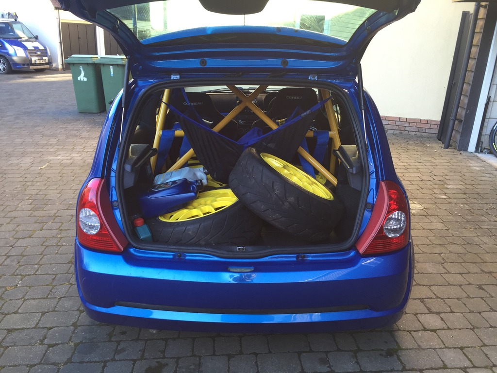

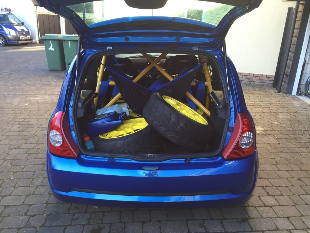

All packed and ready to go
Fuelling up ready to go

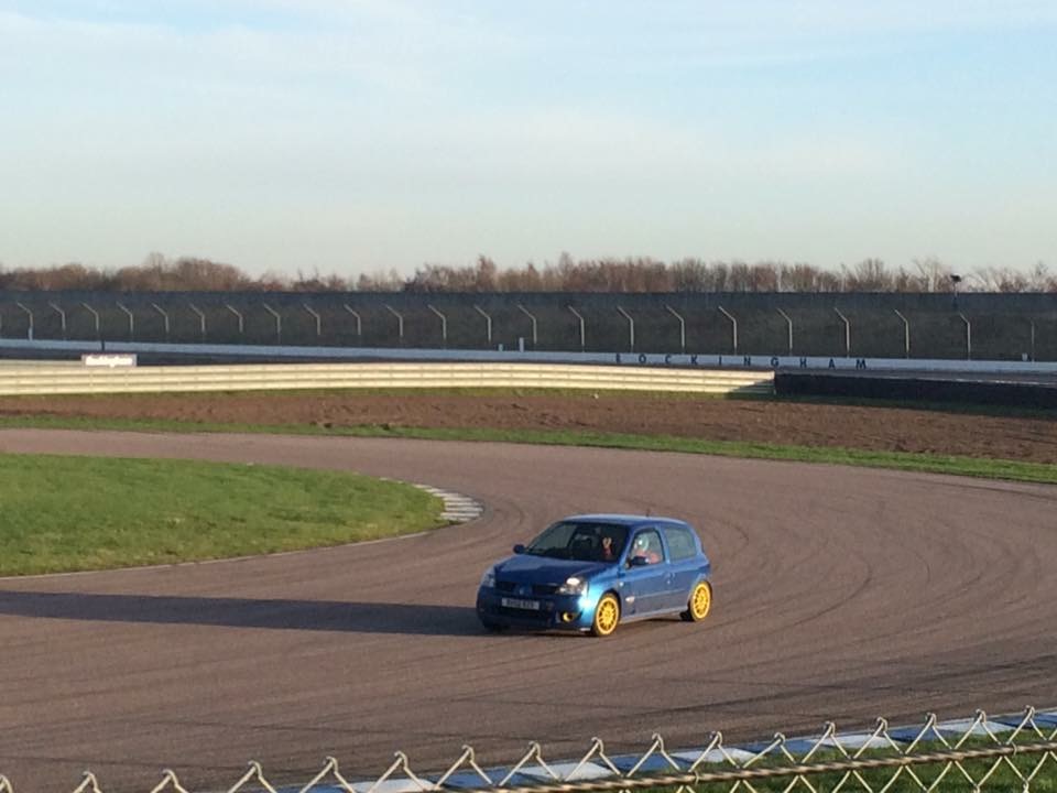

Well the weekend is over and what a weekend, on Saturday I couldn't stop grinning.

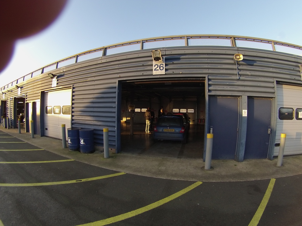

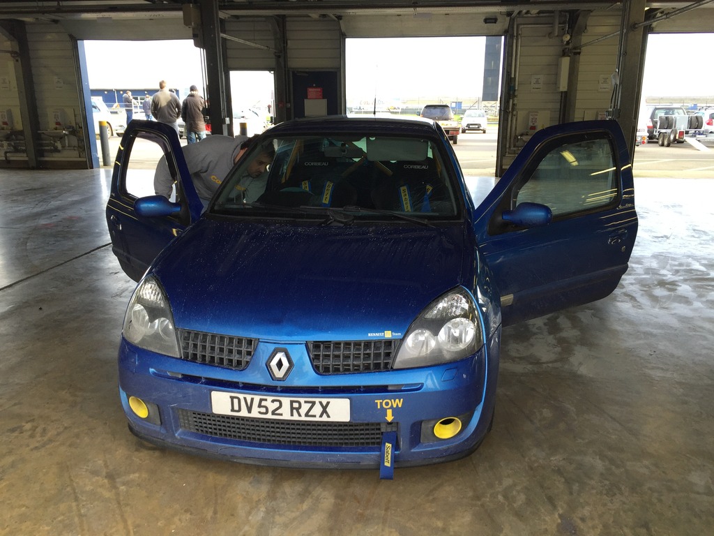

It was an early start from Worcester at 5:15am in order to get to Rockingham with plenty of spare time, which was just as well as there was an accident on the A14 and we where at stand still for over and hour.

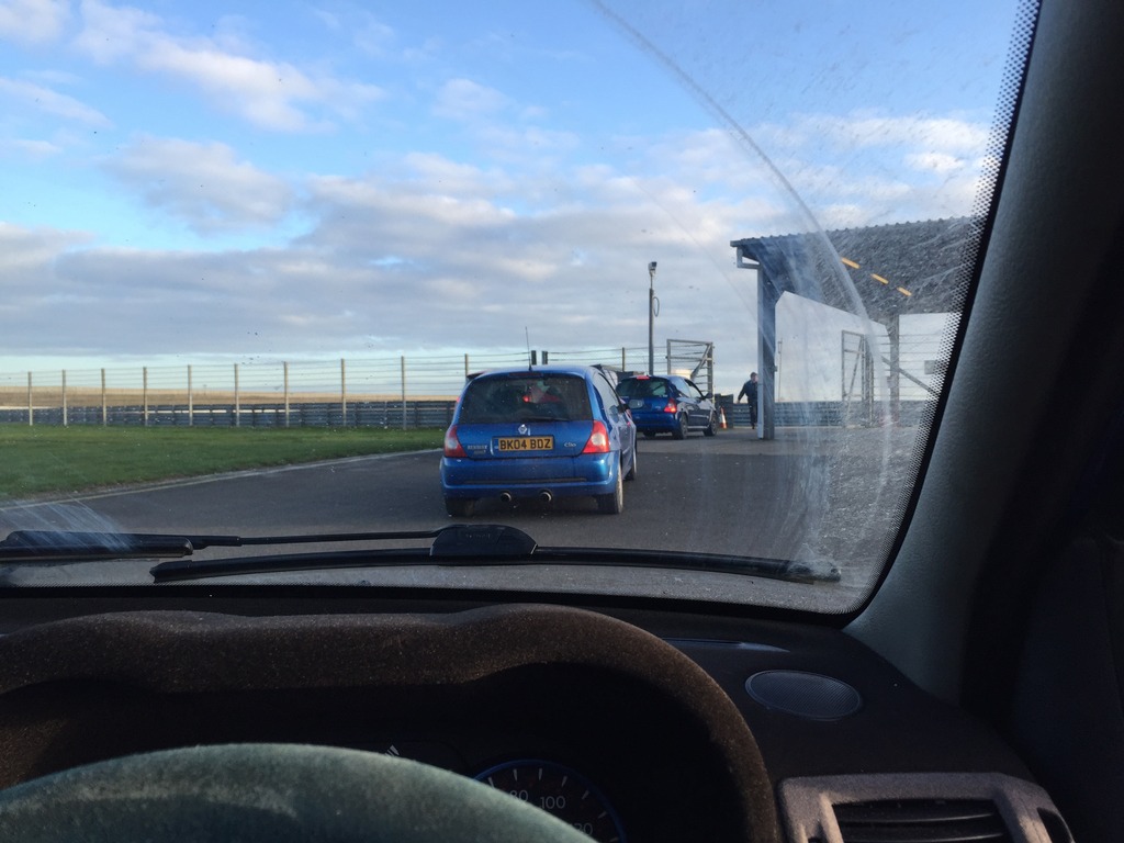

Finally we arrived and just in time for the briefing

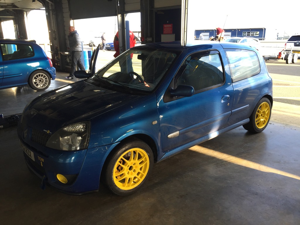

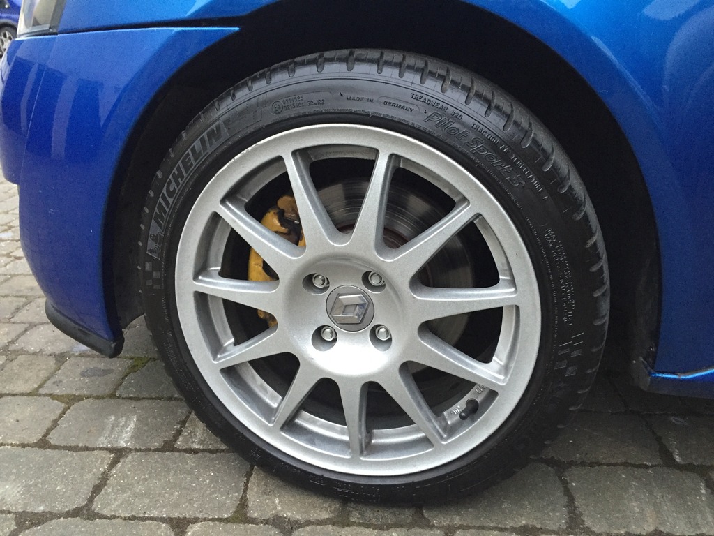

After the briefing we went out for the sighting lap, silver wheels still on at this point
Once back we proceeded to change the wheels over
Then I was finally ready to head out
At the dB check, only got 88dB however I had measured it at 95.5 on the Wednesday so I was surprised at the reading tbh.
So my co-pilot Si has done a number of track day previously and was a great help with giving me much needed advice, I had within the first few laps managed to spin the car and I was driving like I was on the road which I soon realised is in no way the way you should be driving on track as Si explained to me once we returned to the pits to check over the car.
On return to the pit lane and a once over the car everything seemed great
We checked the tyre pressures and they where at a cray 40 (should of checked before heading out) this certainly wouldn't of helped with the spin (not that it was down to my driving at the time) Once the tyres pressure was dropped to around 28 the car felt much better.
After a few sessions Si then had a few laps which at this point I realised I still had plenty to learn and many improvements to make
After the last session before lunch we noticed a squeal from the front brakes, I had checked in the morning and there was around half of the pad amount left but the inside pad in just 4 / 5 outings had worn out, this left us a little concerned however after a few calls we found a local motor factors that had some pads in stock. We loaded up the fuel tank and the 20ltr jerry can and headed back to fit the new pads
After lunch it was back out on track and after some further advice my confidence grew and I really started to get to grips, hitting the apecs, carrying more speed through corners hitting braking points and really begin to enjoy the experience even more.
I did have a moment in the afternoon where I braked way to late and locked up and ended up in the gravel trap, I was soon rescued after the Tow strap was ripped off when being recovered, there was no damage to the car, just the front scoops full of stones.
So with a quick look over the car I was back out on track again

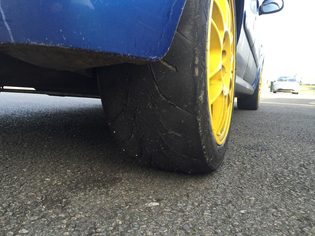

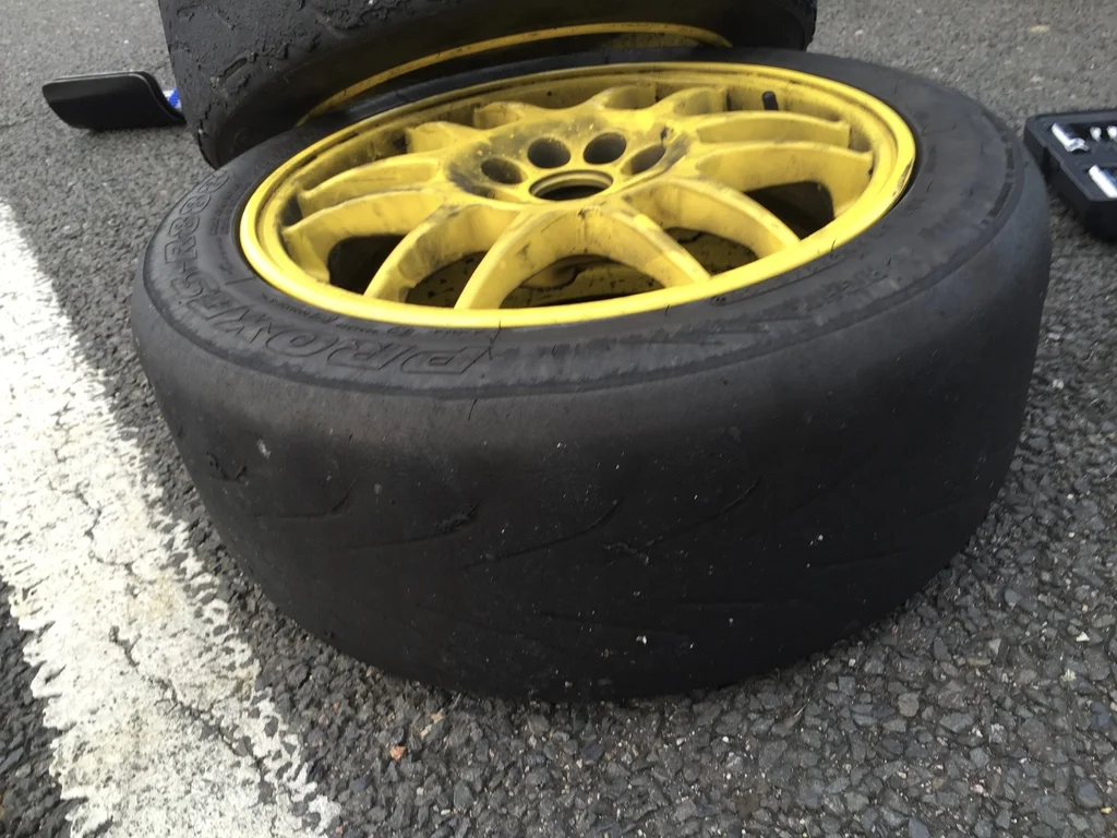

So what a day tyres are looking very worn out now and will certainly need a new set for the next adventure.
It was then on to the long journey home. 3 hours 15 mins, but I was so high on adrenaline that it didn't seem to take to long, the car was fantastic it was running almost all day from 5:15am till 8pm at night, apart from the brakes wearing out and having to adjust the exhaust bracket slightly it was faultless.

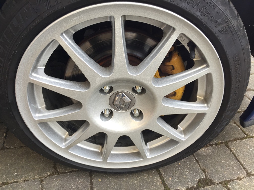

When I arrived home in the evening I found that the brake scoops had been delivered, but I have to say the brakes where excellent all day long, it was a chilly day so that certainty would of helped, but I can see why now many owners say just a decent set of pads and decent discs are all that are required using the standard callipers, more than tough enough for the job.
So whats next, well number one get stud conversions as changing wheels over was a ****ing nightmare and just took way to much time, replace the centre section of the ktec stealth exhaust to a silenced section as the motor way journey was horrendous.
What an experience, I have already started looking for other track days, hoping to attend Castle Combe pretty soon.

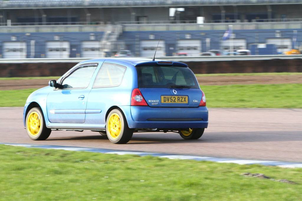

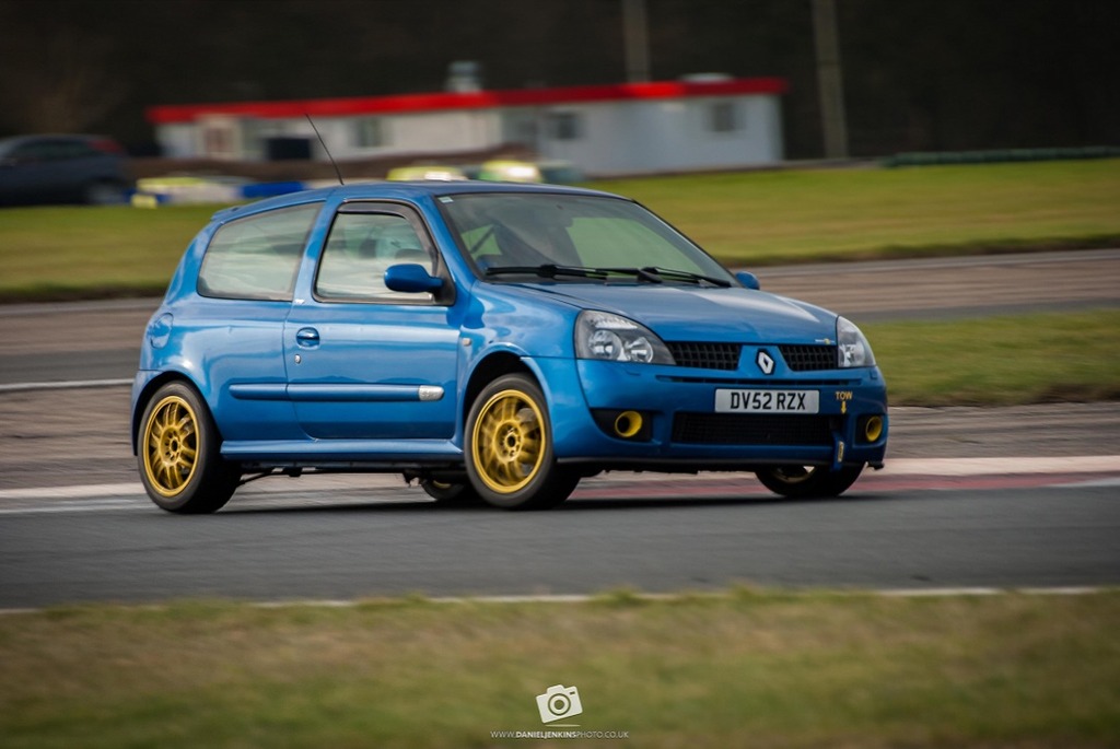

Till then a last shot of me in action

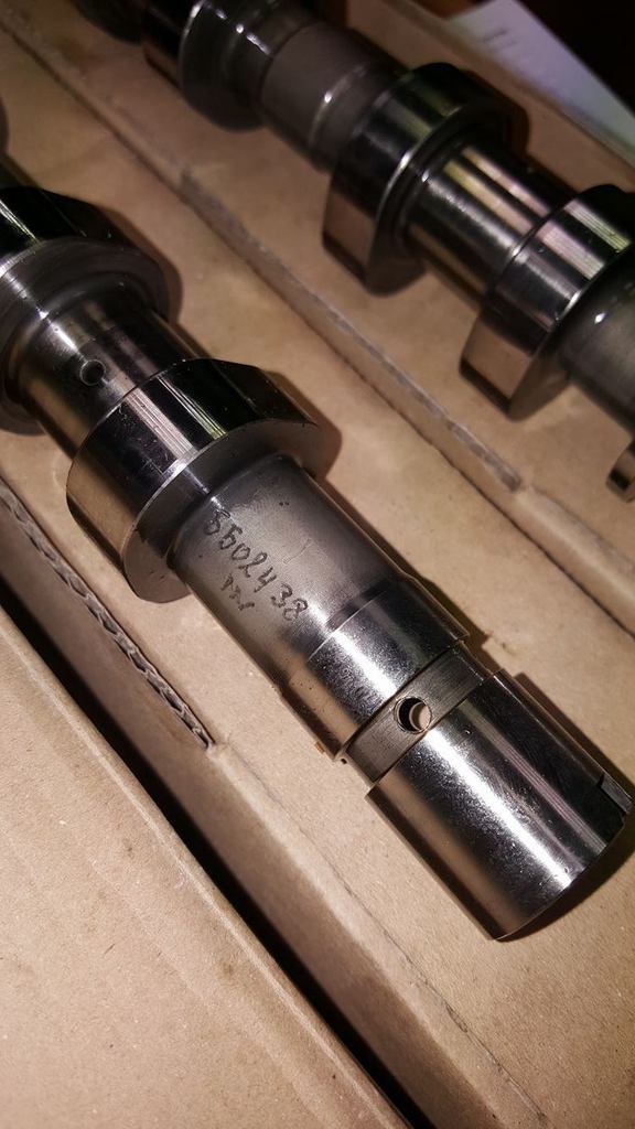

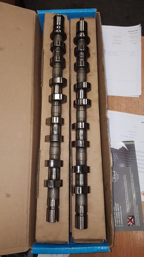

Well things just got a bit more expensive, purchased a set of 438 Cams :)
Will need to mapped but can be mapped on the standard ECU, also going to have them timed up slightly different so that I can see further gains, with my setup and can expect to see around 190 to 195bhp with a nice jump in torque. Which would give me that bit more power and suppose to make the car a lot more track friendly.
Down side is the cost of the cams and the fact that cam belt will need doing and with the maping its going to cost a few hundred quid, but its a Cheaper route then the RS2 inlet option with similar performance.
Out of interest, how much were the cams?
  FRP - Clio 182
I paid £350 delivered which I think is a pretty good price, so they aren't cheap, 197 cams I think you can get for under £100 but then the gains aren't as much, but with 197 cams and RS2 inlet you can see 195 to 200bhp but thats talking around £1200+
  Clio 172 (CUP)
Does sound good, was that new?
  172 Turbo
Good choice on cams, I've just picked up a set, be interesting to see what you get with them. Do you have an initial power run?

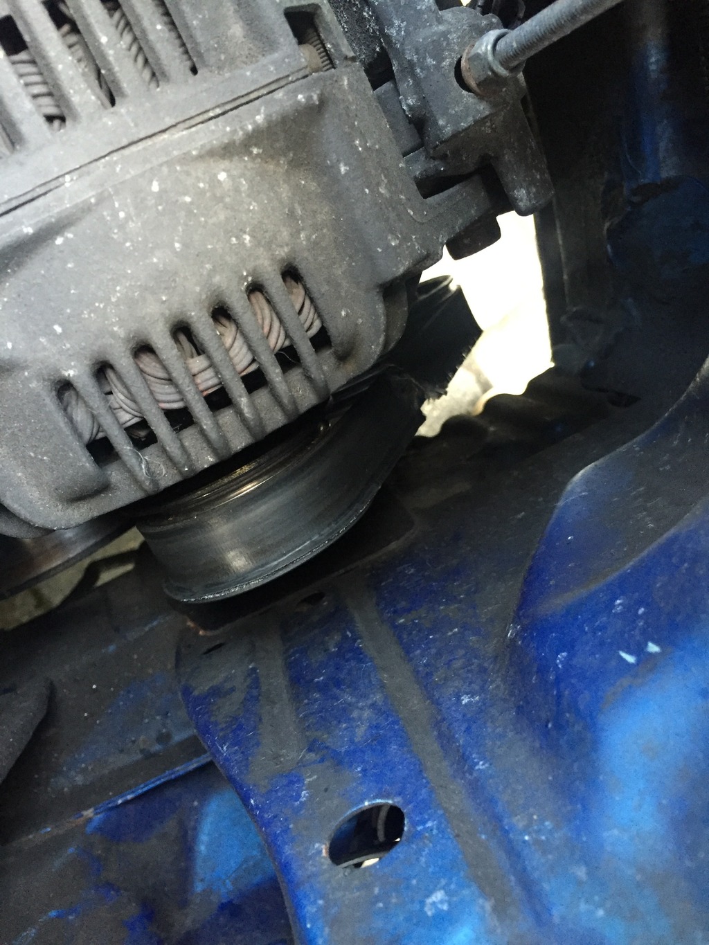

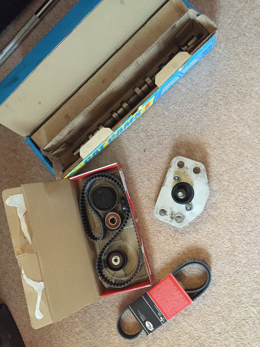

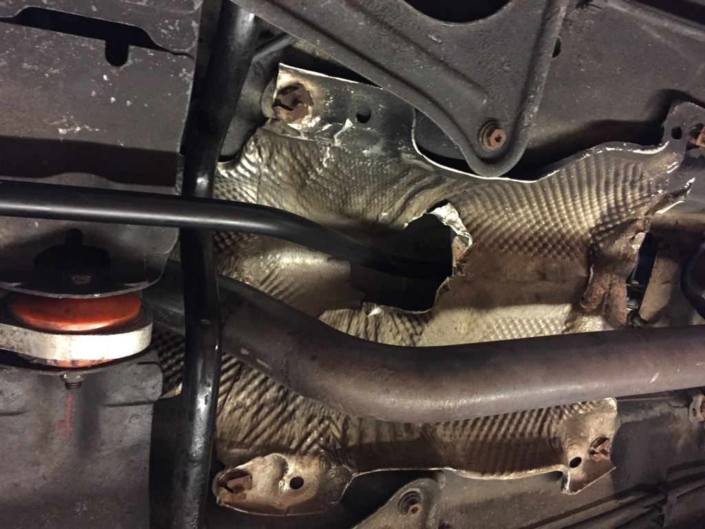

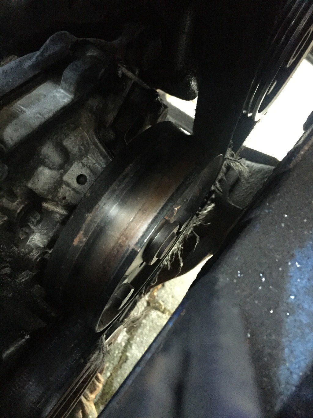

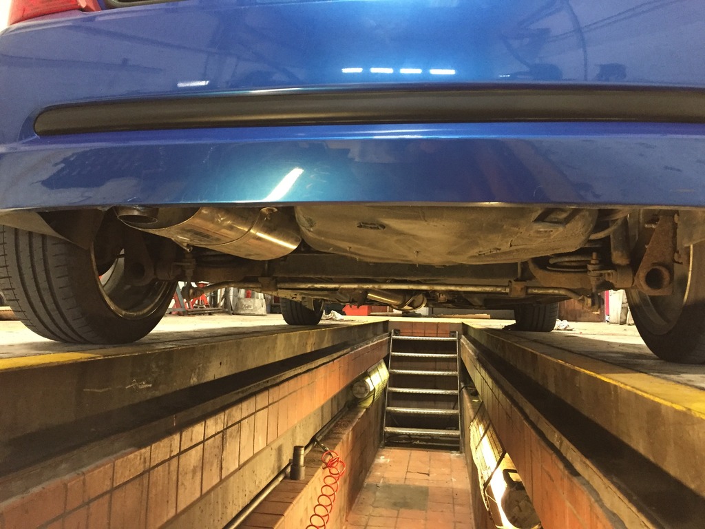

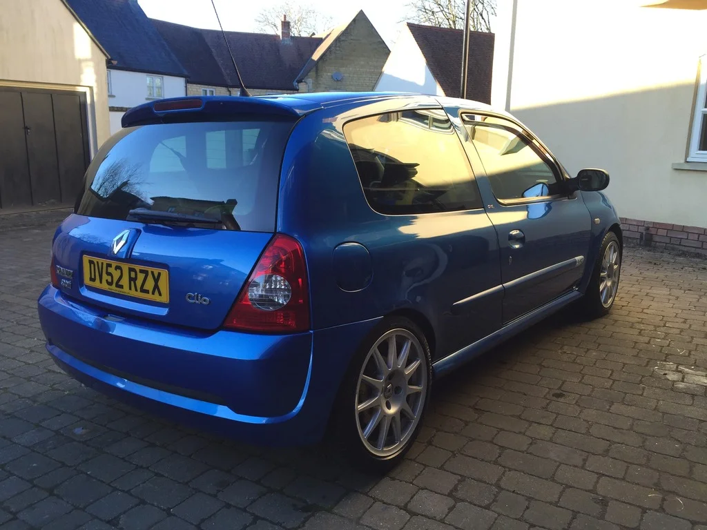

Well the luck gods where with me yesterday, I swapped over the centre section on the exhaust as with it being straight through was just ridiculously loud when using the car off the track, particularly on the motorway.
Anyway took the car for a blast to see what it sounded like and once back home I checked under the bonnet as I do sometimes and I spotted this

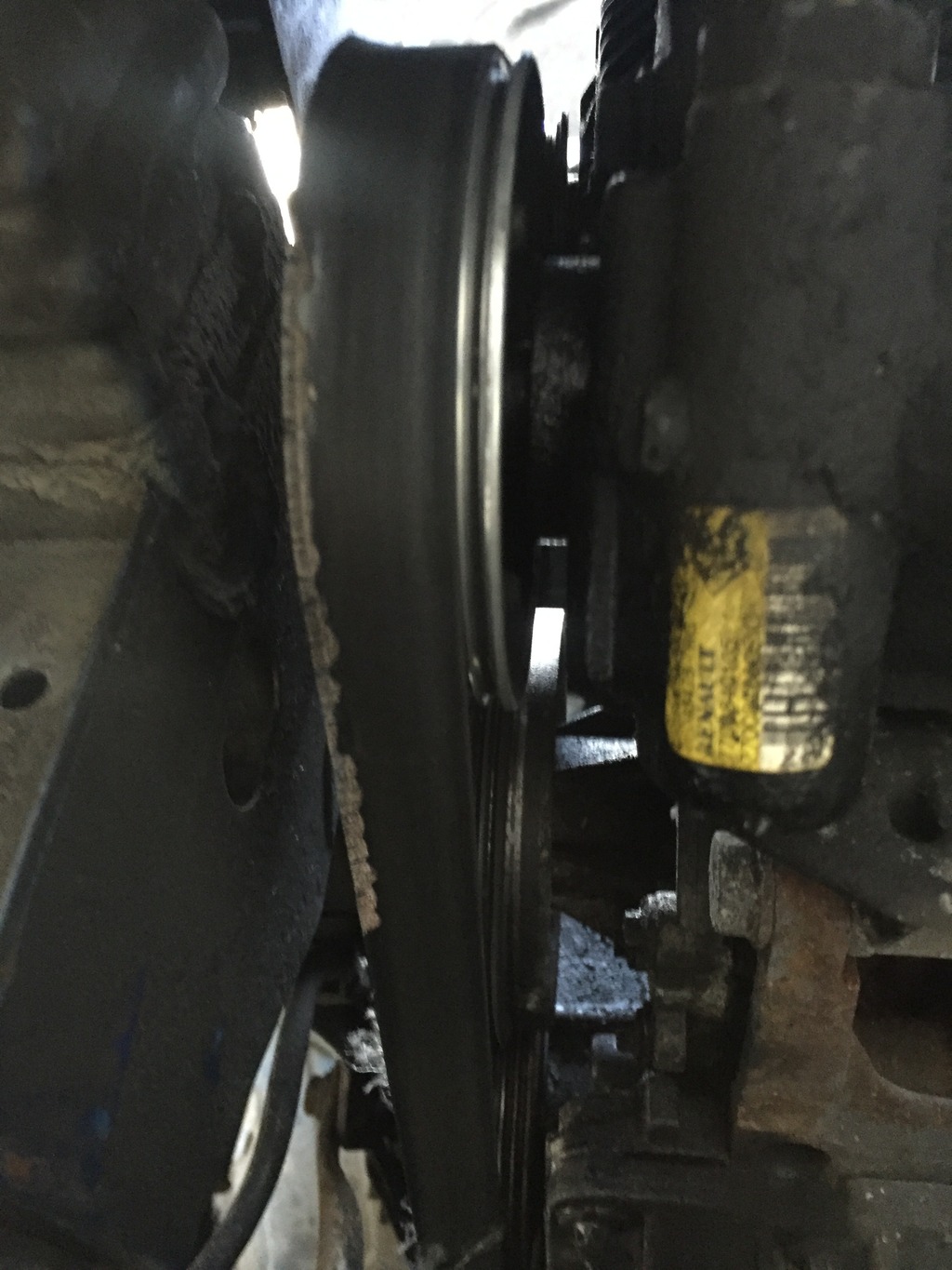

The Aux belt is just about about hanging on, very lucky not to of snapped as nine times out of ten when they do they take the cam belt with it and then the engine. Just shows worth changing when doing the cam belt, a bit annoying as cam belt was done just over a year ago and the aux bets should be changed generally around ever 3 years and or at the same time as cambelt.

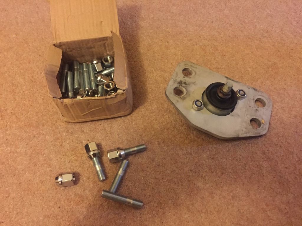

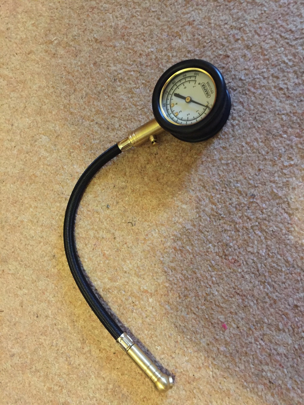

Tyre pressure gauge has turned up

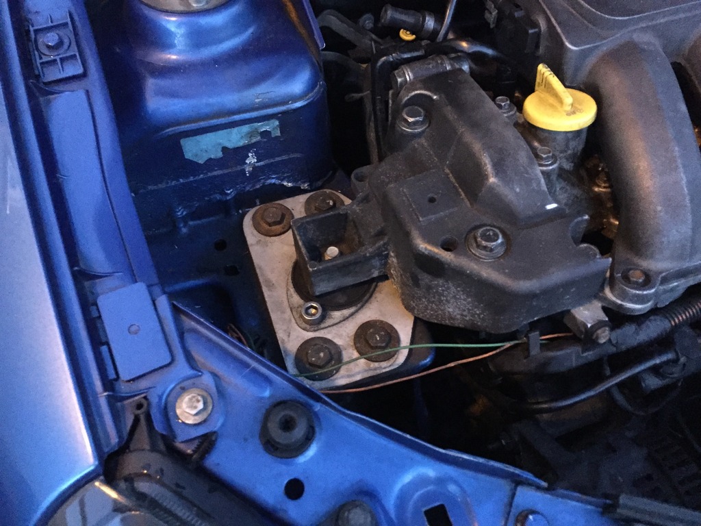

Also stud and nut conversion kit and a solid engine top mount I picked up for £50 second hand (usually around £100)

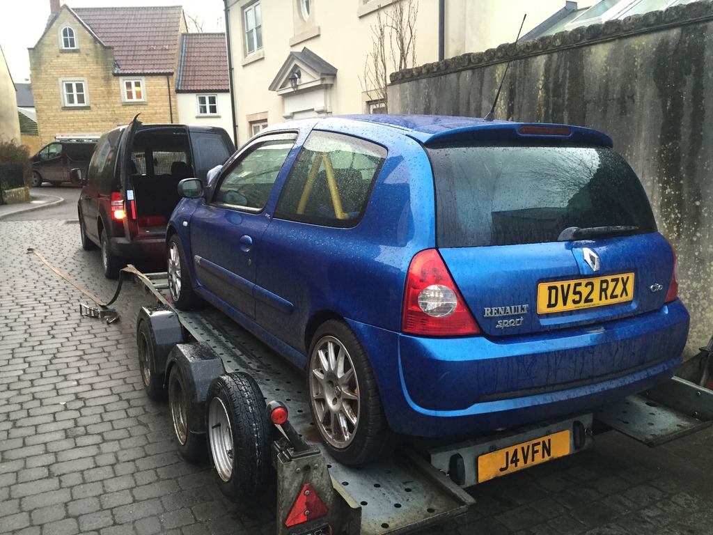

Car picked up and taken to Dan Potter RJ Motorsport to have work carried out, should be ready by Thursday / Friday :)

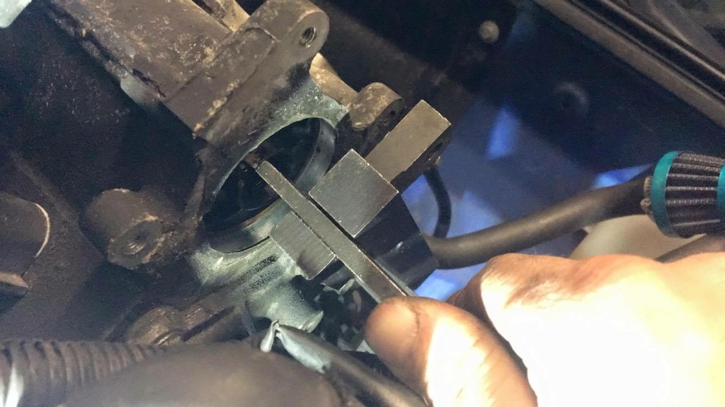

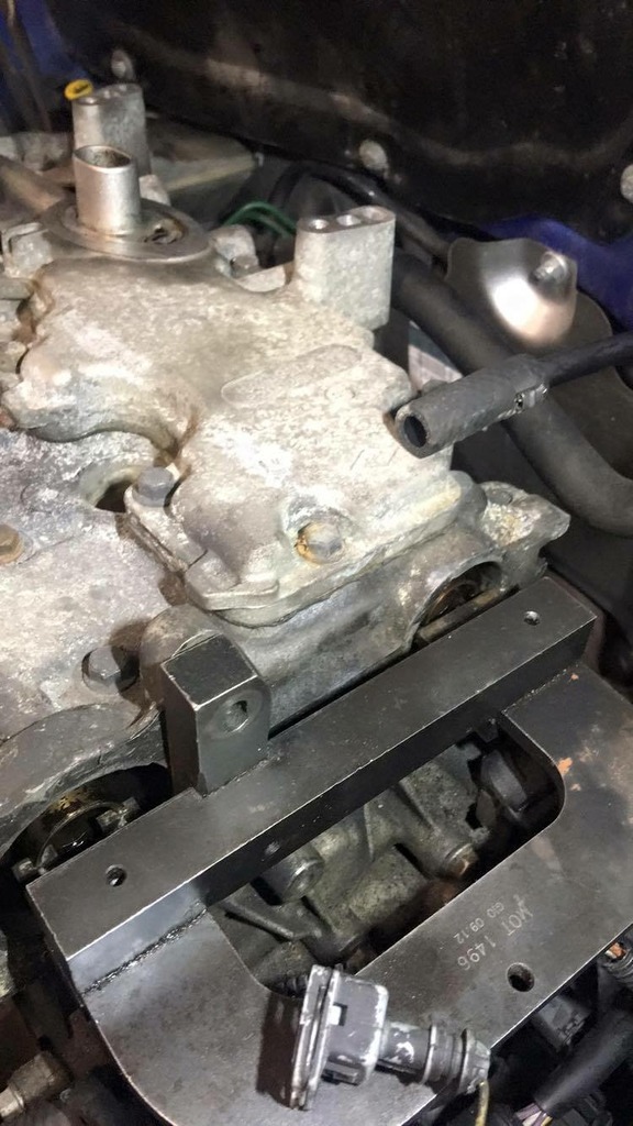

So update as its been a while, Dan started work on the car and before he swapped the cams over he checked the timing and as can be seen it was out
I could of actually been down around 20 to 30 bhp than I should be, so even after the fitting of the 438's it would feel much improved.
Now this is where the issues start, and perhaps where i was lucky seeing the Aux belt almost going I am not so lucky, anyway after fitting Dan flashed the ECU with the 438 map which is the standard map he uses and then makes changes to suit after a road test, unfortunately during the road test it came apparent that there was an issue with the car and he soon realised that the bottom end had gone 😧

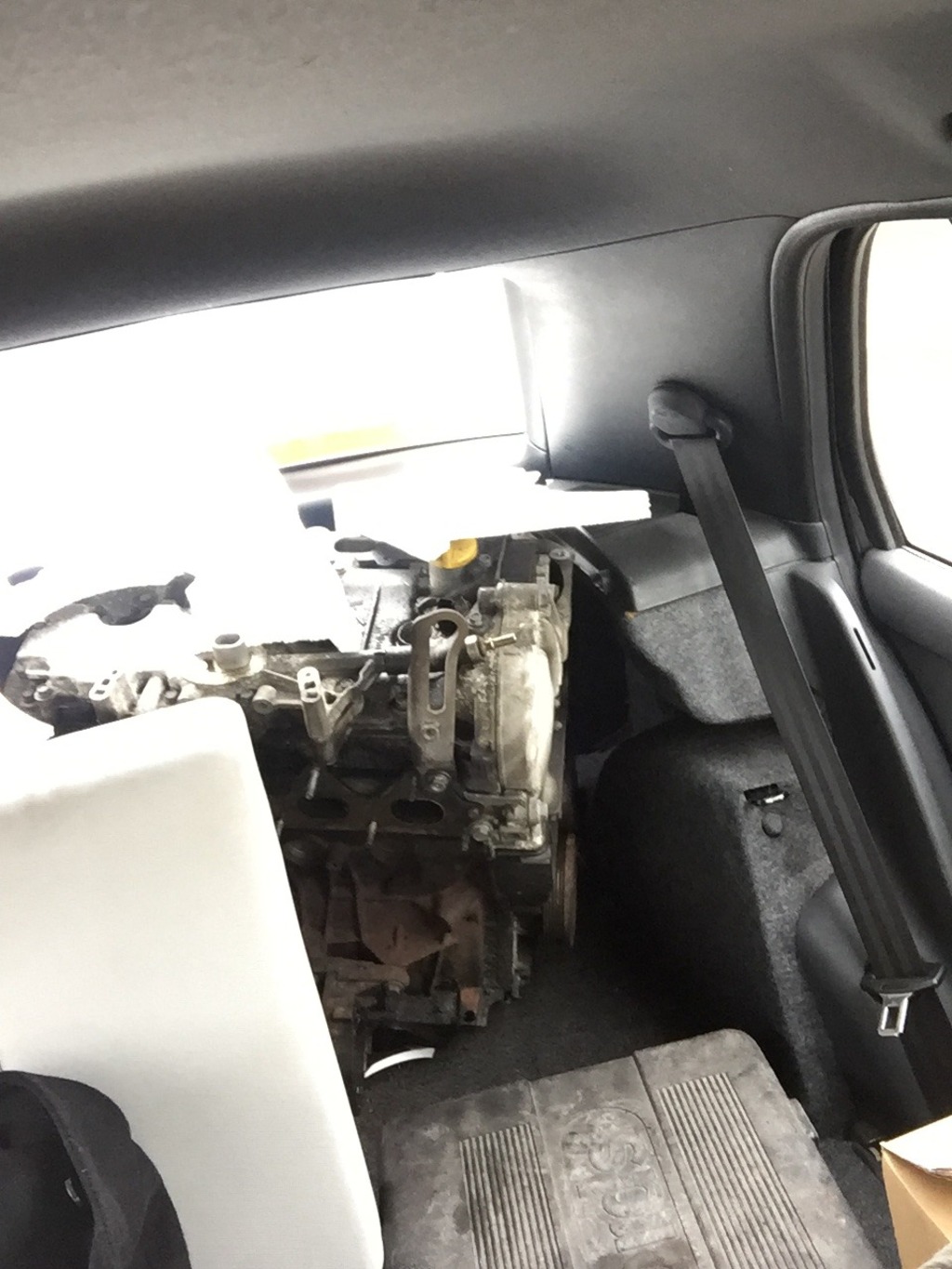

After speaking to Dan it was decided that the easiest solution was to get a replacement engine rather than trying to strip this one and rebuild it and then he would re-fit all my parts over, the starter motor power steering cams new belts etc etc
It just so happens that during the road mapping that the car was spotted by another forum user:
So I managed to source an engine out a recently stripped Clio which had 96k on so a fair few miles, a bit more than I would have liked but the cost of the work plus the engine was really beginning to add up. I have been assured that the car it came out of ran well and it was only stripped due to being worth more in bits. So after a 1.5 hour drive to Wales and back I picked up the replacement engine for £200 cash.
Dan started replacing the engine today and has assured me that it will be ready for Bedford this Saturday :smile:

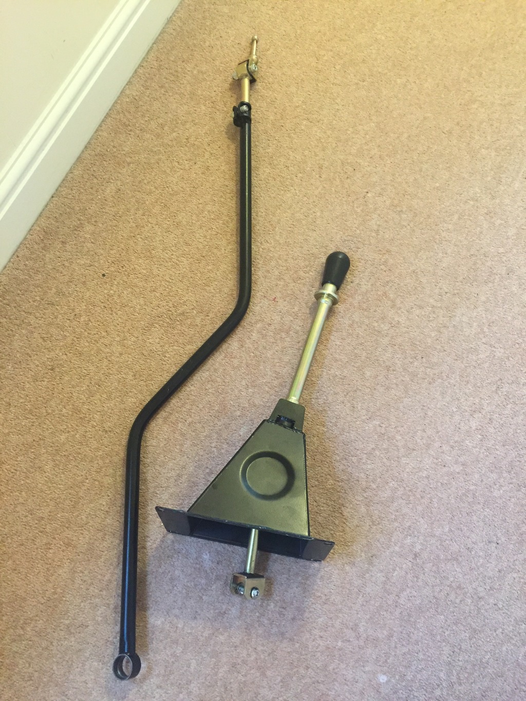

I have also managed to pick up a PMS shifter, the BMS shifter I had was a great improvement but I am hopeful this will be even better.

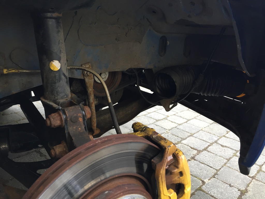

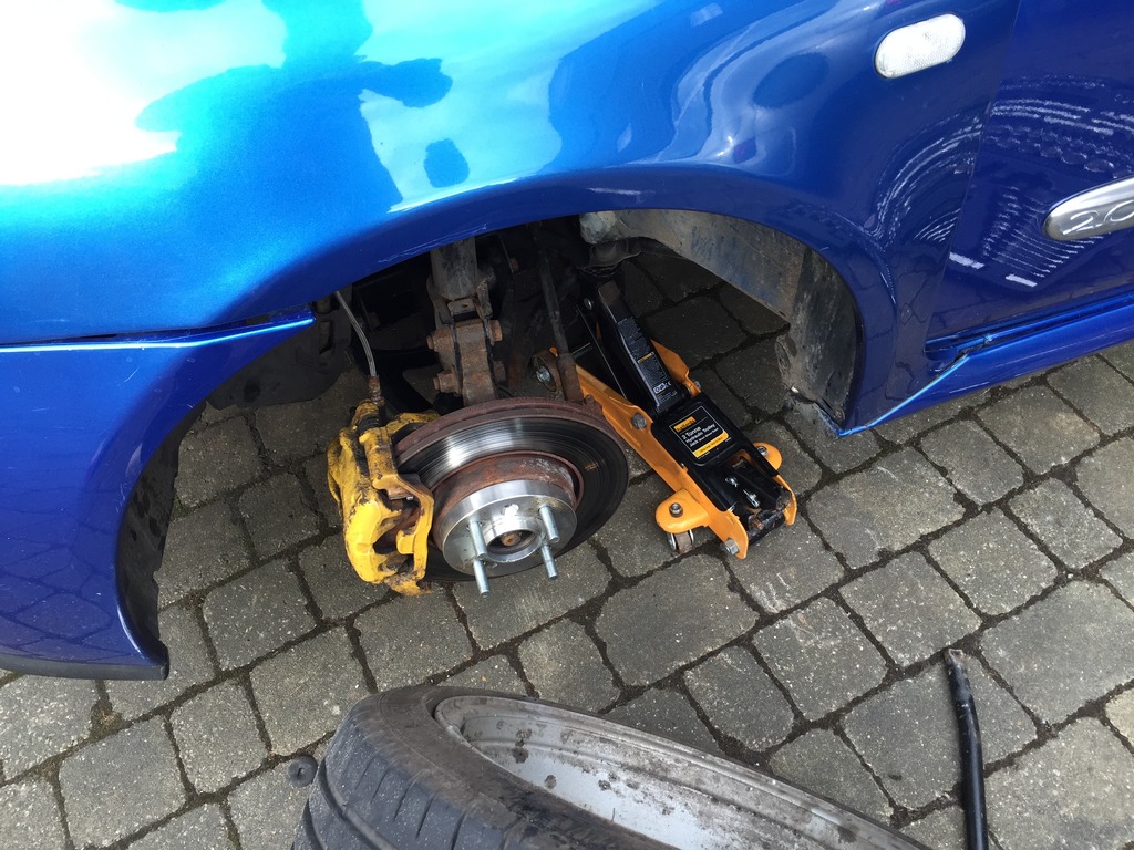

So few photos, new solid engine mount is in:

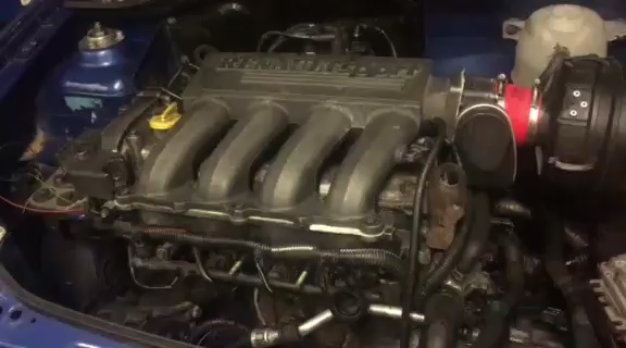

Engine bay as it is now

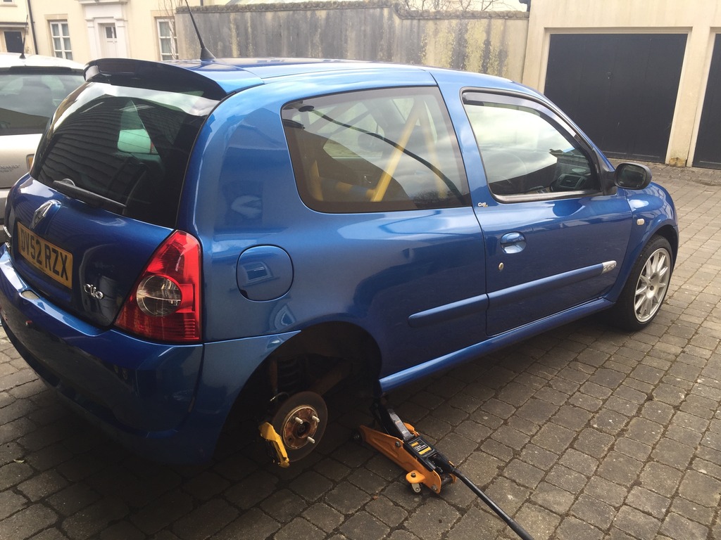

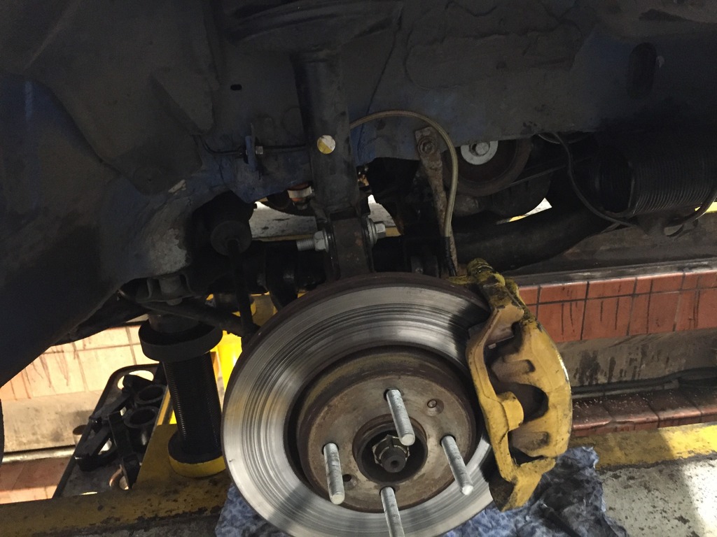

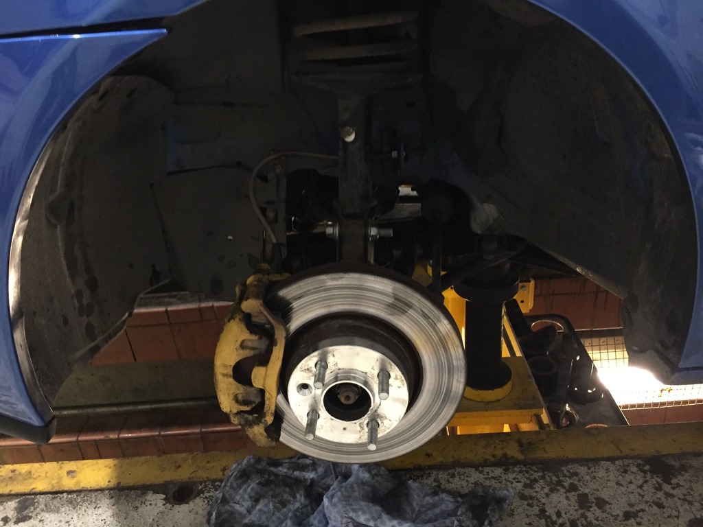

Fitting the 50mm studs to the rear

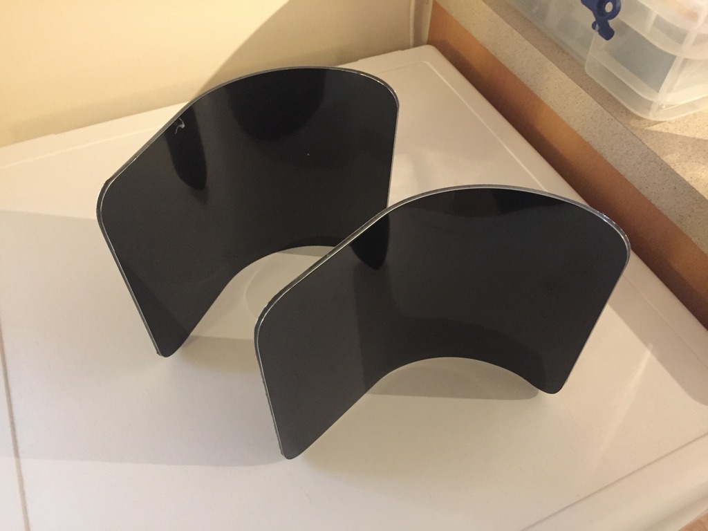

Lining up the air deflectors to see how and where I will fit them, should have them on tomorrow
On the front I did have 10mm spacers but I purchased 80mm studs so that I could also trial my 20mm spacers. First photo is with the 10mm fitted and the second with the 20mm spacers:
Rear with the 50mm studs

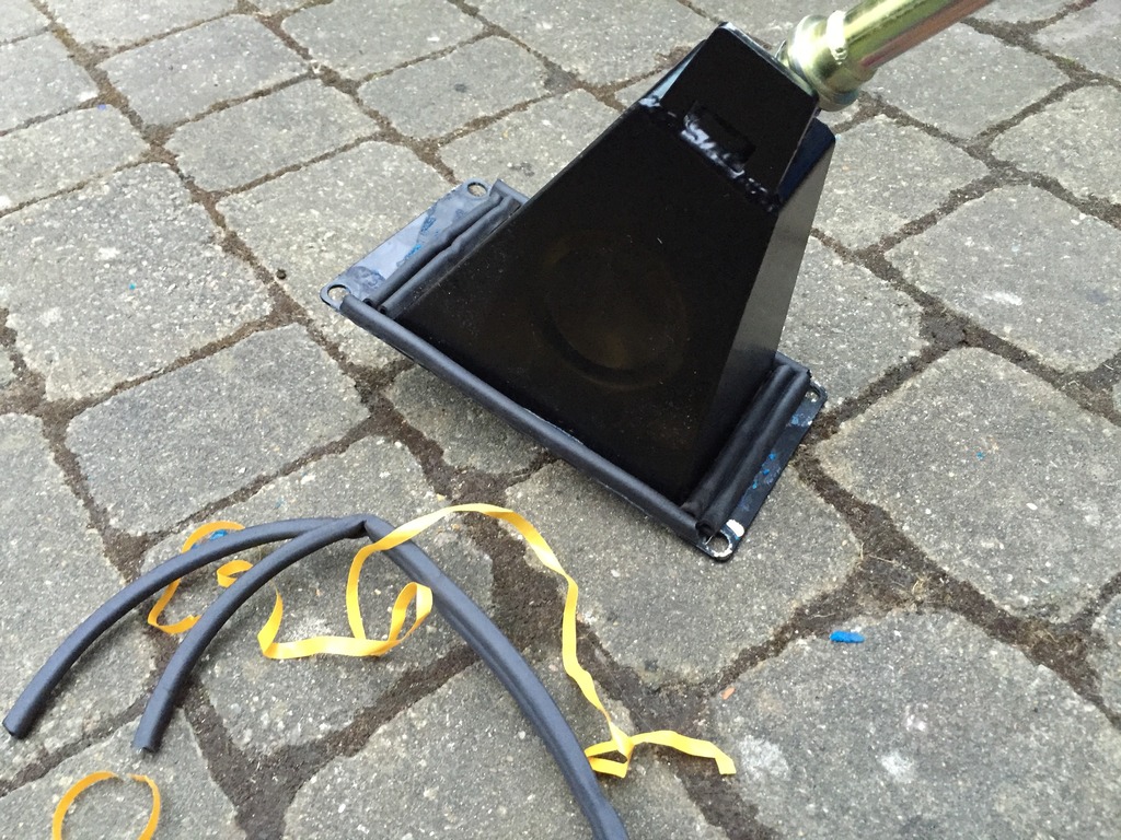

I have fitted some rubber trim to the PMS shifter where it will meet the body of the car to hopefully eliminate any potential vibration

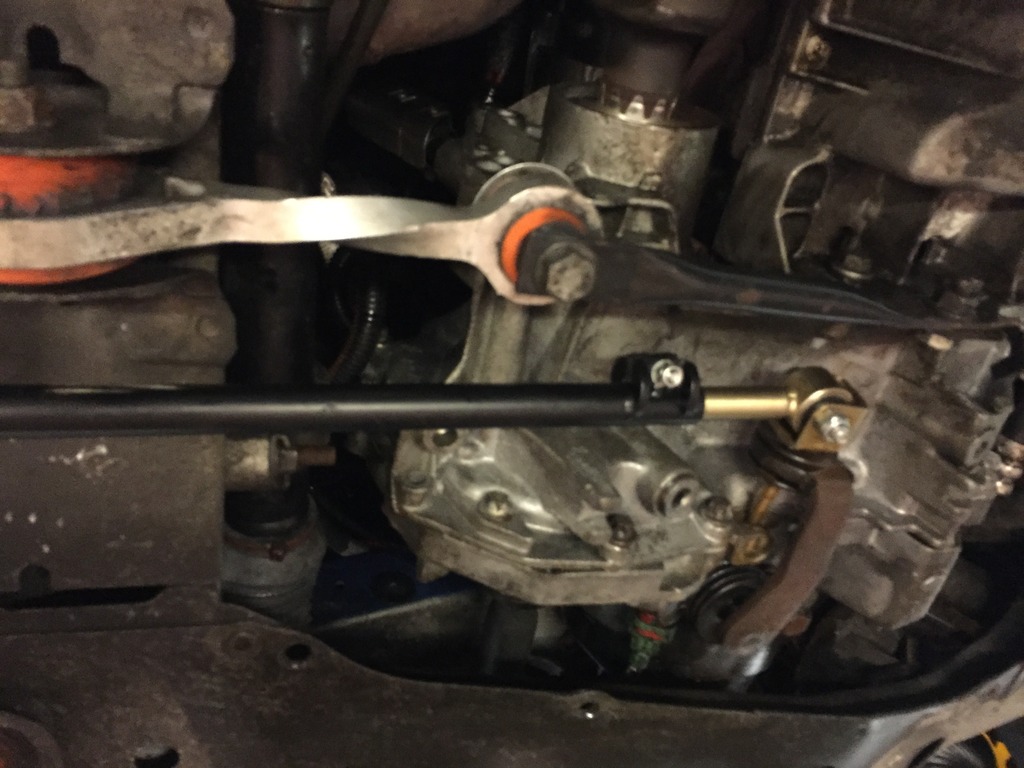

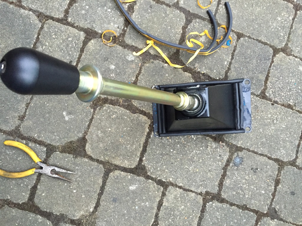

A very successful day, sorted out the PMS shifter, took around 40 mins of fiddling to get it to go in to all gears:

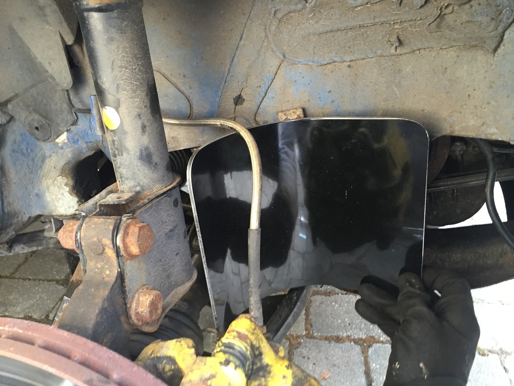

Heat shield bent in order to stop it coming in to contact with the new selector rod

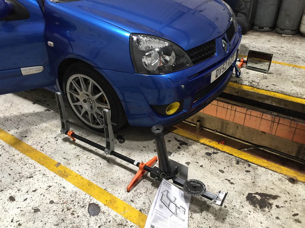

Replaced the braided lines and re-bled the brakes, as well as fitting the camber bolts

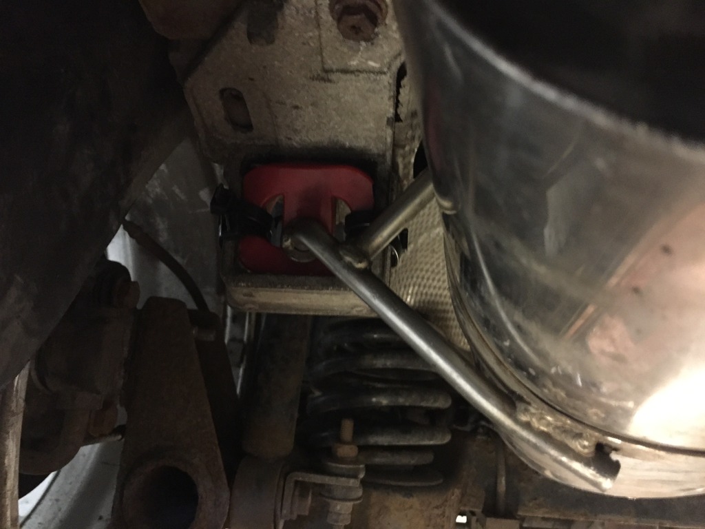

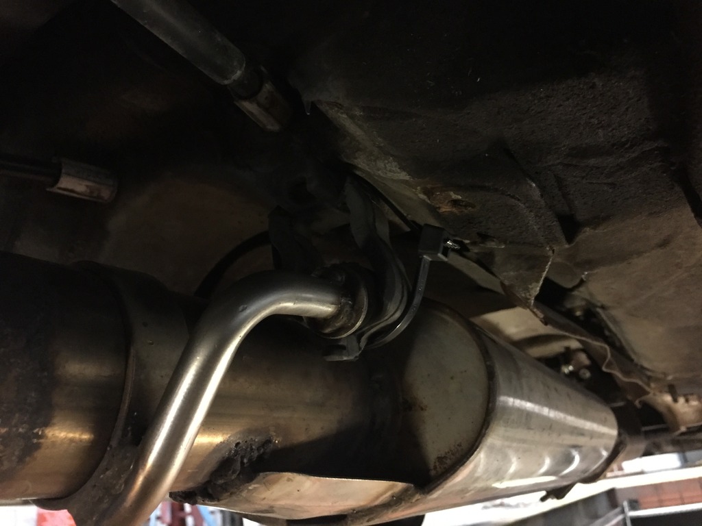

Rotated the rubber exhaust hanger round 180 degrees to drop the exhaust away from the underside of the car slightly as it was vibrating on the body of the car occasionally.
Zip tie on the centre section rubber just to help minimise the movement

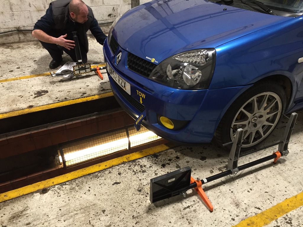

Then it was on to the tracking which was out by a country mile,
When adjusting the tracking I / we forgot to ensure that the steering wheel was held centre, so even though we got the tracking spot on (2 degree camber 1mm Toe) the wheel was on this ****, however it was to late in the day to adjust, on the drive home the car felt great, equal breaking when on the brakes and car pulling straight.

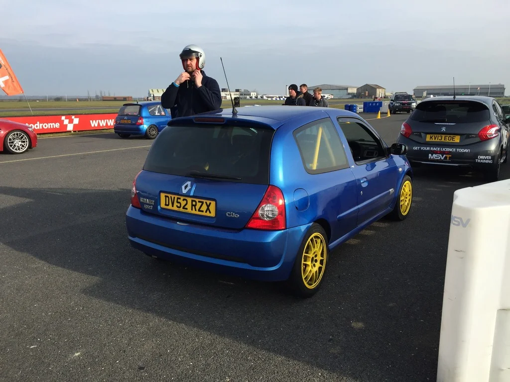

So we arrived at 8:20am just in time for the briefing, I had been on the road at this point for 3.5 hours so I was a little tired but the adrenaline started to flow and after a coffee and bacon sarnie it was time to get ready.
(Note: DB test saw the car at 88.4DB)
We went out for the sighting lap on the return we swapped over to my track wheels with the at this point pretty well worn R888 tyres.

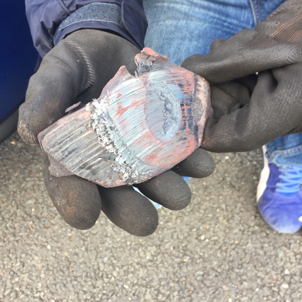

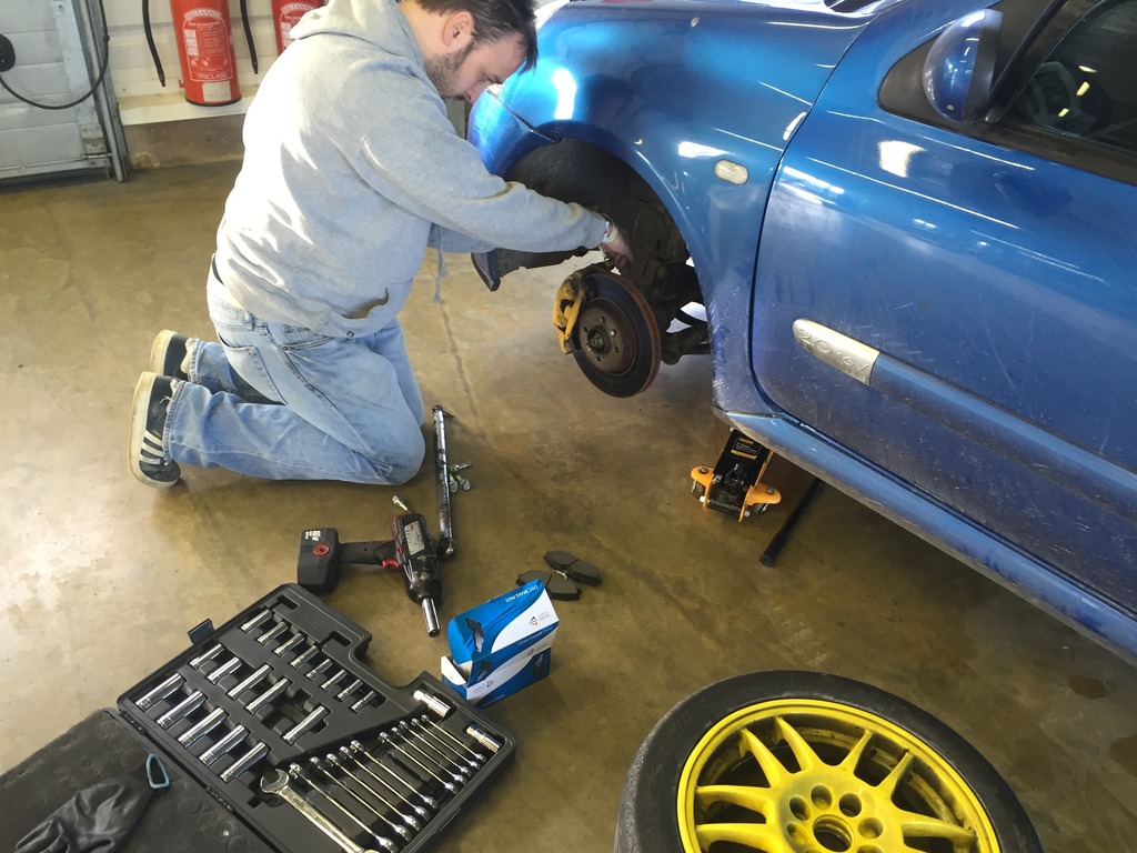

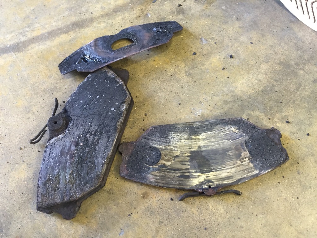

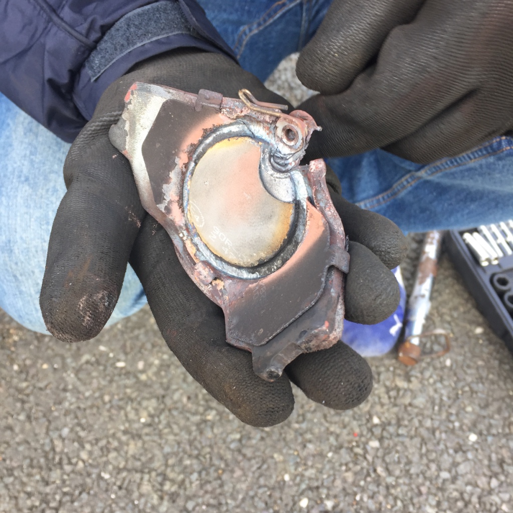

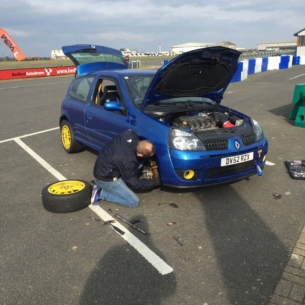

It then became quickly apparent that we where struggling for brakes (I had previously fitted some Nippon £14.99 pads at Rockingham a month earlier) I knew the pads that where on the car where **** and would need replacing at some point so I had a spare set with me. HOWEVER what we hadn’t realised quite how quickly they went off, check these photos:
So after around 15 mins a side and just before lunch we swapped the pads over to some part worn (90% left) pads to get us through the rest of the day.

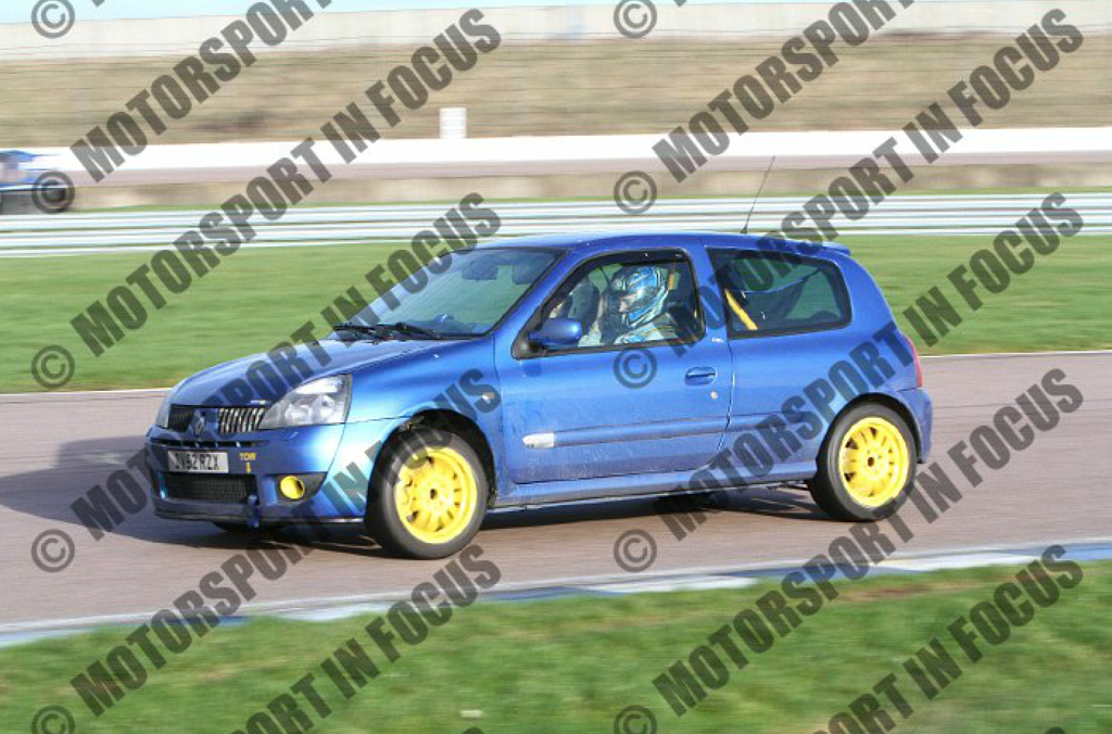

A few last action shots of me in the late afternoon.

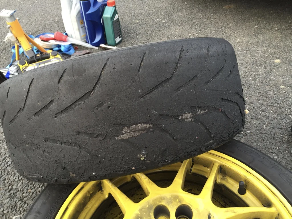

Towards the very end we where vary aware that the grip levels where shot and we knew the tyres where destroyed so on the last few laps we had some fun getting the car sideways as we where no longer able to get any decent level of grip. SO its fair to say I got the most out of the tyres, on the long straight under the hardest braking on the circuit we where shutting down from around 120mph and my pedal went to the floor and we had to use the escape road as I couldn’t shed the speed off for the 90 degree left hander, at this point we knew it was time to call it a day.
We also checked the brakes when changing wheels over and we had got through the other set of pads on the front, as advised Bedford is VERY hard on the brakes, especially when using cheap or OEM pads. I had my three hour drive home with partial pad on drivers side only and managed to only use the brakes under around 15 times.
