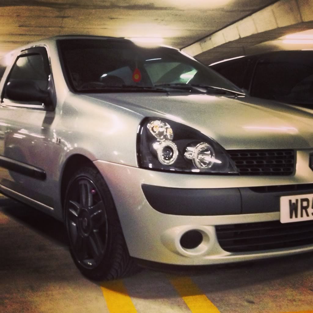

and a cheeky picture in the morning sun

Nice car mate ! But way too high with 16" ! :p Also need some colour coding. The only fault IMO is the angel eyes. But it's your car. ;)

Desperately wanting to lower my car, arch gap is hideous! Saving at the moment for coilies :) ah I know angels are very marmite like, but they're to my taste :) for now ha! Colour coding is on the cards for January along with lowering my car, I just hate waiting!

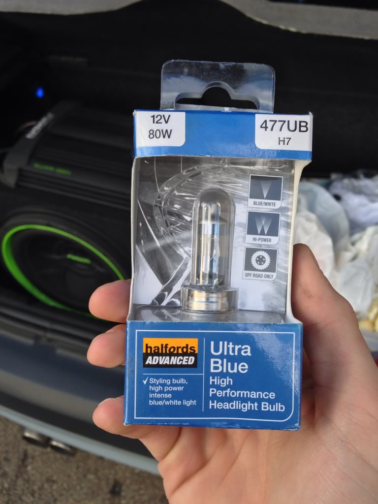

Due to alot of questions here are the non hid bulbs which are effectively hid worthy. Can't tell the difference between my mates hid kits and my standard headlight bulbs
heres them in action. As you can see a blueish white colour. No yellow
They are more noticeably white than yellow yes, but compared to a pair of hid's they look poo haha! But the flood of light you get is good and good visibility. A lot better than the standard yellow.
If you want a nice clear white, I would get these lazer blue 150% ultra brilliance bulbs I'm using. I got the from halfrauds - don't even need a hid kit now - compared to my mates headlights you can not tell who has hid's and who hasnt! I would recommend them over osram anyway! Best £30 spent. Cheaper option is the osram a ofcourse :)

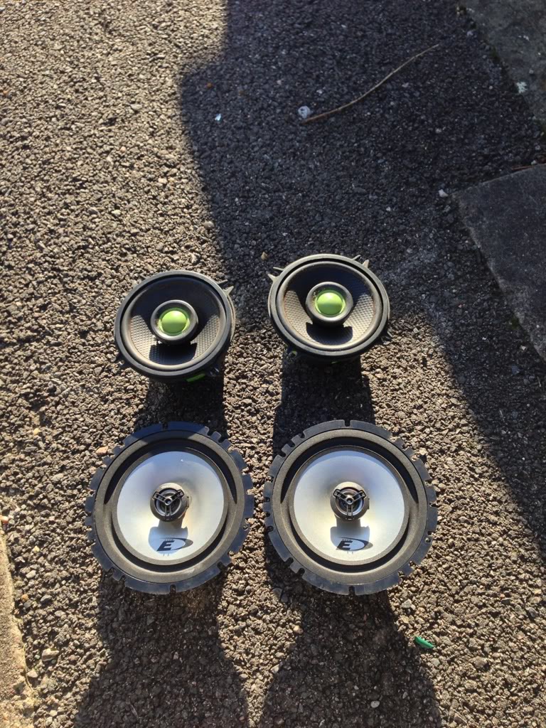

So yesterday I was down a breakers looking for some parts for my mates corsa. Spotted a destroyed black 1.2 clio - had a cheeky look inside and found myself some alpine front door speakers and some fusion rear door speakers. Googled them and the splines retail at £100 and the fusions retail at £80... Spoke to the chap "how much for these standard speakers I found mate"... Bit of haggling later walked away with £180 worth of speakers for £20! Result. Here's how they look
Had them fitted with the help of my mate in about half hour. Nice and easy. Here's the finished look:
Front alpines
rear fusions
and the sound quality out of these speakers is amazing. So much better than standards. Alot crisper and clear around the whole car now. Really chuffed I went with my mate :)

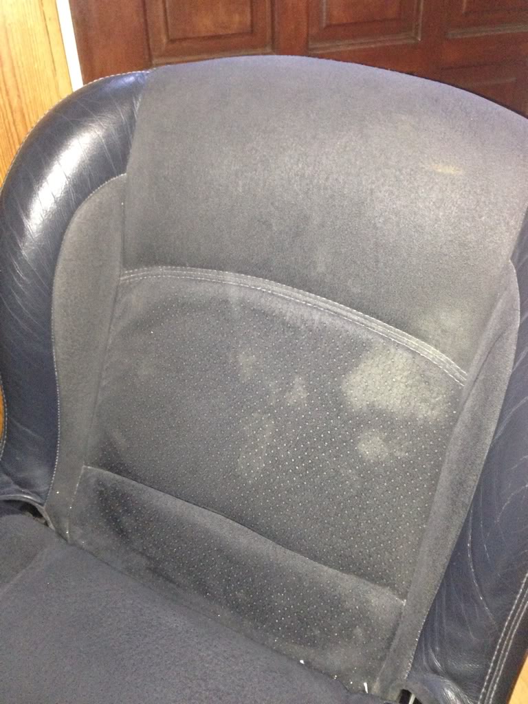

Next major change is my half leather interior from a 172. They were in pretty poor condition. Stains and major bobbling on them. Got fronts seats, rear bench, front and rear door cards, parcel shelf for £120. Not bad considering the condition of them. Here's an idea of the state they were in.
So these stains were pretty much all over the front and rear seats.
And same scenario with the bobbling, front were worse than the rear.

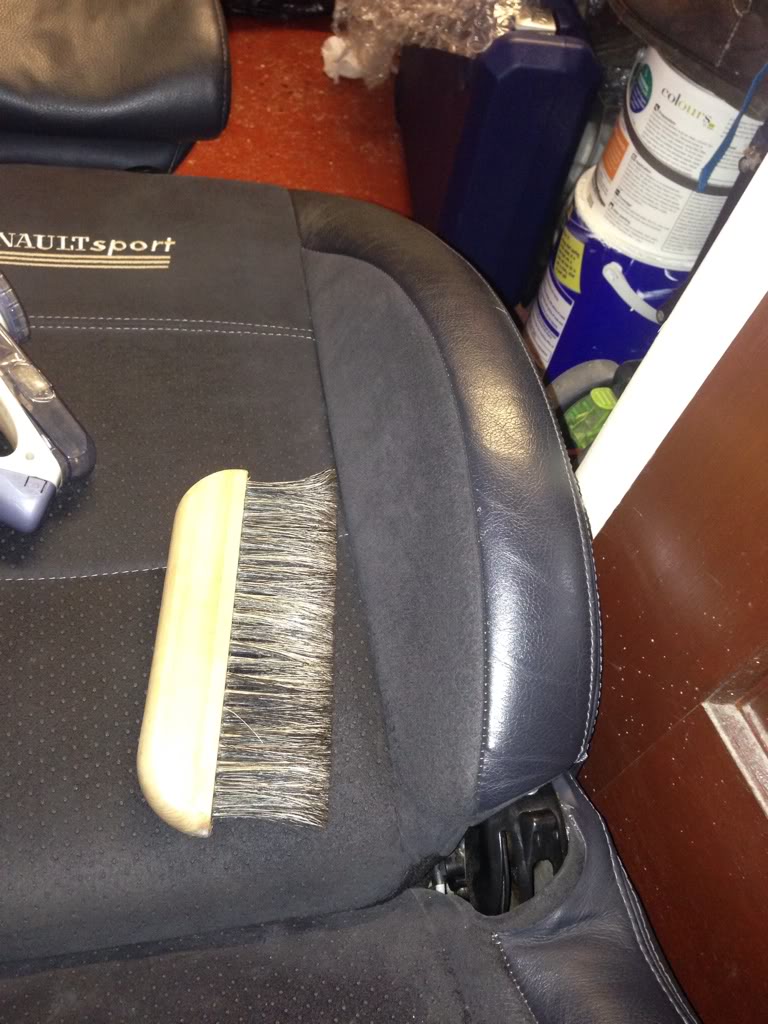

So to remove the bobbles I used a "debobbler" bought off eBay for a fiver.
Proof it works
All of that was clearing bobbles off one front seat! At first I was a bit dubious but soon discovered you have to be forceful with the debobbler to get the job done!

Now for those dirty stains. Looked up a couple of threads, found a Ferrari thread and a Honda type r thread and they suggested that "woolite" is the best stuff to use on alcantara. Ordered some off amazon.
First I wetted the seats with a microfibre cloth and water.
Then sprayed the mixture of woolite and water on in sections and lathered up into soapy foam on the seats. Left for 15 mins and then wiped off as much of the soap as possible. Remember to empty the water when it gets dirty.
Then left to dry, can be sped up if you have a electric heater or something along those lines.
Here's how they came out. Really impressed with them! Didn't expect them to come up as good as they did. Practically new apart from the minimal bolster wear on the leather!
