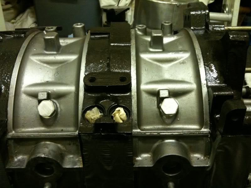

anyway some little parts turned up today (pretty small parts but some might find interesting)
had a kit sent for removing the OMP (pictured on page 1)
lazer cut plate
hand machined caps to go in where the old oil injectors were.
rear oil drain block off plate
as its twin turbo stock the rear turbo drains its oil in where the plate is now... so this plate blocks that and solves that issue :)

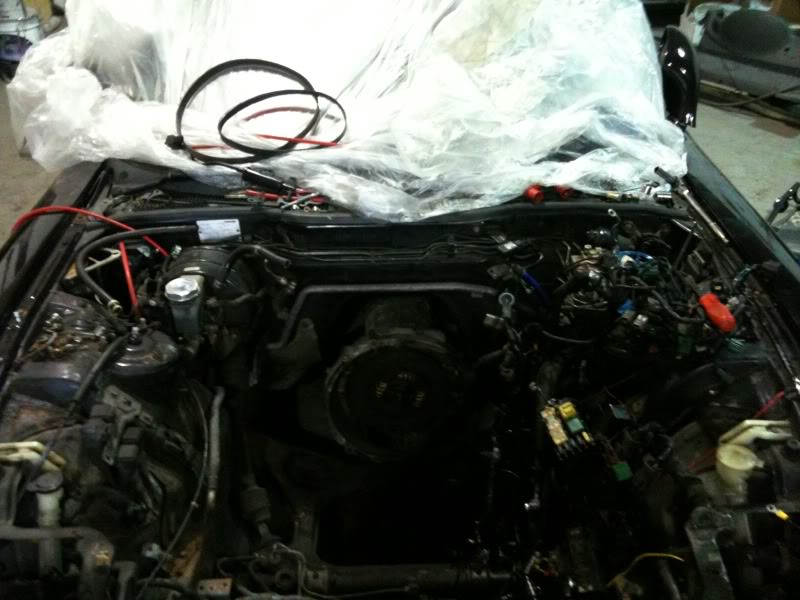

engine is out :D
got pretty much everything (except turbo the volcano has fucked up that getting here) so just gotta clean parts and paint some stuff, i will post up pics tomorrow of the other parts going on :)

once you find all the hidden hoses and stupid clips to disconnect, undo the bell housing, undo the 2 nuts that are on the engine mounts it swang out in 10 mins lol! rest of the day was spent stripping the old engine to take parts home to clean, garage is full of parts, inlet mani was all dirty... found some oven cleaning stuff, said use gloves, i though naaa im manly, i touched the gel and it stripped my skin!

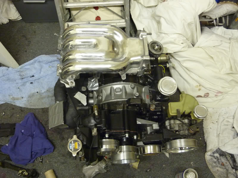

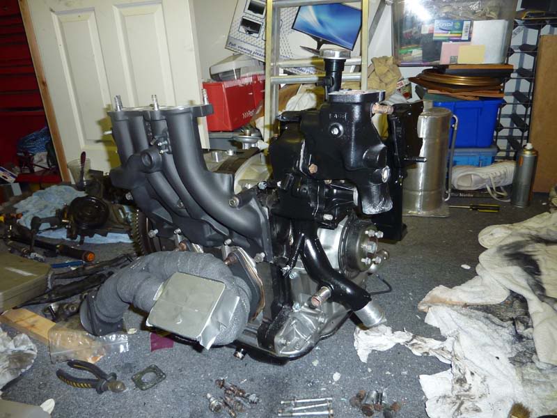

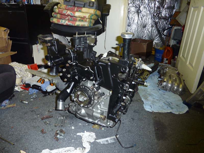

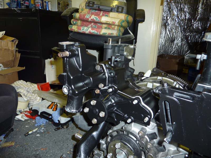

UPDATE!!!!

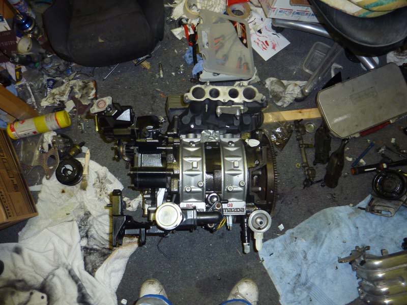

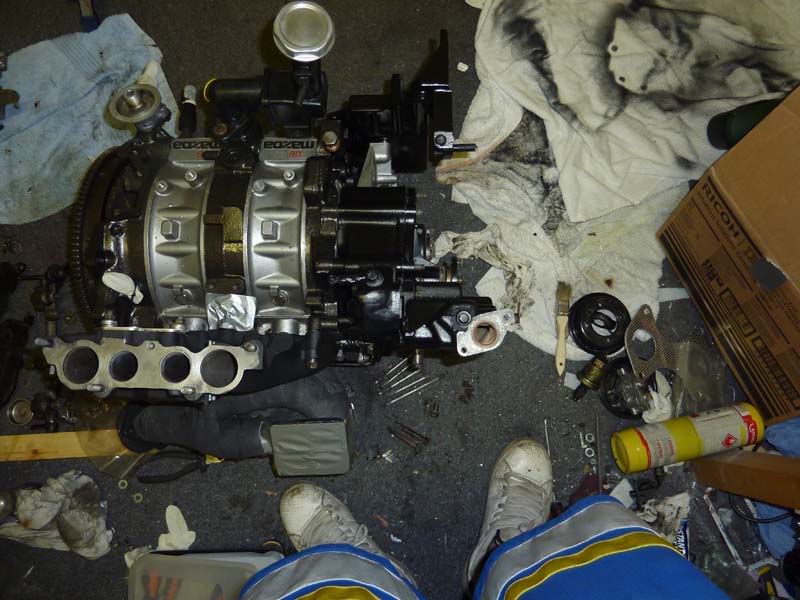

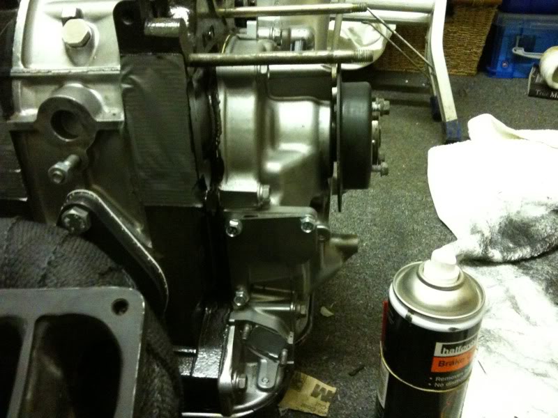

engine is looking a bit bigger now! been painting up the waterpump housing and lower inlet mani etc!
all the mani etc is only loosely bolted on, just seeing what it looks like, need to get the gaskets etc for the water pump before i can bolt it up, also gonna replace all the nuts and bolts with shiney new ones if i have time :)
couple more pics...
on the water pump housing there was a bracket that isnt needed was for the air pump, as i dont run one and never really have i chopped it off and filed it down just to make it a bit smoother :)

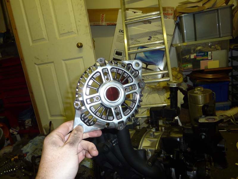

also polished and painted (couldnt get in the grooves with my mop) the alt housing...

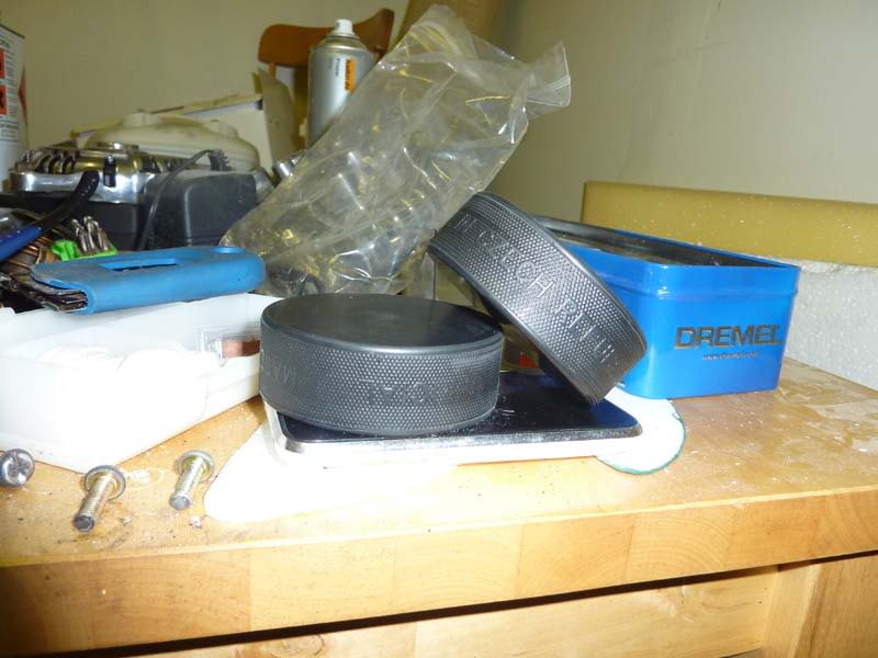

also if anyone can guess what these are, and what they are for you get a goldfish lol!
wozza got it, its hockey pucks.
its an american thing, i was gonna run solid engine mounts (ali ones) however they make a s**t load of noise and shake the car like mad, rotarys have alot of spinning mass... so you take 2 hockey pucks (4 all together, 2 either side) drill a hole through the middle, put a big washer on the side that touches the mount, bolt through the mount, through the subframe and stick a nut on the end :) almost solid engine mounts with vibration dampening!

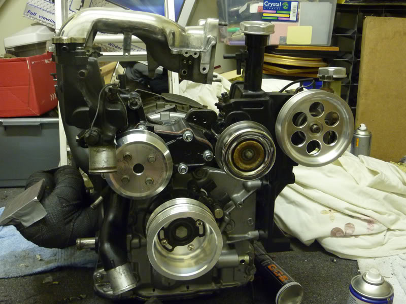

some new parts arrived, billet pulleys etc... polished up the upper inlet manifold, and also the power steering belt tensioner, gonna polish up the oil cap and ps fluid cap... also got a brake fluid cap to polish too!
STILL waiting on the turbo! which i will polish the compressor housing on its supposedly being shipped to the suppliers on tuesday then sent to me after that...
