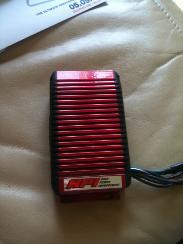

this turned up today, its a ignition amplifier, need this as the more power the engine is pushing, has a tendency to blow the spark on the plugs out... especially running water injection also...
so this makes the spark s**t loads more powerful :)

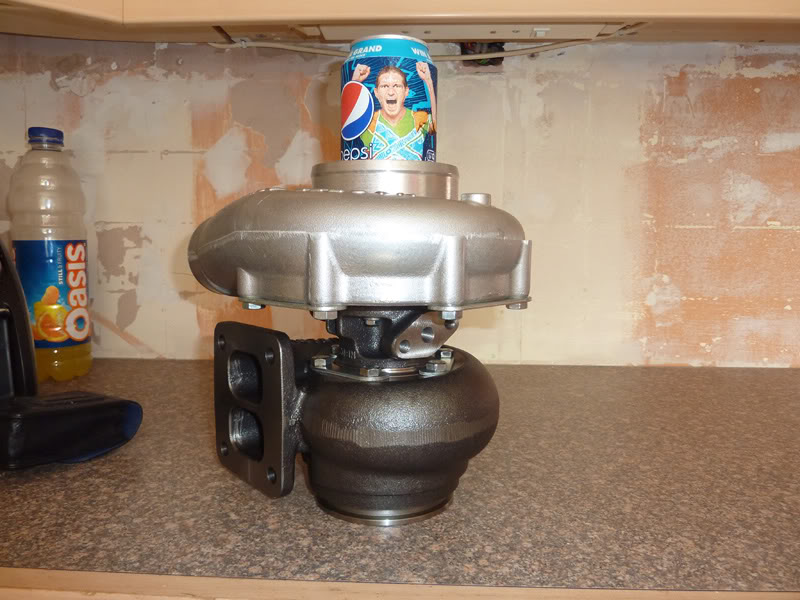

today is a big day... the turbo arrived!

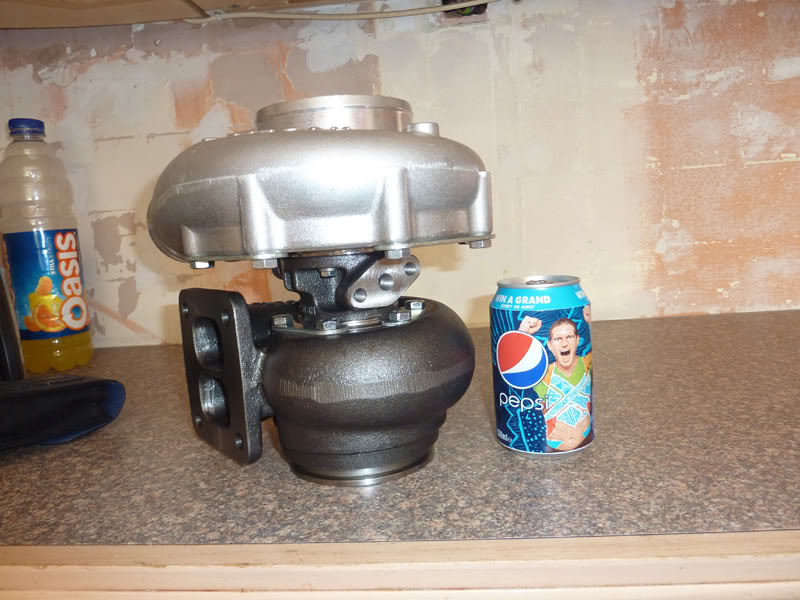

i saw the size of the box and thought OH s**t! the box was massive, on opening it.... the turbo was equally as big!! this thing is ridiculous i have seen bigger but never did i expect it to be this big never EVER lol!

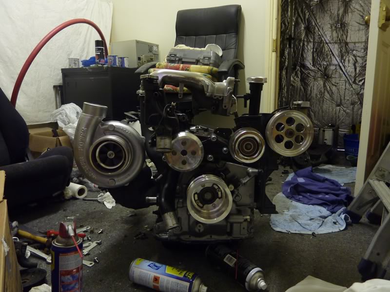

it fits JUST! had some calculations done last night i should be roughly seeing 470bhp at 1 bar, and 530bhp at 1.2 bar!
gonna pop and get some studs in a bit to fit it to the manifold will update once its done lol!

Turbo looks huge!
its being decorated hence the way the walls are... waiting for the plasterer but thanks for your input lol.
Nope not watercooled no... It's a big ass truck turbo that's been re engineered used on a fair few drag cars.... Gotta take core off and rotate everything so it fits :) but was just checking it actually fitted the engine lol!! It's basically ready to fit now! Gonna go over Monday and do a few jobs on the shell then engine over mid week to get it swung in :)

I've been trying to kill mine for 2 years, all that ever goes is the f**king turbos! How much was the truck turbo malice? it'll be too big to be usable on the CA I'm sure but would be worth a look for next time haha
lol a ca or sr or even a rb wouldnt spool it! im serious you wouldnt even get a tiny amount of boost before redline!

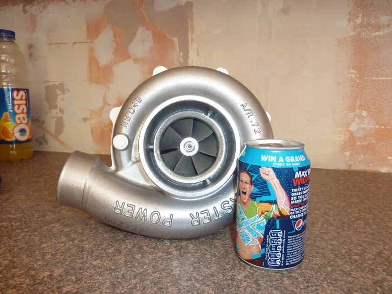

rotarys chuck out so much air its the only reason i can run it, this is big even for a v8 lol! most v8's run the t70 p trim which is smaller wheels than this has lol!
its a master power turbo you looking at $700 ish for it, i got it and didnt get any import duties but i had to wait over a month for it... its a similar size to a hks t51kai which is a HUGE turbo lol! tbh its more to do with the rear housing than anything, im running a t4 rear which is divided so each rotor equally spins it and its a 1.00ar i think the biggest ar i have seen people run on ca's and sr's is a 0.70ar and you wouldnt run t4, t3 would be more suitable, they do a t60 that would be ok but tbh, on a sr or ca i would run a holset, £450 will get you what you need and run 400ish bhp.
I had a feeling the one your running would be too big for a CA if it comes off of a truck :D but Im sure the same supplier could do a more appropriate turbo without costing the £650+ for a decent turbo on the S13. I'm still just learning about turbo's, I just about understand how they work in the simple terms and how they fit on the engines lol, now I'm trying to 'learn' all the different sizes and dimensions of turbo's for all these tech specs and magical figures etc that comes up. The ar numbers and housing sizes at the moment are still completely lost on me haha. I've upgraded to a T28 for ease and that should see me happy with the CA as it should see me upto 280ish and then if the turbo and engine see me through I'll be keeping hold of all my monies for a 1UZ :)
