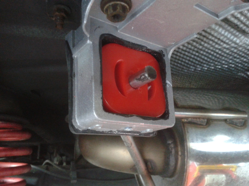

Following on from a thread i read the other day ( http://www.cliosport.net/forum/show...ified-exhaust-mounts&highlight=exhaust+mounts ) , i decided i needed to sort out my two rear mounts.
Only difference i did was put a screw top and bottom instead of cable tieing the powerflex mount in place, which imo looks 100% better.
No extra boot floor vibration either:). Also there is plenty of movement still so welds shouldn't be a problem.

Glad you're happy with them. The 2nd pair I made for another car are still holding out.
Cable ties were only a temporary precaution until I'd bonded them in, plus no one had done it before so I wasn't sure how they'd hold up. 1st pair only had cable ties for a couple of weeks until removed, 2nd pair never had cable ties fitted
