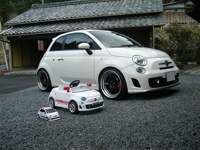

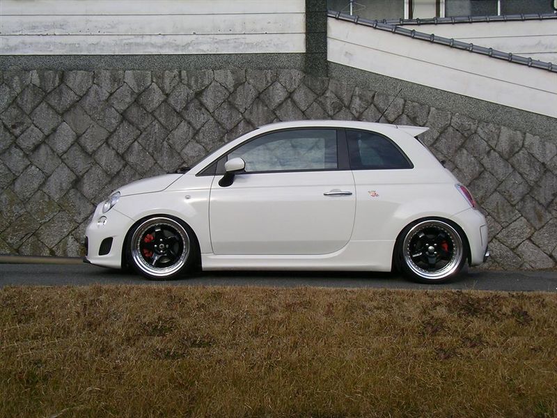

I'm probably going to go for the same wheels that the esseesse run or maybe some of these......
and youcan now buy the assetto corse abarth racing wheels but for road use
