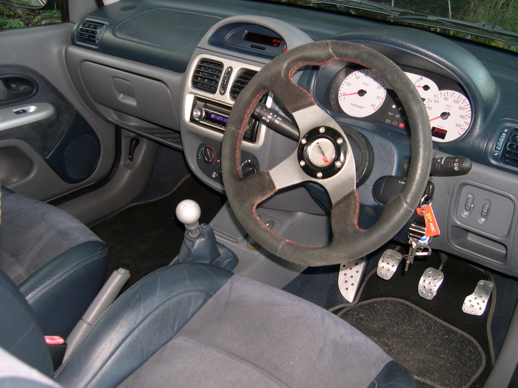

Some eejit has swapped out the steering wheel so no air bag. No horn, and whatever else was on the sterring wheel. In fact the steering wheel blocks out most of the speedometer on the dispplay!
No worries- easy fix in a nice twin air horn

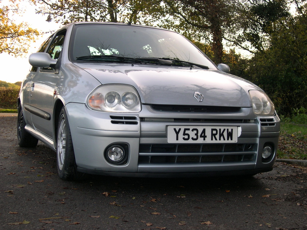

Machine polish tomorrow- spent 4 hrs today cleaning inside and out. Lovely blue inside on the half leather / seuede seats

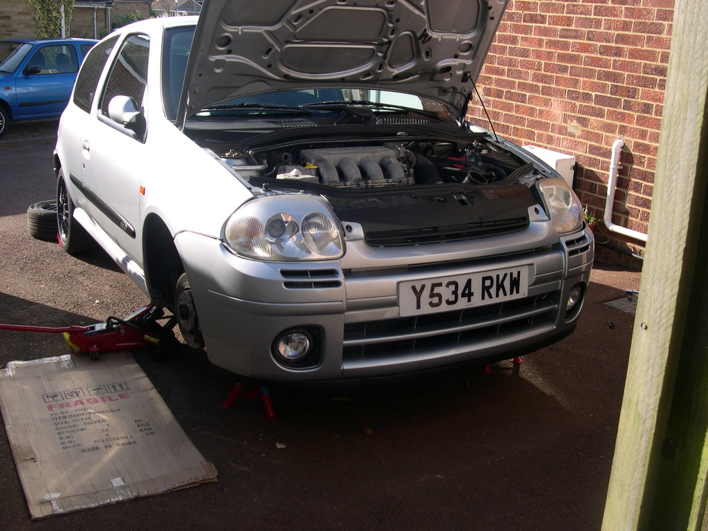

Only piccie i have atm- work to do ;-)
  Clio 182
Looks tidy, I was going to look at it but he didn't get back to me to make arrangements.

Hove. It was a bit of a mess when collected. 6 hours of washing and machine polishing, and engine bay clean. Another few hours sorting bits n pieces

More recent shots of mine- headlamsp need more work, its as if the discolouration is on the inside
Being real honest, it looks better in the photos ha-ha!
