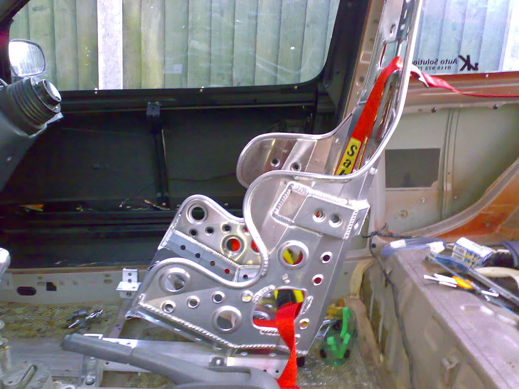

new seating for the clio TT
Clearly function not fashion but as said before i bet they are actually seriously comfy. Most of those kinda chairs are.

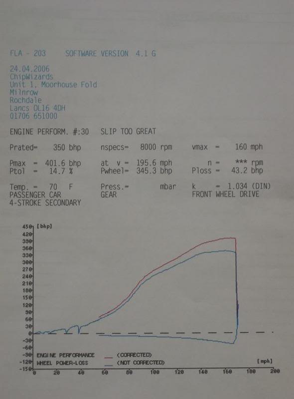

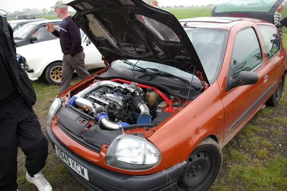

The car has been around since 1998 when it started life as a 1.2 grande clio owned by a vicar from scotland. I bought it as a cat D write off in 2001 and dropped a 172 conversion in it running nitrous ( 13.5's @ 106 )

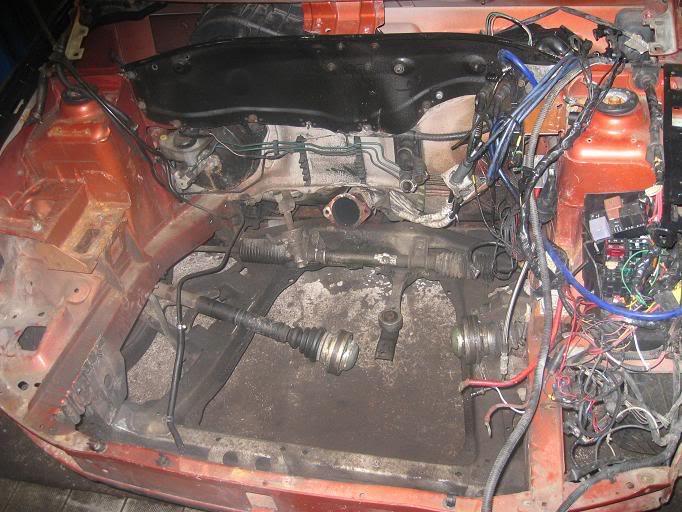

I pulled the 2.0 engine out in 2004 and dropped the Audi TT engine in and ran it with about 275 bhp to start off with. It gradually increased with severe mods to 330 bhp and then to 426 bhp with an IHI VF34 Turbo, steel rods and forged pistons. The top end is as stated nearly 200 mph ( on a roller )
The car is capable of a 10 second quarter - it really need converting to 4wd to achieve a low 10 - my mates car has a very similar spec and his is running 10.1's at the moment

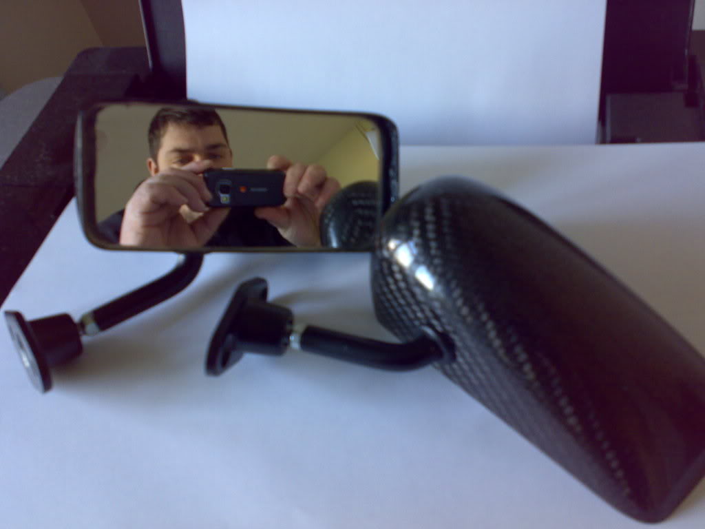

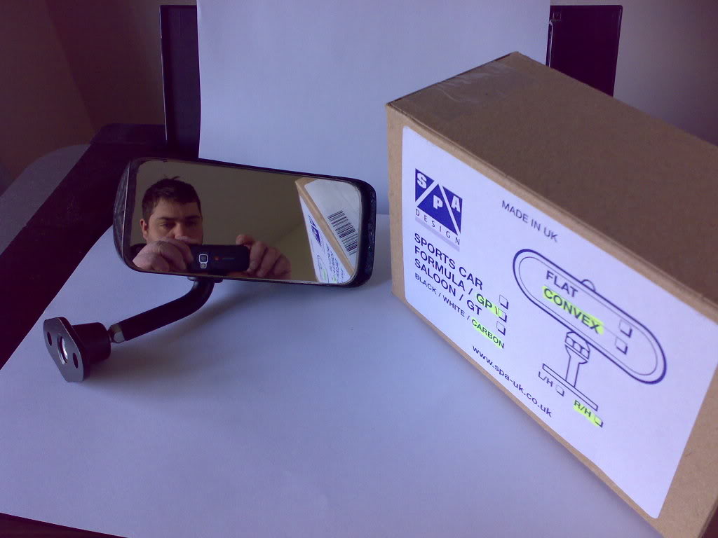

just a little bump......my SPA mirrors have finally arrived today, so ill be fitting these along with all the other stuff tomorrow:)

interesting! I had Cobra Monacos in one of my last cars and those where uncomfy enough for a longish drive, you will need a few pillows with that mate!
looks hardcore:approve:...edde will be pleased you mounted the harness in the correct postion :rasp: saves him having to post his diagram about it
did you mount the mirrors?
not yet mate, im still waiting on my polycarb windows to arrive, will be on with that next weekend:)

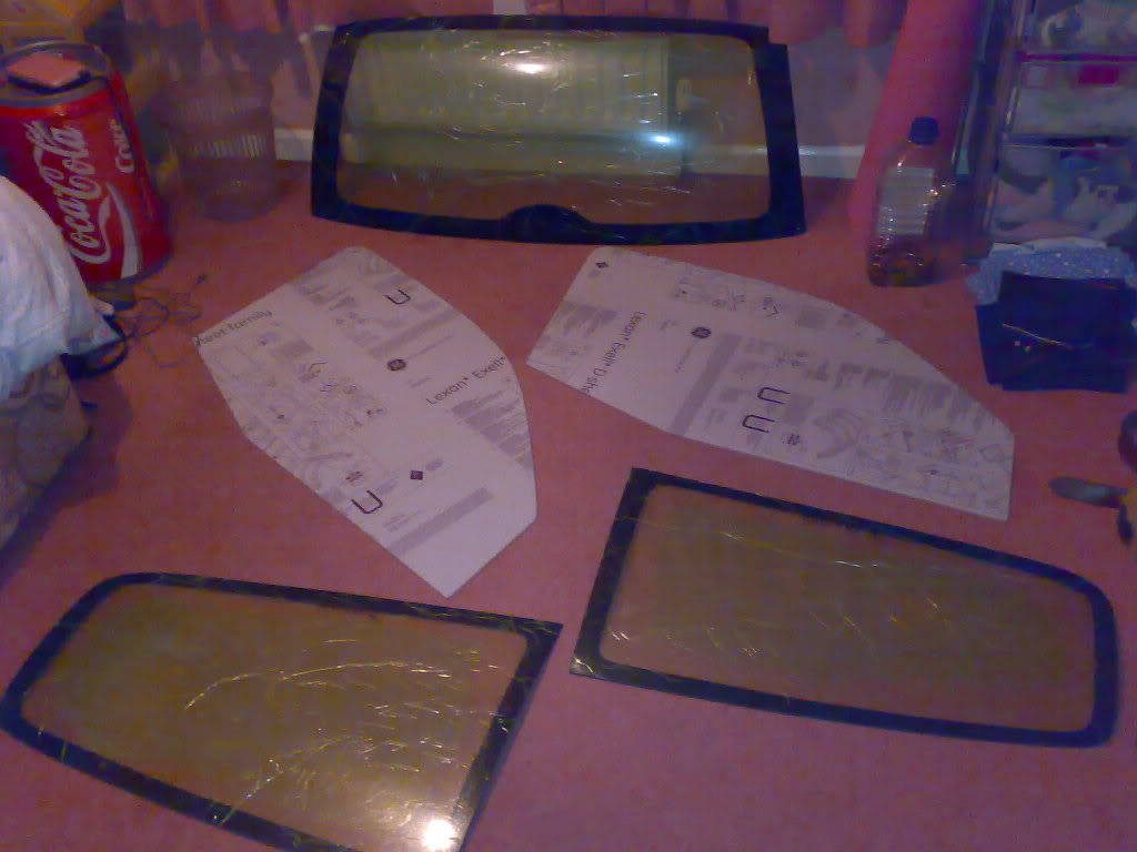

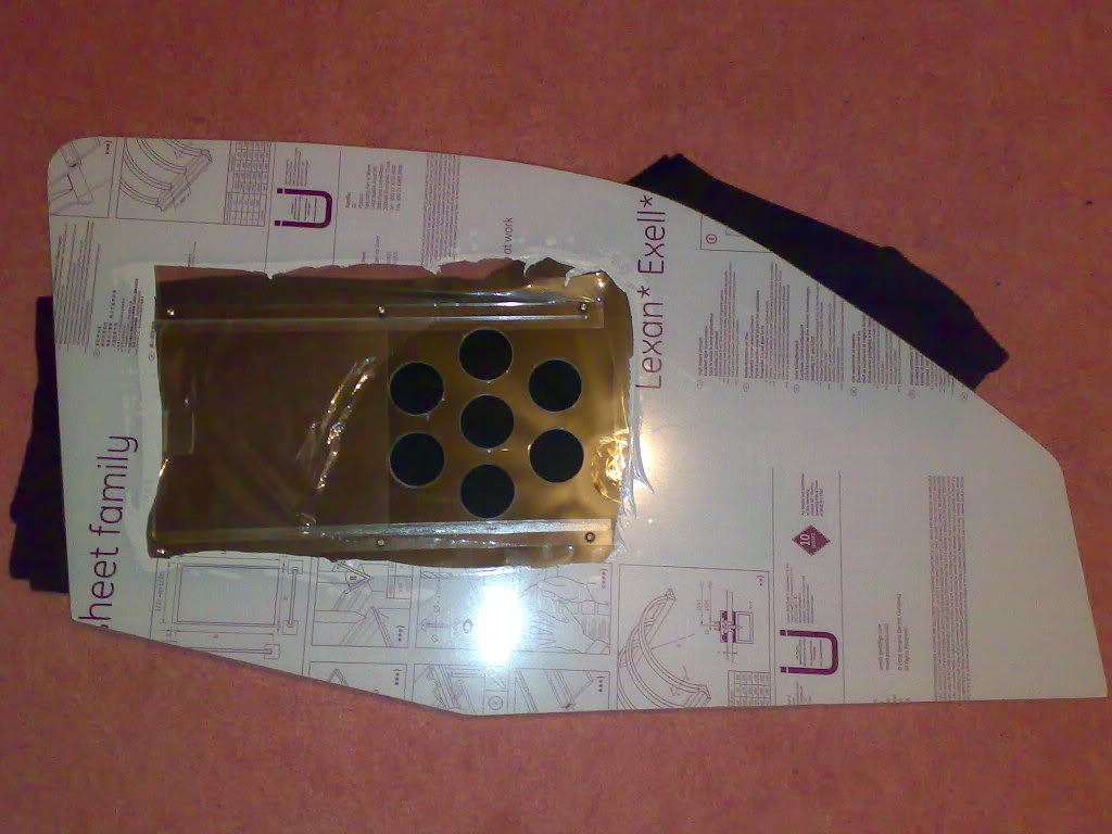

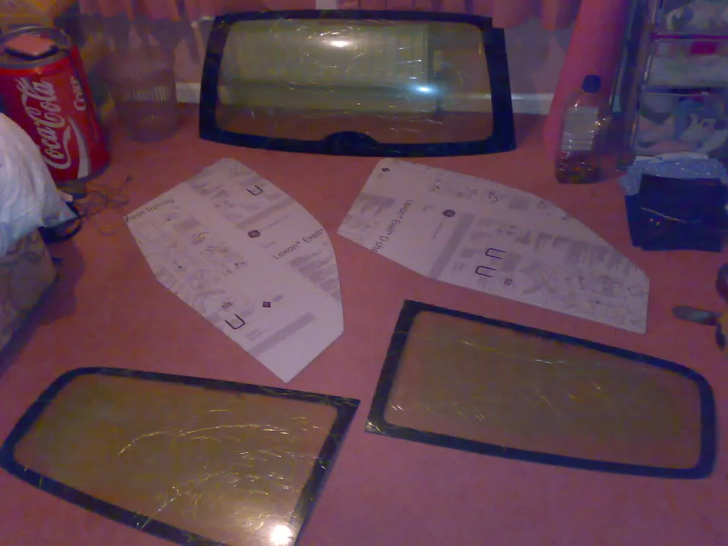

received some other goodies ive been waiting for over the past couple of days!! first out the box was these:-
full polycarb window kit....(plastics4performance)

this weekend will see all this fitted, then im finally ready for the mr mot man:cool: .....................................i think;)
