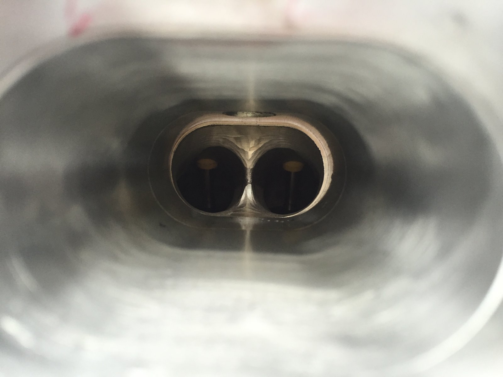

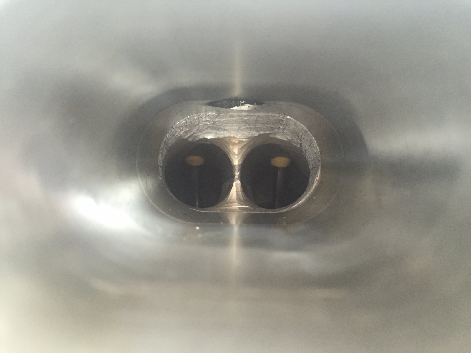

Just to inform people the ports will benefit from a little matching for maximum gains
Before:
After:
