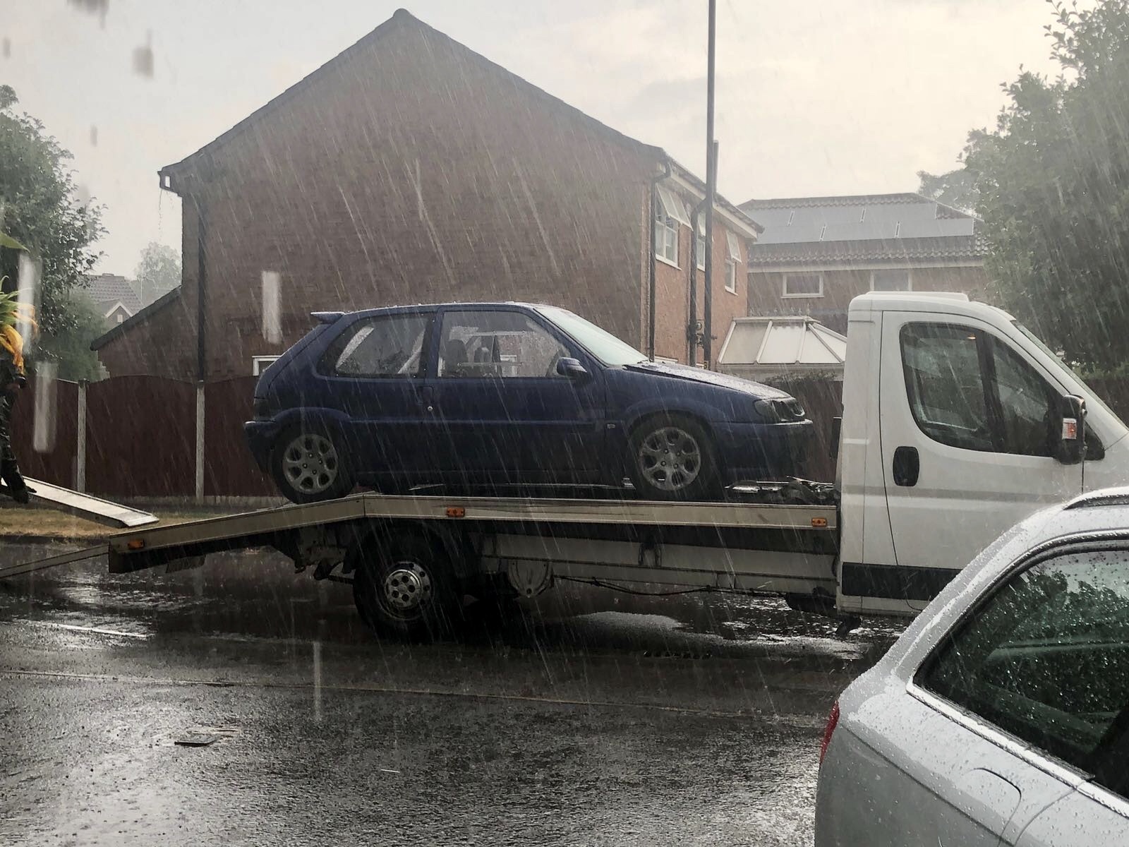

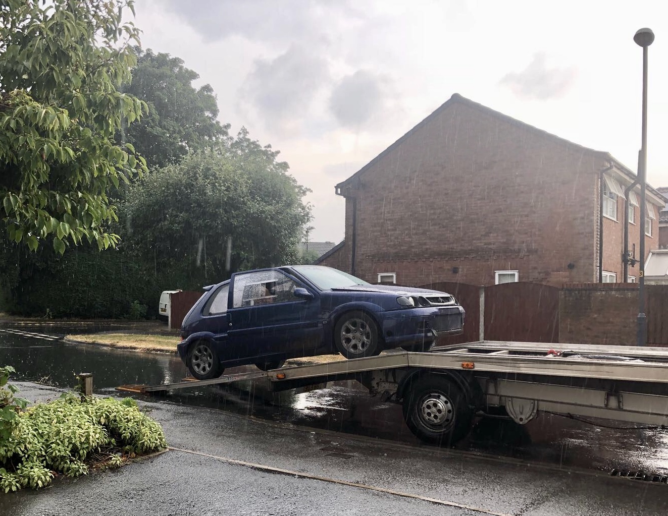

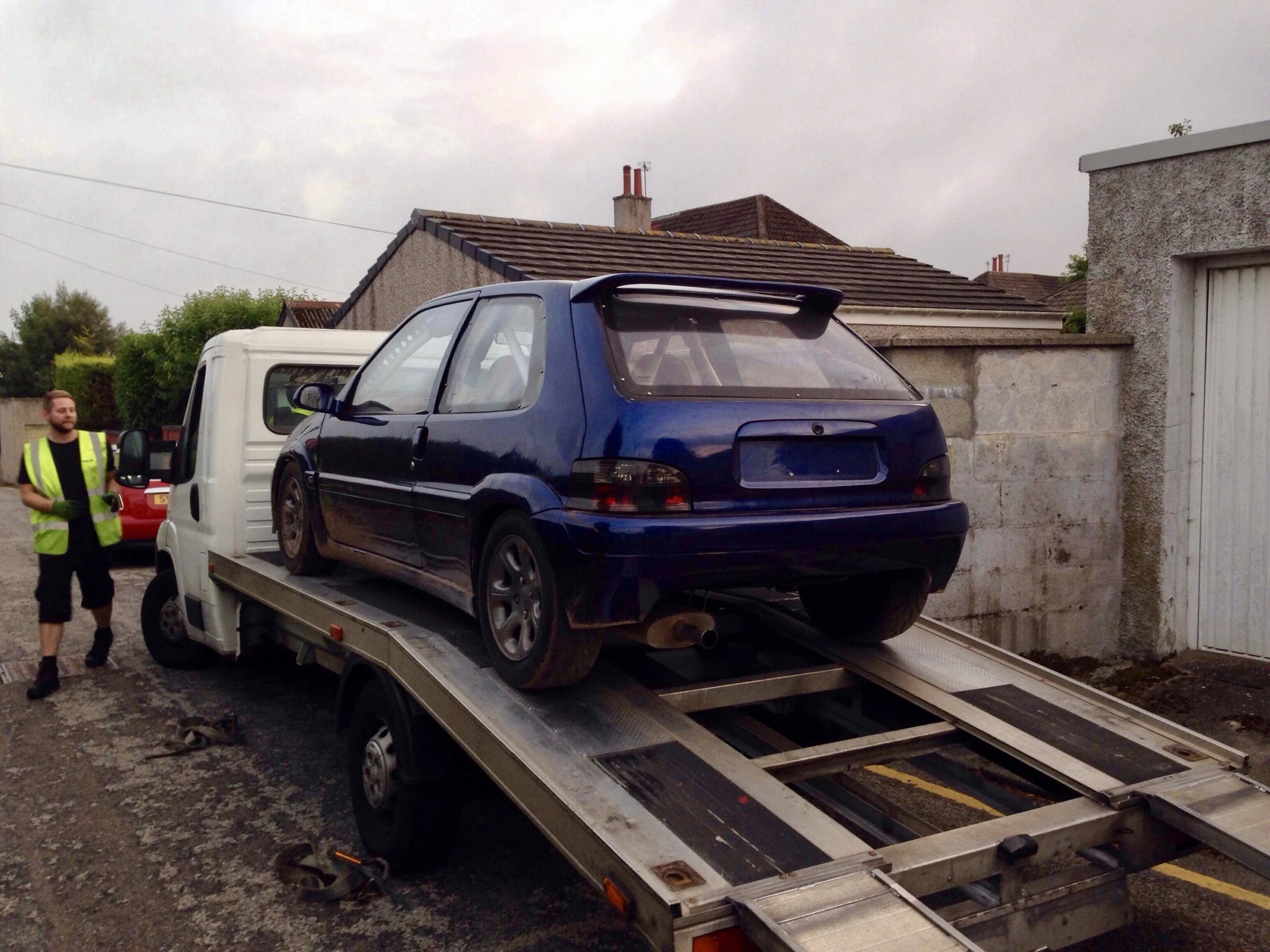

My new saxo has been picked up and is on its way from Scotland.
I’ve bought it blind from Scotland so fingers crossed it’s not a total shitter!
Should be coming tomorrow night so I’ll update when it’s arrived but here’s a picture on the truck.
Alas it’s not boosted or on bodies but seems a good base.

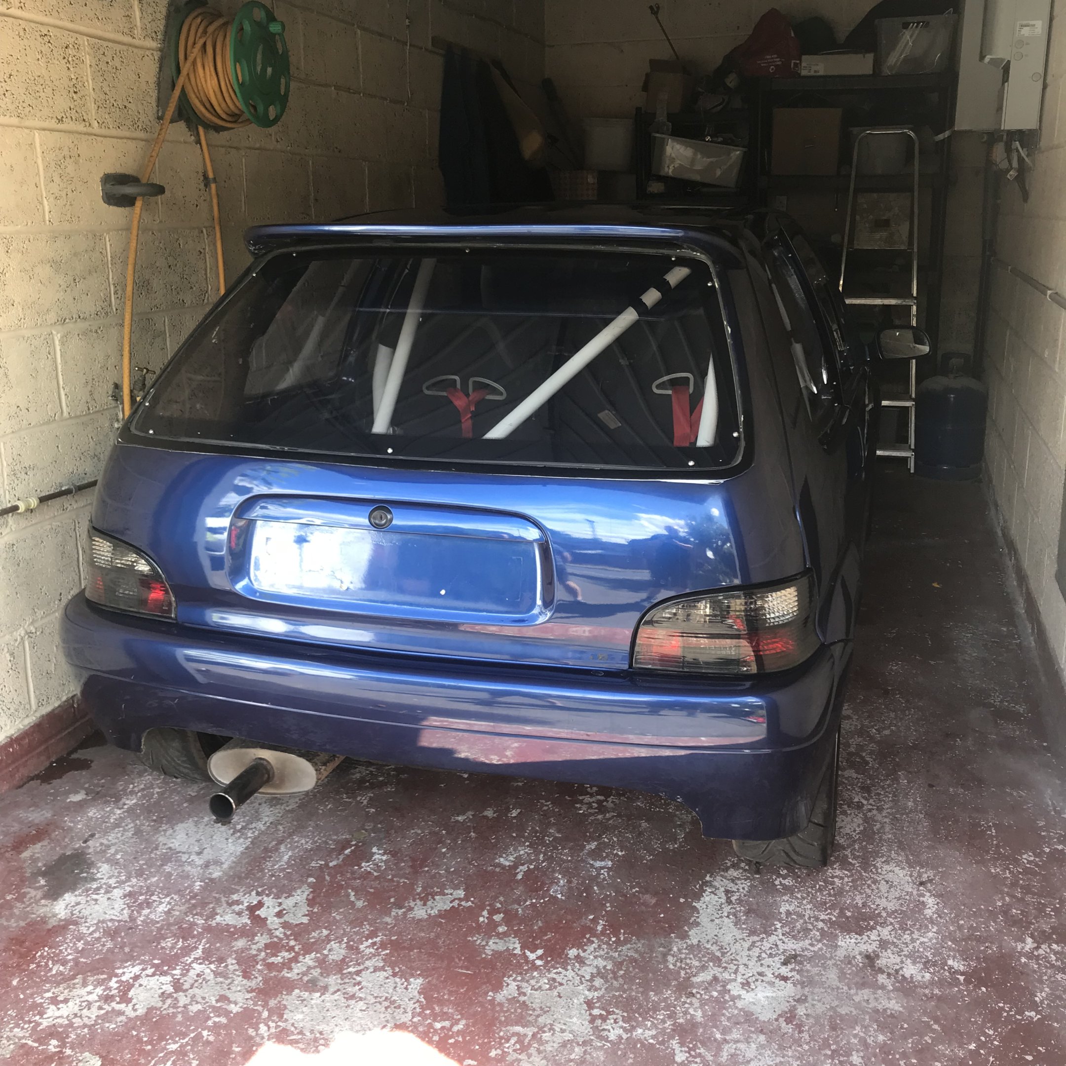

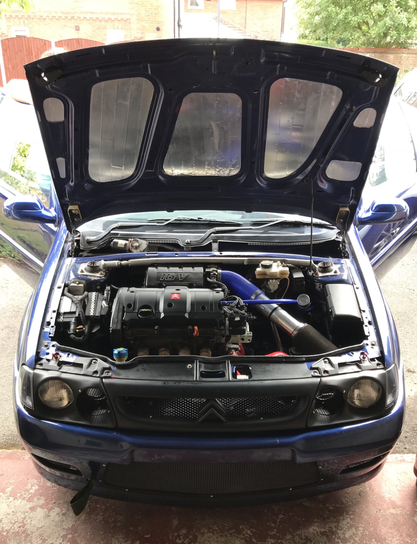

Engine / Drivetrain:
•Engine Mapped by Russ at RA Motorsport (Perth), 143bhp with Soft Limiter Set at 7250rpm, Hard Limiter Set at 7500rpm. Engine was still pulling strong and climbing but set up safe and very reliable. Still an easy 20bhp + to be had if wanted with further fine tuning.
•Saxo VTS J4 Engine
•KMS Standalone ECU & Wiring
•Satchell Engineering Gear Linkage / Shifter (Satchshift)
•Upgraded Clutch
•Upgraded Solid / Powerflex Engine and Gearbox Mounts
•Cat 708 Cams c/w Adjustable Pulleys
•4-2-1 Exhaust Manifold (Heat Wrapped)
•Peugeot Sport Group N Exhaust. (Heat Wrapped)
•Ford 2.0L Ignition Coil and HT Leads
•Custom Intake c/w Pipercross Filter
•ARF Baffled Fuel Cell c/w built in Fuel Collector
•Sytec Fuel Pump and Filter
•High Flow Fuel Lines (In Car)
•Clio 182 Fuel Injectors
•JP4 Cam Covers (Better Breathing and Heat Displacement)
•VTS Nissens Radiator
•Full Spoox Coolant Hose kit
•2 x Radiator Fans (Manual Switch Override Available)
•Oil Catch Can c/w Filter
Chassis / Bodywork:
•Fully stitch welded chassis
•Tube Braced Chassis Front to Rear
•Full Plastics4Performance Poly Window Kit
•Lightened Sunroof Blank
•Wide Mouth Front Bumper c/w Fog Light Brake Cooling Vents
•Headlight Cold Air Feeds
•Front and Rear Tow Straps
•Aero Catch Bonnet Locks
•Lightened Doors c/w Quick Handles
•High Rise VTS Boot Spoiler
•Bonnet Risers
•Rear Bumper Cut out for Better Aero
•Front and Rear Under Trays
•Smoked Jewel Taillights
Suspension, Brakes, Wheels & Tyres:
•4 Wheel Alignment and Suspension Geometry Adjustments done at RA Motorsport.
•Gaz Rear Adjustable Dampers
•Spax Front Adjustable Coilovers
•Rear Axle Copper Bushed c/w Grease Nipples
•Upgraded ARB’s
•Full Powerfex Bushing Kit
•Top and Bottom Front Strut Braces
•23.5mm Master Cylinder
•All new Non-ABS Brake Pipes (In Car)
•Brake Bias Valve
•Braided Brake Hoses
•Black Dimond Discs all-round
•EBC Brake Pads all-round
•14" VTR Alloys c/w Toyo R888 Tyres all-round
Interior:
•OMP 6 Point Roll Cage c/w welded in Gussets to Pillars
•Cobra Club Bucket Seats
•OMP Harnesses
•Battery Re-Located using BMW 5 Series Battery Cables
•Custom half Dash
•Battery Kill Switch
•Manual Override Switches for Cooling Fans
•Gauge – Battery Voltage, Oil Temp, Oil Pressure, Water Temp
•Deep 320mm Steering Wheel
•Hand Held Fire Extinguisher

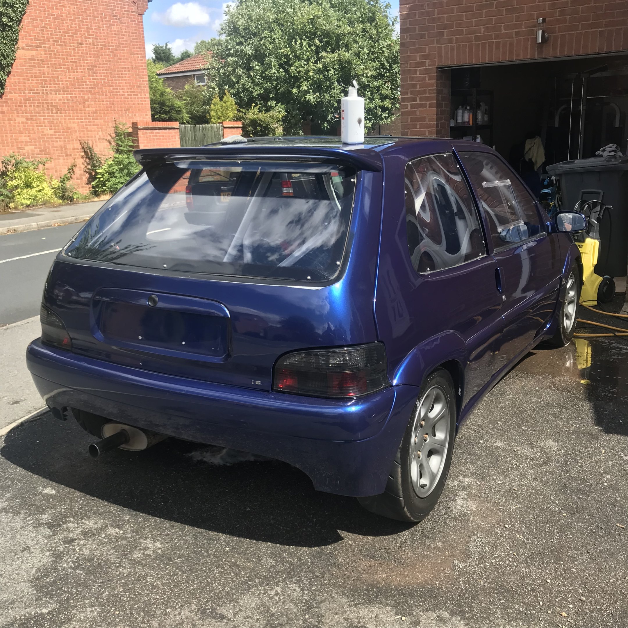

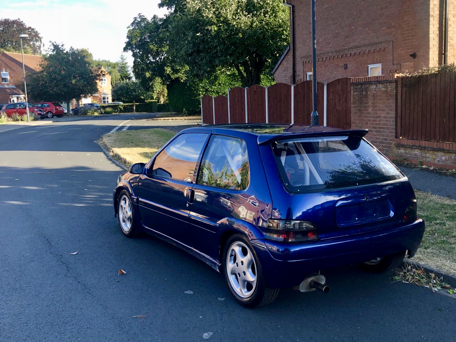

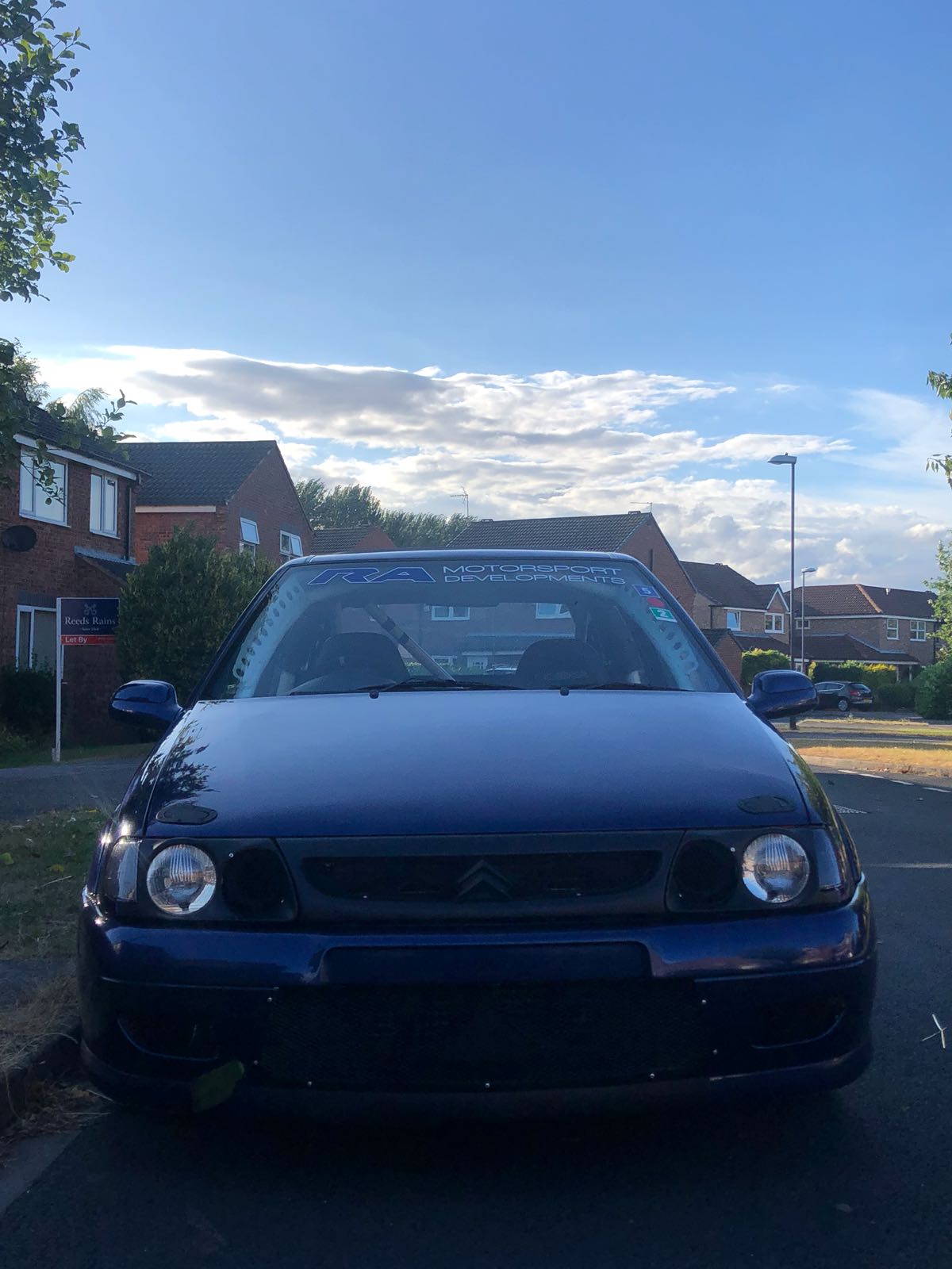

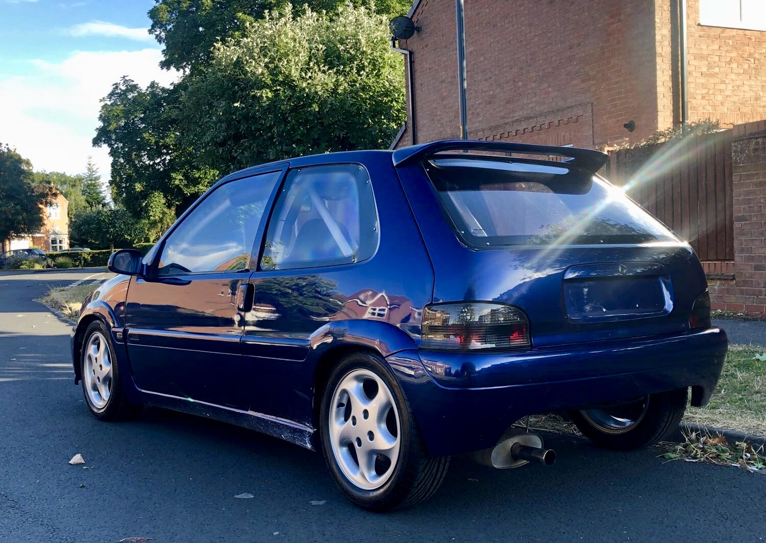

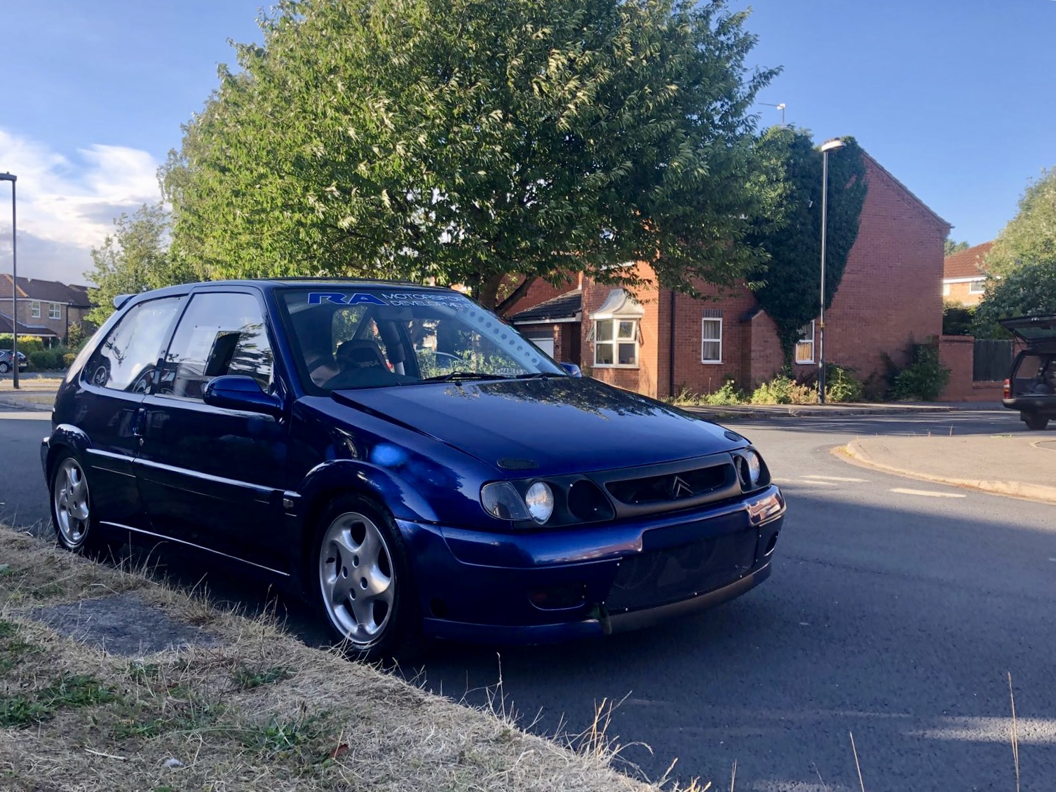

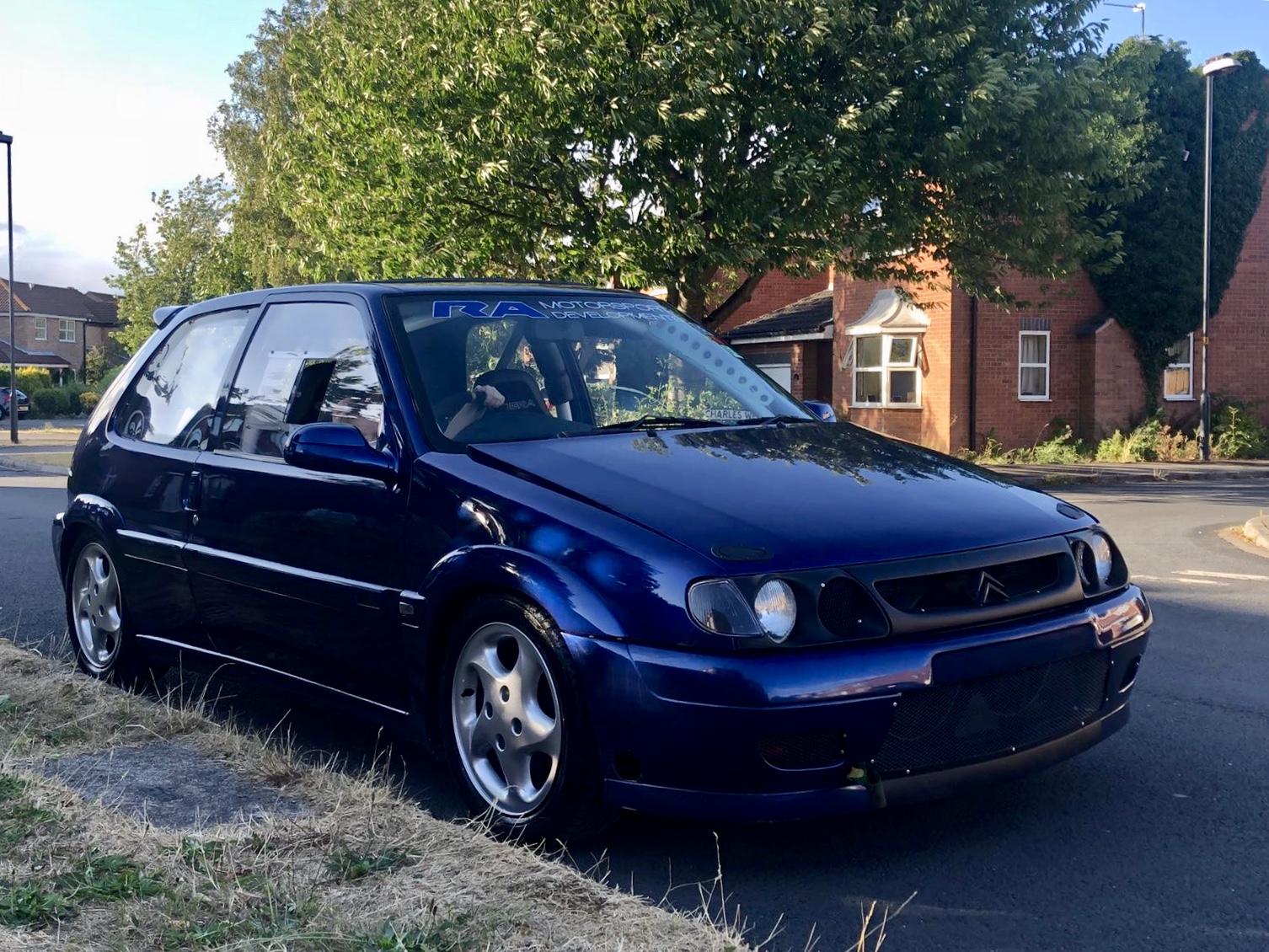

Car turned up in the middle of a storm and was pretty minging to be fair! I was at work but was overly impressed with what I saw

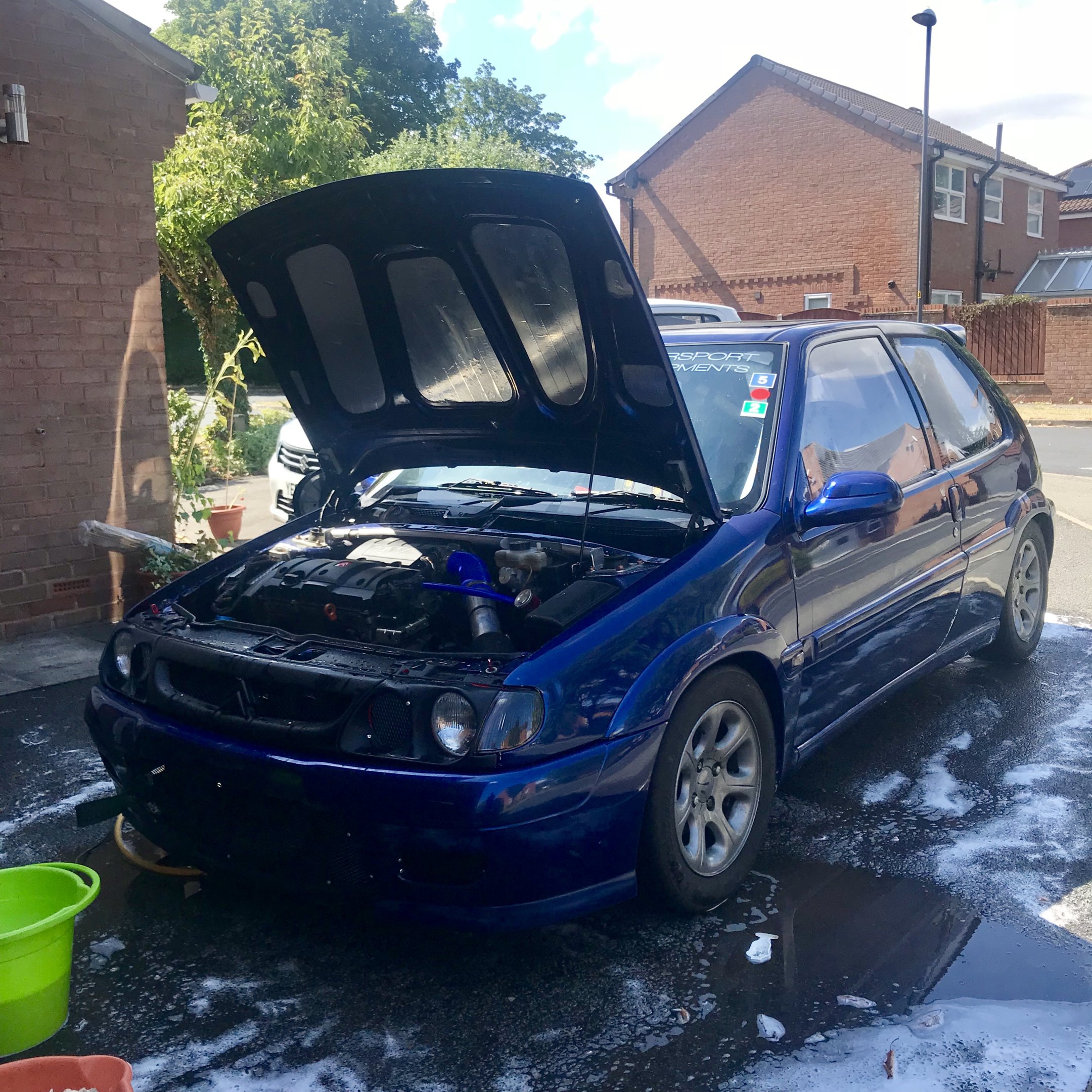

Gave the car a wash and polish today and looks 100x better. Still not perfect but passes the 10ft test now and also fits in the garage.
