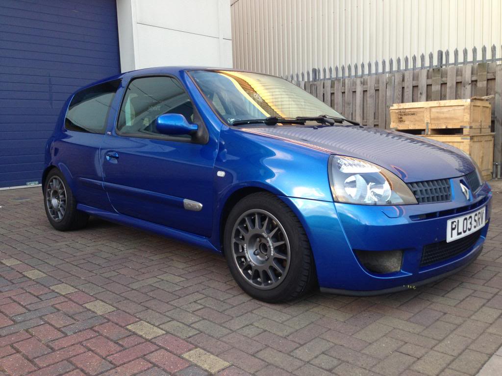

Eventually got some pictures of it after its second clean in my ownership. lol
Work done -

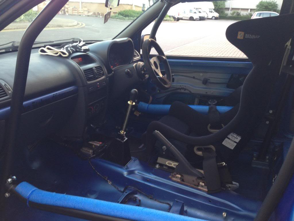

Cobra Imolas sold and my 197/200 Sabelt Cup Racer seat fitted.
PMS gear selector fitted, lovely height and position, still not impressed with fit underneath the car.
Fitted my OMP adjustable boss kit though couldn't fit the Sabelt Cup Racer wheel on it as the bolts have rounded on this wheel, so another job to do!
Made an extended throttle pedal to bring it 15mm closer to the brake pedal, heel-toeing has now become too easy!
Cup spoiler removed in favour of plastic ultra povvo spec spoiler.

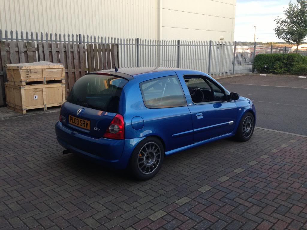

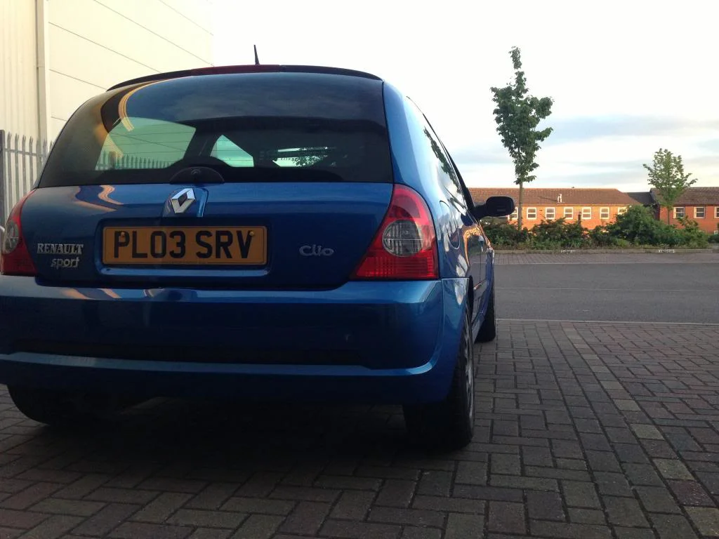

25mm front and 15mm rear spacers fitted along with an extra 1.5 degree of negative camber for the rear. Went to get the tracking checked as the rear had toe in on both sides and wanted to see how even the camber was, printout came out at the rears having 3 degrees of neg camber and miraculously paralleled the toe. Well actually its 2 minutes out on the drivers side and 3 minutes out the other which is perfect! Car feels a lot livelier so should be great fun when I eventually get a trackday booked!
Front and rear diamonds replaced from black to standard silver finish.
Doorcards sold.
That's about it so far, could have done so much more but I've been lazy/on holiday. I have set myself a lovely list of bits to do over the coming month though which should keep me busy enough...

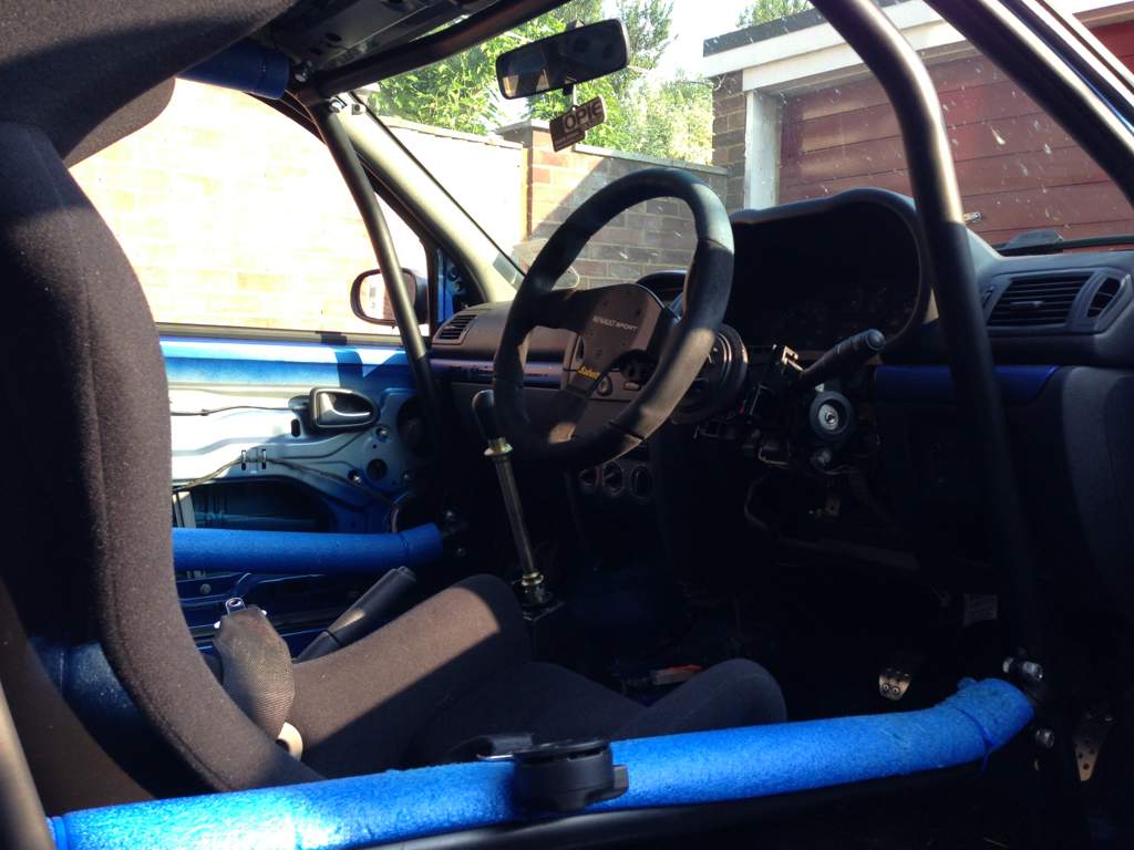

Also fitted my Sabelt Cup Racer steering wheel, played with the adjustable boss kit so it sits closer to me. Moved roughly an inch closer than previous and it is a little too close, but rather than moving that back I'm going to move the seat back instead so I can have straighter legs.
Also lowered the steering column by 10mm so even with the steering wheel closer, it feels just as high as before.

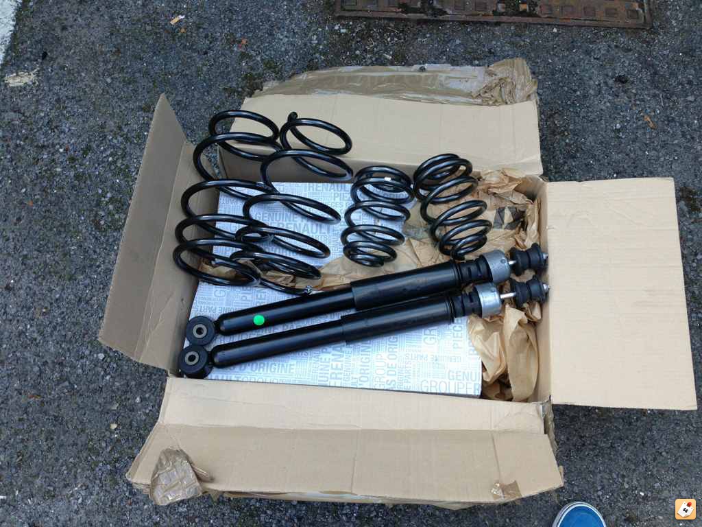

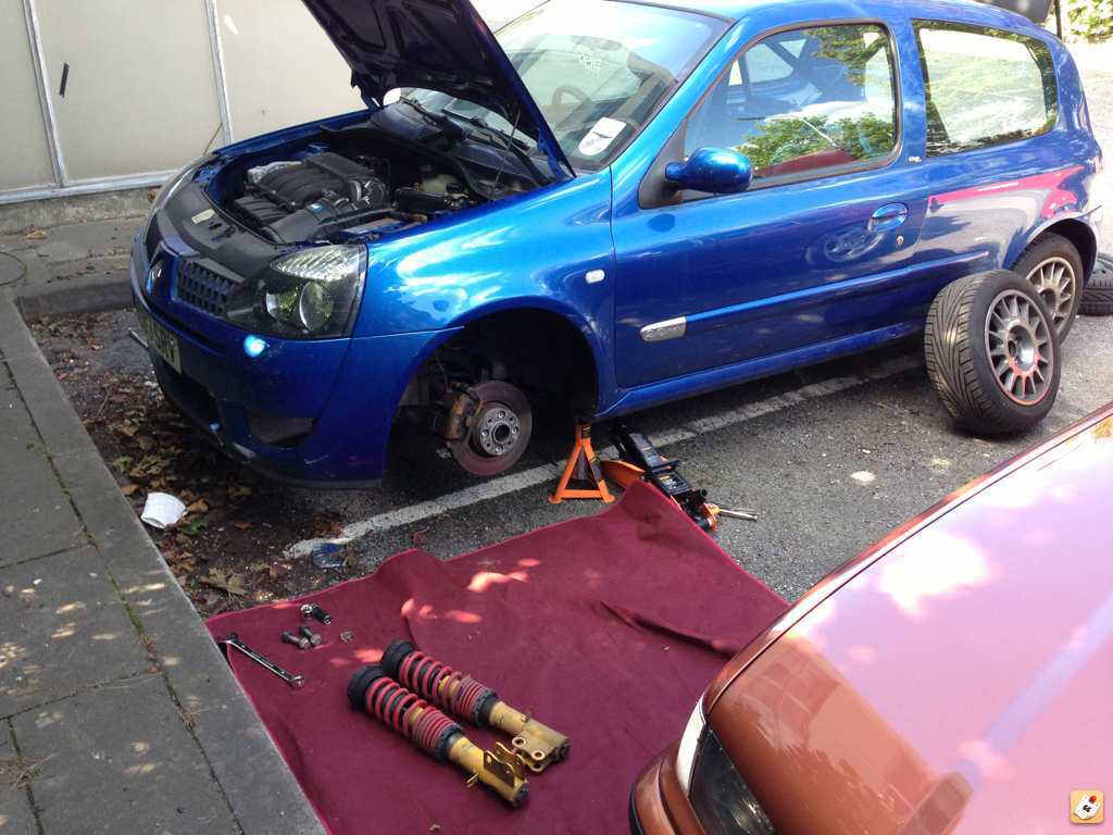

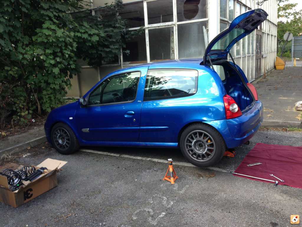

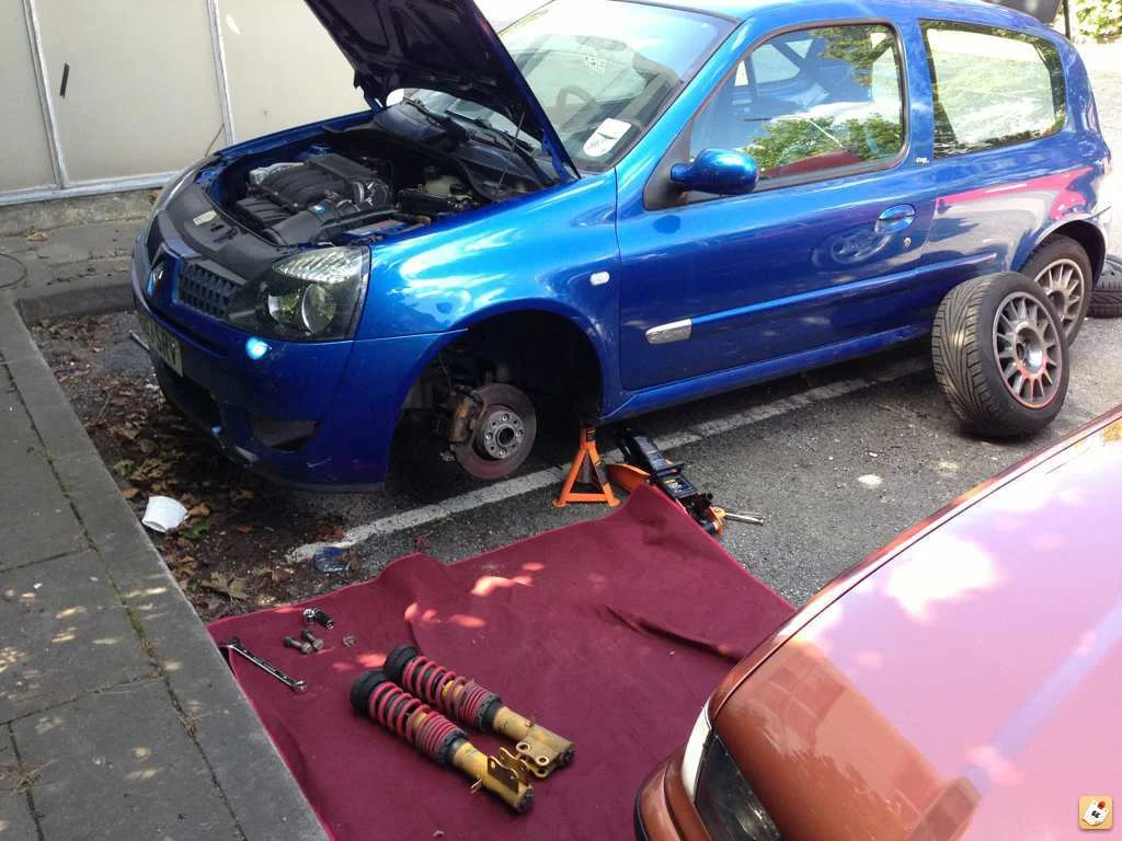

A little update, standard cup shocks and cooksport springs arrived so cracked on with getting them fitted. Rears no issue however the fronts I was missing a few parts for the standard shocks due the previous Spax coilovers not requiring them. So picking them up off the fine Mr Hunter at Cadwell this weekend and hopefully have the suspension all sorted by the following weekend!

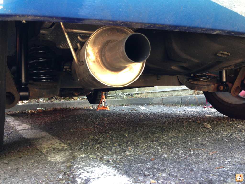

What was the result in the end with the exhaust nick? did you get it replaced/fixed?
Nothing happened in short. lol Its currently sat in the shed until the day where I'll have enough spare pennies to get a new backbox fitted to it and I'll then be using it instead of the homebrew one that's currently on there mate.
