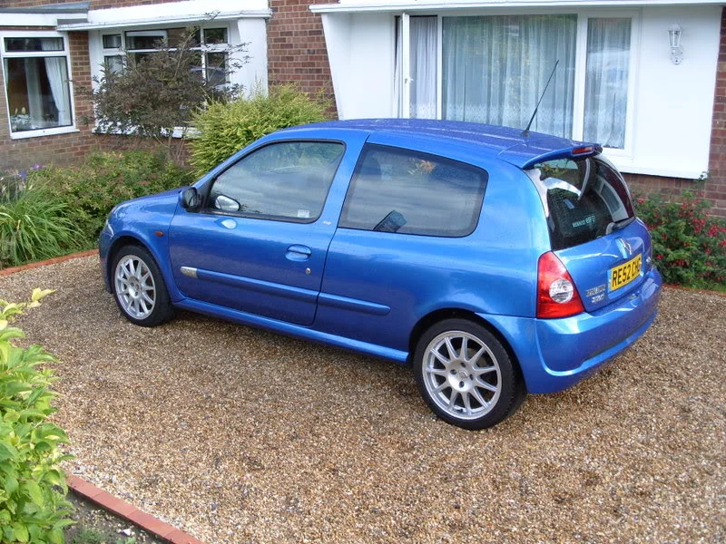

The next port of call for me was a getting a refurb on the wheels, had them done in anthracite as I wanted something different from what I had before. Tyres that came with the car were getting low, so I got a set of 4 Goodyear eagle F1's for the wheels whilst I was there. Reverted back to standard bullets and badges as it complemented the car better. Ditched the Leon Splitter for a 307 Splitter as it was abit more subtle and looked much better...

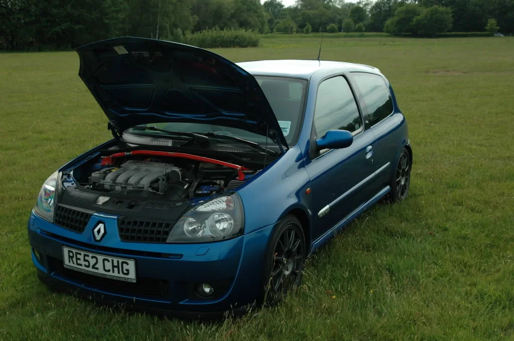

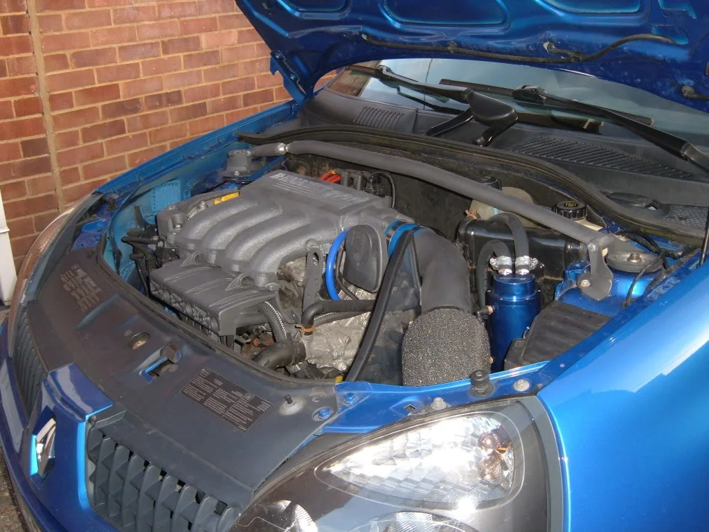

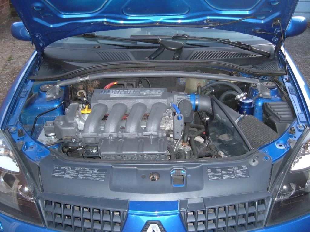

Next thing to come was a V6 airbox, after going to Surrey Rolling Road and meeting a few new people, I looked at MarkCups car and decided that because his car perfomed well on the rollers with similar modifications to mine plus the V6 airbox it was time for me to get something else performance wise. Went to Renault and ordered new for the ease, that day ordered the ITG element for it also. Managed to get some 105mm ducting for it straight from the airbox to the front upper grill, and then go for a drive to see how it was. Was reasonably impressed with it, much smoother through the higher rev range and also pulled harder from lower revs. Also purchased front and rear OMP strut braces, in my mind the rear made a big difference, much less roll and stopped it c**king a wheel as easy!

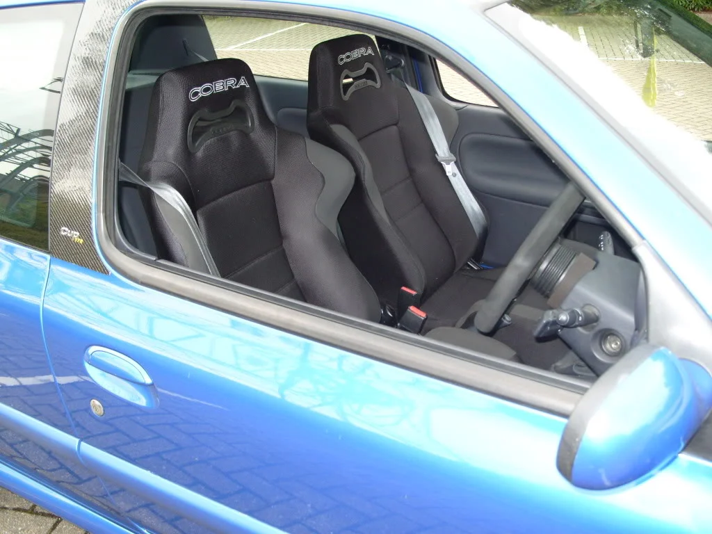

There was a couple of things that still weren't quite right... The seats weren't supporting me at all, so trying to stay in the seat whilst driving spiritedly was turning into a chore as well as disrupting me from enjoying the car. The steering wheel had seen better days also so I went ahead and bought myself a set of Cobra Daytonas off Icarus, and Sparco 'ring' steering wheel for mini-valver. This was probably the best £400 I had spent on the car, it just gave it that sporty and more purposeful look and feel not to mention giving me much more confidence behind the wheel! Also purchased some Luke blue 3 point harness' but havent got any pictures of them in...

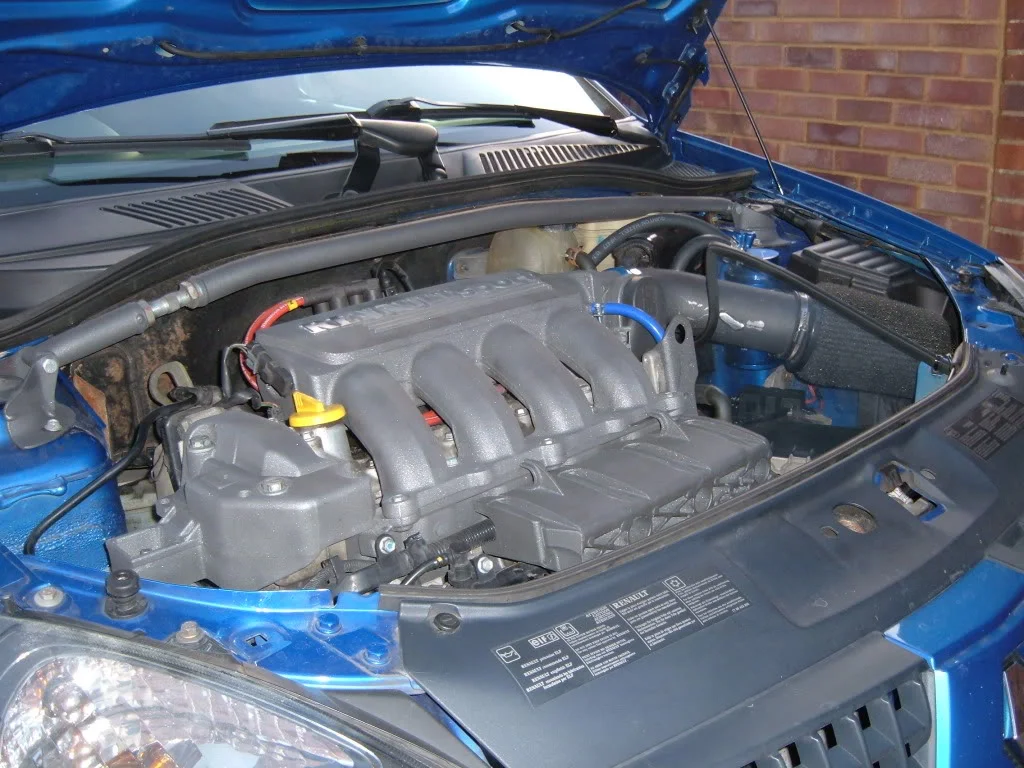

A couple of months later it was time for a little more power! Matched inlets had been the in thing to get so went back to JMS for a set of there inlets. My cup being an early had a shocking set of inlets on it, comparing the normal with the matched, you could tell that there was some gains to be had! Whilst I was there I got new set of genuine Renault spark plugs and some magnecore KV85 leads seeing as the inlets were off the car. The inlets made a really big difference on the car, it pulled now really hard from around 3000 rpm with the the limiter! Probably the best bang for buck modification you can get for the RS.

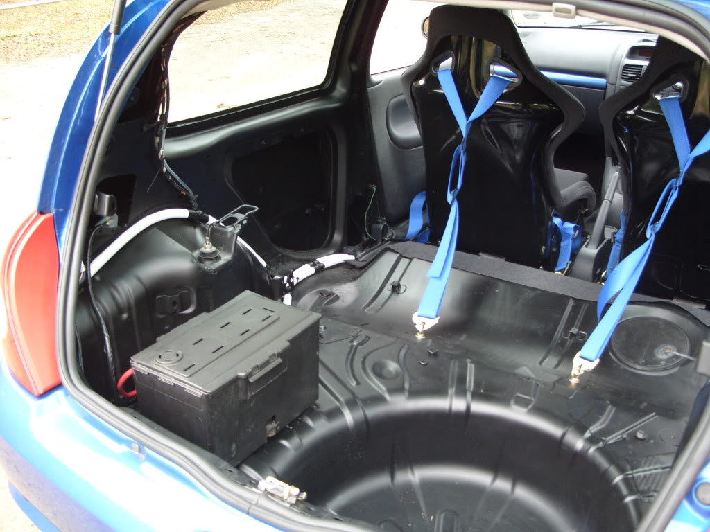

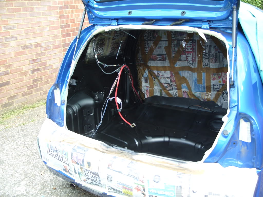

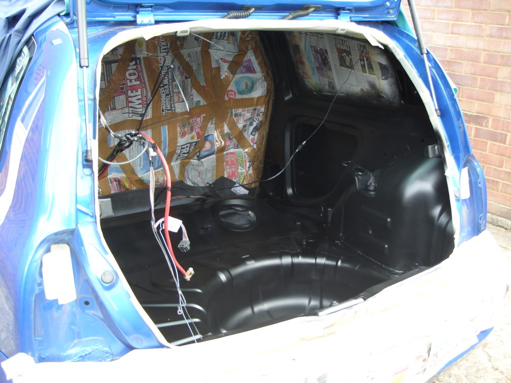

Now on just gone 95,000 miles, At this present time now I had the rear interior out and it looked a bit messy so i'm in the process on painting the rear satin black to neaten it up a little bit. Also sold the turinis as I was getting bored of them, atm i'm running some Renault 19 16v wheels until I find a set I like. Will get some pictures tomorrow of the whole car and some interior shots.

Well here it stands atm, need to go over parts that are a bit dull, but all in all looks much better than it did! Just need to start shopping around for cages within the next couple of months.

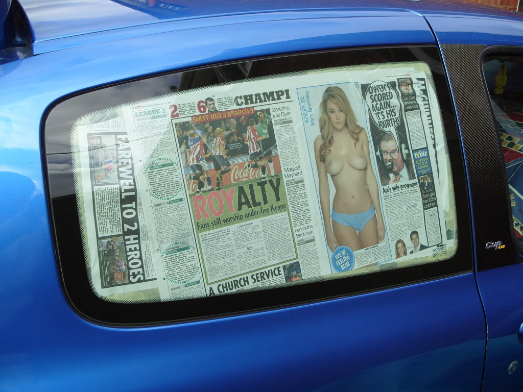

And a funny one whilst we were masking up, didn't even realise we had done it til we had almost finished painting yesterday!

Never actually thought of masking out the back to spray the inside.. Might have to give that a go! How many cans did you use? Just colour spray or did you primer/lacquer too?

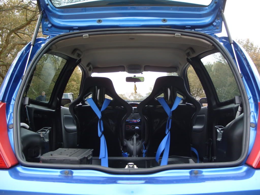

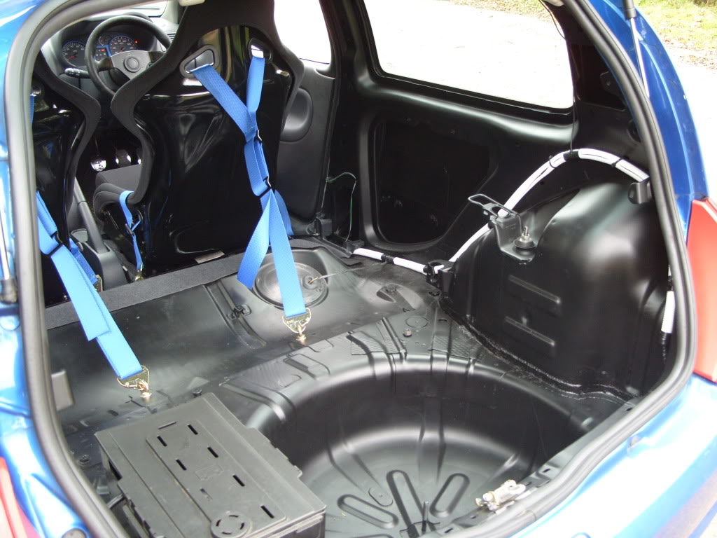

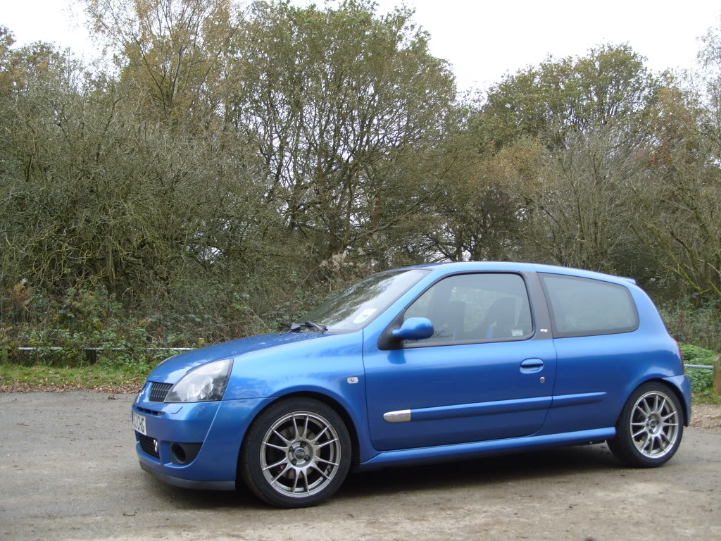

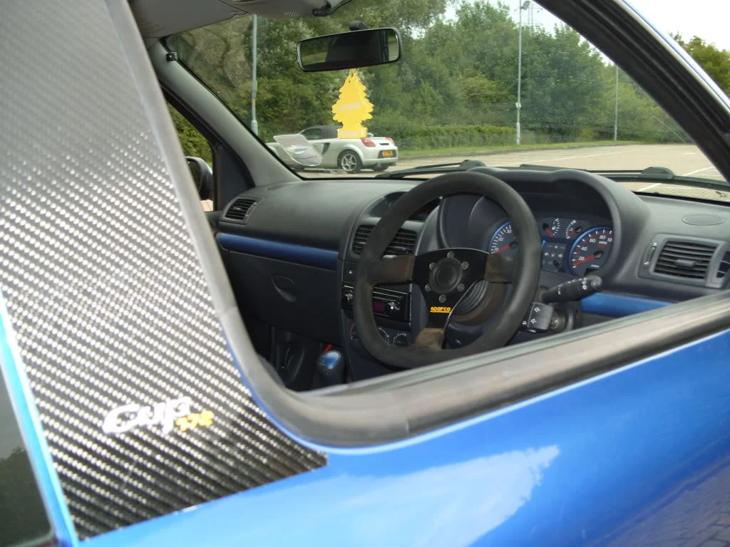

Some updates finally! Been slacking putting it all on here but quite a bit has changed since I posted last time... Finished off painting the rear, sorted all the loom out and put it into copex to make it look much neater.

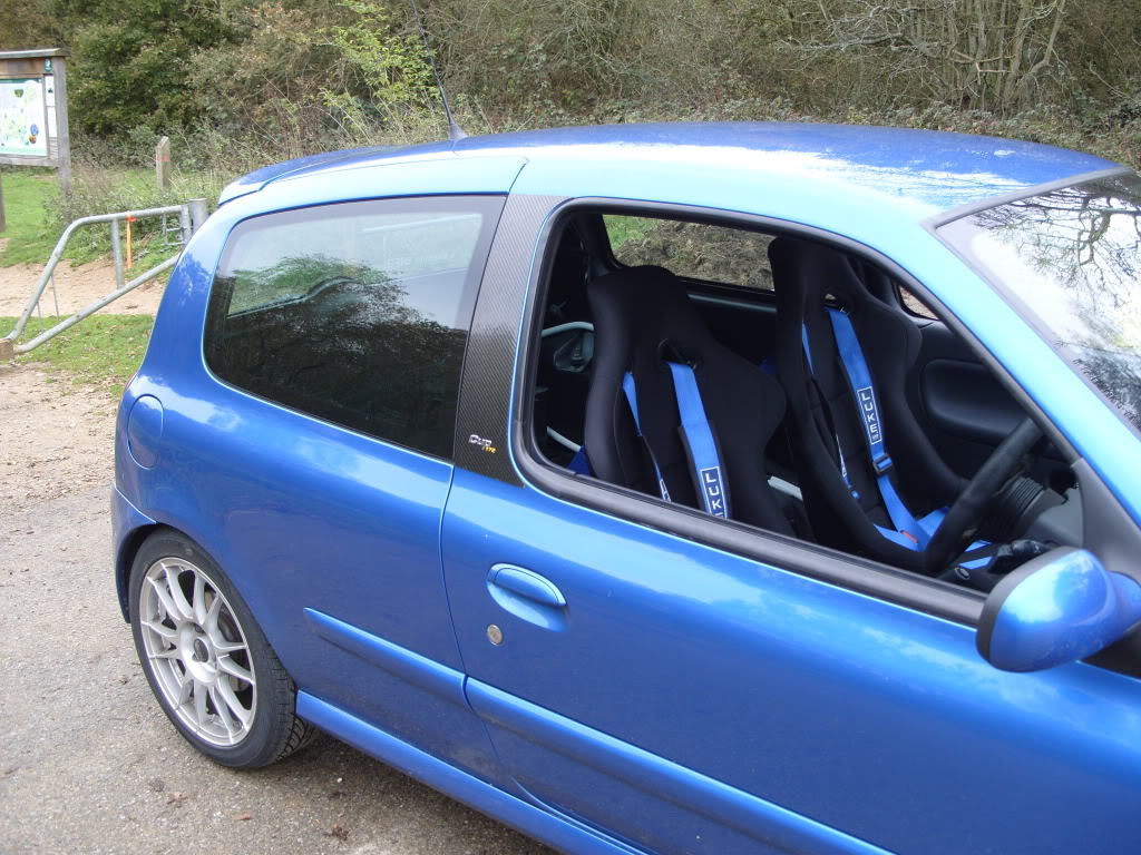

Also purchased some new fixed bucket seats, Autosytle BS1's which were incredibly cheap and hold you far better than the Cobra Daytonas! At £240 for a pair including delivery, and being less than half the weight of the Daytonas with subframes on you cant really do much better without spending loads of ££££!

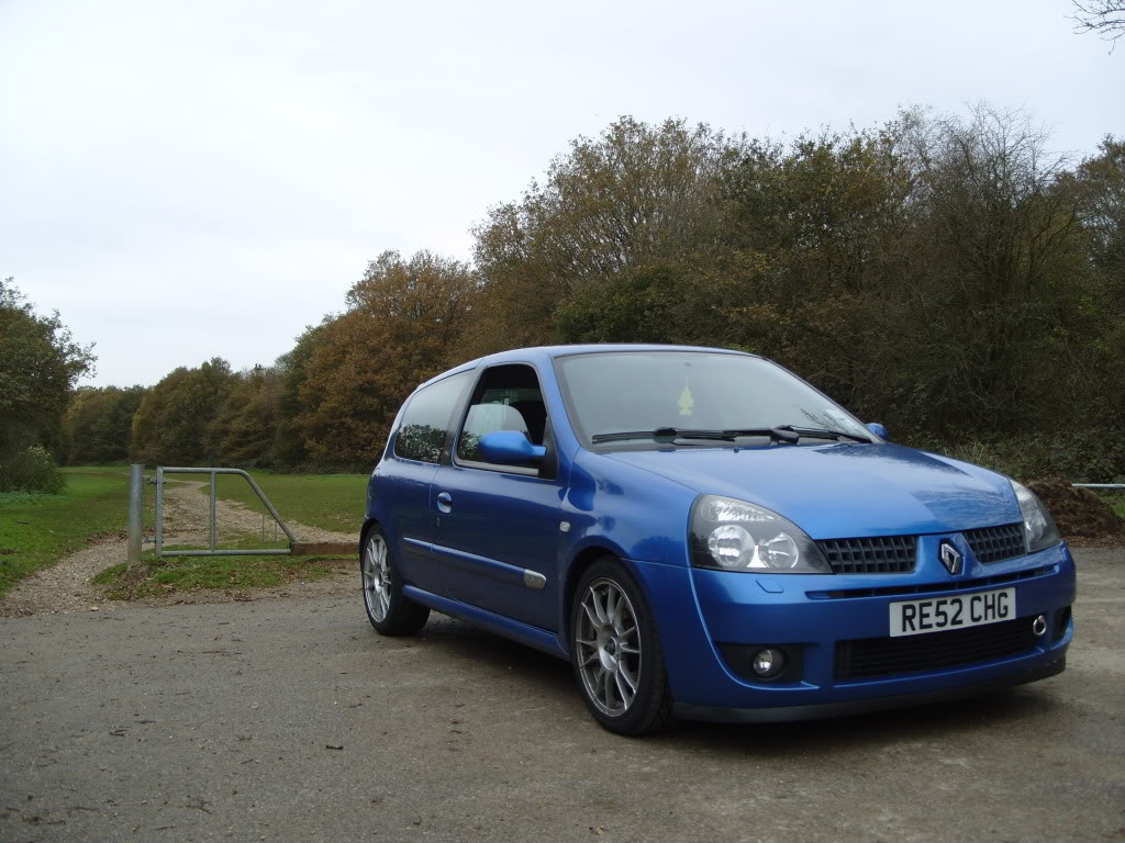

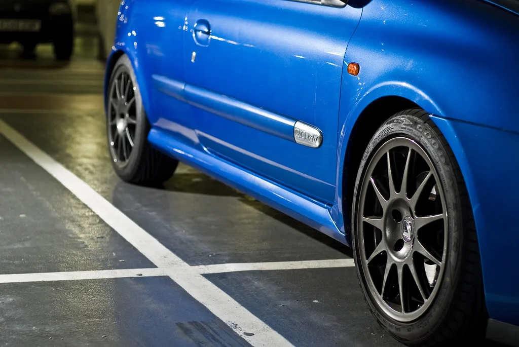

After selling the Turinis I was on the look for some lightweight wheels. I wanted a brand new set of wheels but couldn't justify spending silly amounts and wasn't happy with some of the cheaper options, so when some decent second hand Oz Ultraleggeras came up here I snapped at the chance! Weighting just over 6kg per alloy in 16" I was pretty pleased and don't look too bad either!

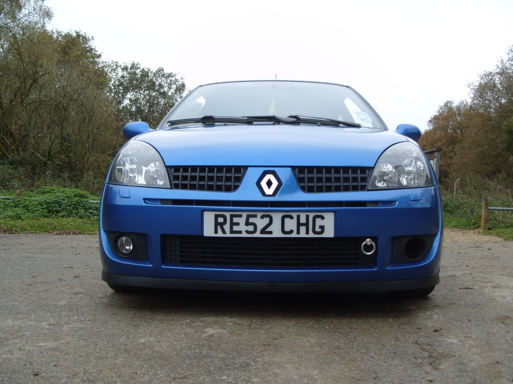

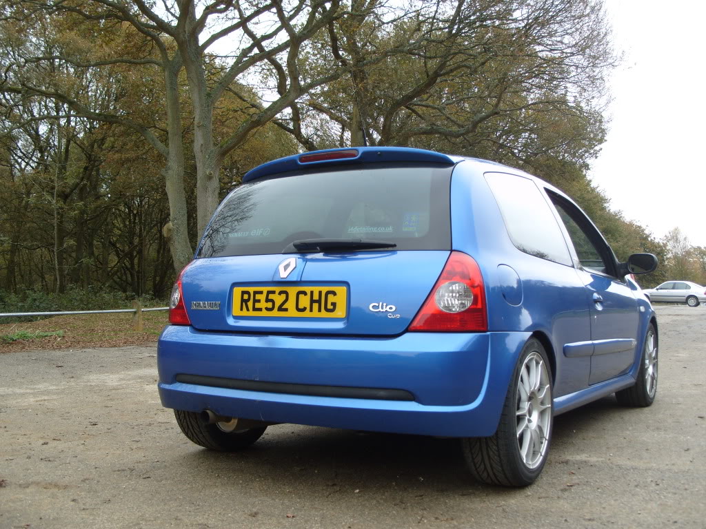

Also got rid of the plate surrounds and trimmed down the front plate to match the recess, looks far better than it did and makes the car look less cluttered with things. Here's a few pictures I grabbed earlier after some 'fun' roads around the shere area...
So the Cups pretty much done now, not really much else I want to do with it tbh. Just waiting on a Whiteline rear arb and some JMS brake ducts, and then spend the rest of the money on tracking the thing!

Did you spray the interour with spary cans? how many did you use if you did?
really nice looking motor think this is what i want to do to mine? do u ever miss having the rear seats? is this ur daily car ?
sorry for gay question btw ;)
you'll only miss them if you use them. Road noise increases though.
Nice work Nick. Nice progress.
Looks really nice, I've just read the whole thread.
Yeah just spray cans matey! Gave the interior a quick rinse with a damp cloth, keyed it up with some 1200 grit them primer and paint! Think I used 2 large halfords primer and 4 large satin black cans.

Where did you get the front plate from???
As Tim said, just marked out an 11mm border around the top and bottom of the plate and trimmed it, not a very good job as I didnt cut it very straight but still looks alright. Still retains the BS number and postcode within the rules and regs. :)

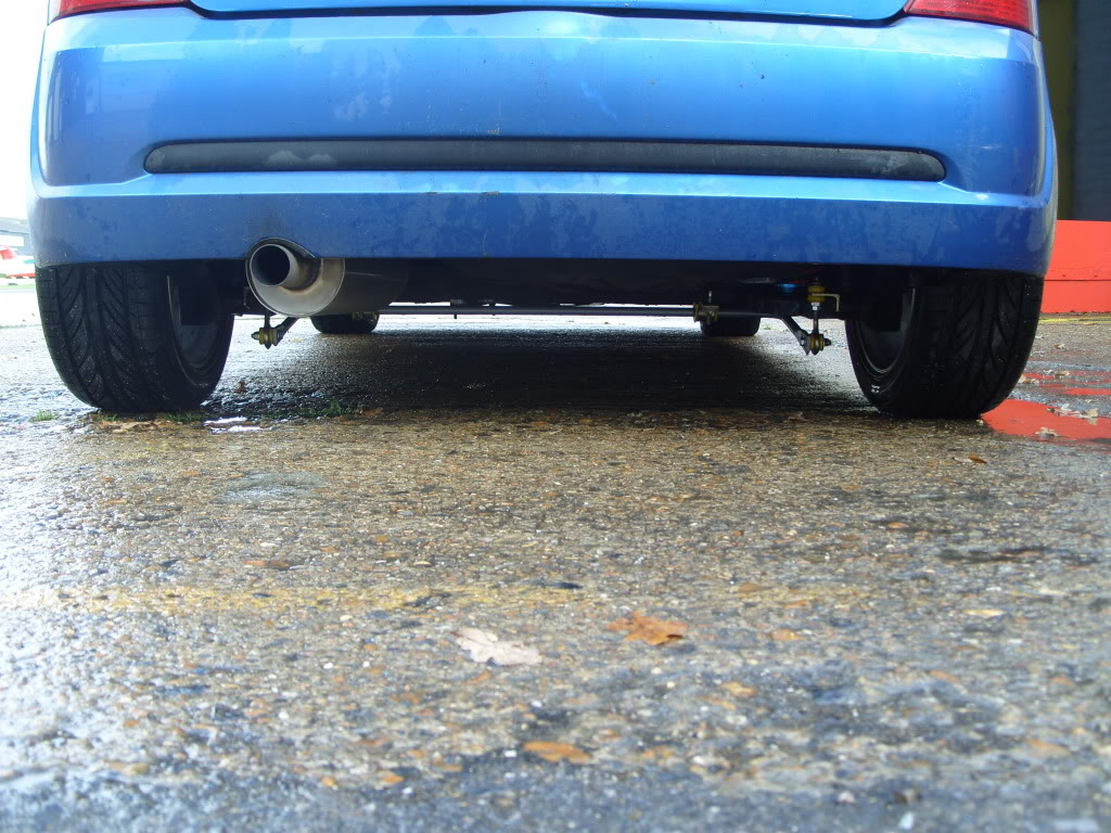

So got the Whiteline ARB about a couple of weeks ago, but finding a time to get it fitted and with it getting dark so quickly and rubbish weather was making it hard. Got it on yesterday, took about an hour and a half as I was on here asking questions about all sorts of things like adjusting the droplinks and setting it on soft so that I can get used to it.
Heres a picture of it on, looks sweet :)
Also gave it a quick clean, was hanging as i've been 'enjoying' my car ;)
Before...
After
Sorry for the rubbish clean pictures, was only on some small digicam and im no good at adjusting settings. :o

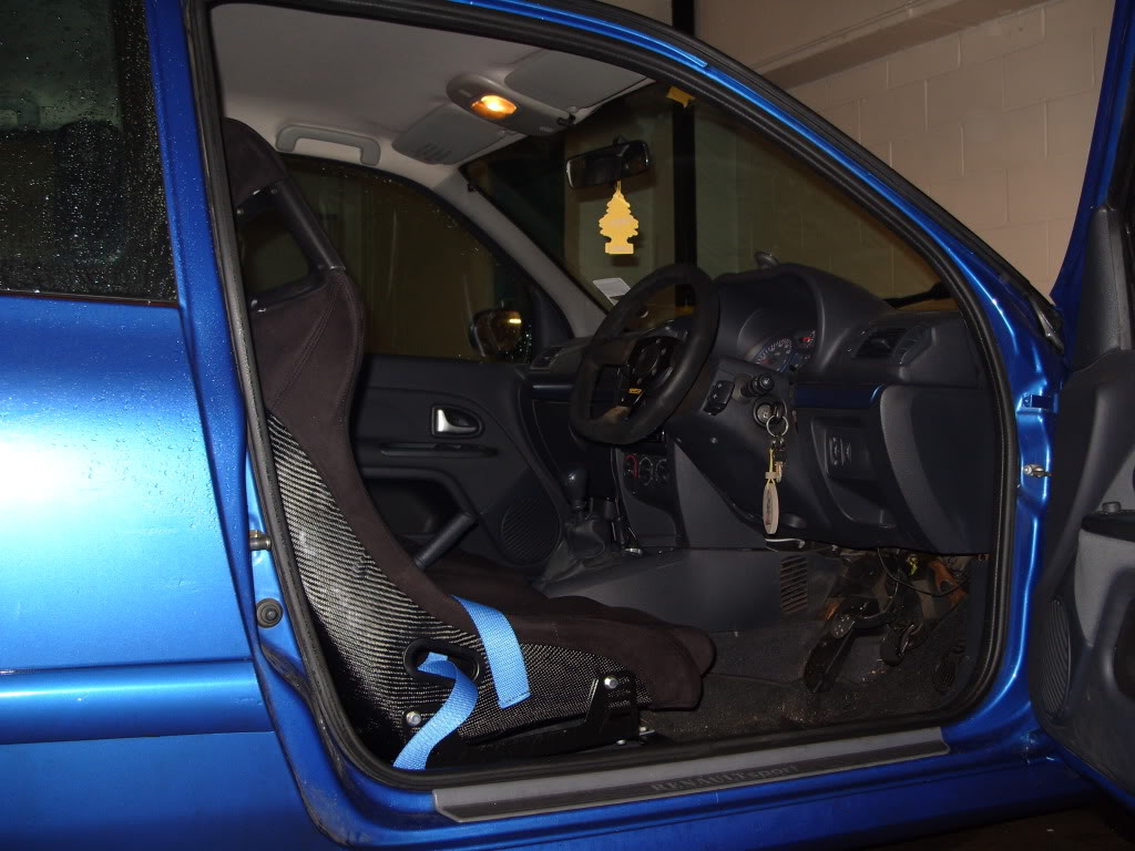

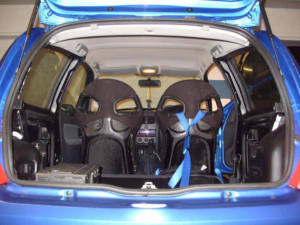

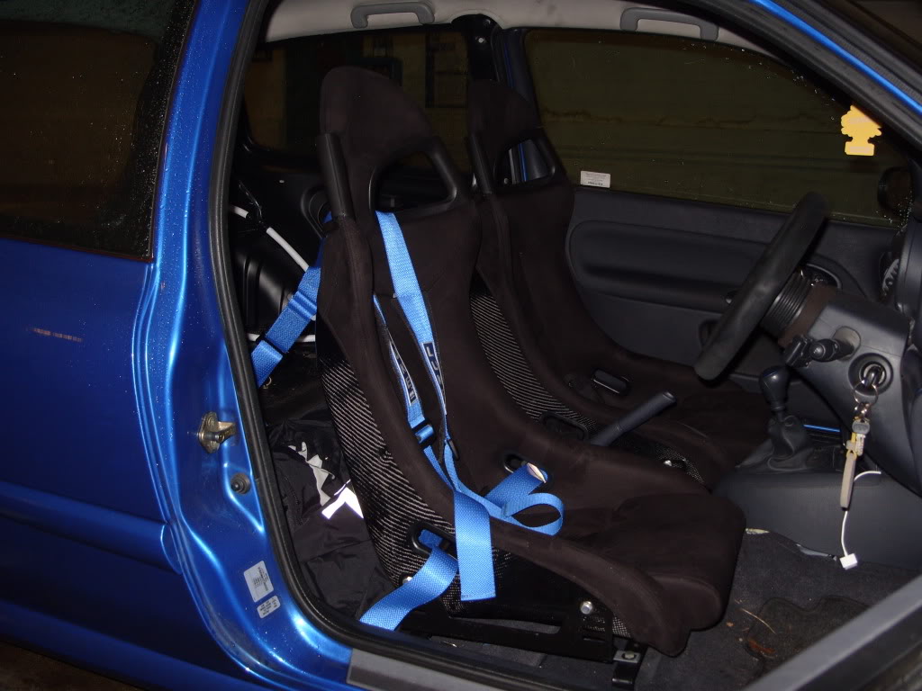

So a small update, car turned over 97,000 miles last month so it went to JMS for the Aux belt, oil and oil filter to keep the service history up... Was getting a bit fed up of the current bucket seats as they were getting a bit much to drive around in all the time, so I here from a friend that he is selling a set of carbon bucket seats so went to have a look... Some money later they were bought and now in the car! :)
Suede with carbon backs, there Porsche GT3 replica seats. They hold you better than the previous Autostyle seats, are slightly lighter and much comfier and for the money paid for them I couldnt really turn them down... I know they wont be to everyones taste being a replica seat, but seeing as they tick all the boxes above they are an improvement on what I had! Plus the carbon is quite addictive!
