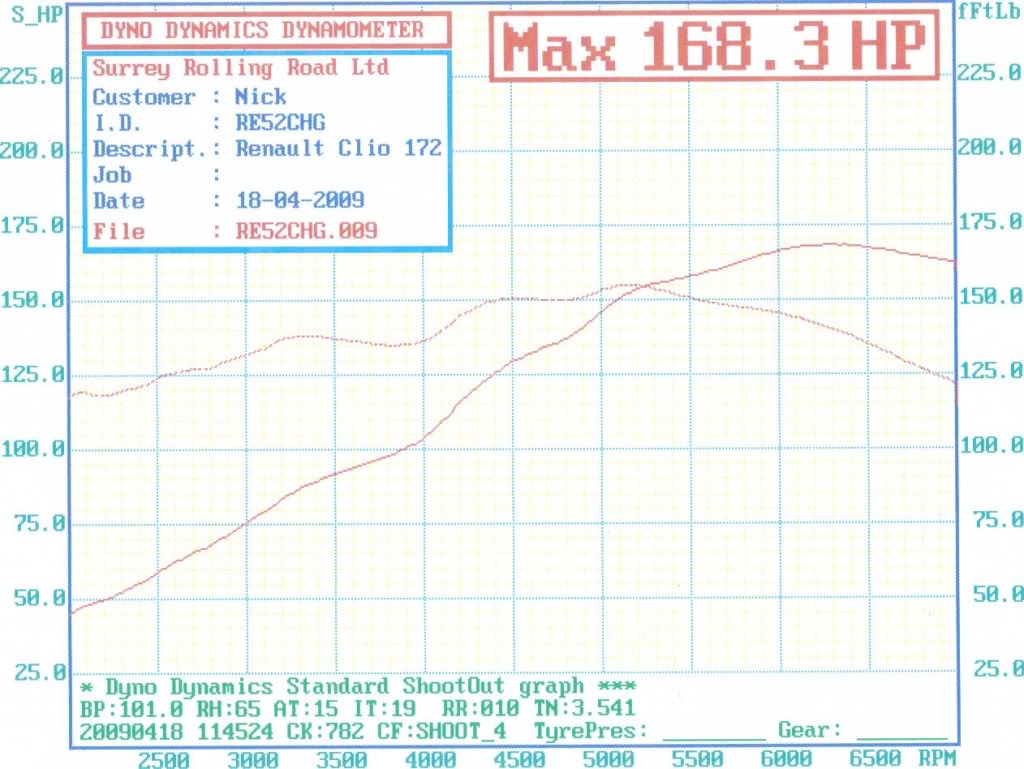

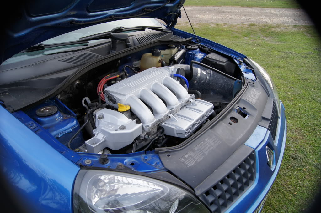

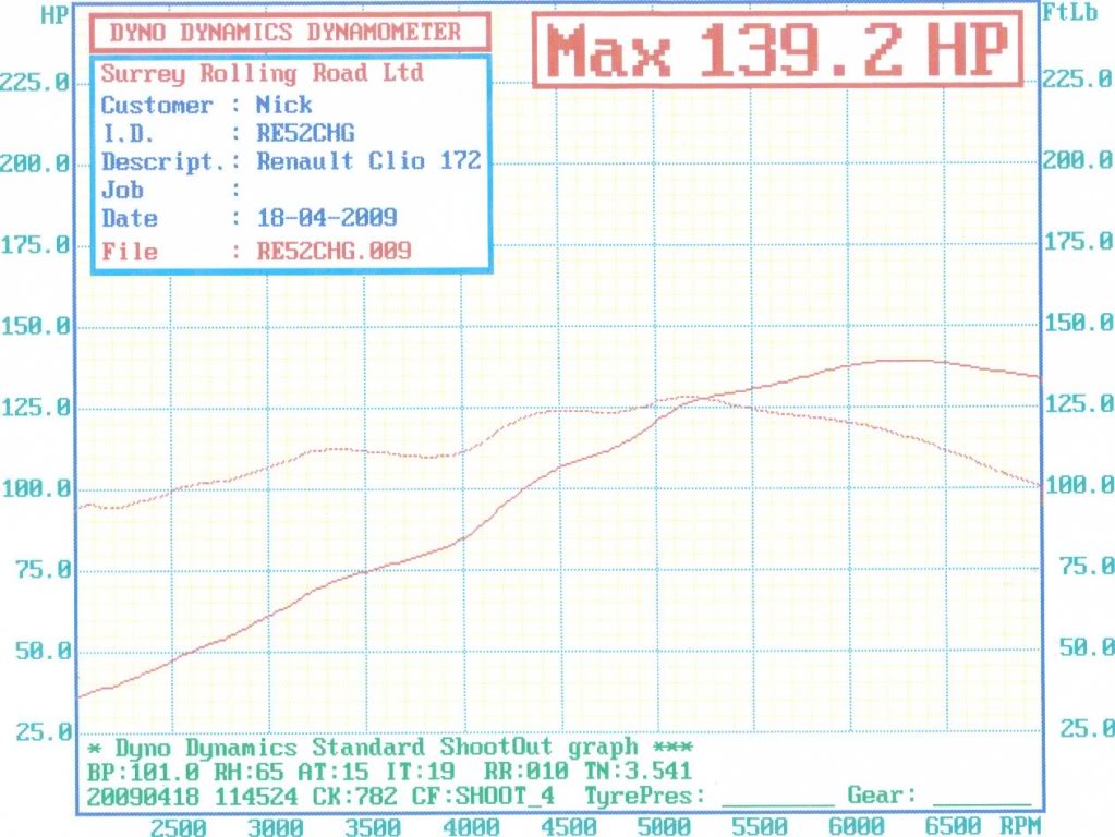

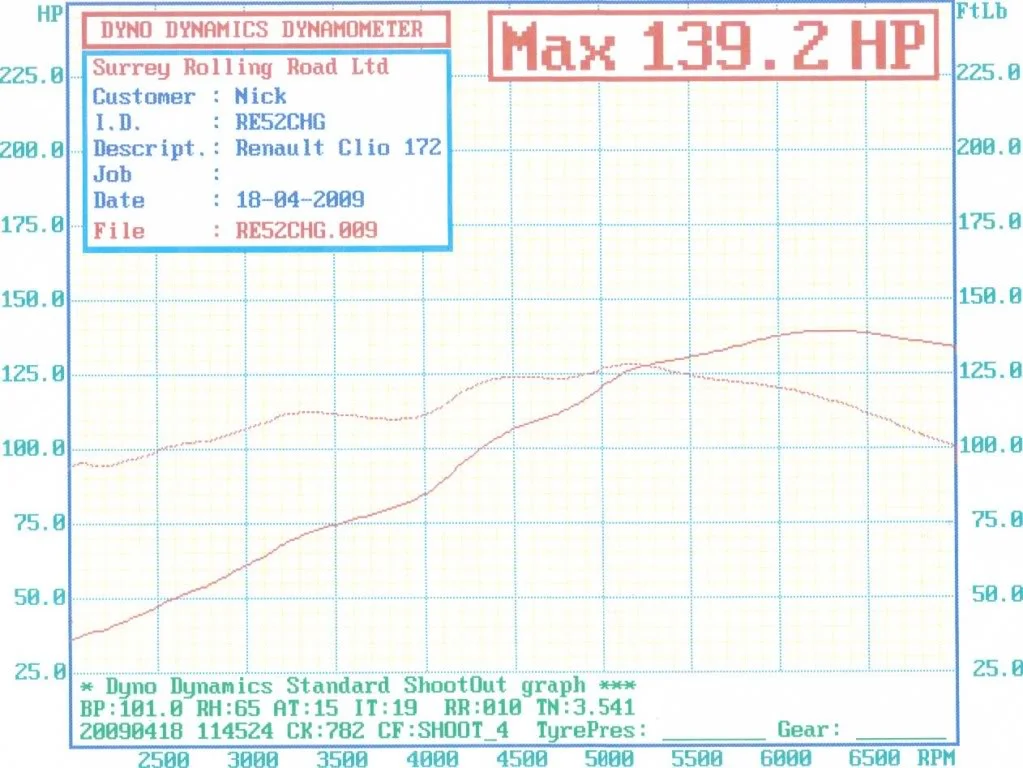

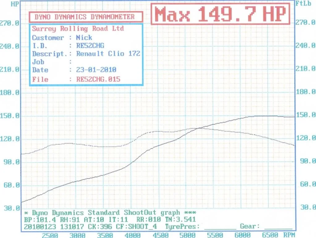

Went to Surrey Rolling Road yesterday with a few others off cliosport to get the Cup put on the rollers to see what sort of power it was making. I wasn't really fussed at first as I 'was' going to the cup back to standard and sell it.
I'll let the pictures do the talking...

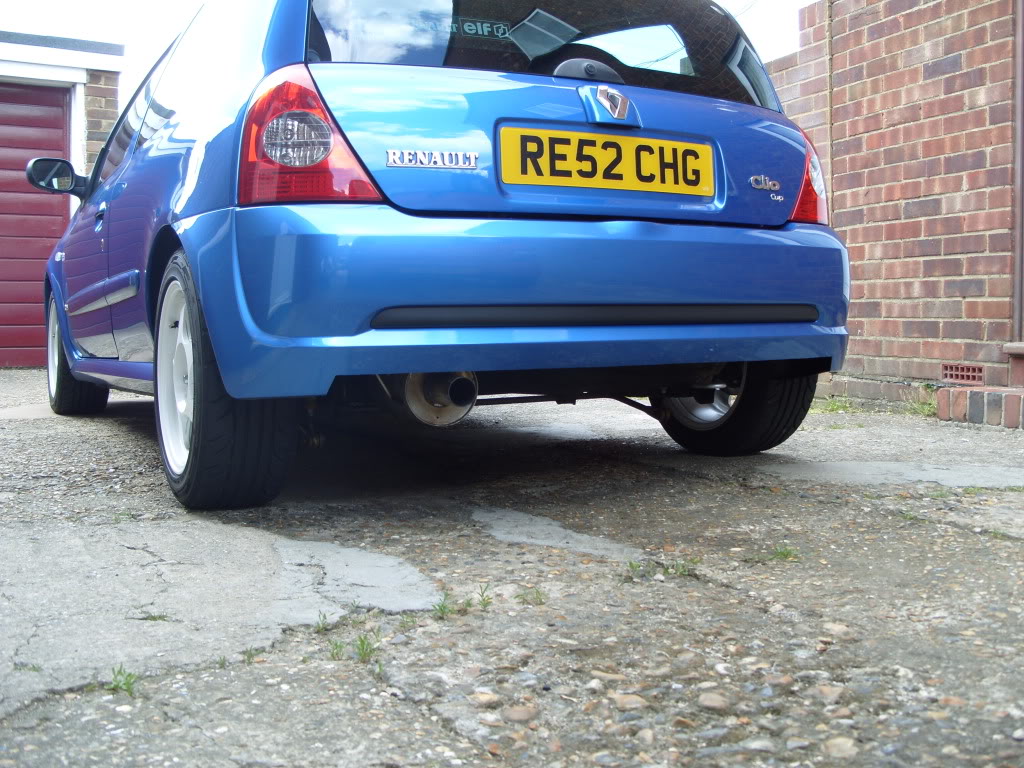

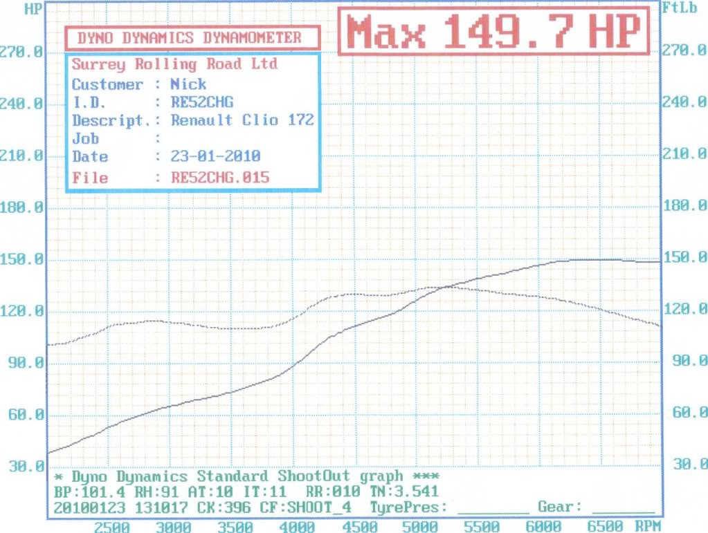

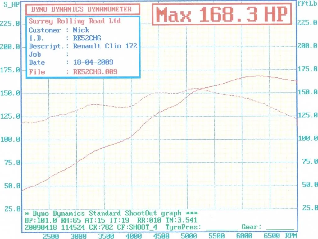

This was last year when I had just the JMS map on it, V6 espace airbox with an ITG filter and a Yozzasport 'sport' cat-back system on it. For those who want to know fly figures it made 168.3bhp/155 ft lb of torque.
And so yesterdays printout, a huge difference from last year but with not a lot more modifications. Chucked out the V6 airbox for the homemade induction kit + heatshield, got a longlife cat-back fitted to it and a set of matched inlets. Made 180.3bhp/162 ft lb of torque at the fly, up there with the similarly modified 182's who were making around 180/181bhp.
The AFR last year was showing it to be just under 14 up to 3500 Rpm and then sinking to around 10! So i'm guessing with the open cone filter and matched inlets getting a lot more air in now, thats what has been making that extra power as yesterdays printout shows the AFR to be around 14.2 upto 4000 Rpm and there after going down to just under 12.
This year I might experiment with a few other little things, I want to try a Ph1 172 head as I've heard they have slightly larger inlet/exhaust ports to see if it makes the AFR from this years prinout a bit better. Would like to get my hands on a 182 manifold also to see if theres some gains to be had from that with either a decat or the standard 200 cell 182 cat.
That will probably be as far as I go with it as anything else will start to be big money and its clearly not going to worth it for the gains given, but we shall see.

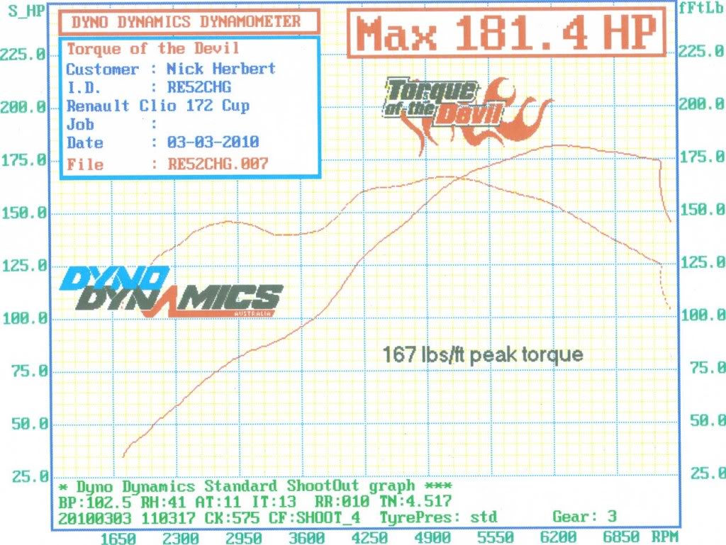

Got the car on the rollers at Torque of the Devil today also after my friend was having his carbed corsa set up there. Only real difference was the decat since the last time it was RR'd at SSR in January...
A slight gain on previous (180.3bhp) but at TOTD they set the rollers up to the correct temp/humidity etc etc. After looking at the humidity at SSR supposedly there was 91 degrees of humidity! :eek: So its more than likely that its couple of bhp increase from having the decat fitted which isn't too bad! Also gained 5lb/ft of torque since the fitting the decat, not bad I think seeing as i'm still on the 172 manifold!

WOW 167lbs/ft of torque. Thats pretty good. I only have 165 lbs/ft of torque and i have ITB's lol
I'm deffently with you on the emmencness of those pads :)
Very good result indeed mate
Torque is very good, whats even better is that Torque of the devil run very strict rollers, Not a chance of pub talk figures with Chris & Andy, As you can see from the RH & BP compared to SRR

Just look at Burps final mapping figure James, 198.5bhp and 168lb/ft of torque. Looks like you gain a shed load of peak power but not a lot extra torque at all with ITB's. Though saying that I guess they'll make a lot more torque at low rpm than mine.
good figures!!!!! what you have to remember with ITBs is the torque is spread over a greater rev range even if it's not a higher peak figure
Good result Nick, not surprised at the torque as it does accelerate really well. Did you stick it on the rollers when it was standard?
Didnt stick it on the rollers when it was standard unfortunately Tim. The lowest reading i've got was at SSR in April 09 with just a Yozzasport Cat-back exhaust. Heres the two for comparison

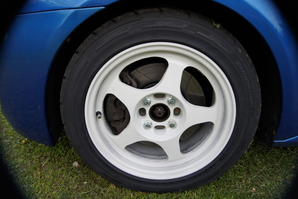

So apart from that havent done a great deal, purchased a new set of wheels (Rota Slipstreams in white), a set of Brembo HC's for the front and eyeing up my next purchase for next month, a set of Corbeau Revolutions! Also got on a painted some engine bay bits as I was getting a little bored of the anthracite.
So anyway heres a few pictures from its first run since the repair :) Still needs the Geometry set up as it toes out bad, and one side has MEGA camber!

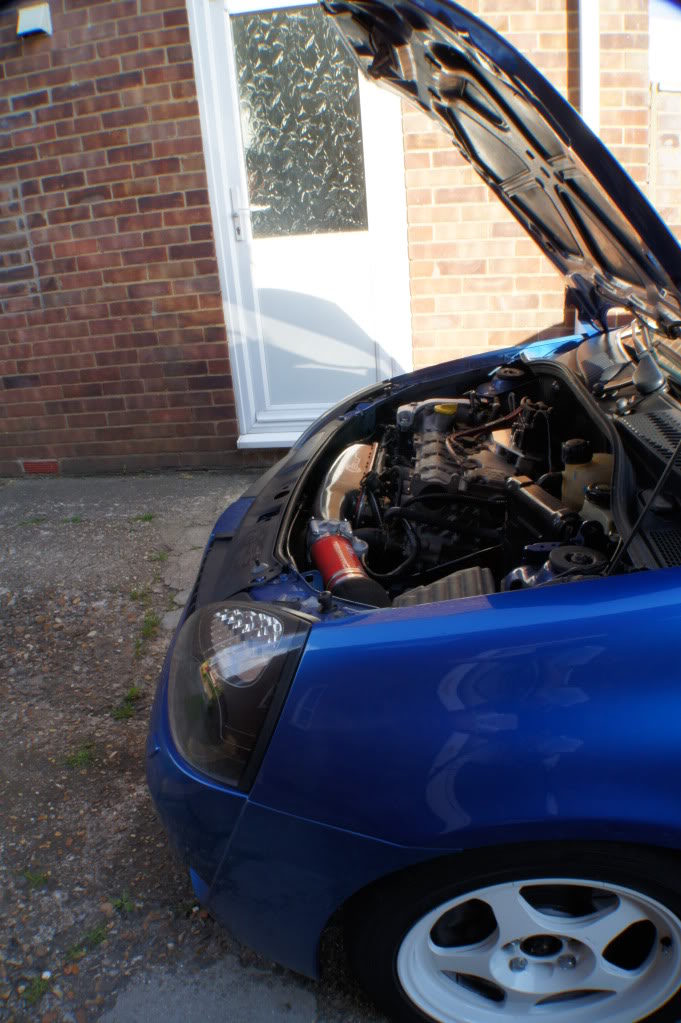

Had a week off so there was a few things I had planned to get sorted in preperation for FCS. Wanted to declutter some of the stickers that have been on there for ages as well as the tacky carbon fibre door pillar stickers. A word of advice to people that have them or thinking of buying them, don't bother as they are a nightmare to get off and fade like mad!
Just waiting now on a new set of Cup badges and the pillars/decluttering is sorted.
Also got another rear bumper as mine was scuffed when I bought it, with my exhaust where its sat i'd of had to make a hole for the exhaust to sit in but decided against and try something different. I'll let the pictures do the talking, was a pretty easy job to do and doesnt seem to look too out of place.

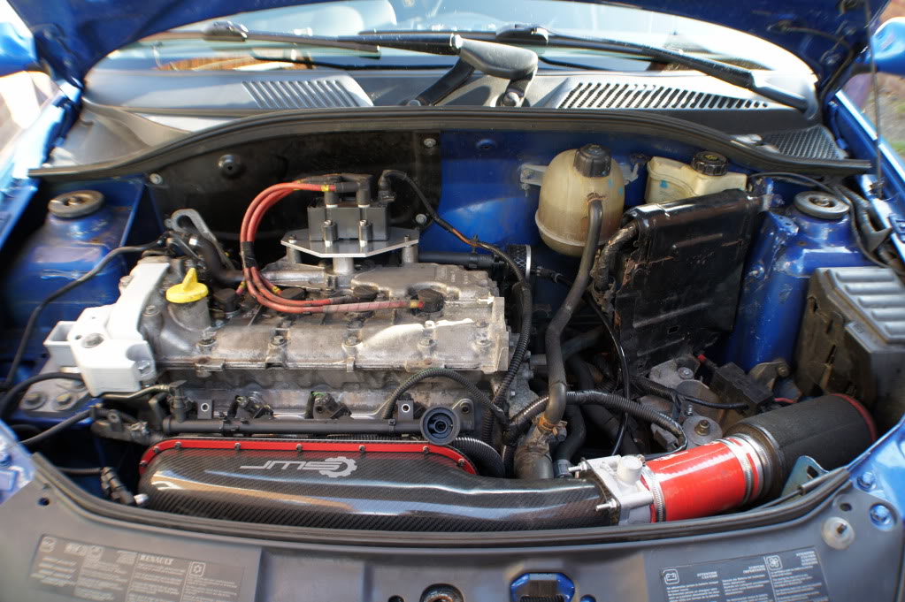

So its that time for the big update!
After me and Tom@JMS had a little chat about the performance manifold they are bringing out I asked if I could put the Cup forward to them to do a bit of development fitting it onto a 172. The car was with them for just over a week and a bit but got it back today! What a lovely piece of kit and looks the mutts nuts, shame the rest of my engine bay lets it down but thats to be sorted in no time.
The power deliveries amazing, really smooth and theres never a time when it feels flat unlike the standard RS inlet manifold which has nothing, nothing then a bit of urgency then back to nothing. Plus it hasn't even got a custom calibration yet so no doubt more to come from the manifold! A big thanks to the JMS guys for the work they've done and putting up with me calling for updates on how its going and putting up with my impatience.
Heres a few pictures of the manifold fitted.

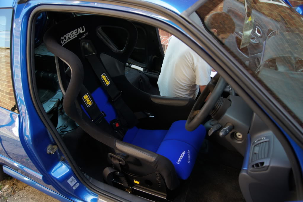

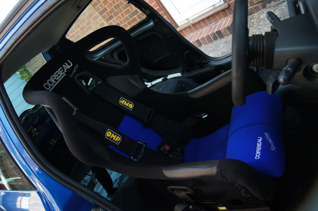

Also got my seat through the post yesterday, a Corbeau Revolution! :) Looks fantastic and holds you so well, feels like your in a little a pod inside the car :evil:
Also waiting apon an OMP 10 point bolt-in rollcage to arrive, once that arrives i'll hopefully get that all trial fitted then sent to the bodyshop to have the interior metal and cage painted mondial blue.

I got the Revolution from Balance Motorsport, its the XL width seat and cost £420 delivered. Was the cheapest I could find...
didnt think id get a reply that quick!! iv found a set of them 1 normal 1 gt for £730 which sounds quite good then, but there local to me so save on the delivery.
