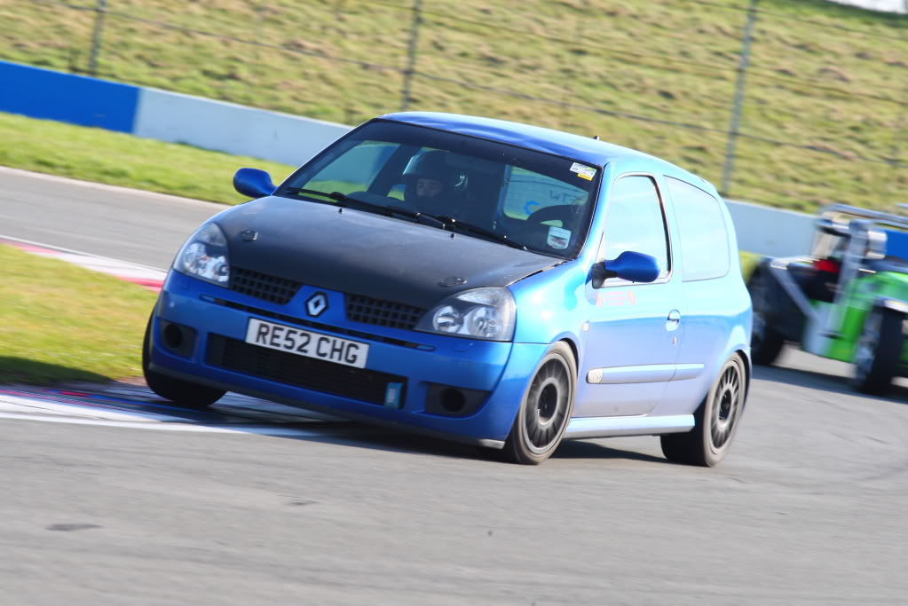

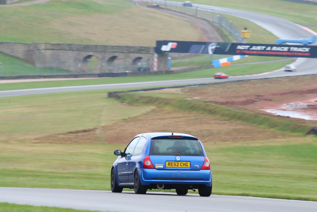

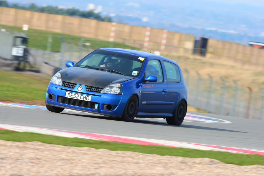

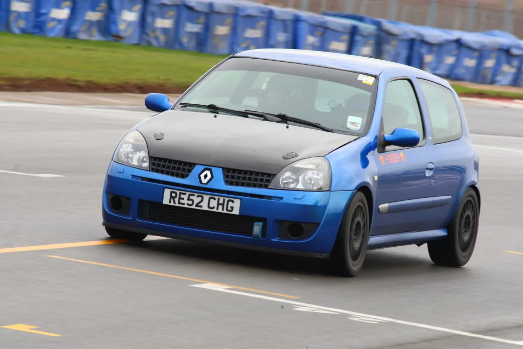

So me and a few of the other locals took the treck up to Donnington for another trackday, all in all the best circuit i've done to date! So much fun and with it ending up being a perfect day the car was flying and thankfully no hickups! Only thing I did do was get the rears rather hot on the outside edges/shoulders, having put a 1 degree shim already in I thought that would be enough (2.2 degrees of Neg) but after speaking to the chap at PureMotorsport he advised putting at least another 1 degree shim on to cure the problem. So got that ordered up there and then!
Anyways a few pictures...
Cheers!

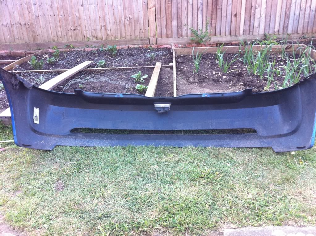

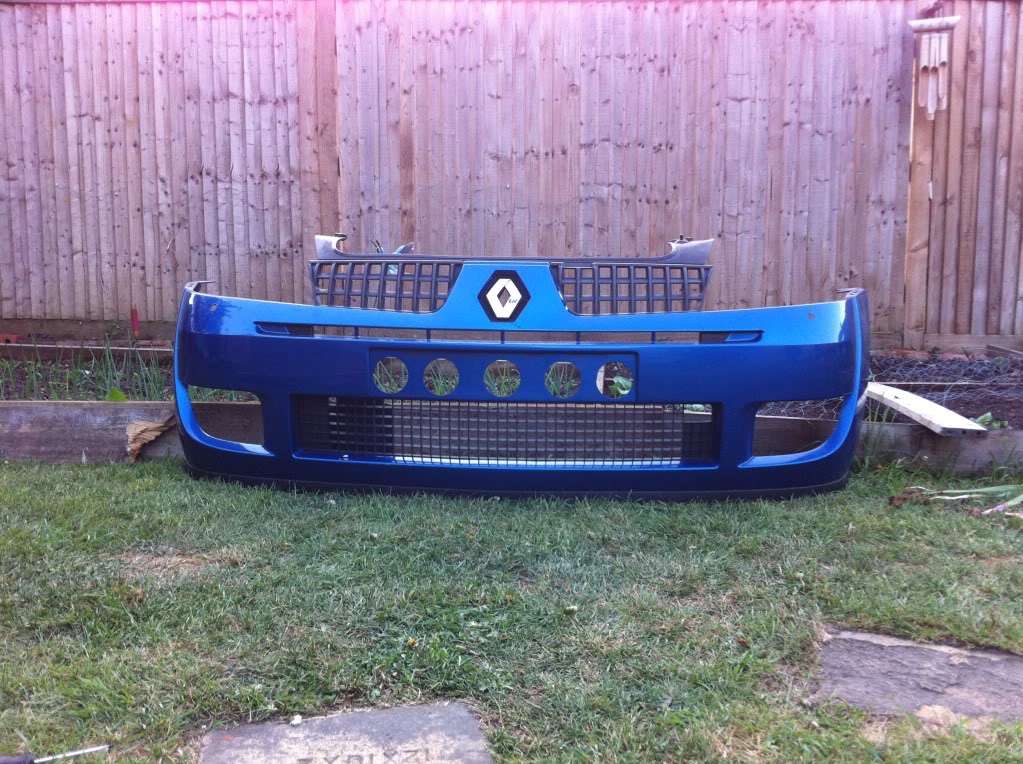

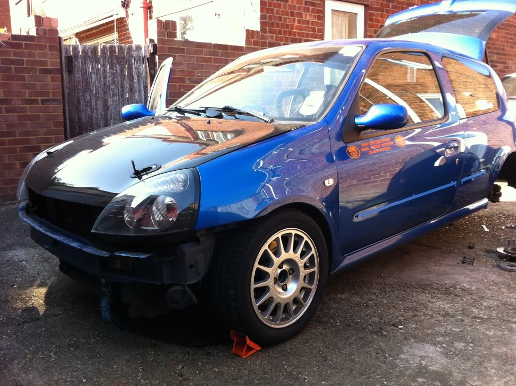

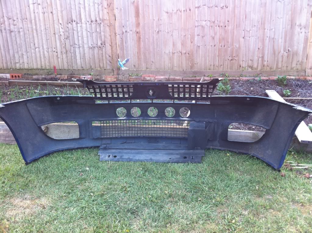

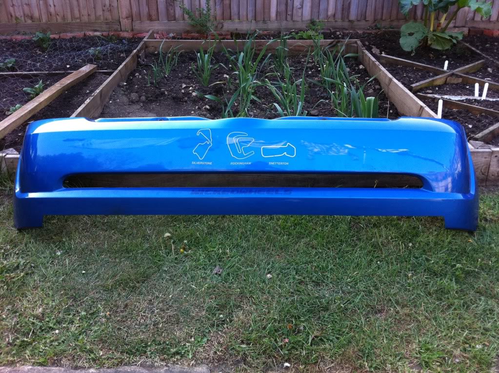

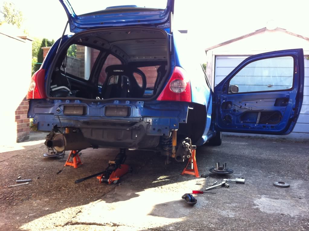

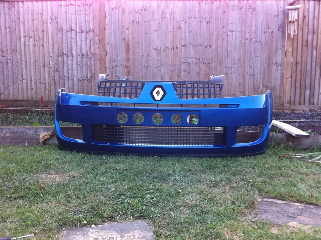

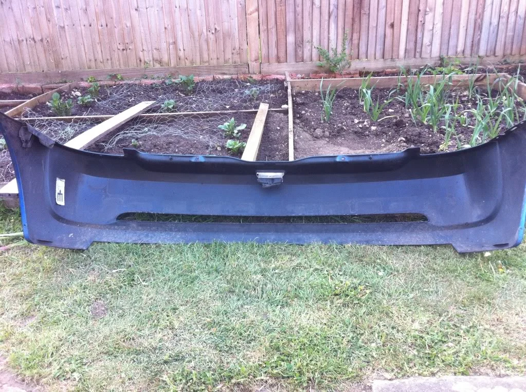

Decided to cut a few things out of both bumpers/remove all the gubbings from behind and fit the camber shims, give me something to do of an afternoon. Anyways a few pictures during and after all back together. :)
Lots of camber now! ;)

Nice pics nick, what camber are you runing on the back - how many shims have you got?
What are you doing with the number plate fitment now you've drilled the holes in the recess?

Looks great Nick. I still maintain your bumper cut out was a moment of genius, really finishes the rear end!
I'm now running 2 x 1degree negative camber shims of each hub, should be given me a total amount of 3-3.5 degrees of camber on the rear.
With regards to the numberplate, not sure to be completely honest! Might get a sticker style one to go on the bonnet or just screw a numberplate over the holes for when its on the road, but we shall see! :) It does look rather good without one completely!
