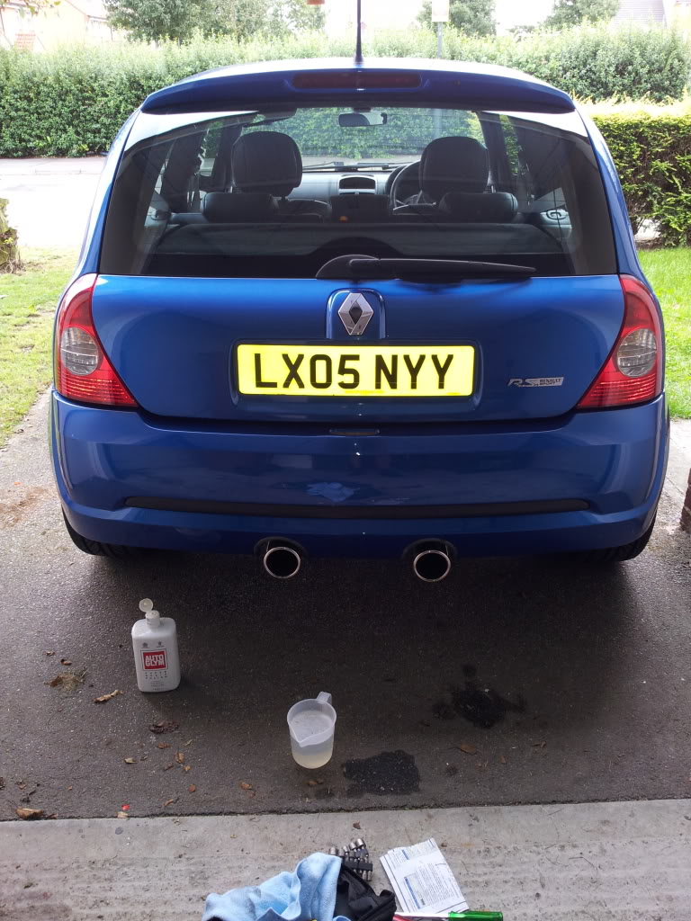

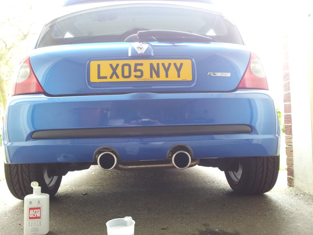

still no alarm unfortunately. ive replaced the alarm module but its still dead, my garage informs that its probably the (insert part name here) control module??
above is a picture of the slightly wonky zorst! new mounts were purchased, any suggestions?
sean
If you mean they dont sit centered into the holes its because the rear mounts are off center , i did mine today slacken off the 13mm nuts on the back two mounts and edge the mounts over till it sits straight in the holes , in terms on high they look bang on to me matey !!
Stefan.
the exhaust mounts really are a pile of horse s**t, to stop them sagging after 18 seconds of fitting them you can put sockets in the gaps and cable tie them in. my yozza didn't sit right but after getting the garage to do so (was in for other work) they sorted that out for me and has been spot on ever since.
