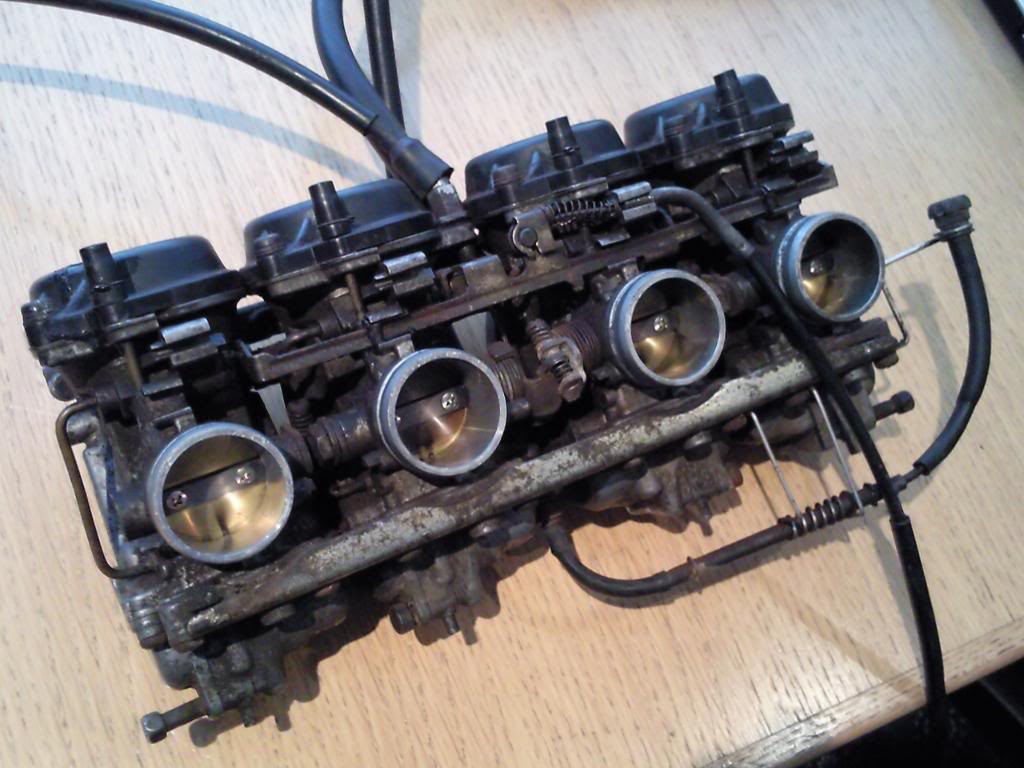

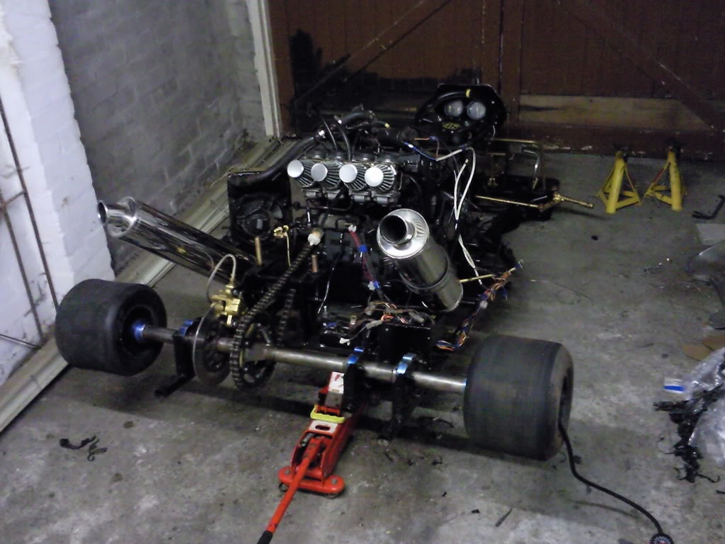

Managed to get the carbs off of the go kart aswell this week to clean them up as the floats were stuck and leaking fuel everywhere.
For those who are interested the carbs came off of this monster ;). Its gsxr powered go kart, which has kept me busy over the winter.

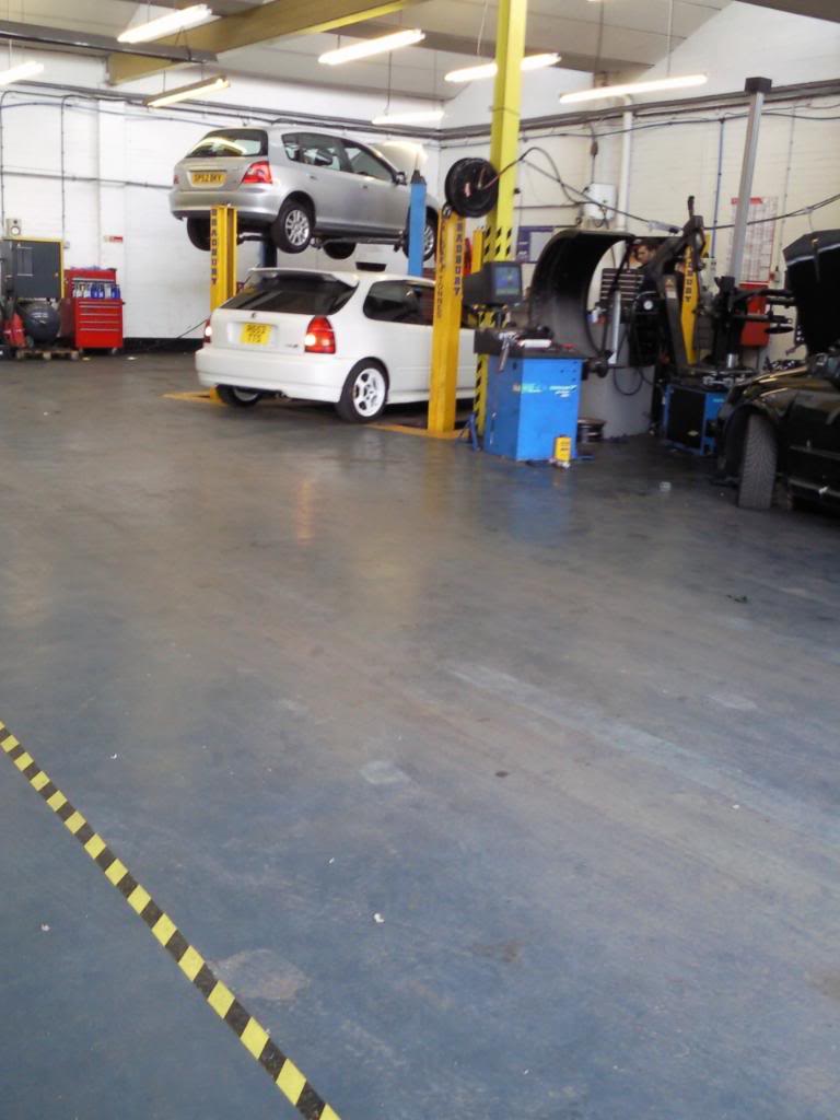

First job was to get my old tyres swapped over as they were of a lower profile. Also got the tyres filled with nitrogen instead of air for a change.
Before:
after (excuse, car was pretty manky when i came back from the tyre fitters)
I dont know if its just a placebo effect but the tyres do feel more grippy with nitrogen. im yet to properly test them out though ;)

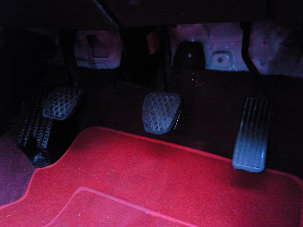

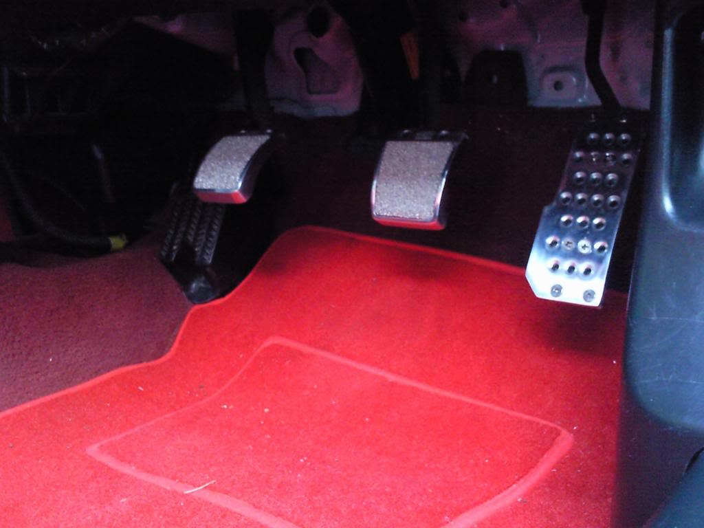

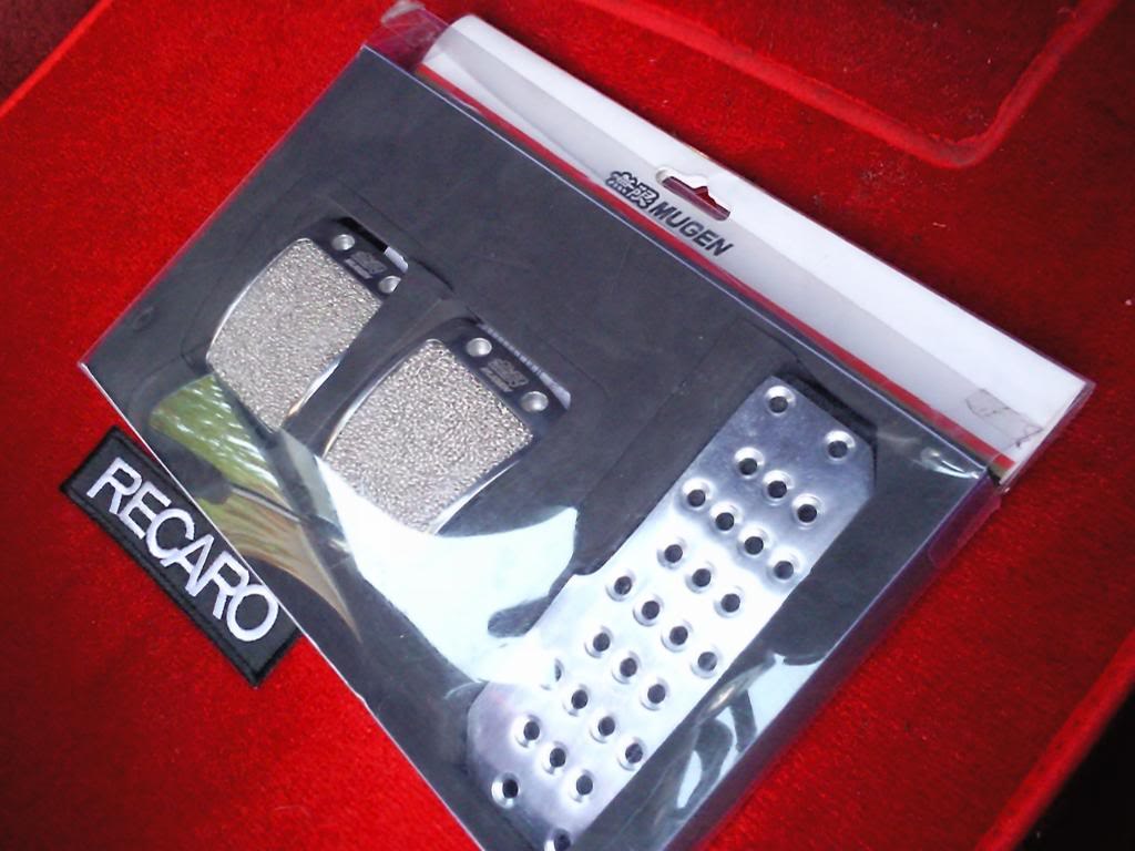

When i came back i started installing the mugen foot pedals.
before:
after

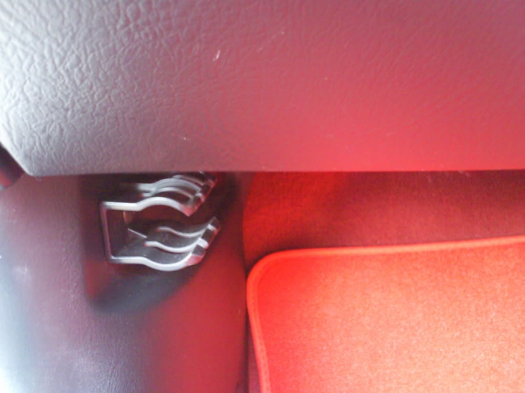

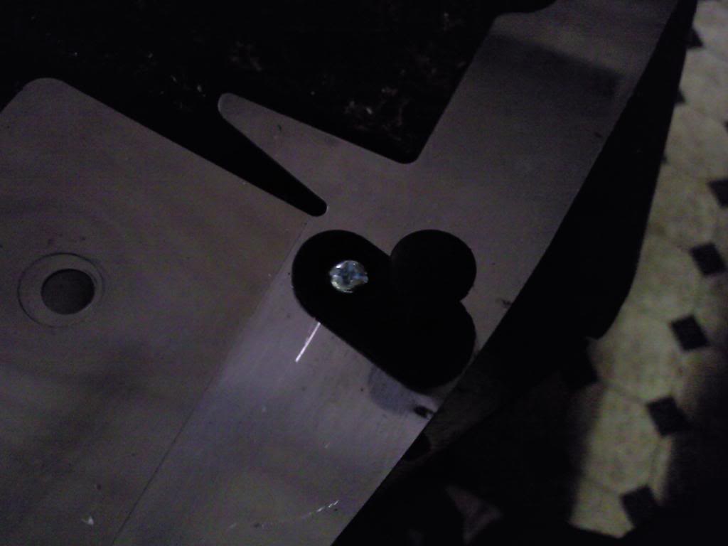

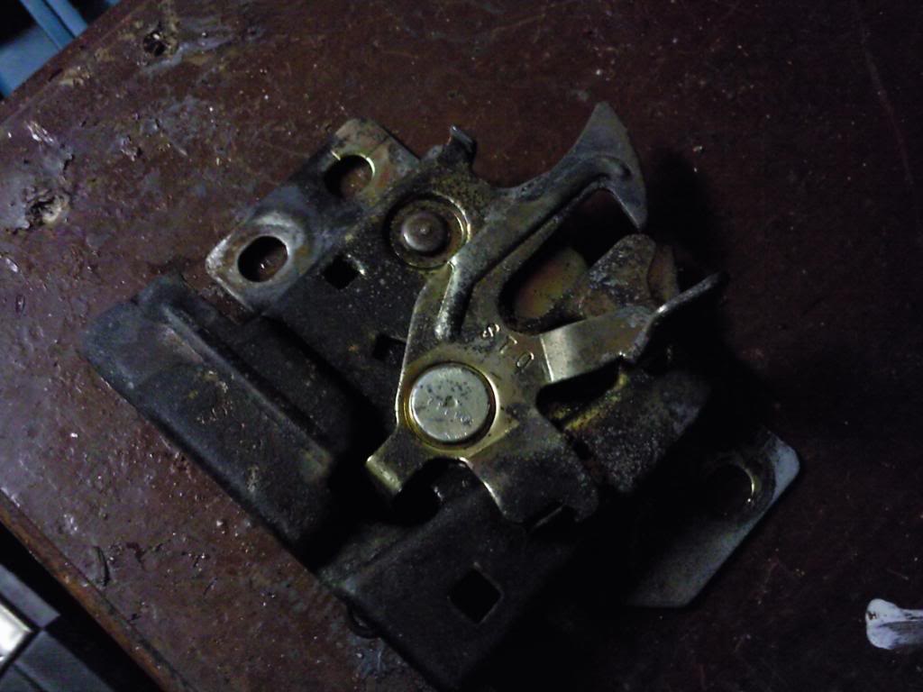

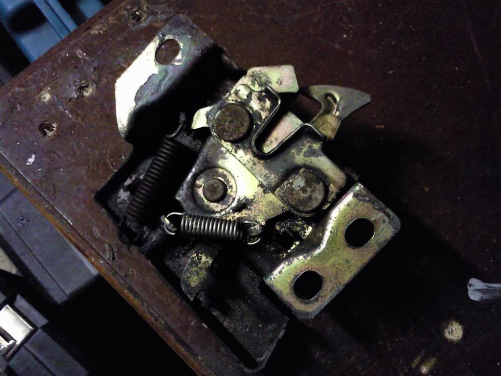

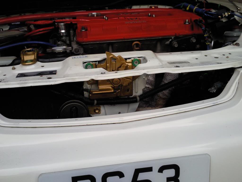

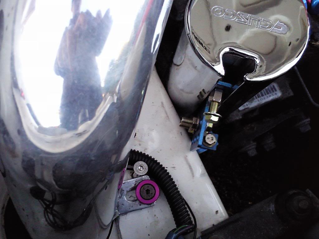

I had to remove the radiator cooling plate to drill a hole out for the bonnet alarm switch so i took the opportunity to remove the bonnet catch to give it a good clean and paint

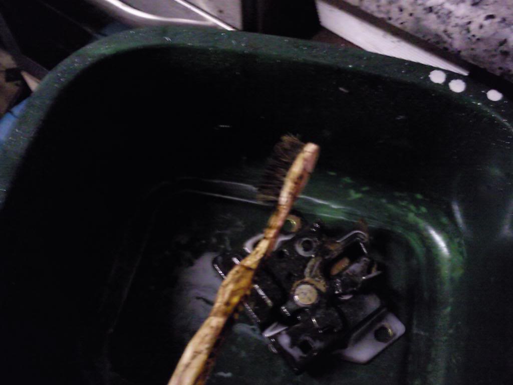

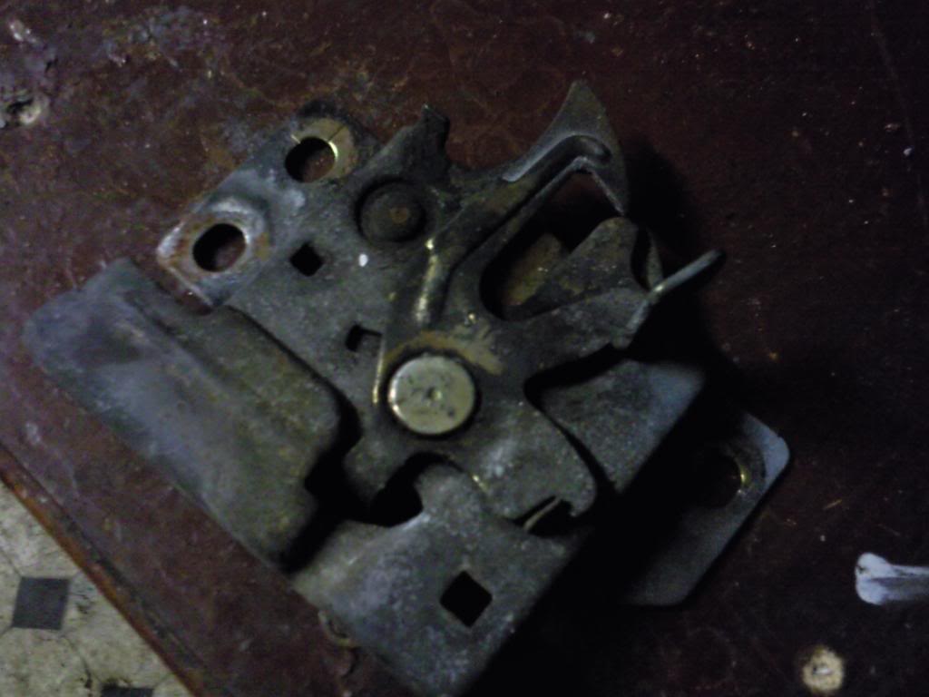

bonnet catch off the car:

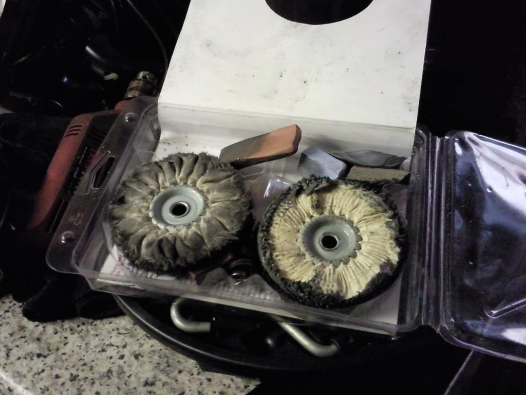

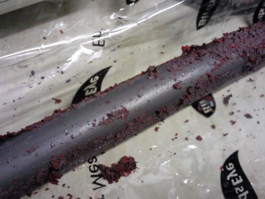

i used an old toothbrush and a combination of autoglym engine degreaser and white spirit to clean it up.
i let it soak for about 30 mins
and then gave it a good blast with the brush
came out good but i stil want happy
so went over it with the polishing kit
and although it looked better i still decided to paint it in some of the vht anodized gold paint

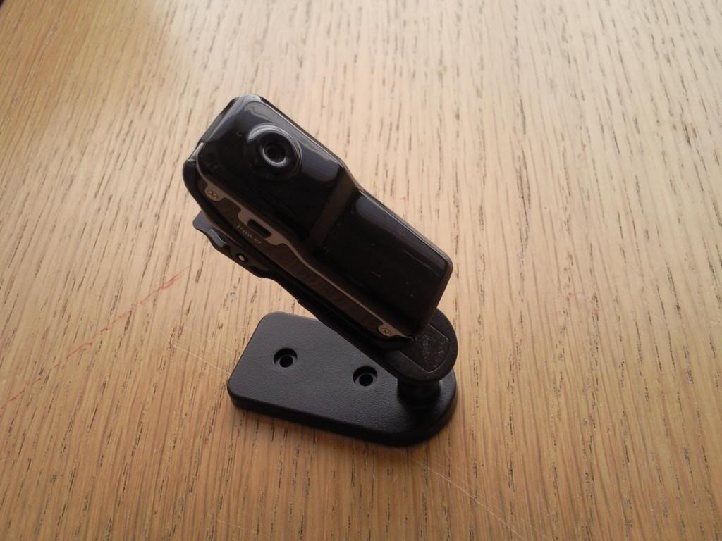

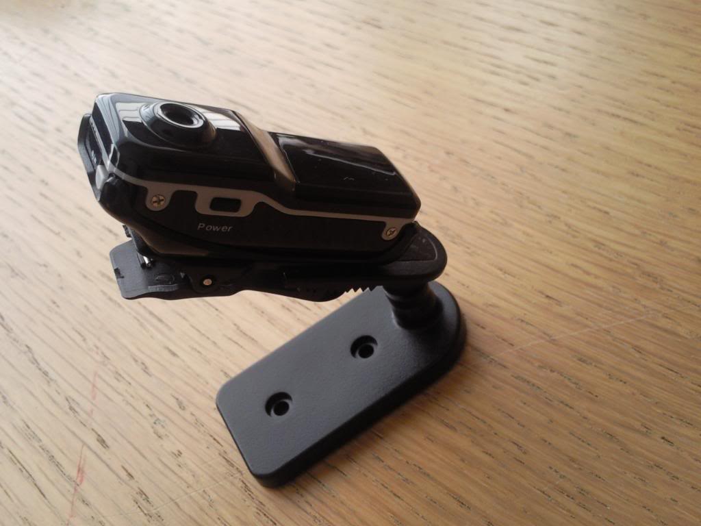

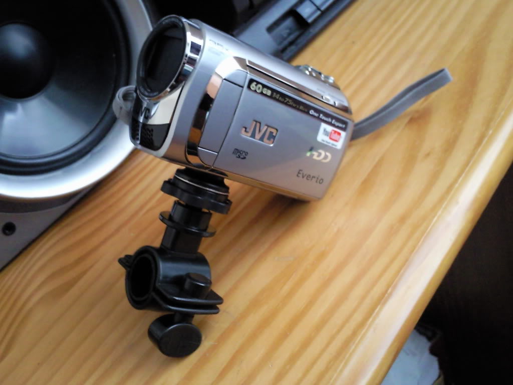

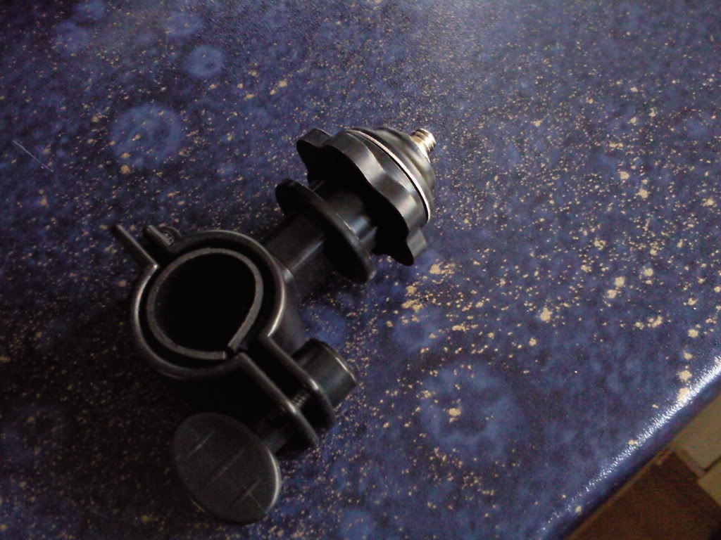

Also got this small camera a while ago but forgot about it at the back of the cupboard so will get a bracket made for that this week. hoping to use it maybe for track days or road trips/b road blasts ect.For the price it seems like a pretty good camera with decent quality footage.

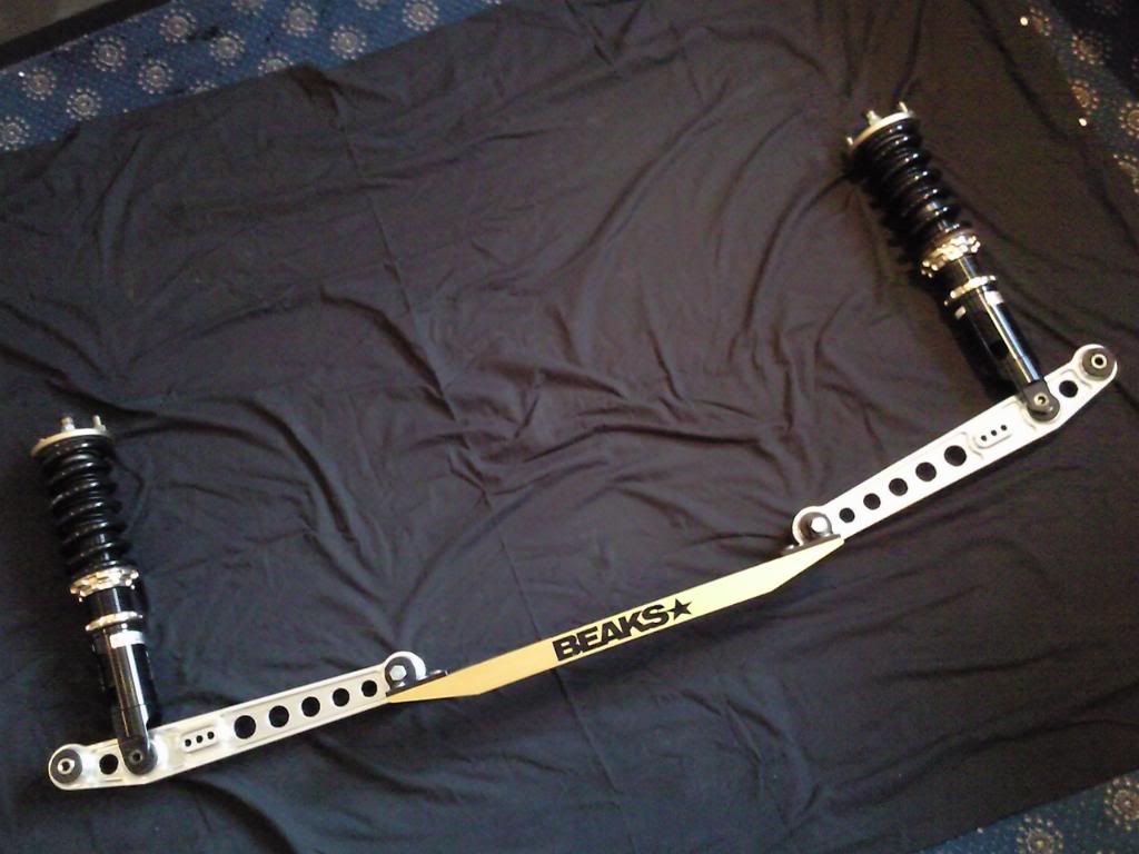

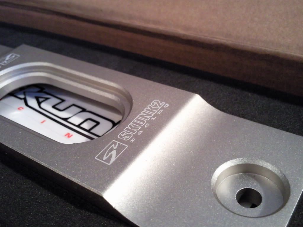

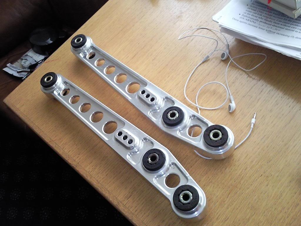

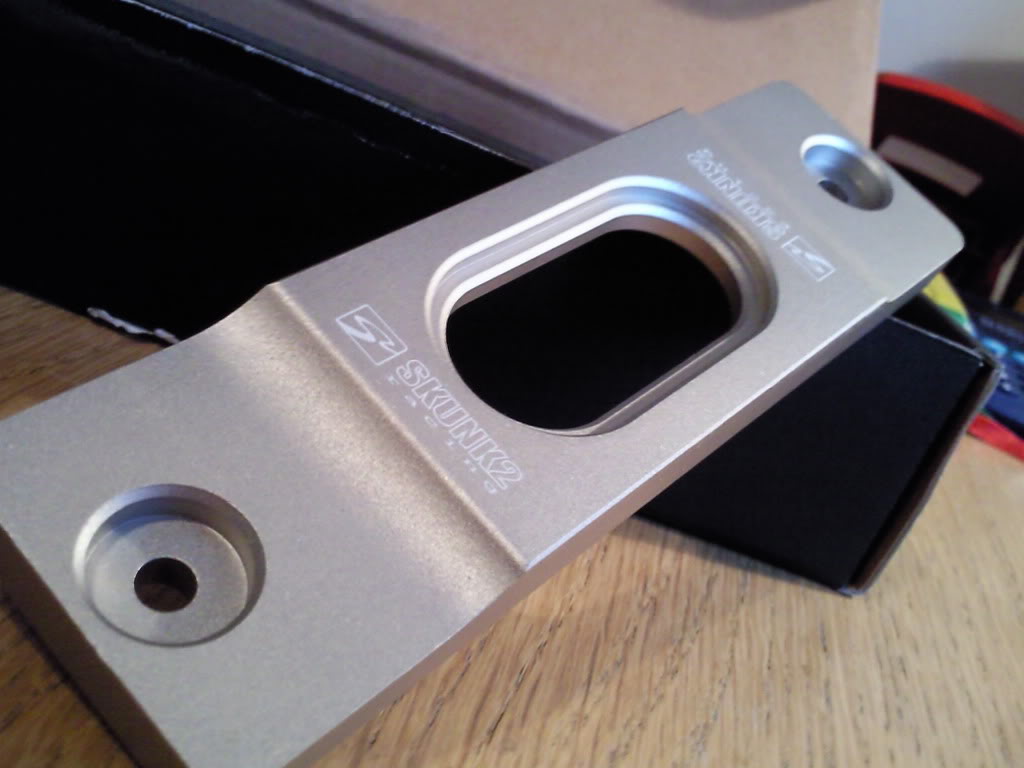

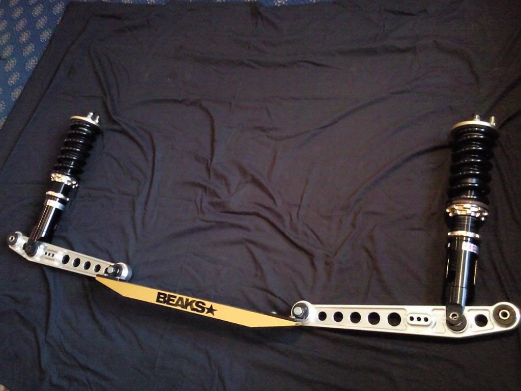

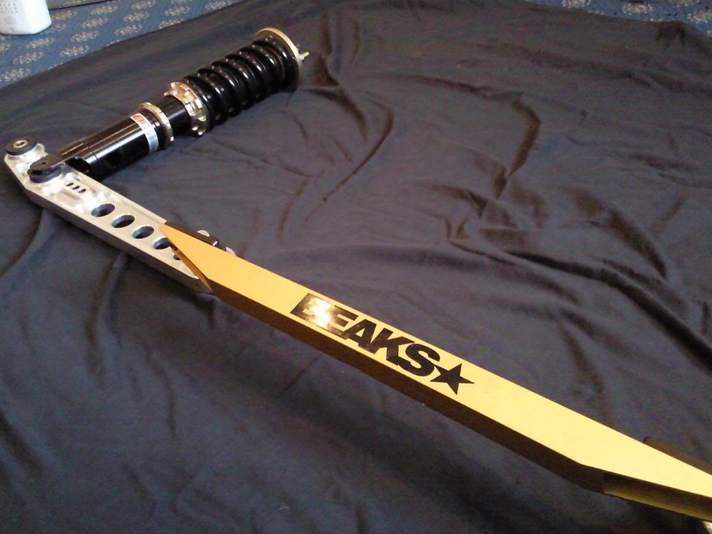

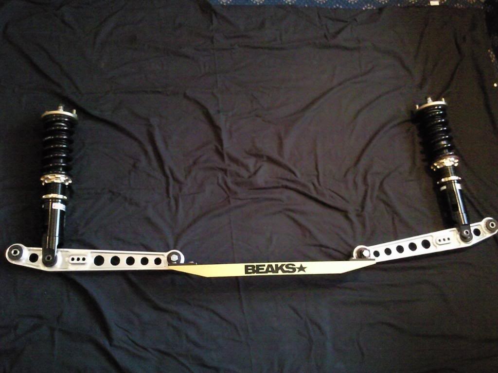

Also got my skunk2 control arms in brushed silver through the door this week
So mock fitted them with the bc coilovers and beaks tie bar to see what the set up will look like under the car. i was pretty happy with them especailly since they should save abit of weight over oem control arms and the bushes are meant to be stiffer too. Hopefully get them fitted as soon as i get the new bolts i ordered today from honda.

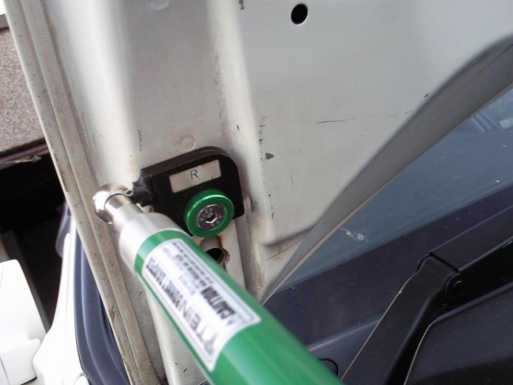

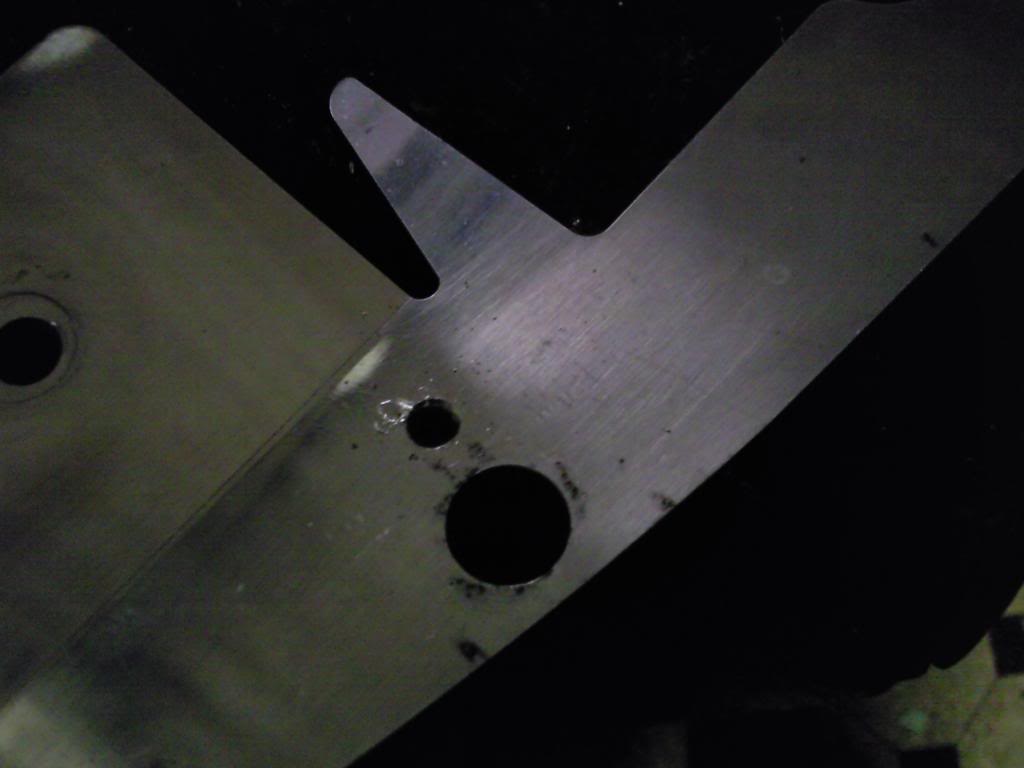

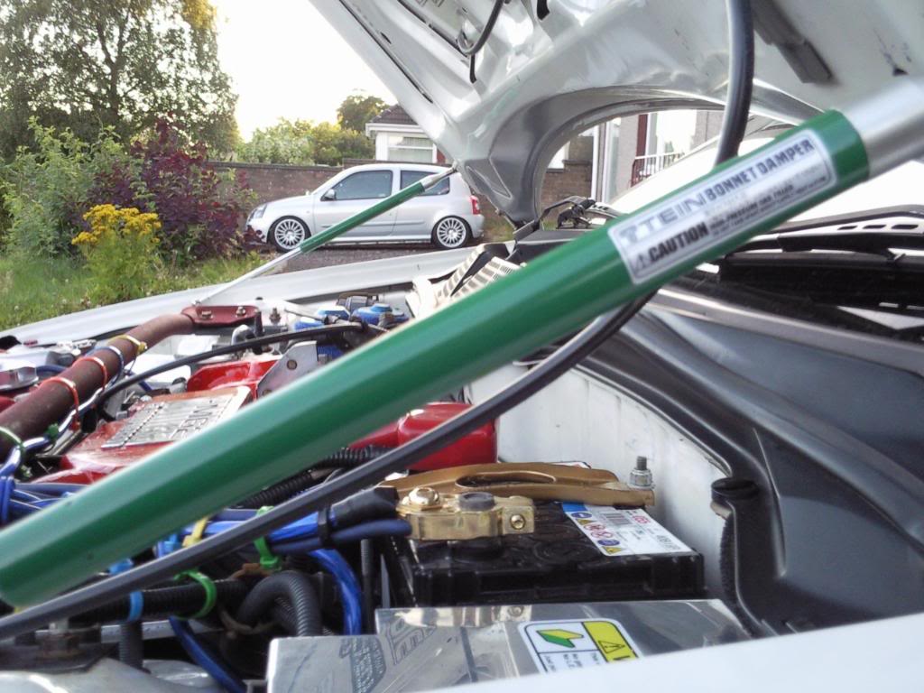

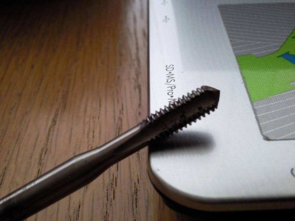

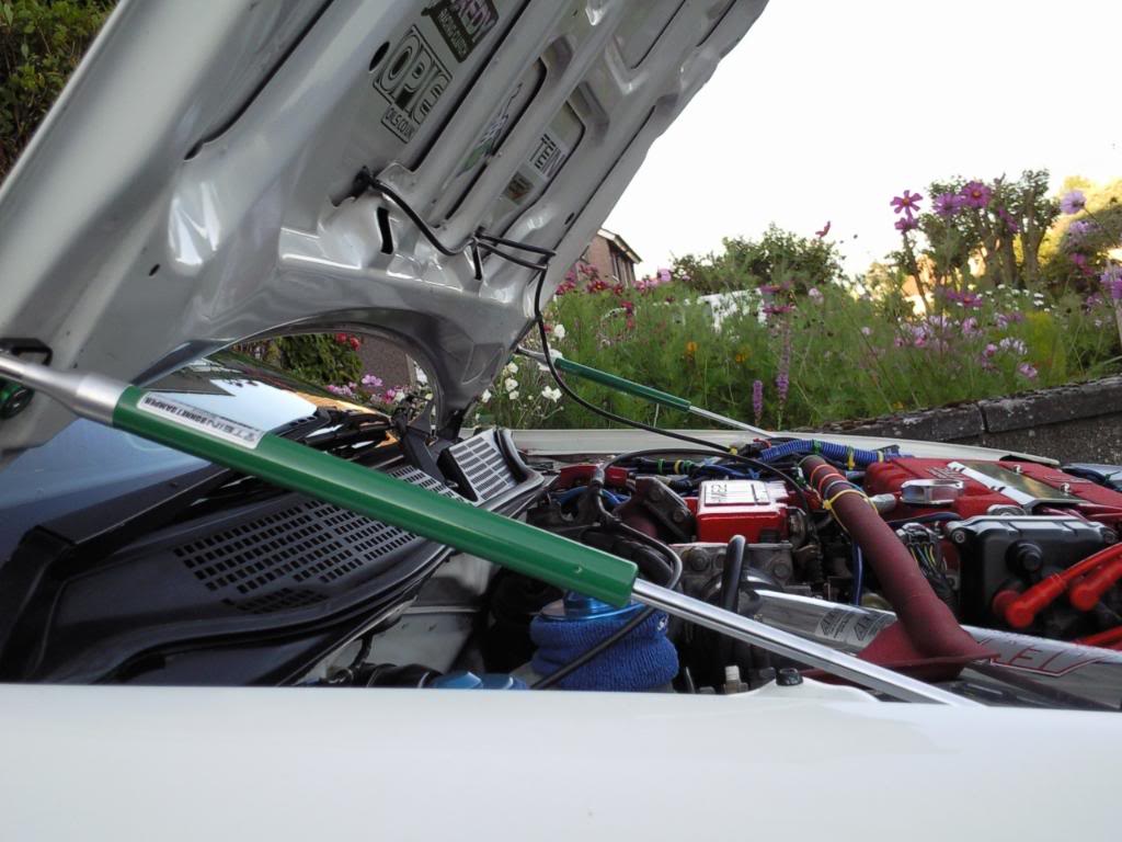

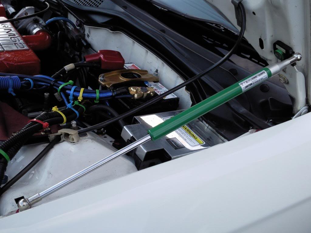

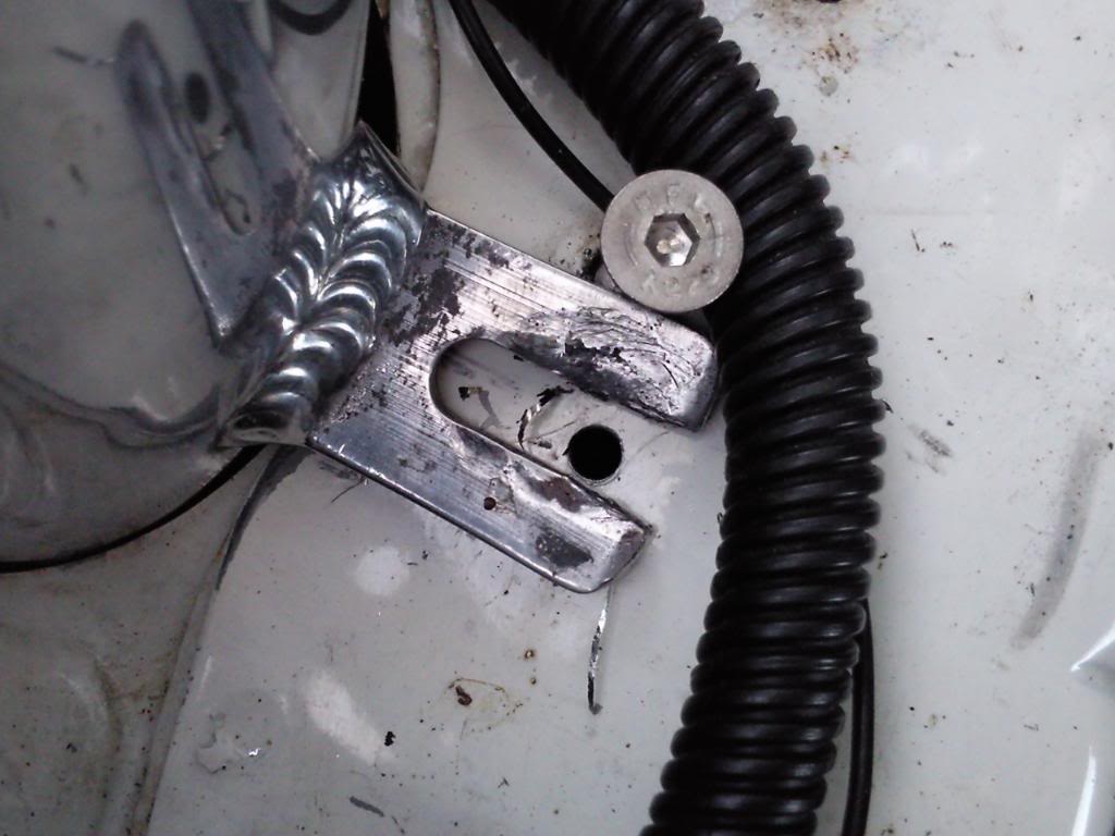

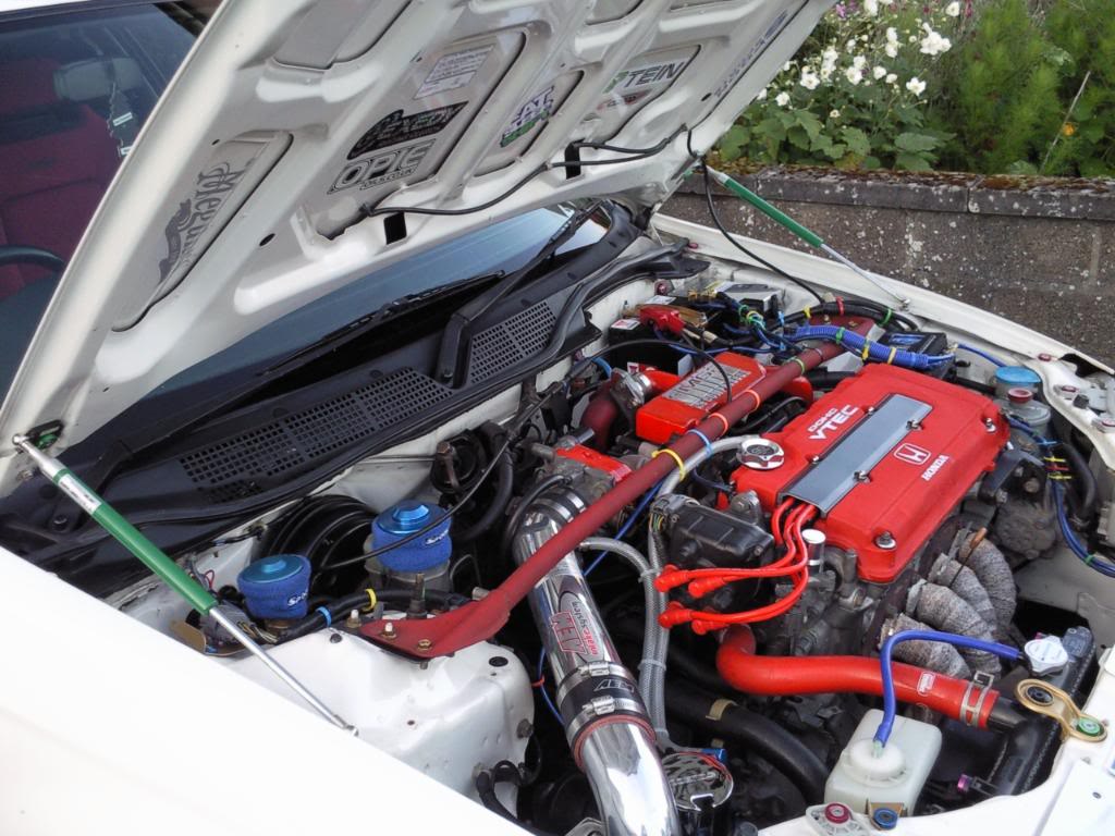

Things never seem to be straight forward with this car. Went to fit the tein bonnet lifters and as i was undoing the nut on the bonnet, it snapped in half :mad:
got the drill and carefully drilled it out.

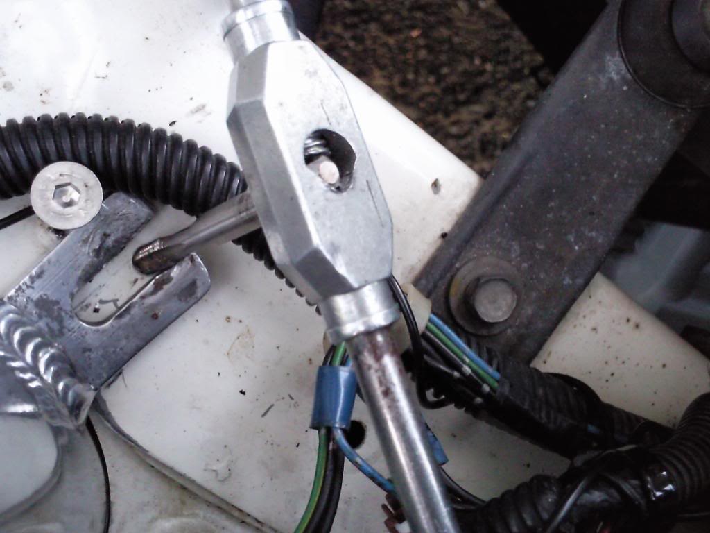

then retapped it using tap that i borrowed from a metal fabricator down the road.
finally got it fitted along with a green anodized washer to go with
out with the old one
in with the new
overall im very happy with the quality of the tein bonnet lifter over the generic one i had on before, although the tein ones arent as powerful

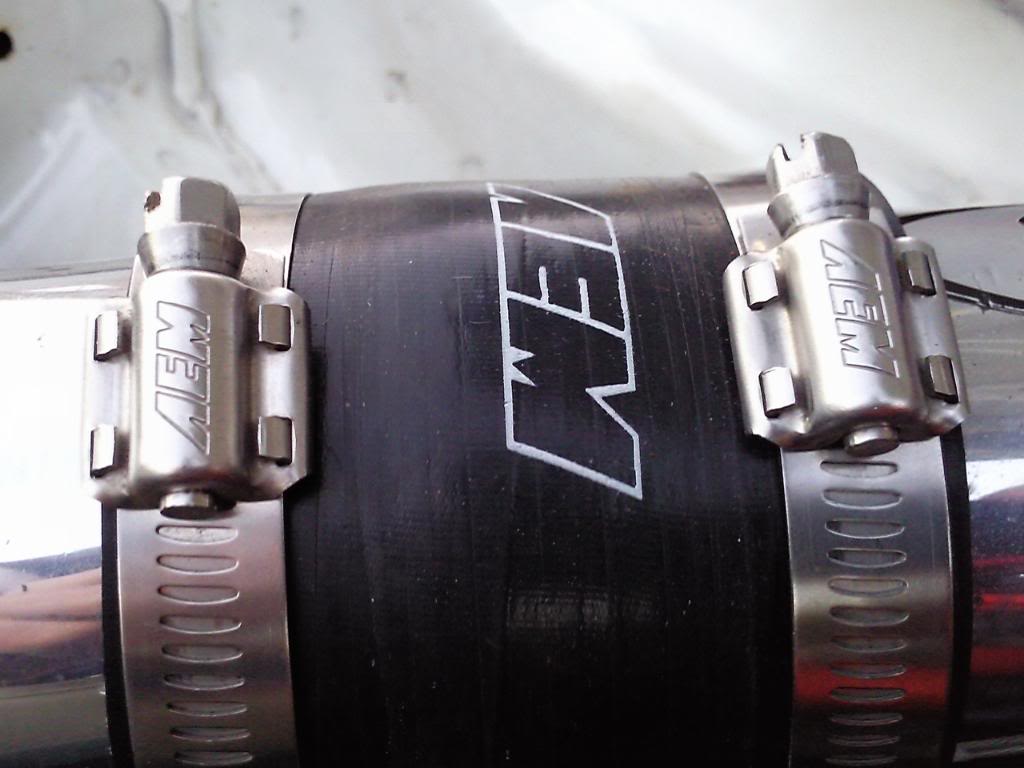

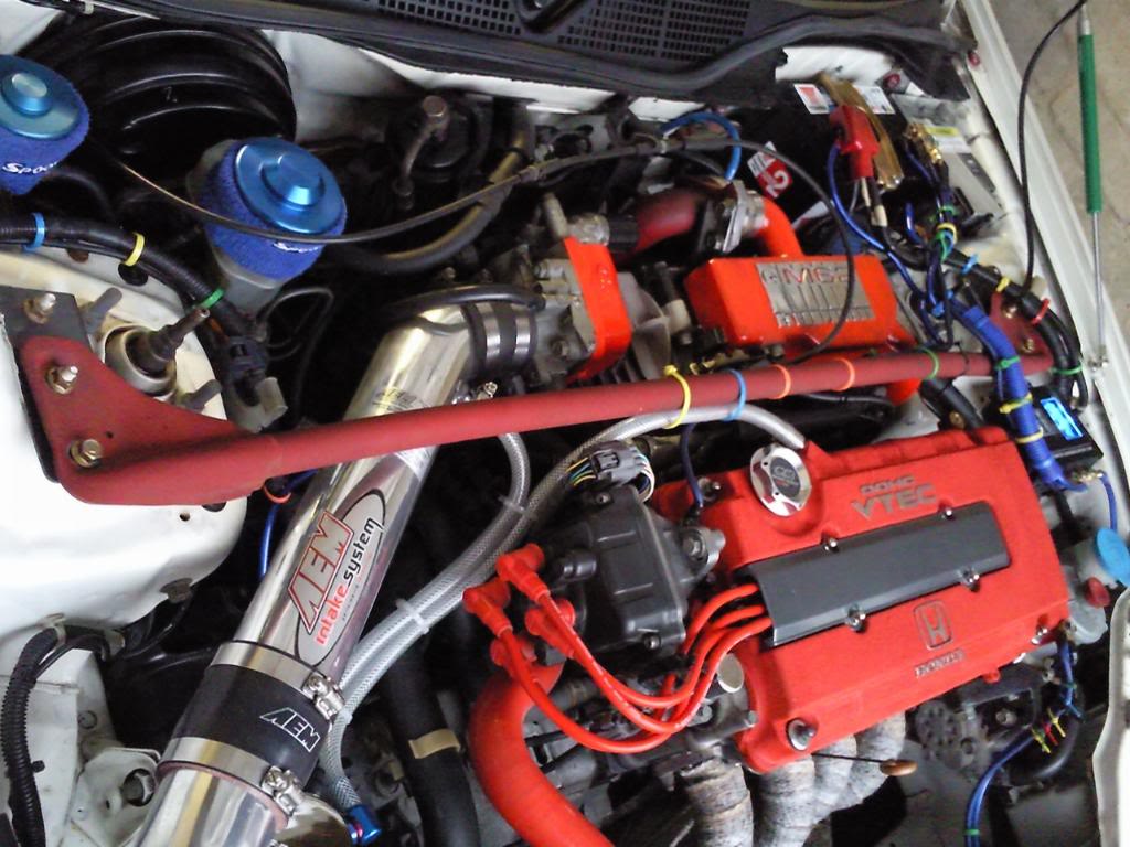

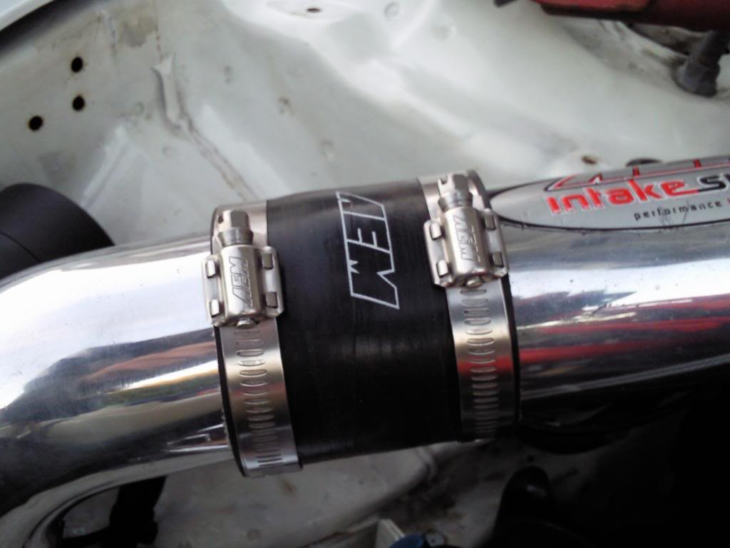

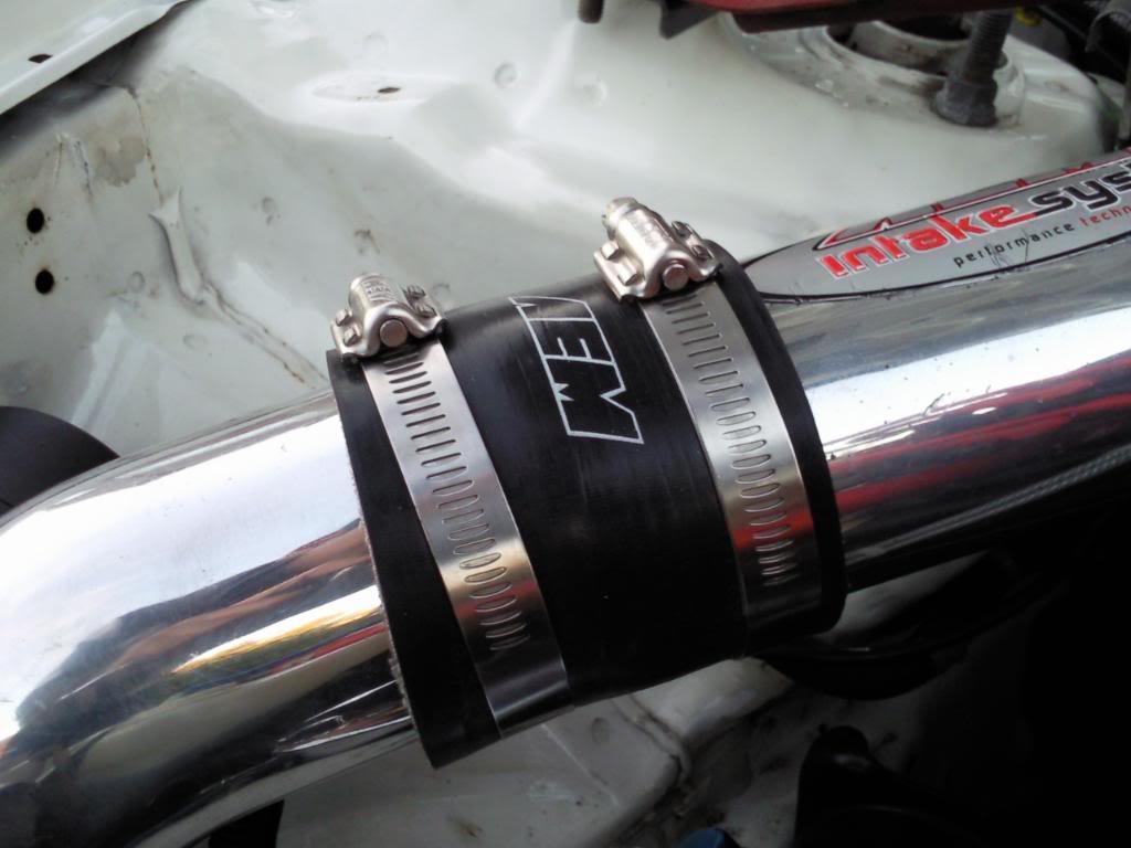

some of you may remember that a bit of cutting and adjusting was needed to get the aem long arm to fit due to the throttle body sticking out further on my set up so it was no surprise that the fixing point for the bolt holding it down was also displaced so i drilled a new one since i had the drill and tap handy
done
minor job but the squint position of the jubilee clips was also bugging me since the civic meet so i moved them in the correct place.

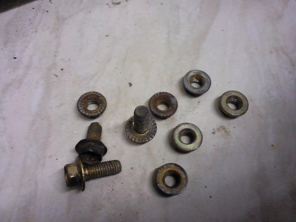

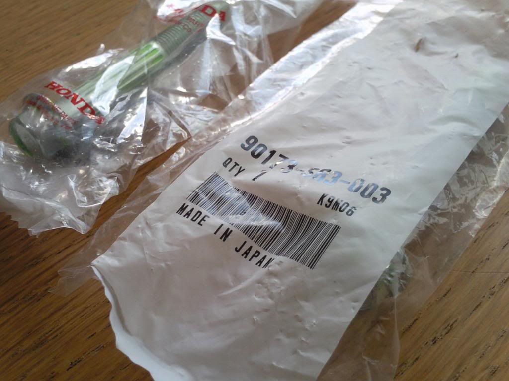

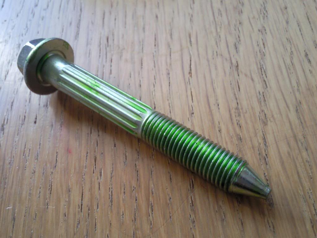

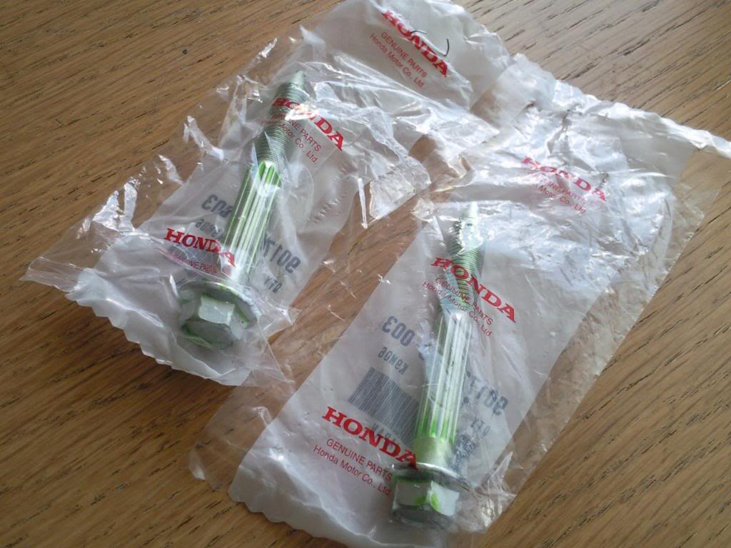

next day i tried fitting the coilovers and control arms but i couldnt get the bolts holding them on to budge even with a breaker bar. so took it into a garage to get the bolts loosened off but they couldnt get them out and i didnt want them to use and air gun incase the bolts snapped and i would end up having to walk home lol. i ordered replacements bolts from honda so as soon as they get here i will just get them out with an air gun and if they snap i will just drill them out but need to wait for he replacements first.
so managed to get 2 of the 8 bolts i need from honda today as it was in stock. £10 for 2 bolts is bloody extortionate imo. whats worse is they want £90 for arb rear drop links. just hope i dont end up snapping mines when i take them off.

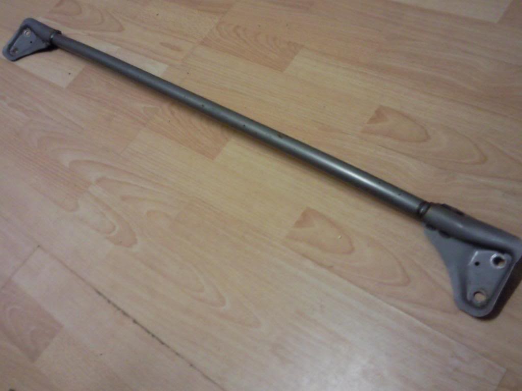

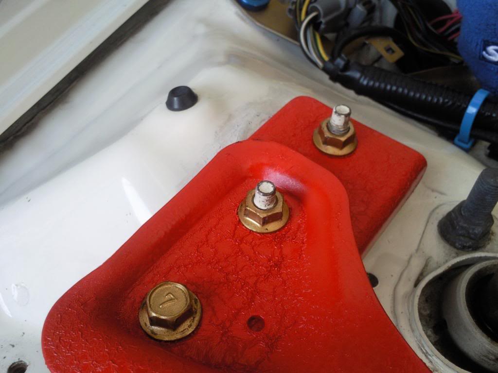

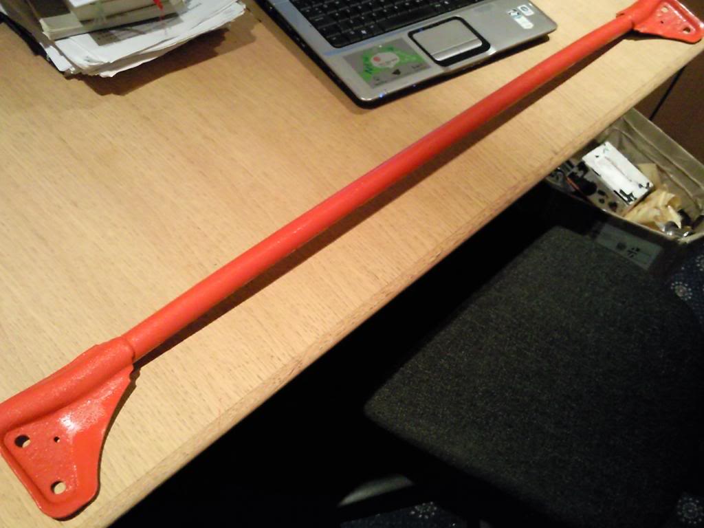

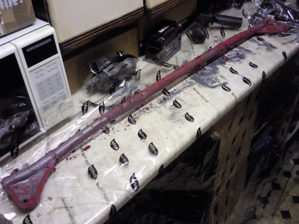

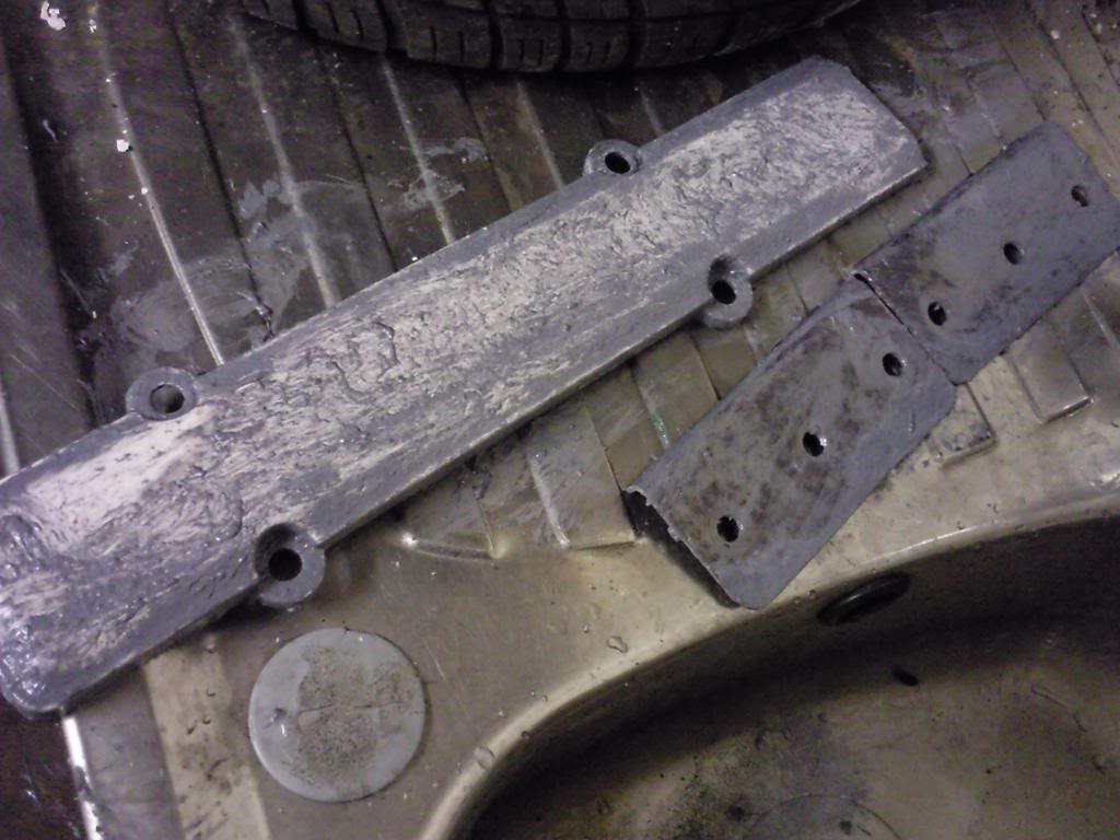

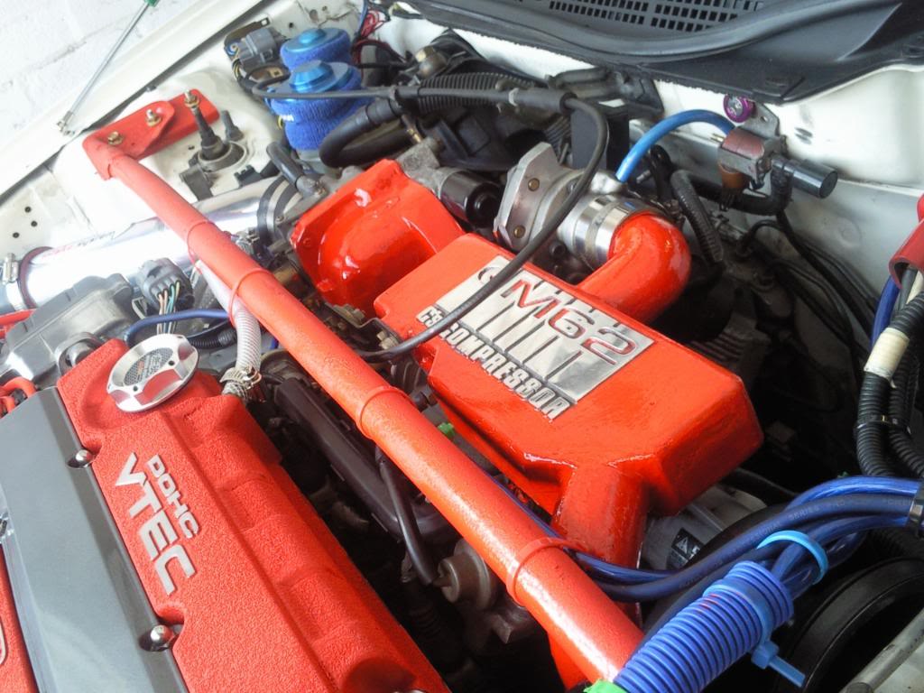

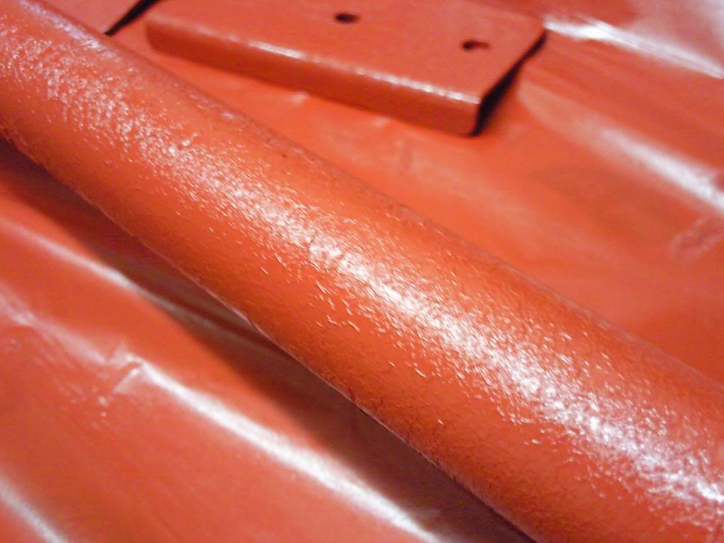

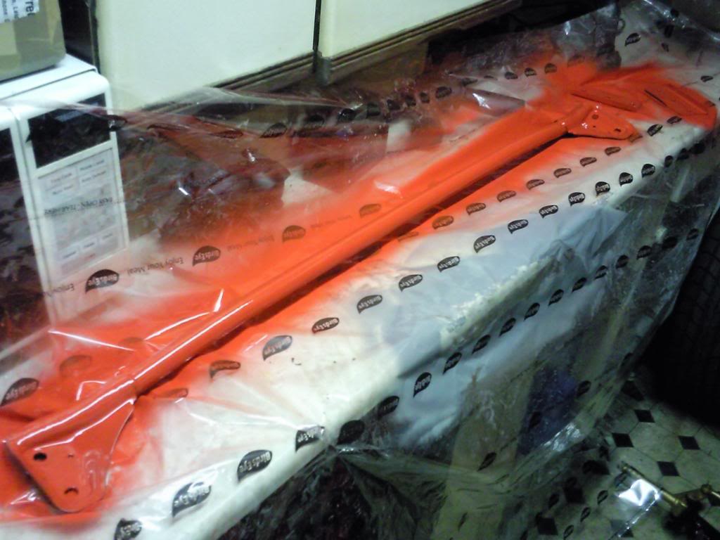

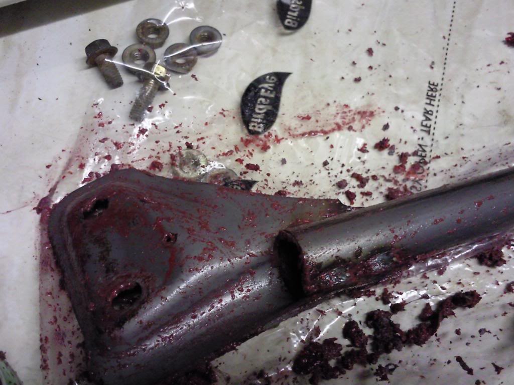

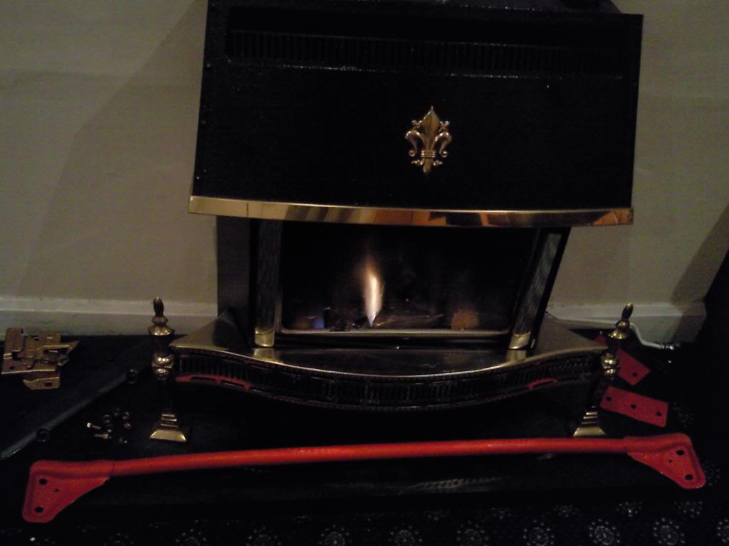

next i wanted to freshen up the strut brace and i also wanted the colour of the strut brace to match the colour of the rocker cover and supercharger so i removed it and took it next door
off the car

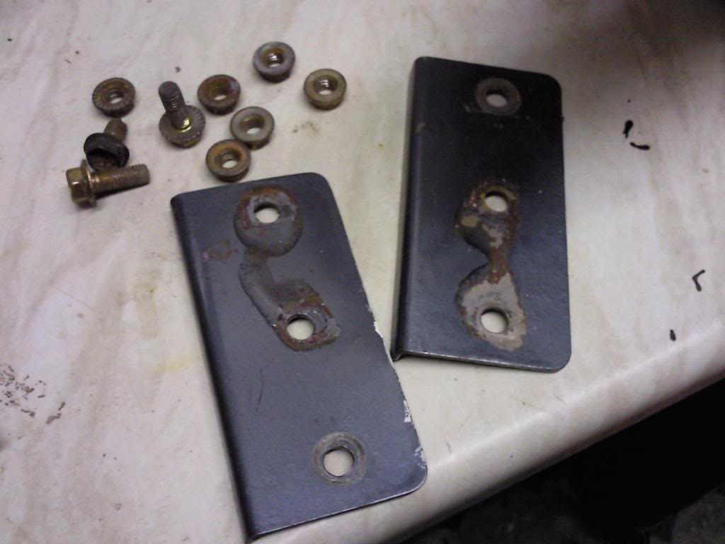

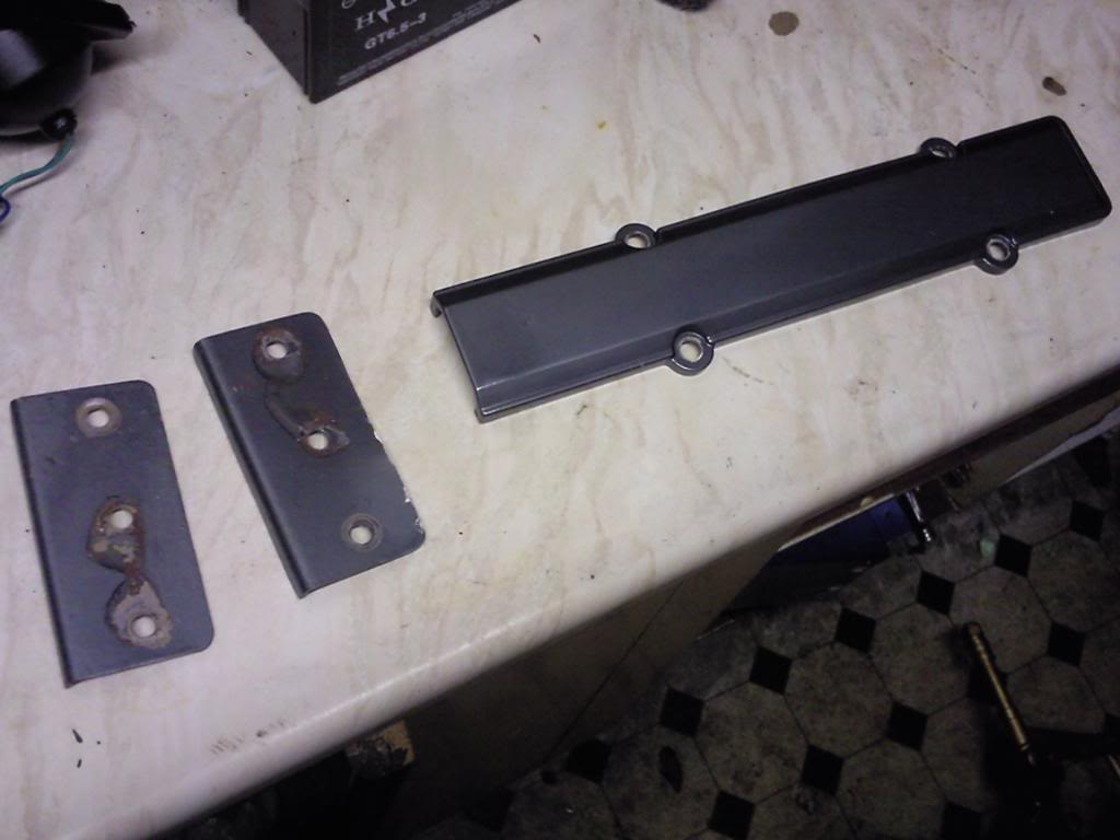

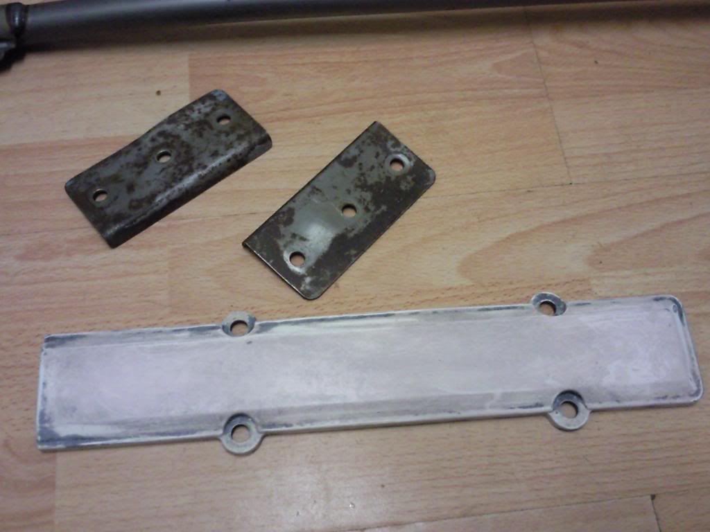

These are the brackets and bolts holding the strut brace on. the brackets were custom made to move the strut brace forward and allow it to clear the supercharger. i recently painted them anthracite but i wasnt happy as it started to flake. i decided to get them done in vht wrinckle red to match the rocker cover and strut brace and also to give them more of an oem look.

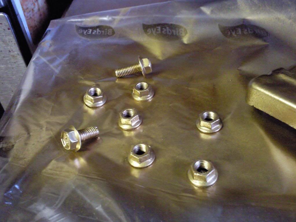

strut brace bolts looking abit dull
so decided to give them a blast with the vht anodized gold paint

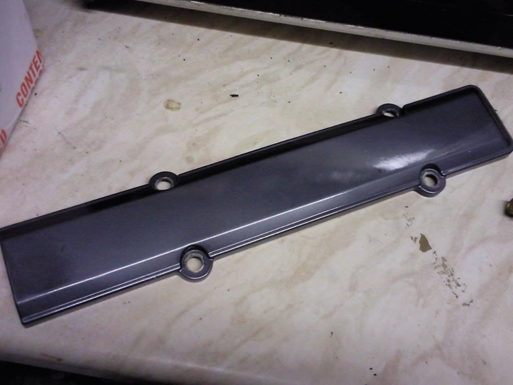

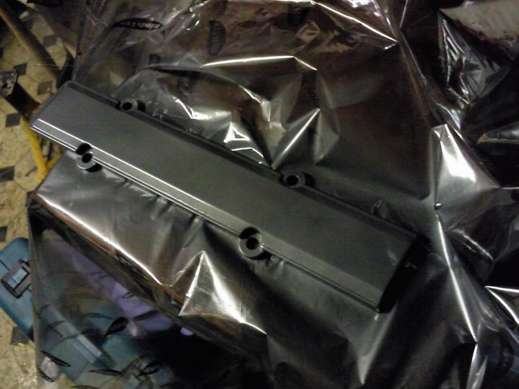

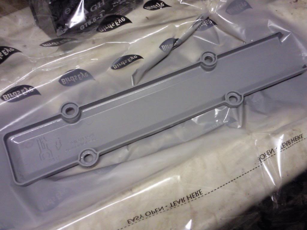

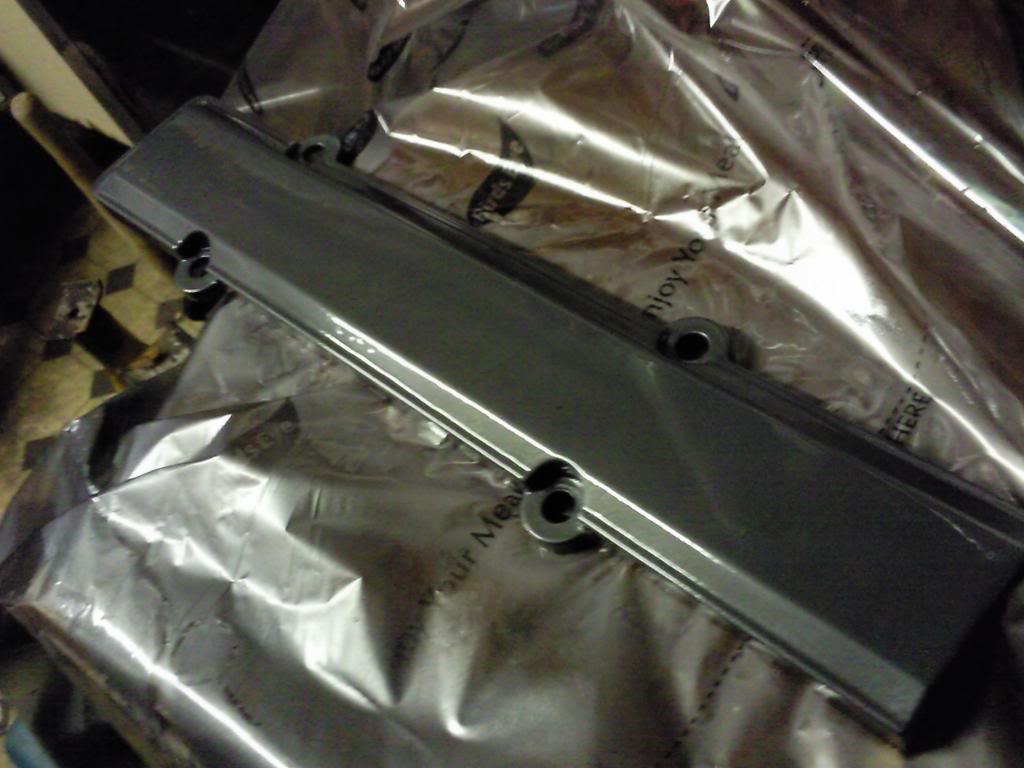

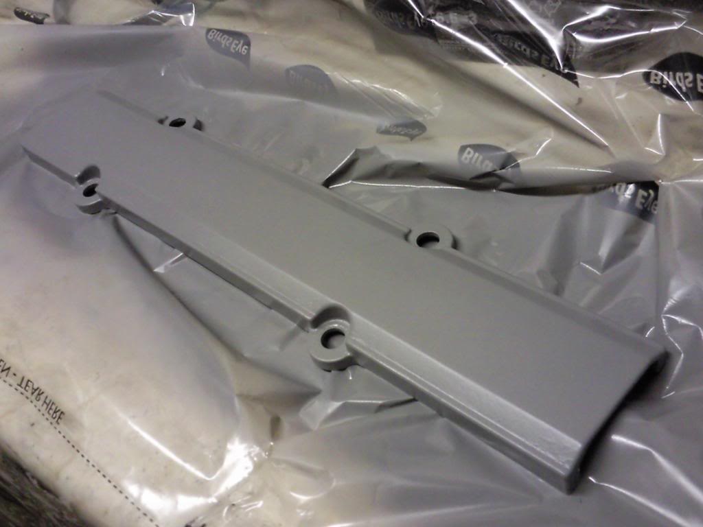

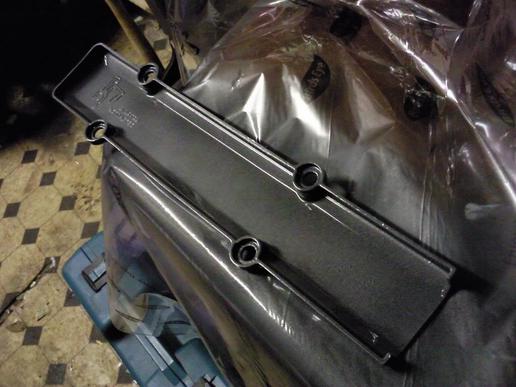

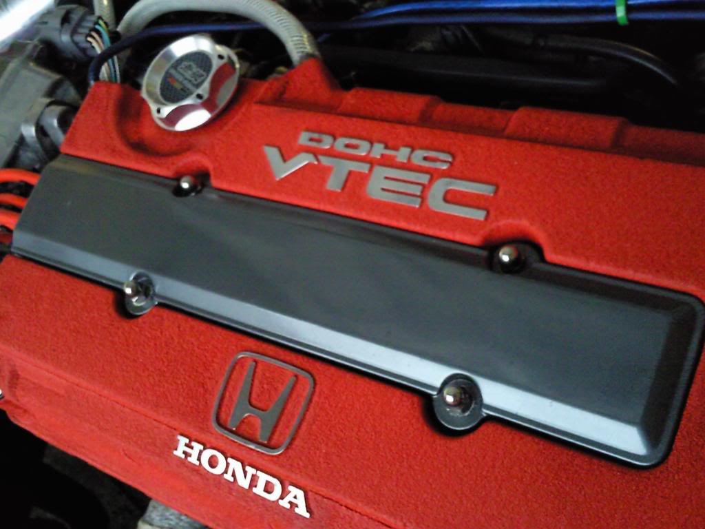

same with the spark plug cover. although painted recently there were a few imperfections that i wanted to sort out. i kept it anthracite as its similar to the oem colour honda used.
whipped it off

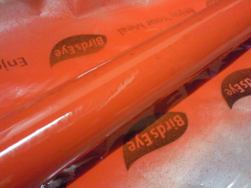

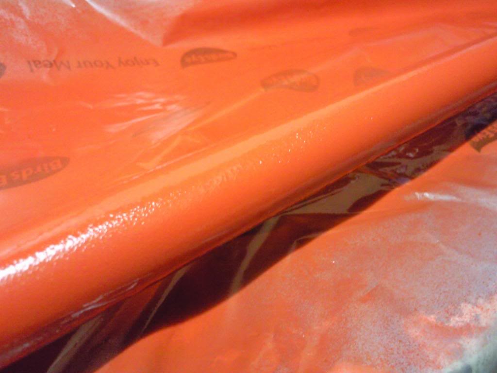

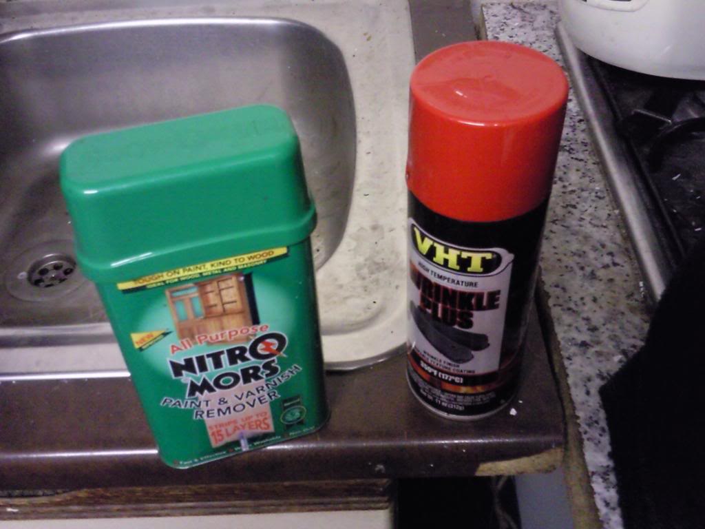

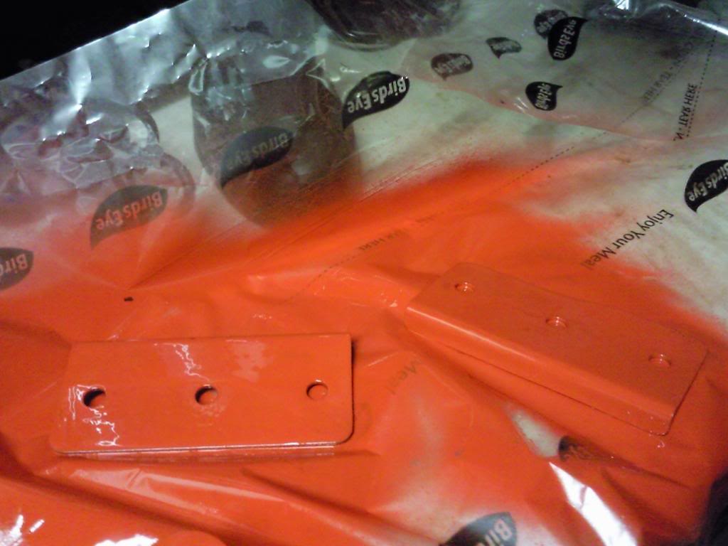

got the nitomors paint stripper and vht wrinckle paint out
everything down to the bare, hosed/dried and wiped down with white spirit i was ready to get painting.
the vht paint needs thick layers and heat to make it wrinckle so got the hairdrier out lol
took everything inside and let it dry in front of the heater for a while
Finished and ready to fit

make sure they are trying to undo the nut and not the bolt as its splined and you wont undo it otherwise lol...
  Charged Superleggera
yeh malice tried it but still no budge man. its a pretty common problem on the civics unfortunately so new bolts are inevitable i think

Fitted the parts i painted the other day. Also got a call from honda saying my bolts are here so should hopefully have the coilovers, control arms and tie bar fitted this week aswell.
Also drilled out the hole for the alarm sensor.
Freshly painted bonnet catch,

Can I ask how much the pedals were?
Oh is the accelerator one not slippy? Looks like no grips.

If they're anything like the Rx pedals on the later cars, they'll be awesome to use. Perfect for H&T.
paid around £110 for them mate. Its not too bad but im yet to try them with wet shoes.

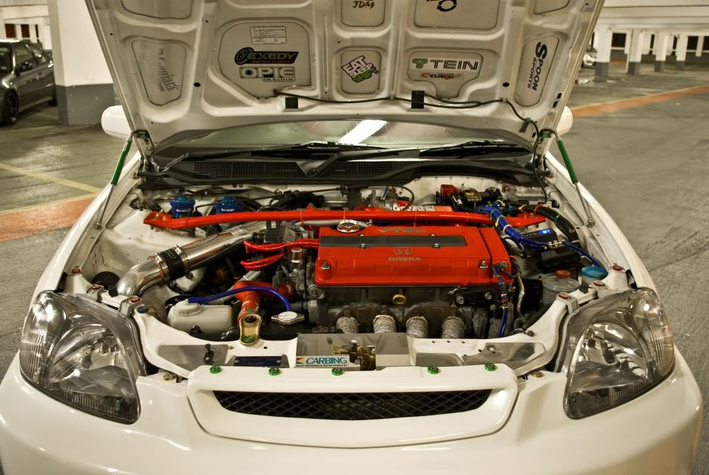

Finally i attended a photoshoot the weekend before the car was tucked away. pictures were taken by my friend for his magazine.

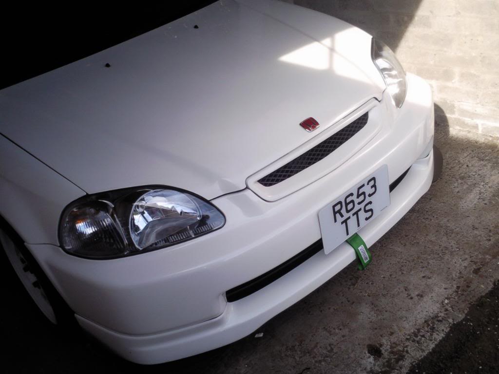

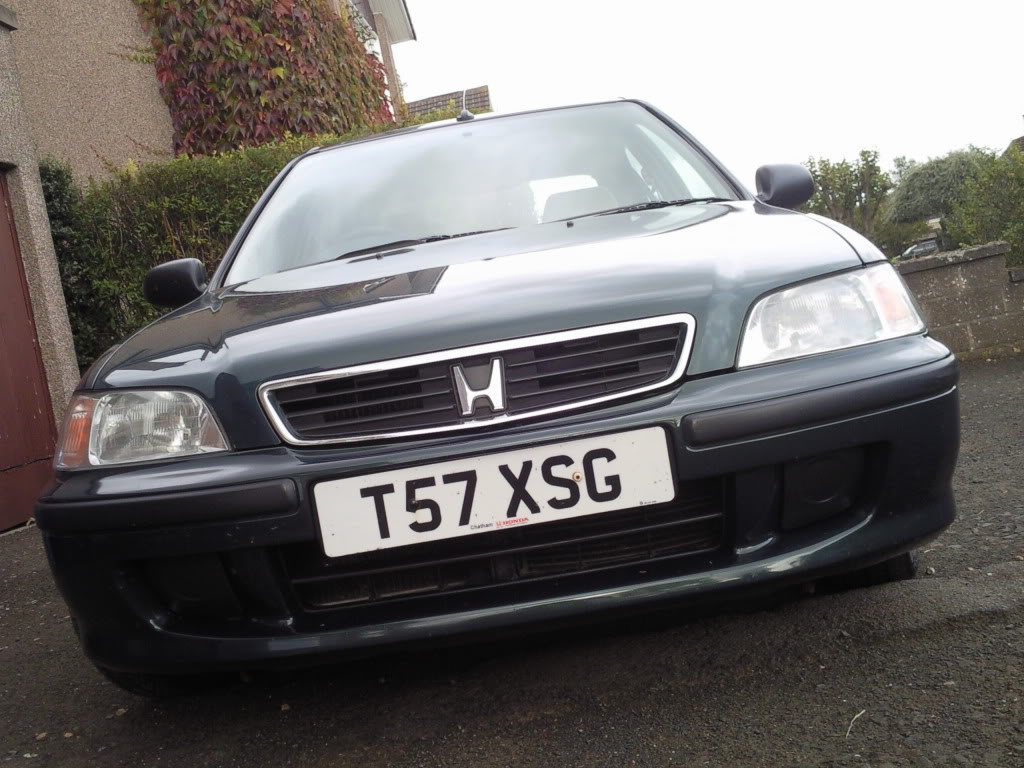

This is the new run around civic i bought about a month ago. Great little runner, reasonably comfy and very economical. I stay near the hospital so it only ever gets used when i go to see my parents in the weekends or for shopping and most importantly it keeps the miles and salt off of the ek9, which is tucked away in the garage for the winter. Although i did start it up 2 days ago as it had not been started up for about a month and i took it for a short blast and oh my do i miss it.

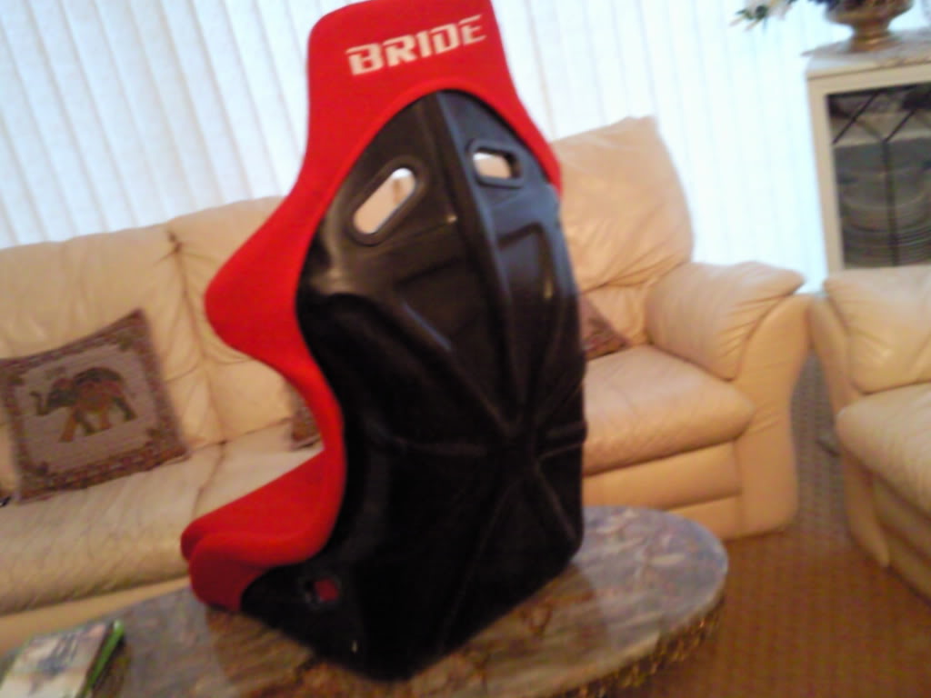

The fixed bride seat arrived but its too small for me so im getting ride of it along with the ek9 recaro's for a set of red fixed recaro pole positions/spg's with another takata harness for the passengers seat.

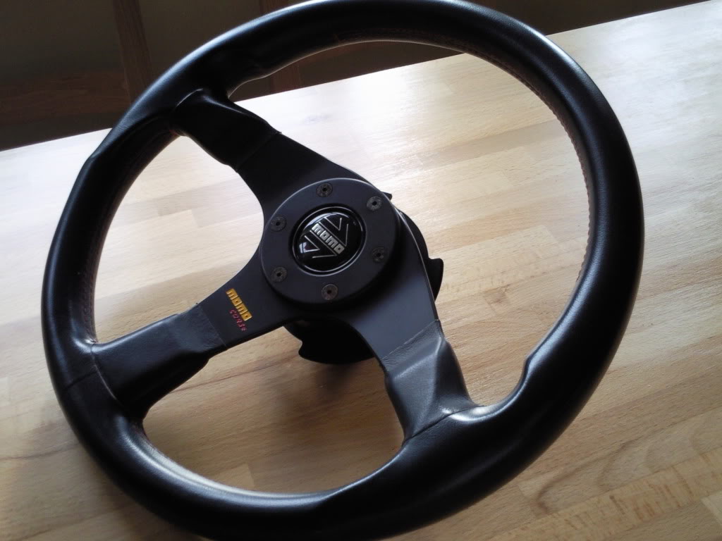

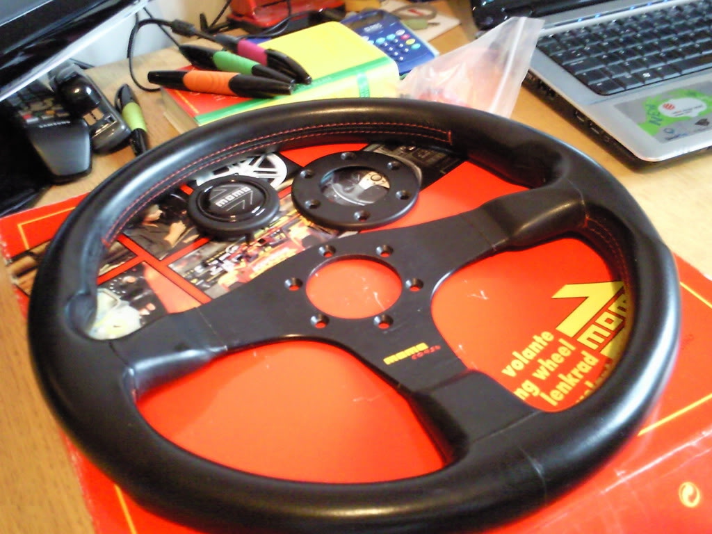

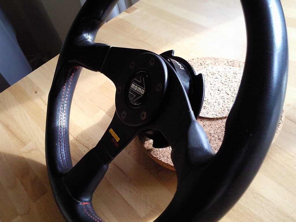

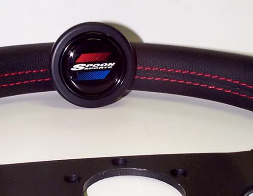

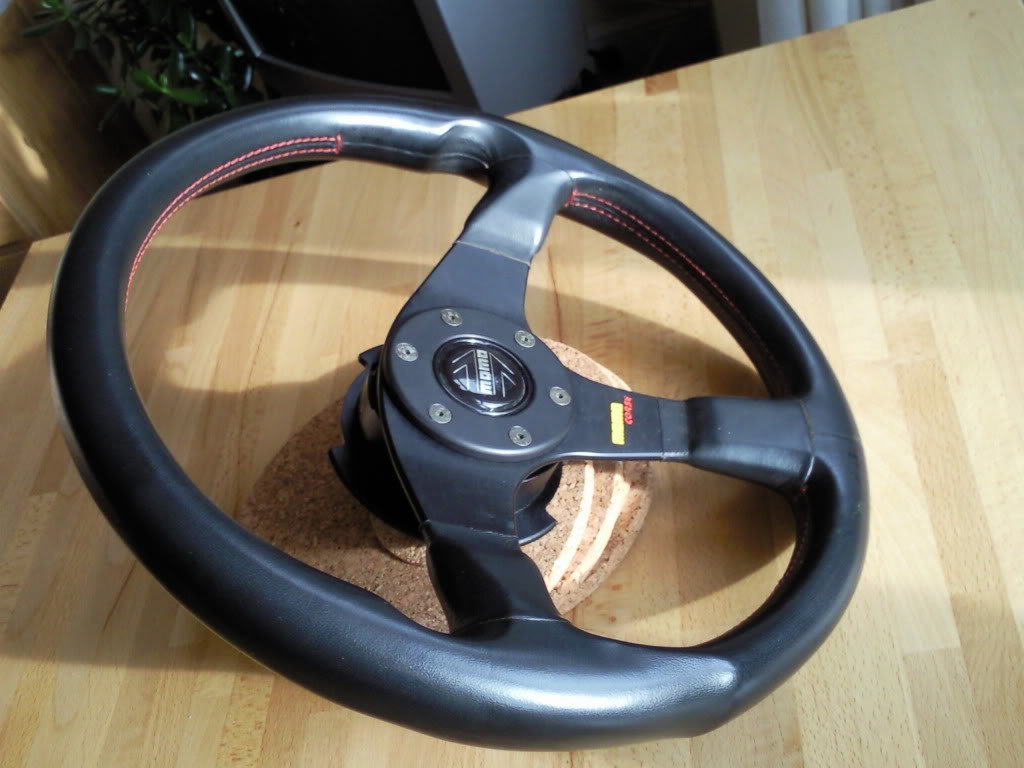

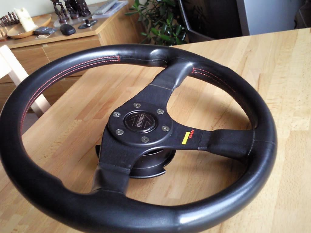

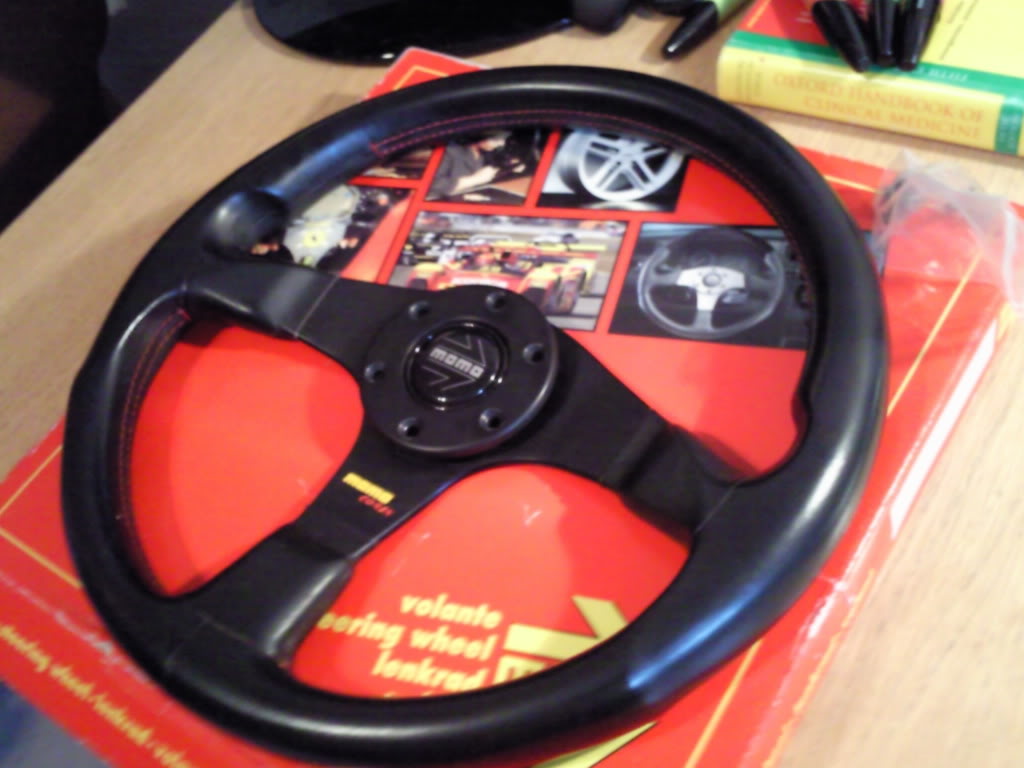

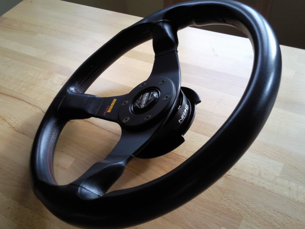

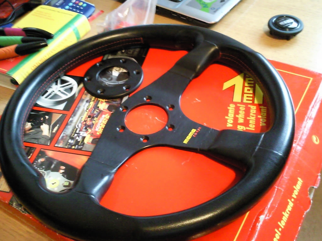

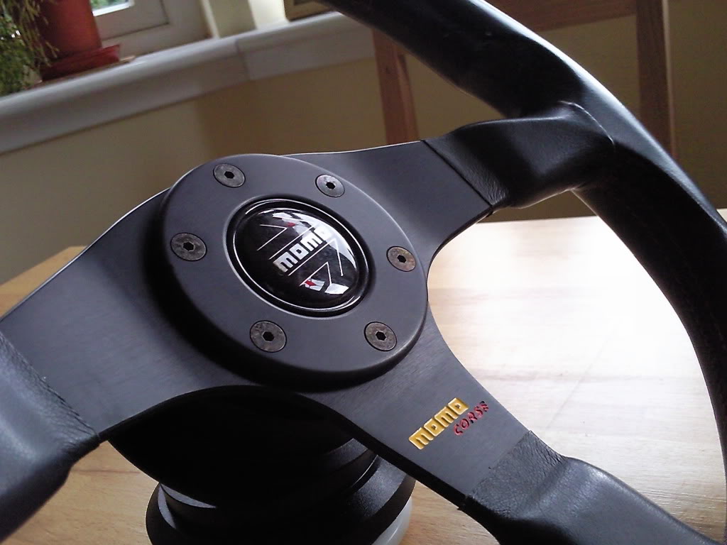

The standard momo steering wheel is a good steering wheel but i have never been fully comfortable using it. So went for a Momo aftermarket steering wheel with a spoon horn(still in the post). Its the same wheel thats in the nsx-r but with a spoon horn obviously. It feels awesome and the red stitching sets it off nicely especially with the ek9 recaros, doorcards and carpet being red too.
Spoon horn to go with the momo steering wheel, which is yet to come.

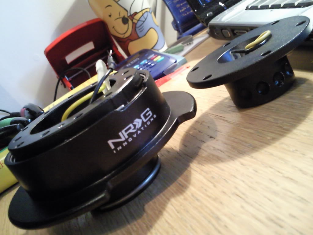

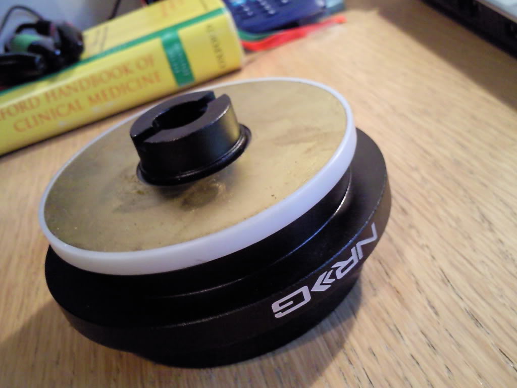

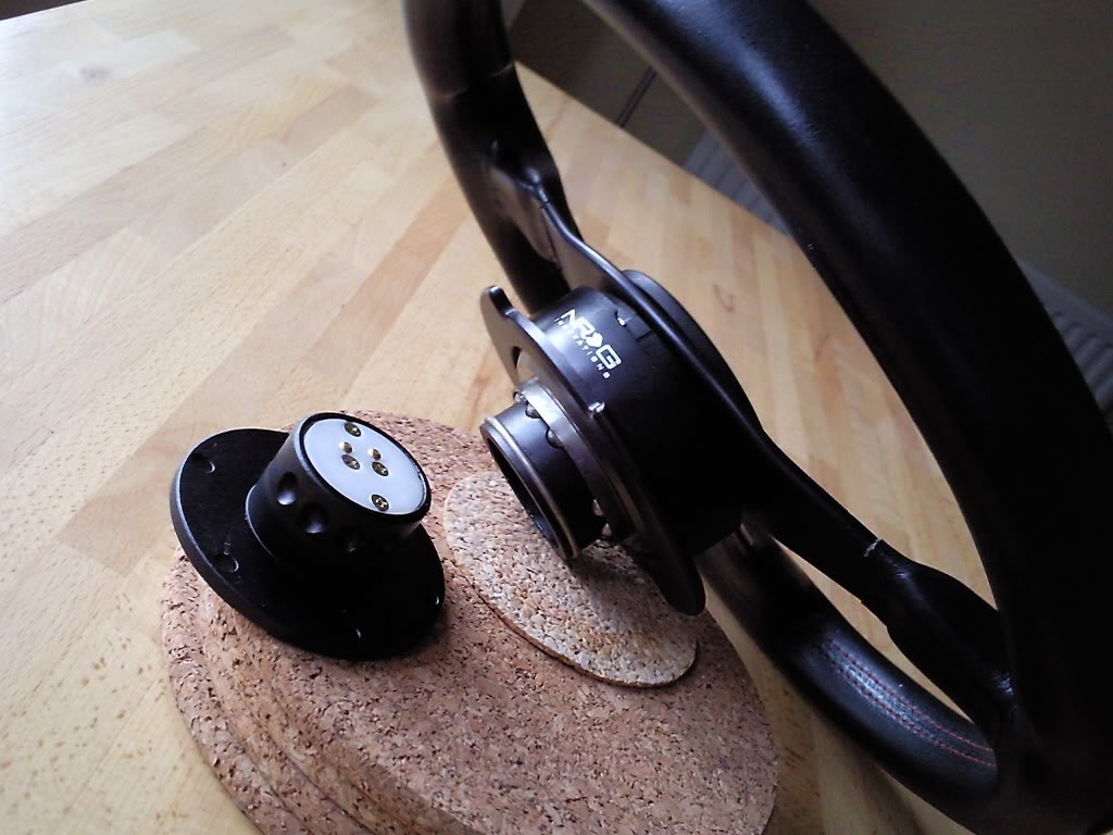

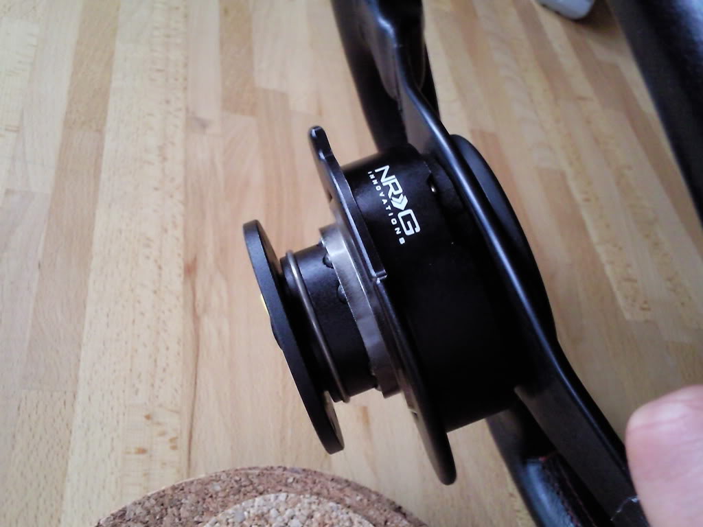

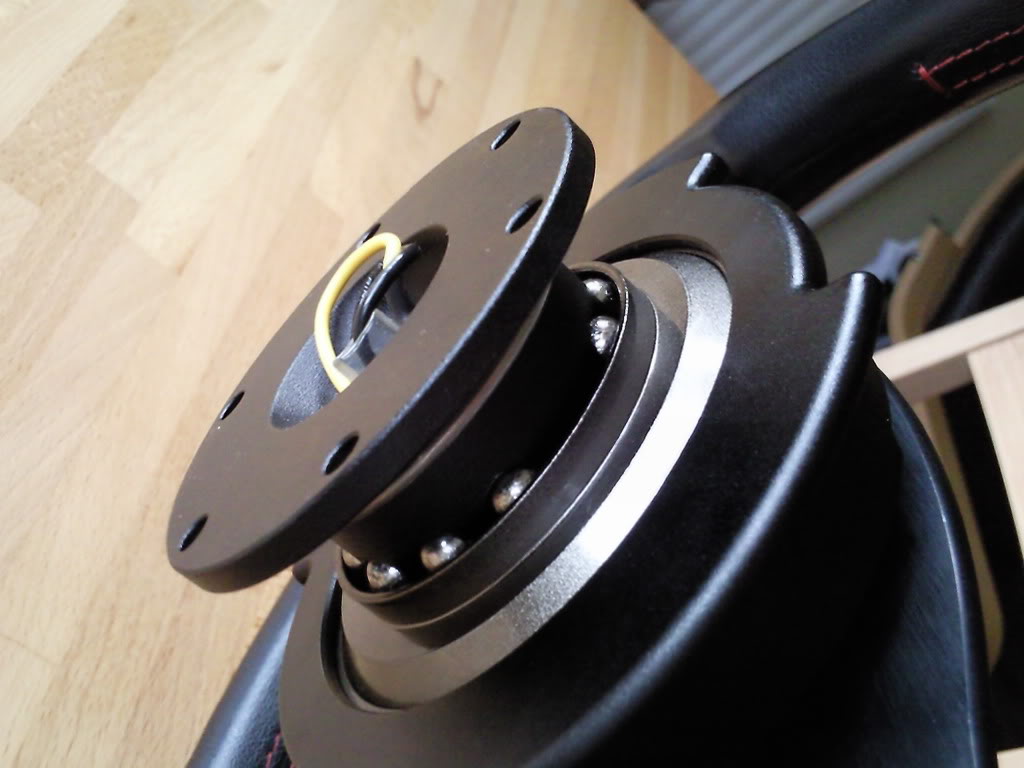

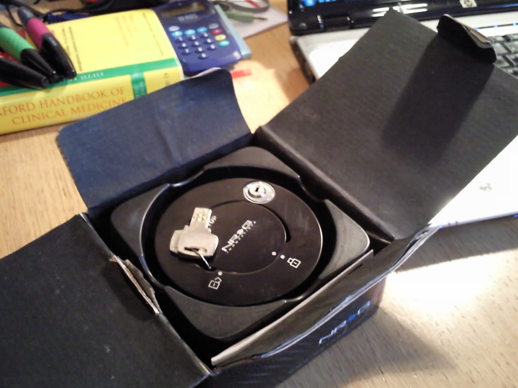

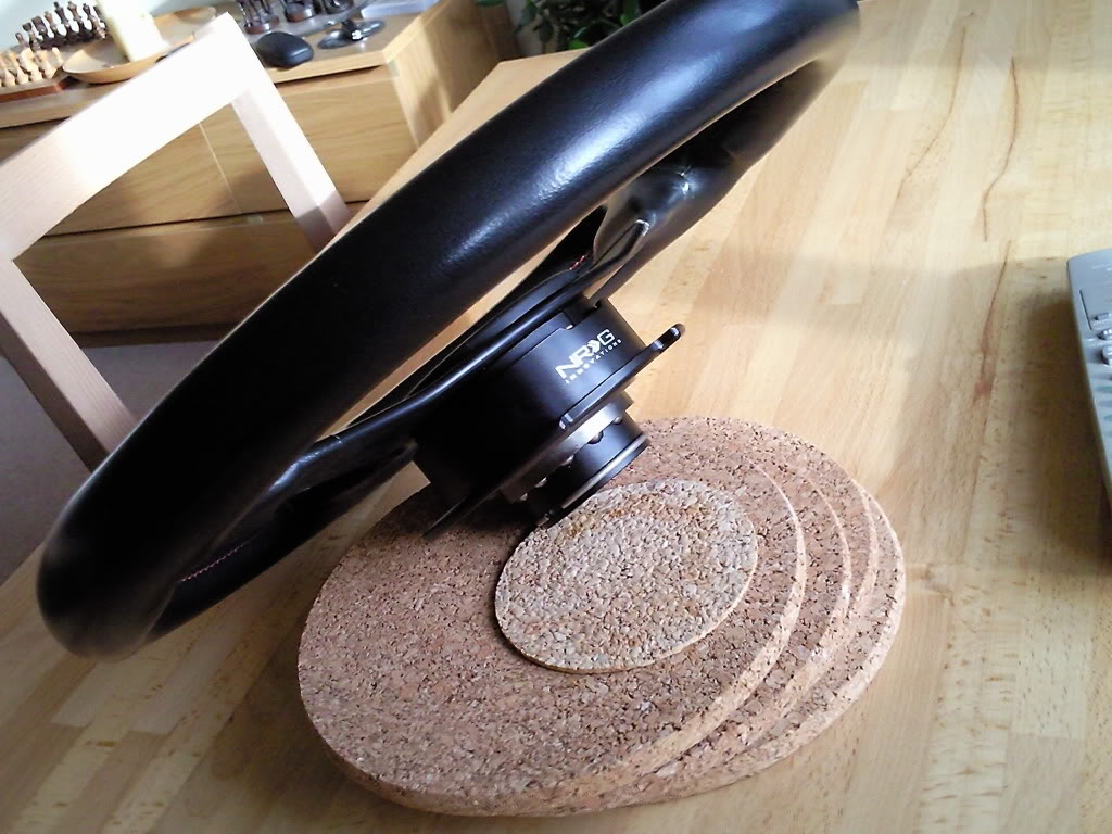

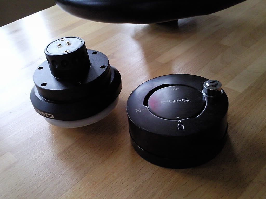

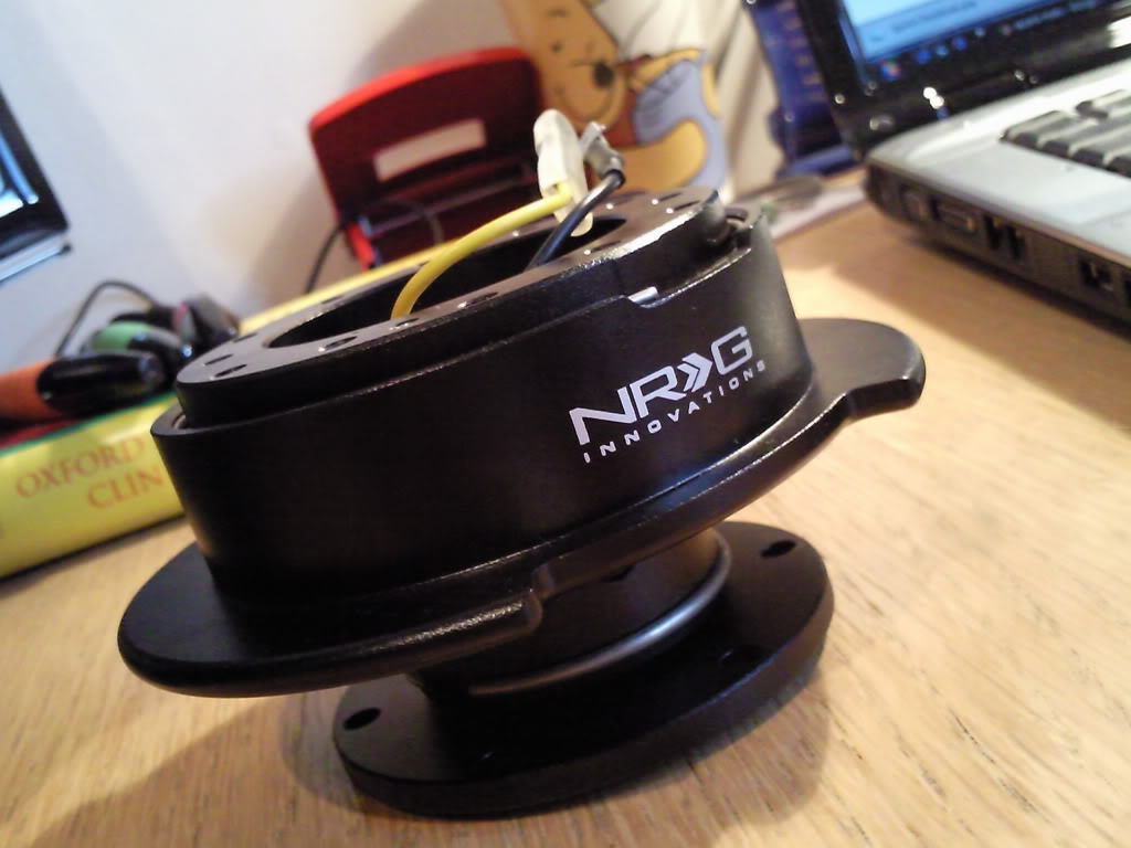

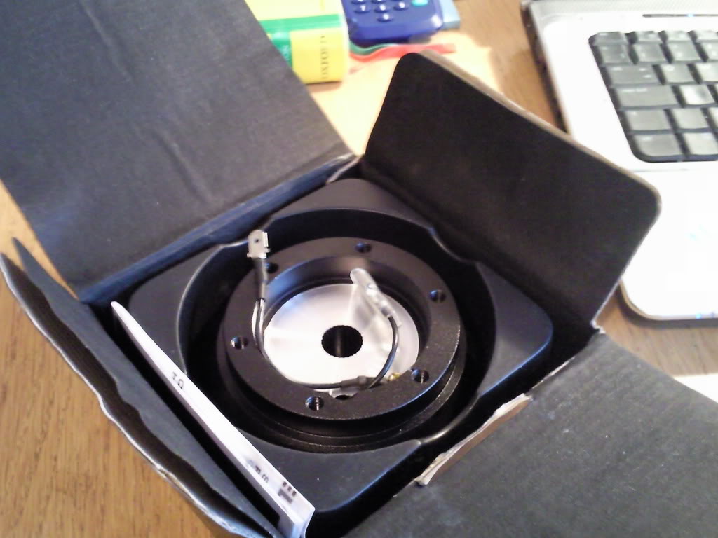

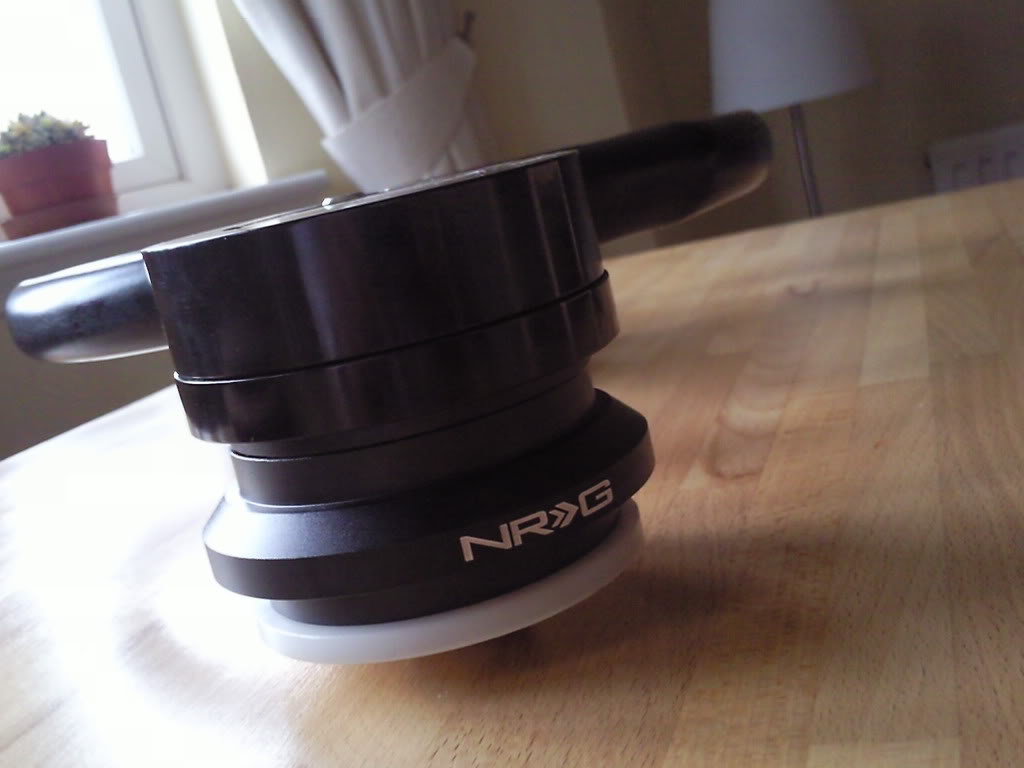

Since i was going down the after market steering wheel route i decided that i wanted an nrg quick release system as it will bring the steering wheel closer to me and will also be a major theft deterrent. No steering wheel, means you cant just drive off. Also im planing on having fixed buckets so getting into the car will be easier with a snap off steering wheel system. So i went ahead and ordered an nrg quick release, nrg short hub,nrg lock and nrg lock holder.

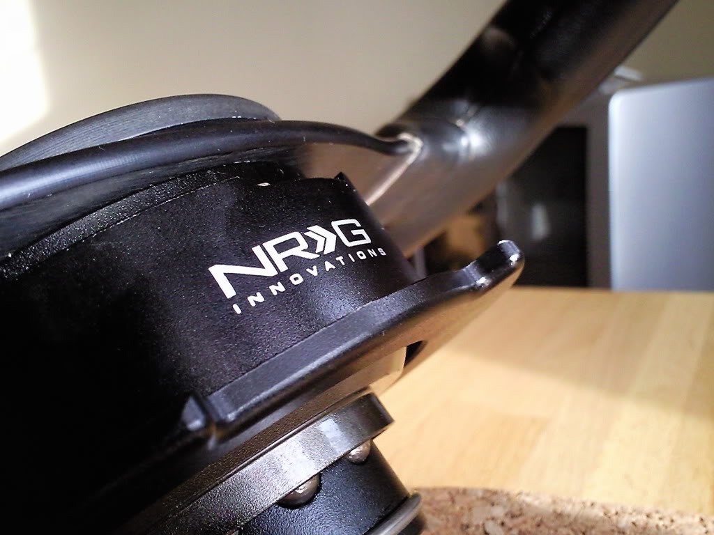

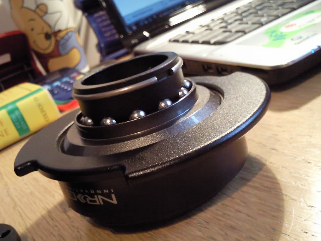

The nrg quick release is a great bit of kit. Its the 2.5 gen version which has the larger paddles at the side, which look like paddles off a sequential box. pull the paddles towards you and you disconnect the quick release from the hub, allowing you to remove the steering wheel altogether. It comes in various colours but i wanted it to be discrete so i ordered it in anodised black. The whol kit is very well made and has an anti scratch surface. Its also has a ball-bearing system to ensure little play in the steering.
ball bearings to minimise play

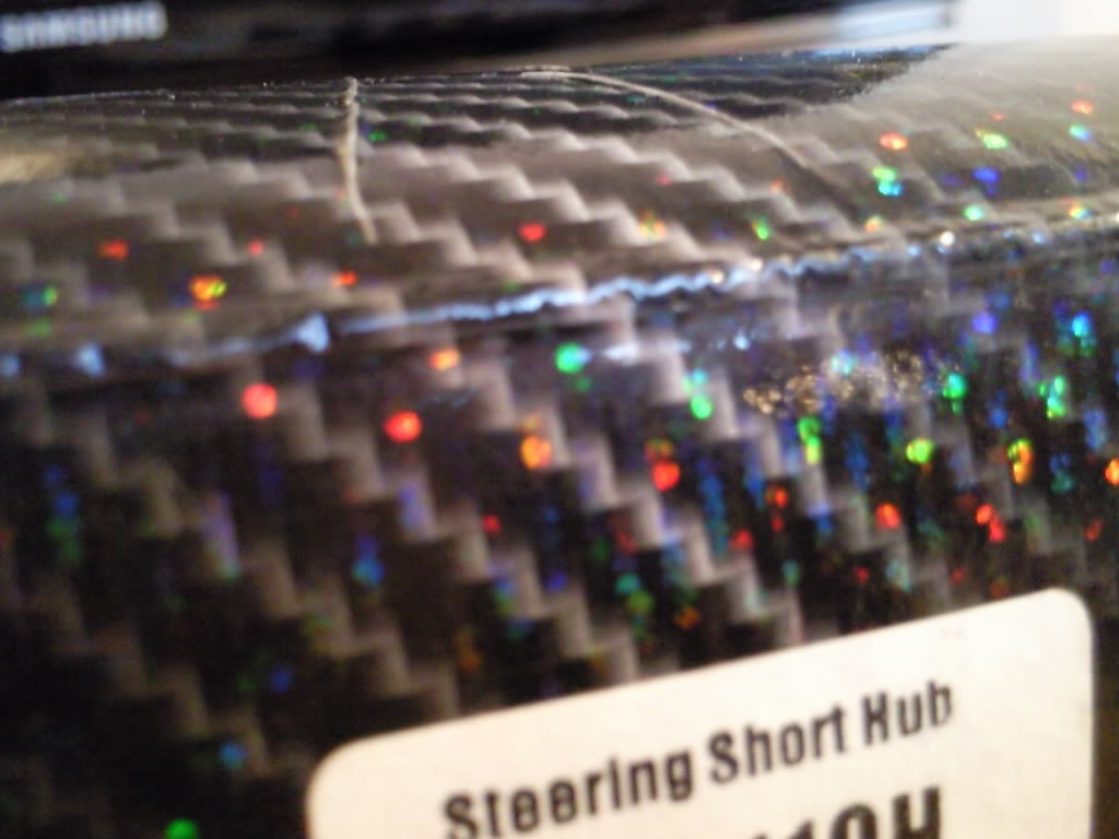

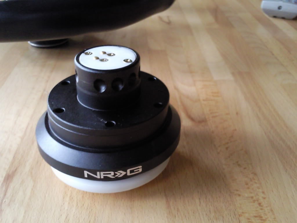

The Nrg short hub. After buying it i have decided against use it. Its too thin and i want the steering wheel to sit even closer so i ordered a momo hub from funky power last week, which will be used instead of this. Still looks and feels like a very well made item.
NRG lock holder
Nrg lock. This is again another security feature that nrg offer separately. Basically when you remove your steering wheel you lock this onto the hub preventing anyone else from fitting their own steering wheel. when not in use it locks onto the lock holder, which should be here by early next week. Overall the steering wheel with the full nrg kit comes in at around £550 but when you consider its value as a theft deterrent then it becomes the bargain of the century imo.

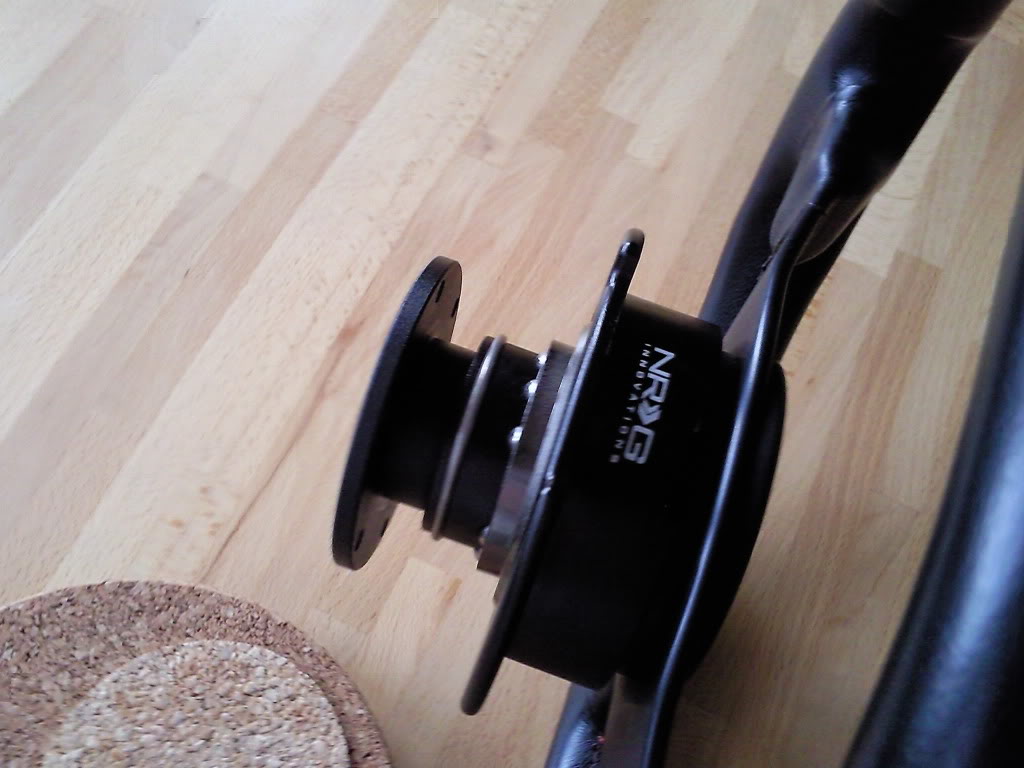

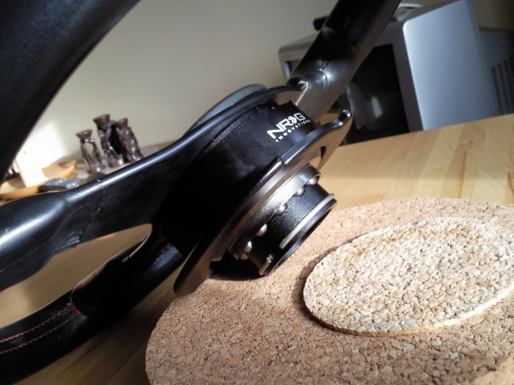

Some pics of it partly assembled.
A couple more of the steering wheel set up

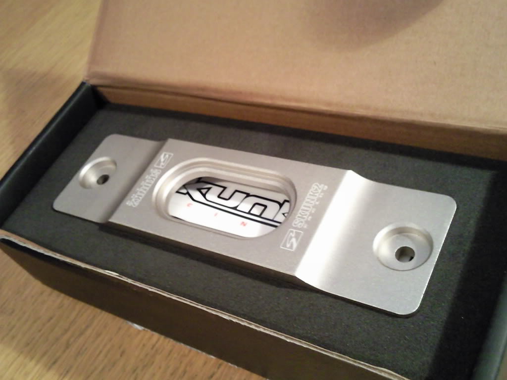

Also ordered some Skunk2 lower control arm bushes from funky power yesterday aswell, which should be here next week. One of the reasons i never fitted my skunk2 lca's was because 2 of the bushes were starting to split so i had to wait around 1 month for funky power (skunk2 uk dealer) to get some in from the states. The ones i have, have been used for less than 800 miles and yet 2 of the bushes were shot. Not exactly the sort of quality you would expect for £220 but hopefully these new 'revised' bushes should be stiffer and wont perish as quick.

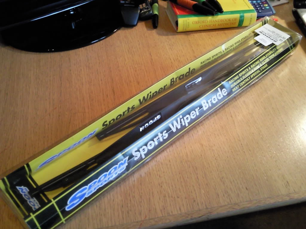

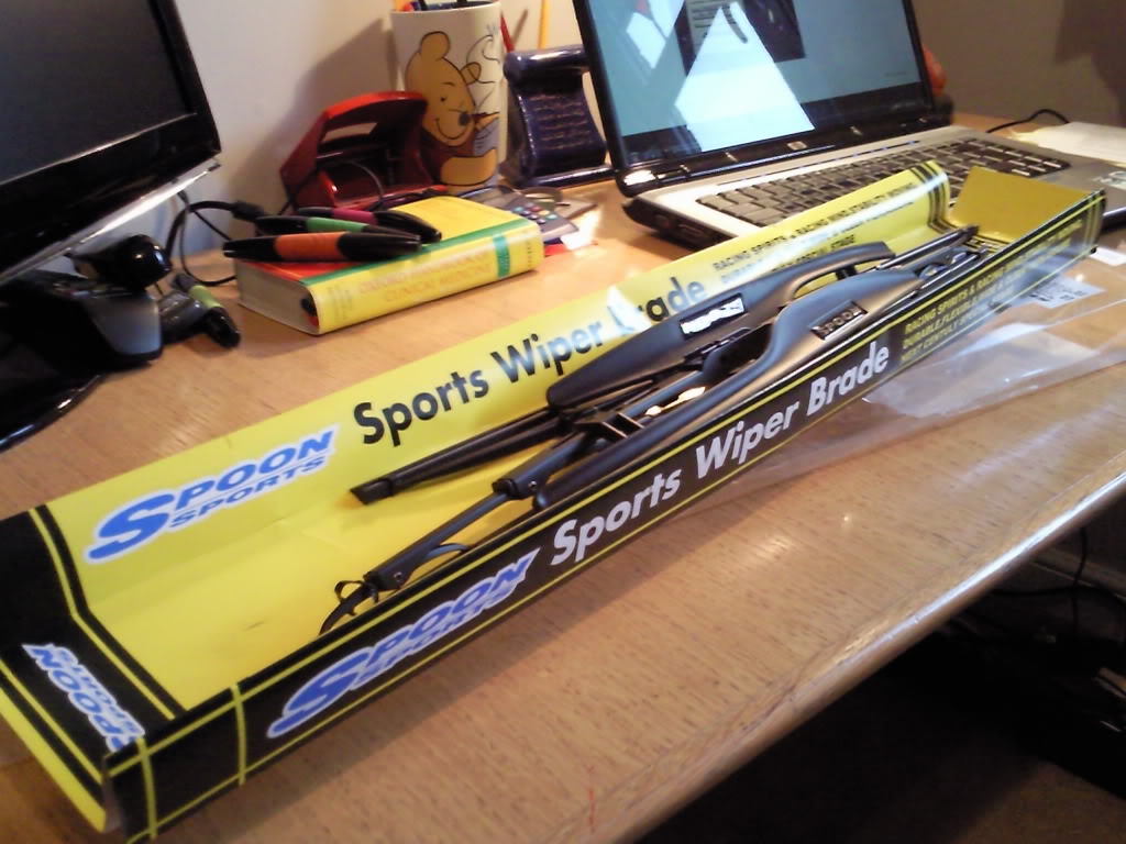

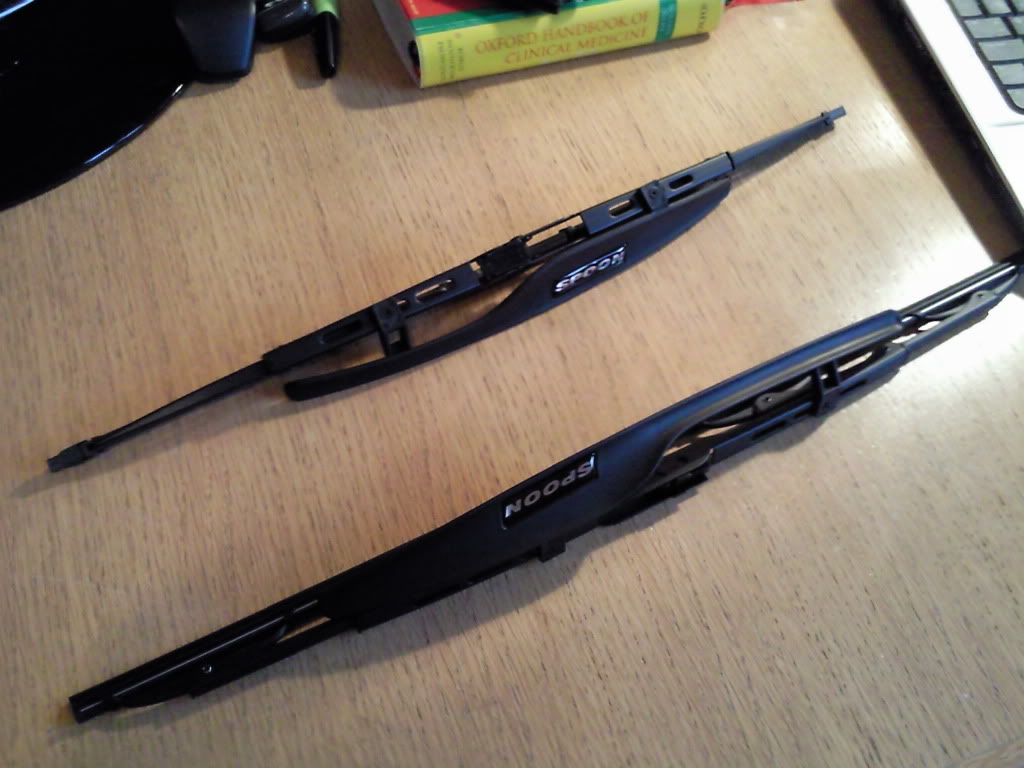

Spoon aero wiper blades. I needed to replace the wipers so i decide to pay a bit more and get spoon ones and since they were on offer at £75, down from £125 i couldn't resist.Still very expensive for just a set of wipers without the arms but i dont know anyone with a set and i always wanted a set so i bought them.

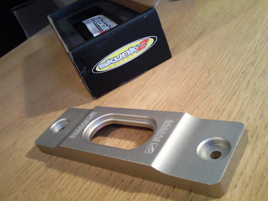

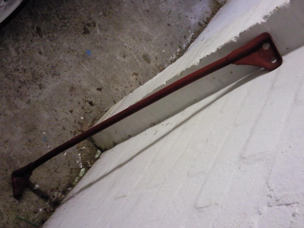

Skunk2 tie bar. This was one of the first things i wanted to buy but never got round to buying one. It does look and feel like a quality the part.

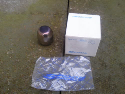

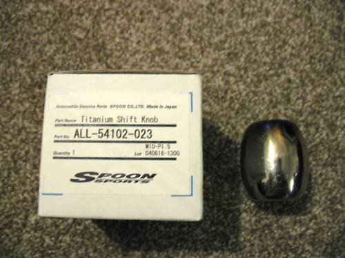

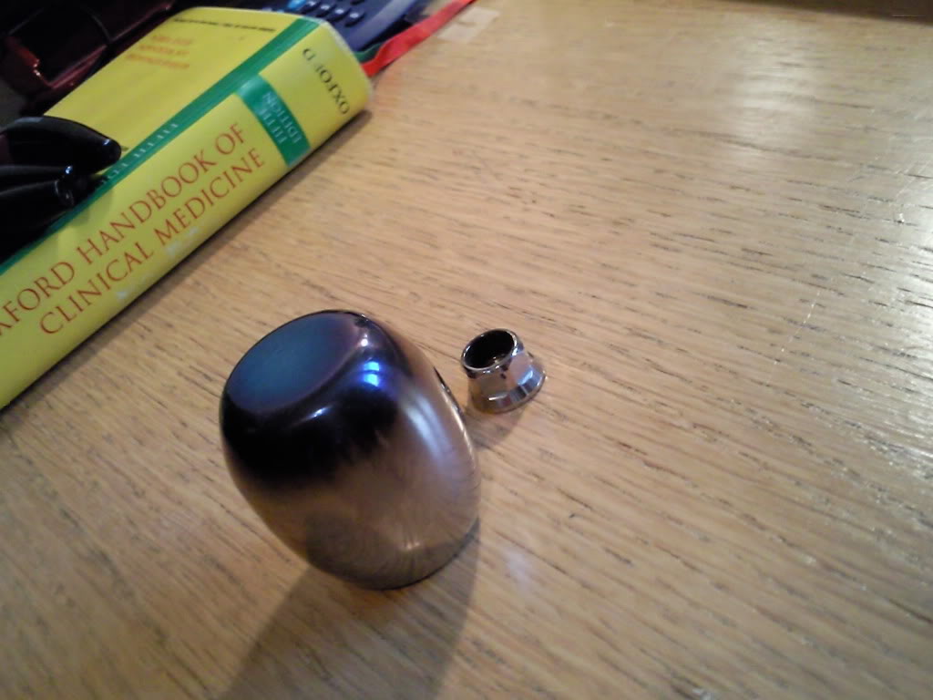

Genuine titanium Spoon gear knob. Probably one of my favourite mods to date. Spoon only made them for a very short period of time and it featured in spoons k20'd ek9. Its hollow titanium so it is unbelievably light at around 40 grams. It has a burnt look to it which is another feature that i like aswell. The stock type r gear knob is also titanium but it is very very heavy. All depends on personal preference but i never liked the throw of the stock ek9 gear knob so this one should have a better feel to it. To cut a long story short I ended up buying 2 because there was a mix up with thread sizes so one will be up for sale if anyone wants it.

you paid £75 for some wiper blades?
Car is epic, but you have to draw the line somewhere. You must be crazy paying that much for wiper blades.
For £75 i'd expect them to last the life of the car.
