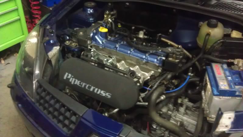

this is my engine bay with AC removed
this is a bay with AC
I know what i'd rather work on
