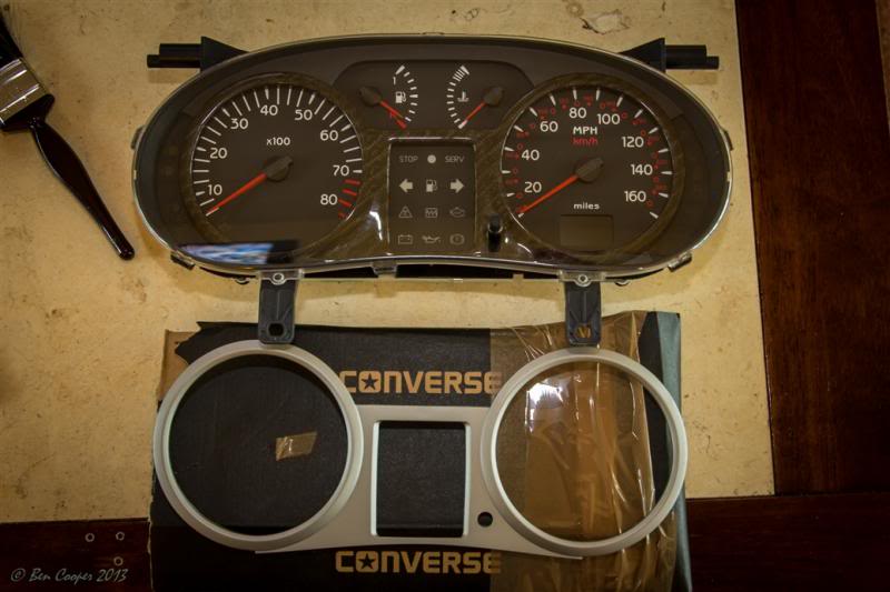

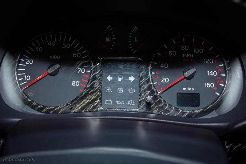

also fitted the C/F clock surround and taxed her, so back on the road tomorrow....provided I get a couple more coats of wax on it and seal up the wheels fully!

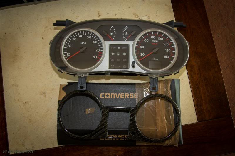

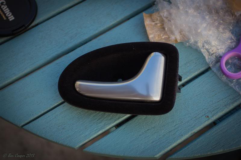

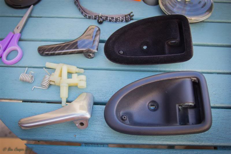

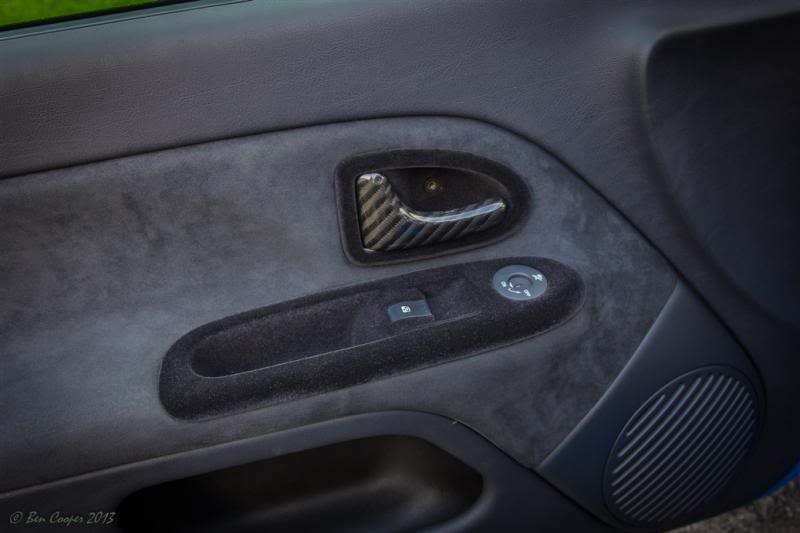

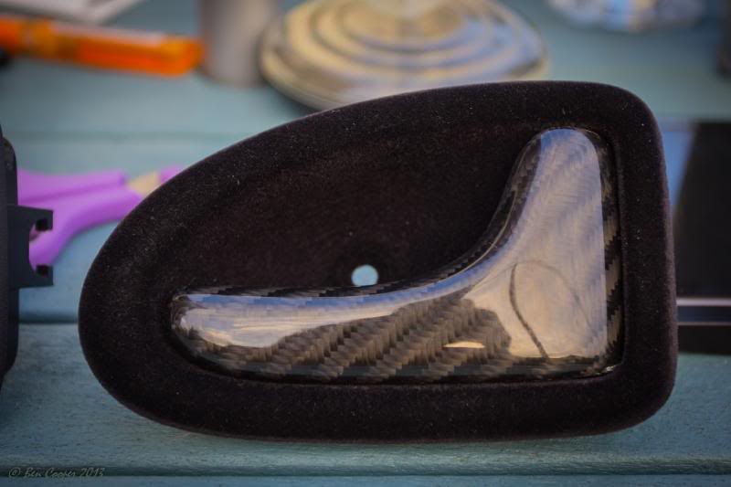

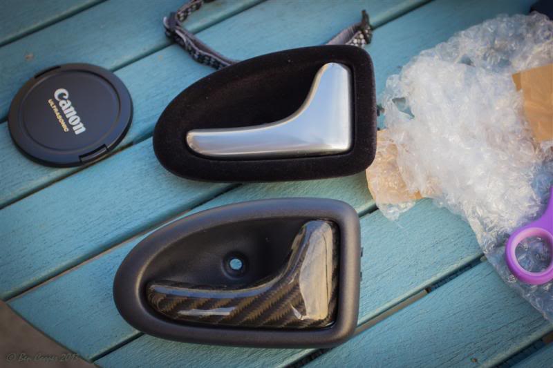

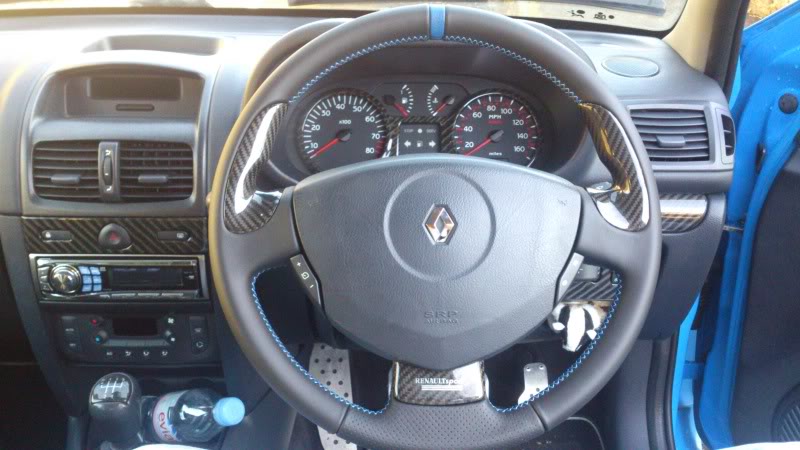

so first off, I already had carbon fibre door handles so they needed stripping to fit to the new flocked backing plates:
new handle with flocking
old handle with c/f
and dismantled
finished article

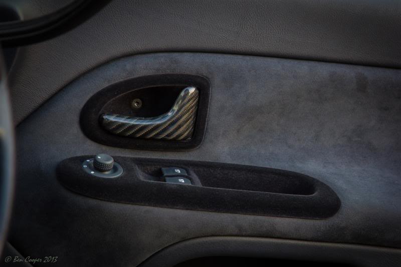

and fitted along with door pull/switch bits

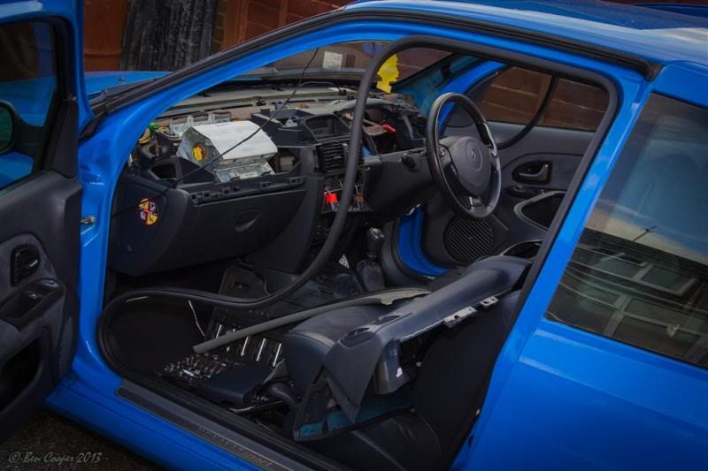

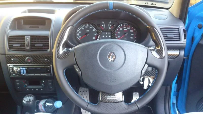

dash surgery!
the switcheroo part 1
the switcheroo part 2
and poor last pic all fitted as its dark out like!!lol!
I bought the flocked parts from classifieds chap, but any flocking place worth their salt should be able to do it
the handles are simple to dismantle, just pop the spring off the back carefully and then lever/pull the white plastic hinge out to release the handle itself from the front. reverse process to refit ensuring the hinge is aligned properly

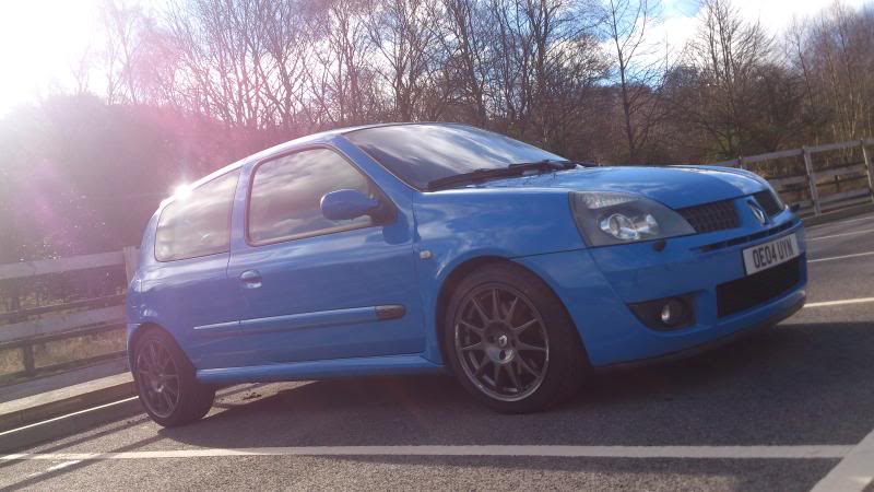

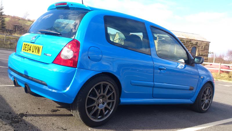

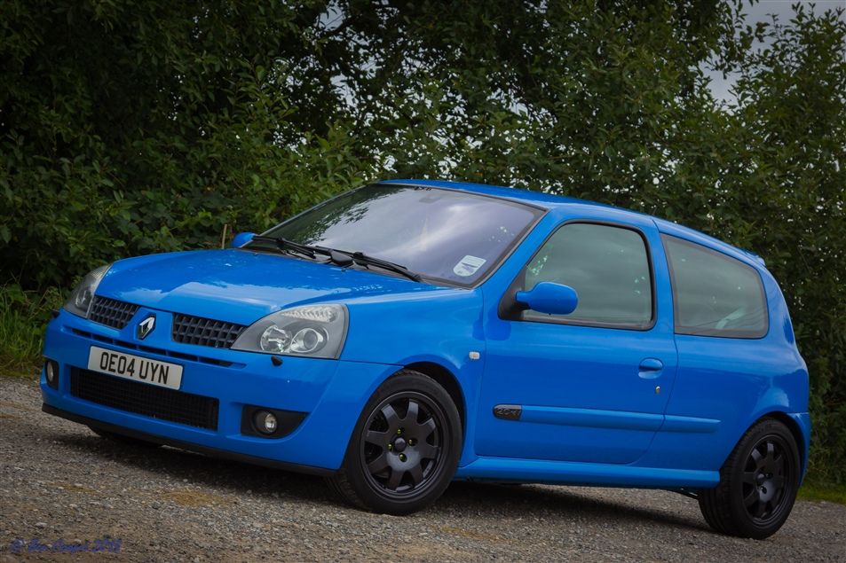

I f**king love what you've done with this. Williams wheels have always been my favourite for a mk2 because they're so under used and understated, only criticism is that they'd look 100x better with a silver polished lip, to just give a nod to the original.
The flocked bits look SUPERB too. Cracking work. A car I'd actually buy quite happily, so give me a nod when you sell and I'll let you know if I'm on the lookout for another RS.

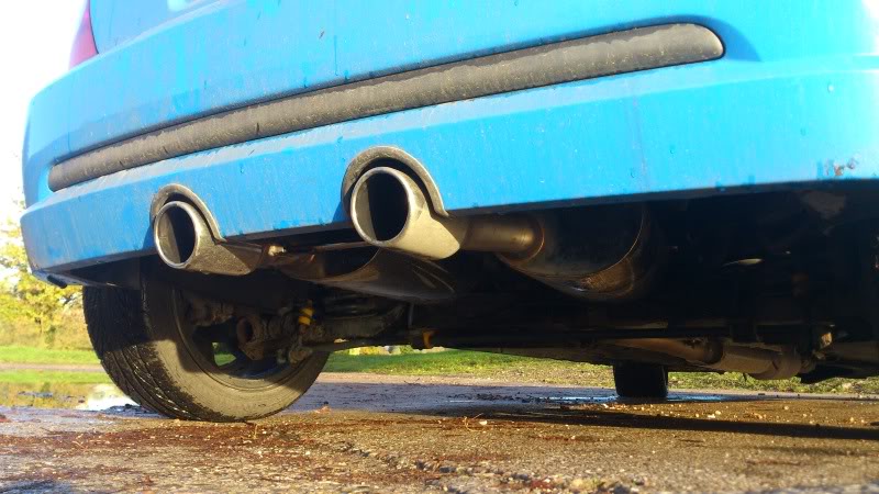

From your latest pics you need to straighten that exhaust out though! Get out there with some cable ties man!
Cheers Rob, it's almost exactly how I want it now, going to flock door speaker grills and toying with maybe doing top dash too but undecided at the mo.
front needs a respray as well as its looking bit tired.
the Wheels I was going to have the lip done but the body shop doesn't have the equipment do it, and hand polish would of been too pricey. I may have it done over the winter as I sort of envisaged it for them from the start.
Zorst is on the list to fully sort, it's being bit of a pain due to mod to expose the tips from under the rear bumper!

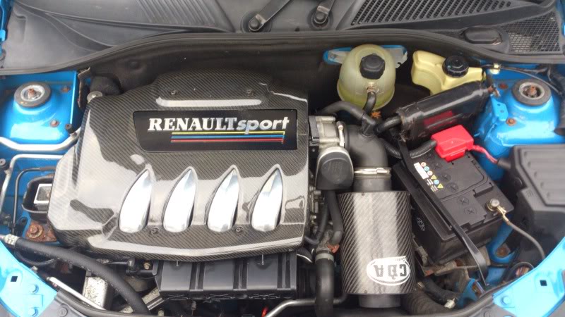

I have also boshed a CDA BMC on it for a giggle, feels slow as hell now but makes a right giggle of a bwarp

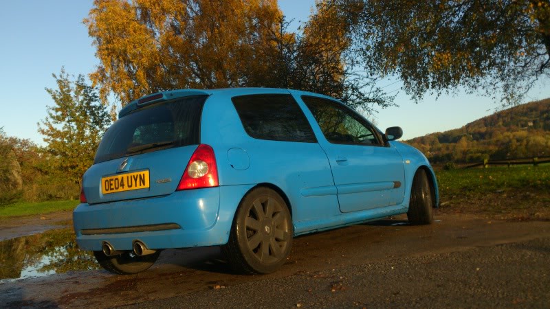

and the cars on winter standard 182 cup wheels (all be is the bargain refurbed ones bought off the classified on here that I feel a bit guilty about using as winter rims!lol!)

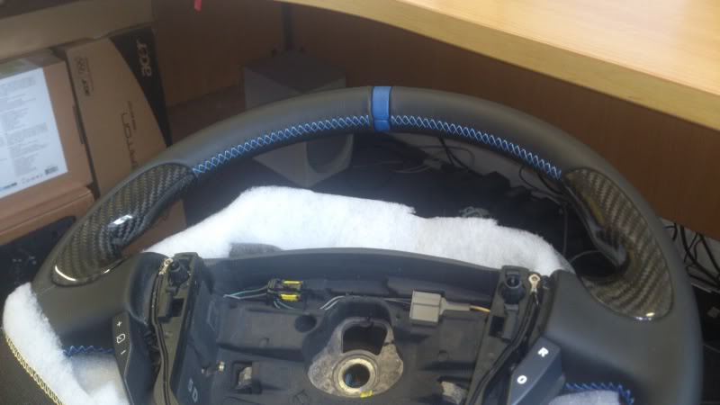

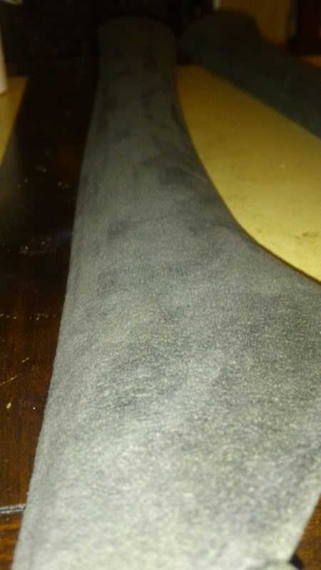

got a couple more bits coming too, snappy wheel and alacantara a pillar trims

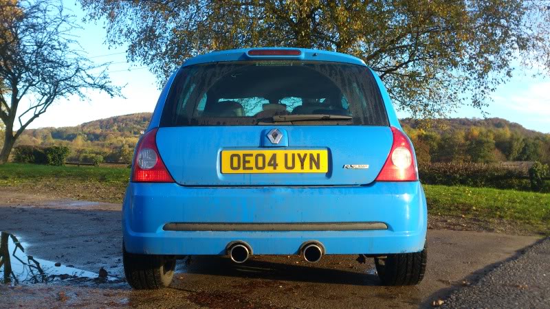

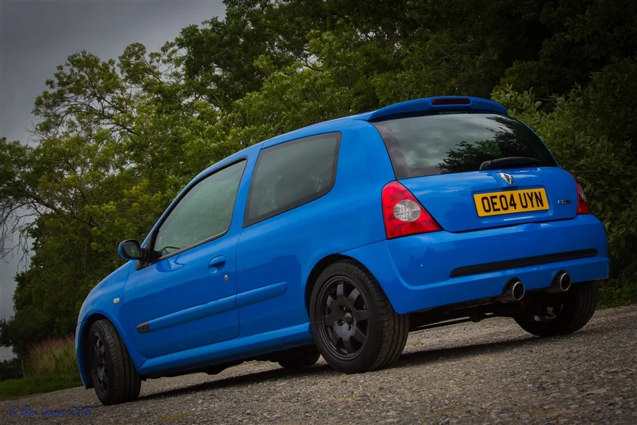

grotty need a wash pictures in winter spec and of the RS192 as promised :)

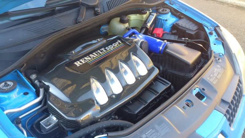

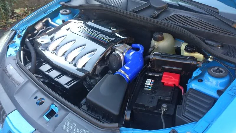

and engine bay with the useless CDA, lol!
ai I know, its terrible for performance but winter bwarp is a giggle :) and tbh (goes to whisper) 182's are a bit slow anyway aren't they ;)

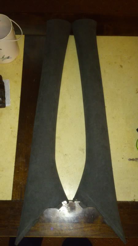

A pillars landed today, along with a royal mail missed delivery....mmm what could that be :)

snappy to fit now too!
http://s14.photobucket.com/user/coopahstar/media/The%20RB%20FF/DSC_4427_zpsd09e9429.jpg.html"]
[/URL]
okay, snappy fitted with marmite

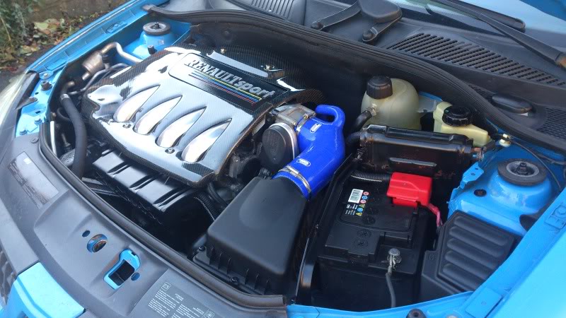

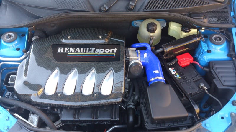

and also ripped off the BMC and refitted standard airbox with samco elbow in blue :) imo looks and goes 100% better :)
also painted up manky bits to tidy the bay up and for a daily, happy now I think!

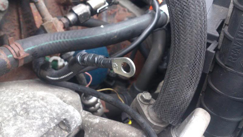

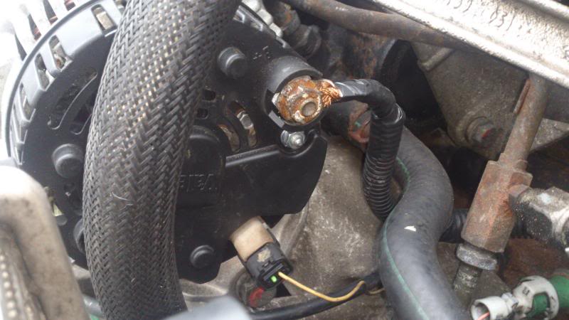

Not to mention the belt squeal in the mornings was starting to annoy me and I wanted to sort the alternator wiring that broke months and months ago!!

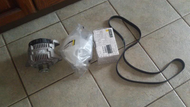

Also, I thought all the belts were due, so I have been collecting all the parts over the last few months to do the full belts, water pump, service, etc etc. However, after using my god given eyes properly I realised it was just the aux belts that are due, I have another 18 months on the cam belt, so this weekend I put together a little service schedule.
plan was:
- Oil and Filter
- Aux belt kit
- Alternator
- Fix broken alternator wiring

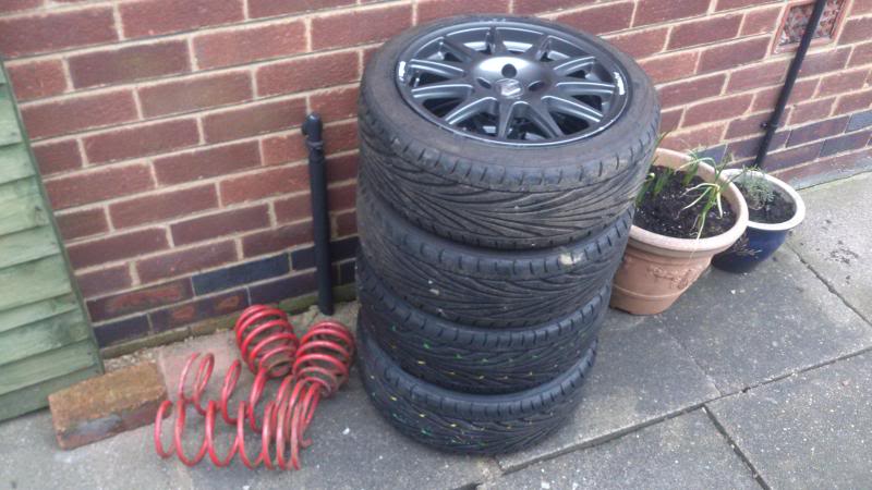

- Fit Eibach Sportline springs
- Fit Speedline Cup Turini Alloys in Anthracite
- Baaaaa like a suitable CS sheep at the result
First thing Sunday morning I got up...........and went to the presentation of a bouldering competition at the local climbing wall I came 3rd overall in :)

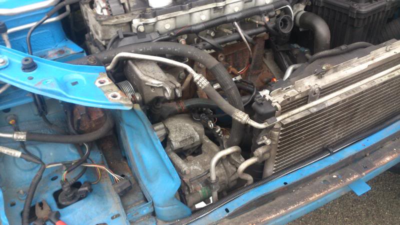

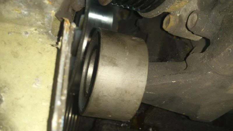

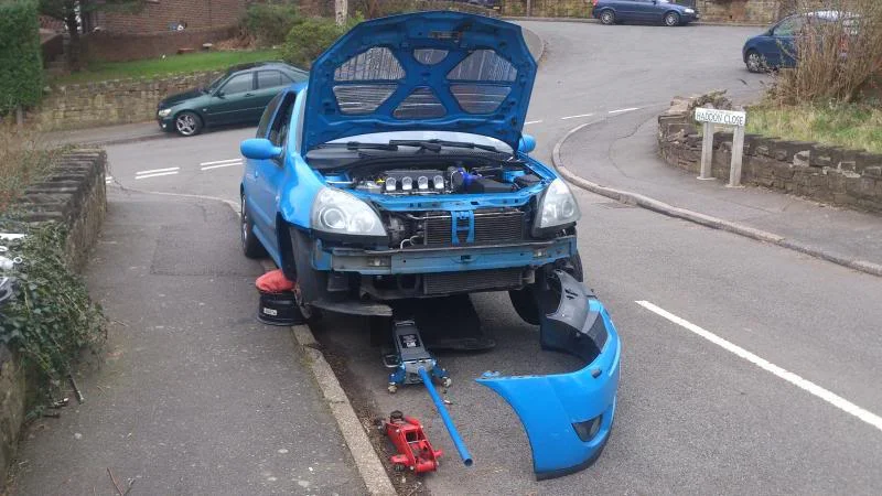

So, after a quick boulder session, a load of prizes and a trip back home I figured probably about time to start on the car. Not taken loads of pics but got a few and its safe to say next time I'm paying some bugger to do it. Wasn't massively hard, but the refitting of the belt was a right pain, the tensioner snapped on the 3/8" slot so I had to guide the belt on and turn the crank over on the pulley to drag it on, nightmare!lol!!! So a 2 hour or so series of jobs turned into a 4 hour + marathon and swearing session!lol!!!
Anyway, few bits to fit:
Front end off, I decided it would be easier to simply rip most of it off for access, it doesn't take long to strip down and makes the job a whole lot easier as its so tight in there!
and old crap out
alternator wiring fixed with new crimp and insulation

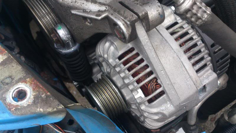

new alternator and tensioner etc in
and alternator connected up
it was at this point that the fight began and I stopped taking pictures and started swearing!lol!
safe to say got it all sorted in the end and car built back up. chucked the springs and wheels on. Did the oil and filter and the pollen filter also for the basic service that was due too :)
