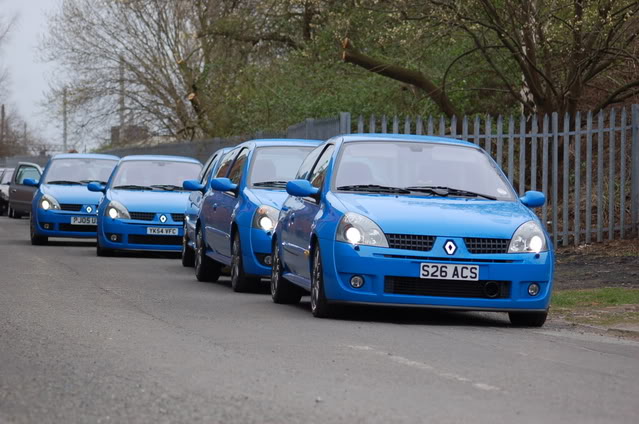

Racing Blue meet from '07. Probably on around 25k miles at the time. Lol.
My old one is fourth from the front.

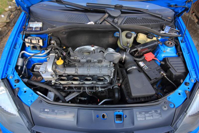

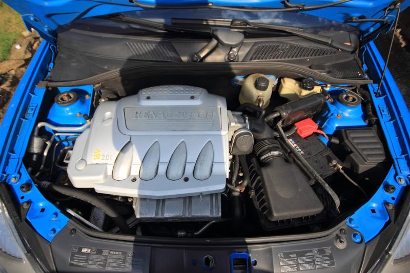

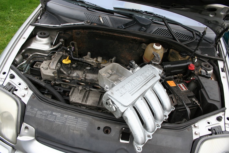

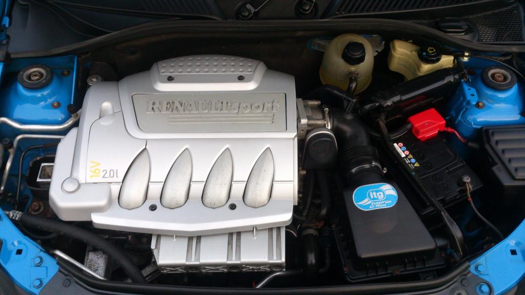

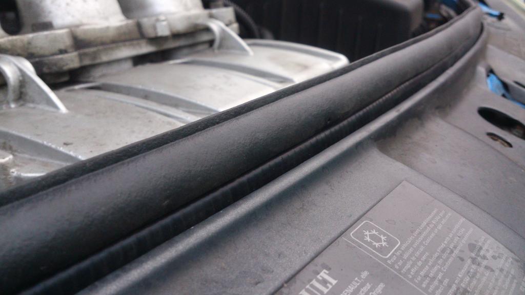

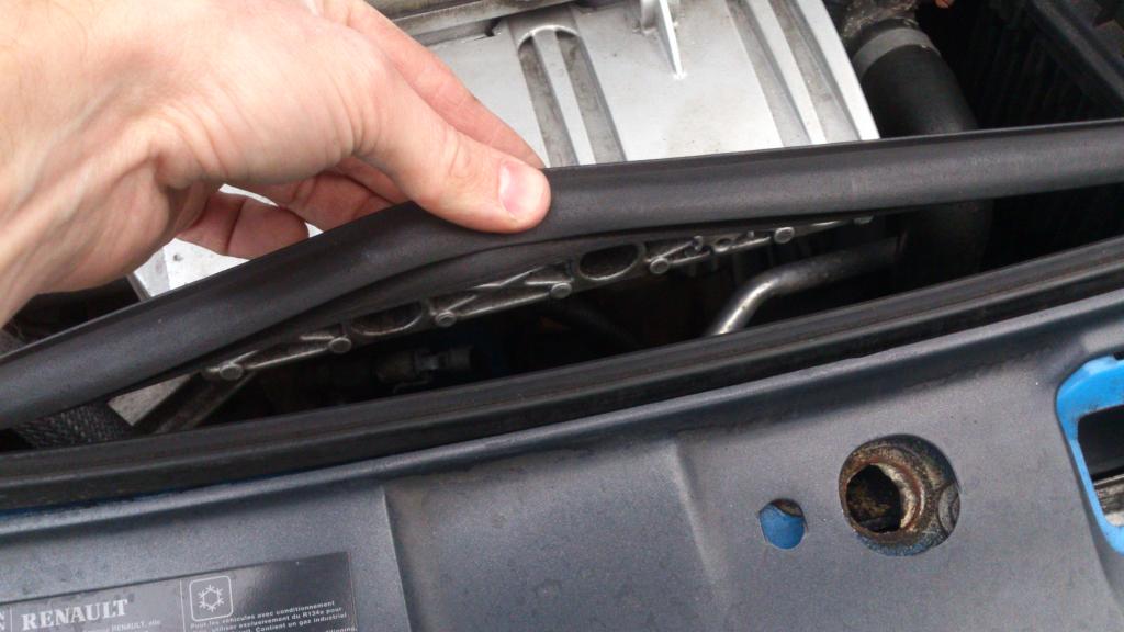

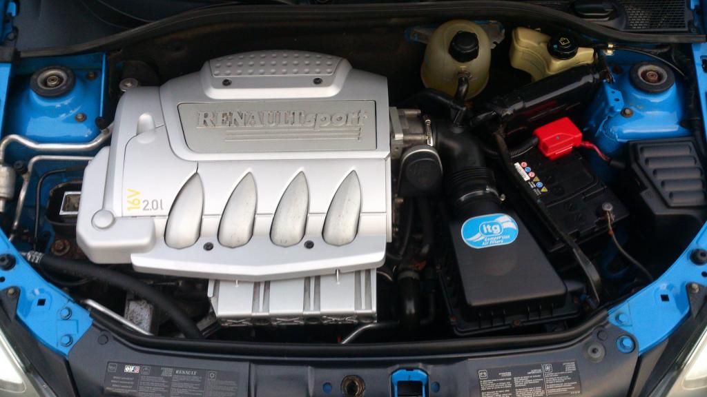

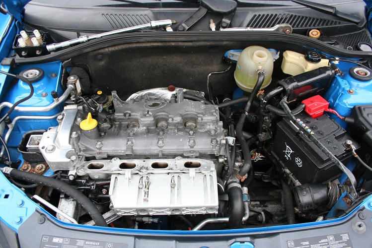

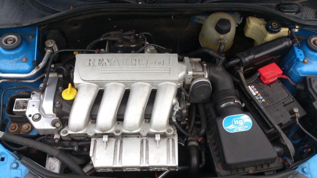

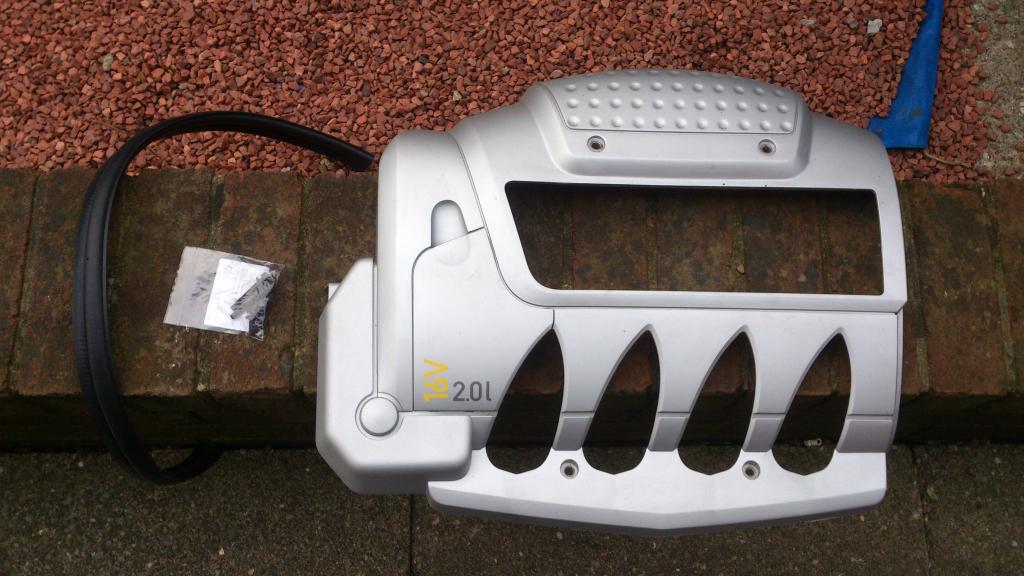

Firstly was the engine bay, it was looking a bit tatty and missing a few bits, so I got hold of a new rubber seal from the forums, spot on product and service, and an engine cover along with some stainless black allan bolts to hold it on, ebay special :)
Bay as it was
new bits to go on
kippered old front seal
new seal fitted
cover fitted with shiny bolts and engine briefly cleaned. I have some gunk in the shed so when the weather cheers up and I have a spare minute it'll get a full treatment and jetwash to clean up the bits that are hard to scrub with a cloth, but it looks okay and scrubs up alright :)

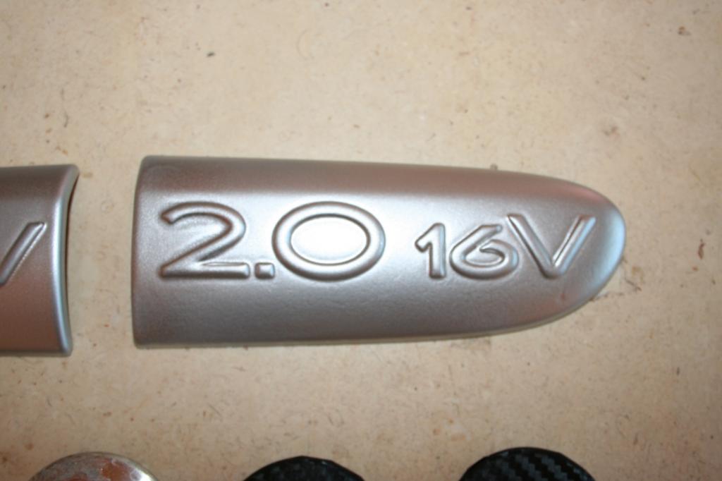

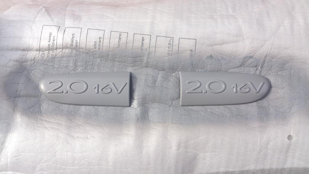

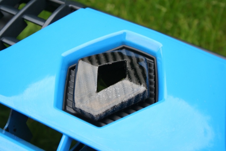

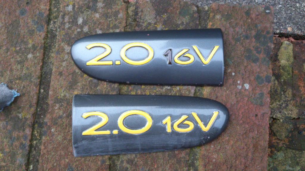

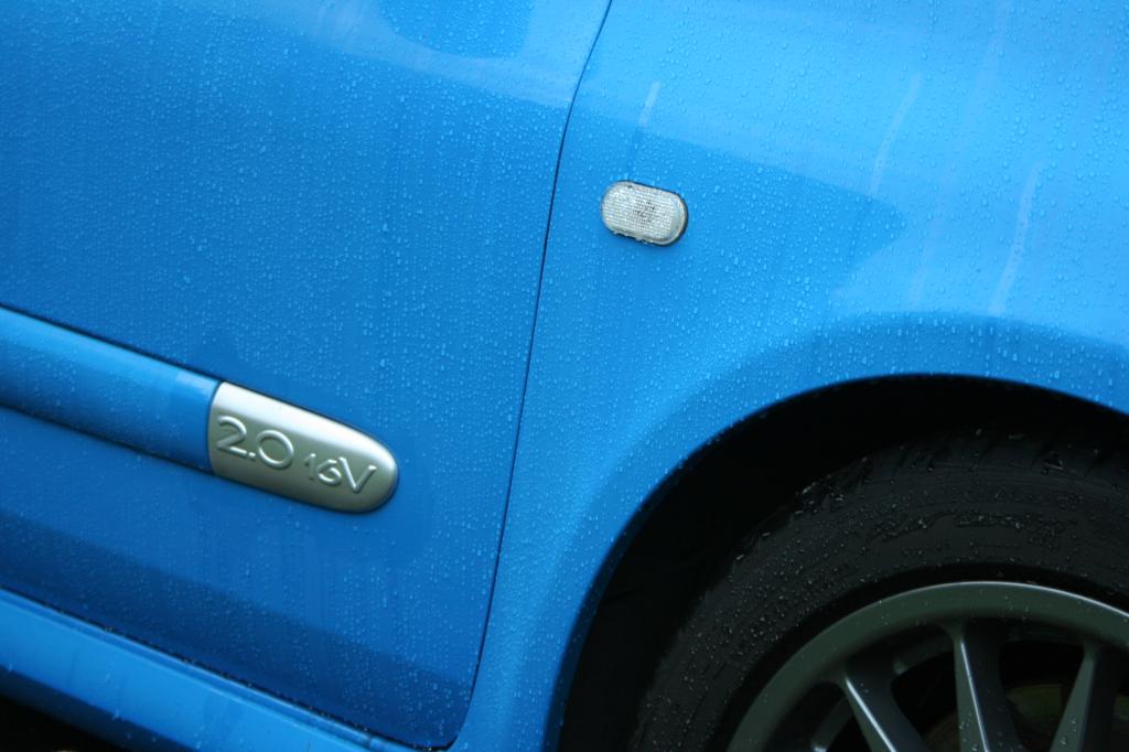

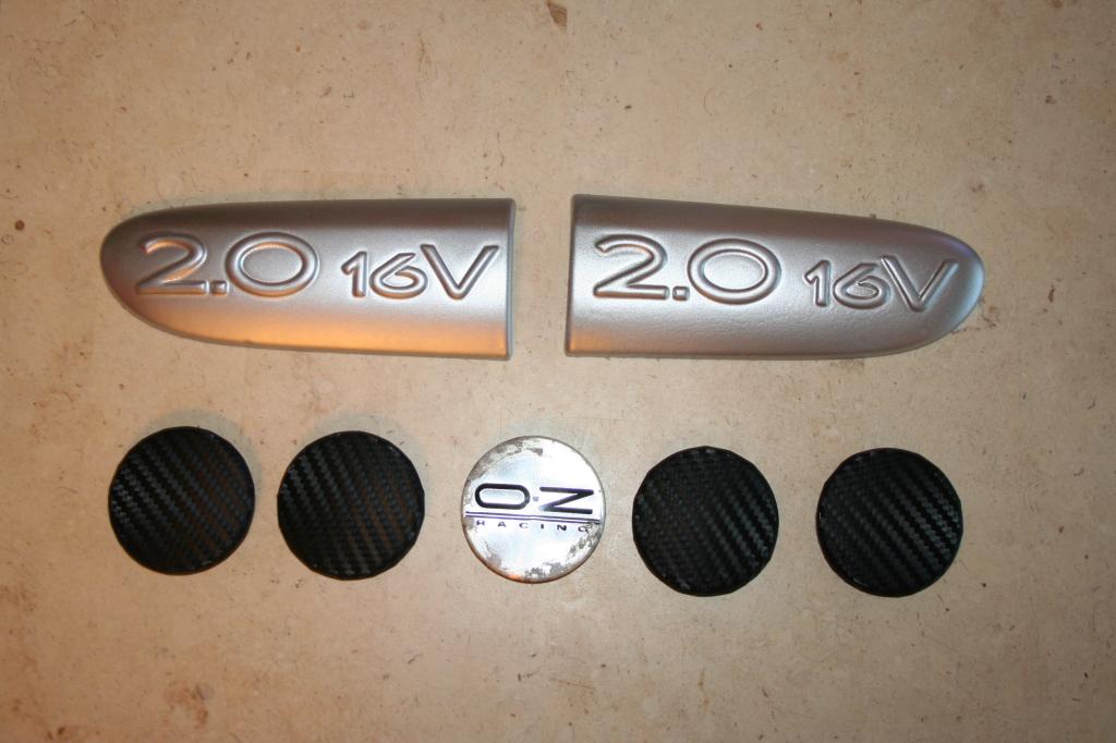

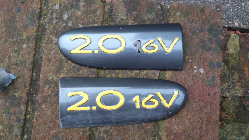

Next little task was to begin the process of removing the yellow highlights from the car, appreciate the sentiment of them but they aren't really to my taste, so I went with the easy one first, again due to time and weather contraints, the calipers will get a seeing to with hammerite over the weekend hopefully :)
anthracite and yellow badges
off the car (started to see if I wanted to just black the lettering, so tested the look with a pen to see, but decided against it and went for full spray instead) Pic was taken after I sort of started to sand back one, then wombled off for a brew, took the pic and carried on!
bit of paint I had kicking about in the shed

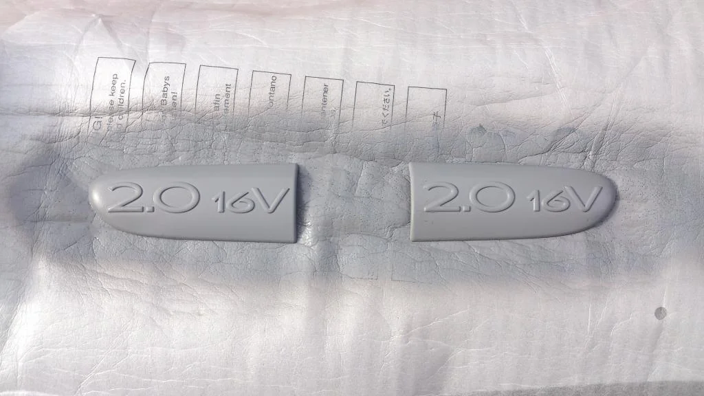

primered
and sprayed, pretty poor prepping from me really and a crappy job but I didn't really take my time, just slapped it on and it'll do for now, I eventually want some c/f bullets but they'll come later :)

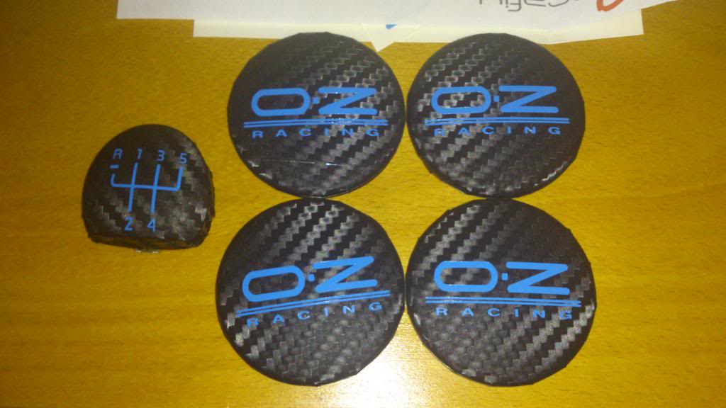

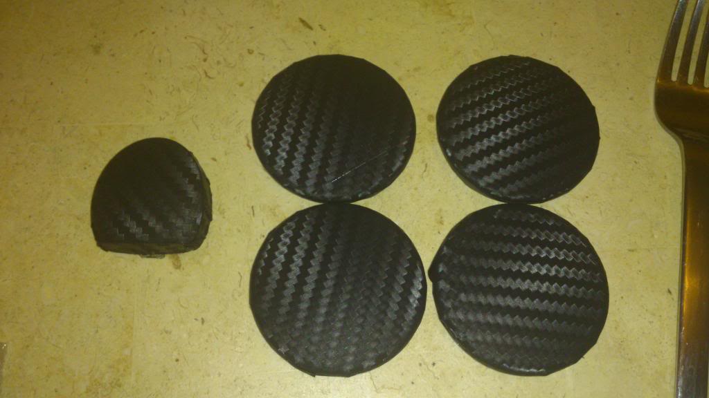

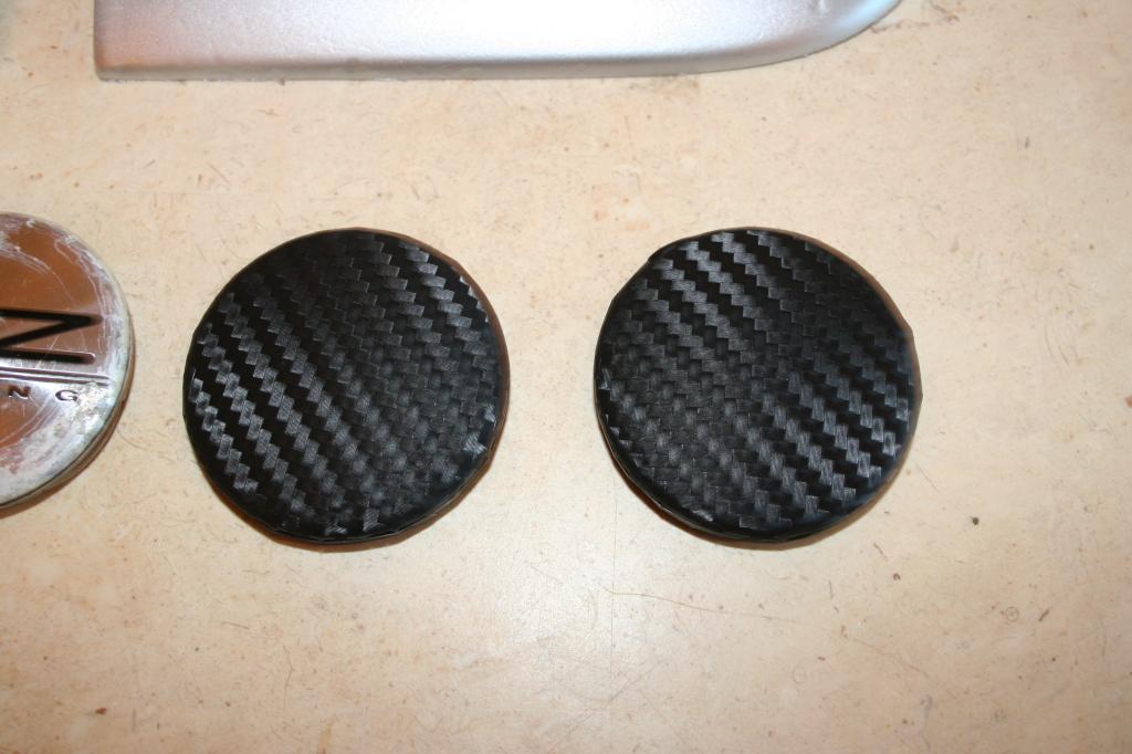

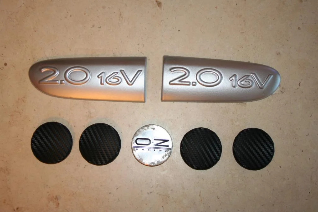

also wrapped my spare and knackered oz centre caps in the rest of the carbon wrap I had, I have some RB oz stickers coming for them as well hopefully and they will do on the black superlegs that I am fitting to the car over the weekend to see what it looks like ;)
and fitted to the car

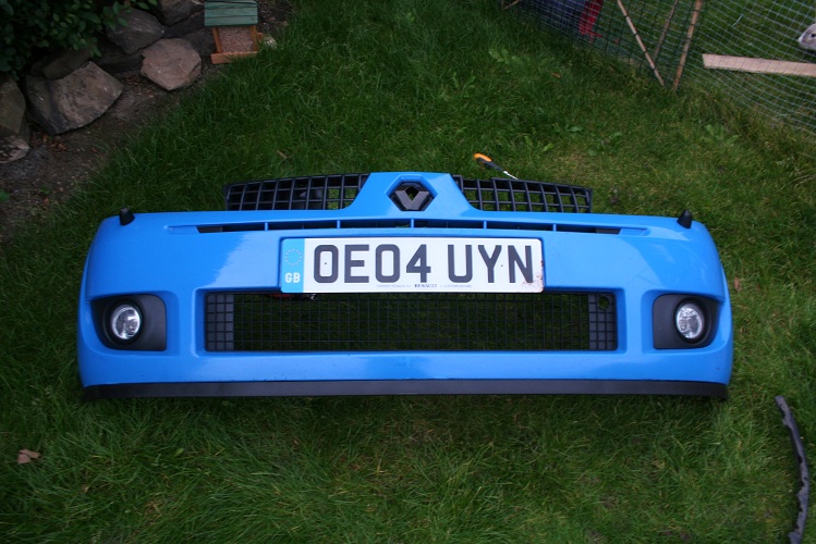

Another little update

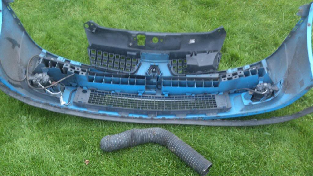

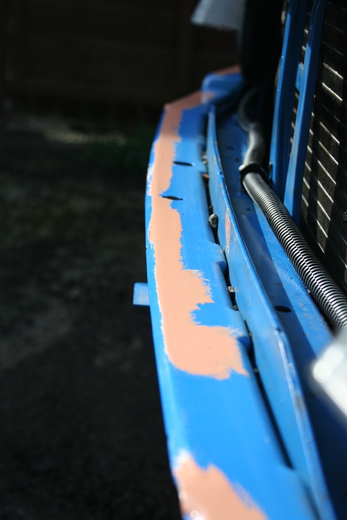

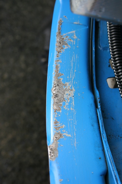

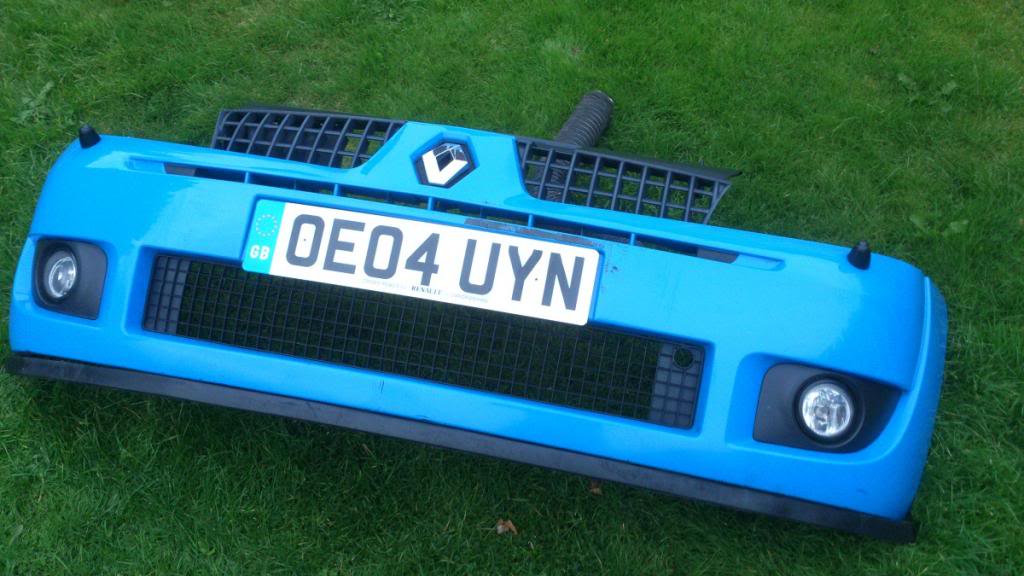

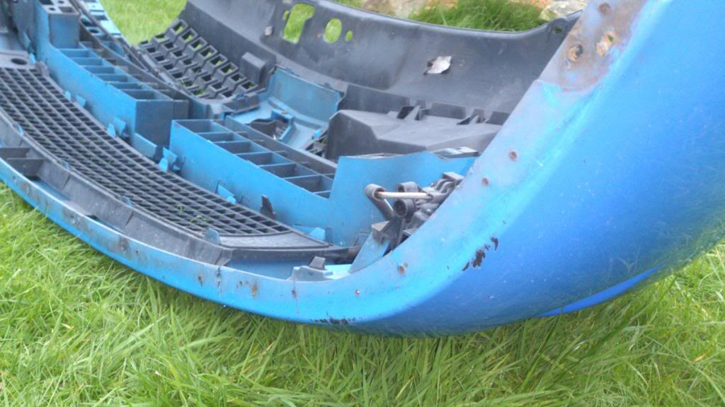

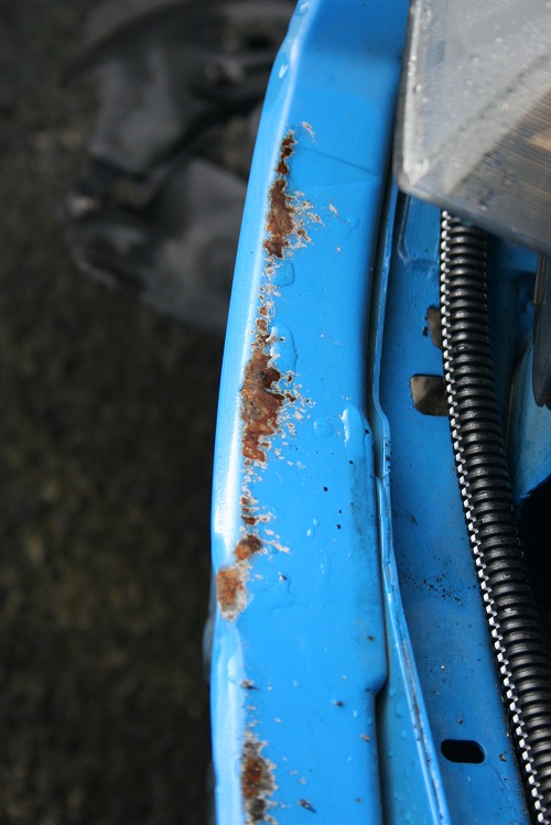

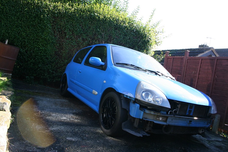

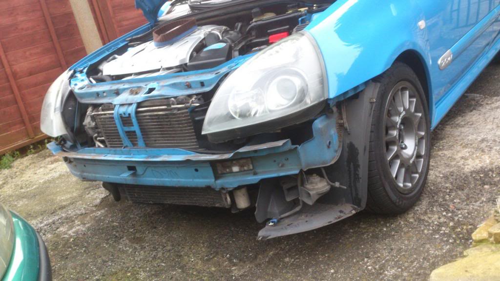

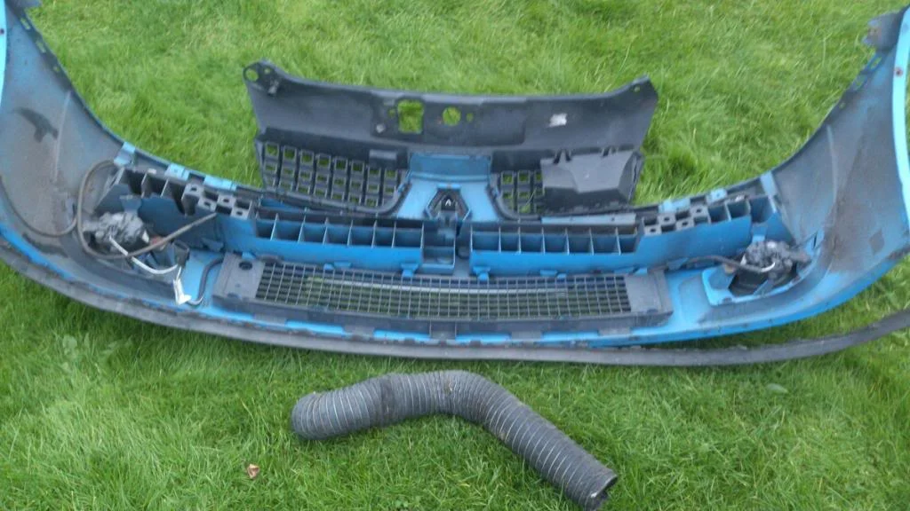

whipped the bumper off and found a few things, bit of rust on cross member where the bumper has rubbed. putting this down to the fact the bottom bumper brace to the subframe is missing so bumper can flap about a bit at high speed.

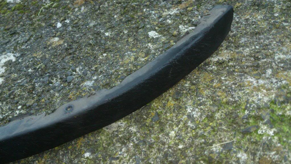

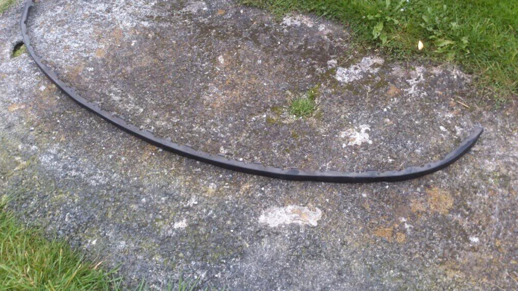

also ripped off the old skoda splitter as it was pretty fubar, I have ordered a new one from the dealership in Chesterfield, plan is to run that and check out damage over coming months and if all looks well on usual driving i'll invest in a carbon item for sexy thrills :)
also ripped out the tumble drier hose that was botched to the front grill, I will hopefully be returning the airfeed to standard at some point.

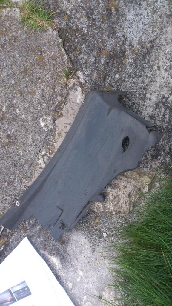

and finally, drivers side front splash shield was totalled, so will be sourcing a new one hopefully if I can find one!
the bumper itself will be going to the bodyshop today hopefully for a patch up, new foglight bolts and a spray along with some other bits to tidy up the front/engine bay

bumper off
car looking a bit sad for itself
tumble drier tube off
broken splash shield
old splitter off
damage to it
and slight crack on lower front bumper
dragged the bumper to couple of bodyshops, looking at couple of ton to get it sorted so its going to wait till next year, i dug out the touch up pen from the boot and just slapped some paint on it to cover the marks, it aint pretty but looks okay from a distance and better than the black platic showing through
also decided to just nick the splash shield from the 172 to fit for now as one for 182 is silly pricey if you can find one so sack that as well!

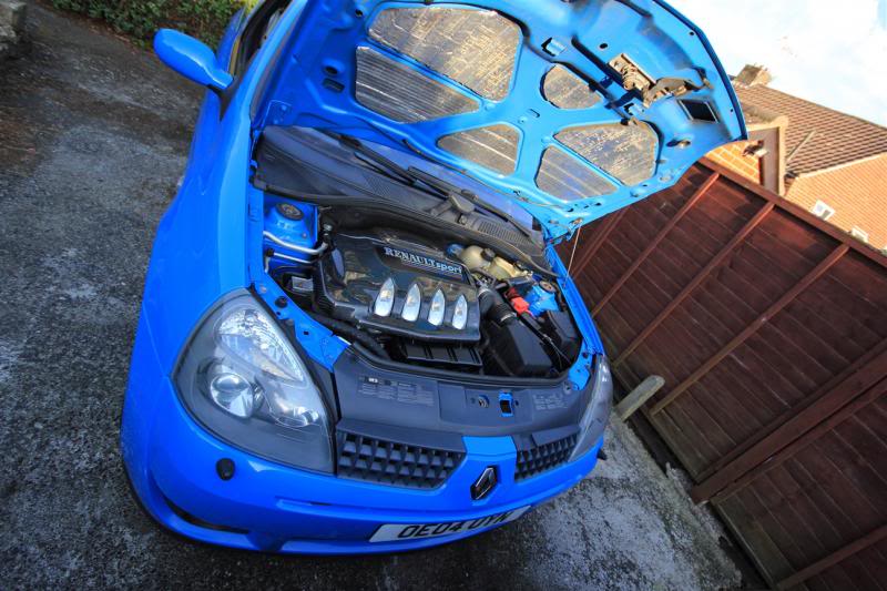

and finally i Gunked and jetwashed the enginebay and underside of the bonnet to clean it up properly.

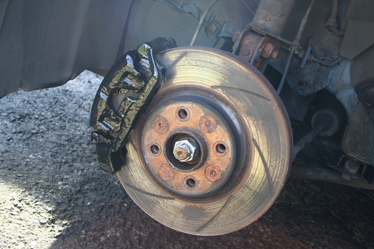

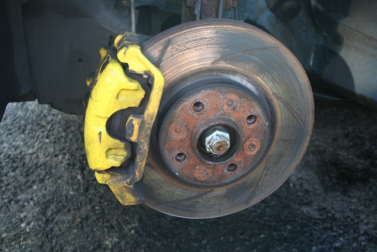

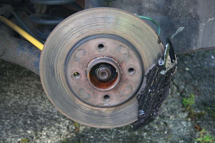

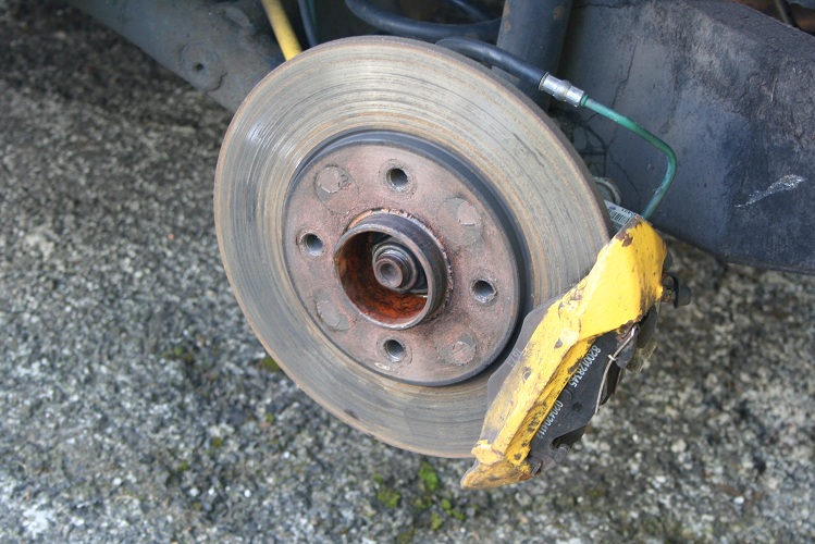

Attacked the brakes and the splitter showed up as well
so thats the last of the yellow highlights gone from the car, looking slightly more stealthy than before which i prefer
old:
new:

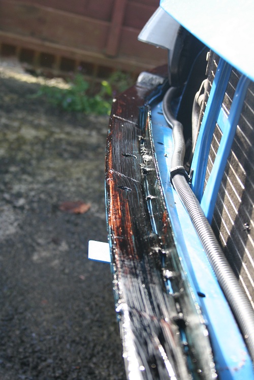

treated the rust i found, all surface so no worries :)
scrubbed back
treated
waxoyl'd, that should keep it okay for while :)

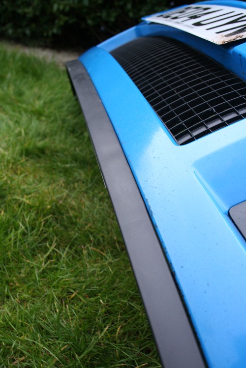

new splitter here, bargain these are, even the bloke in the parts department at skoda was shocked at the price!lol!
fitted

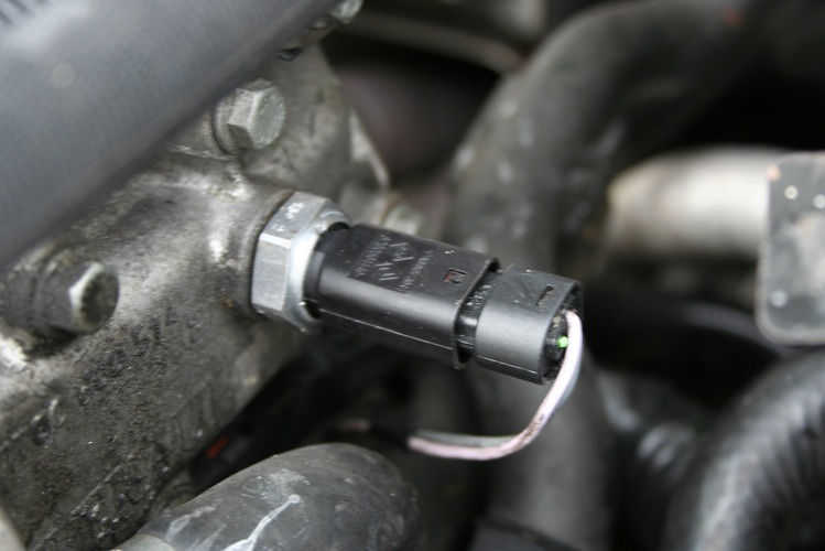

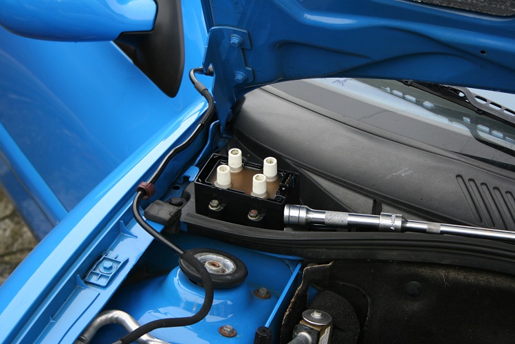

did a bit of geeking and pulled up the CTS as likely cause so i took a half day and spluttered to Gordon Lamb Renault in Chesterfield and picked up a new sensor, and 10 litres of type D whilst i was there for stock :cool:
you can guess the drive home....spluttery!
so onto the drive and new sensor fitted......................no different!fail! so i proceeded to strip bits off the 172 to diagnose, swapped all the obvious and easy to reach sensors, no different, and unplugged the upstream O2 sensor. again all to no avail, car still running like a bag of spanners.

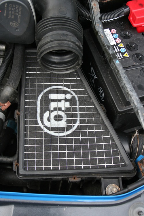

so inlet off and ht leads out to check plugs............what a mess, water ingress was evident on 2 of the pots and it was number 2 that was down. plugs where all whipped out and cleaned up and the sticky mess of residue in the plug wells cleaned up as well. i think its been wet in there for a while so to speak but my engine bay cleaning antics the other day must of made it worse and lead to this issue.
another thing to note was the spark plugs seemed very loose to me, so i nipped them up to my own satisfaction whilst i was there and proceeded to put the lot back together and low and behold fired up and ran lovely! sorted and could of saved myself 20 quid on the sensor. going to leave it on though for piece of mind, so shiny new part added!

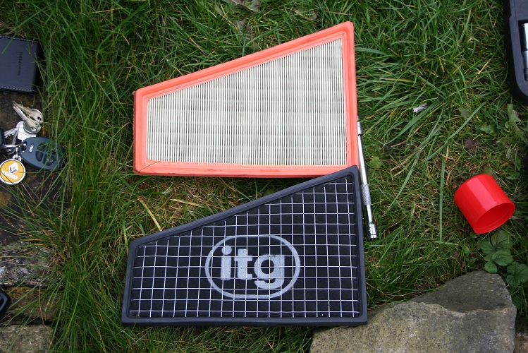

while the airbox was off i figured be rude not to fit my ITG panel filter as well while i was there, so that went in too.

new temp sensor
coil swapped out for testing

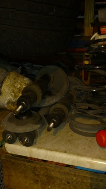

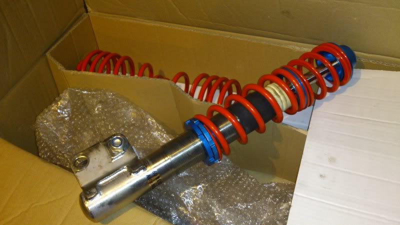

I have also been collecting parts for more improvements to the car, I am currently in two minds as to suspension choices as well.
the car currently runs on KTEC coilovers, which i kind of think are okay, not great, but decent enough for lows and daily road use, but i want to try some other solutions as well.

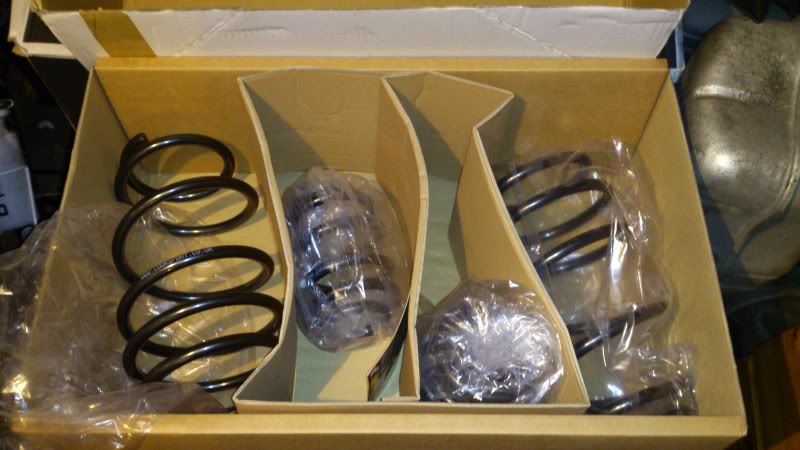

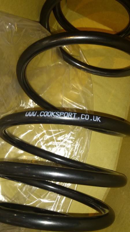

as such i have purchased a pretty much brand new set of Vmaxx coilovers to try, this will give me the freedom to adjust my ride height etc as i see fit. and also i have bought a set of the new cooksport springs to fit to the o/e suspension i have in the shed that Luke included in the sale. i think i will run the cooksports over this winter to keep the ride height up for snow etc and then play out on the coilies next spring :)

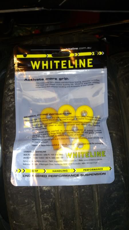

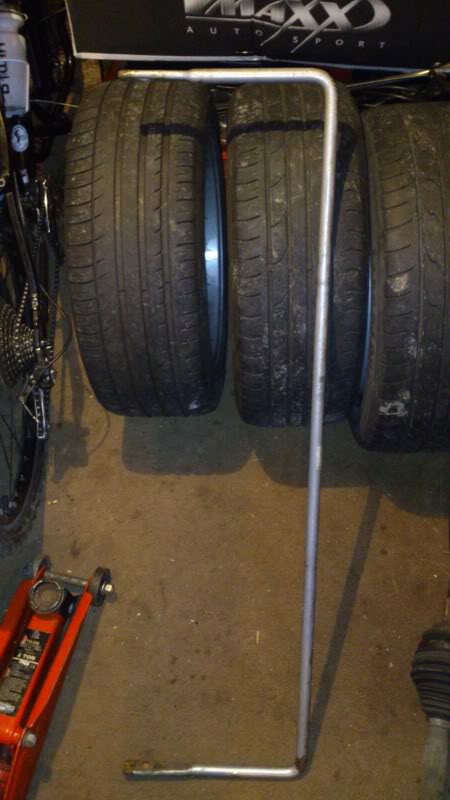

i have also got hold of a whiteline rear ARB and purchased some new bushes for the drop links to keep it tight, i intend to get it powdercoated before fitting it so its not going on just yet!

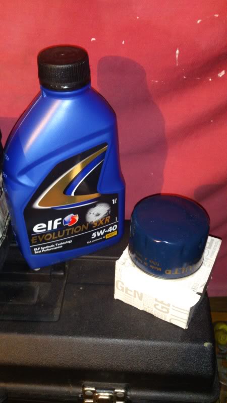

and other bits for the collection are new oil (5x 1L) and a filter/sump plug washer ready for next oil change, a set of brand new gen ren mats and also some carbon fibre exhaust surrounds to continue my c/f fetish :)
that’s it for now, more pics of progress/suspension testing over the weekend hopefully!
parts:
Standard cup shocks
Shiny new cooksport springs
Vmaxx
carbon goodness :)
whiteline plus new bushes
oil and filter

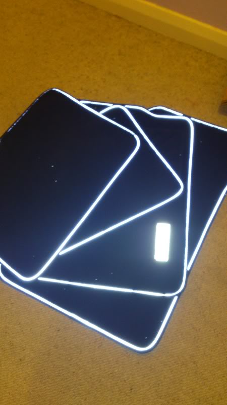

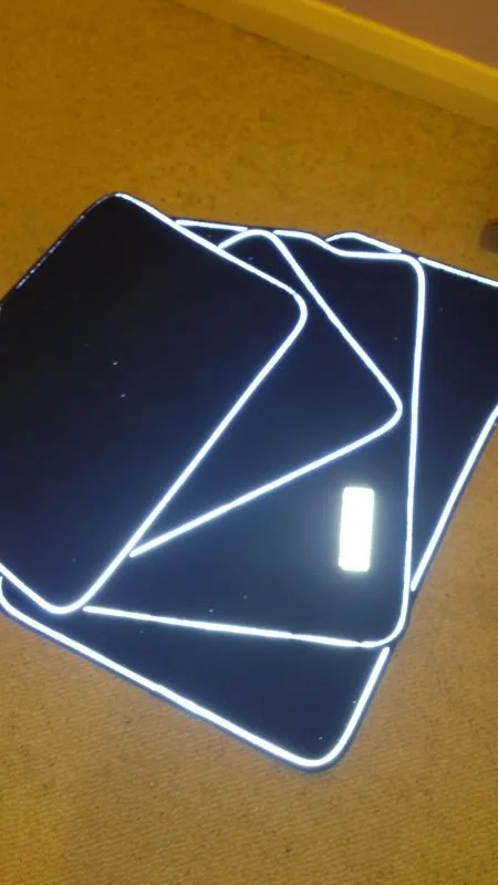

and finally new mats
Looks awesome.
Makes me want to spray my wheels white, remove my stripes & spray the front & back badge.
Where did you pick up those mats from mate? Looking for some myself as I don't have any at the minute :(
You can get them from your local Renault garage. Part number is 7711425548. Alternatively Tom@wests sells them on here.
as above, they are a genuine Renault part, about 50 quid from the dealers iirc, but I bought these 'second hand' but completely unused with receipt :)

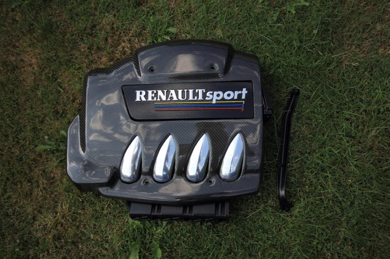

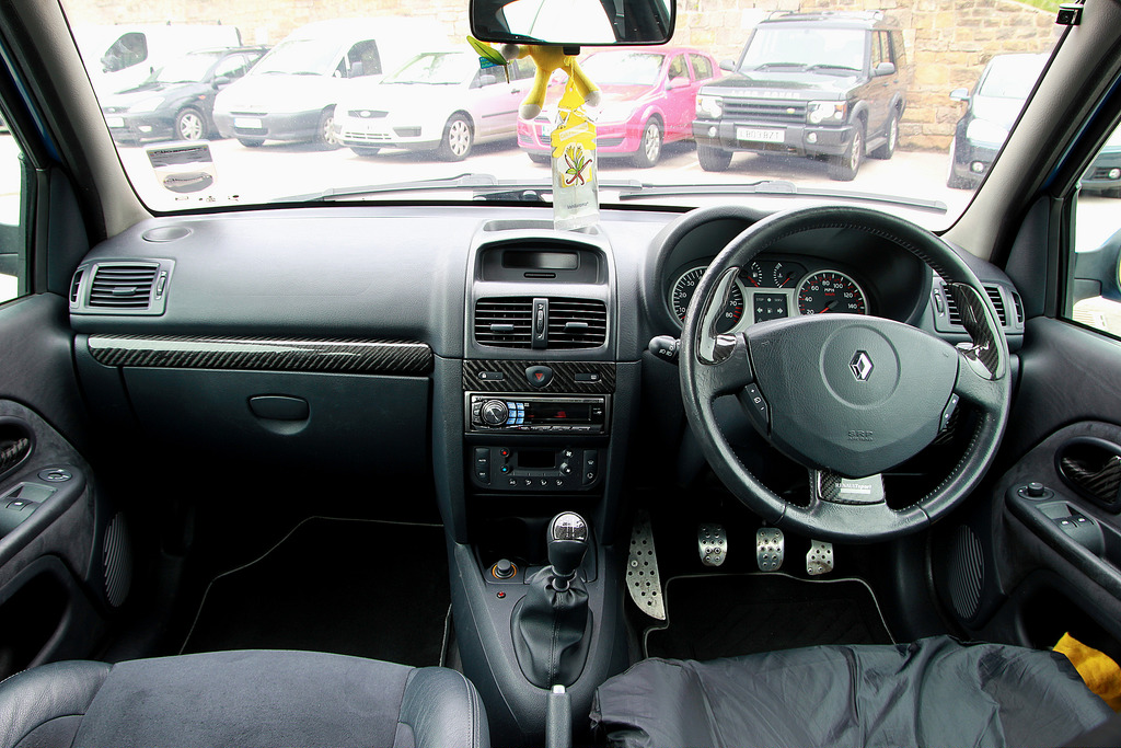

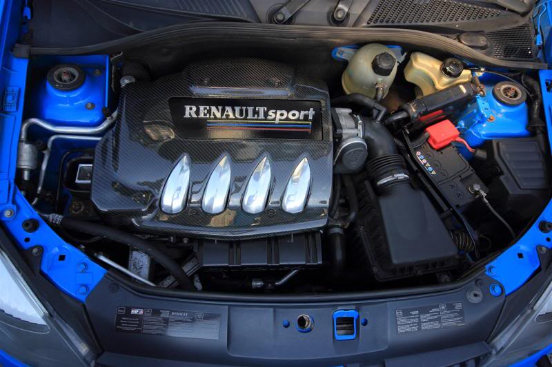

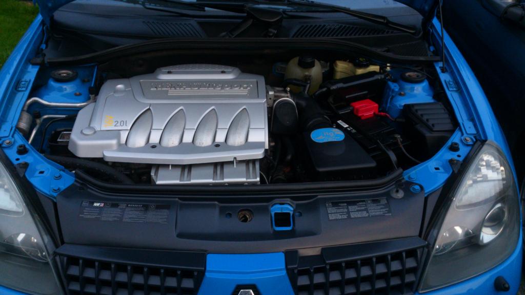

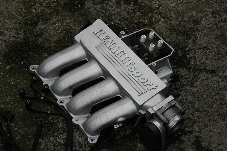

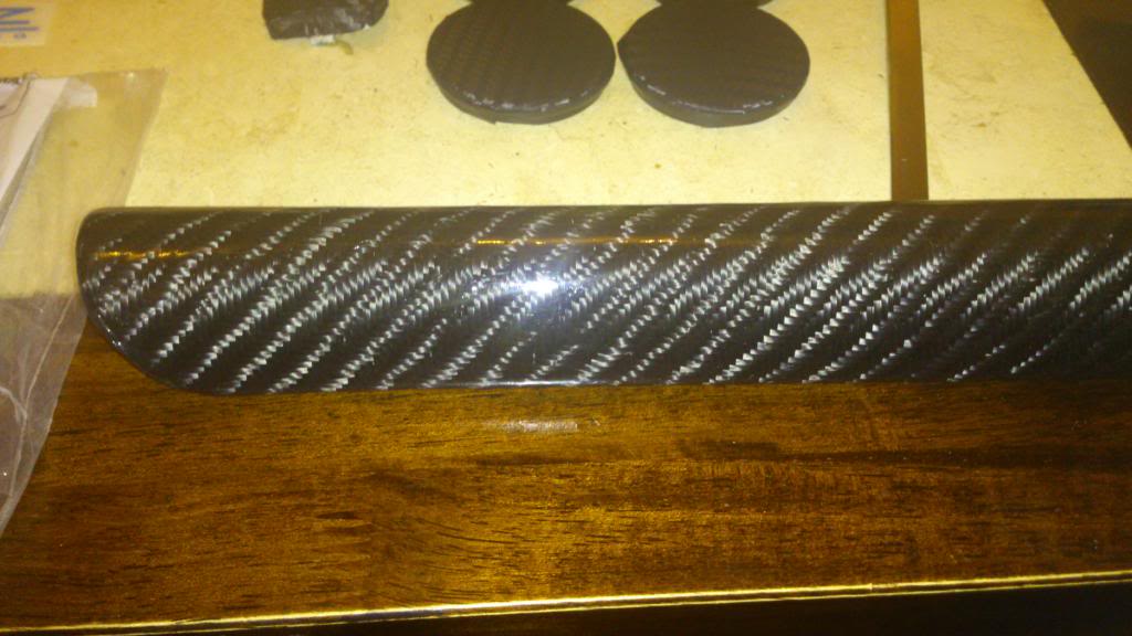

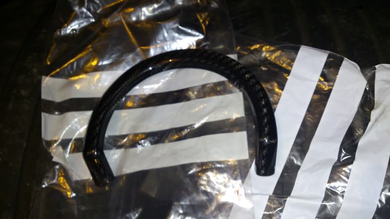

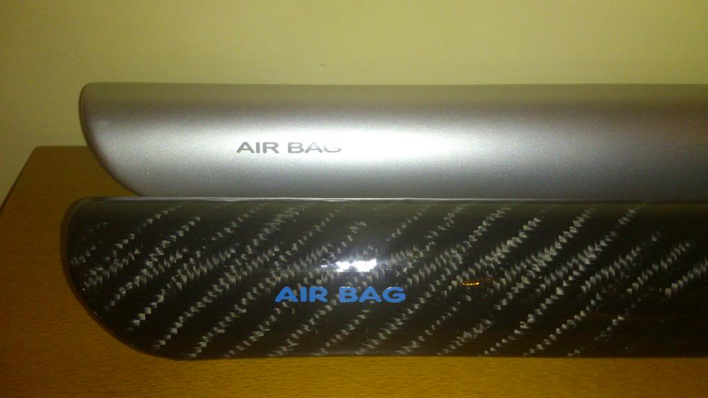

most recent progress has been engine bay changes, perhaps not everyones cuppa, but I like carbon so theres more of it! to go with the interior stuff I added over the winter/spring
interior carbon
IMG_4085 by Coops_Turbo, on Flickr
and then bits and bats under the hood:
so inlet, fuel guard, top cover and ecu bracket all swapped out for bling ones :)
