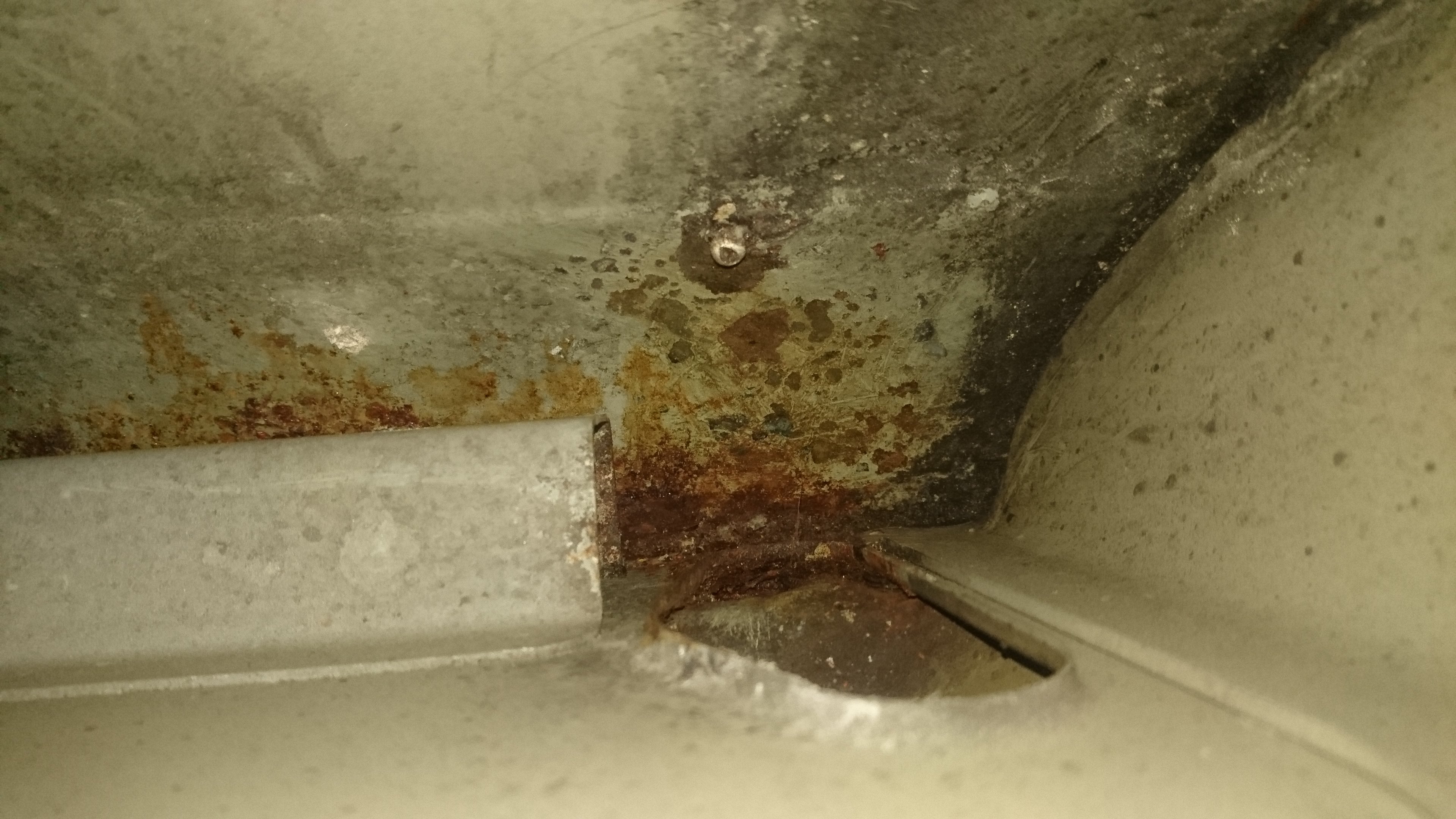

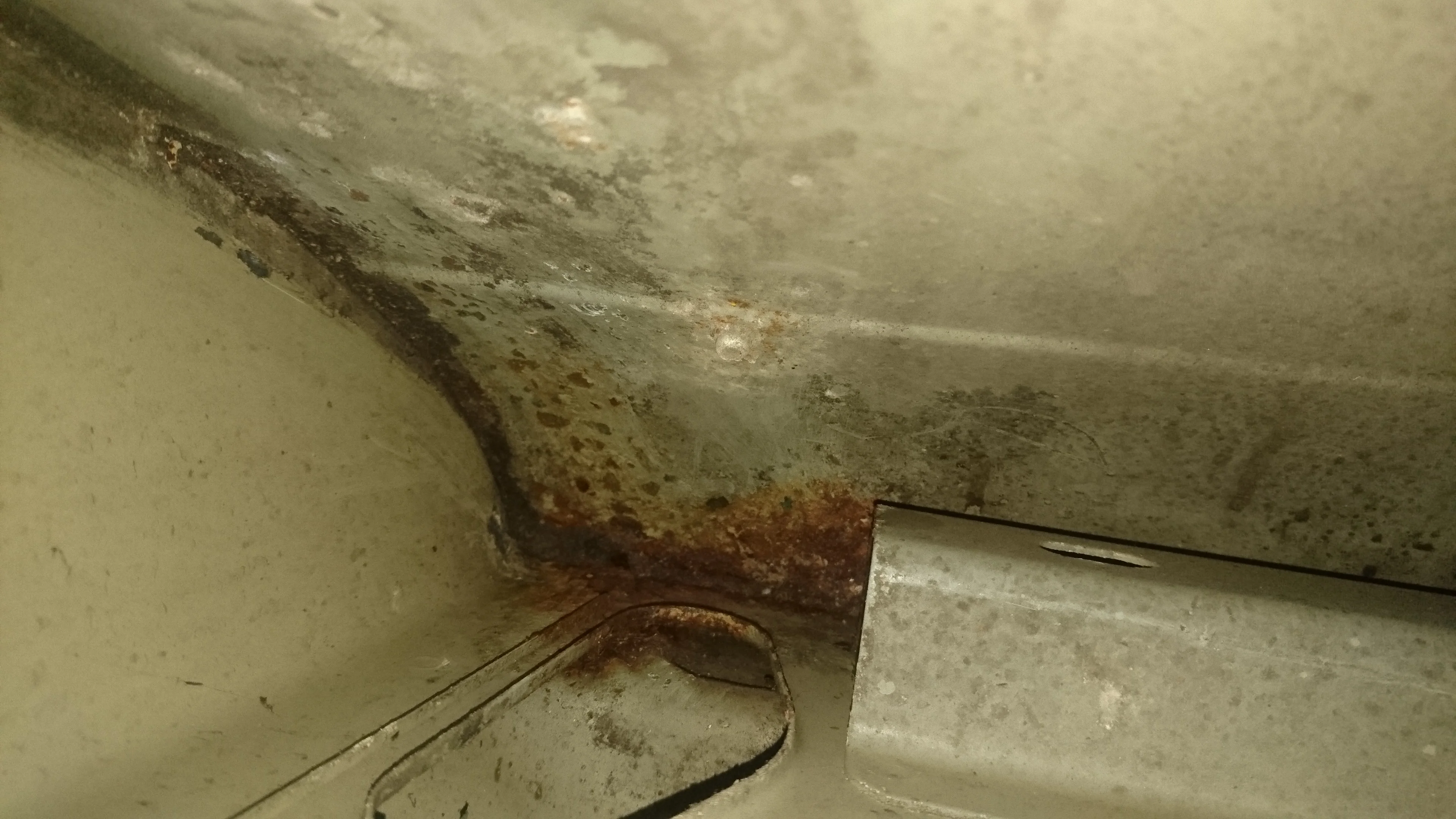

Thought I'd actually take a nosey into the abyss today and check the inner sills for tin worm.
I'm at the crossroads of do I spend the money to sort the arch or not, rot in here would seal the old girls fate...
So opened her up
And took a peak with bated breath ...

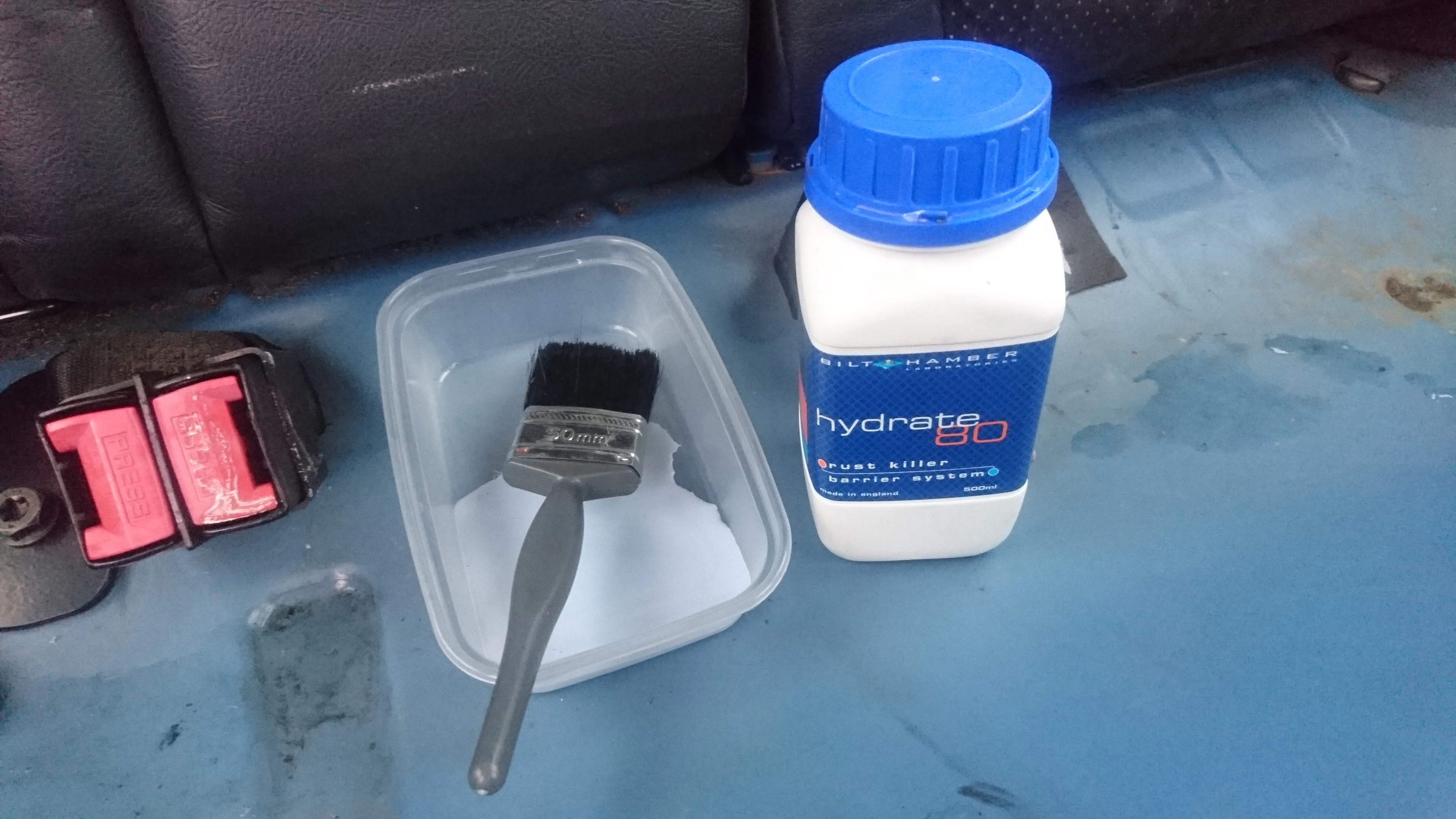

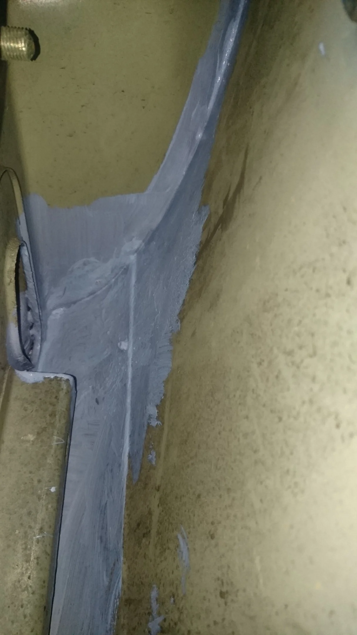

Gave it a prod and a wire brush back both sides and all seems well, surface rust only, no weak points, rot or holes! Happy times.
So cranked out the trusty rust nomming paint and lathered her up from the inside ... Oooo matron
I've left the cards out so I'll set about it with another layer of nomming paint tomorrow and some waxoyl later in the week when it's dried

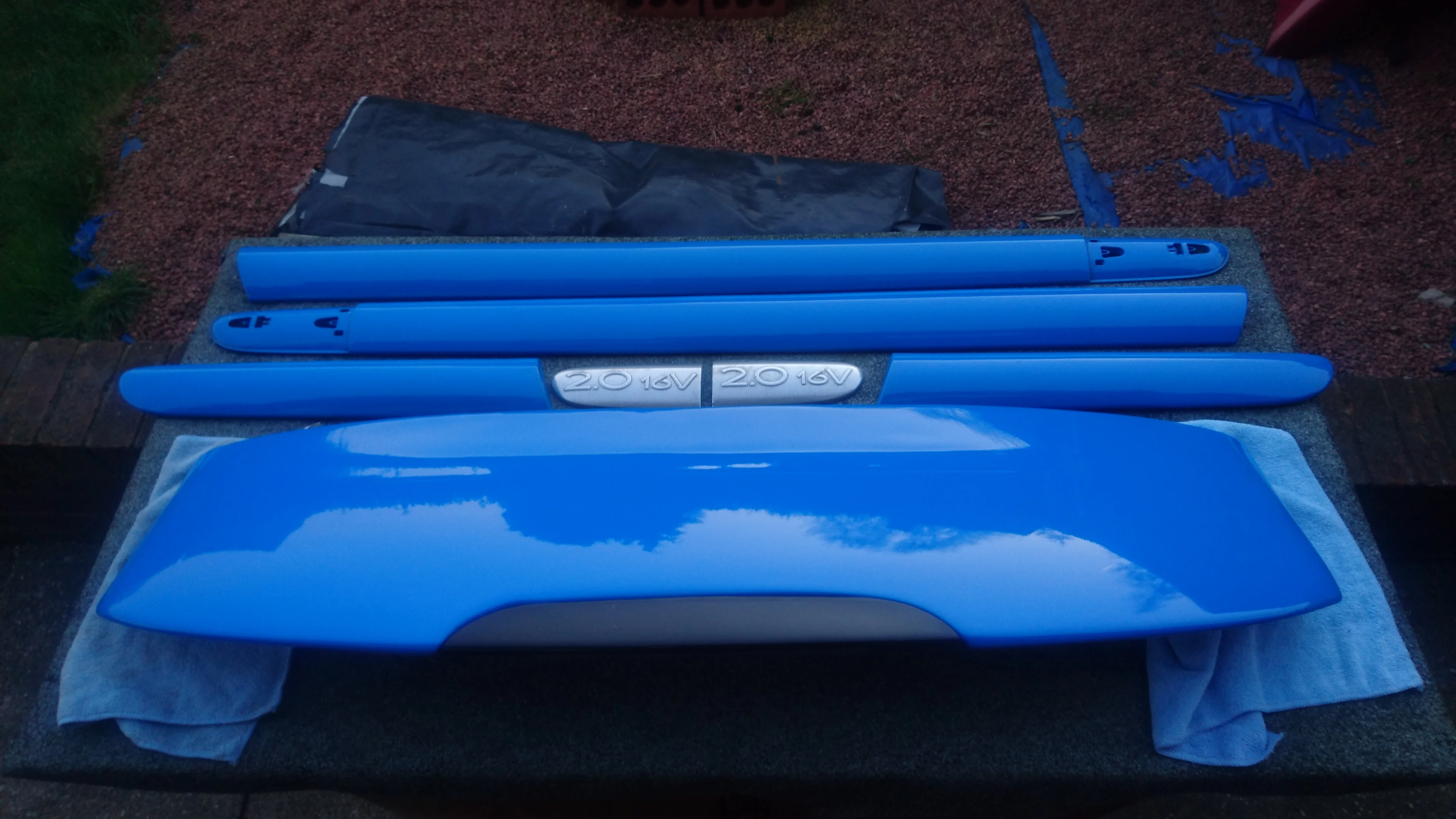

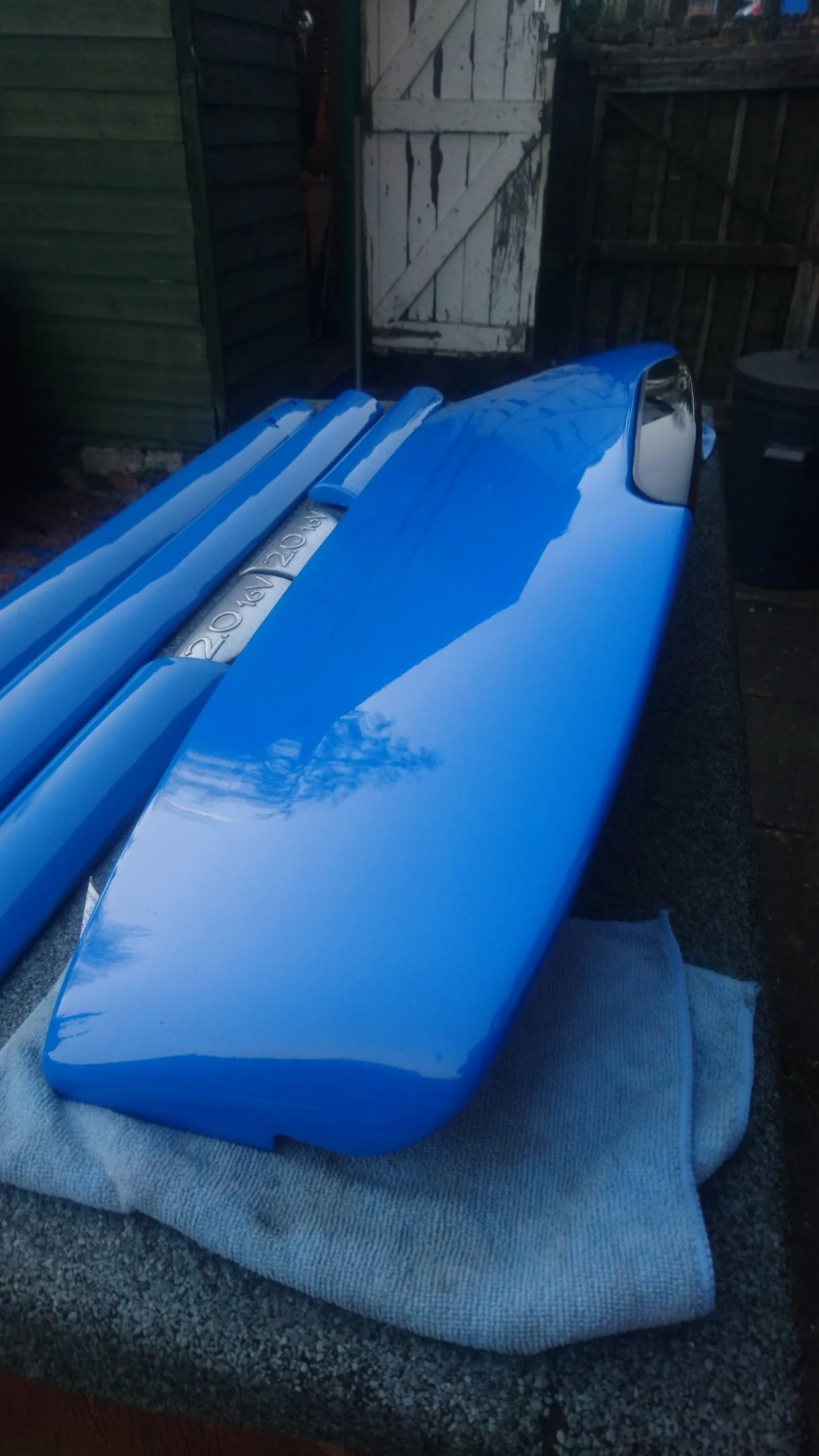

Made another purchase, replica trophy spoiler and some rub strips as my current ones are mis match colours and this set along with the spoiler are a decent match for the car!
Hopefully get everything fitted over the weekend, coilovers, recaros, whiteline, 675 wheels and this stuff. Miiint

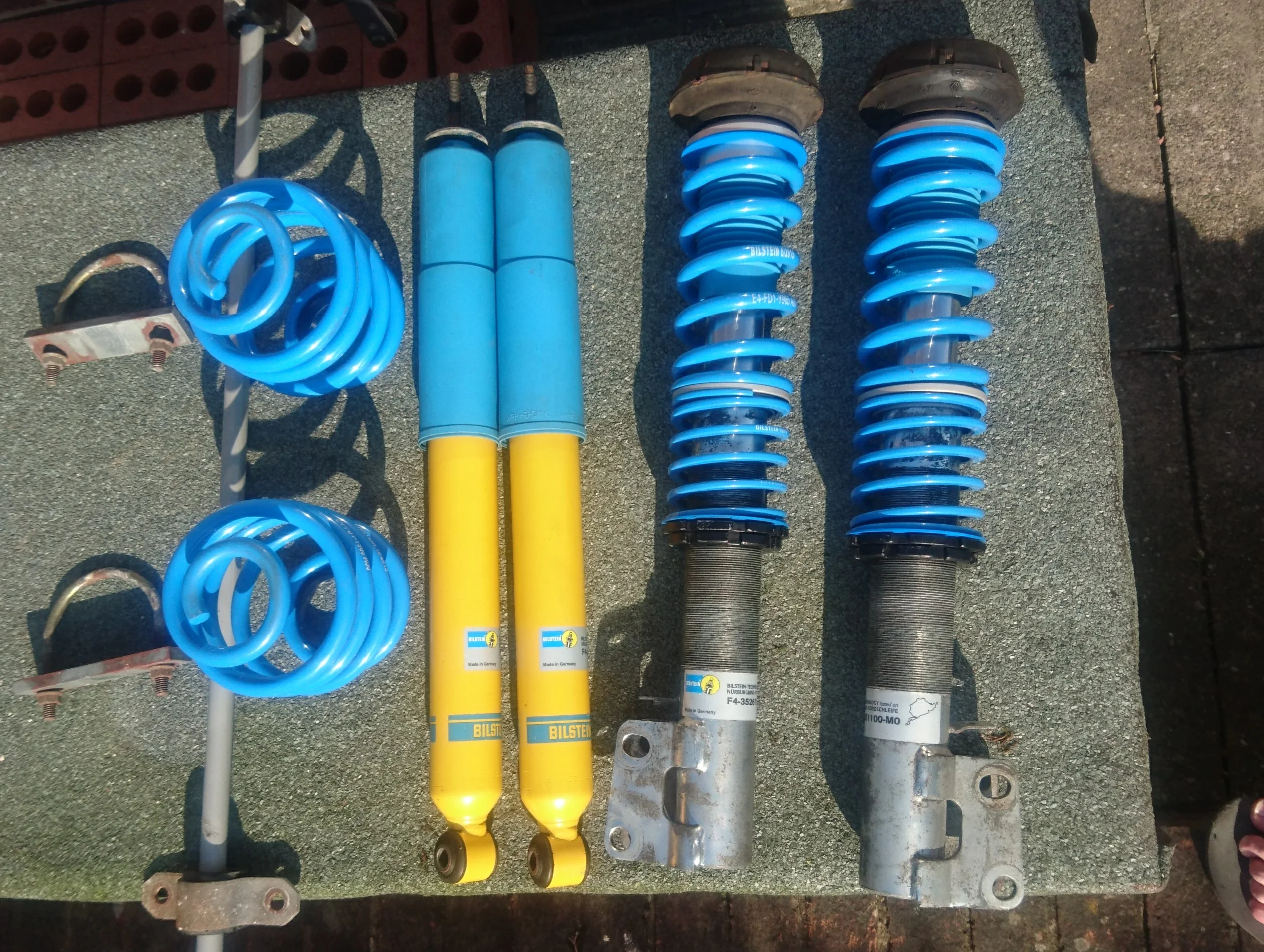

Coilovers, trophy rep spoiler and whiteline, they're all back off again
Williams Speedlines, recaros, spacers are still on
Back on h&r springs on cup shocks again!

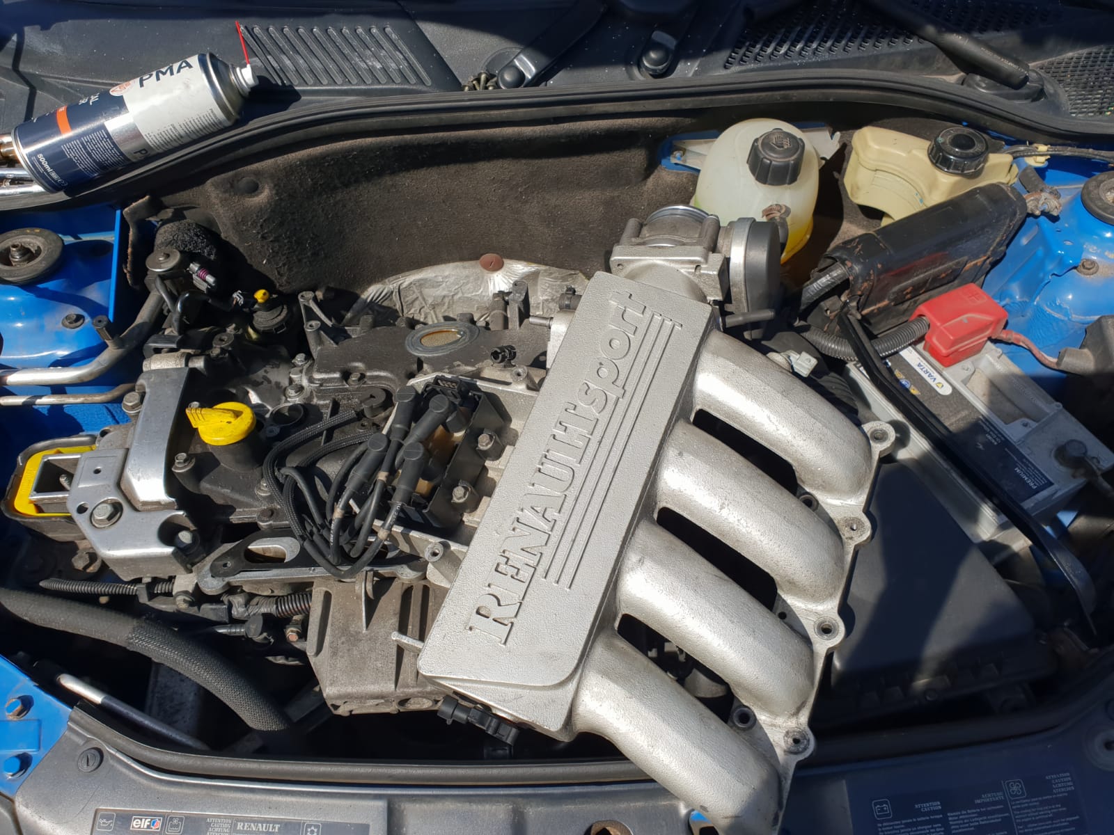

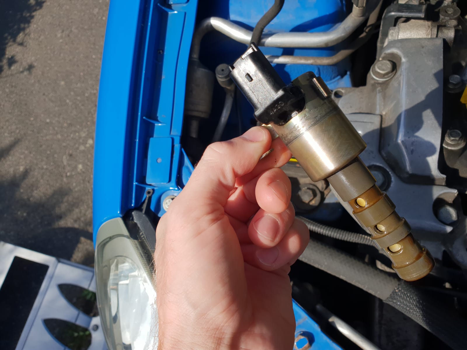

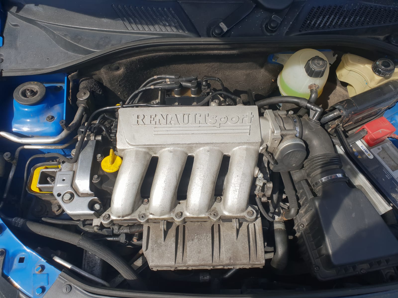

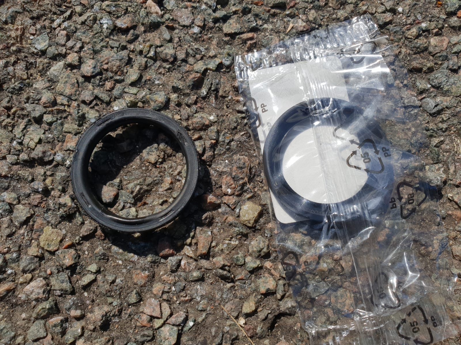

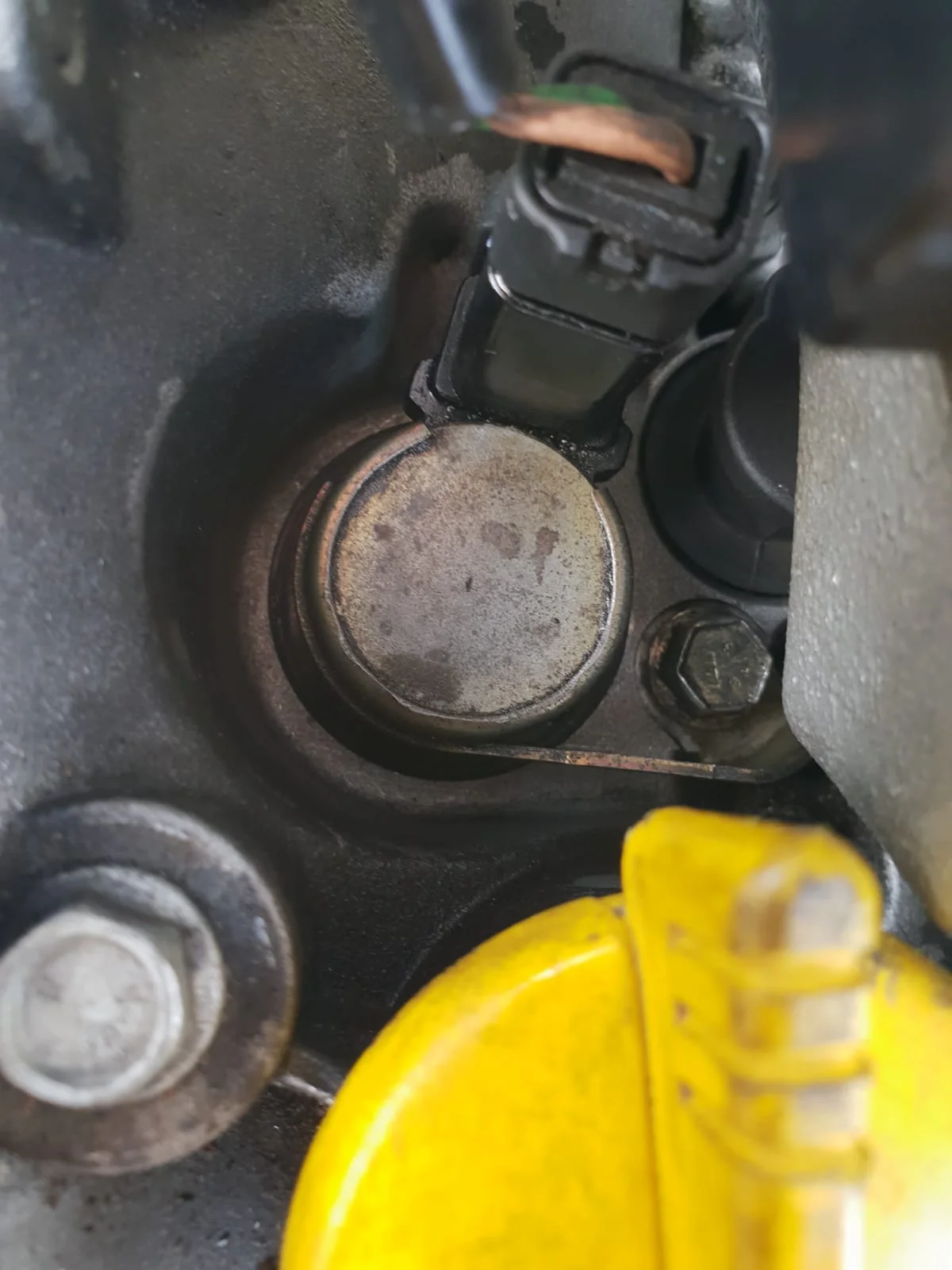

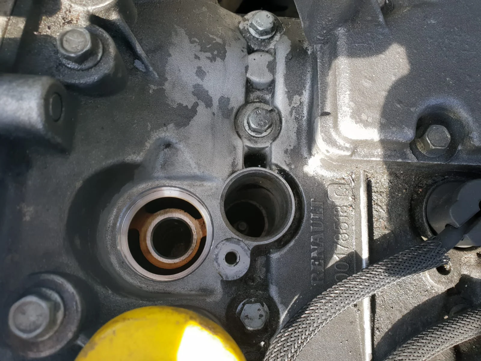

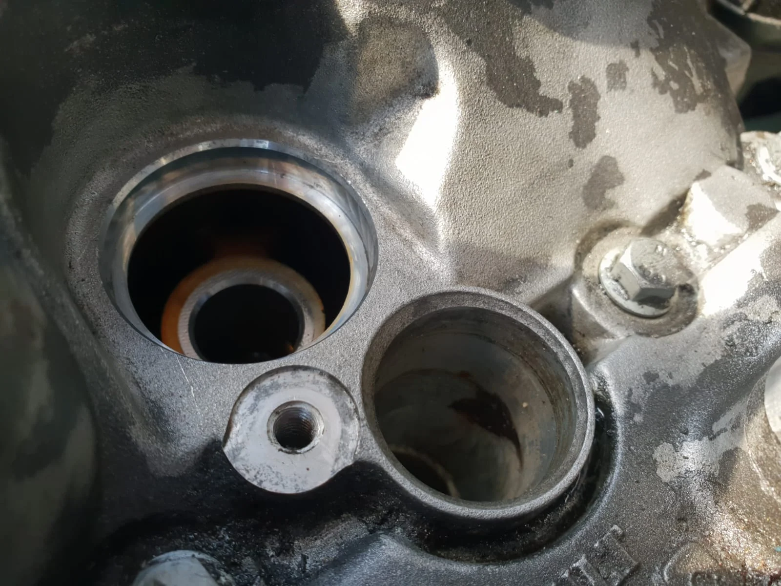

The cam sensor oil seal has been leaking for a while, common fault on these engines, the phase 1 is the same and did the track car one last year.
It was annoying me everytime I serviced the car seeing oil all over the cam cover.
So today I replaced the offending seal for a new gen ren one. I have also bought a second new seal to complete the same job on the odyssey at some point soon.
So inlet stripped off to aid access
Sensor out
Out with the old
Cleaned up
New seal installed and sensor refitted
And back together
Left cover off to run it today and check for leaks later.

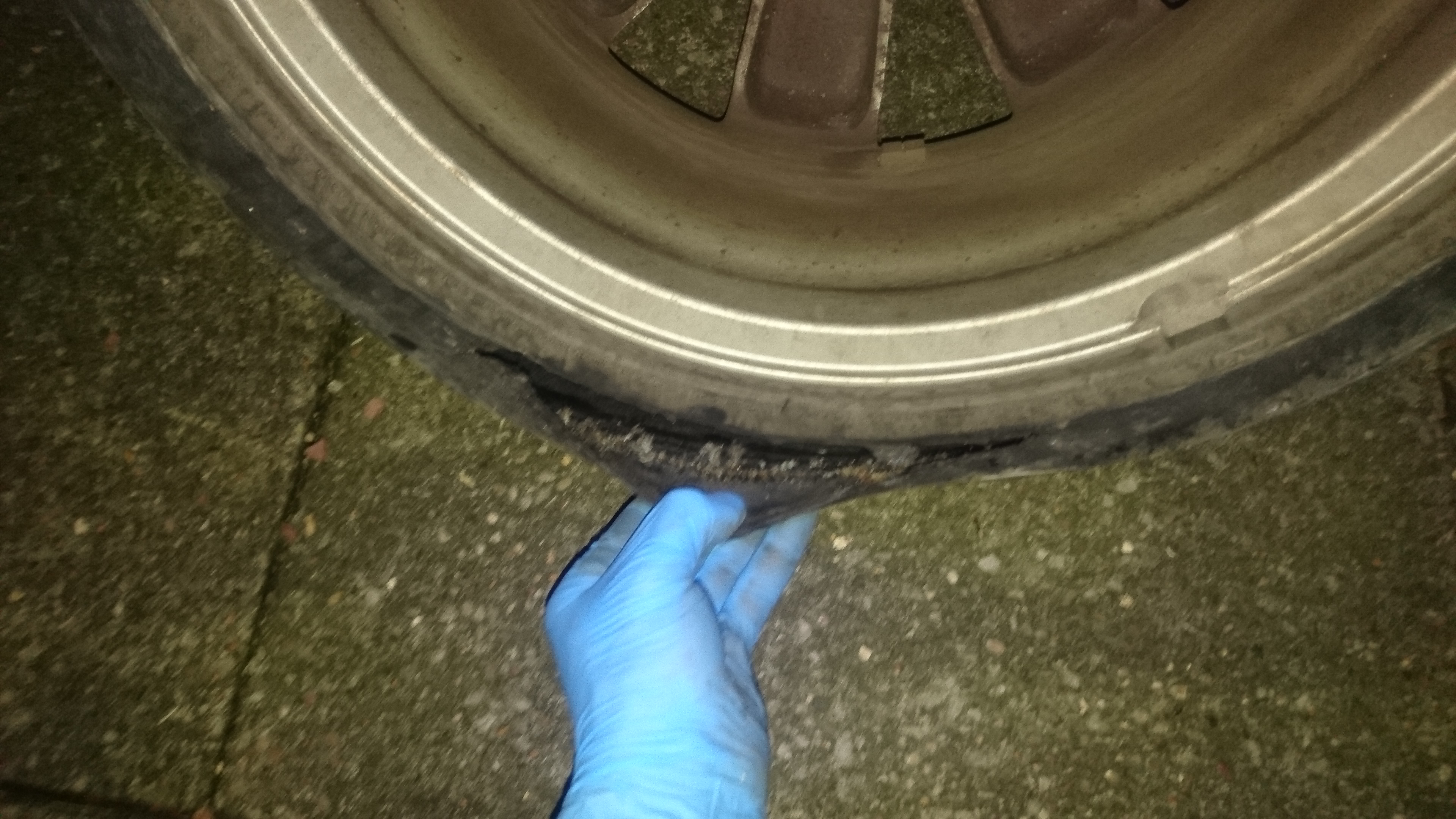

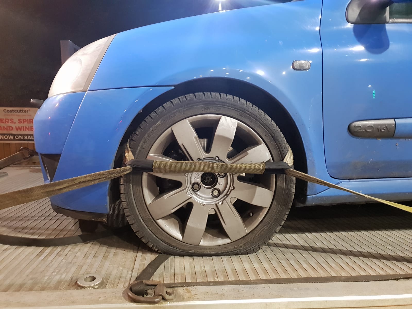

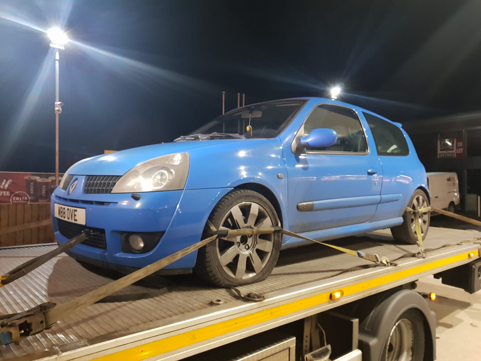

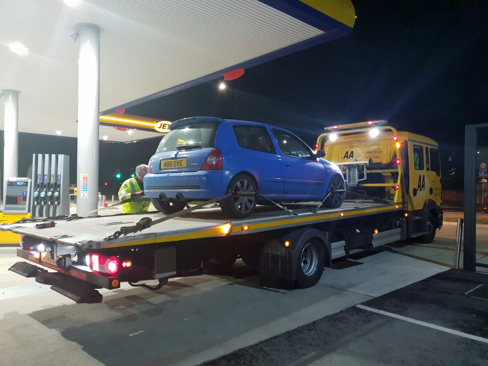

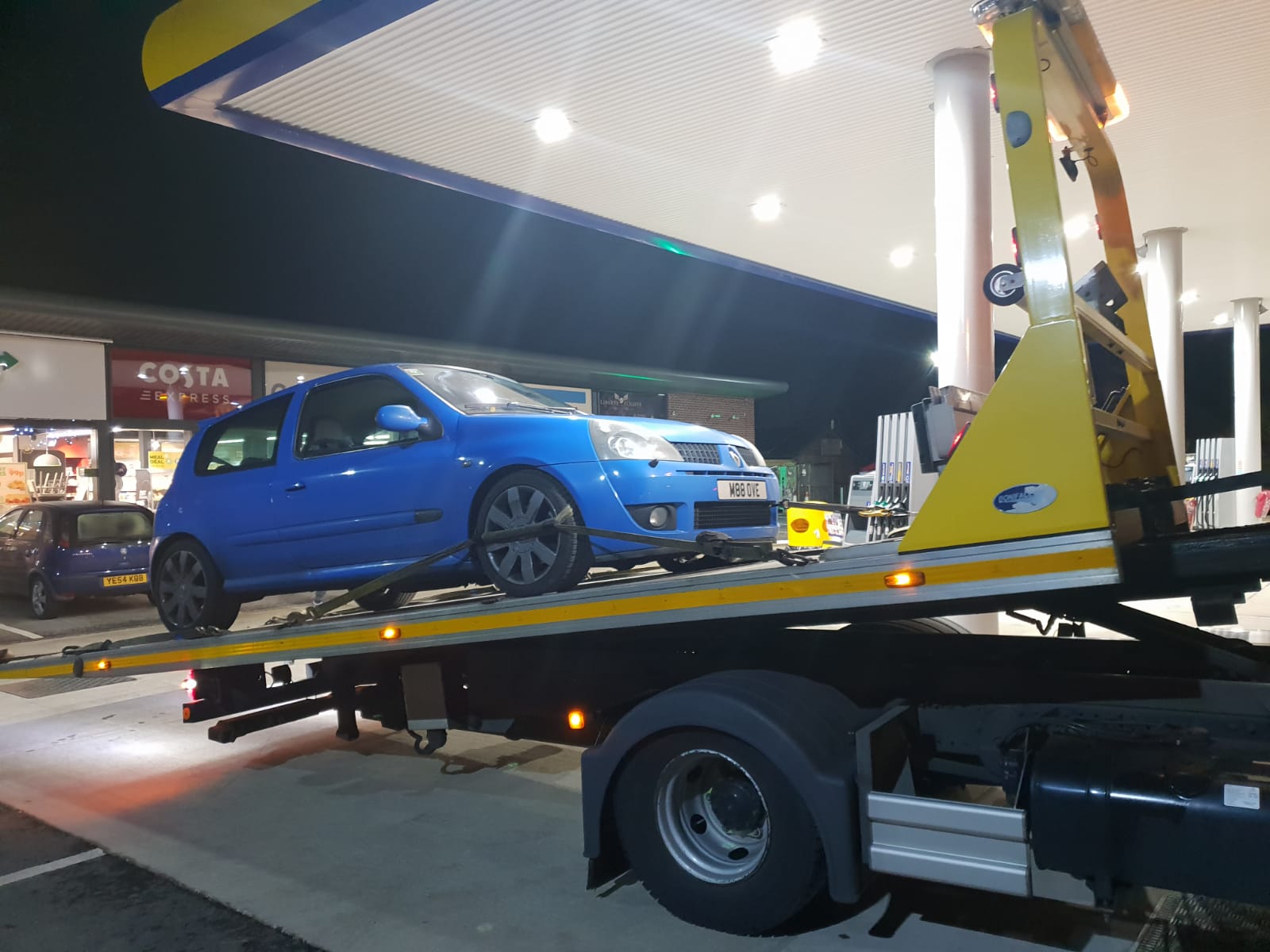

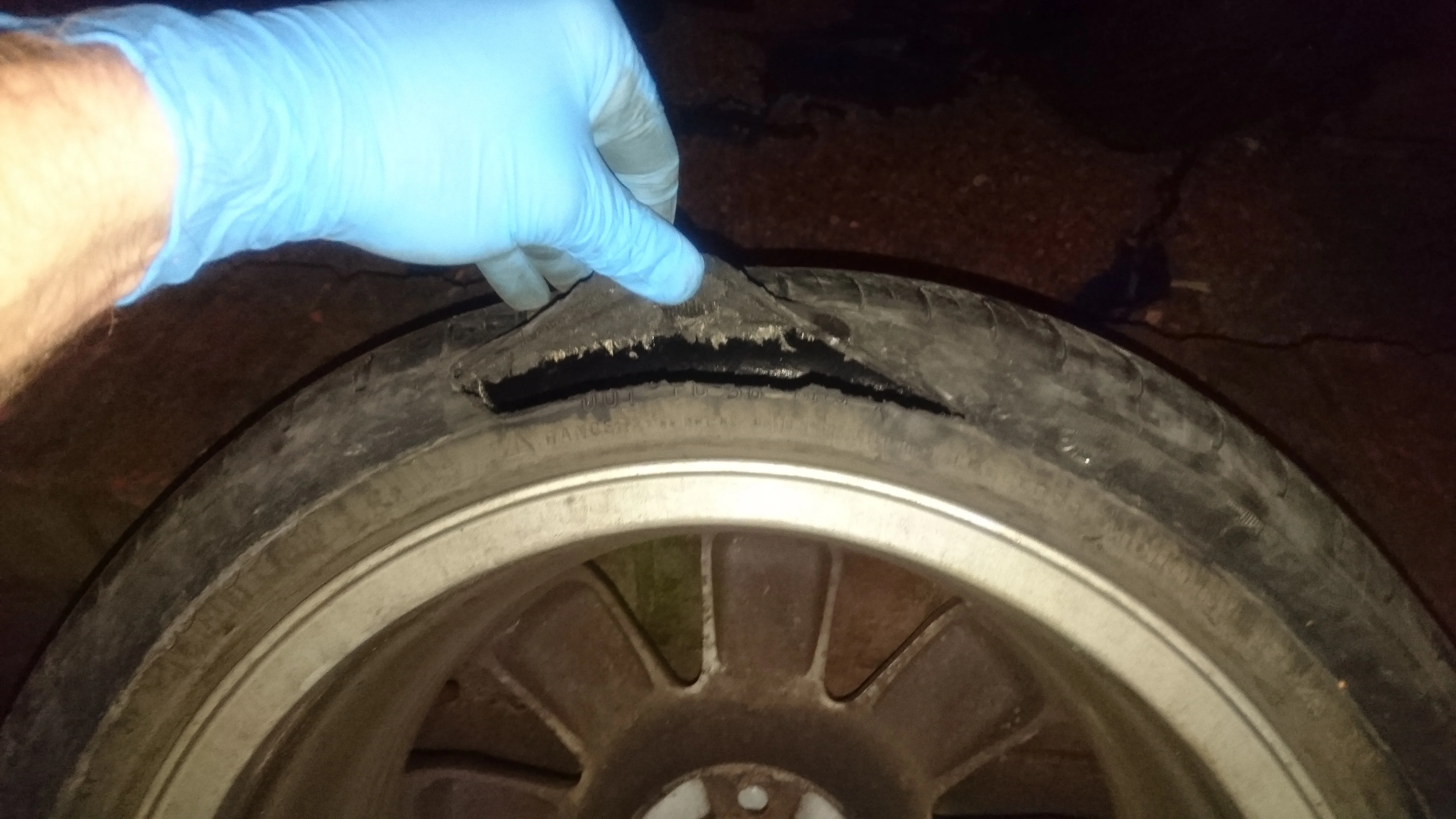

Well after 6 years it finally happened..... Car let me down and had to get recovered home last Sunday.
Well, tbh that's harsh the car didn't, Renault design did with no spare wheel. Had a blow out on the m18 and tyre was completely totalled by time limped off the motorway into a petrol station.
6 hours later finally got home, so the original cup wheels are no longer on for the winter due to tyre death so back on the speedline Vegas now for next few months.
188500 miles clicked on the back of an AA truck, lol!
Anyway, pics
Fail and one slightly unhappy Mrs Coops
Truck arrives
Loading
On

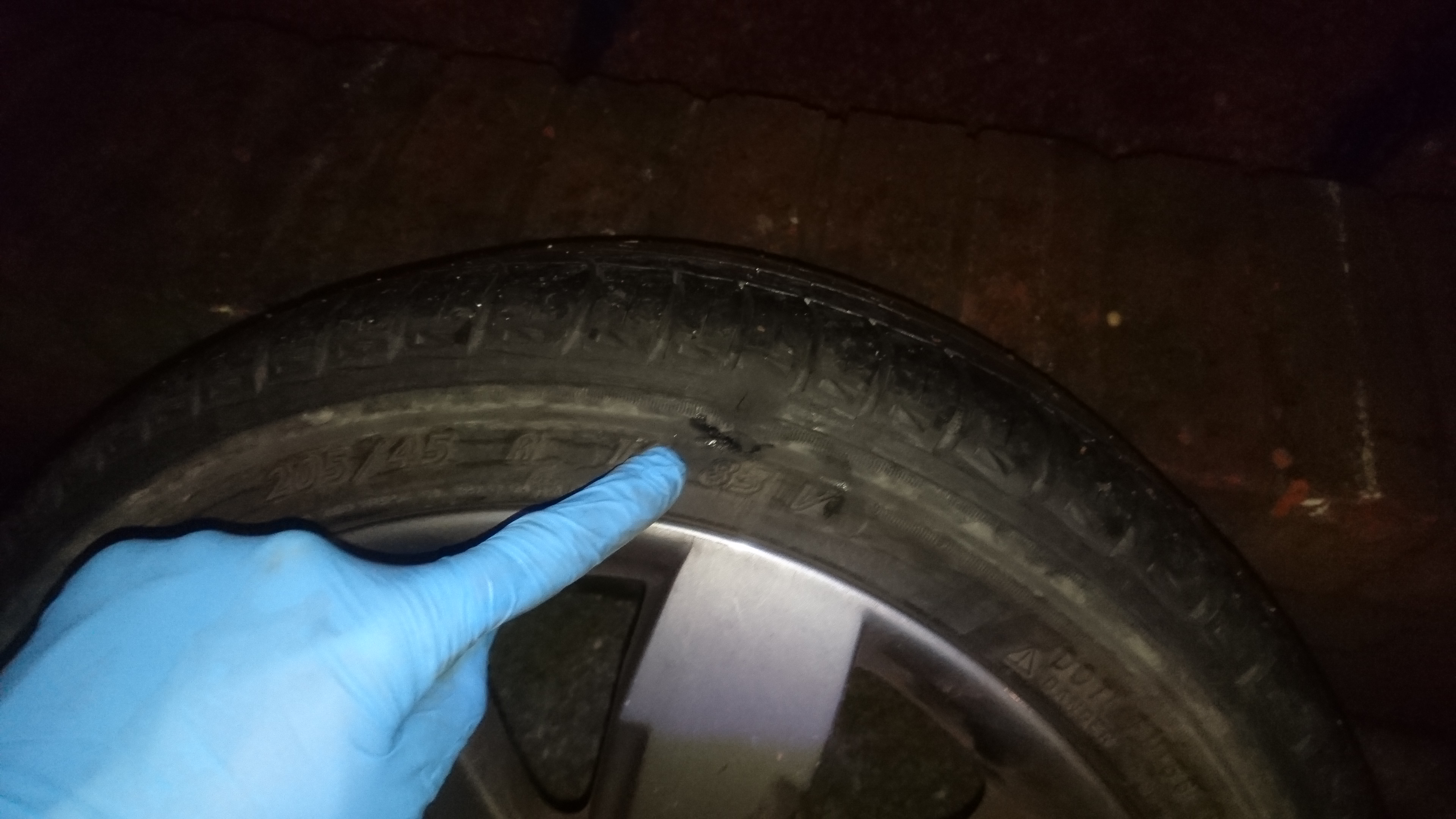

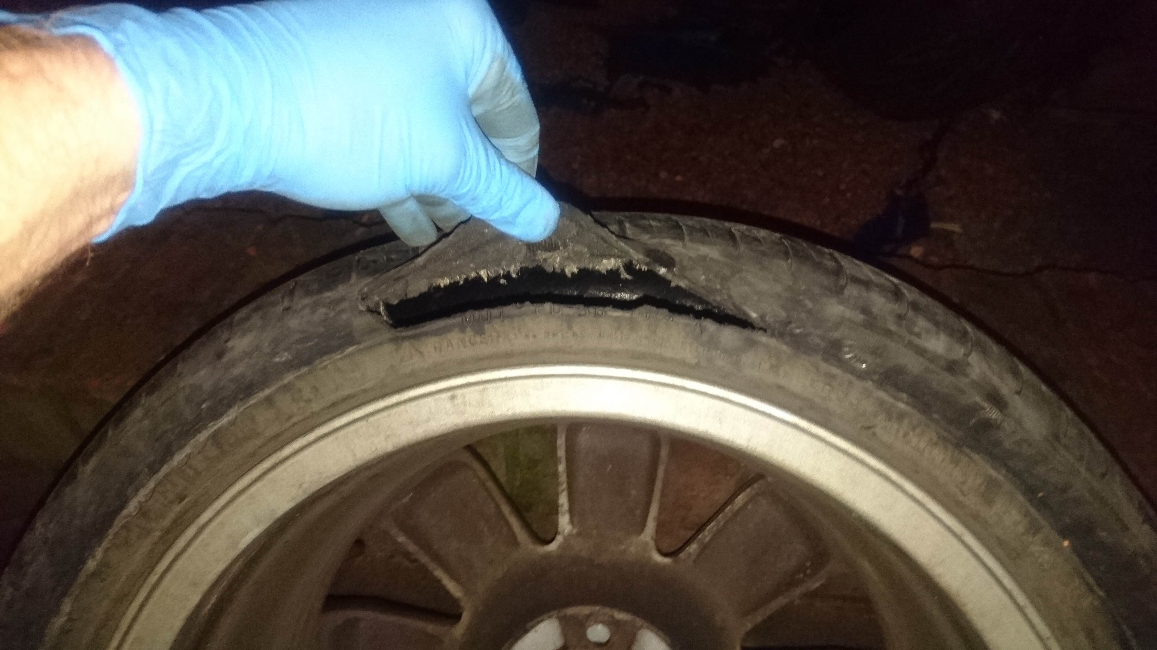

Popped tyre
Split on outer side wall that caused the deflation, guessing there was a manufacturing issue or an egg I didn't notice on the tyre
And result of driving to next motorway junction on it to get to safety, one seriously dead tyre
Temp fix for work before I fitted rest of the Vegas, wasn't changing all 4 at 11:30pm on a Sunday night with work on Monday! Lol!!

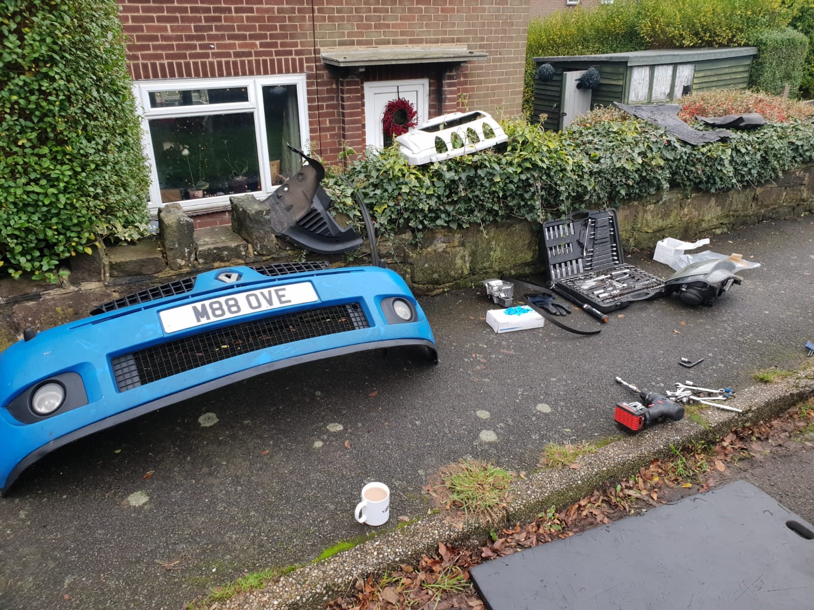

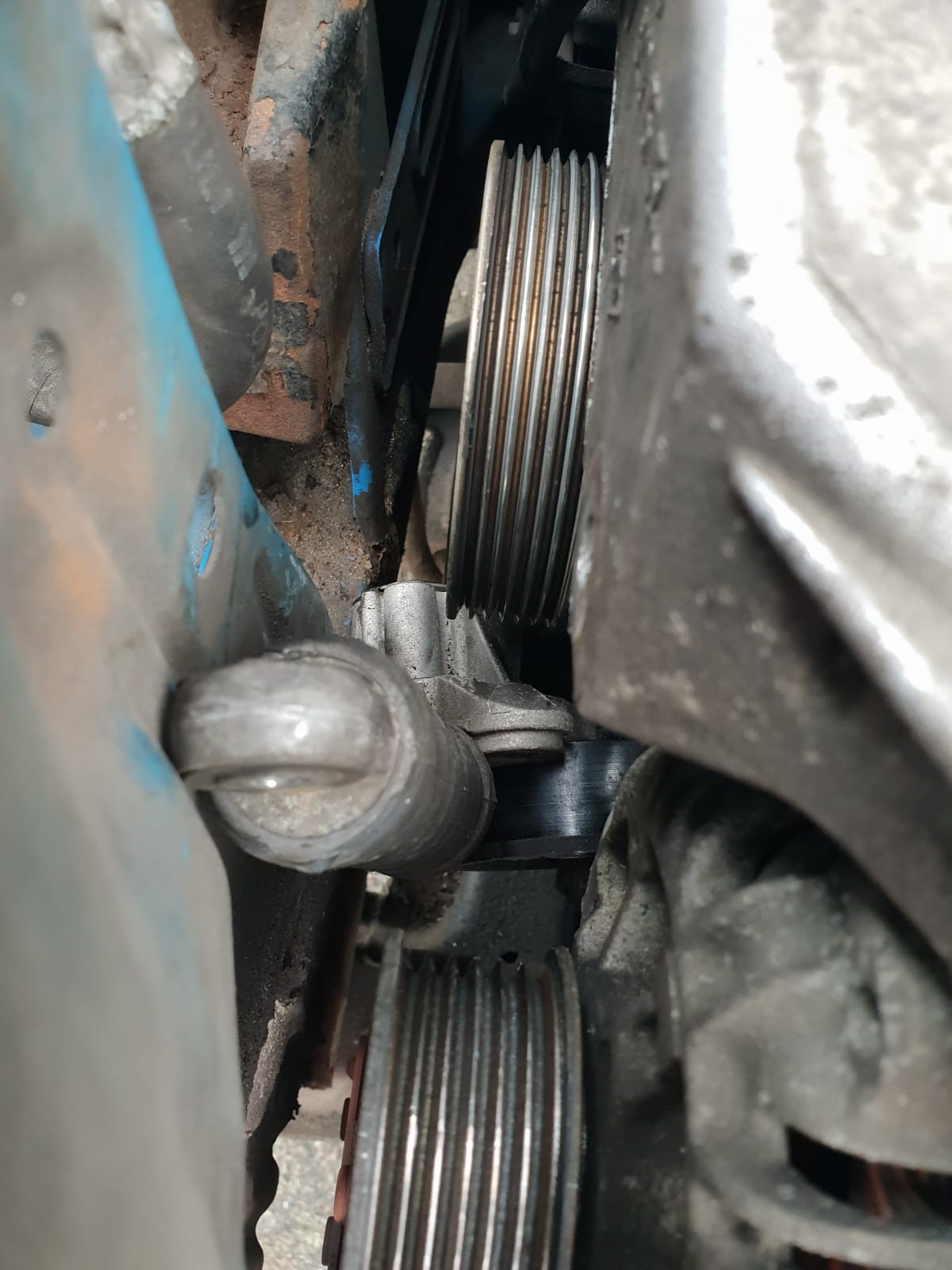

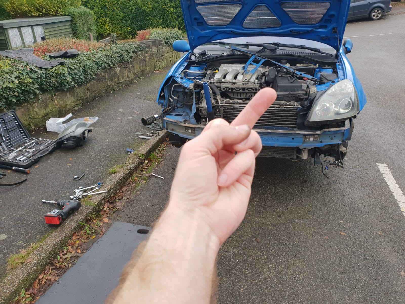

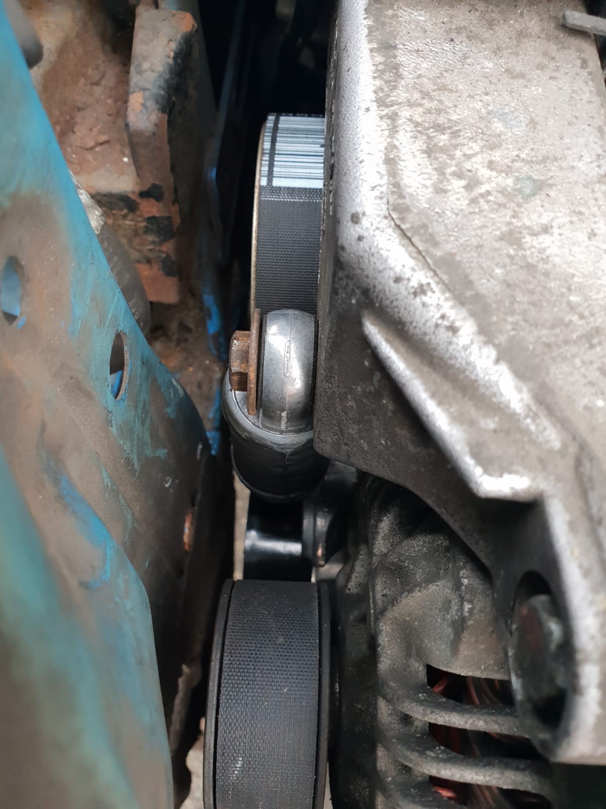

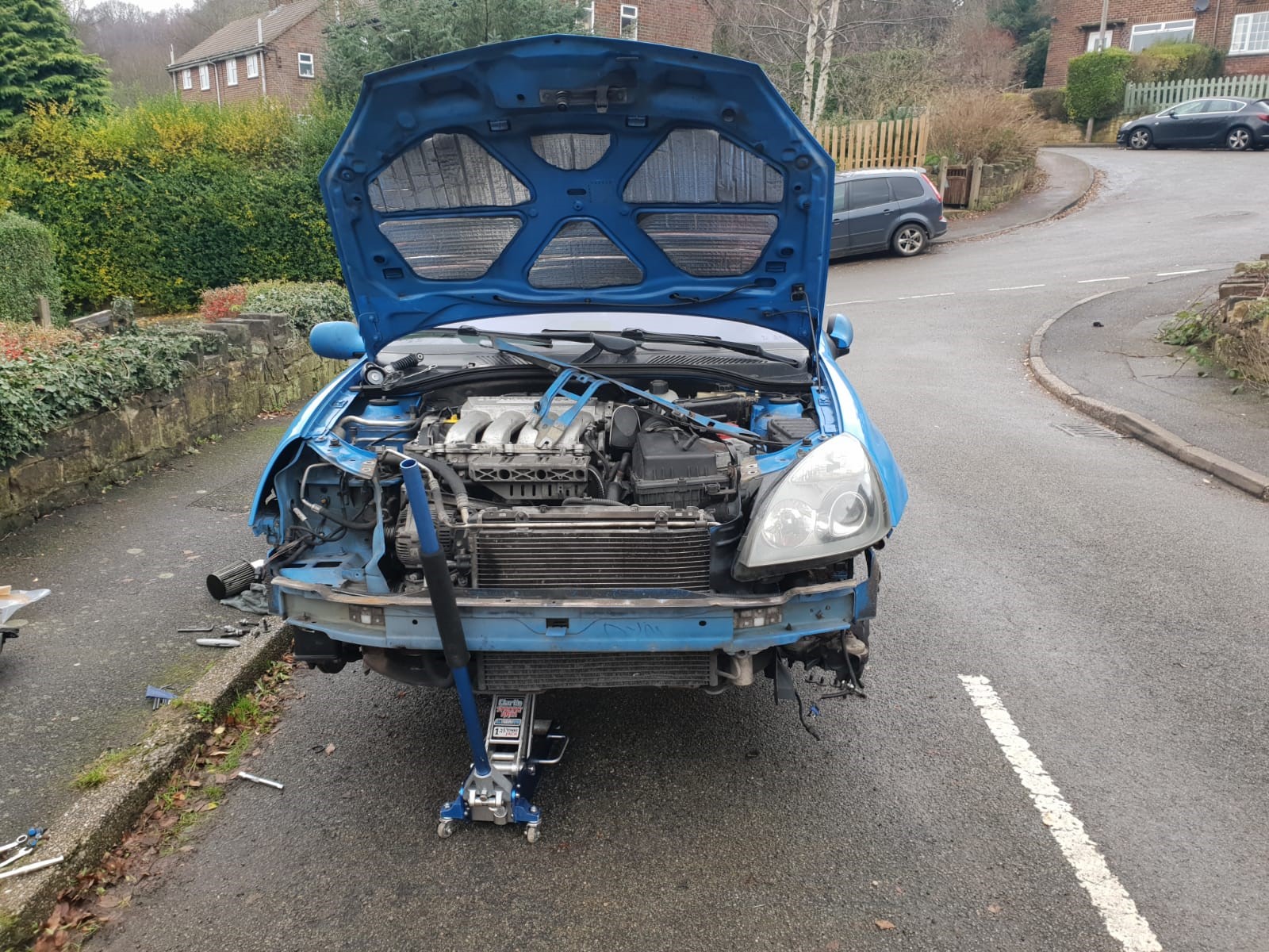

189600 miles on her meant the aux belt was actually overdue by 3.5k miles. So set about sorting that yesterday.
I cannot, nay I will not, repeat some of the expletives uttered throughout the task, I don't remember it being such a pig to do 5 ish years ago when I last turned my hand to replacing it (was done inbetween with Cambelt etc but not by me)
Either way, just gaining enough space to remove the old auto tensioner involved basically removing the whole front of the car and half the engine, lol!
then to add insult to injury, after spending 2 hours sorting it all, got it all back together and bloody belt skipped a rib on the PAS pulley, so had to undo half of it all again to get enough access to realign it!

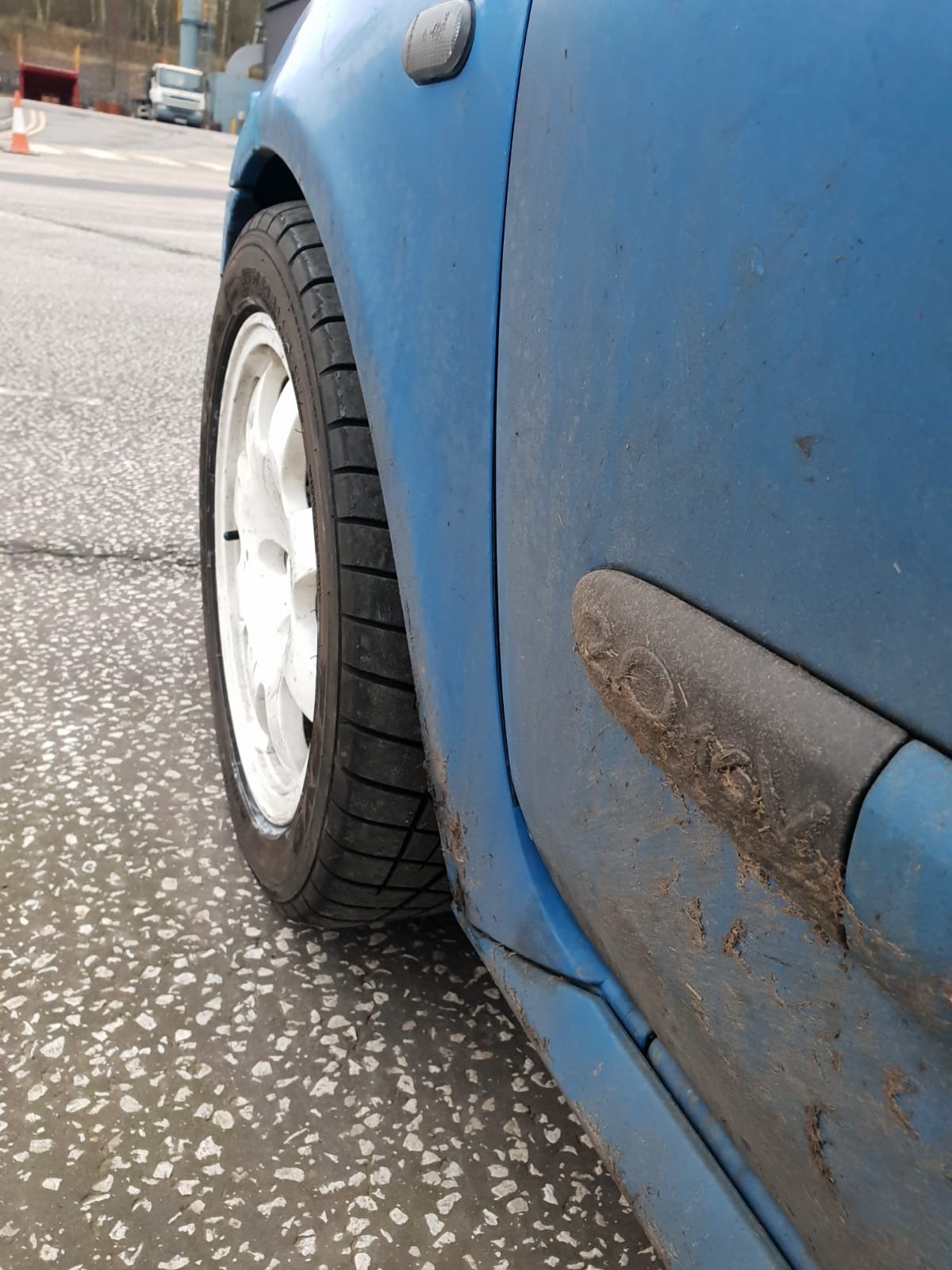

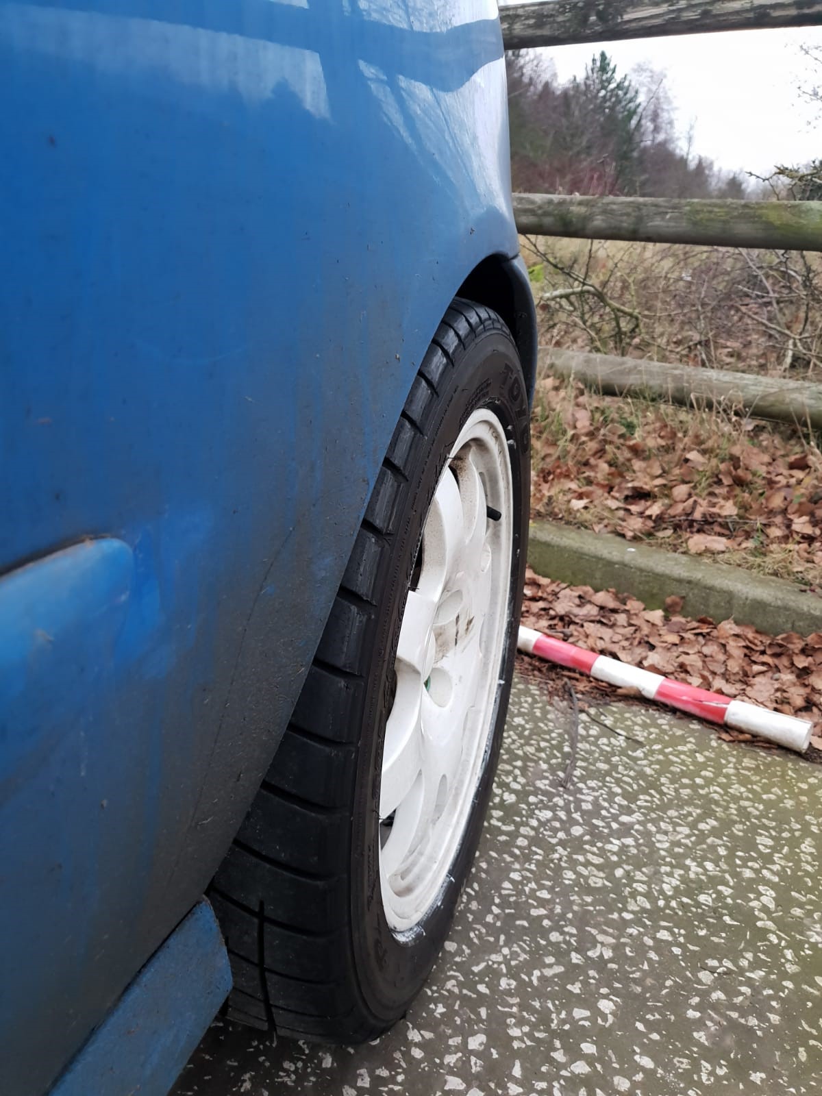

Anyway, all sorted, changed to white Williams wheels, which it with 205 section Toyo R1R's it transpires are too wide with my spacers so now scrubbing the arches over every bump...and she's filthy! lol!
Happy new year all! Soon be 200k vintage.......keep them wagons rolling
Pics

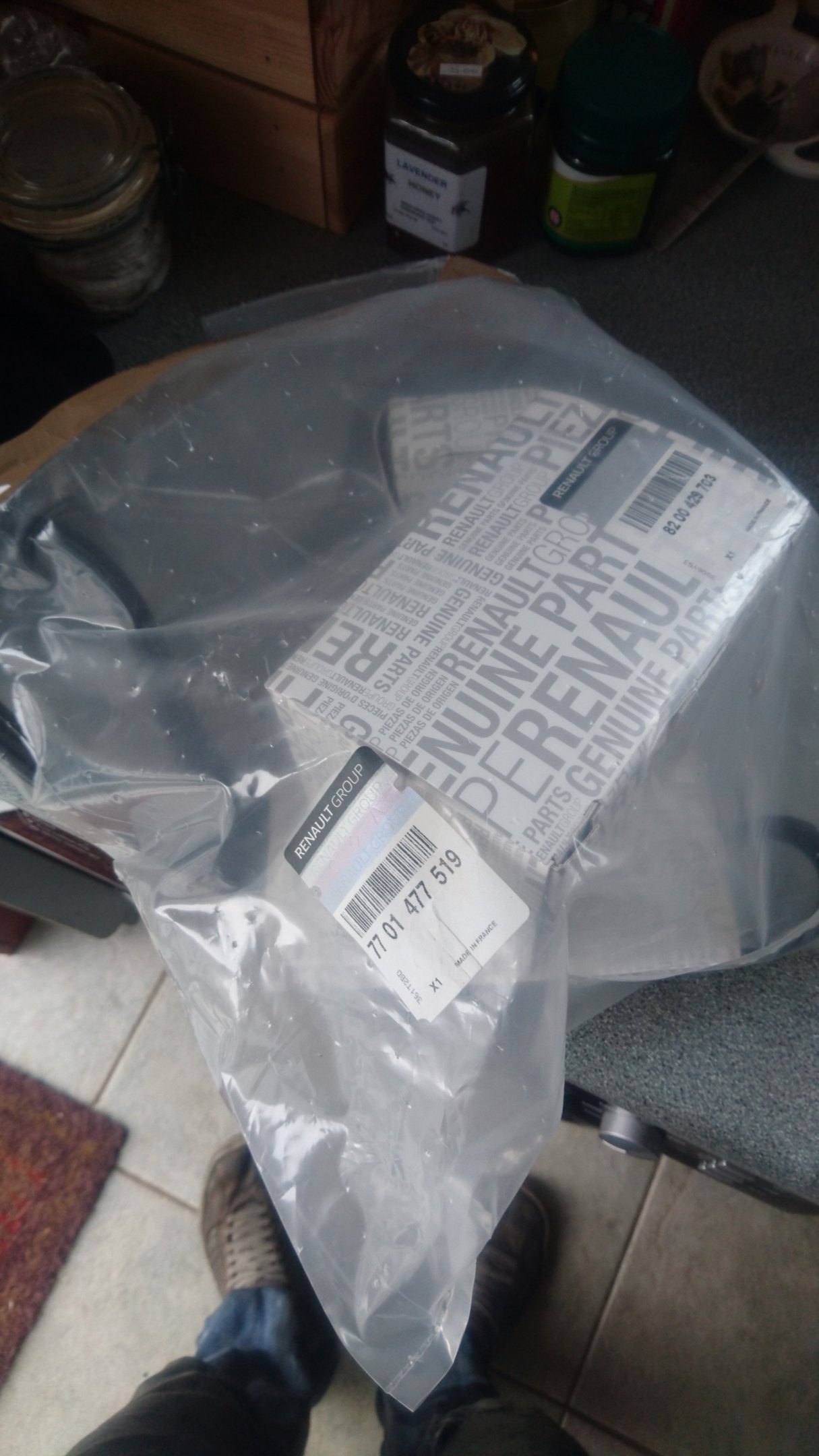

belt kit to fit, upto £85 quid now compared to the £65 I think it was I paid 5 years ago:
The auto tensioner nestled in there, loose but impossible to navigate out....
So all this comes off for the first time...
So got the old out and new in:
Then it jumped the rib on the PAS pulley so I had to remove it all again:
And sorted and on the Williams wheels, showing how much they stick out, thusly causing rubbing, to be addressed:
Front:
Rear:

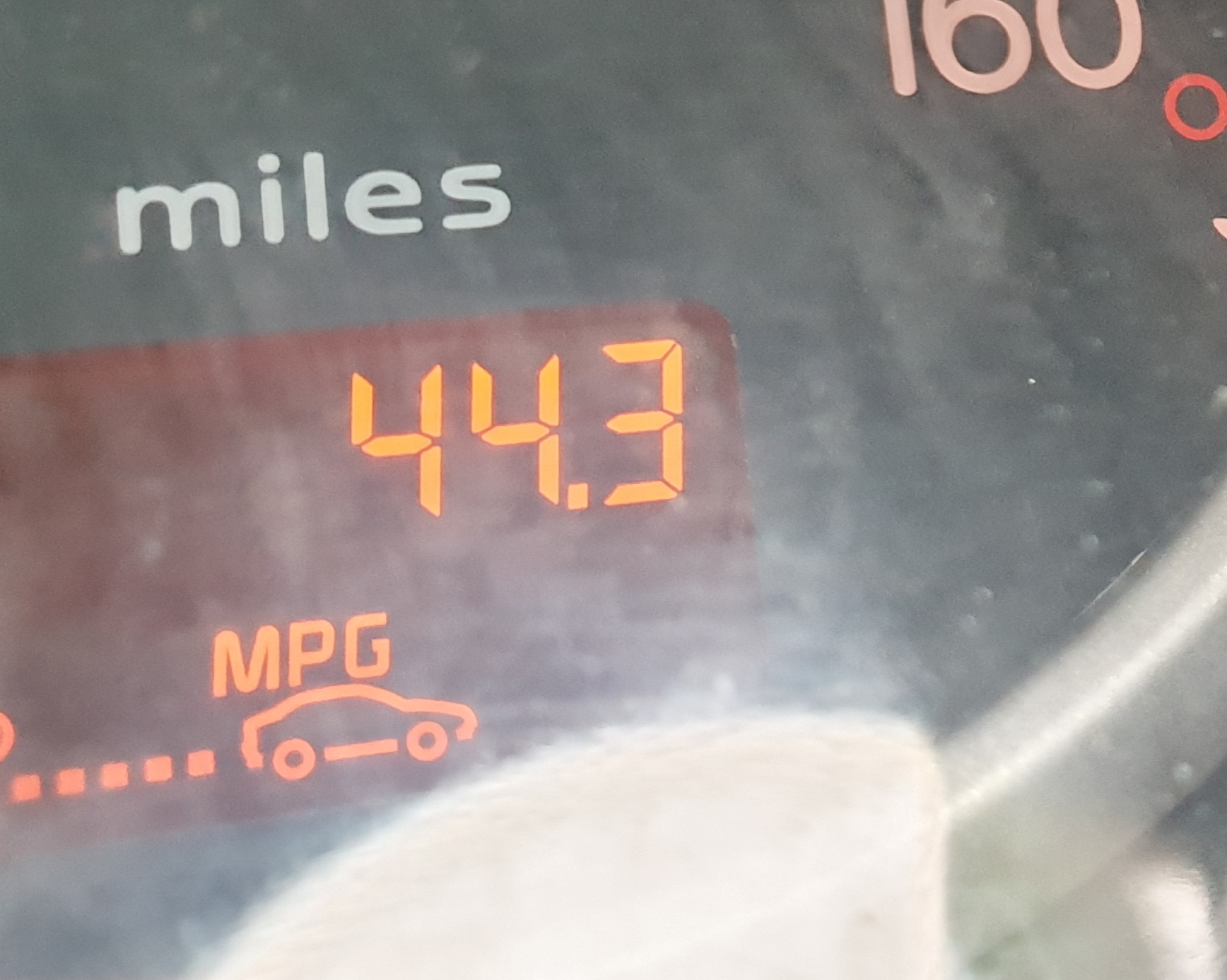

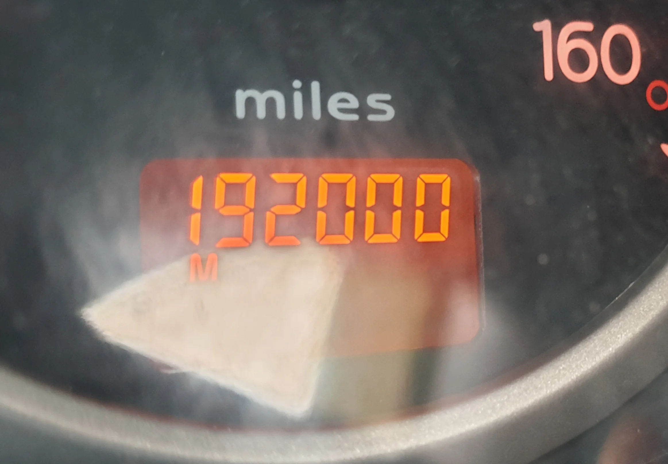

Nothing new to report at the mo, still cranking the daily duties. Just down in Welwyn Garden City for work and clocked 192 mark and still returned 44mpg on the trip computer (real world calculated is about 6 lower ish)
