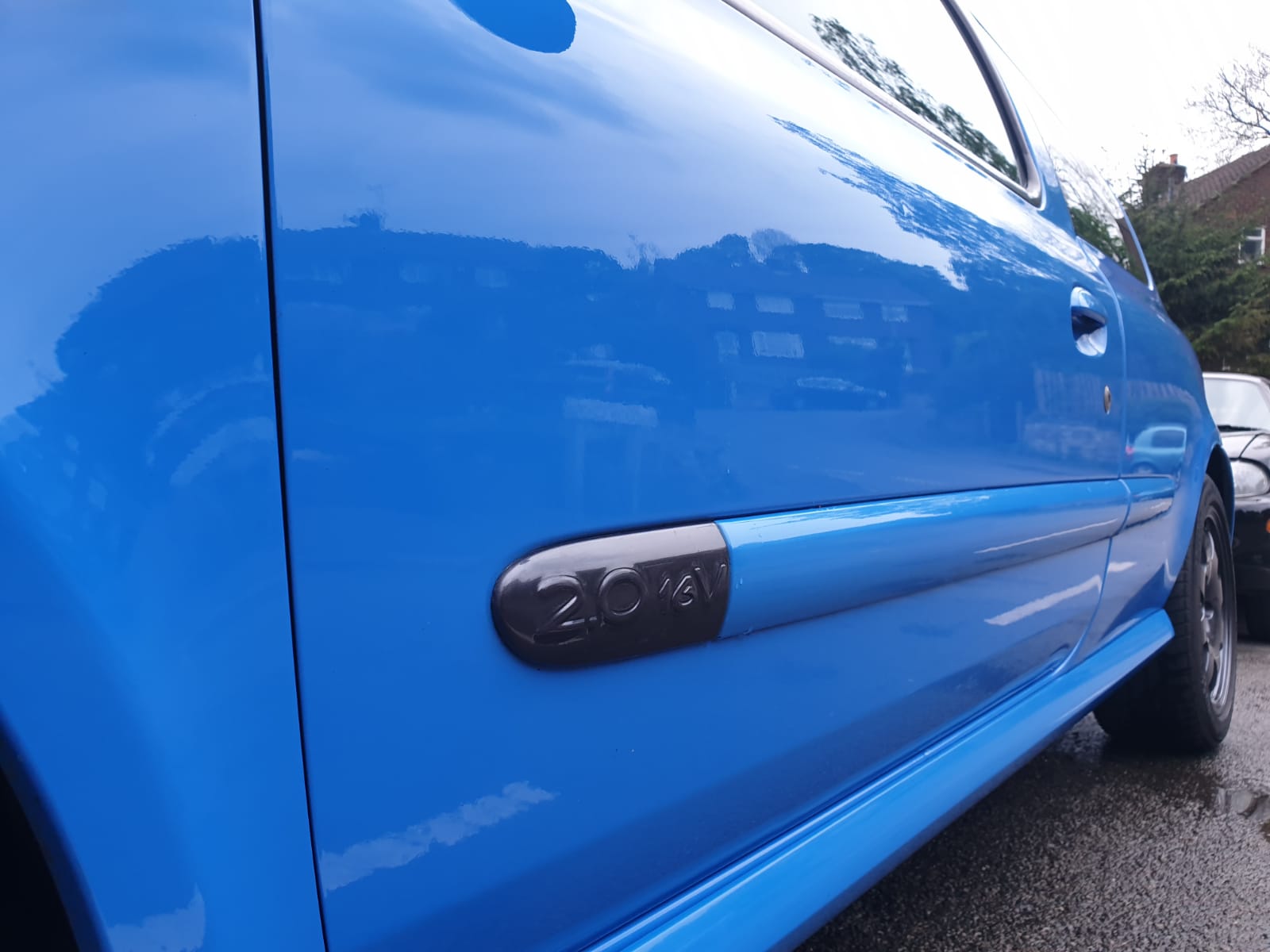

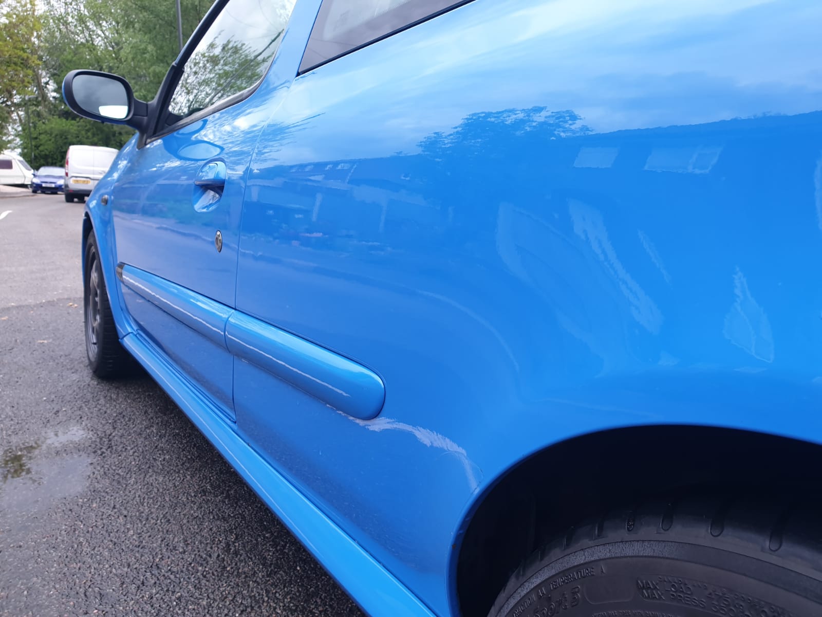

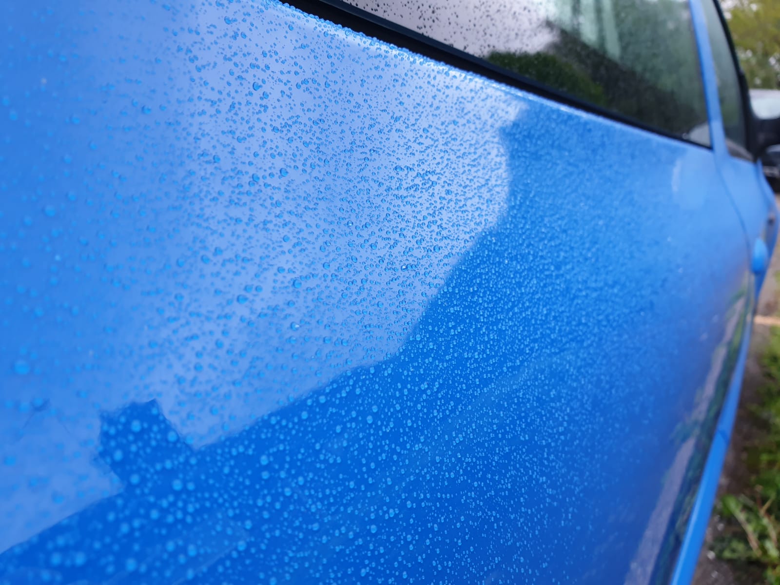

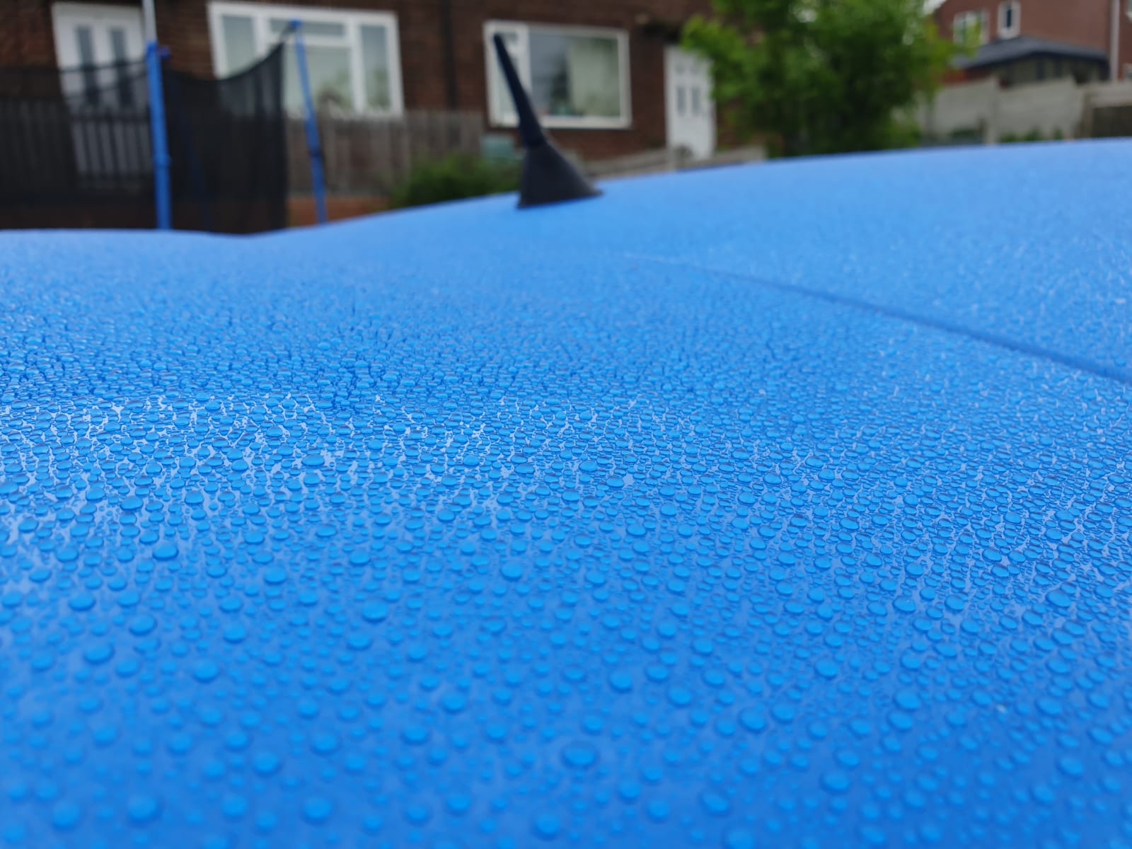

First wash since Cadwell last year and she's come up decent enough. Used all Autoglym products. Wash, de-tar,claybar, wash again, chamois then super resin polish, should keep her okay for a while.
Still love RB so much, seven years using her daily now nearly and not bored yet!

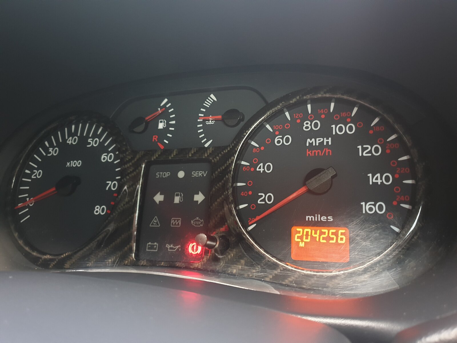

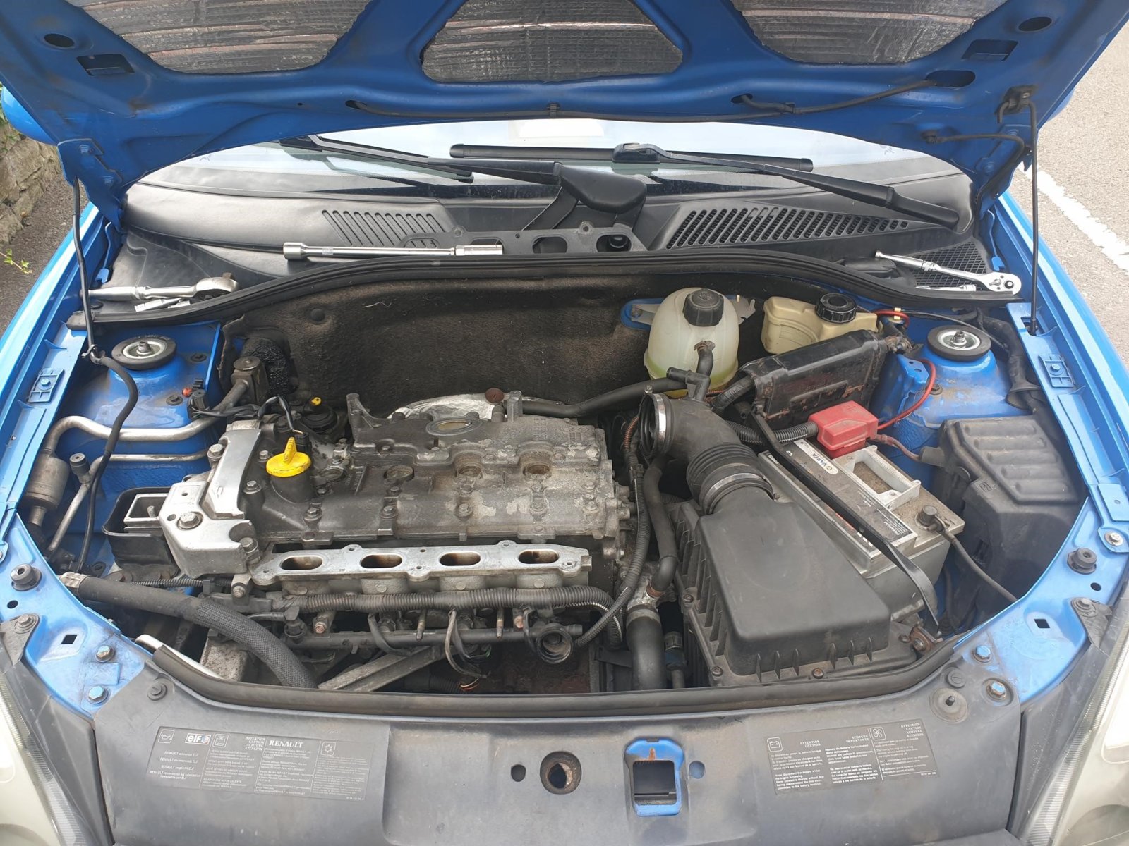

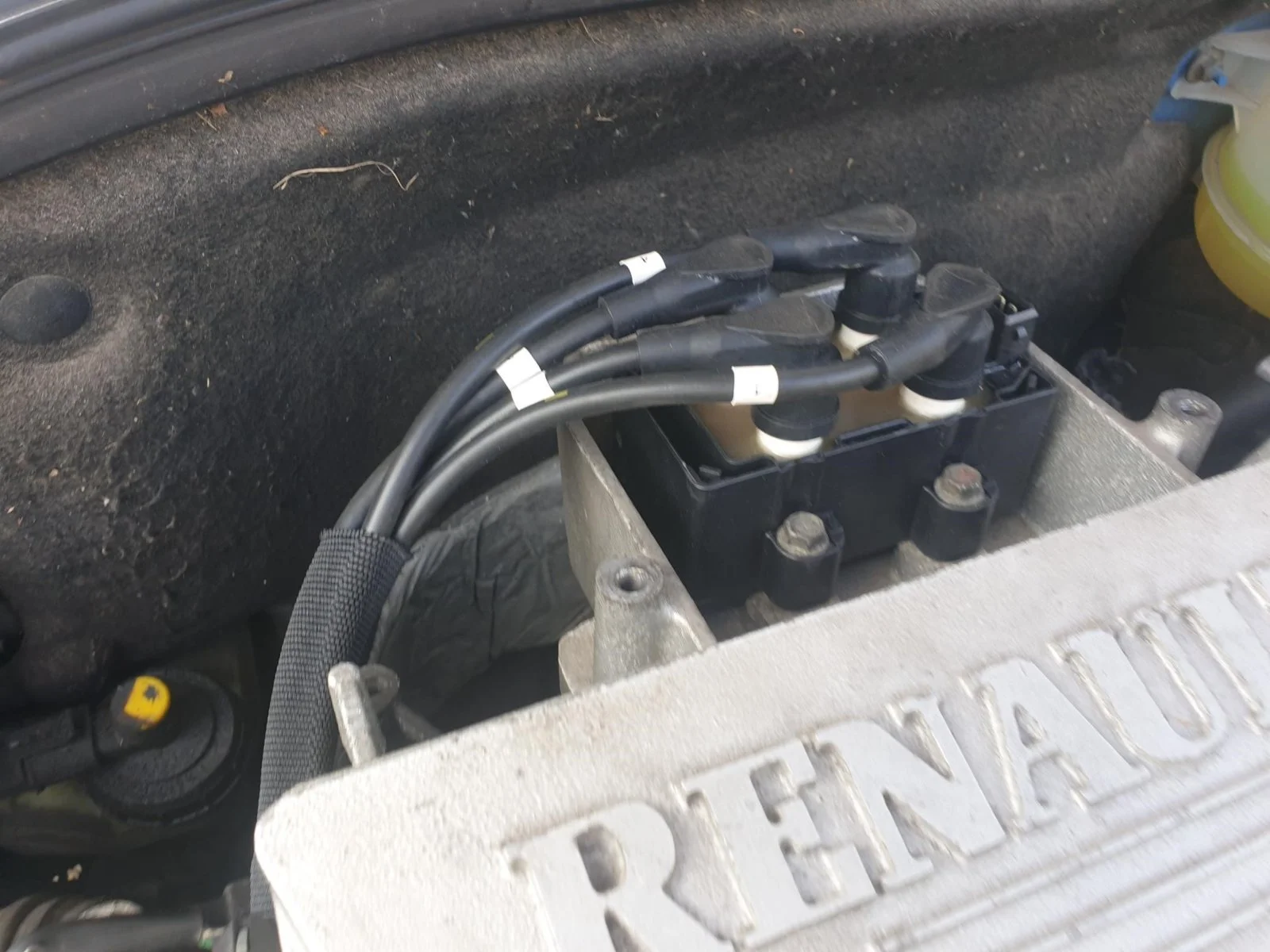

The march to 200k is in its final stages now, treated her to her 199k service a few days back so she got:
- Oil and Filter
- New spark plugs
- New HT leads
- New Coil pack
- New wiper blades

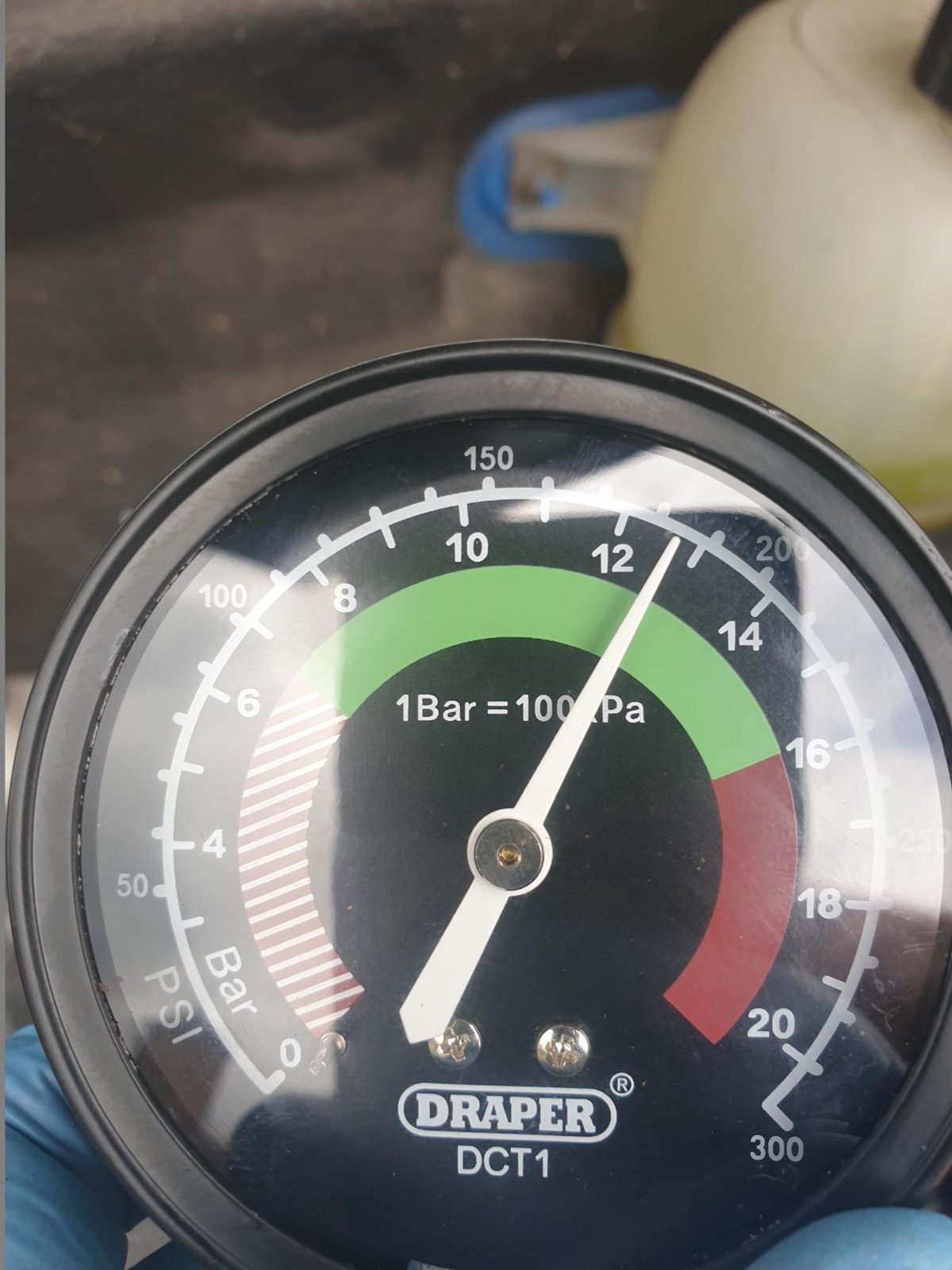

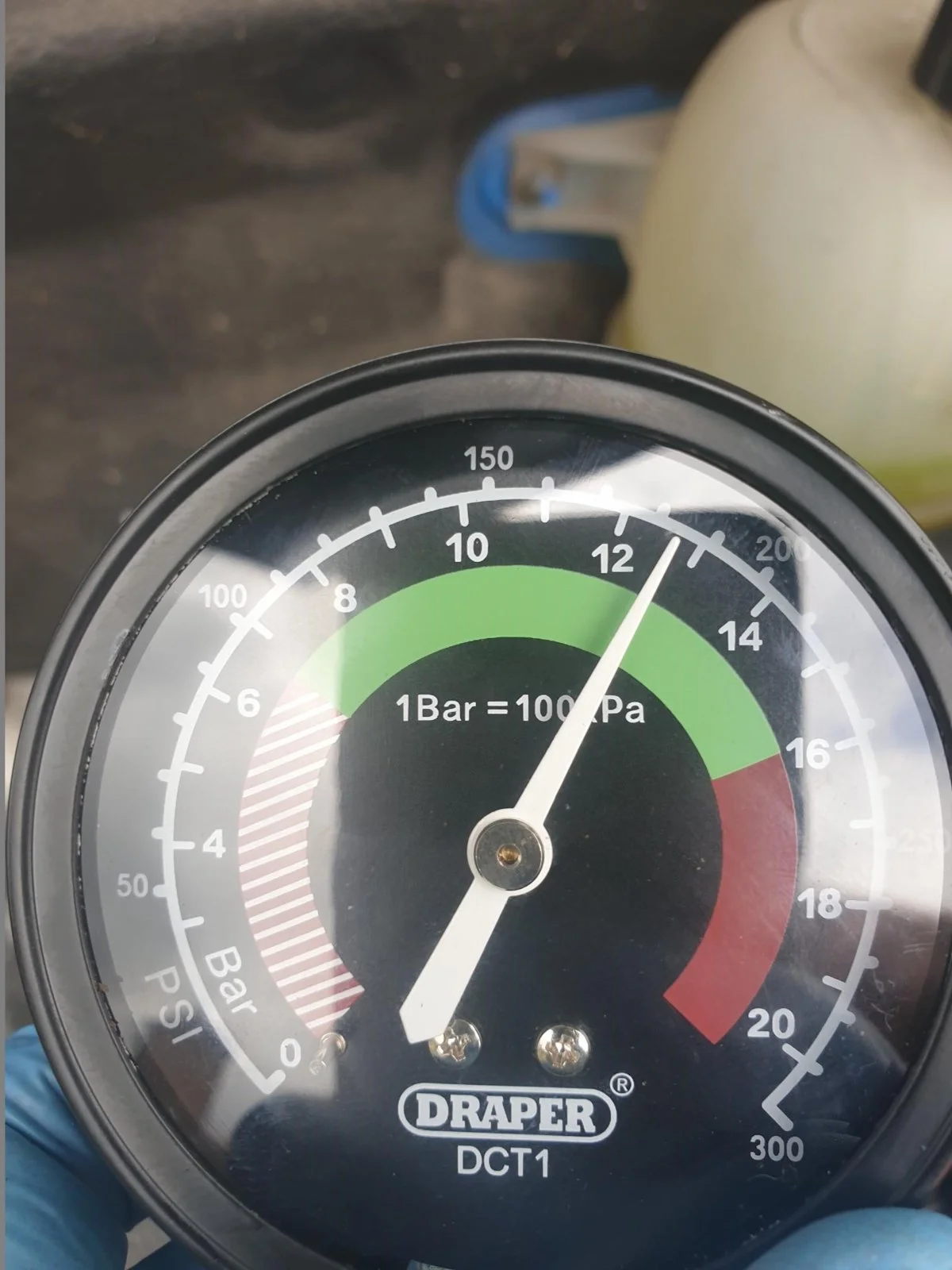

Also comp tested the engine for a giggle, not perfect and done when warm which some say isn't right way to do it and other say is the only way....either way she's okay, no major worries. Result:
Cylinder 1 (flywheel end) - 178psi, Cylinder 2 - 183psi, Cylinder 3 - 170psi, Cylinder 4 - 181psi
And also now booked Donington for evening session on Wednesday for my birthday. Car is on 199685 miles as of today and I have Birmingham for work tomorrow.....with any luck the click over 200k will happen heading down into Craners on Wednesday evening.....how perfect would that be!
Klumpy Dumpy
Not all gingers stink of piss. But I do.
The compression results are bang on the money though tbh!
I never understand people that comp test when stone cold... When the oil gets hot, the engine is up to temp and the viscosity drops that's when the engine is operating most. Oil doesn't stay cold for long ?

Lapped up Donington on Wednesday night, the r888's felt much much better than the newer R version I used at Cadwell last year.

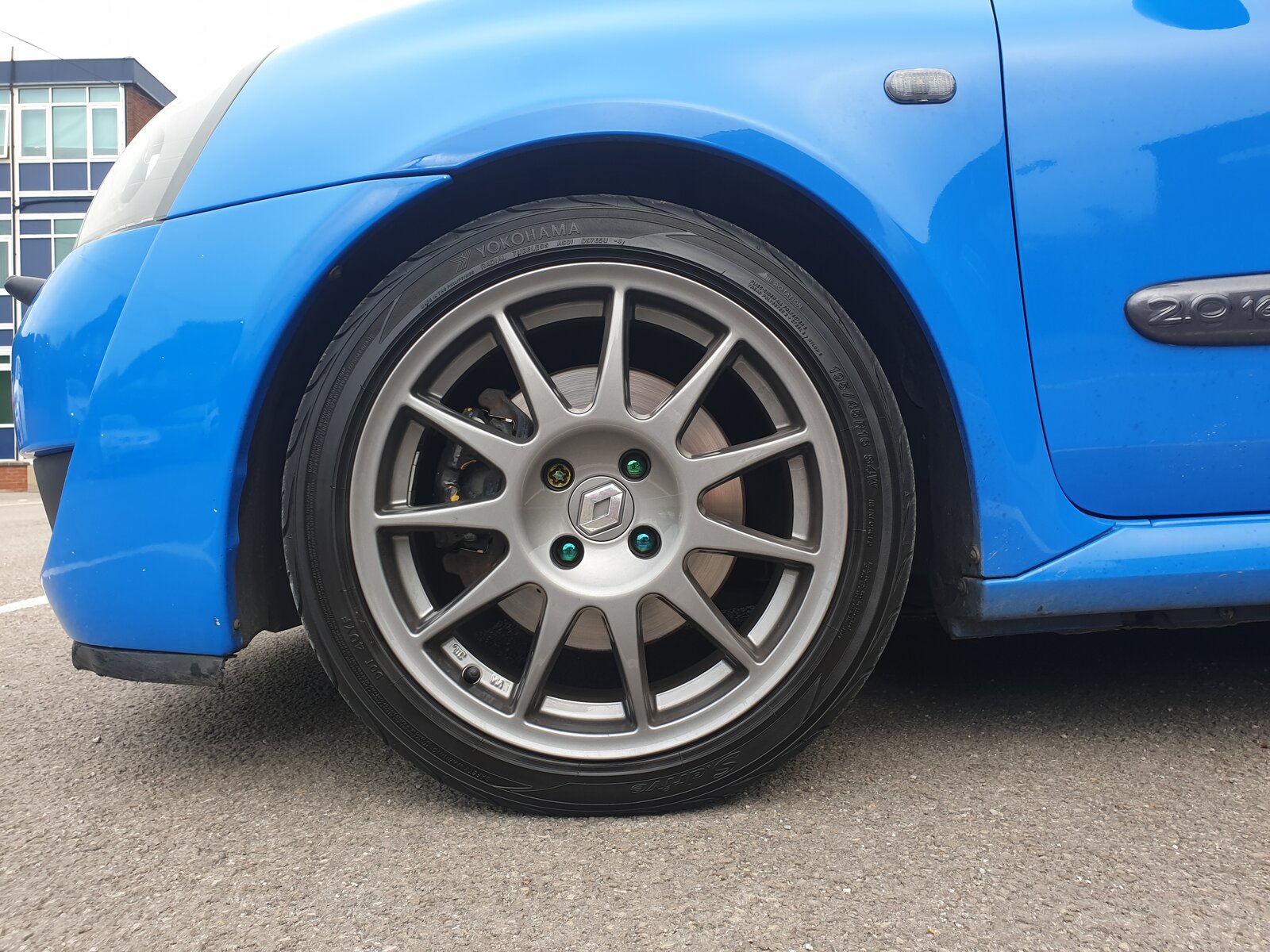

Then finally got tyres fitted to the Turini's and popped them on to cross the line at 200k!

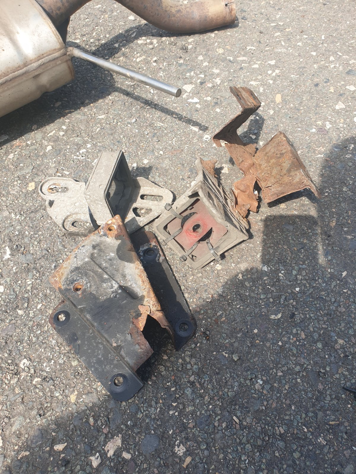

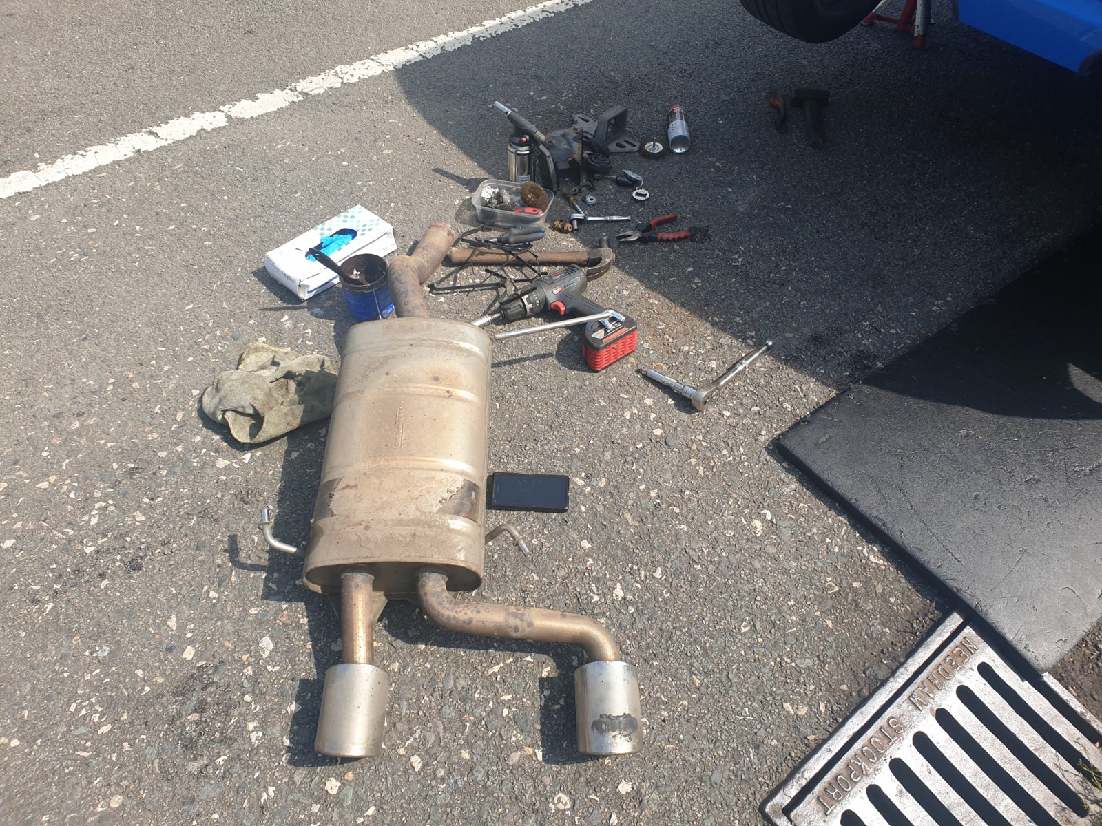

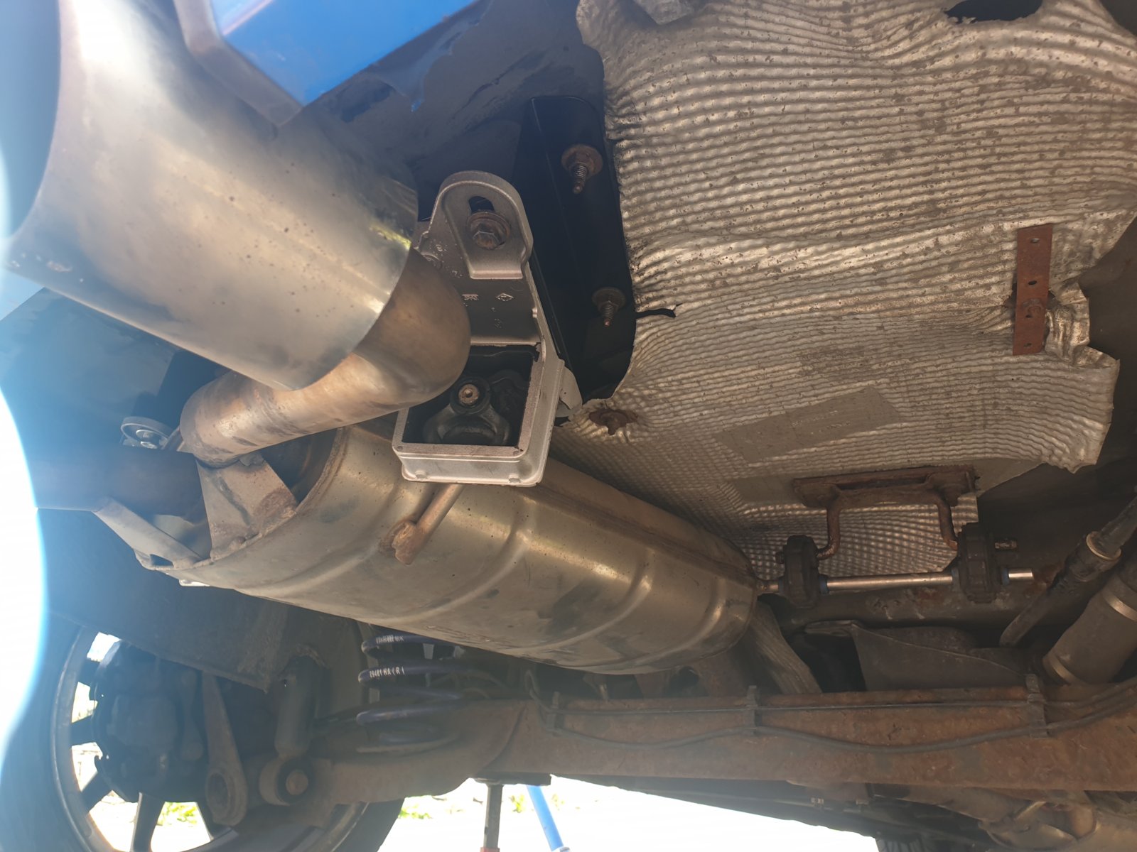

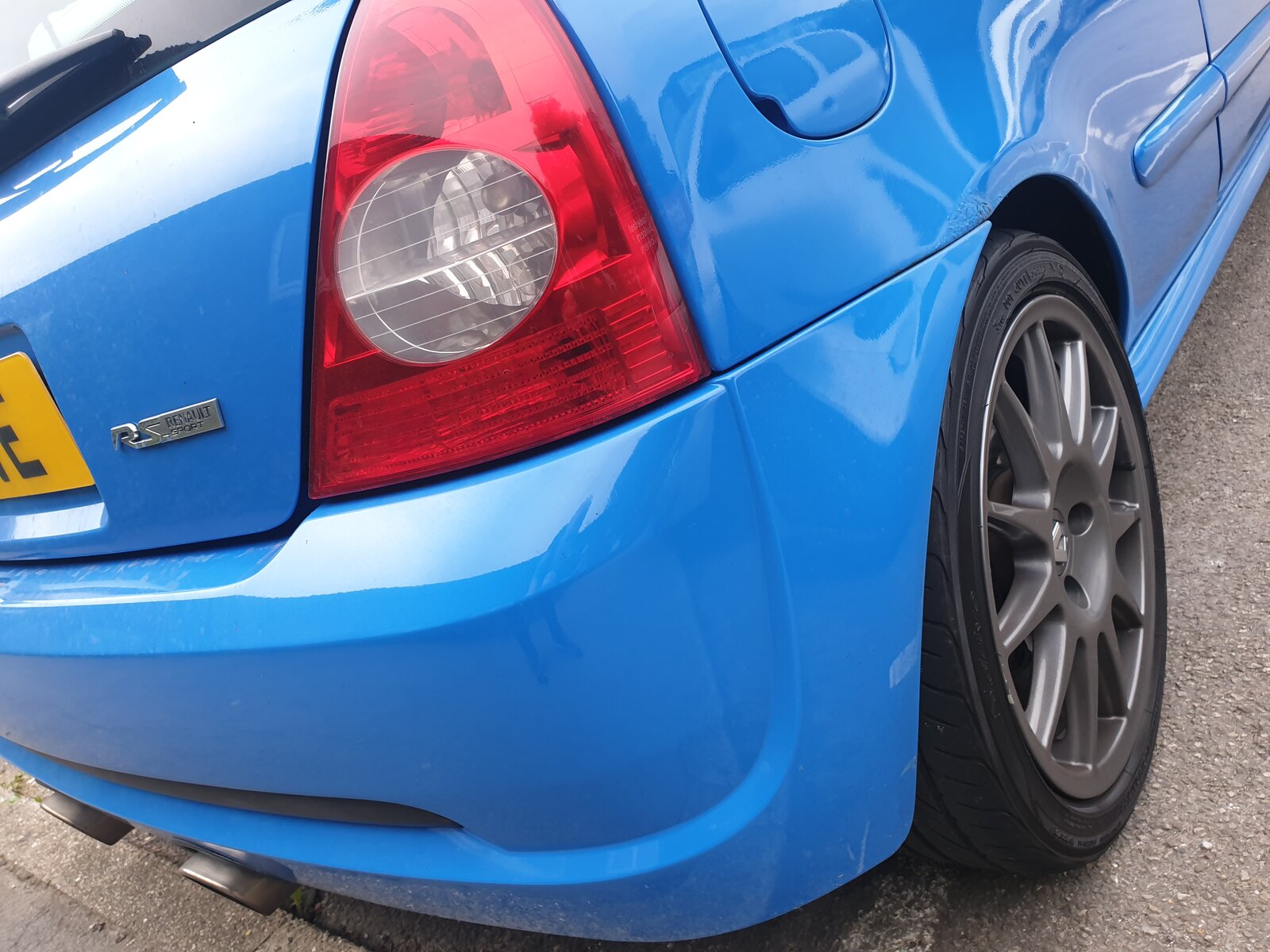

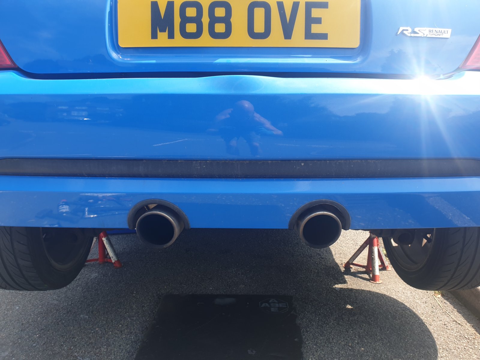

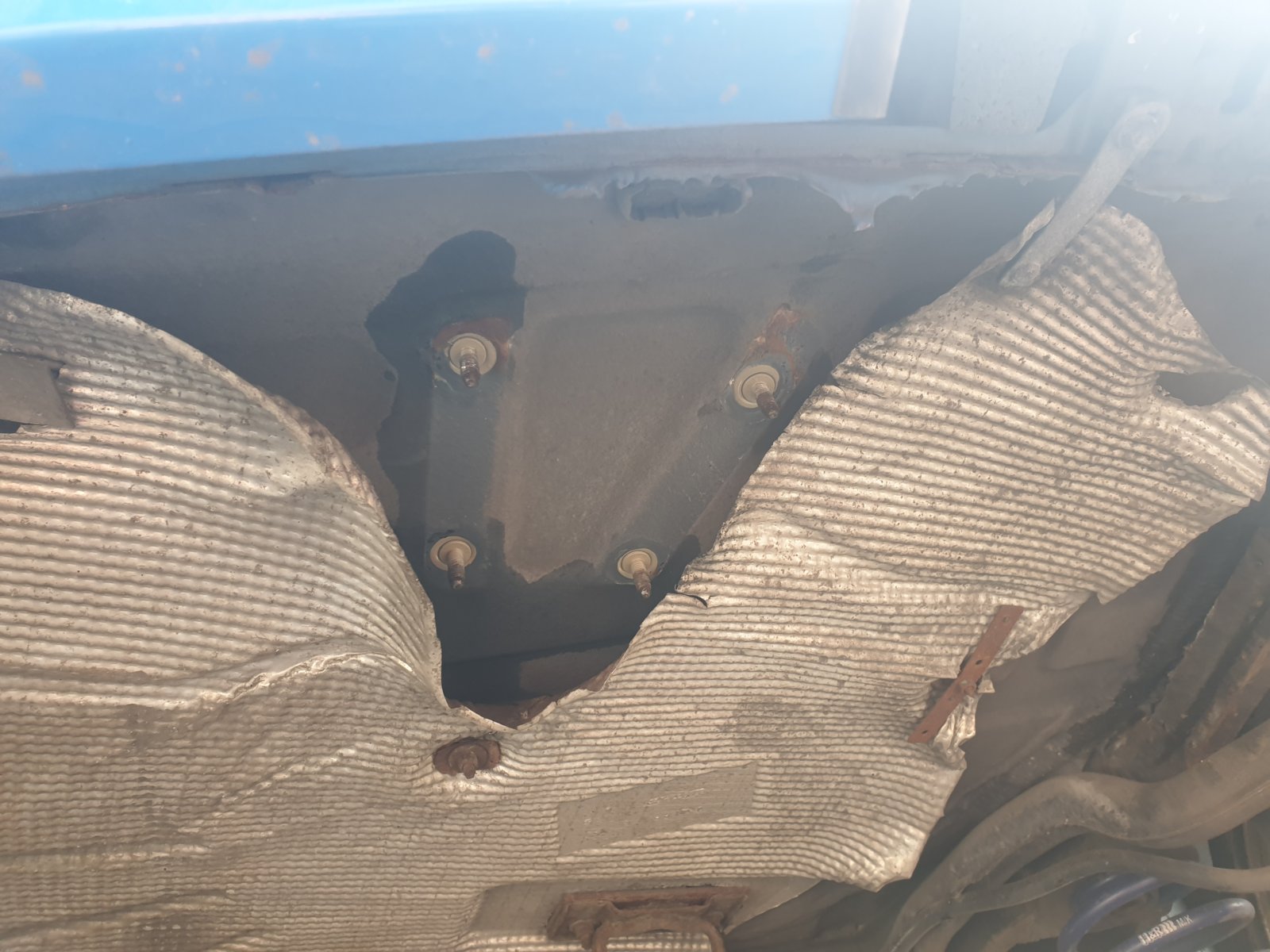

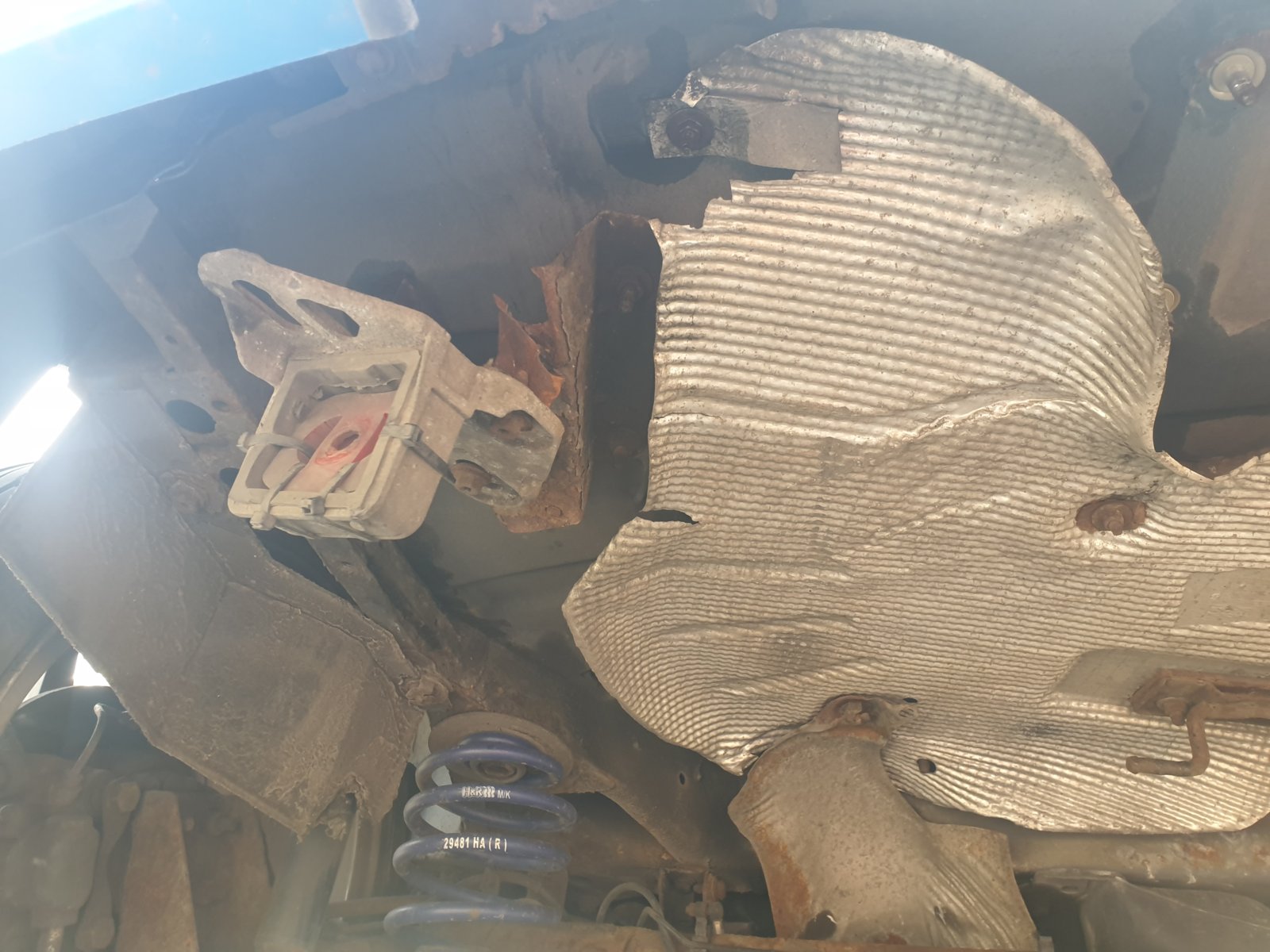

Finally repaired the absolutely knackered rear exhaust hangers today. New pattern part metal plates and genuine rubbers from Renault (see how many minutes they last)
The repair panels are off chap on the Facebook groups and although not cheap can't recommend them enough. Perfect fit, beautifully made and painted. Simply bolt on and go!
Thankfully no broken studs on boot floor either so dodged that bullet, cleaned everything up and copper slipped the lot.
Should last few more years now

Up she goes
Stuff every where
Old and busted
Bye bye
Studs all okay
New hotness
New genuine mounts
And sitting pretty

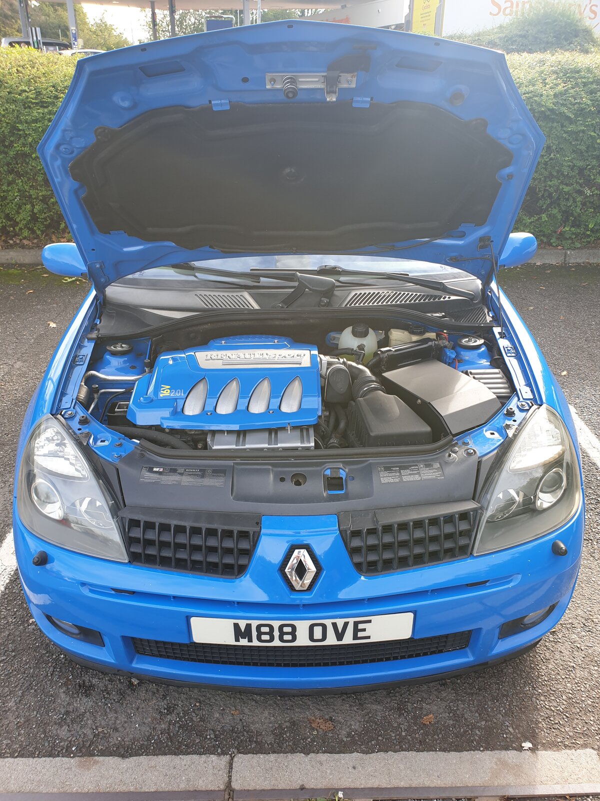

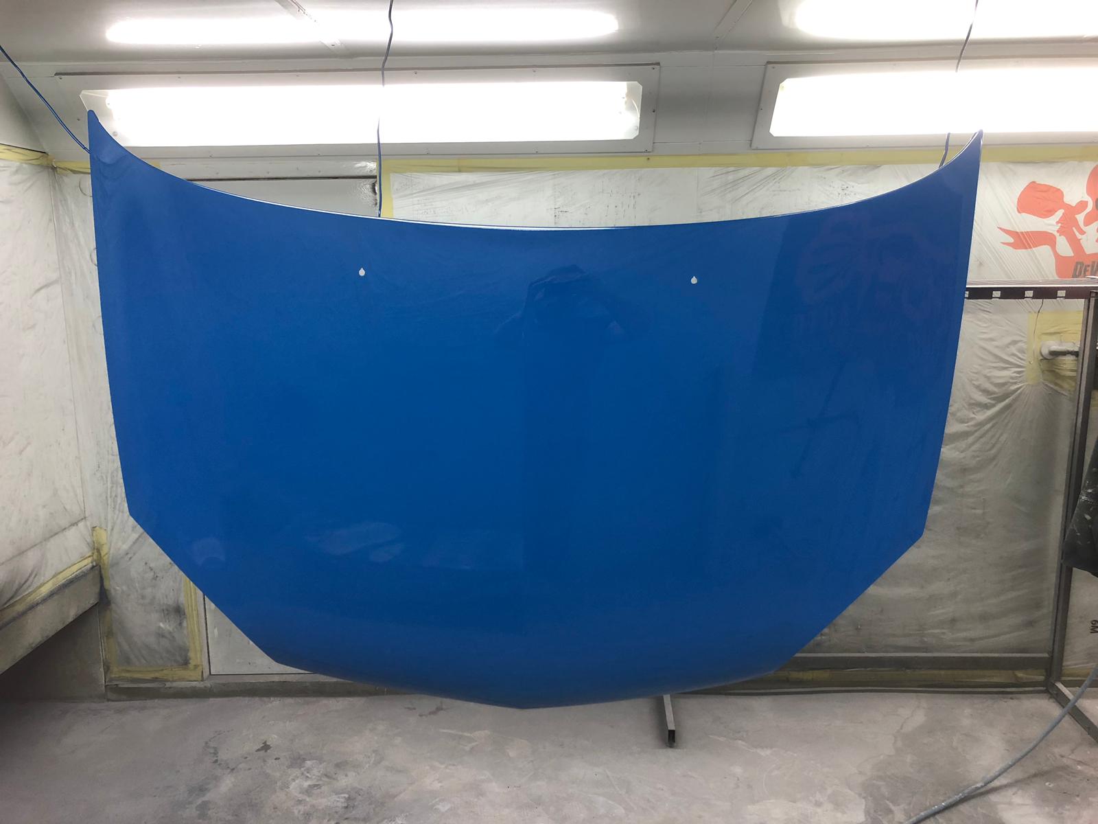

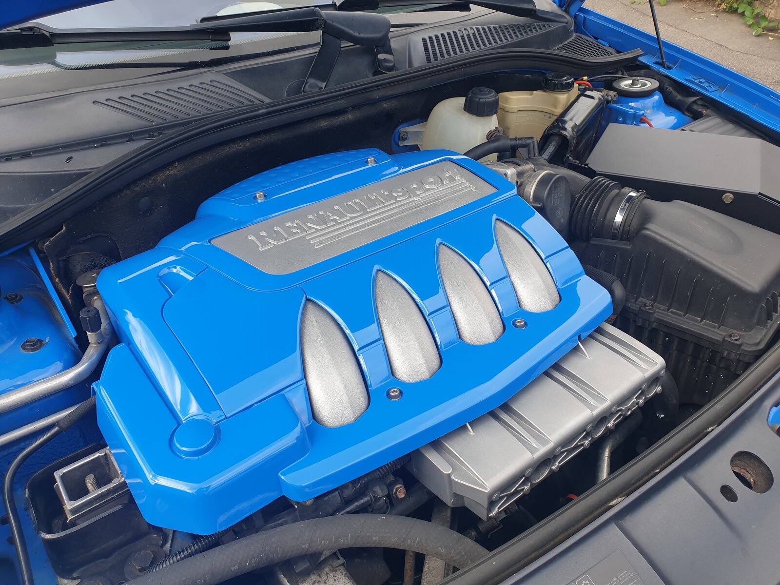

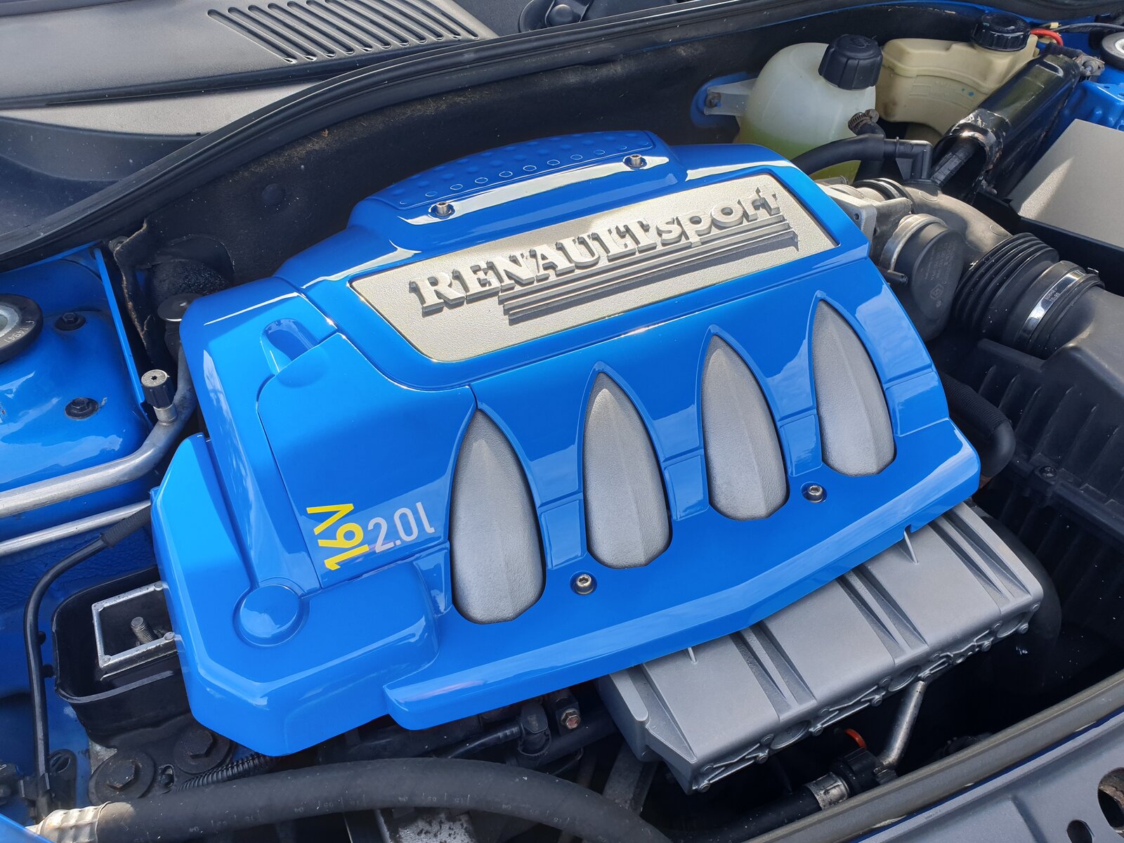

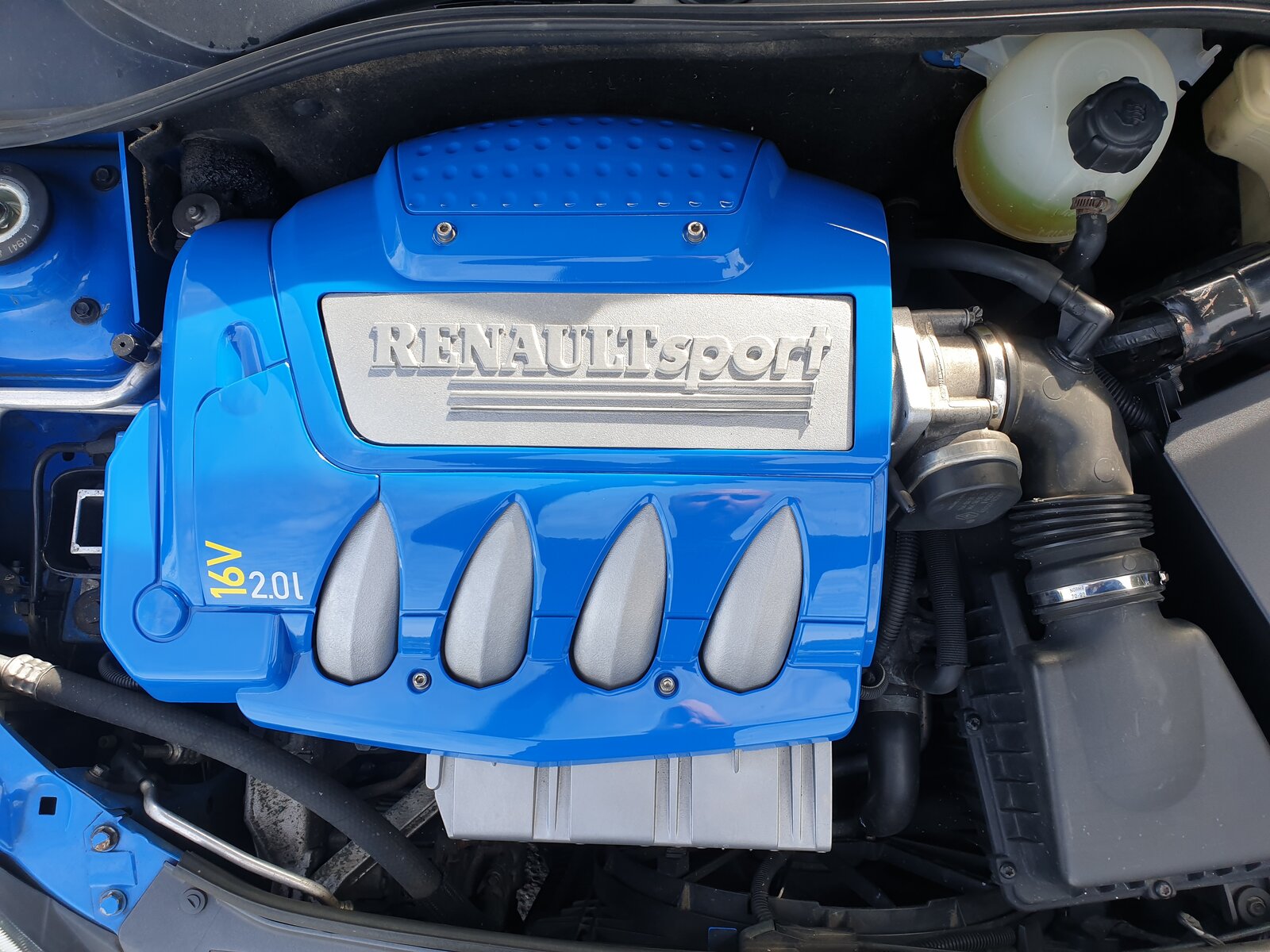

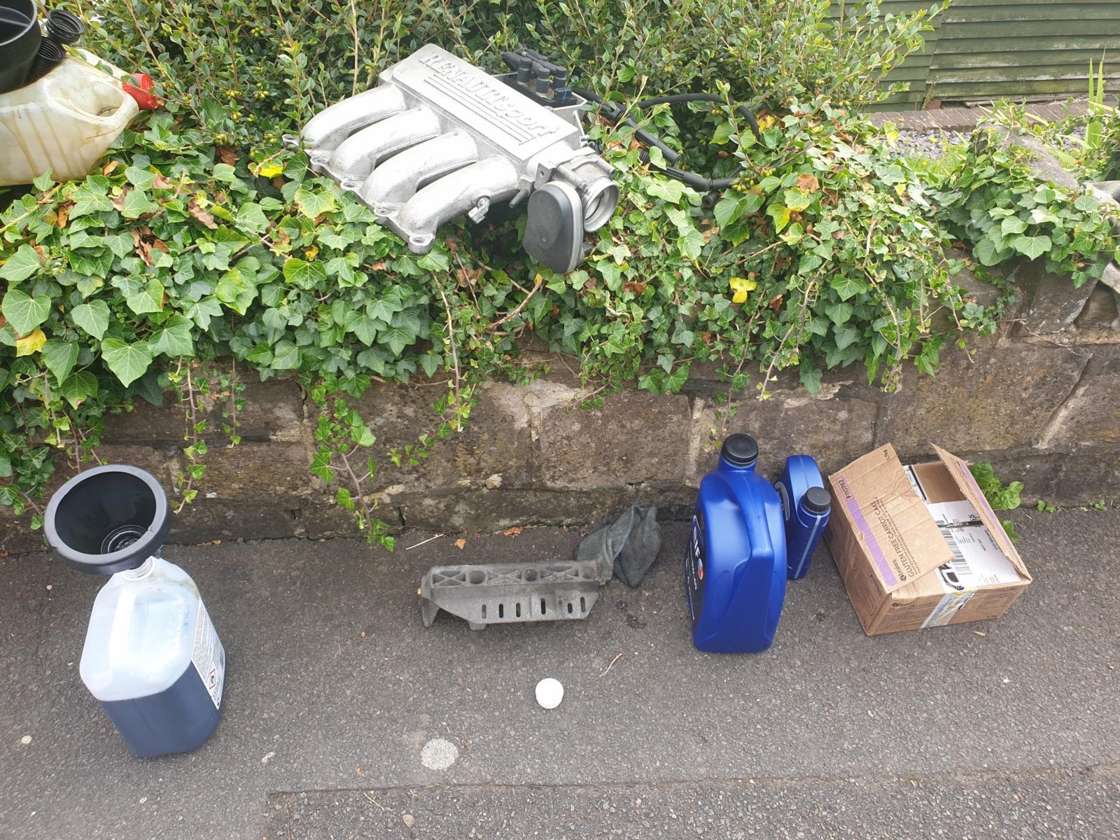

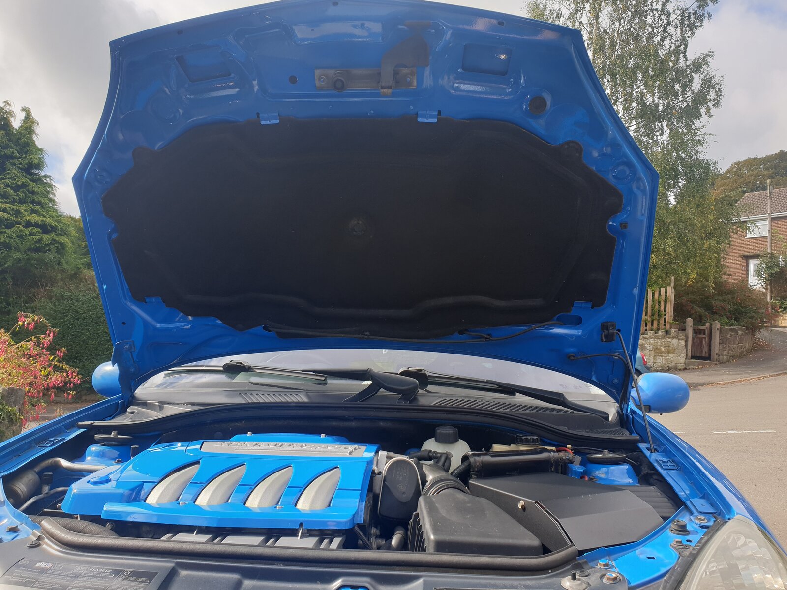

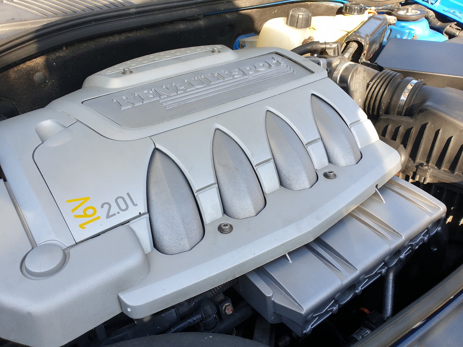

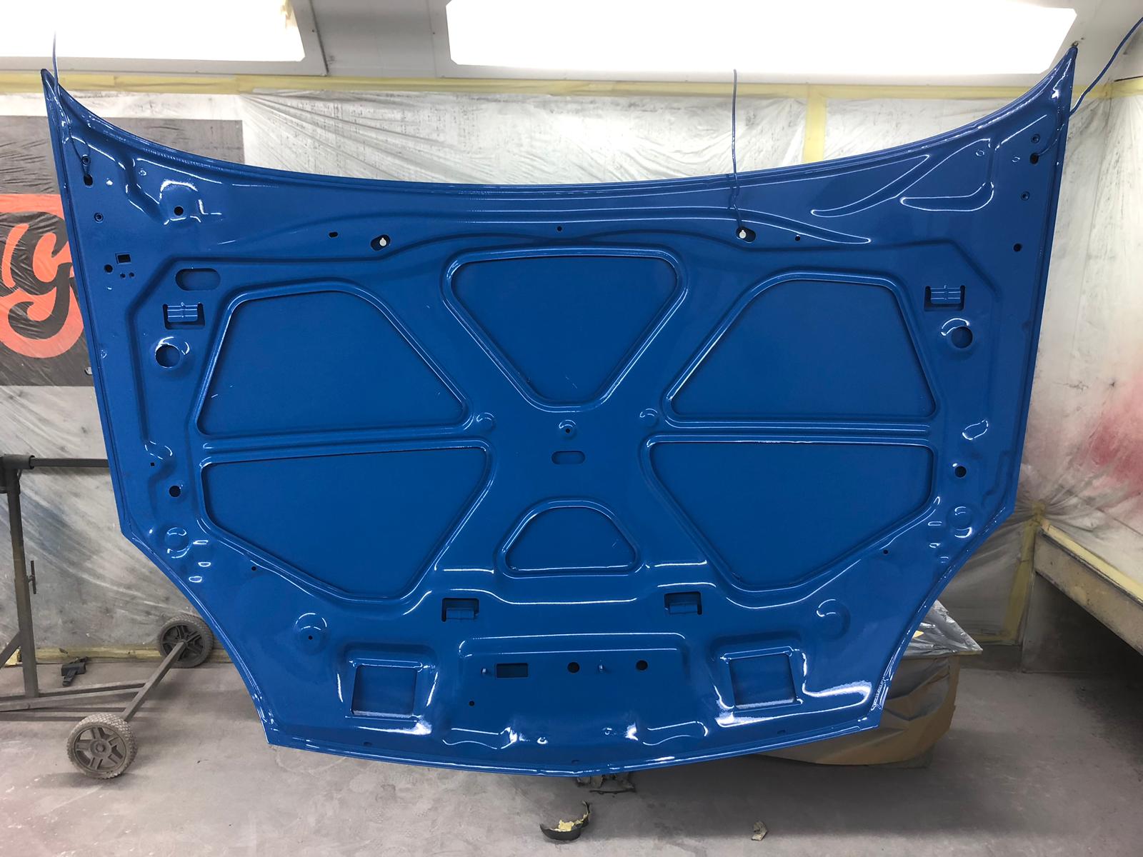

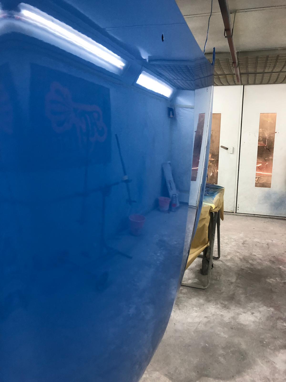

Oh and also fitted vapour blasted top inlet and fuel guard and Austen at bodyshop has worked his magic on my genuine new old stock Renault bonnet and a spare engine cover.
Also fitted battery cover too that's been in shed for few months.

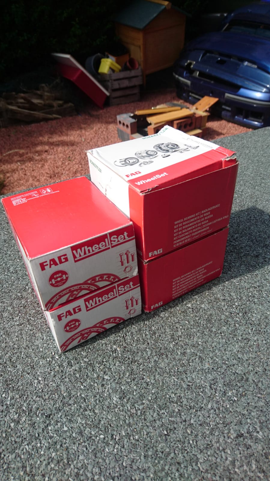

And finally popped too see Mr Mick at diamond and collect some wheel bearings for this and one of my mk1 projects.
So actually pretty busy with stuff on the car afterall, not quite winter shutdown yet! Lol!

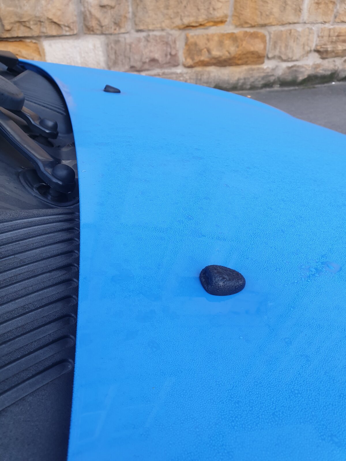

Fitted some genuine citroen mist washer jets when I put the new bonnet on too.
Anyone know how to angle them up neatly? They work okay but ideally need more of the spray pattern aimed above the wipers.
There's no adjustment in the angle of the nozzle as far as I can tell

Had the citroen jets on my 182, no adjustment from what I could see

The pattern is fine, and they're not cheap ones they're genuine Citroën ones. It's the angle that's slightly out.

I’ve got fiat washer jets on mine and they cover the screen perfectly.
Fiat part number is 9681415788.
Daz...
  Inferno 182 Cup
Ha, I’ve just ebayed the part number for mine and it comes up with the Citroen Peugeot ones! Weird, I’ve got a spare in a fiat bag...
