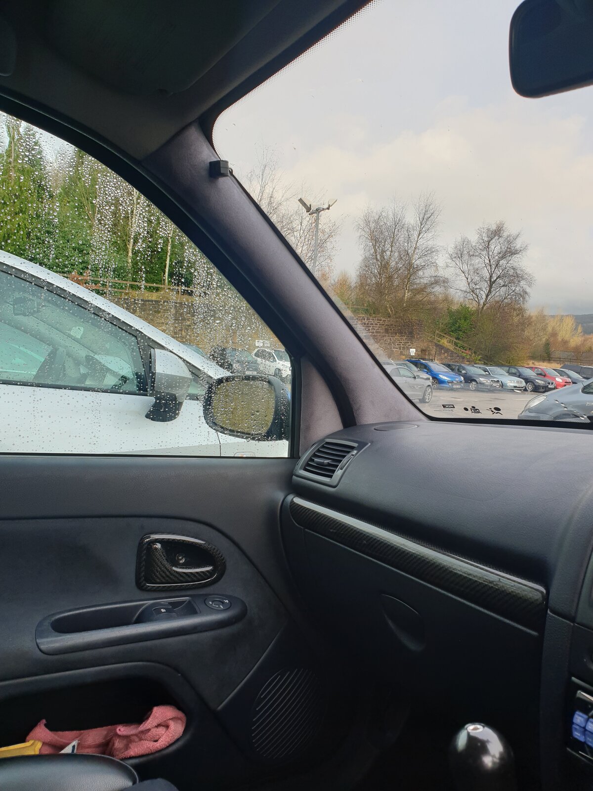

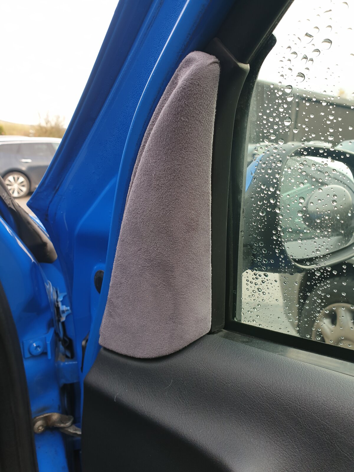

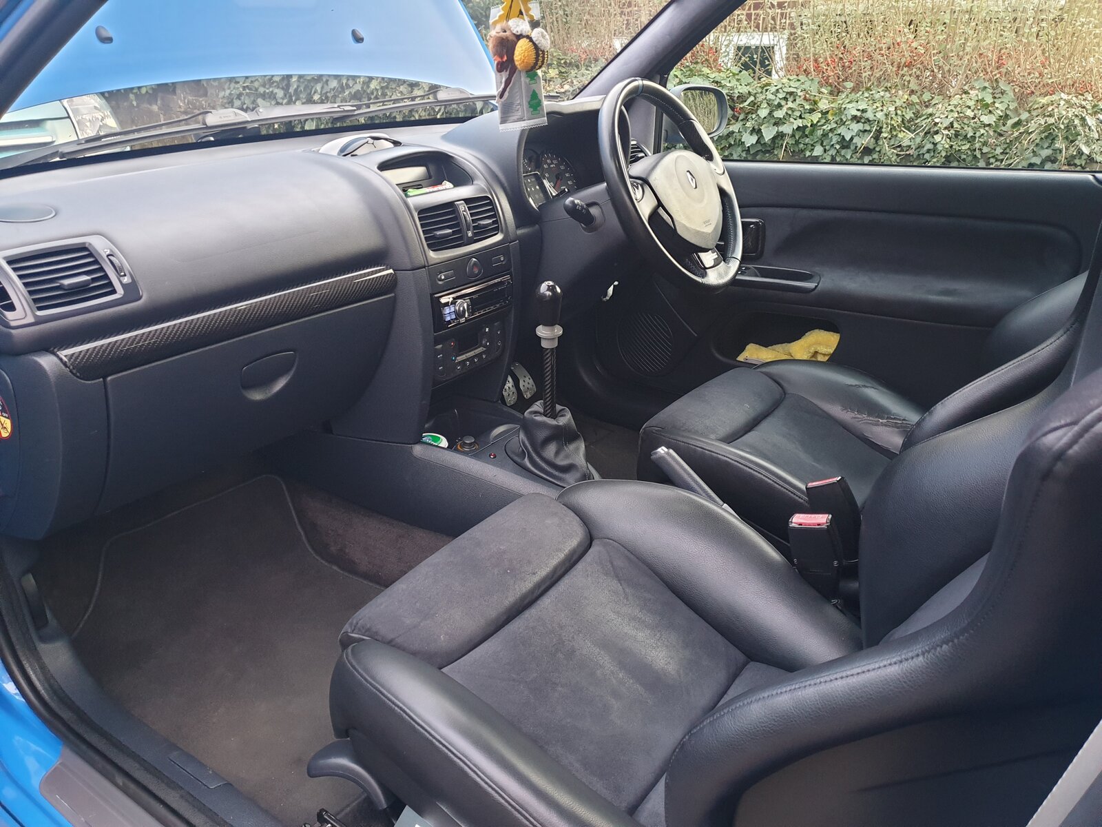

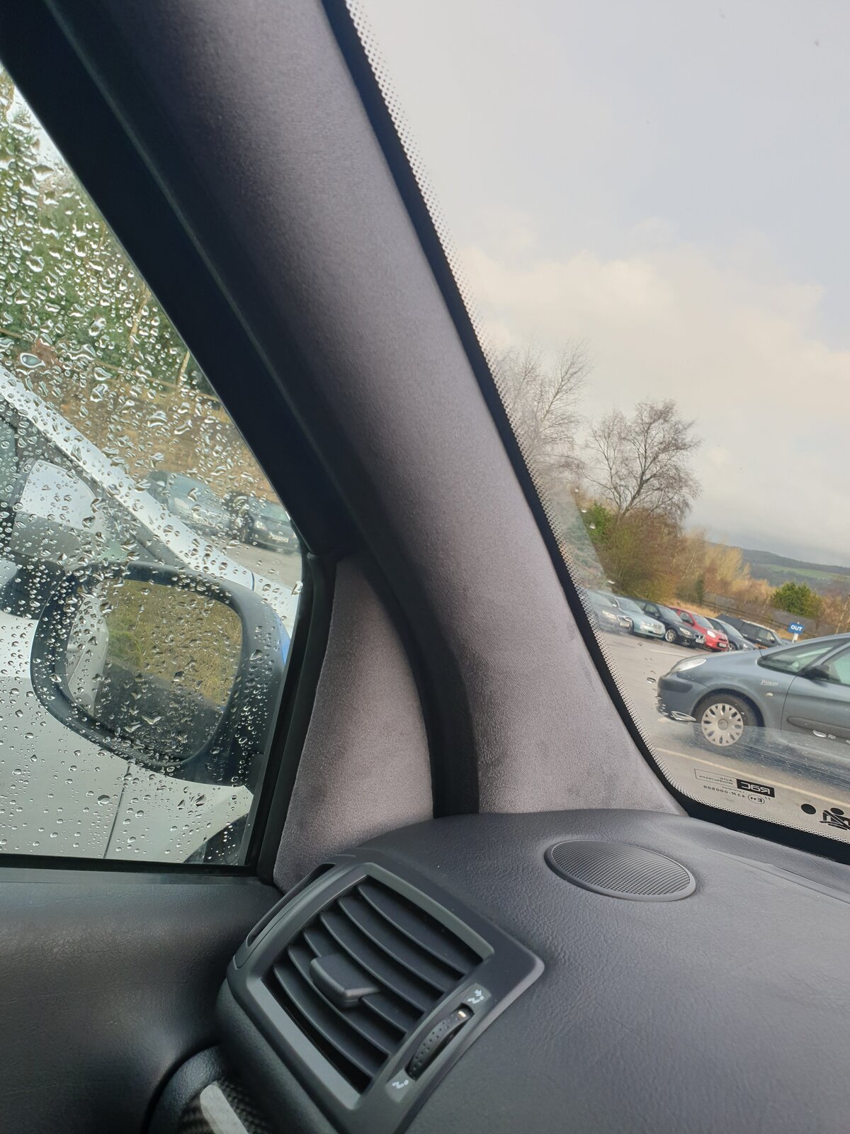

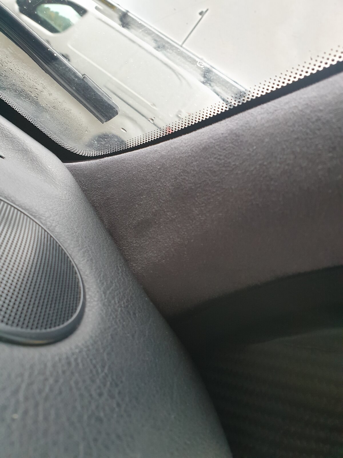

And again, fitted. There's a very slight blue tinge to the fabric that echoes the very slight blue tinge on the rest of the interior.
Loving all the carbon bits oozing out from everywhere!! Where did you order the alcantara from if you don't mind my asking? I'm after some for my daily driver on the front pillars like yours.. There's lots but I want a decent quality.

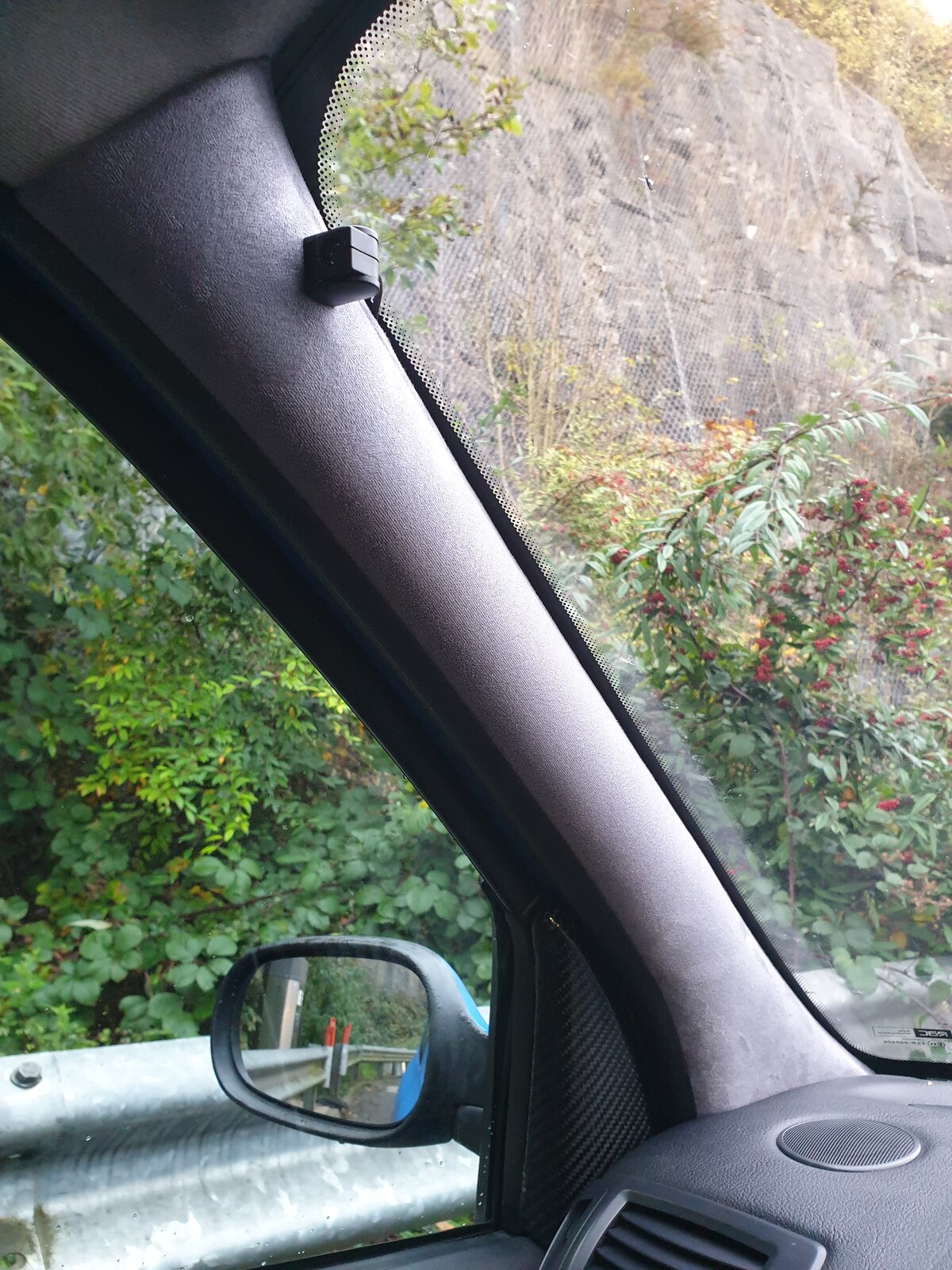

I have toyed with doing the lining at some point but not sure I can get this fabric in a roll wide enough (not actually checked) and I cba removing it. lol
Removing it is a pain and they're quite fragile, I replaced mine because the lining material was sagging off

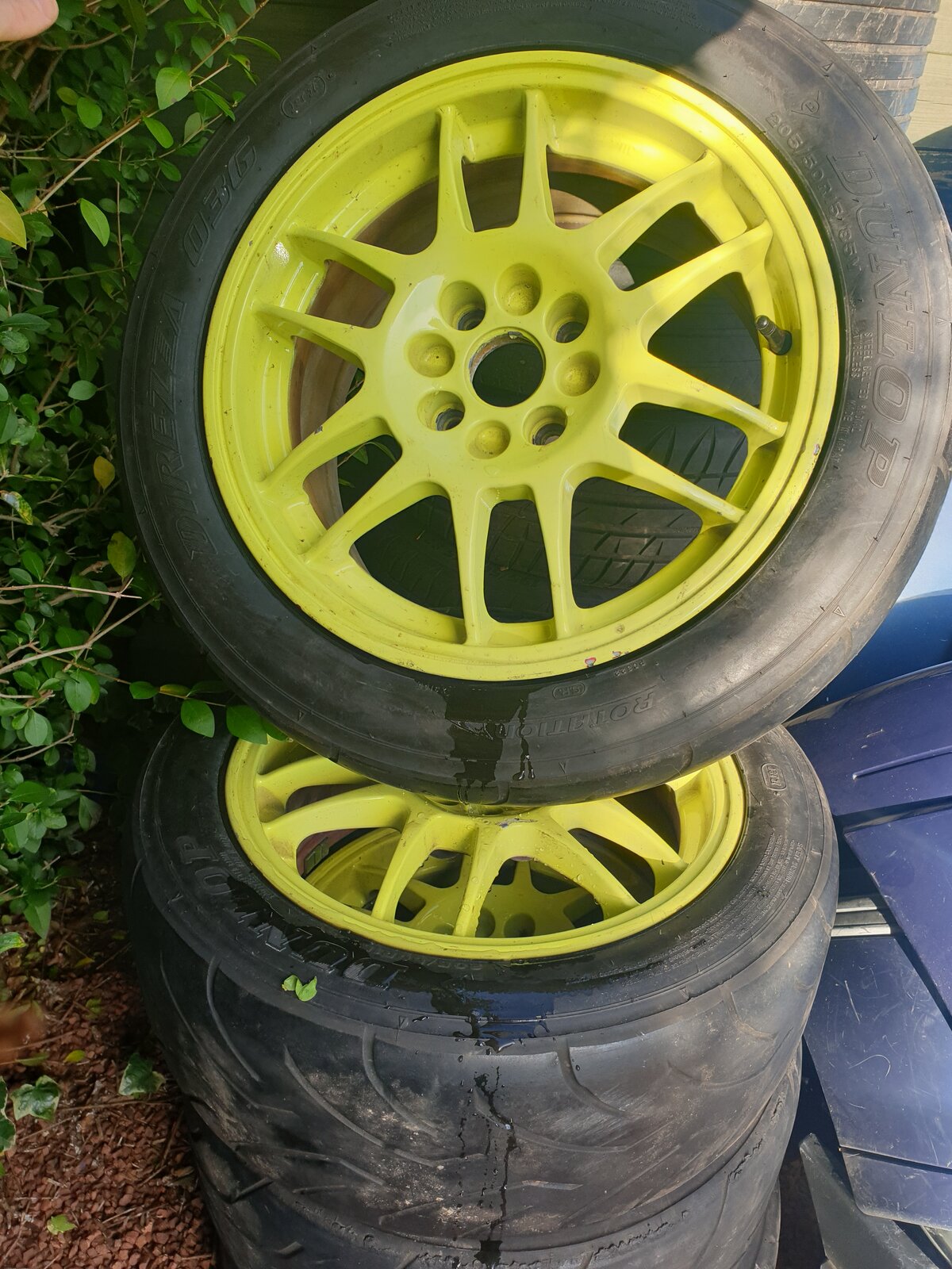

Sold the turinis provisionally and acquired some more standard cup wheels in better nick so tyres will be swapped over the summer and current set sold on.

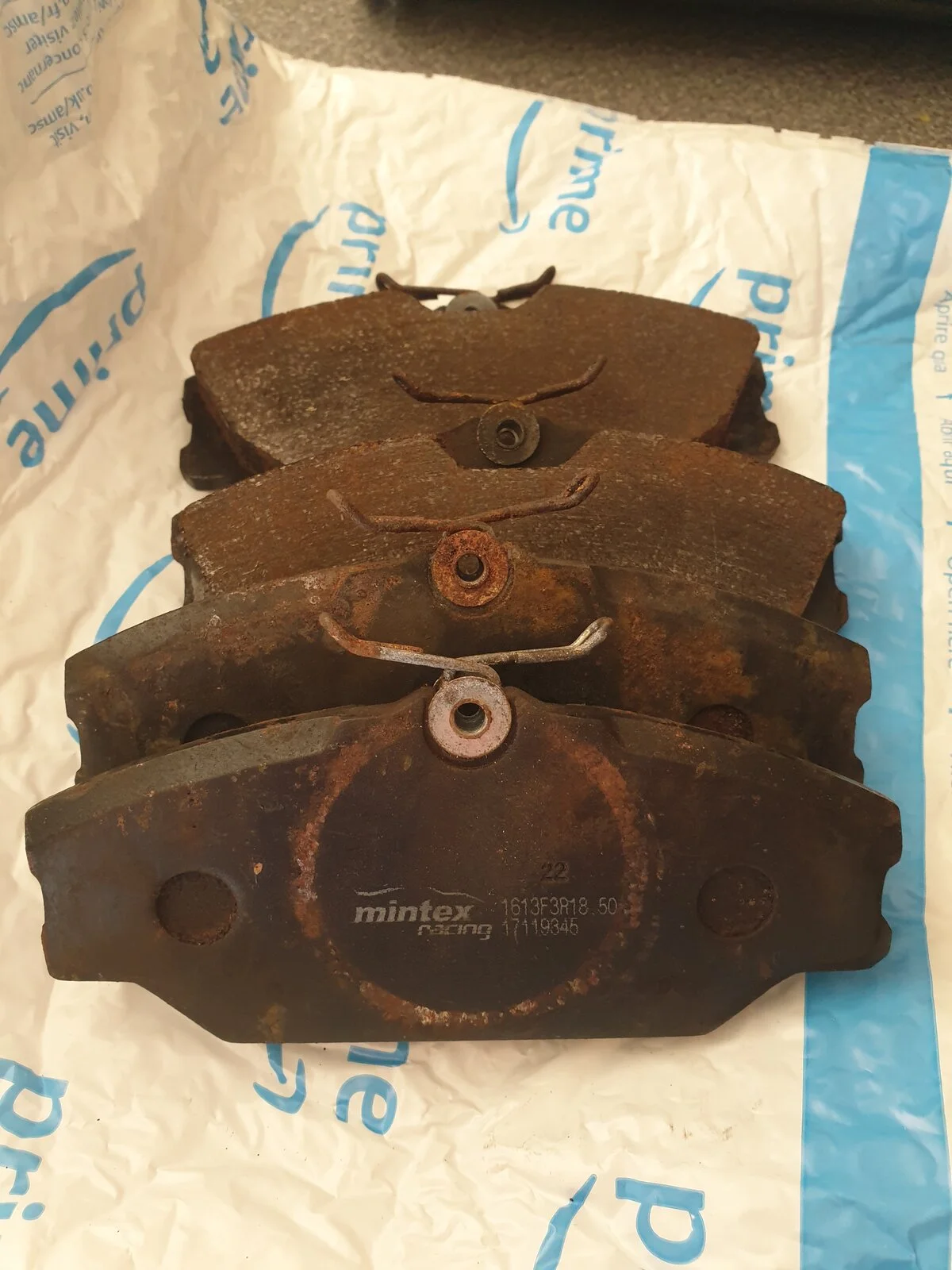

Mallory Park incoming February 2nd so fitted some semi slicks to spare f1's in case weather is good. And bought some Mintex f3 I think they are pads to try up front for the day.

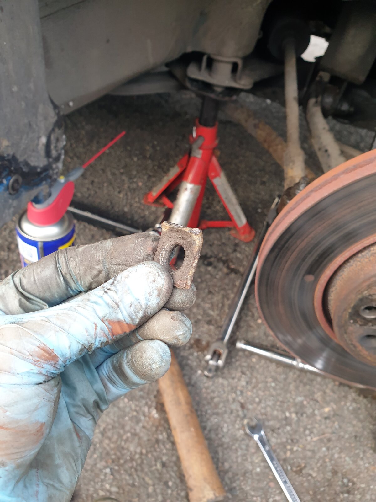

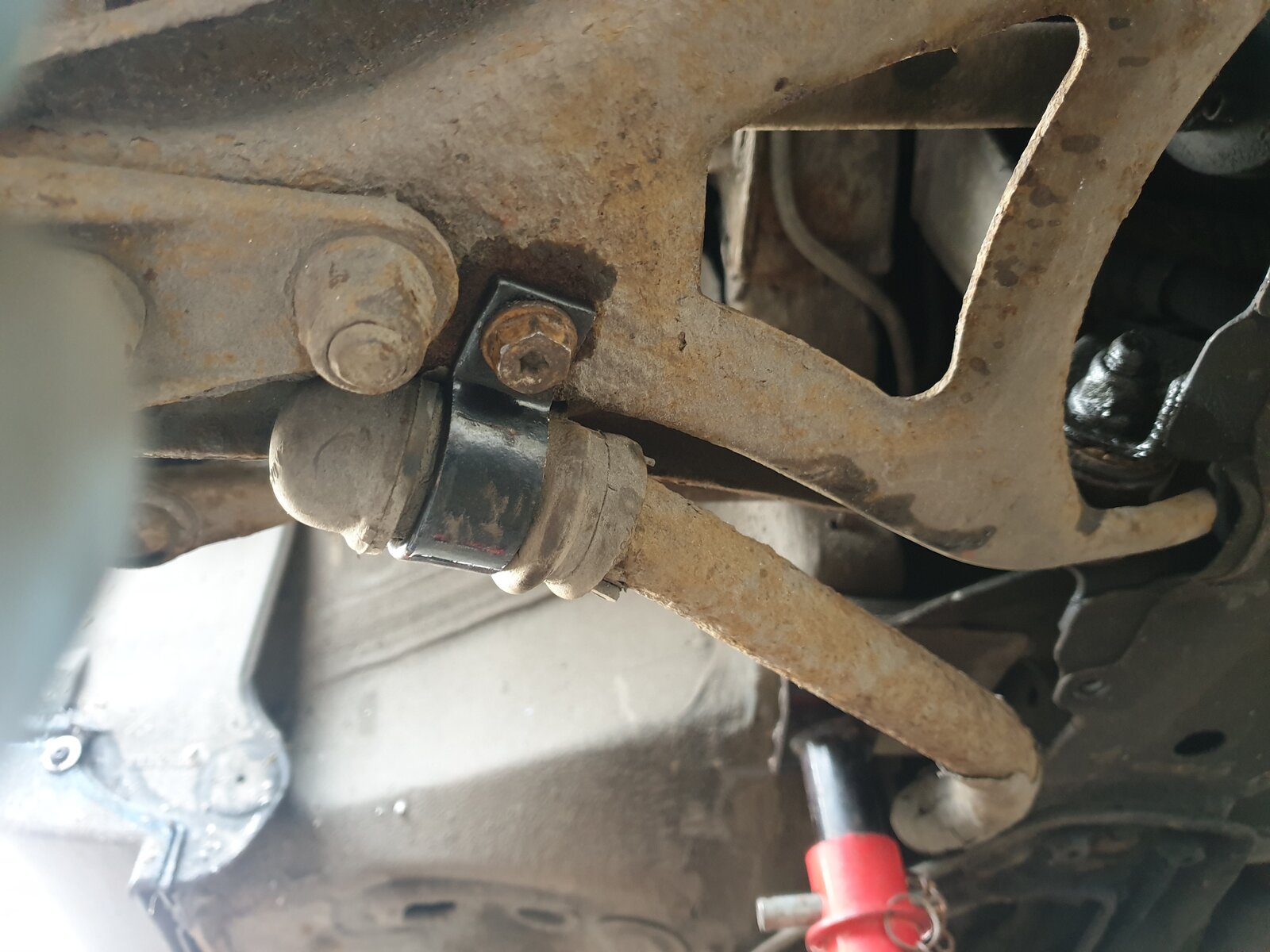

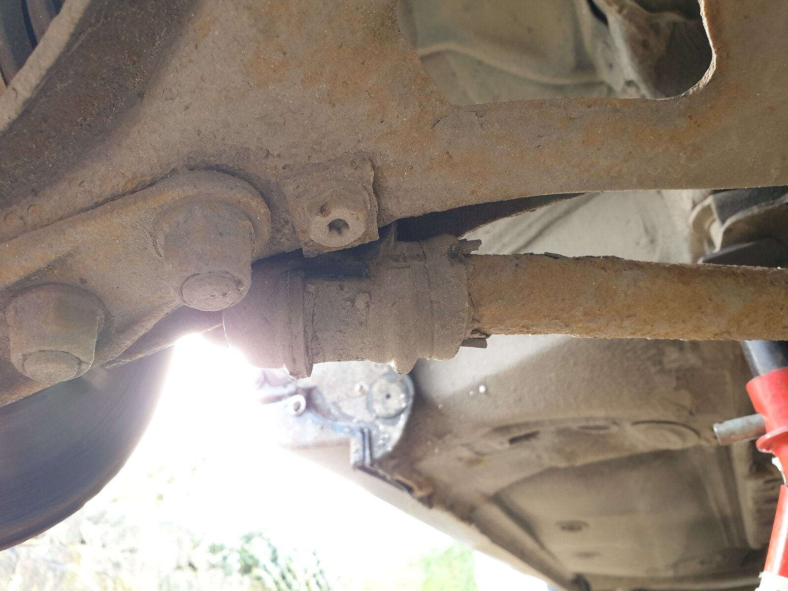

Just before lunch at Mallory, whilst negotiating the hairpin, I heard a metallic clunk and ping, but it down to tyre pickup as when I checked the car over nothing obviously amiss.

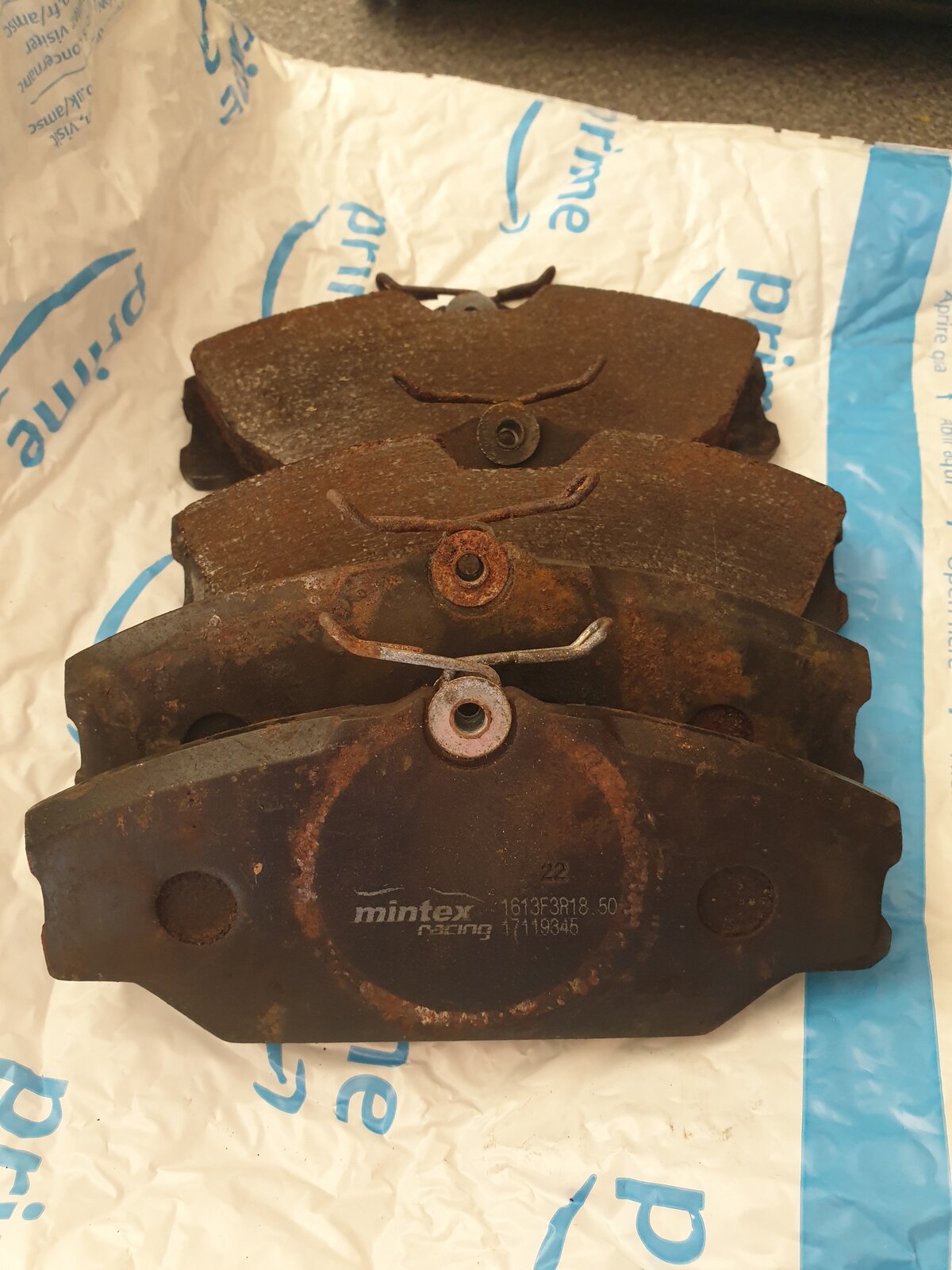

Drove to welwyn garden for work and back Monday/Tuesday and tonight just had time to swap back off the track pads and found...

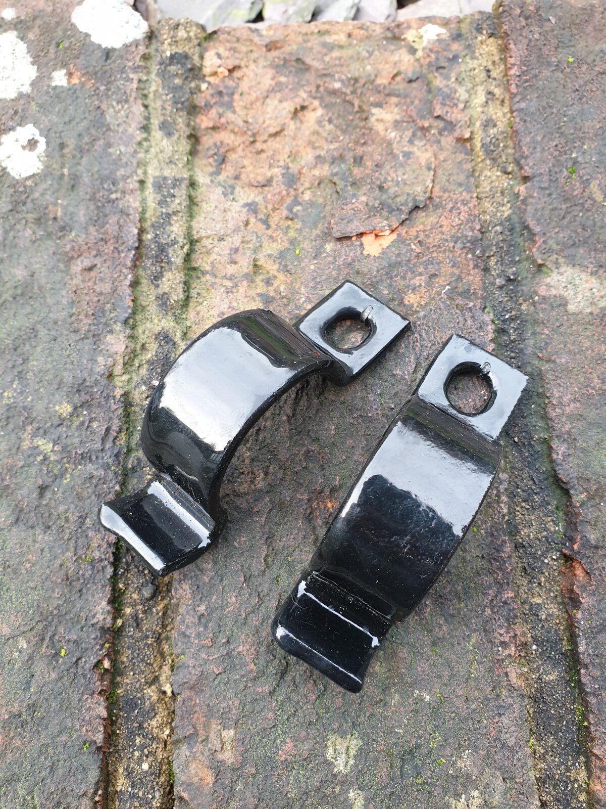

Oops, shed an outer arb bracket, lol
Luckily had some in the shed so easy fix
So road pads back in and sorted, back to the daily grind

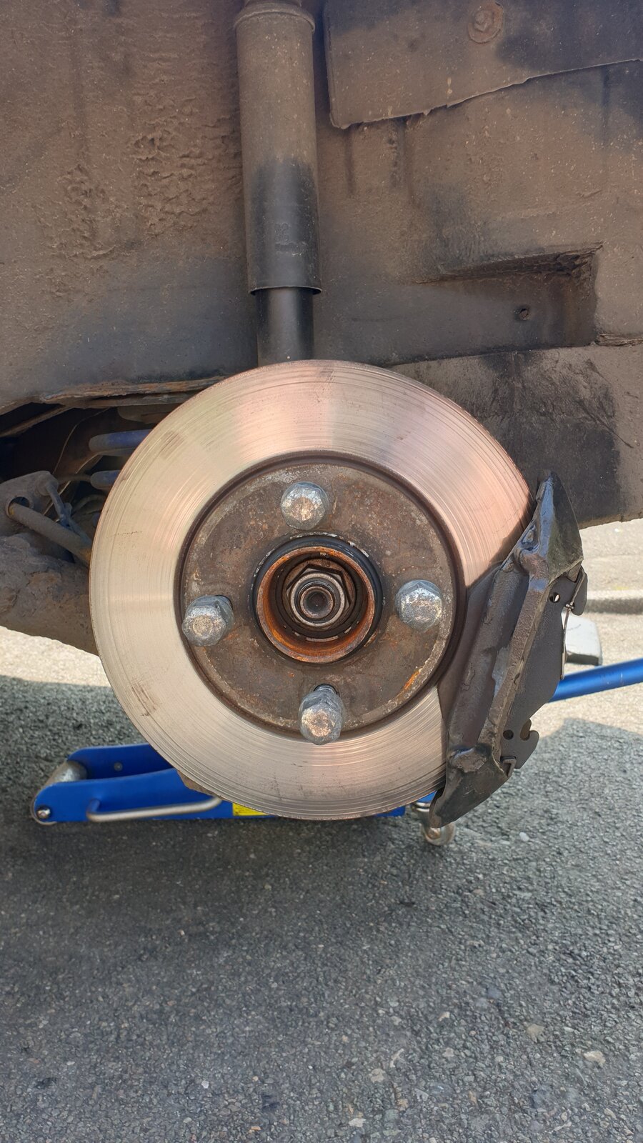

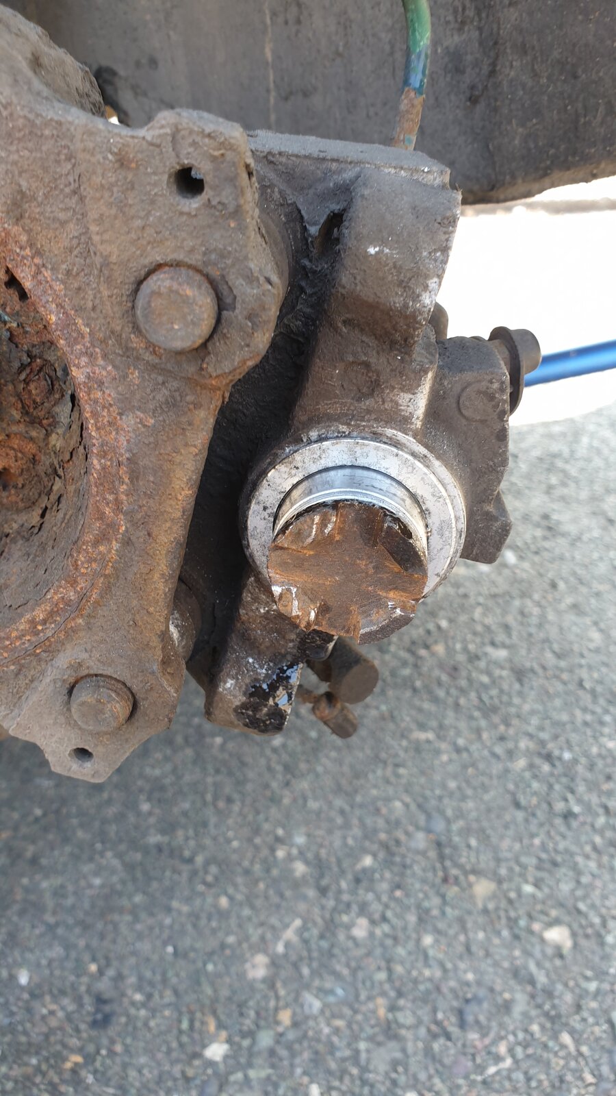

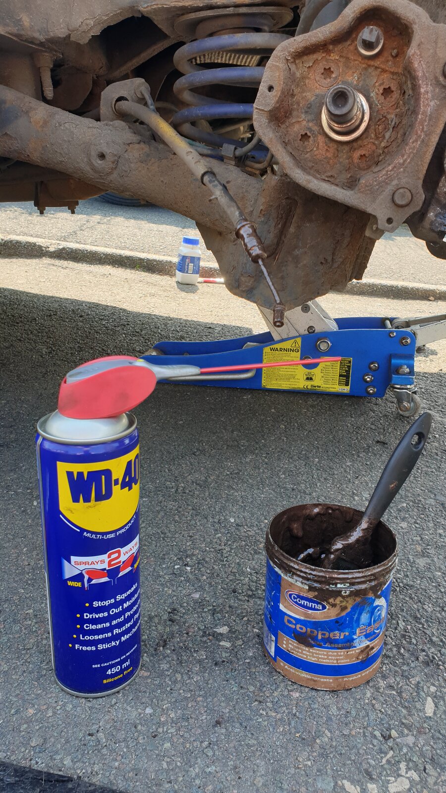

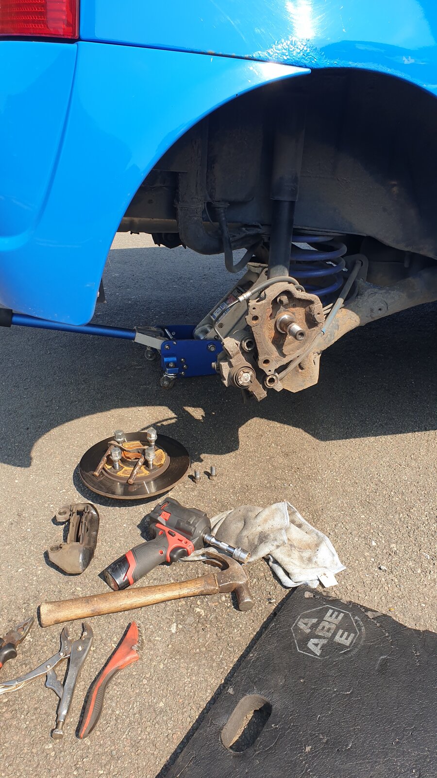

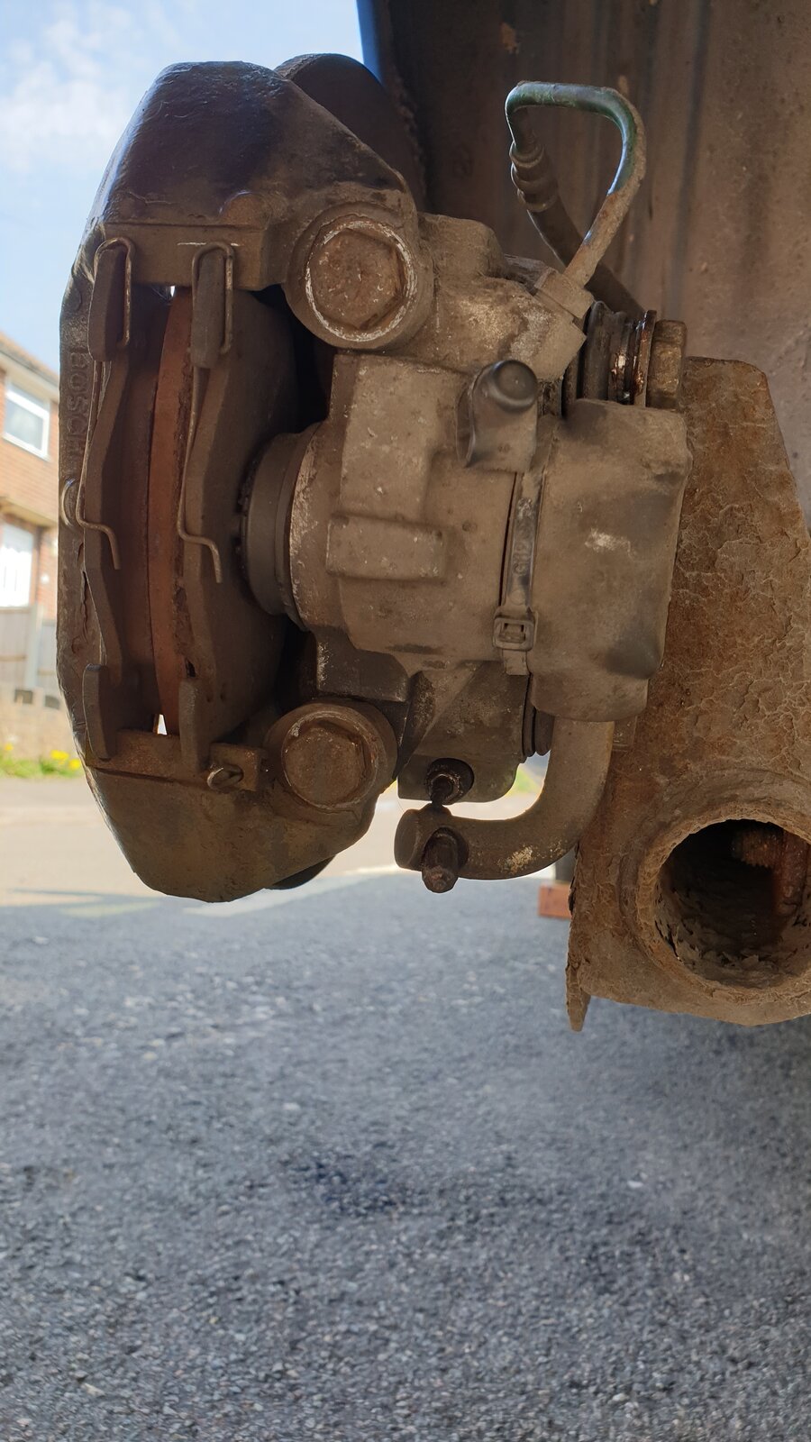

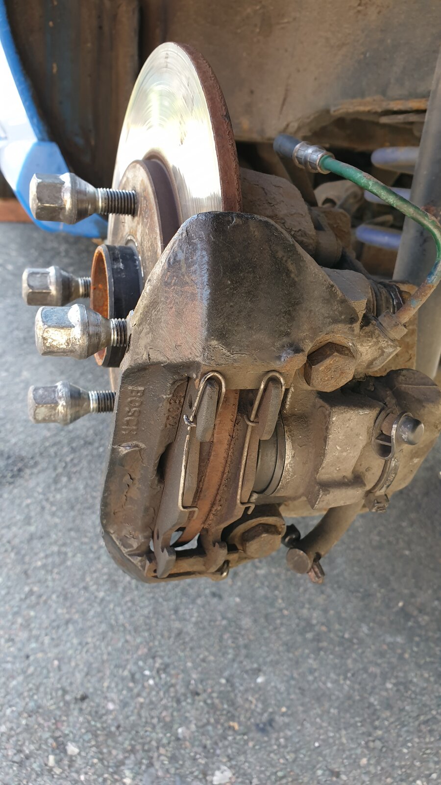

Took the opportunity today to strip, clean and re-grease the rear brakes as one calliper was binding slightly and it's another job i like to do once a year. The rears on the Clio's have been a weak spot, the calliper design harks right back to the R5's i think, so 80's design really.
So rear wheels off, whole lot taken apart, sliders removed, cleaned, seals oiled and re-greased pins. Wound calliper piston out, cleaned, greased. Cables removed from calliper, cleaned and greased. Then all bolts and bolt holes cleaned up with the wire brush and everything reassembled. Not a refurbishment, just preventative maintenance.

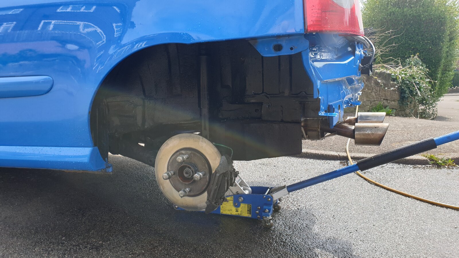

Stripped rear, note bumper off too......see next post for that one :)
In bits
Piston cleaned and greased
Handbrake cable, removed, cleaned, greased etc.
Back together
As said not a refurb, just general maintenance on a honest, daily motor that will end up ditched in 6 months again anyway so no point going to town on her. Just want it mechanically sound. Note inner pad been dragging, so worn more.....hopefully this will of fixed that!

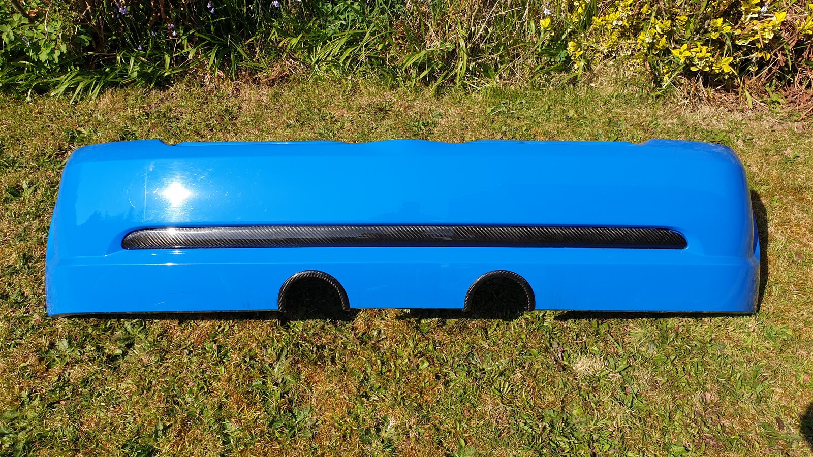

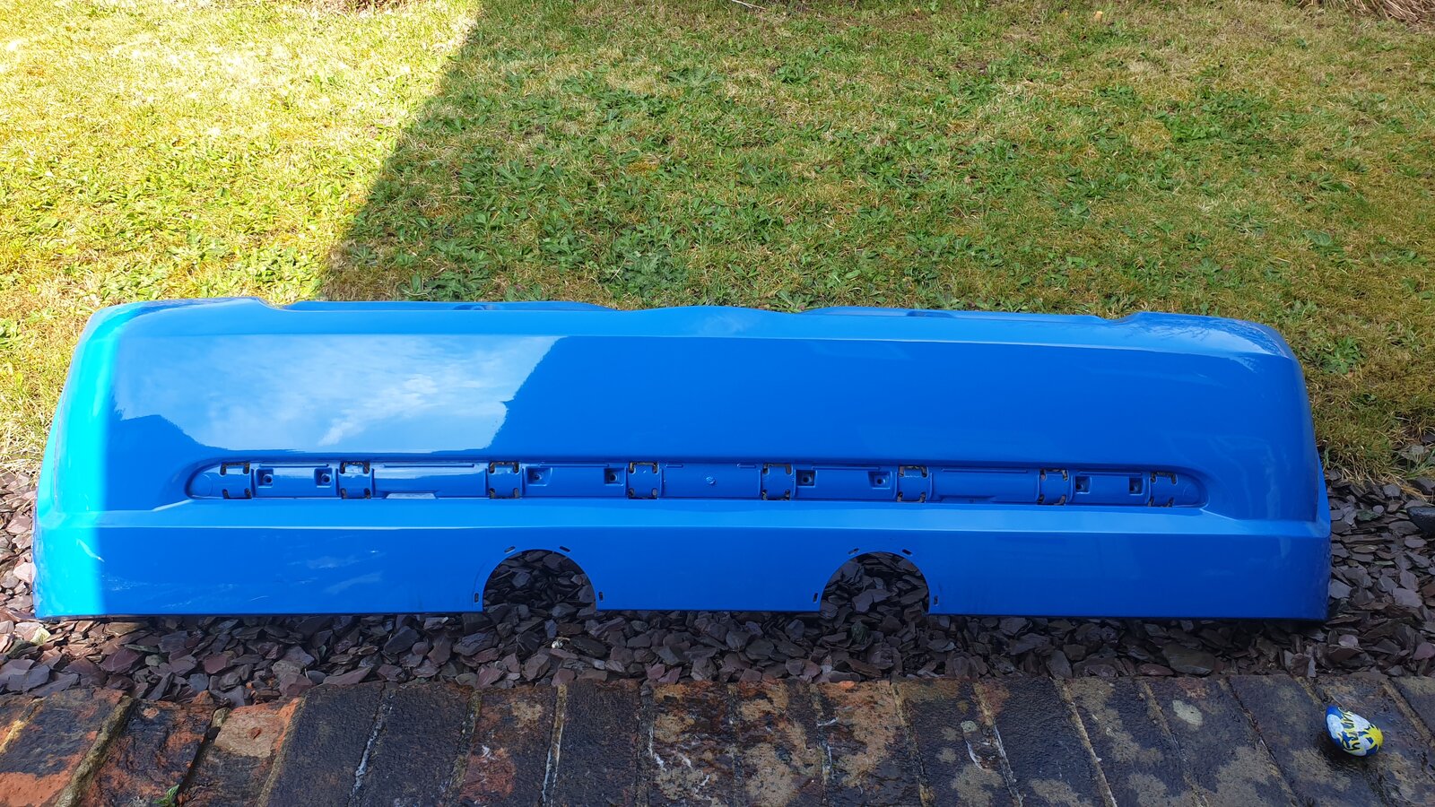

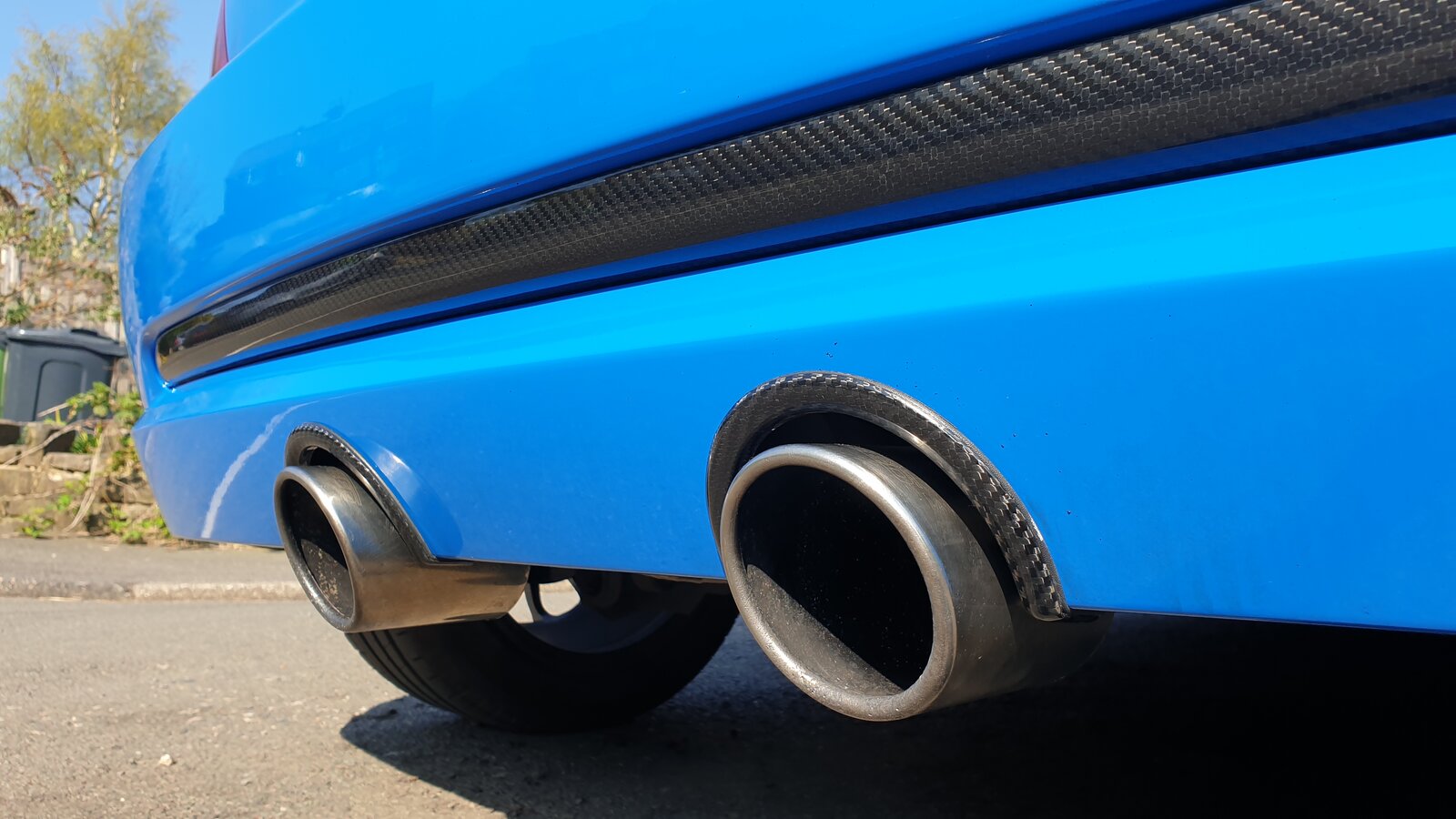

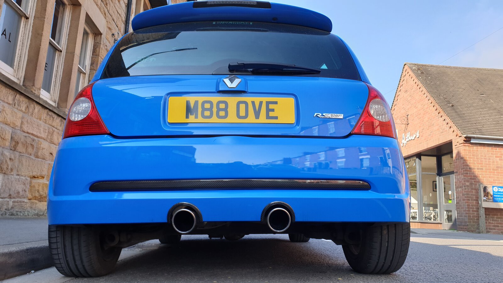

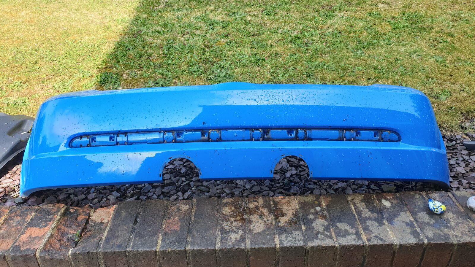

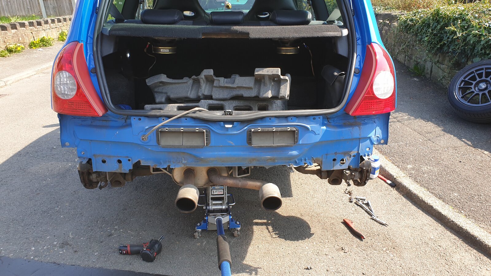

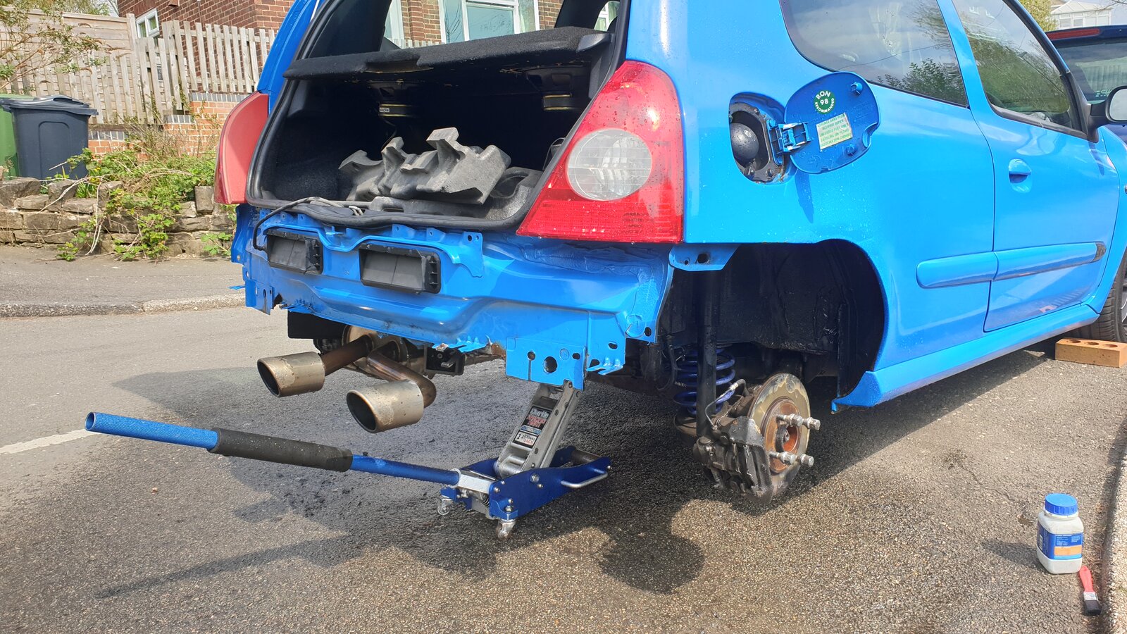

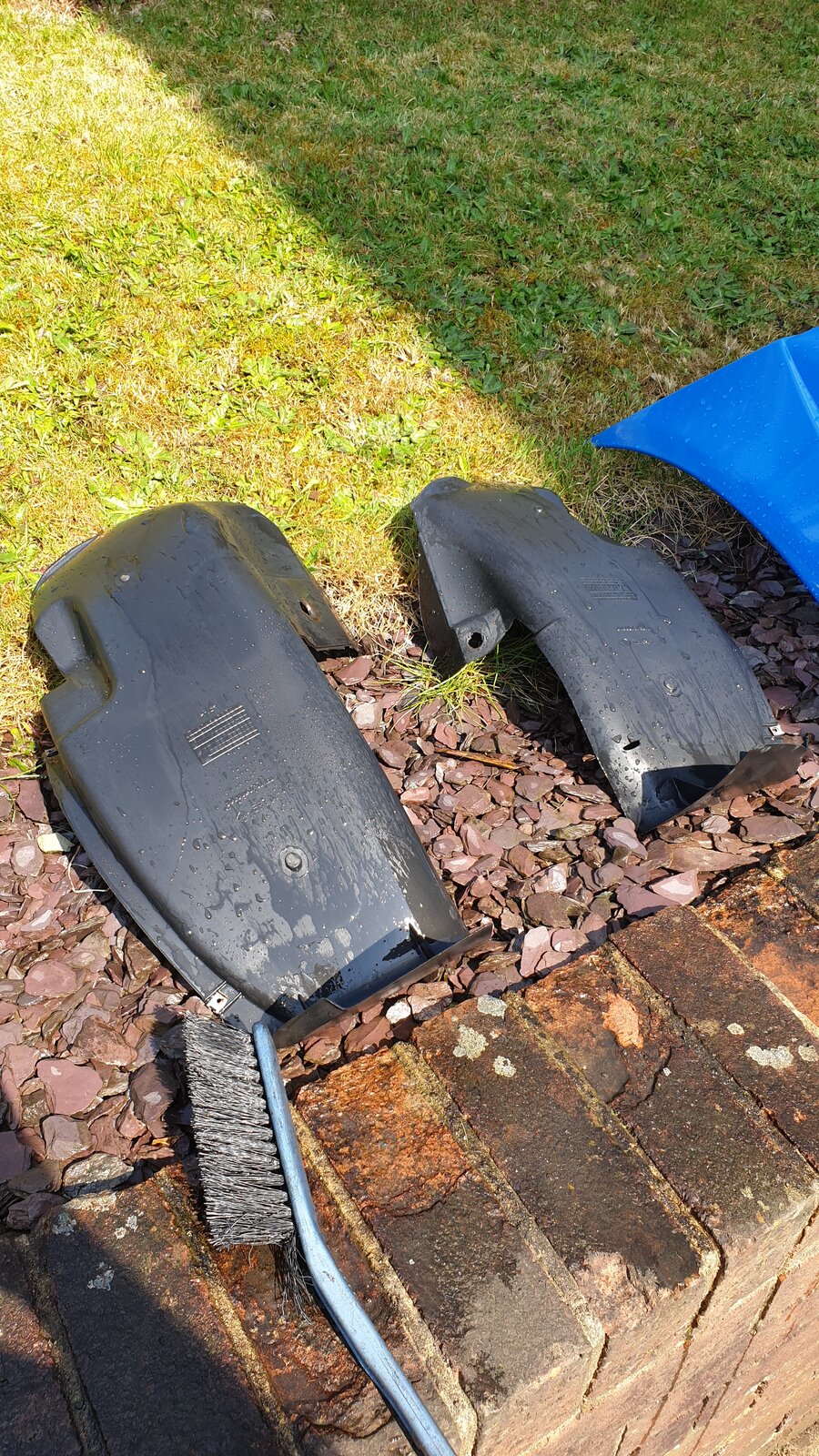

So whilst the car was up in the air for the rear brakes, thought I'd take the opportunity to whip the rear bumper off, clean everything up and fit the carbon insert and exhaust trims I have had in the shed since last Autumn.
Bumper off

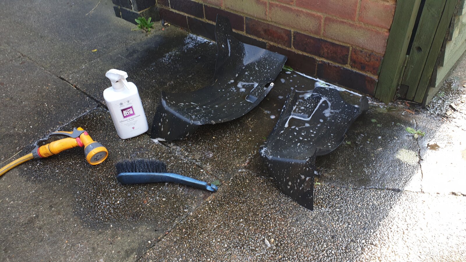

Arch liners out and cleaned up
Old trims removed
bumper cleaned up

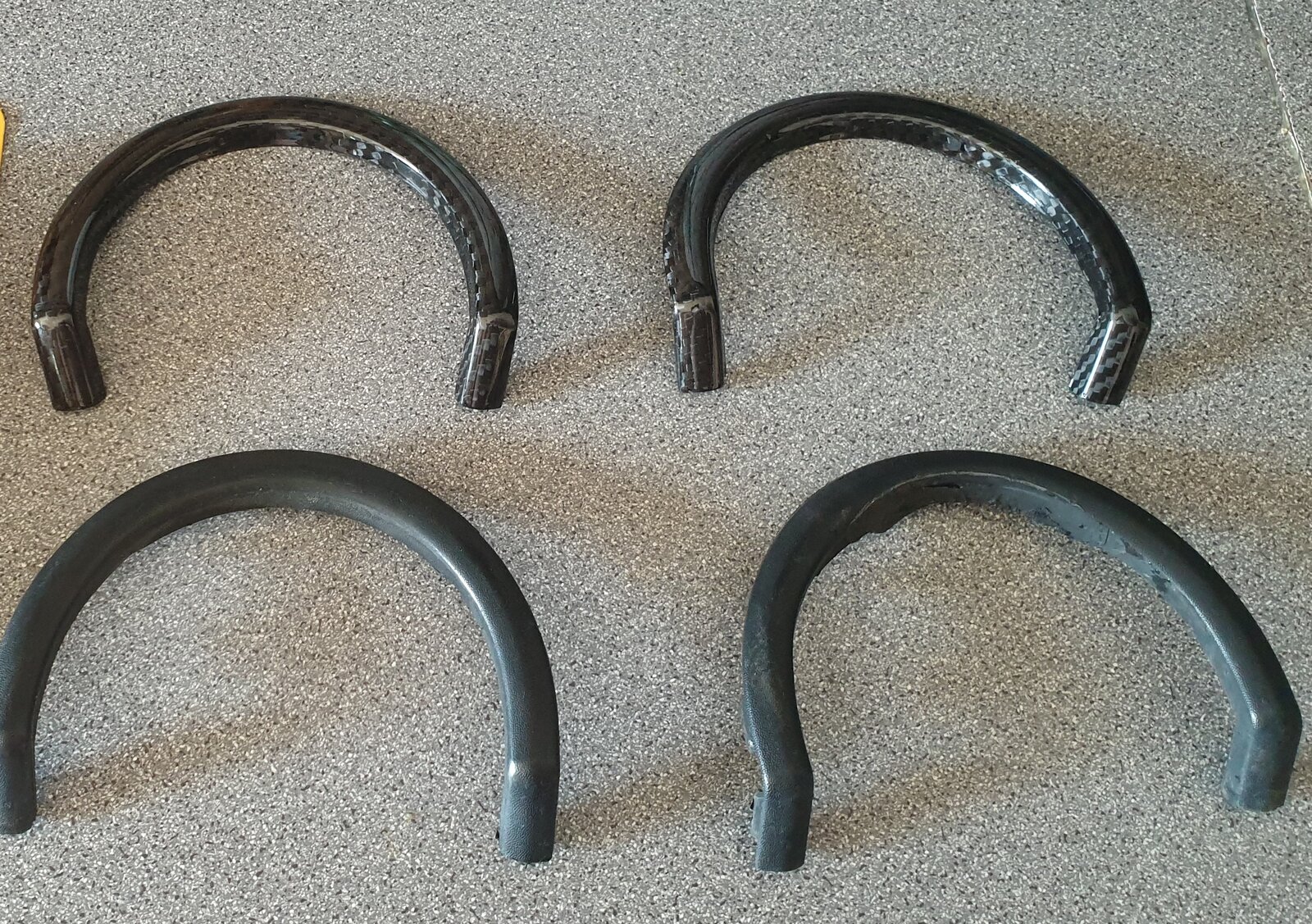

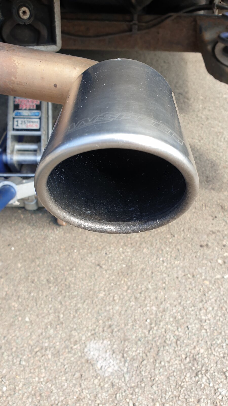

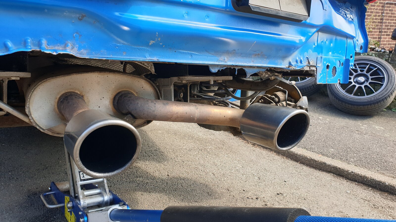

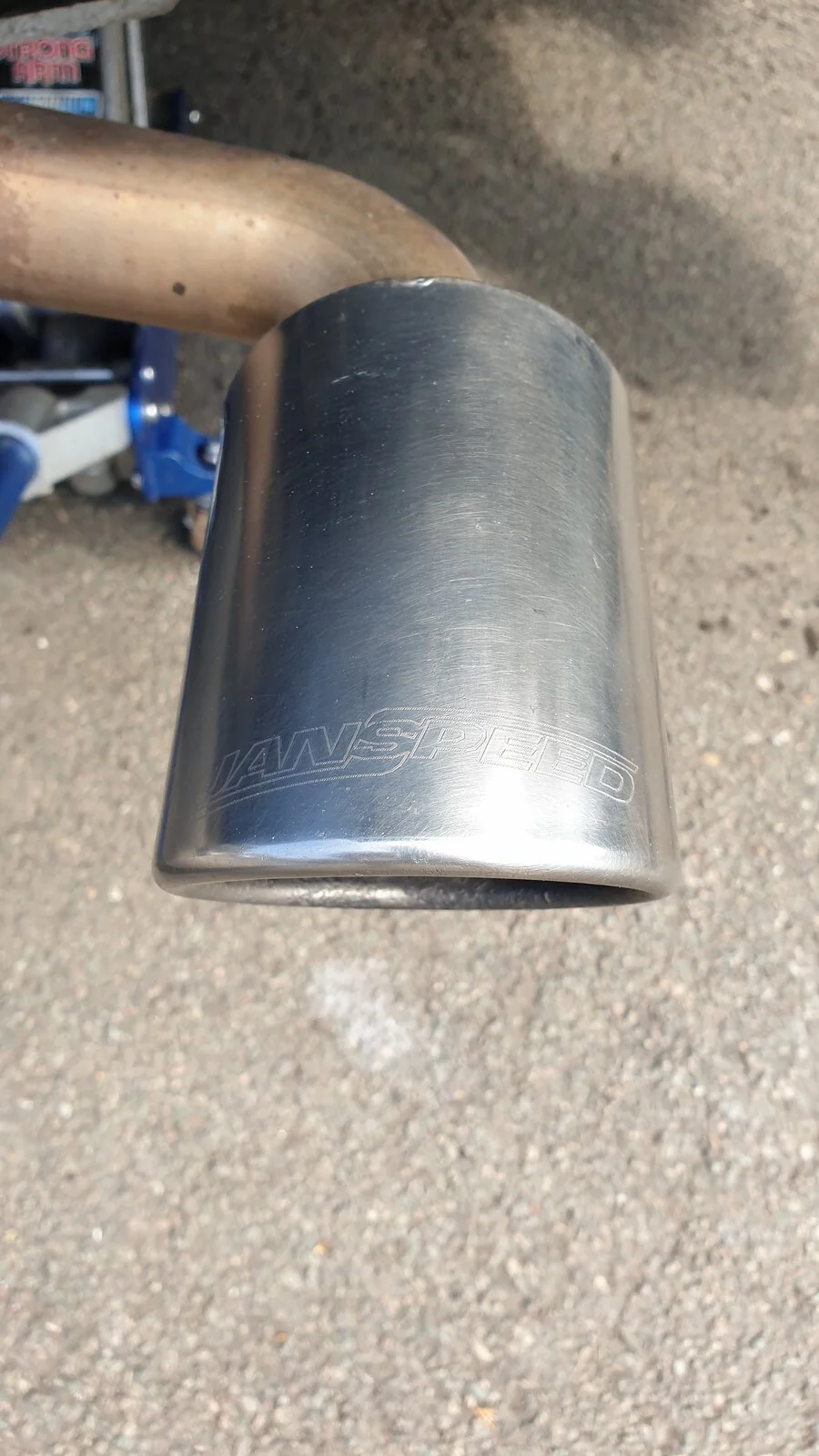

Tried to clean up my tail pipes as best I could, but they're beyond saving, ideally need hacking off and new ones welding on, but not really a major issue on a 200k+ daily car. No idea how old this Janspeed is either, so not surprising its a bit.....worn!
Coops Mk1
  Lots of Scrap...

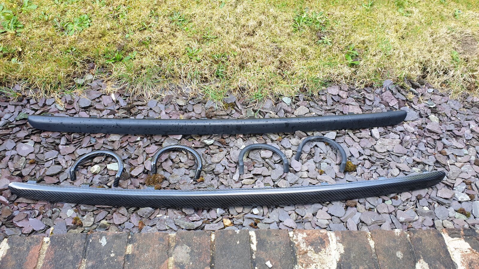

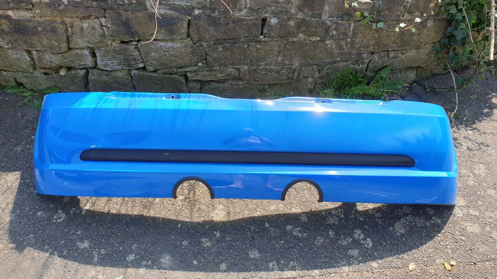

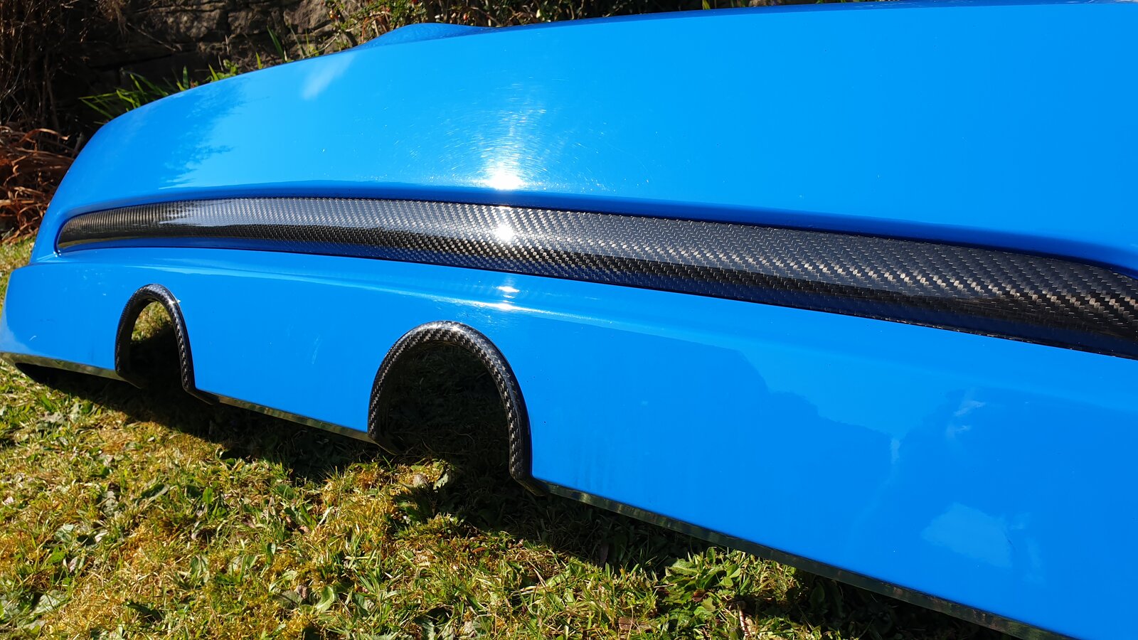

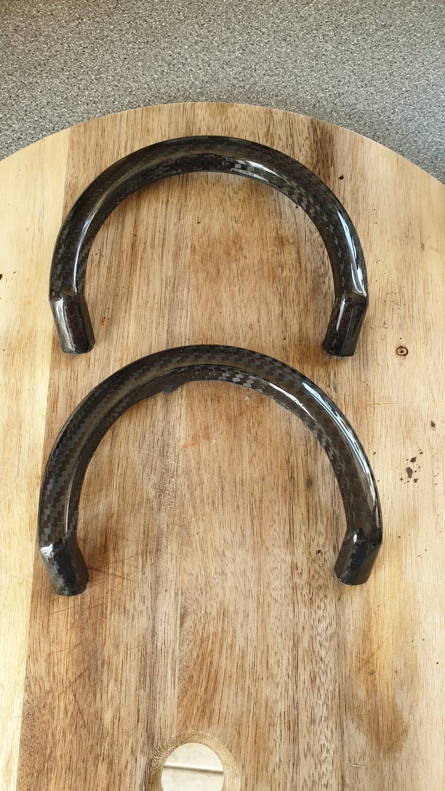

Old versus new, the carbon insert is a full direct replacement for the original, so this is why the bumper needs removing. The clips holding the old one in are seriously heavy duty really for what it is and need to be popped out from the rear with the foam padding removed.
The exhaust trims require bonding to the originals, they are not stand alone direct clip in like the insert.
Exhaust trims cleaned up ready for some quick drying araldite
bit of bondage for a bank holiday weekend, oooo suits you sir!

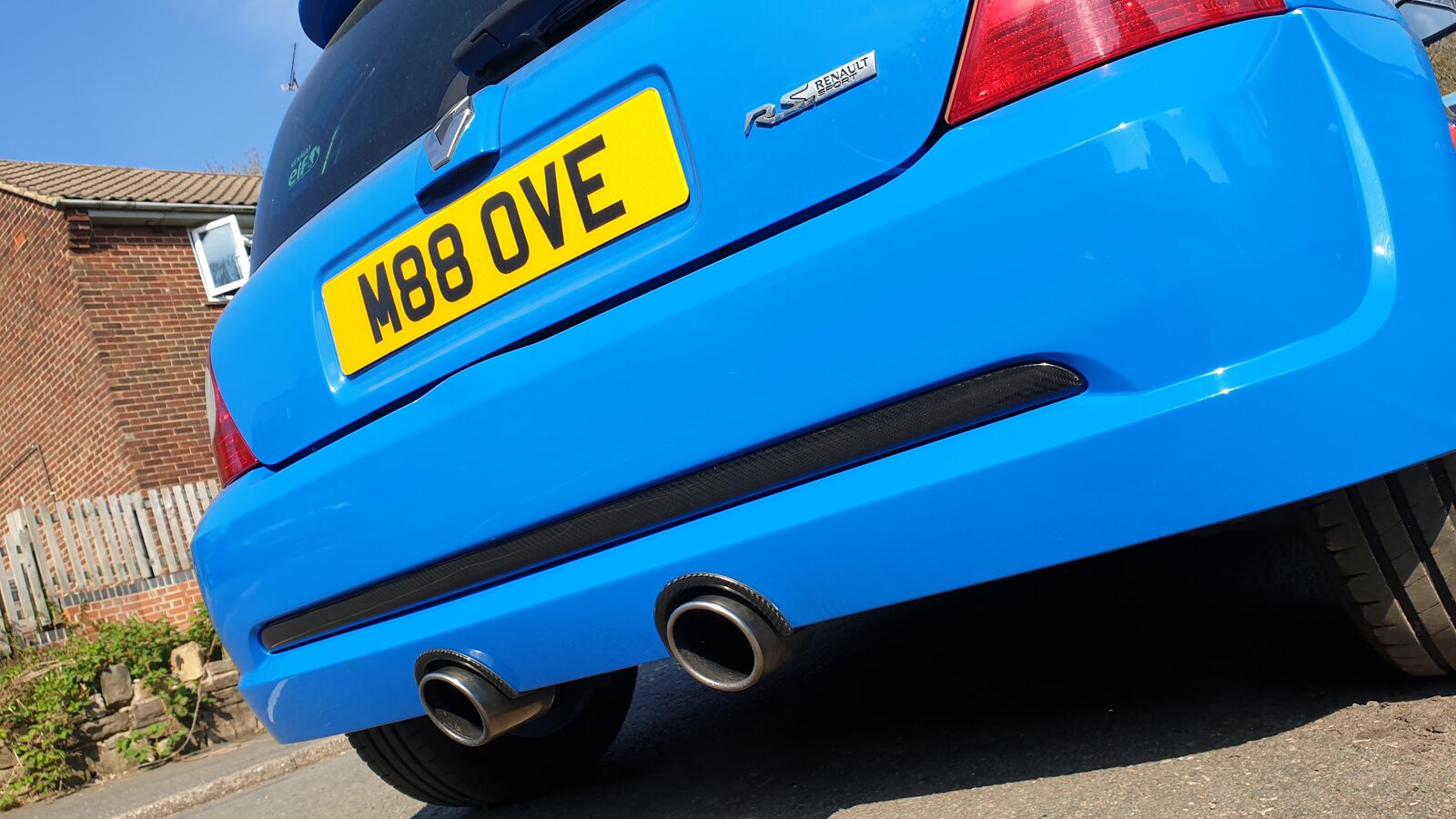

and done
Refitted to cleaned bumper
and chucked back on car, again cleaning up bolts and greasing everything as I went

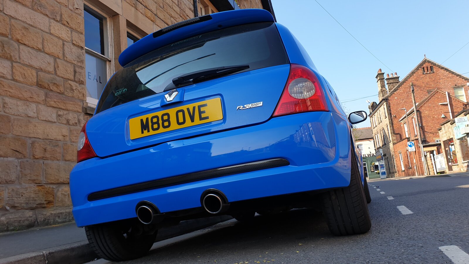

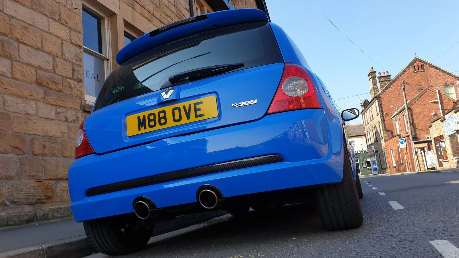

finished result, Dat ass! With the trophy spoiler and 200 badge I'm proper chuffed with the rear end now, it's basically perfect imo. and lest face it, my car so mo is the only o that counts ;-)
