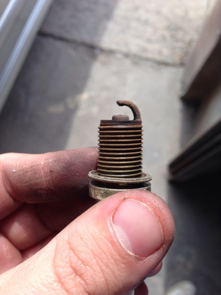

When did it last have a service? My car had a low down hesitation/misfire and then once over the 5k mark a bigger misfire that held it back! Turned out the spark plugs were that old the gaps where huge! Could be worth a look? Just make sure if you do change them to get the NGK plugs as they are the only ones recommended
Pic of the plug

Plugs look a little lean. Does have some wear on lower electrode so ill replace them with what ever the book says. Has a cool 10 heat rating on the current plugs. What plugs do you lot run?

Consensus is genuine OEM plugs only. Loads of threads about non-OEM plugs causing all sorts of misfire, idle, power issues etc.
NGK-PFR6e-10
Actually very reasonably priced.

Ah bum iv just put the BOCH equivalent of the NGK in as they only had 3 of the NGK. Iv also cleaned the throttle body as it was crapped up.
