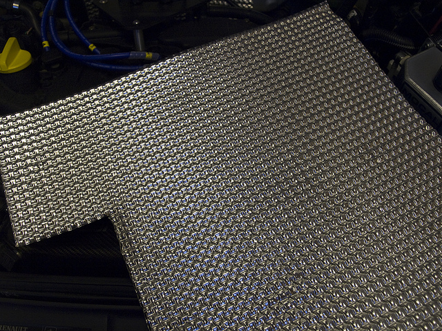

I've just cut my nimbus heat shield to size (and my arm in the process, offcuts are sharp :eek: ).
Looks better than the current one and covers the brake pipes and loom nicely. :)

Not a very interesting photo, as it's not on the car yet, just cut to size/shape. :)
The same shape as the current piece, but deeper to cover the pipes and loom.

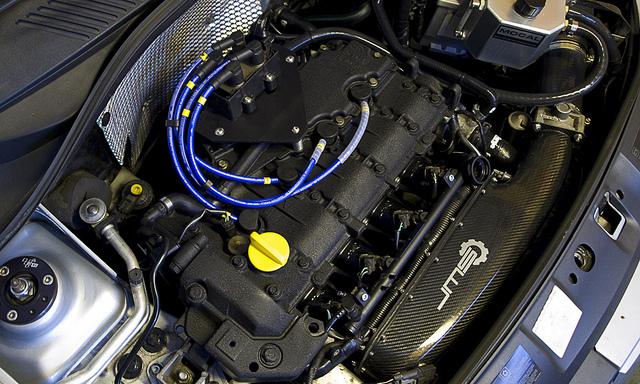

And just an engine bay shot. It got a bit dirty from travelling over the past couple of weeks, so I've given it a quick wipe over! :)
Off down to Danny at 519 tomorrow for a timing check; I want to make sure it's running right before I get mapping sorted. :approve:
