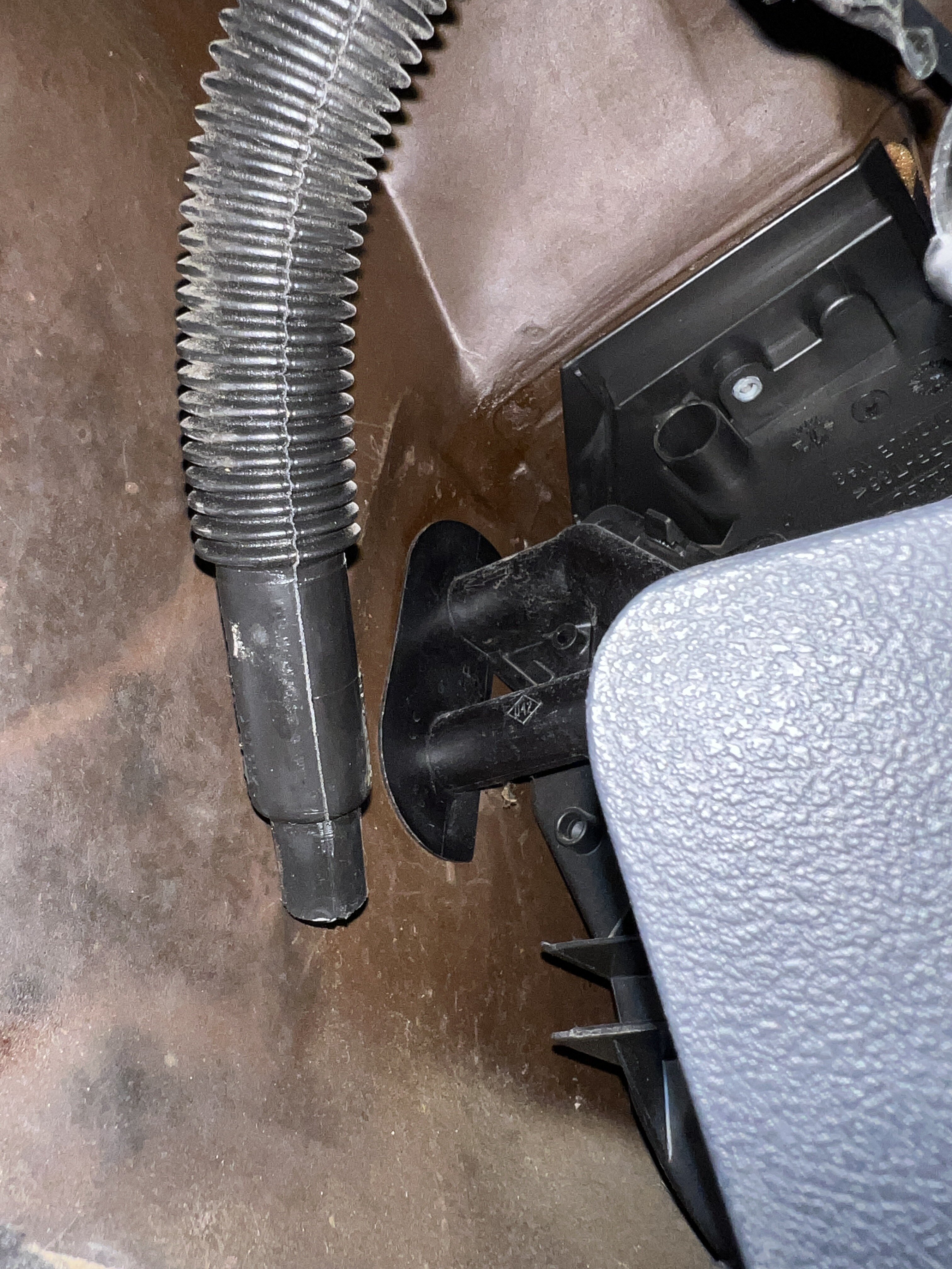

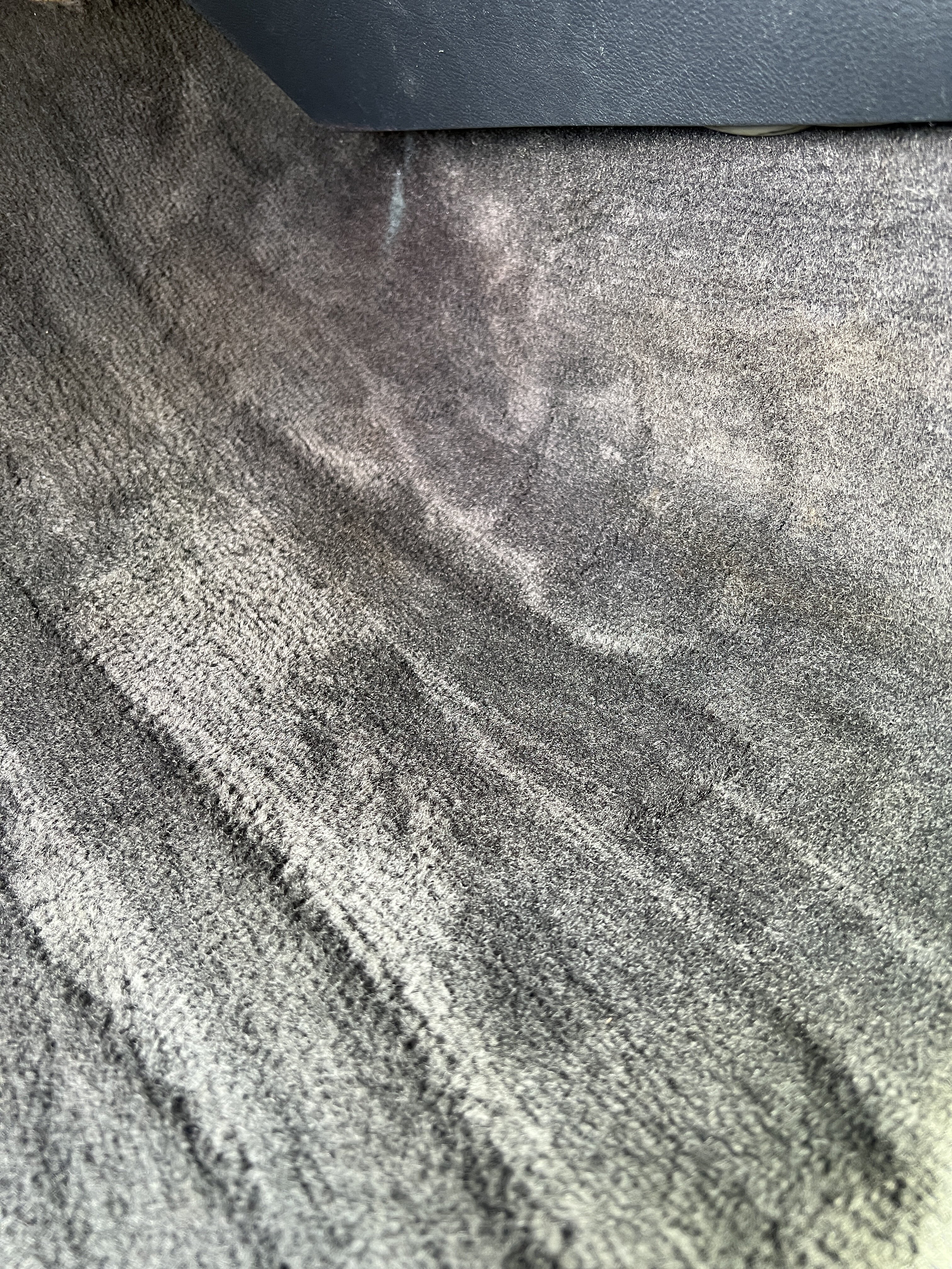

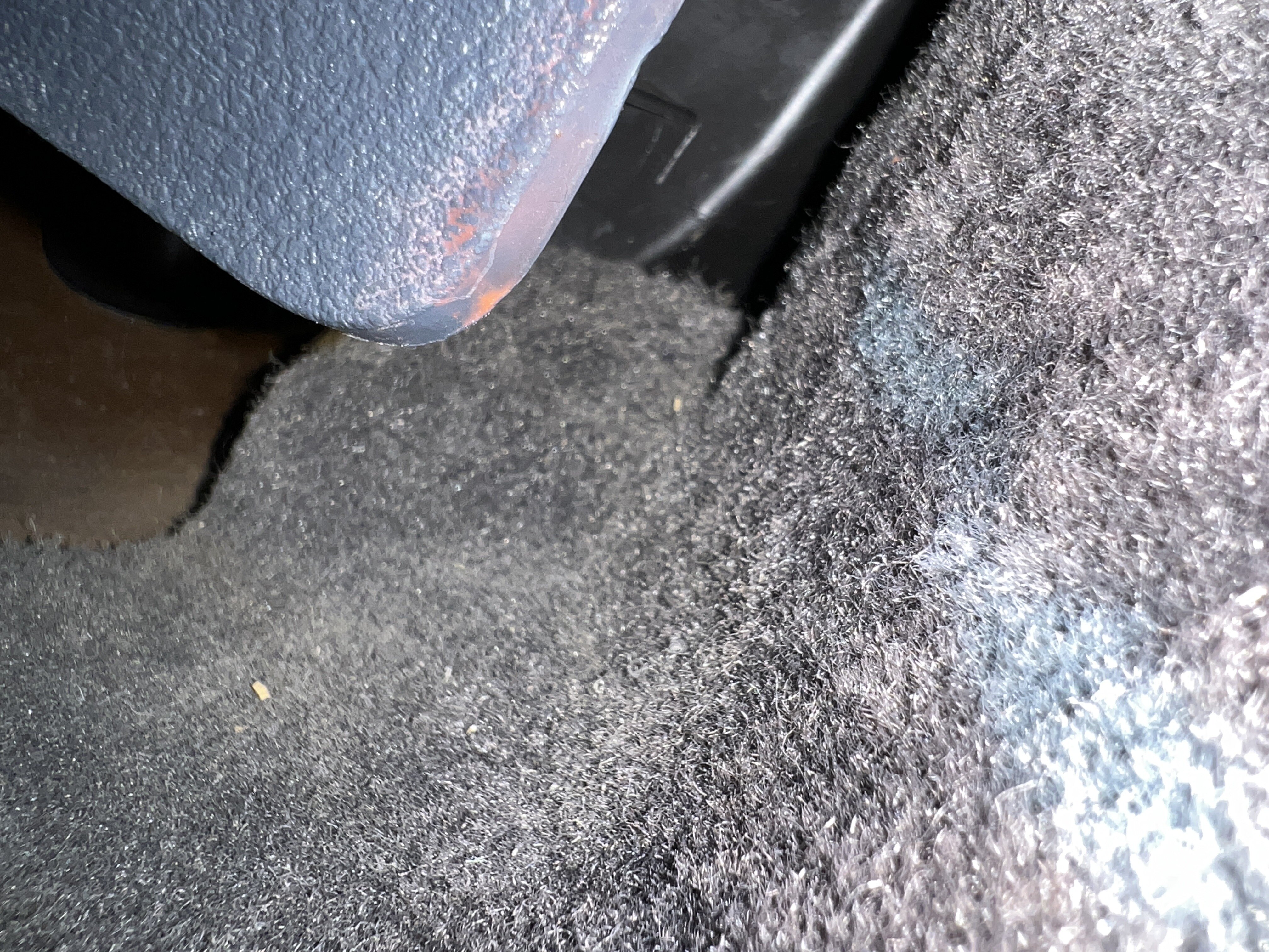

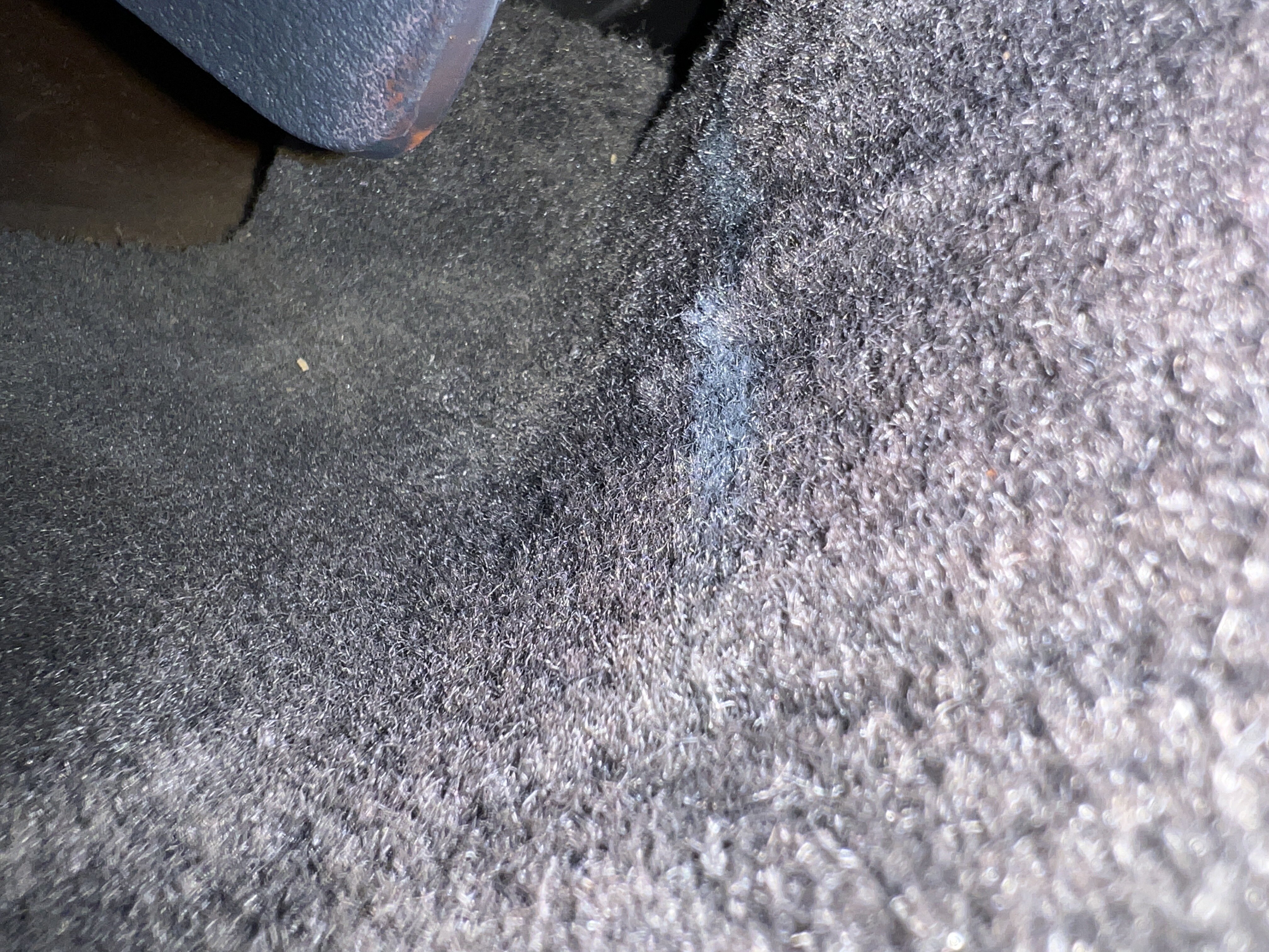

I got to cleaning the car this morning and I found this wet spot on the carpet.
My car has had water ingress for a while but this is more greasy and has a strong smell to it… not sure tho it doesn’t really smell like coolant.
But I’m still thinking it might be the heater core leaking ? Any idea ? Anybody has had this before on here?
This blue spot also kind of throws me off, it looks like something electrical blew off

Pressure up the cooling system to 15psi and you will soon know if matrix is leaking. Itll stink of coolant inside the car.
