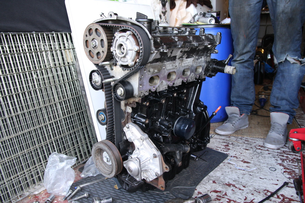

I'm about to order the cambelt kit for the engine we are rebuilding. It's a 172 Cup bottom end with a Ph1 (2000) top end. I've been advised that I need to order the ph2 kit as the differences are relating to an idler pulley on the bottom end. The dilemma I have is that we've used various bits from the ph1 bottom end to replace missing parts on the ph2 bottom end.

Therefore, does anyone have a picture of what I need to measure to check what kit to order, just so I can be 100% sure?

Humour me Fred and point out in a picture what idler spacer we are actually talking about?!
The ph2 bottom end had a few bits missing so we had to use bits off the ph1, I'm just not sure which bit the difference refers to.
the spacer behind one of the idlers is the only difference. If you have one that sits flat behind, thats a ph1, if both spacers slot into the idlers then that is ph2
Right...the blue one?
(thanks Jord for the pic.)
Guy's, do either of you two have a spare ph2 spacer I could purchase from you, or is the spacer available by itself from reno?
